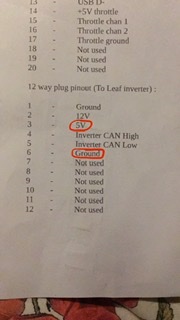

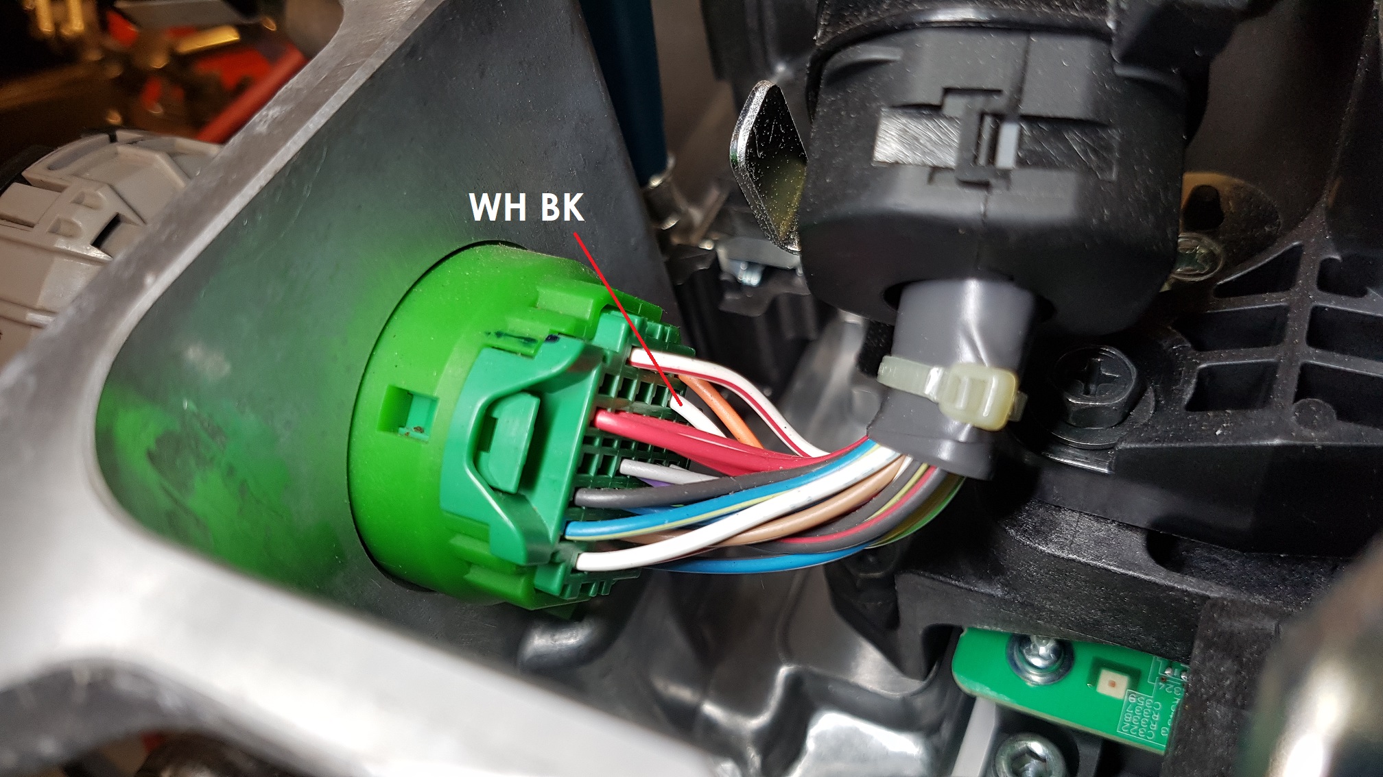

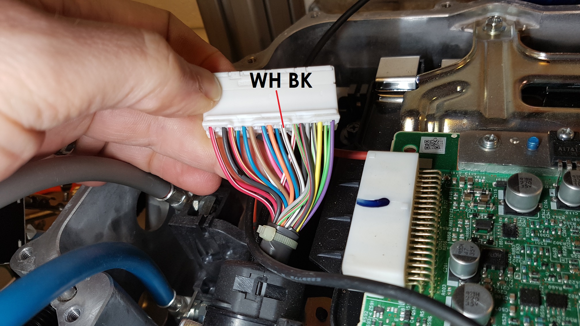

Hi James, like you, I have been digging around looking for the 5v source for the board. For now, I have been powering it externally from the breadboard ps.
The closest I got was when I had a look around the leaf board and found that the resolver temp senser sends 5v. From the board to the connector it is the WH BK wire. On the harness side, it is BK PK.
When I last tried to use this as a power source for the board, it drops to 1v. Not sure but it may be down to me using the 2 grounds that leave this plug incorrectly? I did have them connected together for initial testing. Like you said, not sure where the 2nd ground is specifically meant to go.

The 5v to leaf inverter might just be a spare? From the connector details it doesn't take 5v in, only 2 12v from the battery, 12v key on, and two 12v supply grounds. Also, Damiens board generates its own 5v supply rail, so no need to bring in any 5v to the board. In my configuration the only wires I've got taken out from the main connector are two sets of can wires (spliced from the factory) and the respective 12v, IGN, and grounds (2). Everything else I've left connected (I did untape the entire harness to make things a bit easier).

Correct on the 5v from the board. Just figured that out yesterday when wondering why i was stuck feeding it external 5v via usb to power it. After reviewing the build in design spark, and doing a bit of testing I realised I had the step down reg pin for the 5vcc o/p was not touching the pad.
Fixed now

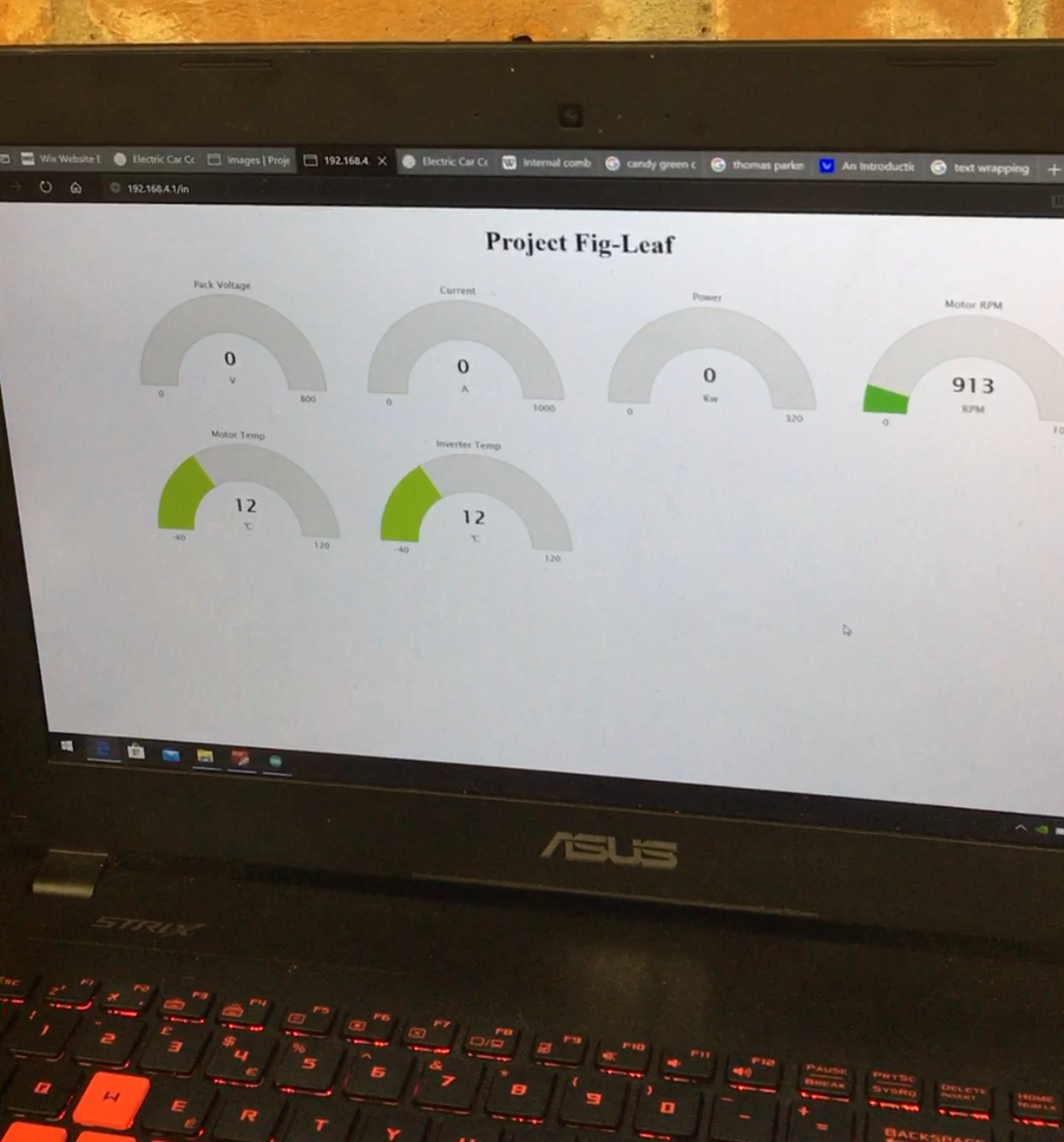

Made some progress with the VCU board. Just got WiFi working :)
I went through the leaf_wifi.ino code and solid-gauge.js looks like it’s missing from the GitHub repository:
https://github.com/damienmaguire/Nissan ... /WiFi/Data
(you can get it from any of the other WiFi board repositories used here)
The VCU board Is now working with V1.5 software. As you can see the Voltage, Current and Power info is not showing on the WiFi Yes as I still need an ISA shunt.
I’m still having trouble with pre-charging. Looking at the code it seems simple enough, just set the voltage level that you want the main contractor to engage and when you send the 12v ignition signal through IN1, the pre-charge contactor and Main contactor should engage through OUT1 and OUT2. So far not getting any output from either pin.

Great work James. Got me over the hump. I'm seeing the same as you now on the web interface
I am also stuck at the same point as you. I have 12v going into IN1 and I trace the voltage all the way over to R14 where it drops to 3v and off to the chip. Tried various times and get nothing out on OP1, 2 or 3 yet. As with James, I'm working through the code to see if I have missed anything.

"As you can see the Voltage, Current and Power info is not showing on the WiFi Yes as I still need an ISA shunt."
"I’m still having trouble with pre-charging. "
Join the dots folks....
