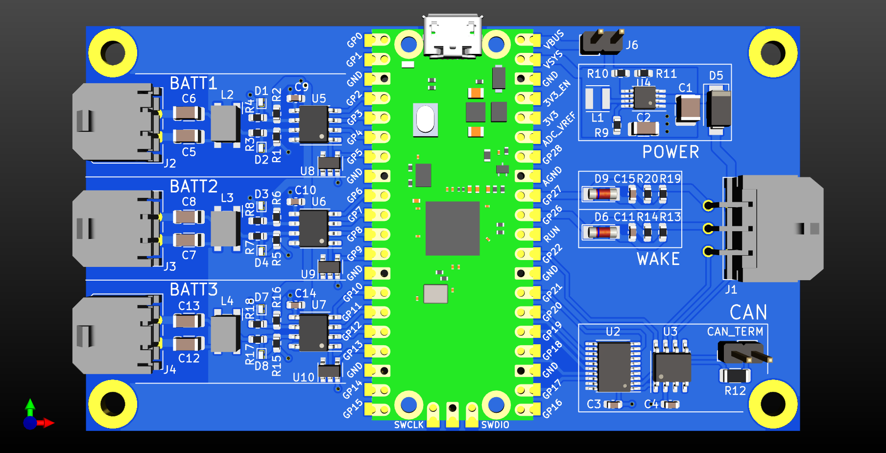

Re: New BMS for bq76PL455A based batteries
Posted: Sun May 15, 2022 8:50 am
by catphish
I think I'll spin a new board.
Posted: Sun May 15, 2022 9:27 am
by Pete9008
Looks good.
Posted: Sun May 15, 2022 1:47 pm
by catphish
I've ordered a new board with the 5V drivers. Fingers crossed!
Latest schematic here: https://raw.githubusercontent.com/catph ... ti-bms.pdf
It occurs to me that there is another improvement that could be made. I'm not inclined to do so on my board at this late stage but for a redesign, I would consider tying RE and DE together, and putting a pull-up on RO. This does 2 things:
1) Frees up a GPIO per transceiver!
2) Disables RX when transmitting, no PIO JMP needed!
Edit: Remembered why I didn't do this originally, the board has a low power sleep mode that shuts down both the TX and RX.
Posted: Sun May 15, 2022 4:57 pm
by Pete9008
That had me worried for a minute, from the render it looked like the chokes were in the wrong way round :o
Just checked the PCB and it's fine though :-)

Yes, for some reason I mounted the chokes sideways. I think at some point I must have been extremely tight on space, and it stuck.
It's all JLCPCB. They have stock, but prices are through the roof. £160 GBP for 5 boards. I really hope they work!
