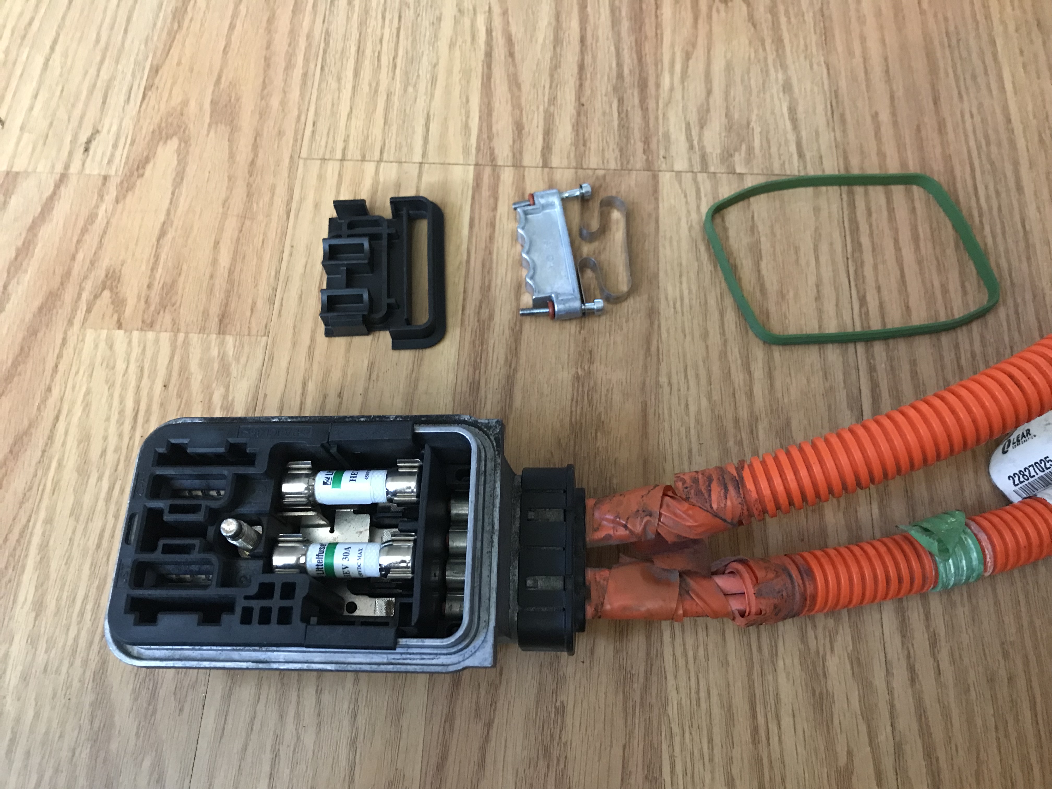

Literally Nobody: "hey remember that wrong cable that you bought [on eBay for over $100 bucks cause you don't like money] for the first gen Chevy Volt converter, did you ever wonder what's inside that fused box plug?"
Me: "hold my beer"
Re: I bought a Chevy Volt Gen1 DC-DC Converter - Now What?
Posted: Tue Mar 15, 2022 11:30 am
by Gregski
"this part appears to be non serviceable, so I am going to take it apart anyway"
~ Professor John D. Kelly
~ WEBER STATE UNIVERSITY
