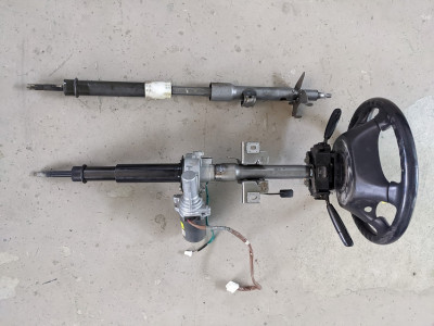

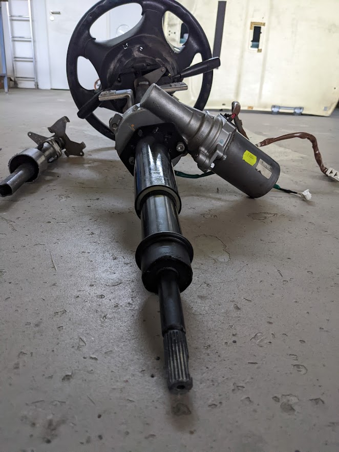

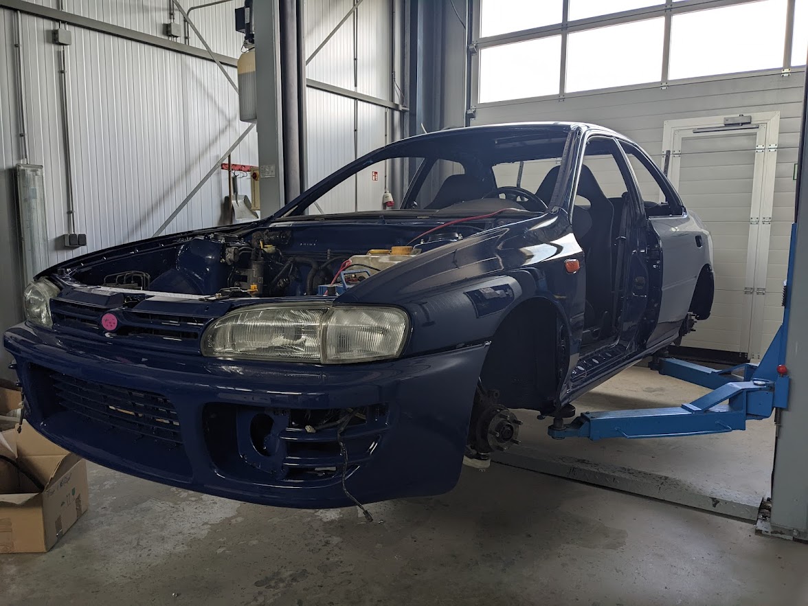

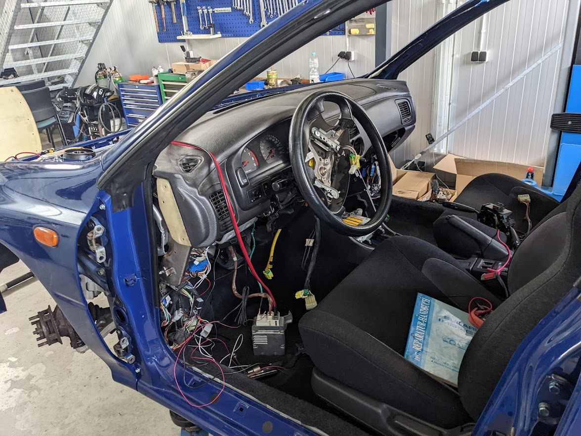

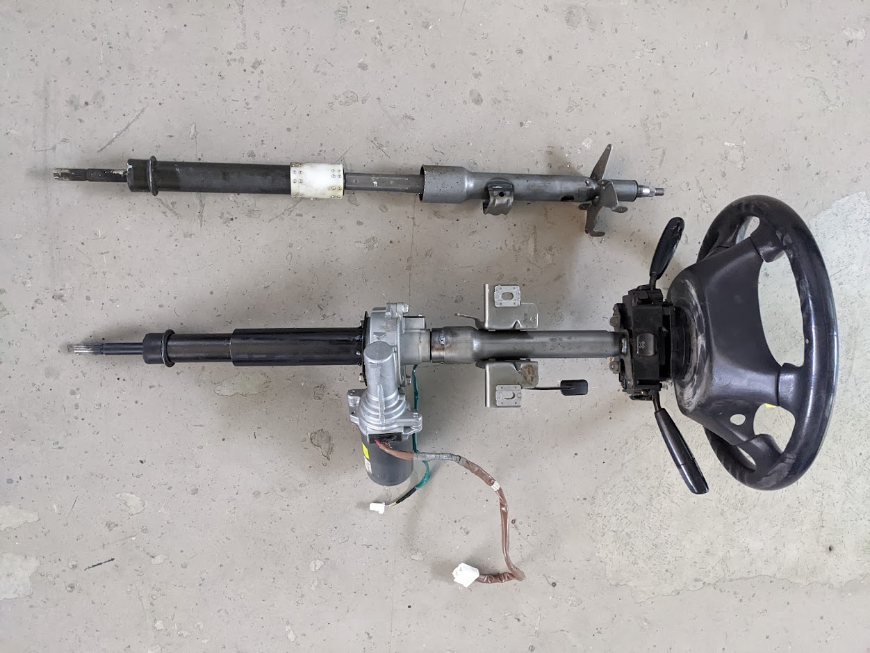

Before and After, allthough i already took the original column apart.
It's in the car, but there's still a lot of work to do:
The Impreza is getting closer to be back on it's wheels:

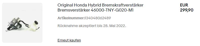

Brakeing is done with a servo, electric motor, assisted master cylinder. So your ABS can stay. It's the vacuum servo etc. what can go.
Zapatero
Posts: 445
Location: Germany, Ulm
Has thanked: 25 times
Been thanked: 42 times
Re: Subaru Impreza 96 - AWD with 2 Outlander rear motors
Post by Zapatero »
EV_Builder wrote: Wed May 11, 2022 5:43 pm Brakeing is done with a servo, electric motor, assisted master cylinder. So your ABS can stay. It's the vacuum servo etc. what can go.
do you have a link (Ebay, Google)?
Thanks!!!
EV_Builder
Posts: 1205
Location: The Netherlands
Has thanked: 18 times
Been thanked: 37 times
Post by EV_Builder »
Google : Bosch ibooster
Zapatero
Posts: 445
Post by Zapatero »
Brake Booster: Check!

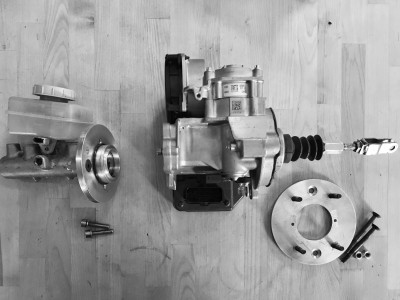

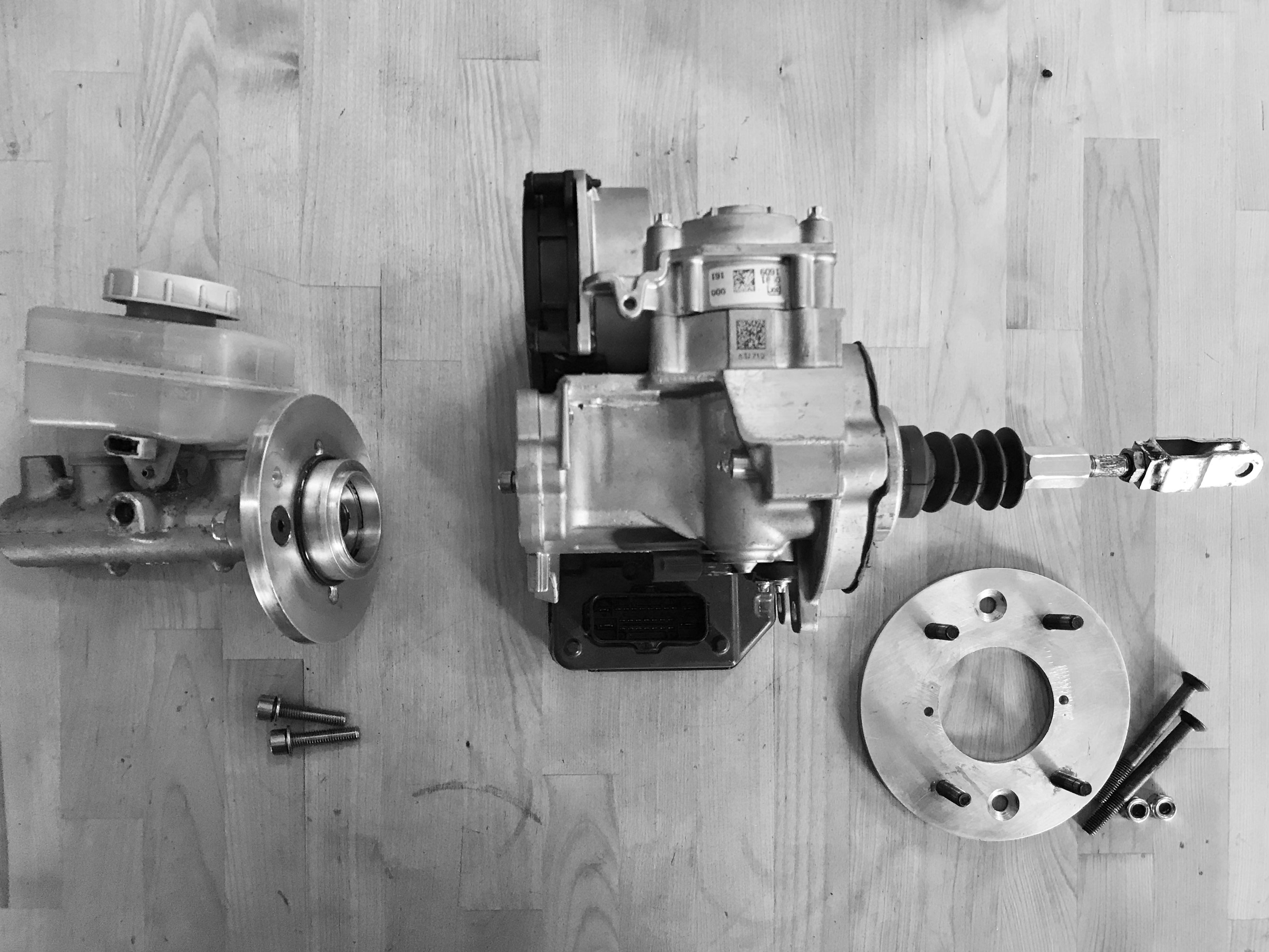

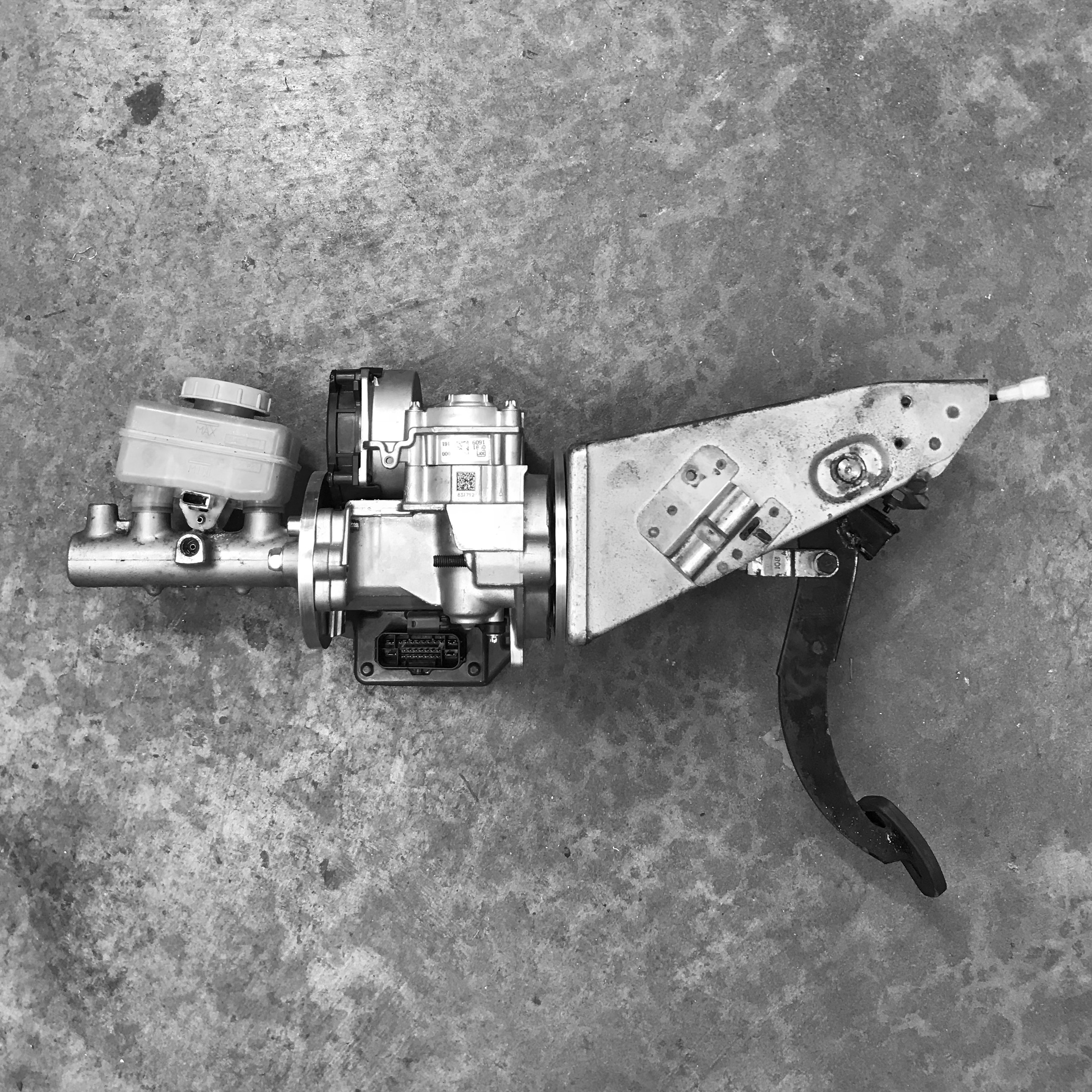

I made some adapters for my Ibooster to fit a Subaru master cylinder, and to bolt up to my pedal box
Zapatero
Posts: 445
Post by Zapatero »
Bratitude wrote: Wed May 11, 2022 9:52 pm 260C62D2-E05E-4655-939A-D68A1EF10BB7.jpeg98957C7D-C0E9-4993-946B-96C7F29AD665.jpeg701F4853-9440-4BB2-97CA-75E3C59AB921.jpeg
Awesome! I'll see how i can mount the brake booster with as little effort as possible.

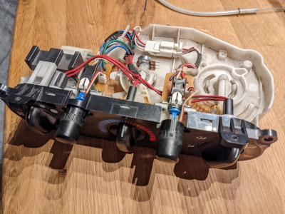

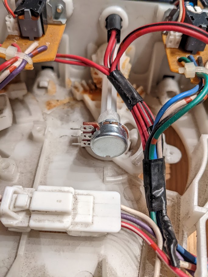

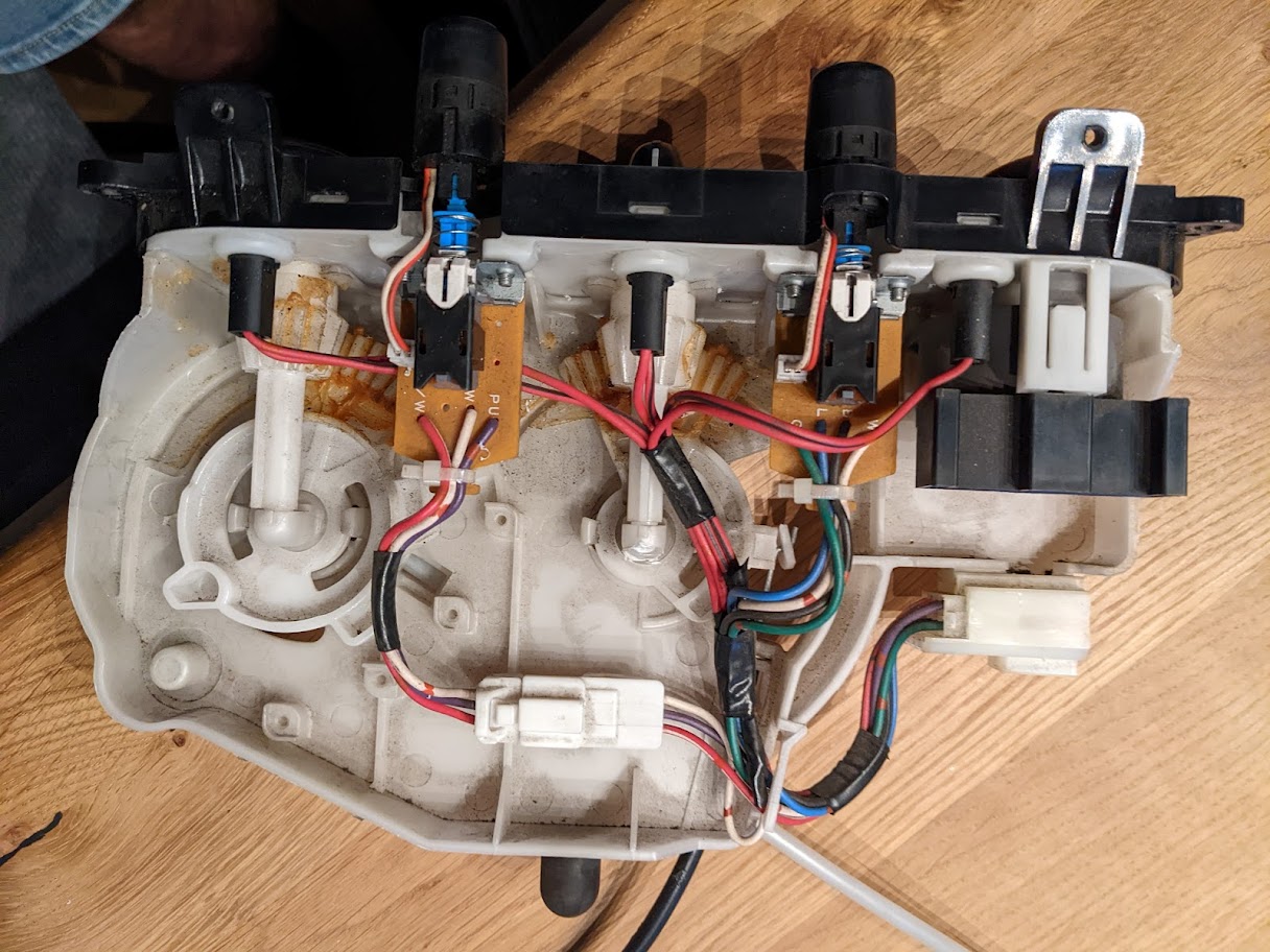

Something else i did was installed a potentiometer to my HVAC unit. Johannes had the idea of using a potentiometer and convert the value to the canbus so the AC or the heater run in variable stages due to the input.
Before
After

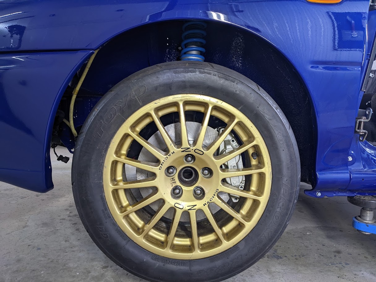

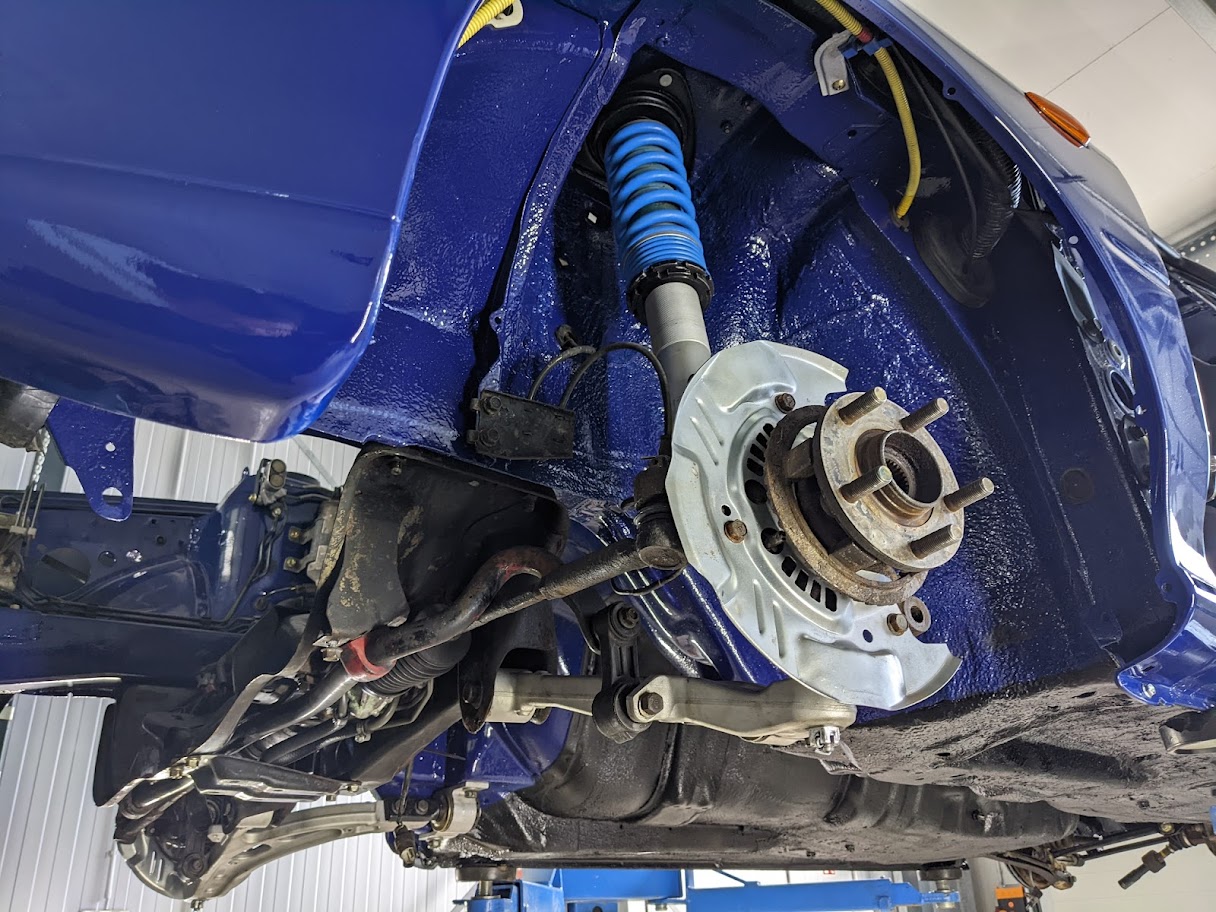

Today i mounted everything on the front axle to get the car back on the wheels as soon as possible:
The front brake calipers and discs are installed and the steering is fully set up:
Getting closer step by step:

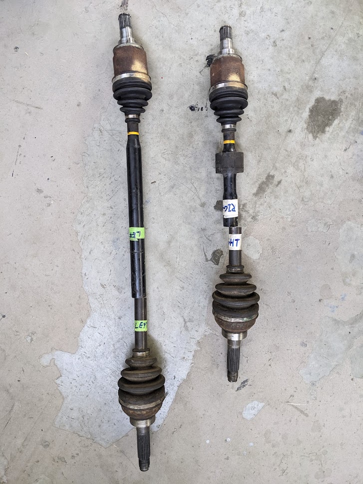

I marked and sent the already cut to the right length driveshafts to motomax.pl to get a set of custom made driveshafts for my build:

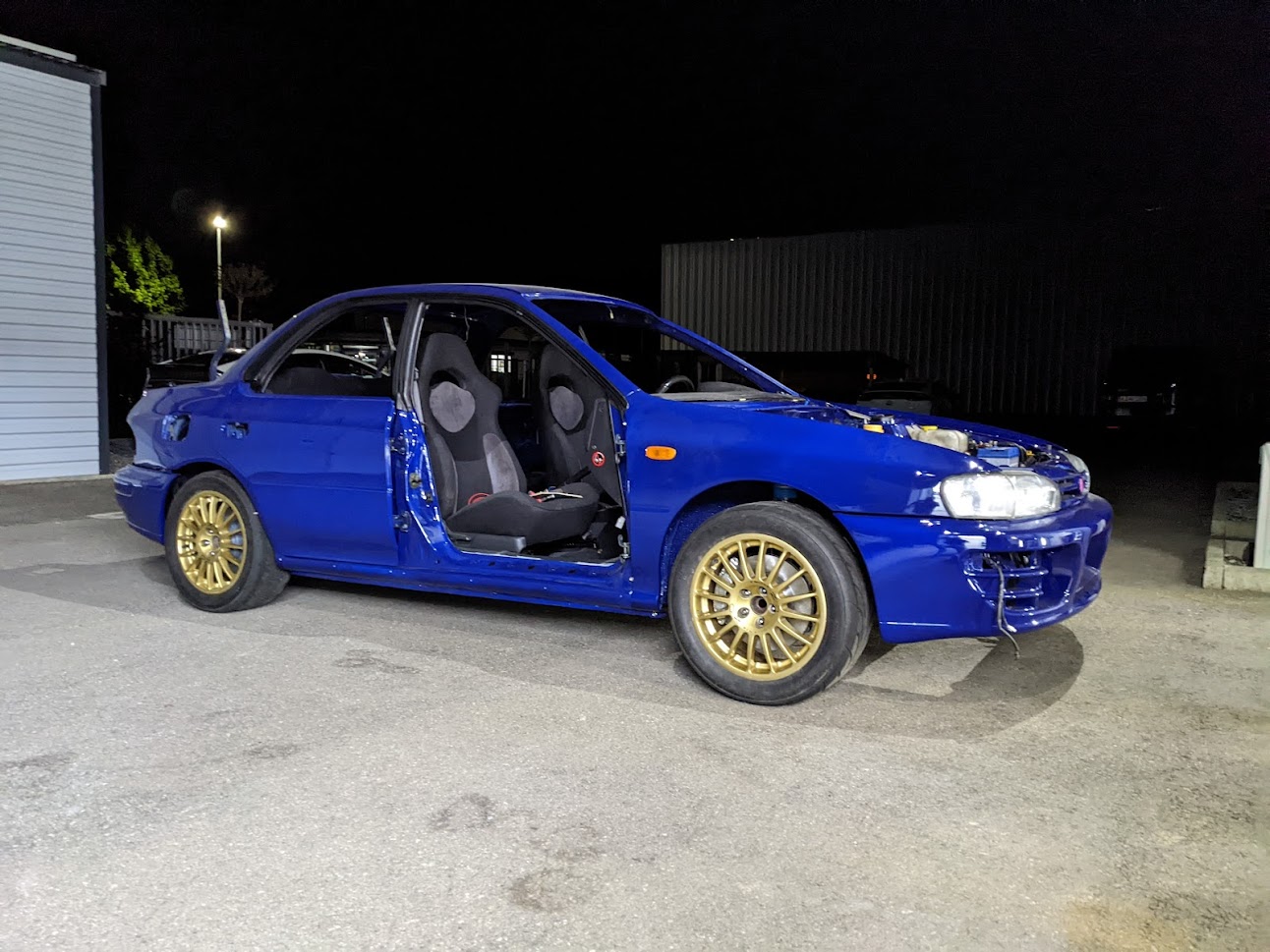

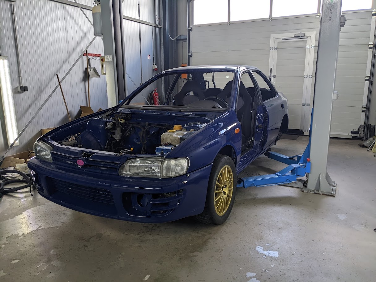

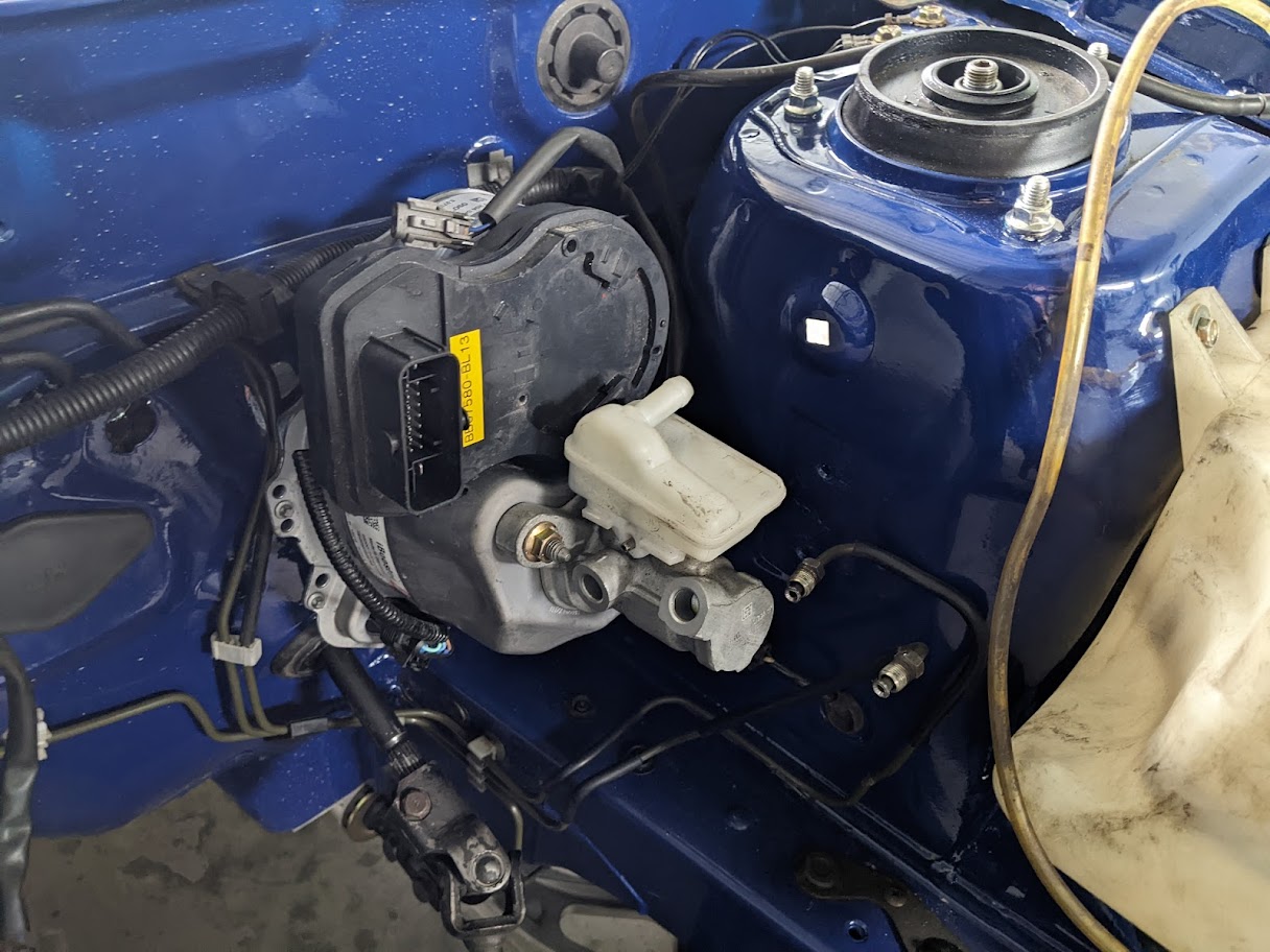

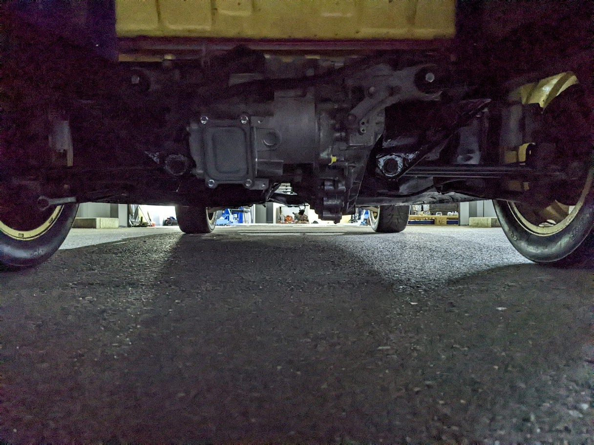

The Subaru is back on it's own wheels:
The iBooster is in the car and fits perfectly well.
Anyone ever controlled the iBooster via CAN-Messages?
Ground Clearance is alright, though i'm going to fabricate a tiny skid plate:

Which booster did you buy? And dit you kept your MC?
Zapatero
Posts: 445
Post by Zapatero »
EV_Builder wrote: Tue May 17, 2022 3:23 am Which booster did you buy? And dit you kept your MC?
I have a honda 2018 iBooster - hopefully the can messages will be the same like with the tesla iBooster.
What is the MC?

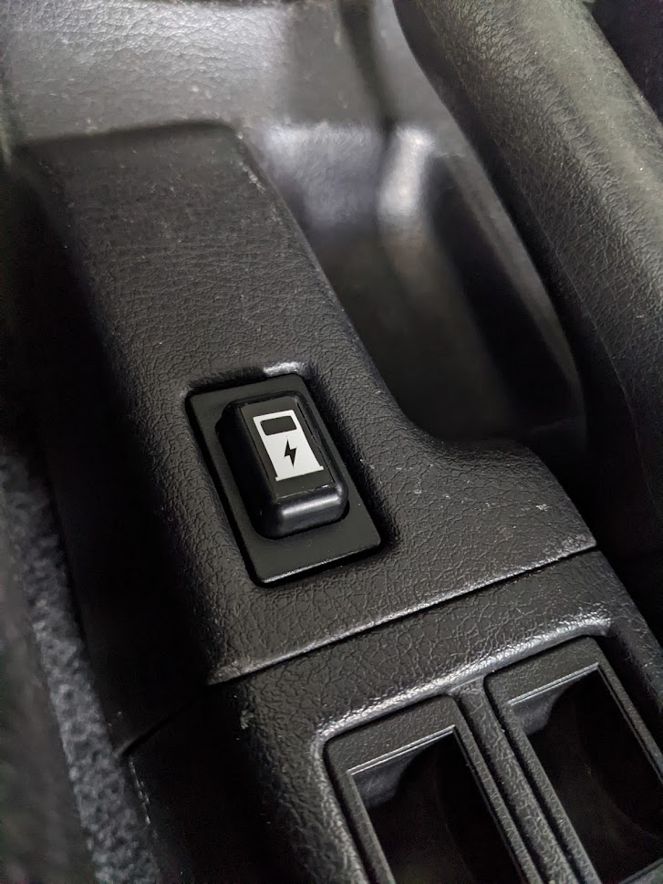

This used to be a button for the front headlight washers. I asked the guys next door (they wrap cars and can make stickers, too) if they can make this button look like a charging door button. I think they did a great job:

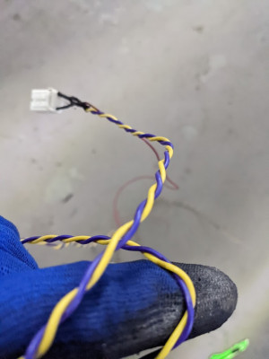

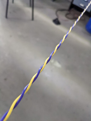

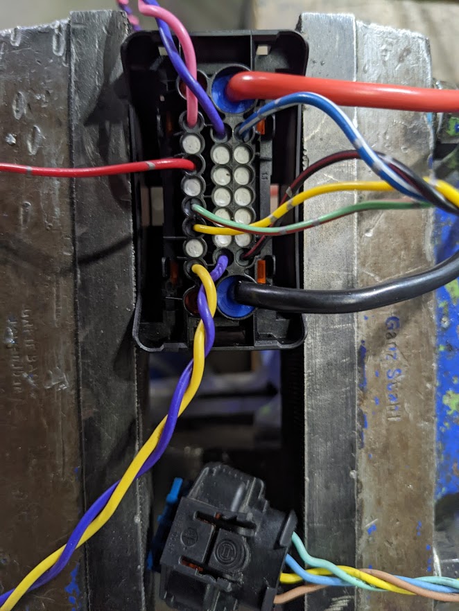

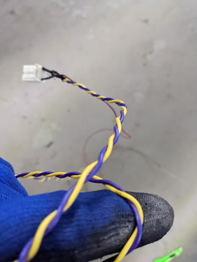

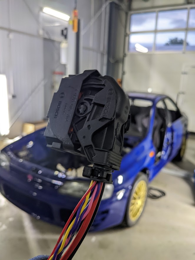

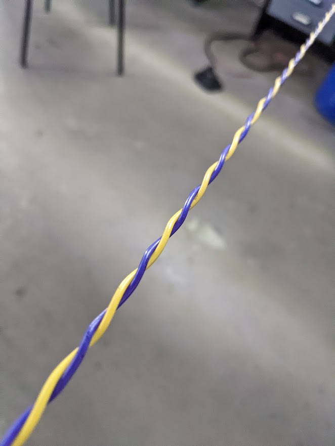

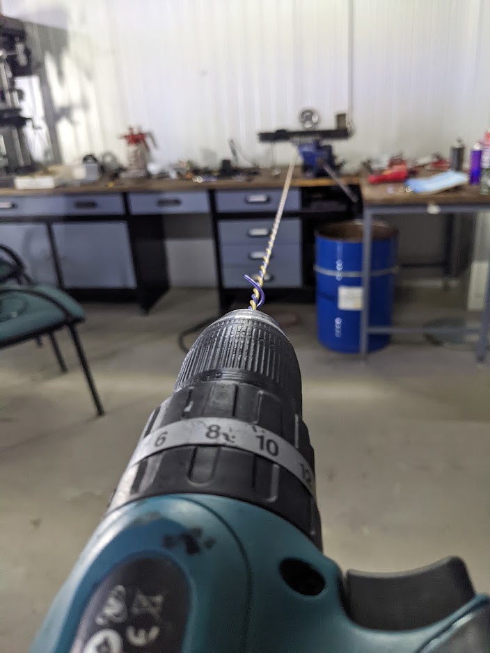

I found out that i can make twisted pair cables easily - did the first one by hand and it took me forever. With the power drill it takes 5 seconds 8-)
Nice, twistet pair can bus cables
On This End there's the plug for the prius power steering
I crimped all the cables for the iBooster plug. I'll connect both can bus systems of the iBooster as i have two can bus systems in my car anyways.
Finished plug
