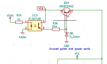

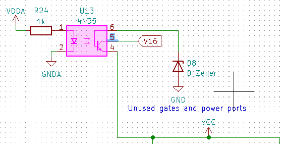

And here's my latest iteration of the mux power supply:
When the ADC power supply turns on it activates the photo coupler which enables the linear regulator. At an assumed 1 mA current draw Q24 needs to dissipate 62 mV when running off 67V (16x4.2)
EDIT: even more tightassed:

I like the last one, very few componentes but don't you need to bias the Zener diode by placing a resistor between V16 and Zener cathode?
Been thanked: 1918 times
Re: Switched ADC BMS
According to the simulation, no. I think the little PV cell inside switches on the transistor which pulls the emitter to V16 and thereby the base to E+0.7V. When base hits 5.6V the Zener starts counteracting the PV cell.
Also biasing the Zener would also bias the opto, turning it always on.
I tested using the opto as voltage regulator and failed. The current generated by the PV cell in the opto is smaller than the Zener leakage current. So will need an external transistor after all.
Also I found there's no need to power the opto coupler from the DC/DC auf the ADC. It can just be turned on by the LV side, maybe even with a pin from the uC. This also puts it in a more convenient location on the PCB.
EDIT: also got to measure the mux power consumption. It draws 900uA at any voltage from 3-5V and the current does not rise when the mux is switching.

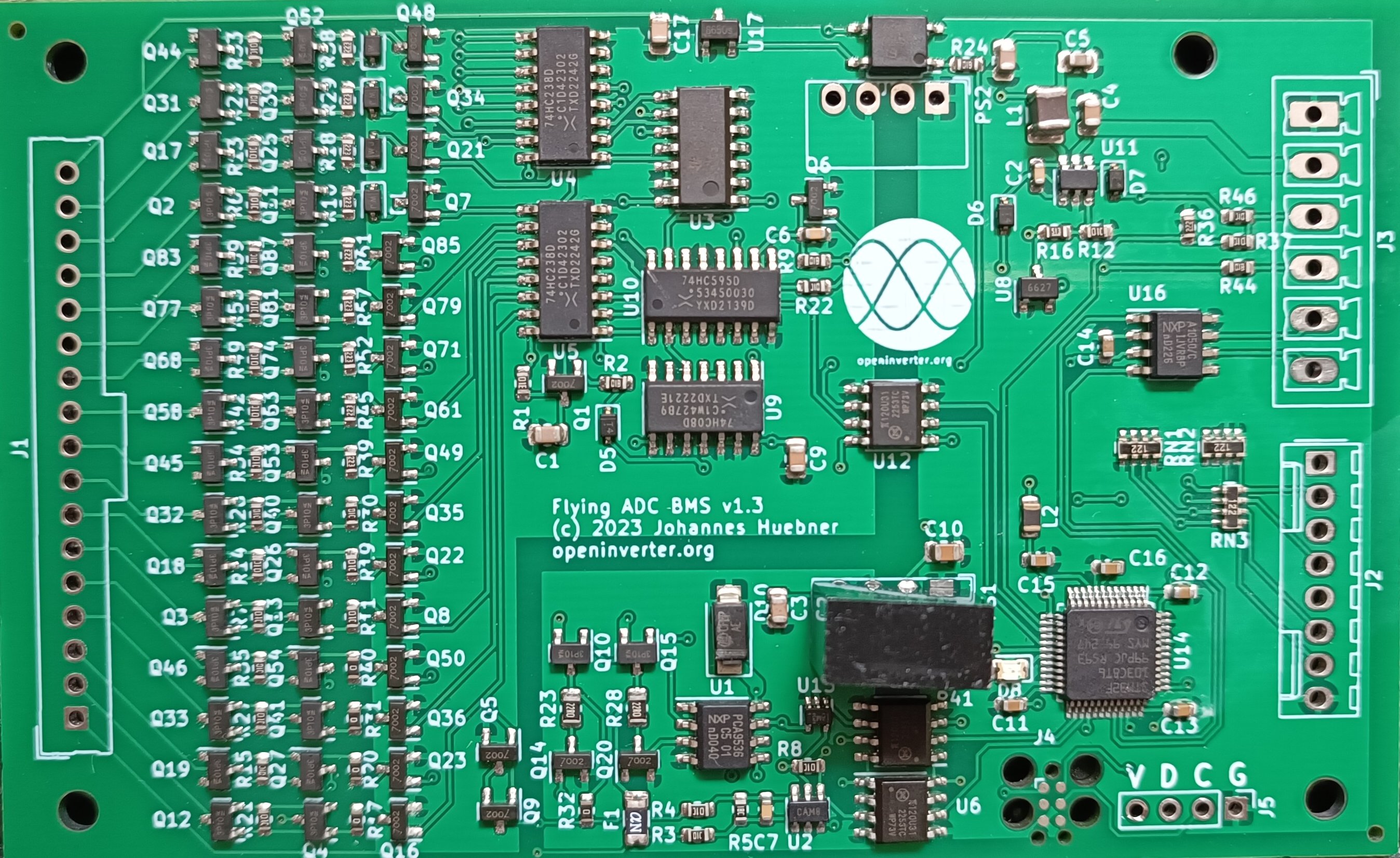

New BMS boards arrived :)
Worked almost out of the box, just needed to stick a 1uF cap across the output of the new LDO. It doesn't like the cap being behind the opto coupler.
These boards will get a proper shakedown in the clipper taxi.
Other changes:
- ADC input/balancer now protected by TVS (maybe too high rating, saw voltage climb above 6V) and fuse
- Enable input doubles as 12V sense input. This also makes it easier to determine whether we're the first module in the row or subsequent one
- LED now connected to processor to give as the usual alive blink
- And again: mux now supplied by battery voltage instead of DC/DC converter
Mux supply draws 4 uA when dormant (quiescent current of LDO) and 1.4 mA when running.

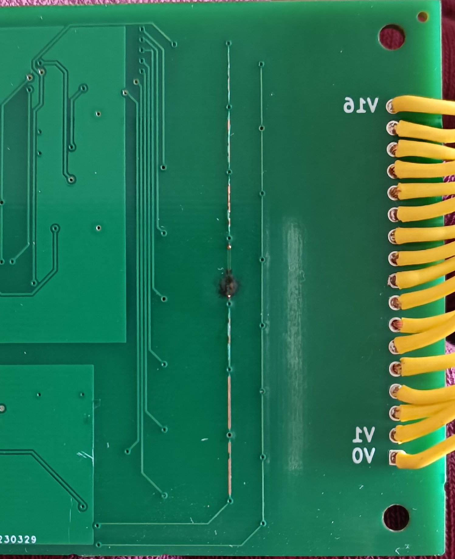

I found it's always the OUTN trace that burns, never UOUTP. Will add a picture later.

UPDATE: picture
It's always that trace that burns plus the low side mosfets are often killed but never the trace to them (the horizontal part of the burned track). Could either point to something meaningful or just means the weaker 2N7002 burn before the trace does.

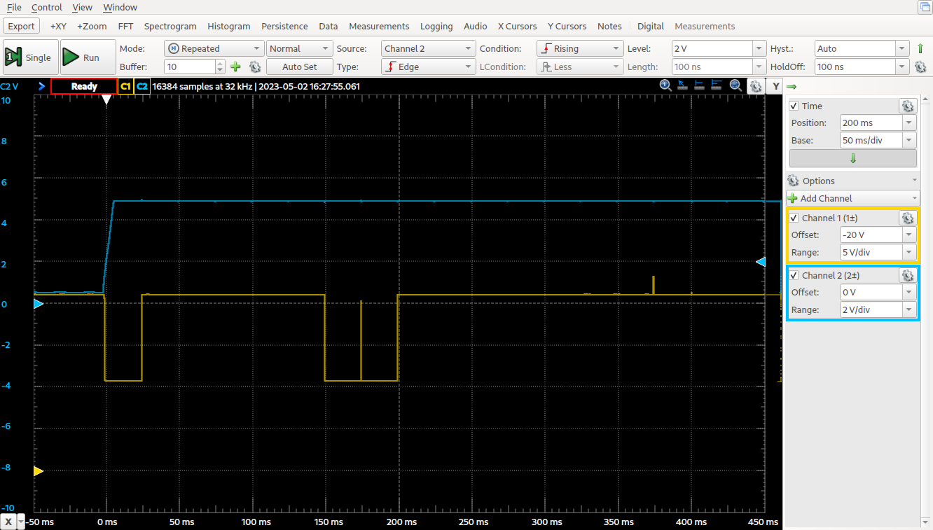

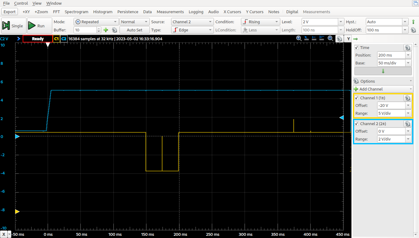

Alright, some new findings

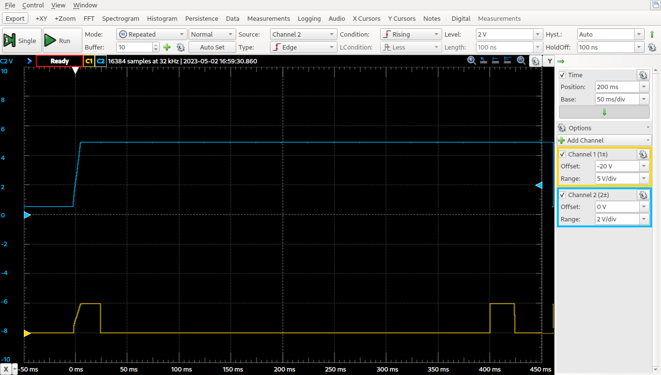

I have scoped the mux 5V supply (blue) which is switched on by the processor about 1s after power up. The other trace is the gate of Q18/Q26 (channel 6). We'd expect first the power-up and 150ms later turn on of channel 7, like so:
After doing many power cycles I got a picture like this:
I repeated it on channel 8 and found the same glitch at the same time.
I don't see the other channels but somehow I suspect they glitch as well.
And likewise on channel 0
I suspect they all glitch at the same time or at least there is a possibility they will. In any case the early turn-on is not supposed to happen. Will keep digging.

Strange. So it means, that the 1-out-of-8 decoder randomly has (hopefully only) one output active after startup. This looks ugly, but still is no reason to burn anything, because it is just ONE, no current flow possible in the OUTN rail itself. I did not analyze the complete logic part, maybe the idea of "self-secure" is not fully realized, an a certain, random init pattern leads to activation of two pathes on OUTN.

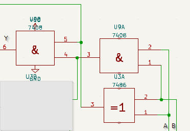

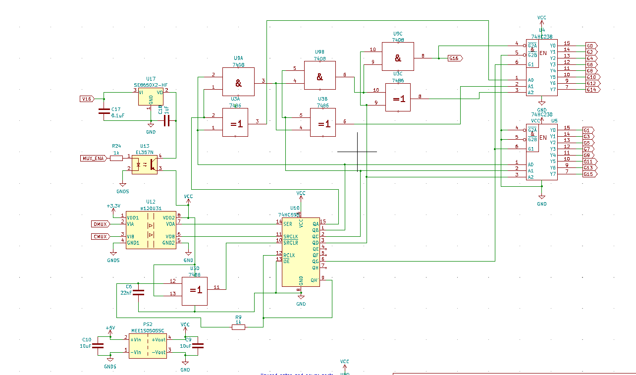

Another thing: As I understand the logic, the Y is always false, because it would be only true if (A XOR B) AND (A AND B), but either they are different to fulfill the XOR or they are both true, to fulfill the AND. Maybe I missed something or use an outdated version (it is from the beginning of the thread).

Sorry, here is a more recent version (PS2 is not populated in case you wonder)
Meanwhile I found random output bits of the HC595 start out as one. Unfortunately there is no reset signal for them, only for the internal shift register. Like you say, that in itself doesn't present a problem, as the first control word that is sent after power-up disables all channels.
EDIT: G16 is a special case where the "even" decoder is disabled and the fet is switched by the AND gate instead

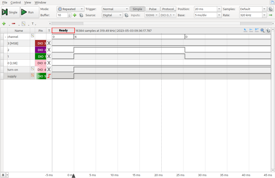

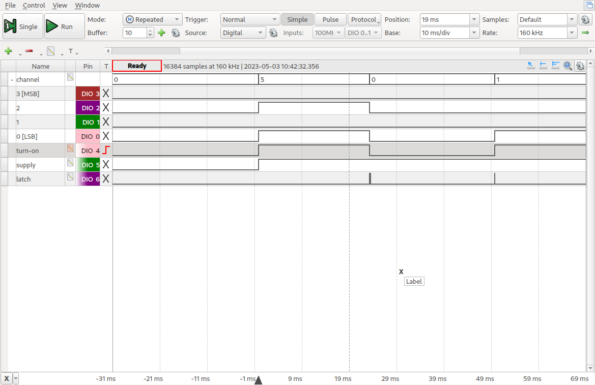

Attached the logic analyzer, here's the issue:
Switching from channel 6 (that happens to be in there) straight to channel 0 without blanking time.
UPDATE:
It seems indeed to be a function of the cycling time. So if you power down and 2s later power up again it seems the output latches of the SR are still in the state where they were turned off. If you wait like 10s the start up is normal. One solution would be to delay mux power-up by 10s in software. Bit of a workaround, a hardware delay might be nicer
Alright, this might fix it:
