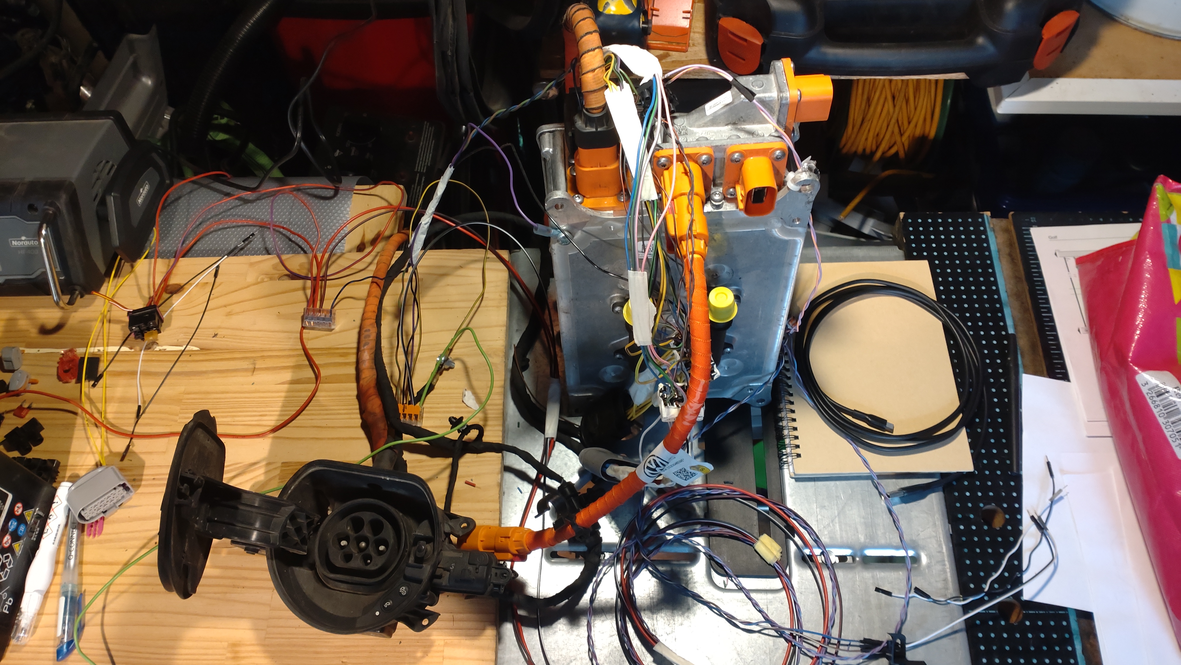

I have a Cayenne two phase 7.2kW charger. Part number 5QE 915 681 BQ.
Got it responding to 0x570 DLC8 0xFF 0x00 0x00 0x00 0x00 0x00 0x00 on PT CAN at 1 sec intervals. Same as the Seat Mii Damien has, which is probably unsurprising given the part numbers are very similar. I also then get some can data on the PT canbus, log attached. Although I get nothing on my Hybrid can.

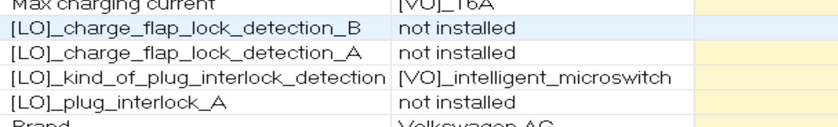

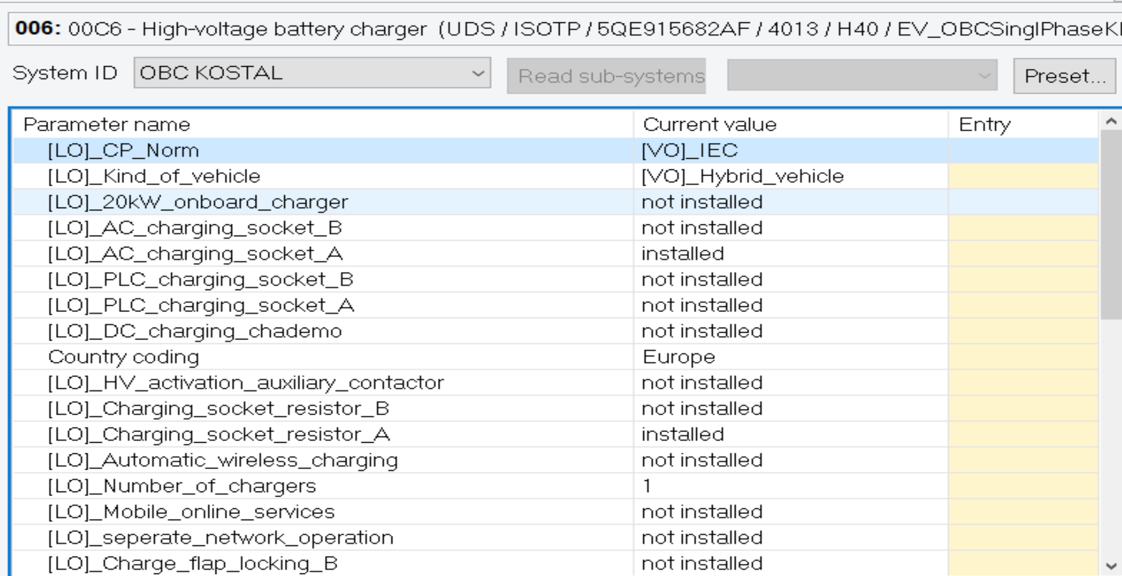

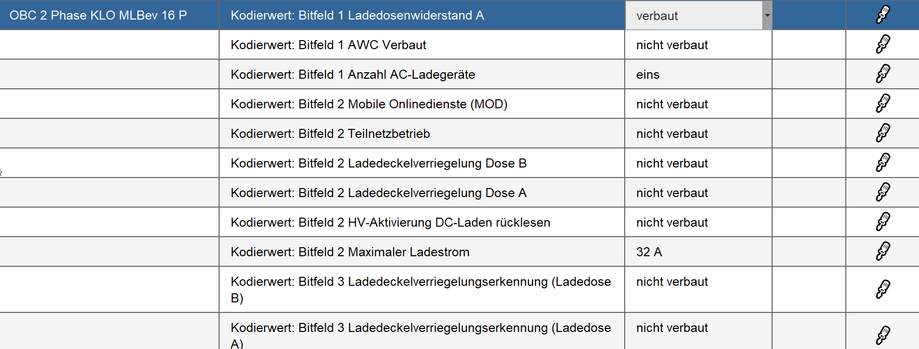

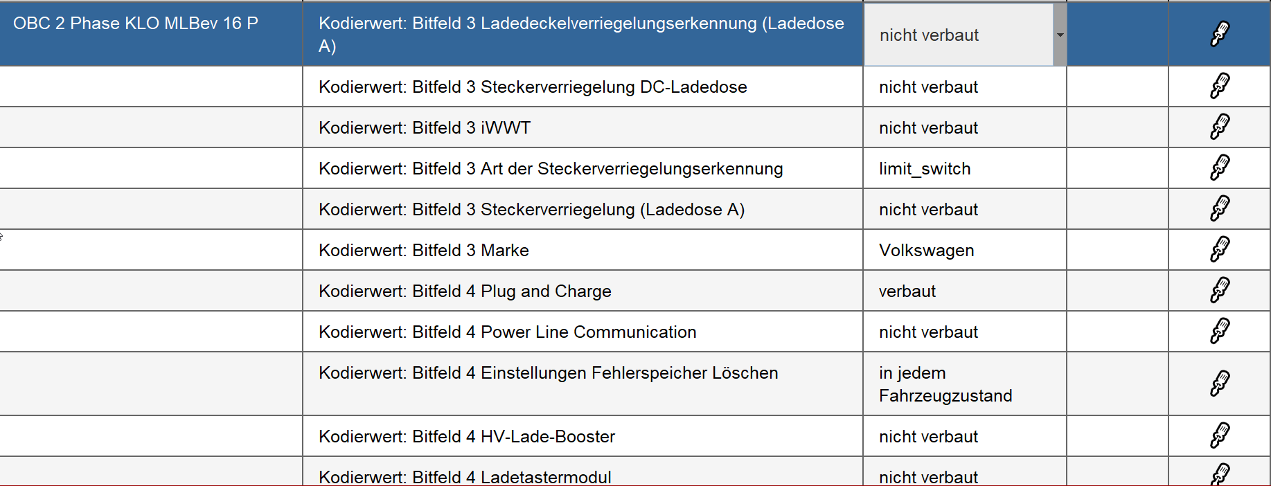

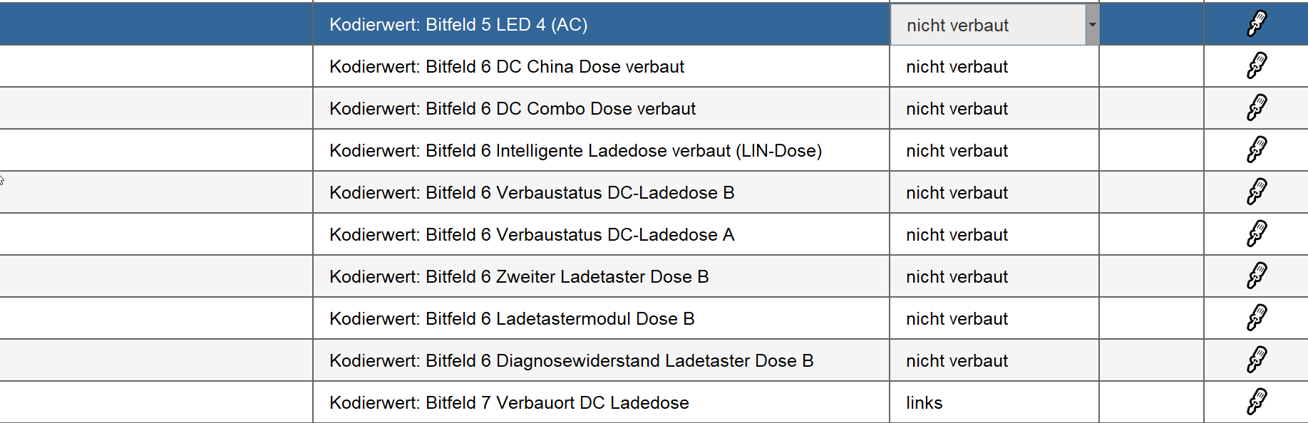

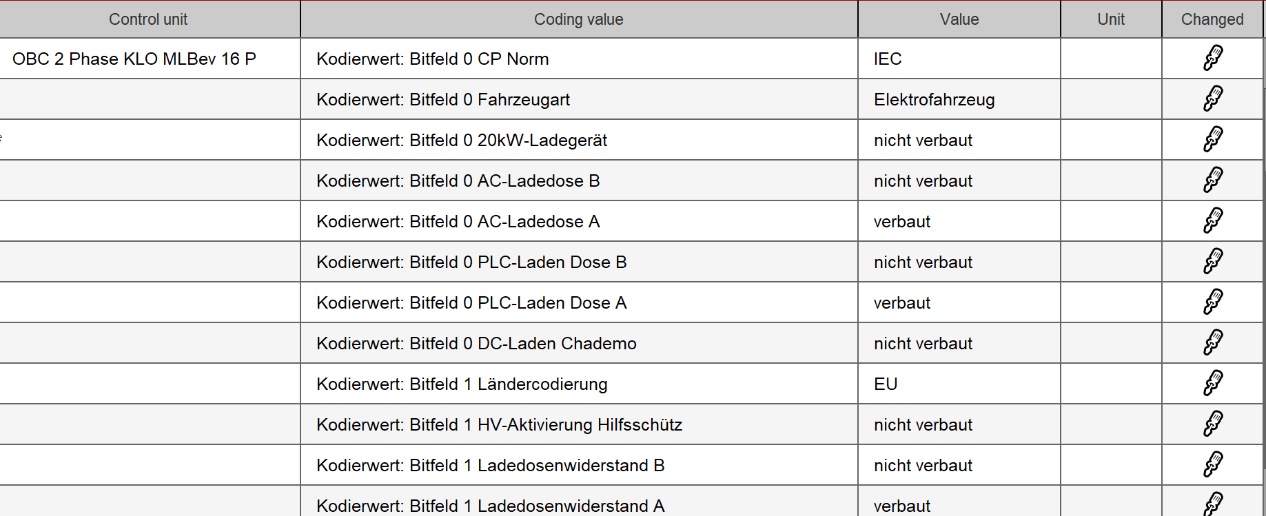

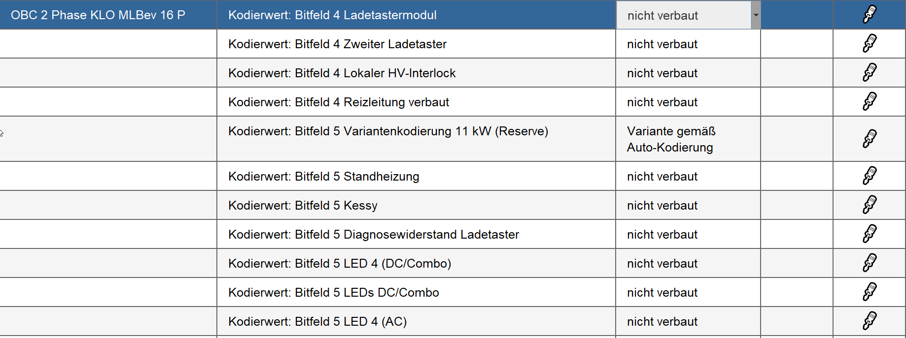

Re: MEB Chargers
I'm just guessing, but I think it is because those chargers are build to provide also markets with a single phase 32A infrastructure.
You can recode the charger to use one phase with 32A or back to two phases with 16A.

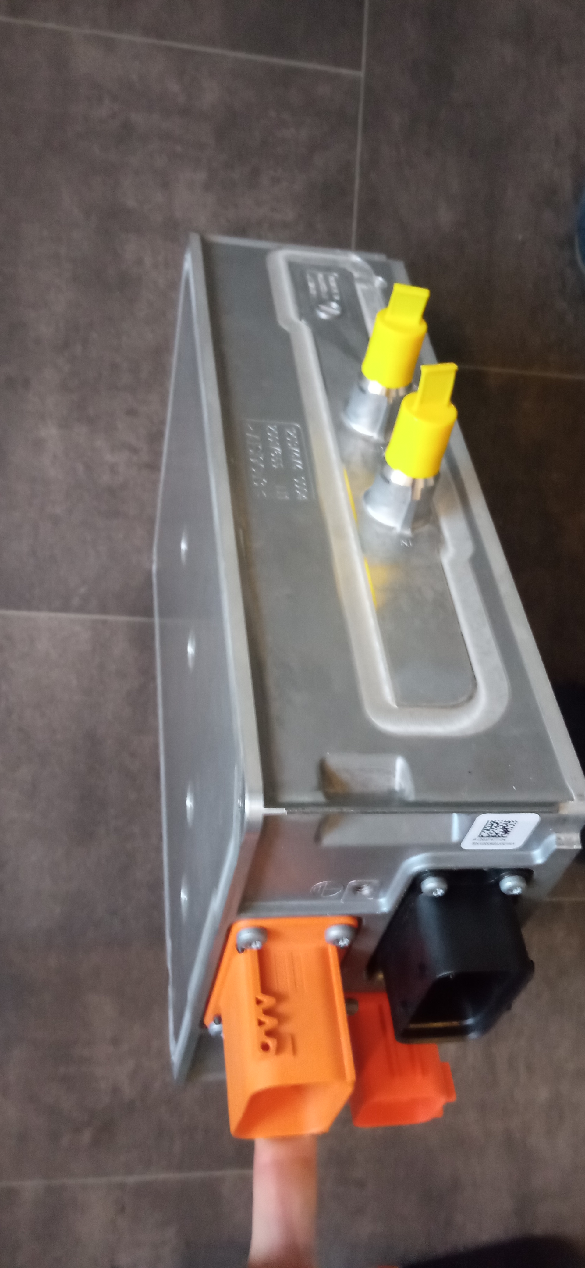

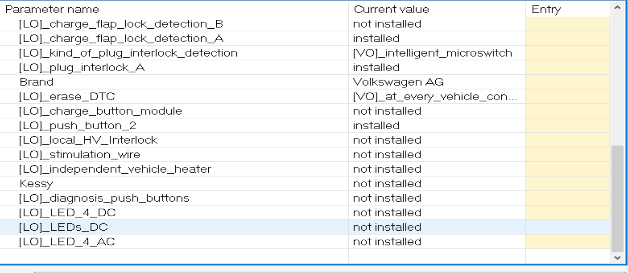

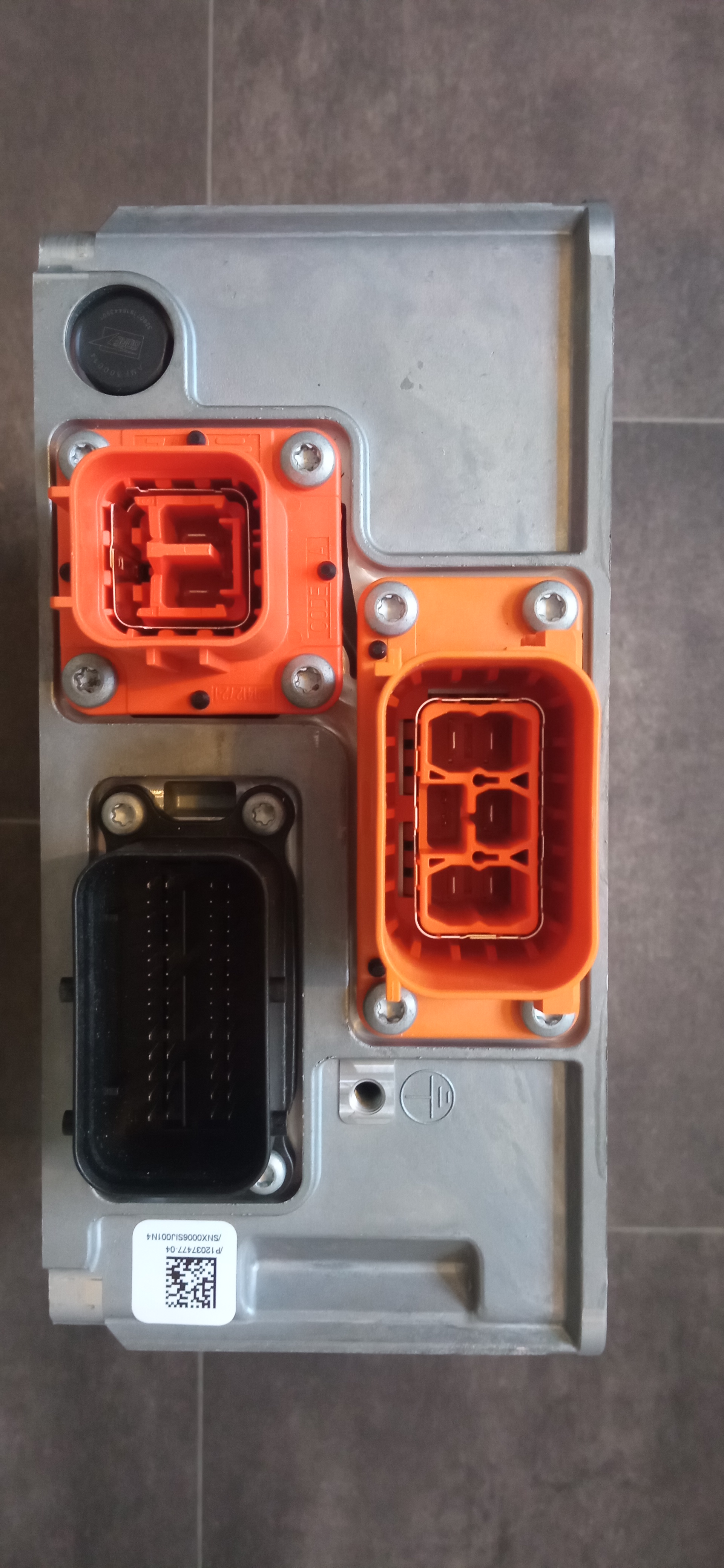

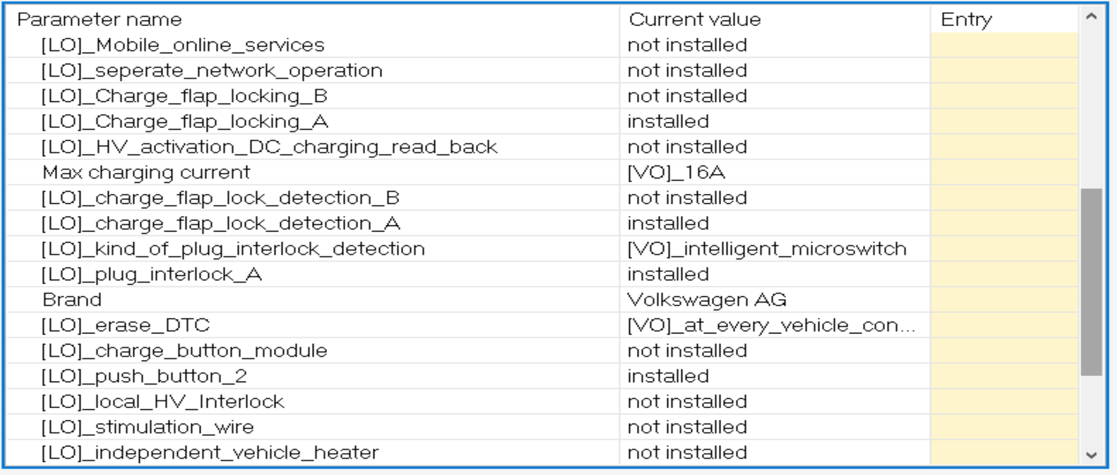

Re: MEB Chargers

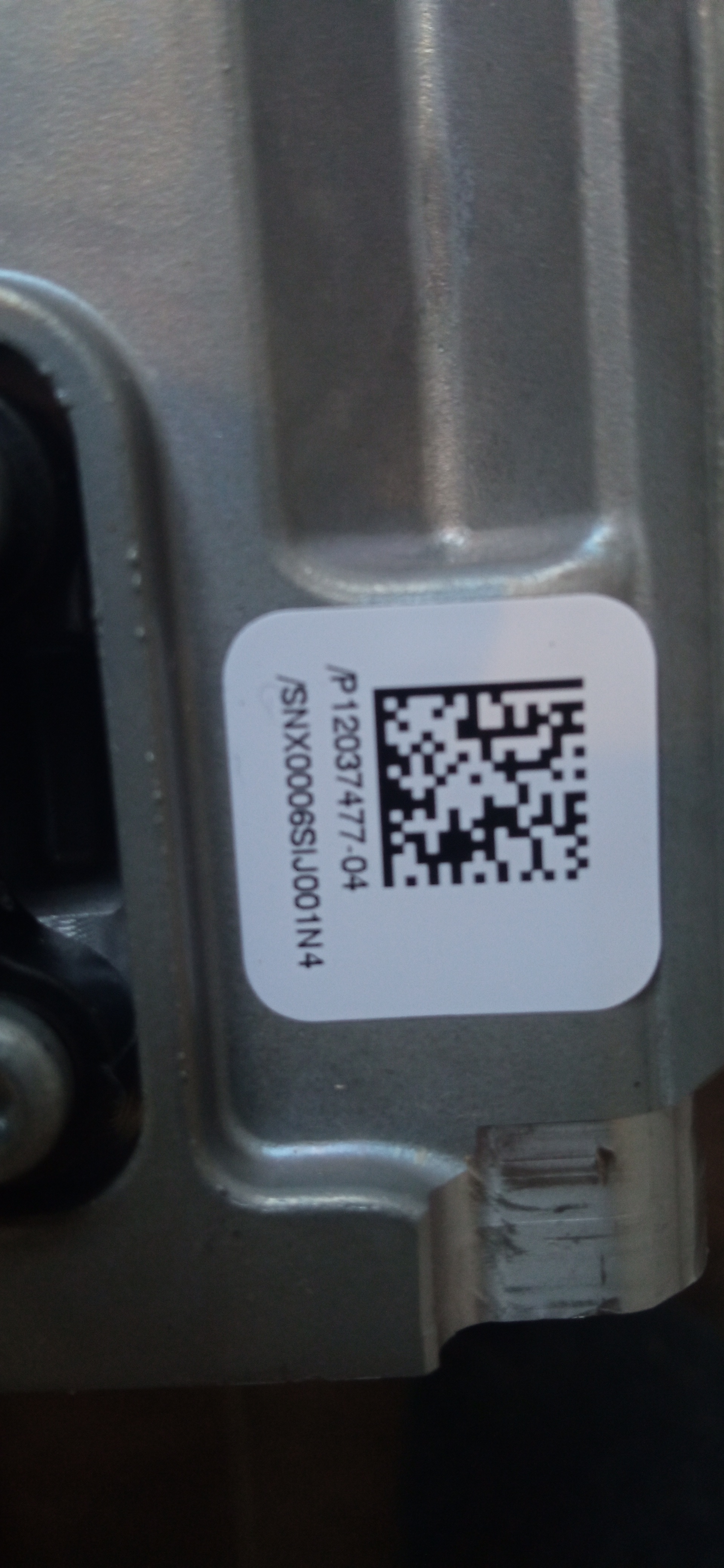

Just picked up a 5QE.915.684.AD charger from a 2021 Audi E-Tron Canadian Model.
Hoping to help out with the Reverse Engineering efforts, or at least prove them on North American variants.
Likely best to document everything here, but I think this thread will fragment into the few various different models, even if they're all 'MEB' type, the implementation seems to differ quite a bit between the MQB and MLBevo models.
The E-Tron chargers have several things which make them a bit different, one major being the LIN LED module and Door actuator, as well as only having a Hybrid CAN connection (No Drive CAN)
The CAN signals appear to be totally different than those for the rest of the charger line.
As per the DBC file I posted, The charger is pretty integrated into the other bus messages, but the messages seem totally different than those found by Damien
**See Next Post for CAN Signal List**

Address C6: Batt. Chrg. (J1050) Labels:* None
Part No SW: 5QE 915 684 AD HW: 5QE 915 684 AD
Component: OBC KOSTAL H34 0070
Serial number: EEEEEEEEEEEEEEE
Coding: 7A59AC6742080E000000
Shop #: WSC 00000 000 00000
ASAM Dataset: EV_OBC3Phase1KLOMLBev16B 004001
ROD: EV_OBC3Phase1KLOMLBev16B.rod
VCID: 116AB0B8C07266035C-8044
Flap 1 for charging socket:
Subsystem 1 - Part No SW: 4KE 862 277 A HW: 4KE 862 277 A
Component: F496LKL1 004 0004
Serial number: 20200704030206080495
Flap 2 for charging socket:
Subsystem 2 - Part No SW: 4KE 862 277 A HW: 4KE 862 277 A
Component: F497LKL2 004 0004
Serial number: 20200527030206080290

IDE00058-MAS12436,History data 3-Range 8,0,
IDE00058-MAS12437,History data 3-Range 9,0,
IDE00059-MAS12429,History data 4-Range 1,0,
IDE00059-MAS12430,History data 4-Range 2,0,
IDE00059-MAS12431,History data 4-Range 3,0,
IDE00059-MAS12432,History data 4-Range 4,0,
IDE00059-MAS12433,History data 4-Range 5,0,
IDE00059-MAS12434,History data 4-Range 6,0,
IDE00059-MAS12435,History data 4-Range 7,0,
IDE00059-MAS12436,History data 4-Range 8,0,
IDE00059-MAS12437,History data 4-Range 9,0,
IDE00060-MAS12429,History data 5-Range 1,0,
IDE00060-MAS12430,History data 5-Range 2,0,
IDE00060-MAS12431,History data 5-Range 3,17,
IDE00060-MAS12432,History data 5-Range 4,93,
IDE00060-MAS12433,History data 5-Range 5,52,
IDE00060-MAS12434,History data 5-Range 6,4,
IDE00060-MAS12435,History data 5-Range 7,0,
IDE00060-MAS12436,History data 5-Range 8,0,
IDE00060-MAS12437,History data 5-Range 9,0,
IDE00061-MAS12429,History data 6-Range 1,0,
IDE00061-MAS12430,History data 6-Range 2,0,
IDE00061-MAS12431,History data 6-Range 3,10,
IDE00061-MAS12432,History data 6-Range 4,96,
IDE00061-MAS12433,History data 6-Range 5,54,
IDE00061-MAS12434,History data 6-Range 6,6,
IDE00061-MAS12435,History data 6-Range 7,0,
IDE00061-MAS12436,History data 6-Range 8,0,
IDE00061-MAS12437,History data 6-Range 9,0,
IDE00322,Status of basic setting,was not yet started,
IDE00323,Security Access: Number of invalid keys,0,
IDE00637,DC link voltage,0.9, A
IDE00637,DC link voltage,0.7, A
IDE00767,No. of unscheduled ECU resets,00,
IDE01985-MAS01159,FAZIT identification test sum-Version number,81,
IDE01985-MAS06879,FAZIT identification test sum-Checksum,CB 08 20 A6,
IDE02486,Data logger triggering,not initialized,
IDE06805,Status of voltage freedom,High voltage power off not recognized,
IDE06954,Actual HV charge current,80 00,
IDE06955-ENG114223,Target HV charge current-Charger_HV_current_commanded_value,-102.0, A
IDE07145-ENG119926,Component protection properties-KS_Data_Generation,2,
IDE07145-ENG119382,Component protection properties-KS_data_version,0,
IDE07145-ENG119680,Component protection properties-KS_Standard_Software_Major_Version,1,
IDE07145-ENG119410,Component protection properties-KS_Standard_Software_Minor_Version,3,
IDE07145-ENG119983,Component protection properties-KS_Standard_Software_Patch_Version,5,
IDE07145-ENG119813,Component protection properties-KSB_Configuration_Status_1,01,
IDE07145-ENG119724,Component protection properties-KSB_Configuration_Status_2,5E,
IDE07159-ENG30068,Control module switch-off: counter-raw_value_in_develop_by_ODXauthor,00 00,
IDE07160-ENG119373,Control module switch-off: switch-off time-Control module,15, min
IDE07160-ENG119372,Control module switch-off: switch-off time-Data bus,15, min
IDE08097-MAS12429,serv.life charge current-Range 1,6297,
IDE08097-MAS12430,serv.life charge current-Range 2,0,
IDE08097-MAS12431,serv.life charge current-Range 3,3727,
IDE08097-MAS12432,serv.life charge current-Range 4,12,
IDE08097-MAS12433,serv.life charge current-Range 5,4,
IDE08097-MAS12434,serv.life charge current-Range 6,0,
IDE08097-MAS12435,serv.life charge current-Range 7,0,
IDE08097-MAS12436,serv.life charge current-Range 8,0,
IDE08421-IDE05431,Power outlet A for battery charging-Lock for high-voltage charging connector,not locked,
IDE08421-MAS07220,Power outlet A for battery charging-Status connect. recognition,not installed,
IDE08421-MAS07221,Power outlet A for battery charging-Connector locking requirement,00000000 ,
IDE08421-MAS07222,Power outlet A for battery charging-Connector unlocking requirement,00000000 ,
IDE08421-MAS07223,Power outlet A for battery charging-Max. current of charge connector,0, A
IDE08421-MAS07565,Power outlet A for battery charging-Activation charge cover lock charge socket A,not requested,
IDE08421-MAS07567,Power outlet A for battery charging-Status charge cover lock charge socket A,not locked,
IDE08421-MAS10983,Power outlet A for battery charging-Activation charge cover unlock charge socket A,unlock,
IDE08421-MAS12565,Power outlet A for battery charging-Charge socket temperature sensor AC,-54.8, °C
IDE08421-MAS12566,Power outlet A for battery charging-Charge sensor temperature sensor DC,6037.8, °C
IDE08422-IDE05431,Power outlet B for battery charging-Lock for high-voltage charging connector,not locked,
IDE08422-MAS07220,Power outlet B for battery charging-Status connect. recognition,not installed,
IDE08422-MAS07221,Power outlet B for battery charging-Connector locking requirement,00000000 ,
IDE08422-MAS07222,Power outlet B for battery charging-Connector unlocking requirement,00000000 ,
IDE08422-MAS07223,Power outlet B for battery charging-Max. current of charge connector,0, A
IDE08422-MAS07224,Power outlet B for battery charging-Temp. of charge socket,-54.8, °C
IDE08422-MAS07566,Power outlet B for battery charging-Activation charge cover lock charge socket B,not requested,
IDE08422-MAS07568,Power outlet B for battery charging-Status: chg. cover lock. device: chg. socket B,not locked,
IDE08423-MAS02949,Control signal for power outlet A for battery charging-Frequency,0, Hz
IDE08423-MAS02952,Control signal for power outlet A for battery charging-Control voltage,0, mV
IDE08423-MAS03873,Control signal for power outlet A for battery charging-Duty cycle,0.0, %
IDE08423-MAS04136,Control signal for power outlet A for battery charging-Current,0.0, A
IDE08423-MAS07262,Control signal for power outlet A for battery charging-Signal recognized,00000000 ,
IDE08424-MAS02949,Control signal for power outlet B for battery charging-Frequency,0, Hz
IDE08424-MAS02952,Control signal for power outlet B for battery charging-Control voltage,0, mV
IDE08424-MAS03873,Control signal for power outlet B for battery charging-Duty cycle,0.0, %
IDE08424-MAS04136,Control signal for power outlet B for battery charging-Current,0.0, A
IDE08424-MAS07262,Control signal for power outlet B for battery charging-Signal recognized,00000000 ,
IDE08425-MAS07225,Indicator lamps for socket A for battery charging-Status: indicator lamp 1,OFF,
IDE08425-MAS07226,Indicator lamps for socket A for battery charging-Status: indicator lamp 2,OFF,
IDE08425-MAS07227,Indicator lamps for socket A for battery charging-Status: indicator lamp 3,OFF,
IDE08425-MAS07228,Indicator lamps for socket A for battery charging-Intensity: indicator light 1,0, %
IDE08425-MAS07229,Indicator lamps for socket A for battery charging-Intensity: indicator light 2,0, %
IDE08425-MAS07230,Indicator lamps for socket A for battery charging-Intensity: indicator light 3,0, %
IDE08425-MAS07231,Indicator lamps for socket A for battery charging-Period duration: indicator light 1,0, ms
IDE08425-MAS07232,Indicator lamps for socket A for battery charging-Period duration: indicator light 2,0, ms
IDE08425-MAS07233,Indicator lamps for socket A for battery charging-Period duration: indicator light 3,0, ms
IDE08425-MAS07582,Indicator lamps for socket A for battery charging-Intensity: activation 4,0, %
IDE08425-MAS07590,Indicator lamps for socket A for battery charging-Period duration: activation 4,0, ms
IDE08425-MAS13012,Indicator lamps for socket A for battery charging-Status: indicator lamp 4,OFF,
IDE08426-MAS07225,Indicator lamps for power outlet B for battery charging-Status: indicator lamp 1,OFF,
IDE08426-MAS07226,Indicator lamps for power outlet B for battery charging-Status: indicator lamp 2,OFF,
IDE08426-MAS07227,Indicator lamps for power outlet B for battery charging-Status: indicator lamp 3,OFF,
IDE08426-MAS07228,Indicator lamps for power outlet B for battery charging-Intensity: indicator light 1,0, %
IDE08426-MAS07229,Indicator lamps for power outlet B for battery charging-Intensity: indicator light 2,0, %
IDE08426-MAS07230,Indicator lamps for power outlet B for battery charging-Intensity: indicator light 3,0, %
IDE08426-MAS07231,Indicator lamps for power outlet B for battery charging-Period duration: indicator light 1,0, ms
IDE08426-MAS07232,Indicator lamps for power outlet B for battery charging-Period duration: indicator light 2,0, ms
IDE08426-MAS07233,Indicator lamps for power outlet B for battery charging-Period duration: indicator light 3,0, ms
IDE08426-MAS07582,Indicator lamps for power outlet B for battery charging-Intensity: activation 4,0, %
IDE08426-MAS07590,Indicator lamps for power outlet B for battery charging-Period duration: activation 4,0, ms
IDE08426-MAS13012,Indicator lamps for power outlet B for battery charging-Status: indicator lamp 4,OFF,
IDE08427-MAS07237,Statistics of power outlet A for battery charging-No. of connections,0,
IDE08427-MAS07238,Statistics of power outlet A for battery charging-No. of lockings,0,
IDE08428-MAS07237,Statistics of power outlet B for battery charging-No. of connections,0,
IDE08428-MAS07238,Statistics of power outlet B for battery charging-No. of lockings,0,
IDE08430,Cause of cancellation of charge procedure,not active,
IDE08639,max. loading power,0, W
IDE08640,Spec. mode: load mgmnt.,Standby,
IDE08649-IDE06971,Ready to charge-Operational readiness in H-V system,not active,
IDE08649-MAS07215,Ready to charge-Status charge readiness charge mngmt.,Unknown (0),
IDE08649-MAS15304,Ready to charge-Status drive readiness,not ready to drive,
IDE08677-MAS07258,Load mode-Stat.: charge mode,no request,
IDE08677-MAS07259,Load mode-Chg. type,Imm. charg.,
IDE08717,Status mains voltage,not installed,
IDE08718-MAS06699,Chademo version-Vehicle,2,
IDE08718-MAS07395,Chademo version-Charging Station,0,
IDE08719-IDE08720,Values from battery mgmt system-Current condition of battery mgmt. system,HV mains activ.,
IDE08719-MAS01420,Values from battery mgmt system-Limit for charge current,589.0, A
IDE08719-MAS04059,Values from battery mgmt system-Battery temperature,21.0, °C
IDE08719-MAS07397,Values from battery mgmt system-Act. current HV battery,-0.8, W
IDE08719-ENG119994,Values from battery mgmt system-bms_energy,57750, Wh
IDE08719-ENG119383,Values from battery mgmt system-Highvoltage_battery_state_of_charge,67.85, %
IDE08752,Stop management system,Park function active,
IDE08938,Chrgr cooling reqrmnt,Med. cooling reqmnt.,
IDE09039,HV charger - current output voltage,419, V
IDE09057,HV battery charge state,67.5, %
IDE10187-ENG119392,Supply voltage [V]-3_3V_supply_voltage,3.30, V
IDE11752-IDE09469,IP network: IPv6-addresses-IPv6 address,00 00 00 00 00 00 00 00 00 00 00 00 00 00 00 00,
IDE11753-MAS14855,IP network: IPv6-multicast-addresses-IPv6 Multicast address,00 00 00 00 00 00 00 00 00 00 00 00 00 00 00 00,
IDE11757,IP network: counter messages with inadmissible IPv6-addresses,0,
IDE11761-IDE09467,IP network: MAC addresses-MAC address,F0 7F 0C 0B 3C 04,
IDE12027,Active Security Access procedure,PIN_Minicode,
IDE12238,I network: discarded messages counter,0,
IDE12625,IP network: current link deceleration: branch 1,0, ns
IDE13628-MAS12429,HV charging voltage: current value-Range 1,131, H
IDE13628-MAS12430,HV charging voltage: current value-Range 2,2562, H
IDE13628-MAS12431,HV charging voltage: current value-Range 3,6983, H
IDE13628-MAS12432,HV charging voltage: current value-Range 4,257, H
IDE13628-MAS12433,HV charging voltage: current value-Range 5,0, H
IDE13628-MAS12434,HV charging voltage: current value-Range 6,0, H
IDE13628-MAS12435,HV charging voltage: current value-Range 7,0, H
IDE13628-MAS12436,HV charging voltage: current value-Range 8,0, H
IDE13628-MAS12437,HV charging voltage: current value-Range 9,0, H
IDE13628-MAS12438,HV charging voltage: current value-Range 10,0, H
IDE13628-MAS12439,HV charging voltage: current value-Range 11,0, H
IDE13628-MAS12440,HV charging voltage: current value-Range 12,0, H
IDE13806,Specified mode: contactless charging,not_active,
IDE14287-ENG120029,Connector lock loading hatch 1: voltage values-actual_voltage_plug_interlock_a,2218, mV
IDE14287-ENG119976,Connector lock loading hatch 1: voltage values-Max_limit_voltage_plug_interlock_locked_a,12194, mV
IDE14287-ENG119859,Connector lock loading hatch 1: voltage values-Max_limit_voltage_plug_interlock_not_locked_a,4574, mV
IDE14287-ENG119710,Connector lock loading hatch 1: voltage values-min_limit_voltage_plug_interlock_locked_a,6672, mV
IDE14287-ENG119579,Connector lock loading hatch 1: voltage values-min_limit_voltage_plug_interlock_not_locked_a,1655, mV
IDE14305,Plug and Charge service 3,00 00 00 05 00 00 00 00 00 00 00 00 00 00 00 00 00 00 00 00 00 00 00 00 00 00 00 00 00 00 00 00 00 00 00 00 00 00 00 00 00 00 00 00 00 00 00 00 00 00 00 00 00 00 00 00 00 00 00 00 00 00 00 00 00 00 00 00 00 00 00 00 00 00 00 00 00 00 00 00 00 00 00 00 00 00 00 00 00 00 00 00 00 00 00 00 00 00 00 00 00 00 00 00 00 00 00 00 00 00 00 00 06 DF E8 1C 8E 86 7A AB B4 99 05 38 40 CE C6 ED 58 6B E3 35 72 D3 50 C2 6C 94 05 04 30 62 23 3E E1 D2 A4 36 2F 6A 47 23 E8 D2 21 37 58 A0 00 30 0A 06 08 2A 86 48 CE 3D 04 03 02 03 48 00 30 45 02 20 46 B9 E3 DA 69 19 8D C8 80 E4 2C 11 53 EC 70 4F 82 89 4D E4 EC FE 3F 9B AC 45 44 D8 33 AB F7 CB 02 21 00 DE EF A1 CE B8 6D 47 B7 63 D4 9D 96 DE B8 88 3B 50 7A A5 1C FF DE 5D 69 69 D1 E5 5C D9 42 57 71 00 00 0A 30 30 30 30 30 30 30 30 30 31 00 17 4B 4F 31 2D 41 42 59 31 36 2E 31 31 2E 32 30 54 49 47 32 37 36 36 30 00 00 00 00 00 00 00 00 10 C2 D5 D1 30 BB 8F 34 EA 8C 0B 15 E7 CE 83 6D FA 00 00 00 00 00 00 00 00 00 00 00 00 00 00 00 00 81 94 06 45 B8 10 1B 79 EA D0 50 D1 CA 1B 66 DE 00 00 00 01 30 81 EC 30 81 93 02 01 00 30 31 31 0B 30 09 06 03 55 04 06 13 02 44 45 31 0D 30 0B 06 03 55 04 0A 0C 04 56 57 41 47 31 13 30 11 06 0A 09 92 26 89 93 F2 2C 64 01 19 16 03 4F 45 4D 30 59 30 13 06 07 2A 86 48 CE 3D 02 01 06 08 2A 86 48 CE 3D 03 01 07 03 42 00 04 E8 F2 54 F8 1D 8E 1F 87 40 35 0A 2E 6B 58 F0 EE EB 5A 40 06 DF E8 1C 8E 86 7A AB B4 99 05 38 40 CE C6 ED 58 6B E3 35 72 D3 50 C2 6C 94 05 04 30 62 23 3E E1 D2 A4 36 2F 6A 47 23 E8 D2 21 37 58 A0 00 30 0A 06 08 2A 86 48 CE 3D 04 03 02 03 48 00 30 45 02,
IDE14315,Plug and Charge service 13,00 00 00 05 00 00 00 00 00 00 00 00 00 00 00 00 00 00 00 00,
IDE14316,Plug and Charge service 14,00 00 00 05 00 00 00 00 00 00 00 00,
IDE14317,Plug and Charge service 15,00 00 00 05 00 00 00 00 00 00 00 00 00 00 00 00 00 00 00 00 00 00 00 00 00 00 00 00 00 00 00 00 00 00 00,
IDE14318,Plug and Charge service 16,00 00 00 05 00 00 00 00 00 00 00 00 00 00 00 00 00 00 00 00 00 00 00 00 00 00 00 00 00 00 00 00 00 00 00 00 00 00 00 00 00 00 00 00 00 00 00 00 00 00 00 00 00 00 00 00 00 00 00 00 00 00 00 00 00 00 00 00 00 00 00 00 00 00 00 00 00 00 00 00 00 00 00 00 00 00 00 00 00 00 00 00 00 00 00 00 00 00 00 00 00 00 00 00 00 00 00 00 00 00 00 00,
IDE14324-ENG119646,Connector lock loading hatch 2: voltage values-actual_voltage_plug_interlock_b,2218, mV
IDE14324-ENG119783,Connector lock loading hatch 2: voltage values-Max_limit_voltage_plug_interlock_locked_b,12193, mV
IDE14324-ENG119618,Connector lock loading hatch 2: voltage values-Max_limit_voltage_plug_interlock_not_locked_b,4574, mV
IDE14324-ENG119604,Connector lock loading hatch 2: voltage values-min_limit_voltage_plug_interlock_locked_b,6672, mV
IDE14324-ENG119506,Connector lock loading hatch 2: voltage values-min_limit_voltage_plug_interlock_not_locked_b,1655, mV
MAS00464-MAS00106,Standard - ambient data 1-Year,2021,
MAS00464-MAS00107,Standard - ambient data 1-Month,4,
MAS00464-MAS00108,Standard - ambient data 1-Day,5,
MAS00464-MAS00109,Standard - ambient data 1-Hours,12,
MAS00464-MAS00110,Standard - ambient data 1-Minutes,31,
MAS00464-MAS00111,Standard - ambient data 1-Seconds,56,
MAS00464-MAS00468,Standard - ambient data 1-Unlearning counter,33,
MAS00464-MAS00711,Standard - ambient data 1-Odometer reading,1463, km
MAS01118-MAS01904,Air Conditioning-Direct,0,
MAS01118-MAS14087,Air Conditioning-time delay activation,0,
MAS07396-ENG30068,Act. voltage HV battery-raw_value_in_develop_by_ODXauthor,06 81,
MAS07407-ENG30068,Max. battery charging voltage-raw_value_in_develop_by_ODXauthor,01 CB,
MAS07558,Spec. charger operating condition,Standby,
MAS07559,Act. charger operating condition,Standby,
MAS07564,Function limitation charging due to temp. charge unit,not active,

ENG119302,prx_voltage_charging_connector_B,4416, mV
ENG00221-ENG127691,rail_energy_transformation-rail_1_energy_transformation,2.4, kWh
ENG00221-ENG127692,rail_energy_transformation-rail_2_energy_transformation,0.3, kWh
ENG00221-ENG127693,rail_energy_transformation-rail_3_energy_transformation,0.4, kWh
ENG119227,recharge_request,not active,
ENG119305-ENG119904,remaining_charging_time_chademo-overflow_remaining_charging_time_chademo,0, min
ENG119305,remaining_charging_time_chademo,0, min
ENG119308,request_connector_locking,not requested,
ENG119309,request_phev_combuster_pre_heater,combuster_pre_heater_forbid,
ENG119310,request_preconditioning_ilf,not requested,
ENG119313,scc_response_code,no_response_code,
ENG119314-MAS00478,selected_service_list_ilf-Reserved,not active,
ENG119314-ENG119460,selected_service_list_ilf-Contract_Certificate_Service_Installation_available,not active,
ENG119314-ENG119697,selected_service_list_ilf-Contract_Certificate_Service_Update_available,not active,
ENG119314-ENG120053,selected_service_list_ilf-diagnosis_iccpd,not active,
ENG119314-ENG119932,selected_service_list_ilf-EV_Charging,not active,
ENG119314-ENG119652,selected_service_list_ilf-Internet,not active,
ENG119314-ENG119570,selected_service_list_ilf-ISO_extension_ilf_private,not active,
ENG119314-ENG119979,selected_service_list_ilf-operation_and_display_ilf_iccpd,not active,
ENG119325-ENG119858,status_bap_actuality-bap_date,obsolet,
ENG119325-ENG119633,status_bap_actuality-bap_time,obsolet,
ENG119326,status_clamp_15,not active,
ENG119327,status_communication_scc,no_Information,
ENG119328,status_contract_certificate,certificate_not_proved,
ENG119329-ENG119444,status_dc_charging_abort_ev03-error_hb_battery_low_voltage,No malfunction,
ENG119329-ENG119810,status_dc_charging_abort_ev03-error_hv_battery_over_temperature,No malfunction,
ENG119329-ENG119838,status_dc_charging_abort_ev03-error_hv_battery_over_voltage,No malfunction,
ENG119329-ENG59344,status_dc_charging_abort_ev03-error_vehicle,No malfunction,
ENG119330-ENG119787,status_dc_charging_abort_evse2-error_chademo_charging_station,No malfunction,
ENG119330-ENG119601,status_dc_charging_abort_evse2-error_hv_battery_voltage_compatibility,No malfunction,
ENG119330-ENG59344,status_dc_charging_abort_evse2-error_vehicle,No malfunction,
ENG119331-ENG18444,status_dc_charging_vehicle_ev03-Charging_Readiness,not operational,
ENG119331-ENG119821,status_dc_charging_vehicle_ev03-request_charging_termination,not requested,
ENG119331-ENG119507,status_dc_charging_vehicle_ev03-status_hv_relais,Open,
ENG119331-ENG120003,status_dc_charging_vehicle_ev03-status_selection_lever,not requested,
ENG119332,status_hlc,No communication,
ENG119333,status_ilf,not active,
ENG119334-MAS00478,status_scc_errors-Reserved,not active,
ENG119334-ENG119590,status_scc_errors-Scc_Stack_Error_Crypto,not active,
ENG119334-ENG119885,status_scc_errors-Scc_Stack_Error_Exi,not active,
ENG119334-ENG119894,status_scc_errors-Scc_Stack_Error_Invalid_Rx_Message,not active,
ENG119334-ENG119763,status_scc_errors-Scc_Stack_Error_Invalid_Rx_Parameter,not active,
ENG119334-ENG119585,status_scc_errors-Scc_Stack_Error_Invalid_Tx_Parameter,not active,
ENG119334-ENG120009,status_scc_errors-Scc_Stack_Error_NRC,not active,
ENG119334-ENG119443,status_scc_errors-Scc_Stack_Error_NvM,not active,
ENG119334-ENG119662,status_scc_errors-Scc_Stack_Error_SLAC,not active,
ENG119334-ENG119625,status_scc_errors-Scc_Stack_Error_Timeout,not active,
ENG119334-ENG119825,status_scc_errors-Scc_Stack_Error_Transport_Layer,not active,
ENG119334-ENG119497,status_scc_errors-Scc_Stack_Error_Xml_Security,not active,
ENG119335-ENG119827,status_state_machine_hlc-status_chademo_state_machine,0,
ENG119335-ENG119541,status_state_machine_hlc-status_china_dc_state_machine,0,
ENG119335-ENG119886,status_state_machine_hlc-status_plc_state_machine,24,
ENG119336-ENG119869,supported_energy_transfer_mode-AC_single_phase_core,not active,
ENG119336-ENG119895,supported_energy_transfer_mode-AC_three_phase_core,not active,
ENG119336-ENG119555,supported_energy_transfer_mode-DC_combo_core,not active,
ENG119336-ENG119939,supported_energy_transfer_mode-dc_core,not active,
ENG119336-ENG119698,supported_energy_transfer_mode-DC_dual,not active,
ENG119336-ENG119580,supported_energy_transfer_mode-DC_extended,not active,
ENG26417-ENG119918,Thermomanagement_conditioning-maximum_duration_pre_conditioning,calculation_phase,
ENG26417-ENG119481,Thermomanagement_conditioning-runtime_requirement_pre_conditioning,Default,
ENG26417-ENG120055,Thermomanagement_conditioning-Thermomanagement_operation_interior_conditioning,Voko_inaktiv,
ENG26417-ENG30160,Thermomanagement_conditioning-Thermomanagement_satus_interior_conditioning,Kond_innen_moeglich,
ENG08846-ENG09570,Thermomanagementsystem Entwicklerwerte-TME_Heizstrategie,OFF,
ENG36586-ENG36897,wakeupcounter_Infrastructure-wakeupcounter_cp,0,
ENG36586-ENG36898,wakeupcounter_Infrastructure-wakeupcounter_prx,0,
ENG125864,warning_status_battery_charger,Warning active,
ENG119341,warning_status_hv_booster,no warning,

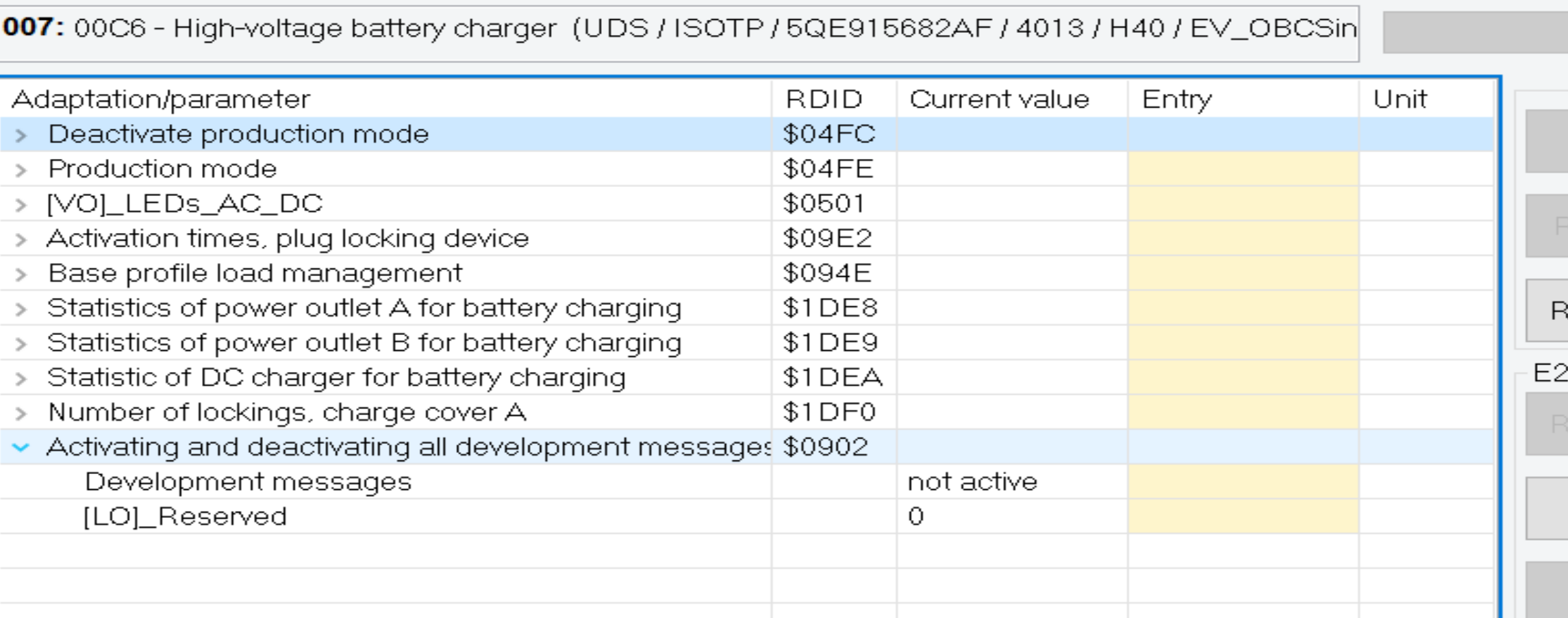

I've connected my Golf GTE charger up to ODIS (connected to the power train can) and it looks like theres some coding options.
Not sure what they mean as of yet, but maybe some of the checks can be coded away like on it's bigger brother.
EDIT Coded off the flap lock and socket lock. Lets see.

Been messing around with my Cayenne charger for the last few months. Tonight I finally got some continuous charge out of it. Uploaded are the coding settings I used in PIWIS.
I think the main settings that did it was disabling power line communications and also enabling plug and charge.
Edit: On further testing these didn't make any difference.
Further edit: It seems what it really cares about is socket temperature, if that's open or too high it wont charge at all. It also doesn't like charging with a target voltage of below 380v or so. Apart from that I have many faults showing on PIWIS but it will charge anyway.
With this set I use Mitchys code that he used with the higher power chargers and could enable and disable charge, also lower or increase charging amps.
Further further edit: On reflection I think this is probably more useful in the MLBevo charger thread, as I think this Porsche charger is part of that family.

EDIT: Got 684J 11kW charger. After testing I 'accidentally' noticed charger data is on the same CAN bus, no need for two busses on this one. Now that I read previous posts this is clear, mee soo stupid
Now I need to code things using ODIS, so there is hope on this.

3.6Kw 5QE 915 682 AF charger up and connected along with mating Charger Port - 5G0 971 509 F.
VCDS HEX+CAN is too old to read out data. I can Connect , read Fault Codes and Long Coding.
@Bigpie is using ODIS, along with others, do you have a suggestion of where to get my hands on this without paying the earth?
Basically, I am sending the 0X157 ID on PT CAN and seeing data flying by, but don't know what they all mean.
Are the Magic Bytes required whilst Fuzzing with SavvyCan? Basically, I'm trying to get the LED's to light up on the Charge Port as a first step.

Thanks to a cocktail of @Mitchy, @Bigpie and @Uhi22, I have 2 CAN boards running. PeakCan listening, and SavvyCan 'Fuzzing'. I have a new VCDS Hex-V2 connected too, as the previous Hex+Can is too old.
I can send messages from VCDS for the locking flap. I can see the CAN ID's that are concerned by the action, but when I try to use SavvyCan to find the Bits to be set High and/or Low, I can't copy the message. Are the CRC Magic Bytes required when using the Fuzzing Mode in SavvyCan?

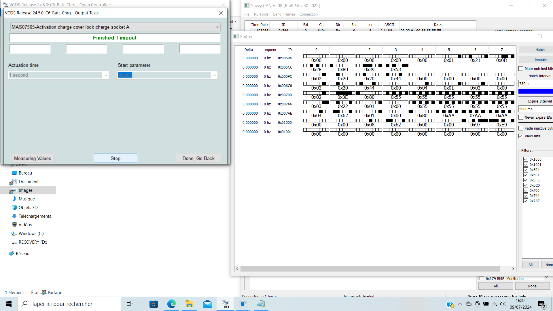

What I meant was I have VCDS connected.
I have wifican module connected to Savvycan.
I also have a dualcan module connected to Peakcan. All modules connected to PowerTrain CAN.
I 'played' back the blinking command from VCDS, captured the raw CAN messages with Savvycan (Peakcan only used for verifying I have the same messages), but I cannot simulate the LED blinking when I playback a data capture in Savvycan..
I have done the same with the lock mechanism on the flap.
I understand VCDS protocol is different to a working system (UDS), however , are the raw CAN messages to switch for example an LED from the control unit different to those of a working system?
I understood that there are CAN logs that were played back to see if these chargers could work. That means the magic bytes were not needed when doing a 'replay'. Is this is correct, or have I got it all muddled up?
Re: MEB Chargers
Hey,
Not sure if replaying VCDS logs will activate any options,
I'm not too familiar on the protocol, but within the CAN messages there's likely some handshaking and authentication.
Some quick reading https://github.com/openvehicles/Open-Ve ... TP-2.0.txt seems to suggest some CAN IDs that are associated, so if you see those in your VCDS Logs then it would make sense.
Magic bytes are likely only used in the vehicle communications between modules, so they become important if trying to spoof signals to operate the charger as it would in the car.
Regarding the magic bytes; They are mostly used to have a constantly changing way to ensure some can messages are fully as intended (It's a CRC check)
Along with the Message Data, there is a rolling counter. together each of the 8 bytes of data use the magic byte value to calculate agaist
Some messages have just one magic byte, used for all of the counter values, while other messages have different magic bytes for each counter value.
I assume it was added to make the CRC checks more robust, as it's unlikely it's a security measure (or at least a poor one).
Depending on the charger version, we can try to replay particular IDs from logs, or use some Arduino programs to simulate to get it to charge.
There are some interlocks to clear (such as when the charger does actually output a voltage, then the BMS CAN message will need to mirror that voltage as the actual voltage, or else the charger will cut-out as the two voltages differ more than 5Vdc

Thanks for the info. This is all helpfull. Attached is a screen print of CAN ID's when playing the Blinking LED's with VCDS.
To me, it looks like the raw data, and I assumed that playing this back would make the LED's blink....obviously it's not the case.
I might try to connect my other CAN Board, but don't see how that would help.
For info, I get ID - 05CC that seems to change whilst the blinking is running. If I get this working correctly, hopefully I can help move this charger along to a workable solution......
