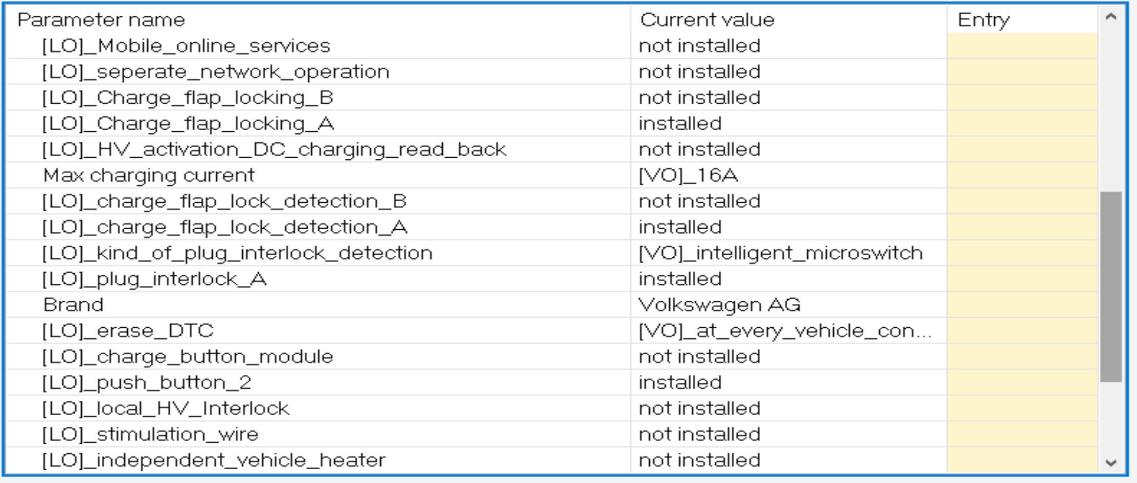

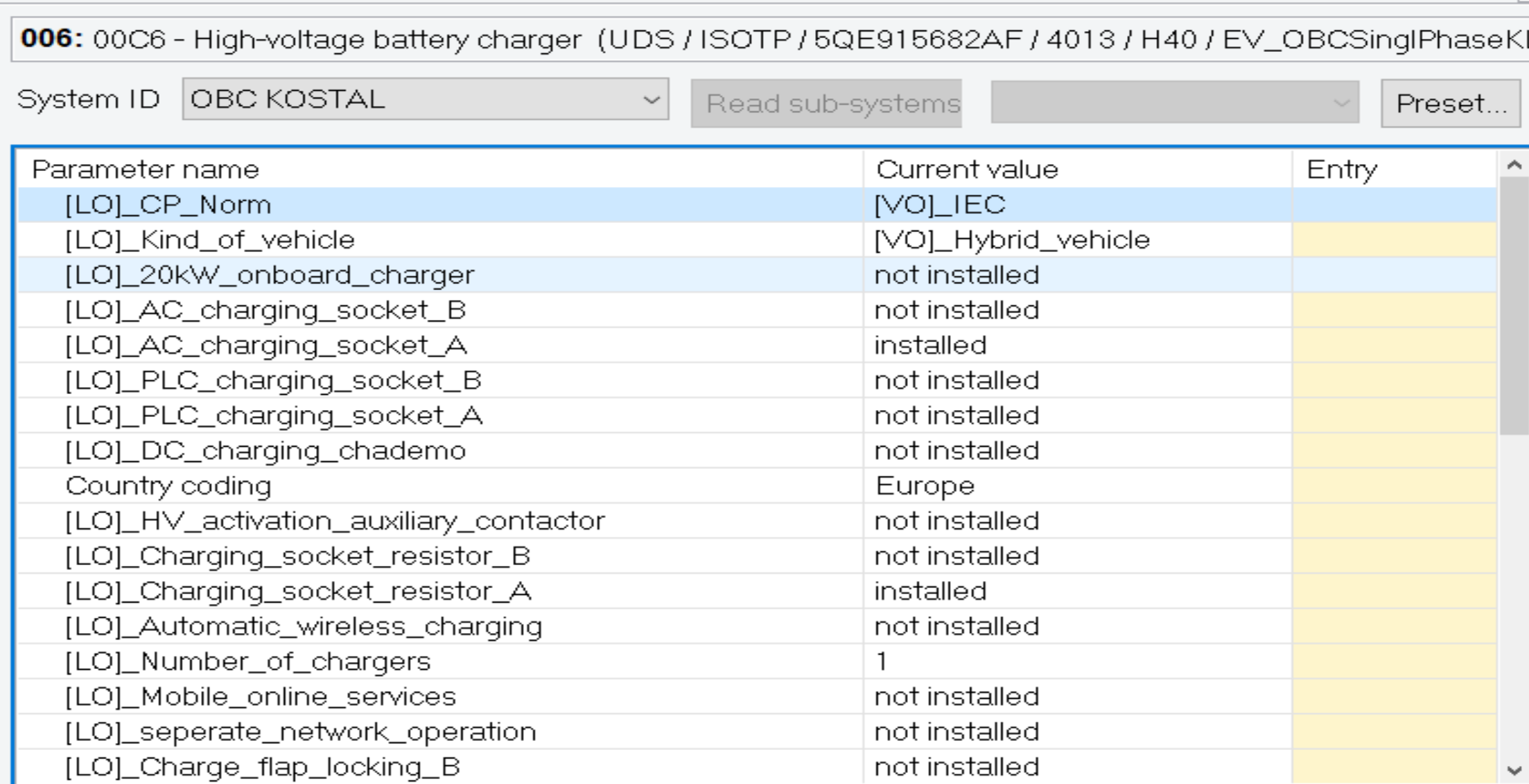

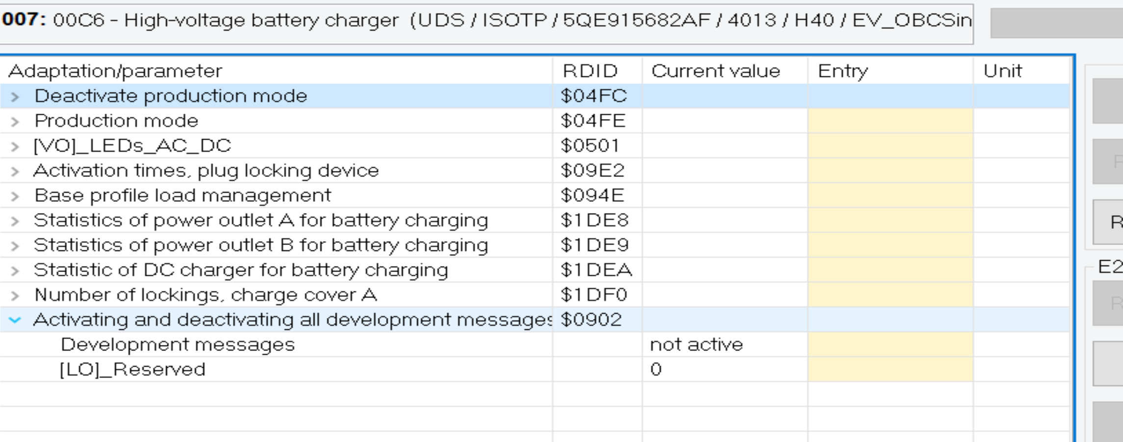

I've connected my Golf GTE charger up to ODIS (connected to the power train can) and it looks like theres some coding options.
Not sure what they mean as of yet, but maybe some of the checks can be coded away like on it's bigger brother.
EDIT
Coded off the flap lock and socket lock. Lets see.
