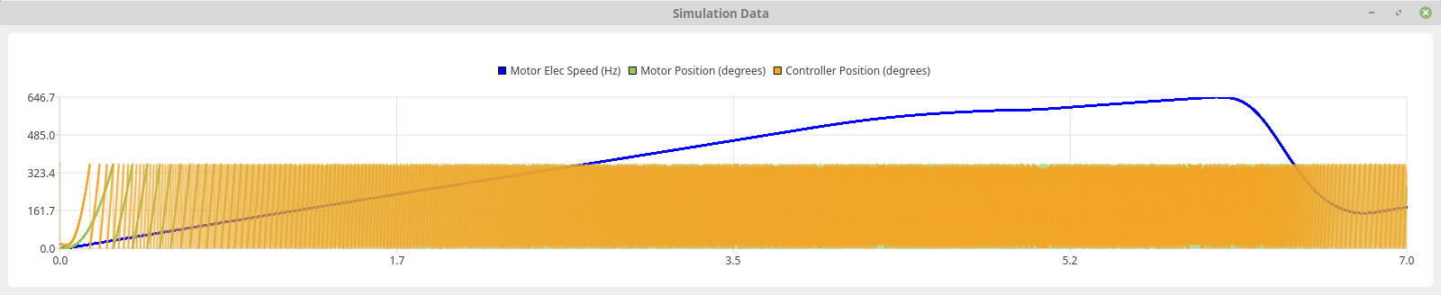

A plot with MTPA disabled for reference:

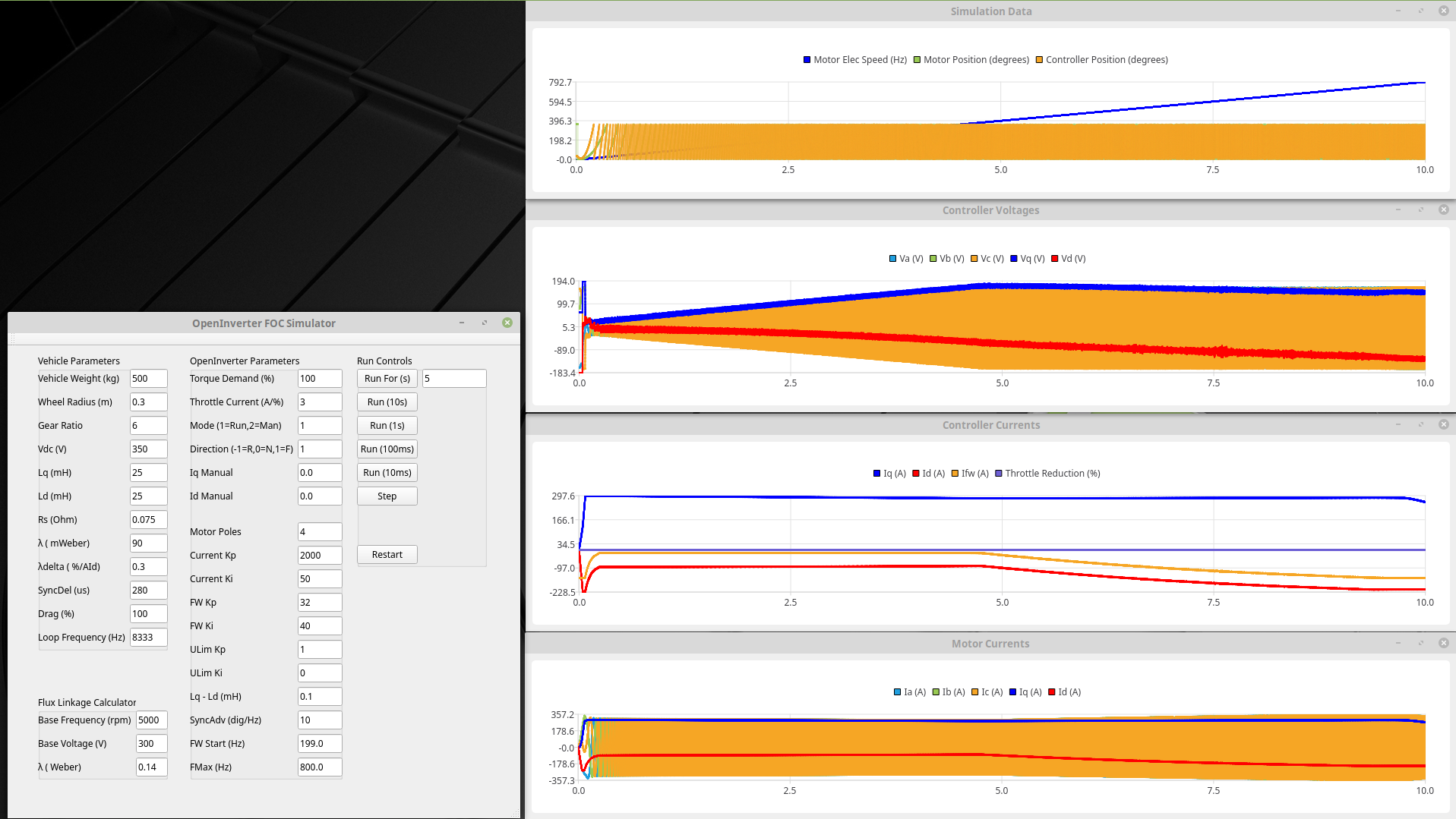

A plot with Lq-Ld = 0.1mH:

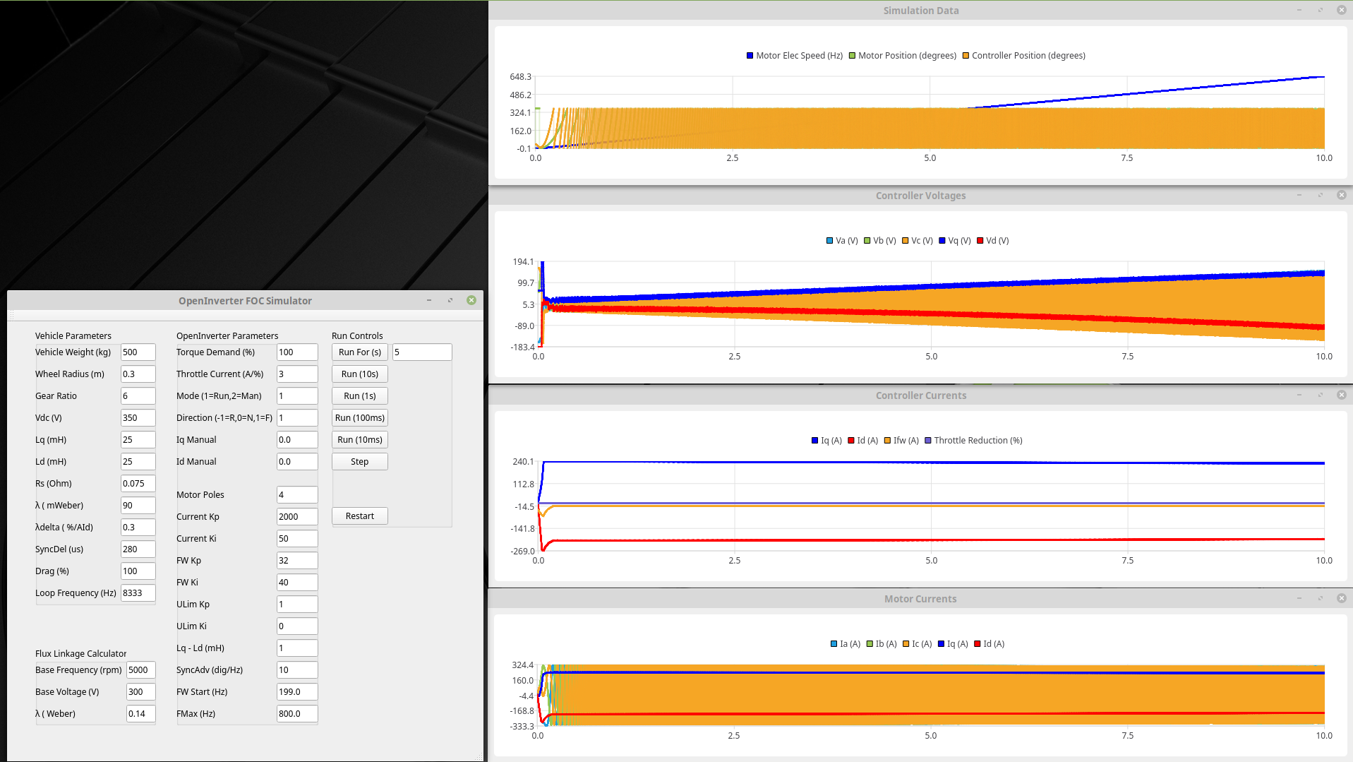

A plot with Lq-Ld = 0.5mH:

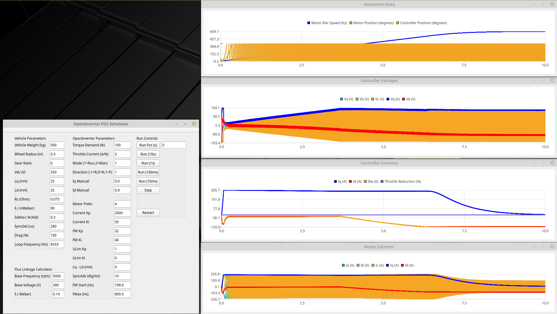

And one with Lq-Ld = 1mH:

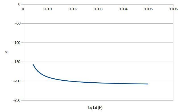

What's interesting is how little Lq-Ld is needed to generate significant -Id, 0.1mH is enough to produce 100A rising to 200A by 1mH. I'm wondering whether the 5.8mH default in the original code is realistic? I'm now thinking that for tuning start at 0 and increase in 0.1mH steps rather than 1mH.
It's also worth noting that the -Id vs Lq-Ld curve flattens out quite quickly so high values of Lq-Ld don't give significantly higher -Id currents than seen above. The plot below shows the calculated -Id for various values of Lq-Ld for an Is of 300A (same as above plots):
It's also interesting that OpenOffice couldn't calculate the current for values of Lq-Ld of less than 0.4mH (underflow giving a divide by zero error) which goes to show it's not an easy calculation to get right in code!
On all these plots the motor is set for low saliency (as I still don't trust the motor model here) and it's interesting to note that the MTPA algorithm just reduces the motor acceleration as it effectively limits the available Iq (the only torque generating component on low saliency motors). It does have a field weakening effect though so allows the motor to run to a higher top speed. On higher saliency motors the situation should be reversed.

johu wrote: Tue Aug 30, 2022 11:47 am 2. Can your simulation show the effects of non-synchronous sampling of motor current and rotor position? I'm afraid if we drop it into a car now, we still get the effect that you are commanding throttle-independent d-current and end up with a fraction of q-current because the rotor angle is lagging. And thus unwanted acceleration
Better answer - just tested this again. The plot below shows accelerating up to full speed for 5sec with matched SyncDel and SyncAdv. Without changing anything else I then reduced SyncDel to 0 (so the model is simulating simultaneous angle and current sampling but the controller is still assuming early angle sampling) and ran for another second which gives acceleration (more field weakening)? Then set SyncDel to 560us and ran for another second, this produced strong deceleration. Lesson to learn here is don't adjust SyncAdv live while driving along above base speed!! (would the firmware even let you if you tried?)
So I think the model correctly simulates the non-synchronous sampling and I believe that the SyncAdv features present in OpenInverter correctly account for it. I've seen no evidence that the non-simultaneous sampling is the cause of the unwanted acceleration.

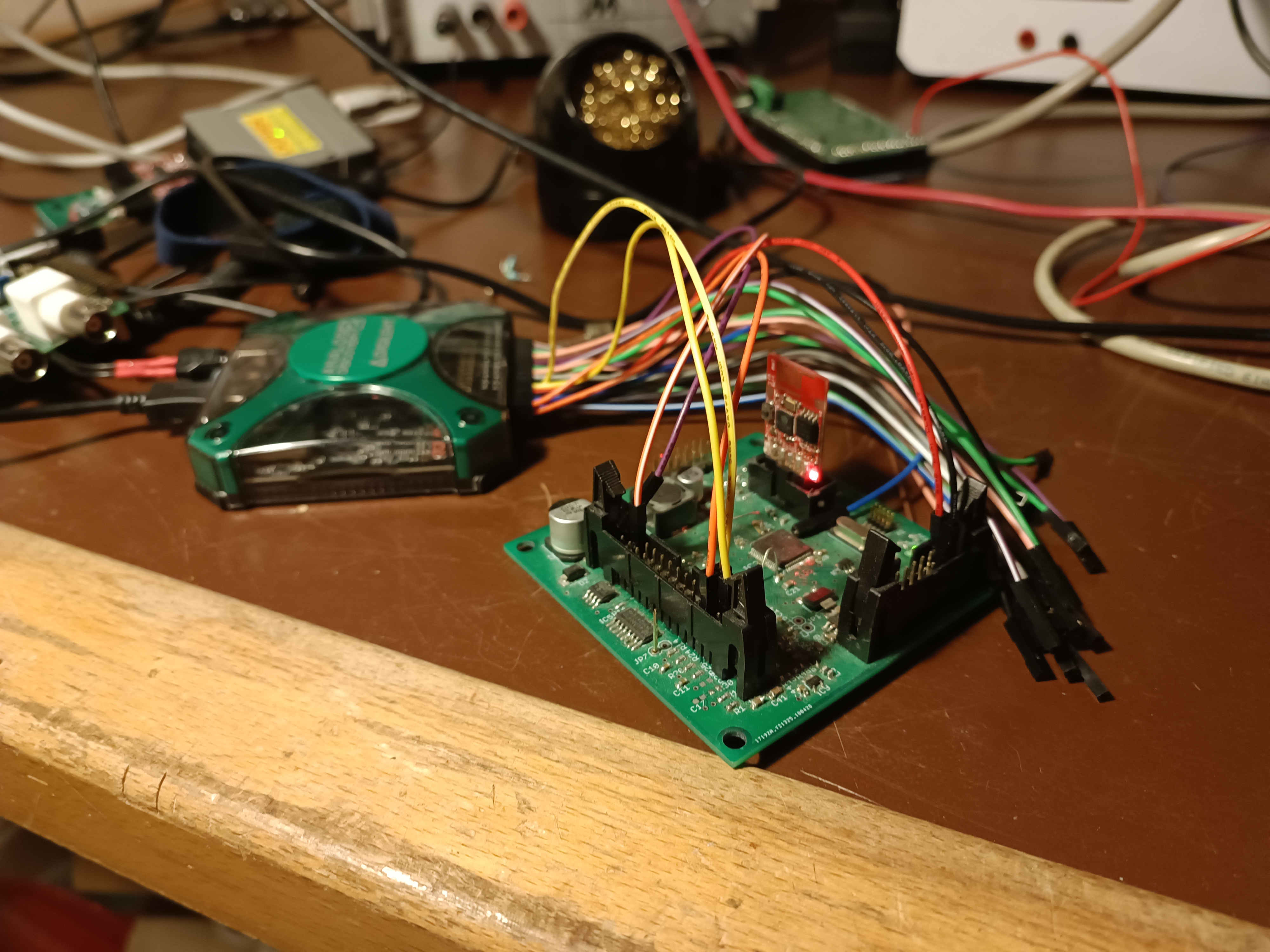

Just wondered how hard it would be to run the motor model on another processor and generate signals. But that would be a whole lot of DACs! At least 4 anyway for resolver and 2 phase currents.
EDIT: hmm, the interface for the AD2S chip (resolver to digital) runs via SPI. So the 2 DACs of an STM32F4 would suffice!
Pete9008 wrote: Tue Aug 30, 2022 6:45 pm That's good news (although I was hoping the processor load would be a little lower than that - there are probably a few places where efficiencies could be had if needed).
Not unexpected, so sqrt loops and such. Would it be sufficient to run the FW controller in the 10ms loop i.e. in SetTorquePercent()? Or will that kill continuity?
Pete9008 wrote: Tue Aug 30, 2022 6:45 pm Not sure about the increased performance - could it be turning some of the excess Id back into Iq (or is that the wrong way round)? Is it possible that SyncAdv tuning is being affected by something else (say interaction with unmatched Lq-Ld parameters) and isn't actually being set right in the first place?
Yes maybe that shifts id/iq split back into something more performant

johu wrote: Tue Aug 30, 2022 8:05 pm Just wondered how hard it would be to run the motor model on another processor and generate signals. But that would be a whole lot of DACs! At least 4 anyway for resolver and 2 phase currents.
I like that idea a lot :D It would be ideal for use on the bench giving you a fully configurable motor to test/develop with!
