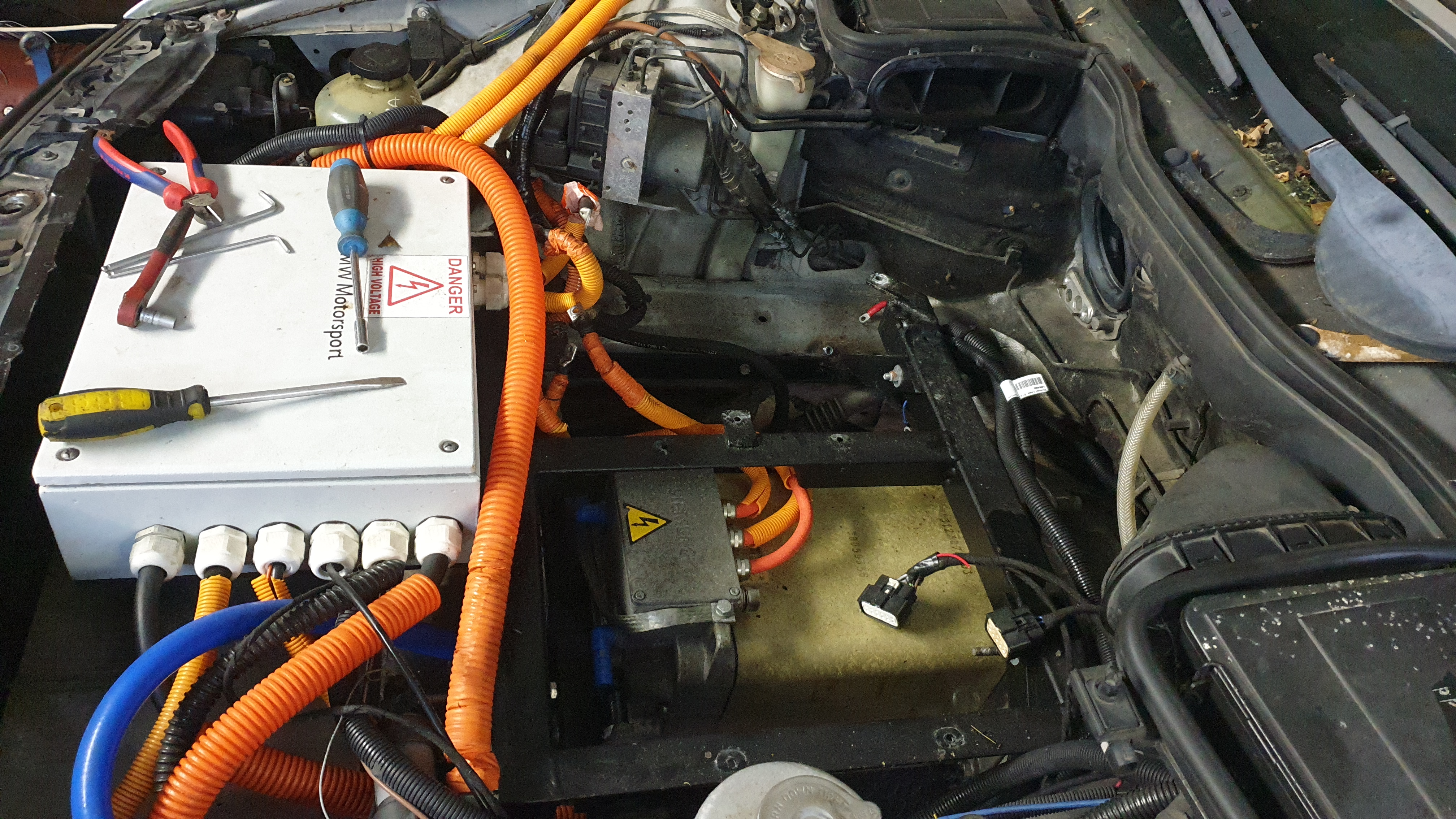

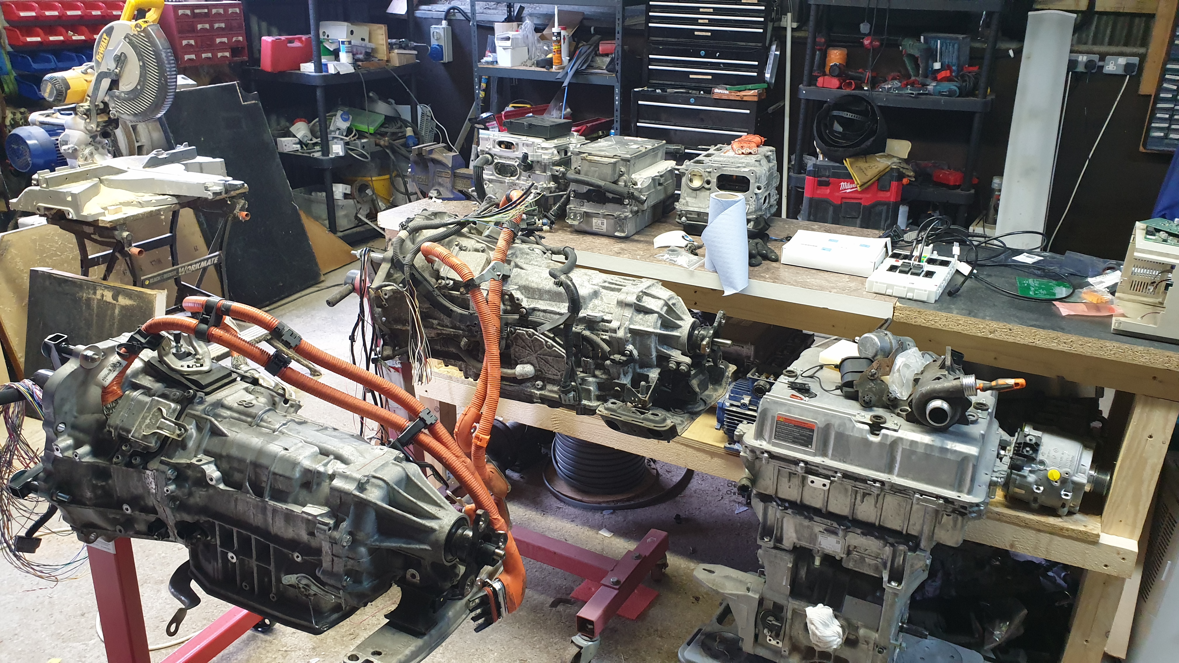

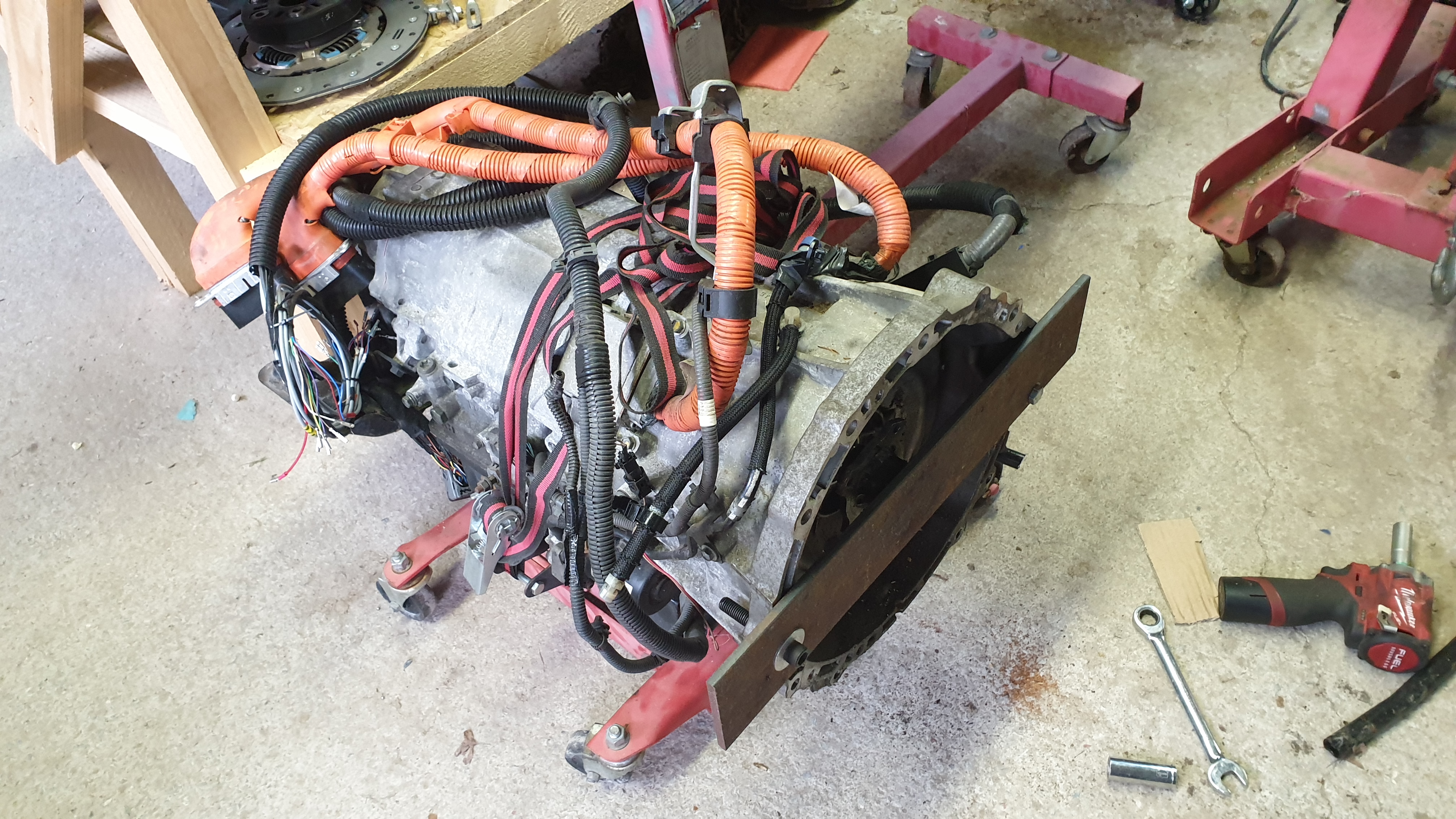

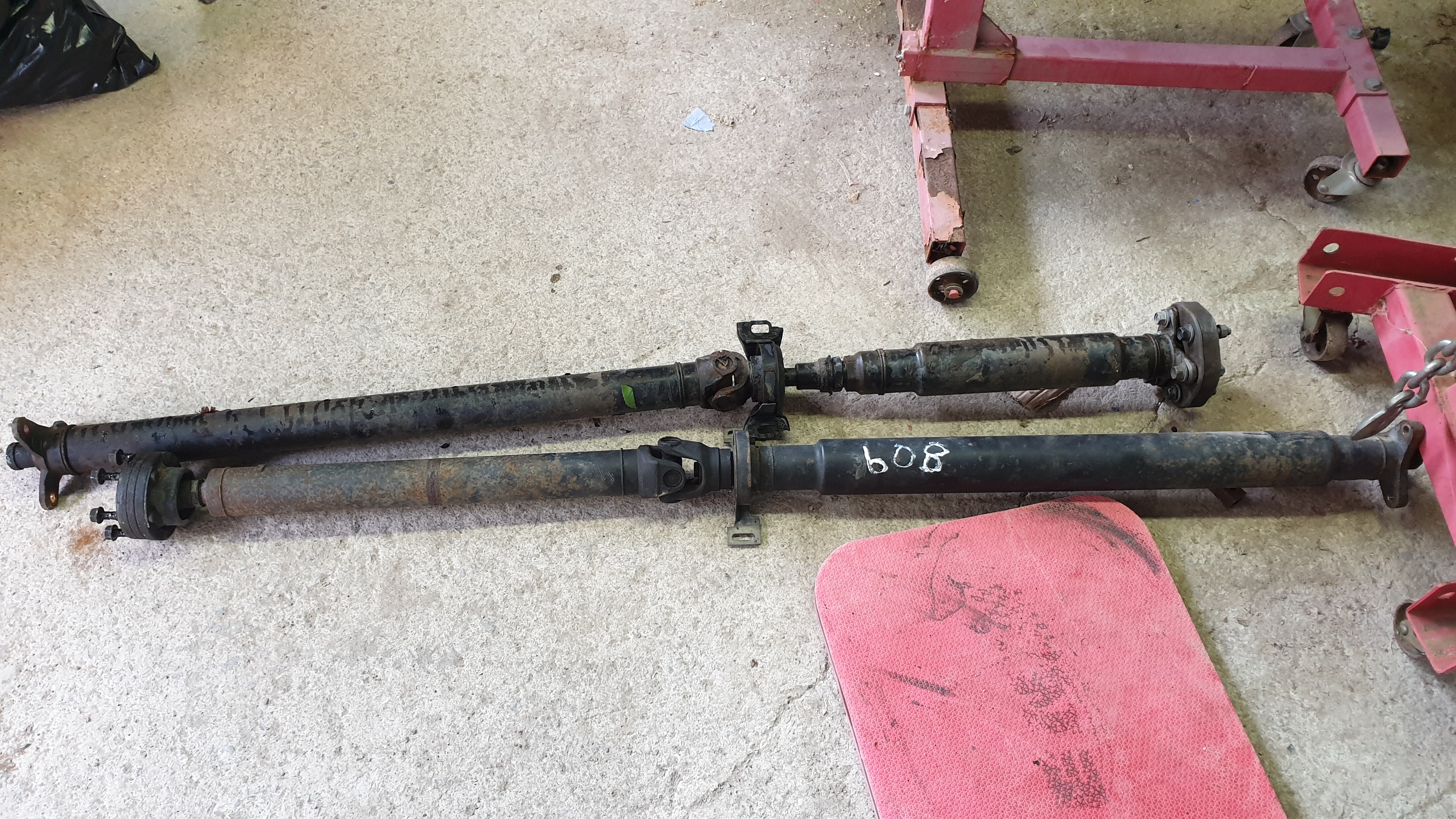

Long time no update. As some of you will know I have a bench setup with a GS450h and GS300h now for software testing with the VCU. A few folks on Patreon had suggested fitting the 300h to the yacht and I started parts gathering for an "auto swap" :) Anyway, plans change and I'm now going to pop the 450h in the E39 as it will give me a nice testbed to get things like gearshifts etc ironed out. The 300h is going in .....a new project:)

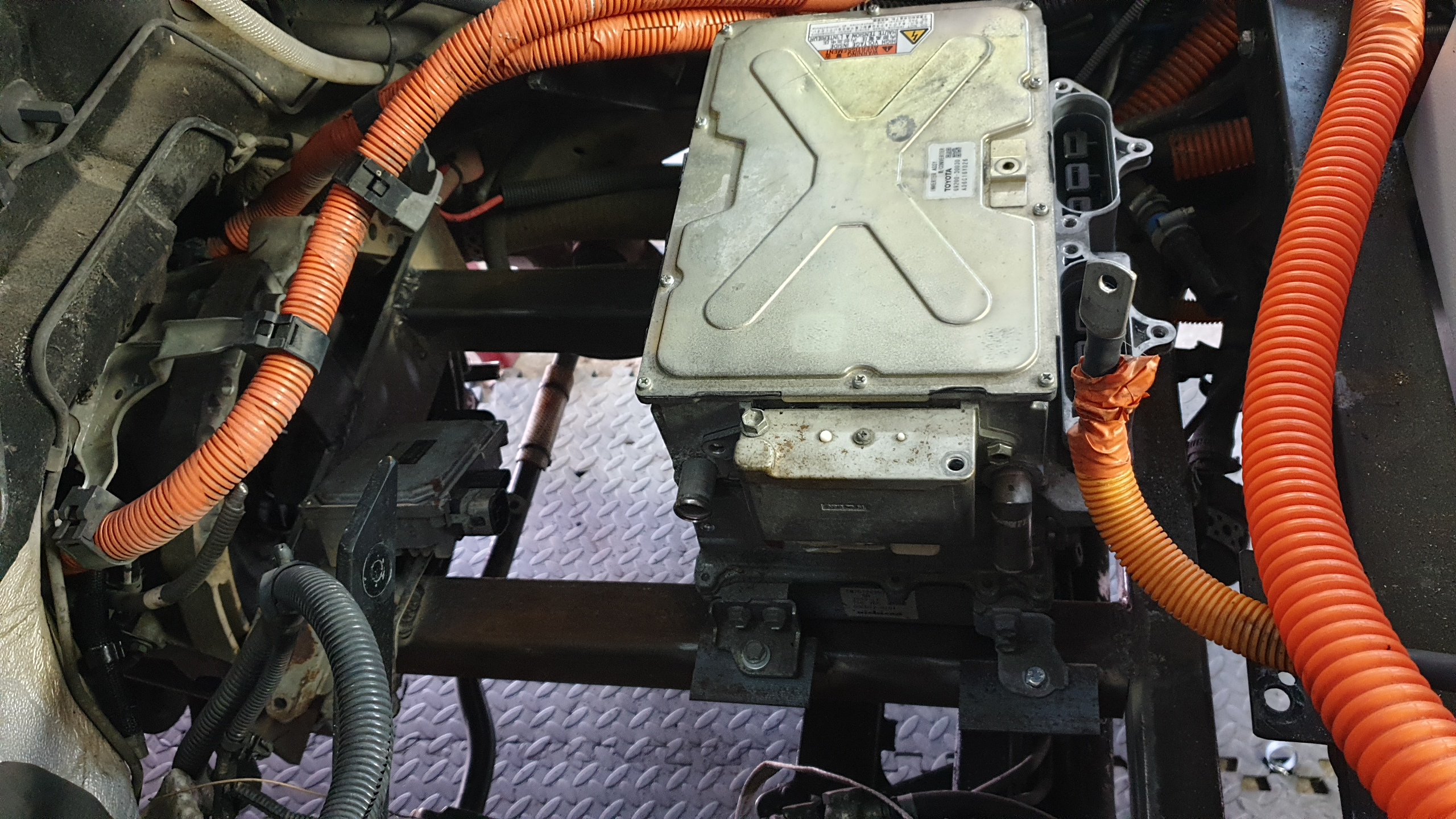

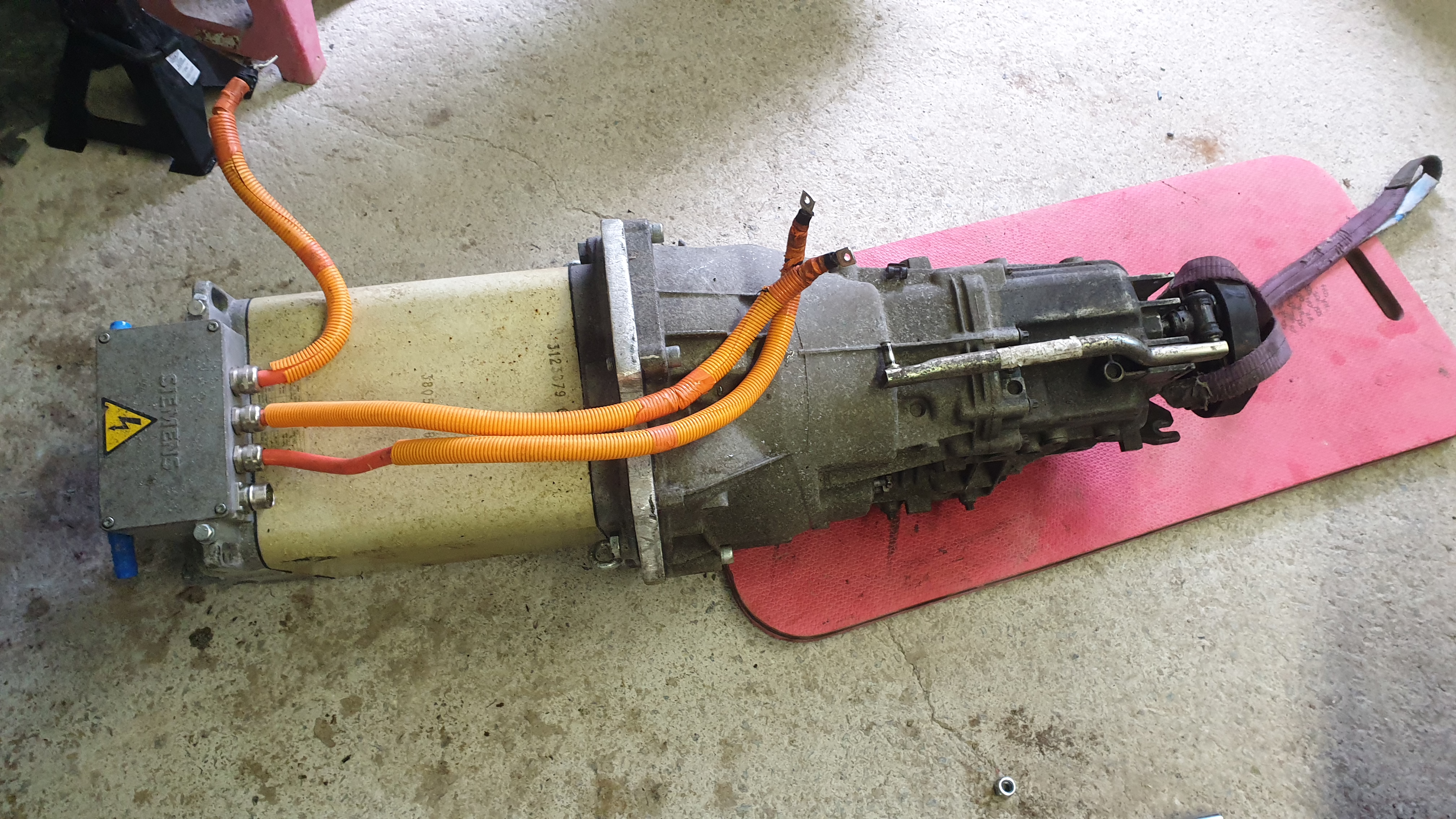

Stripping out the charger, inverter and motor.
Posts: 4005
Been thanked: 1132 times
Re: The LandYacht BMW E39 Saloon

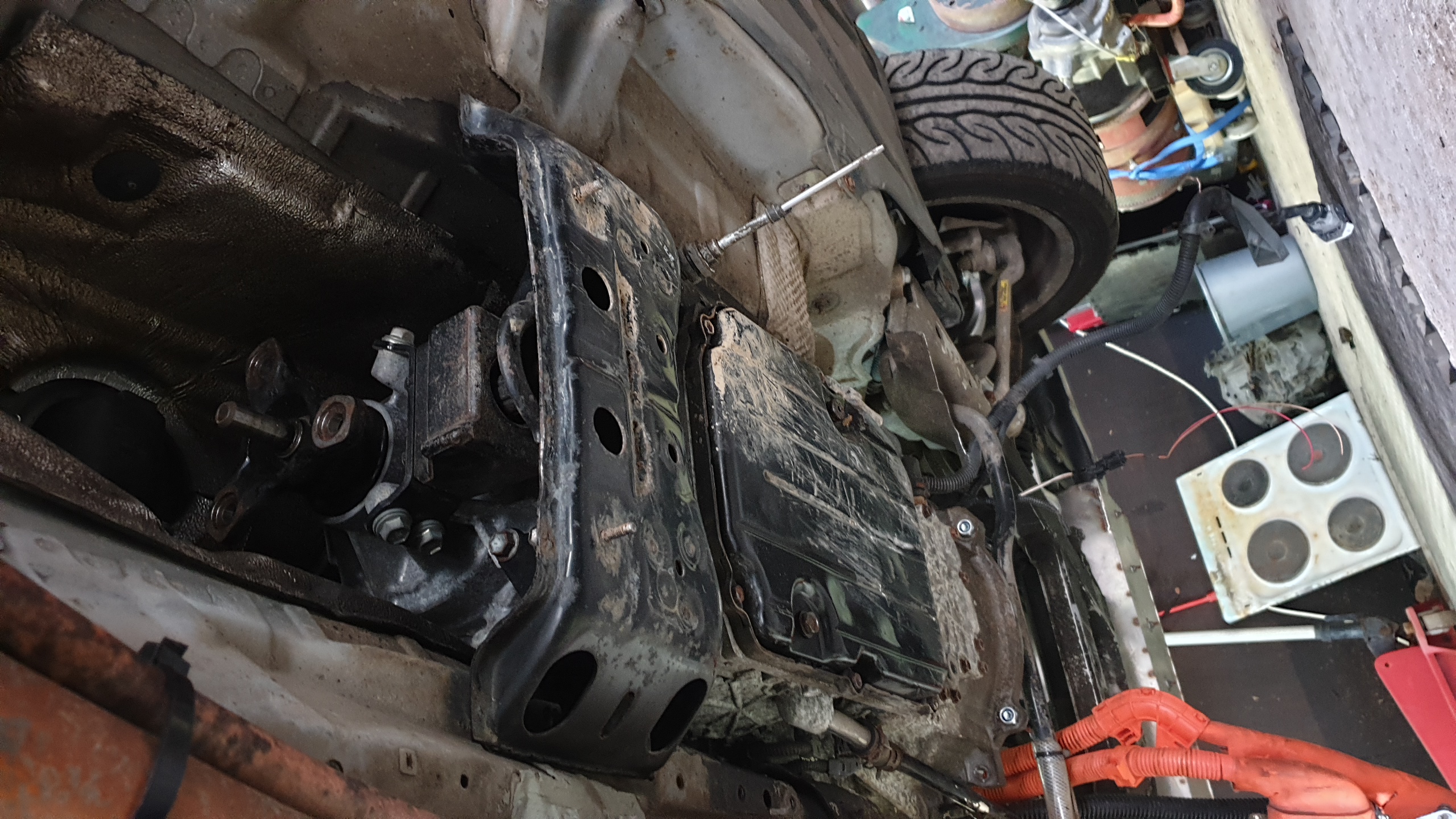

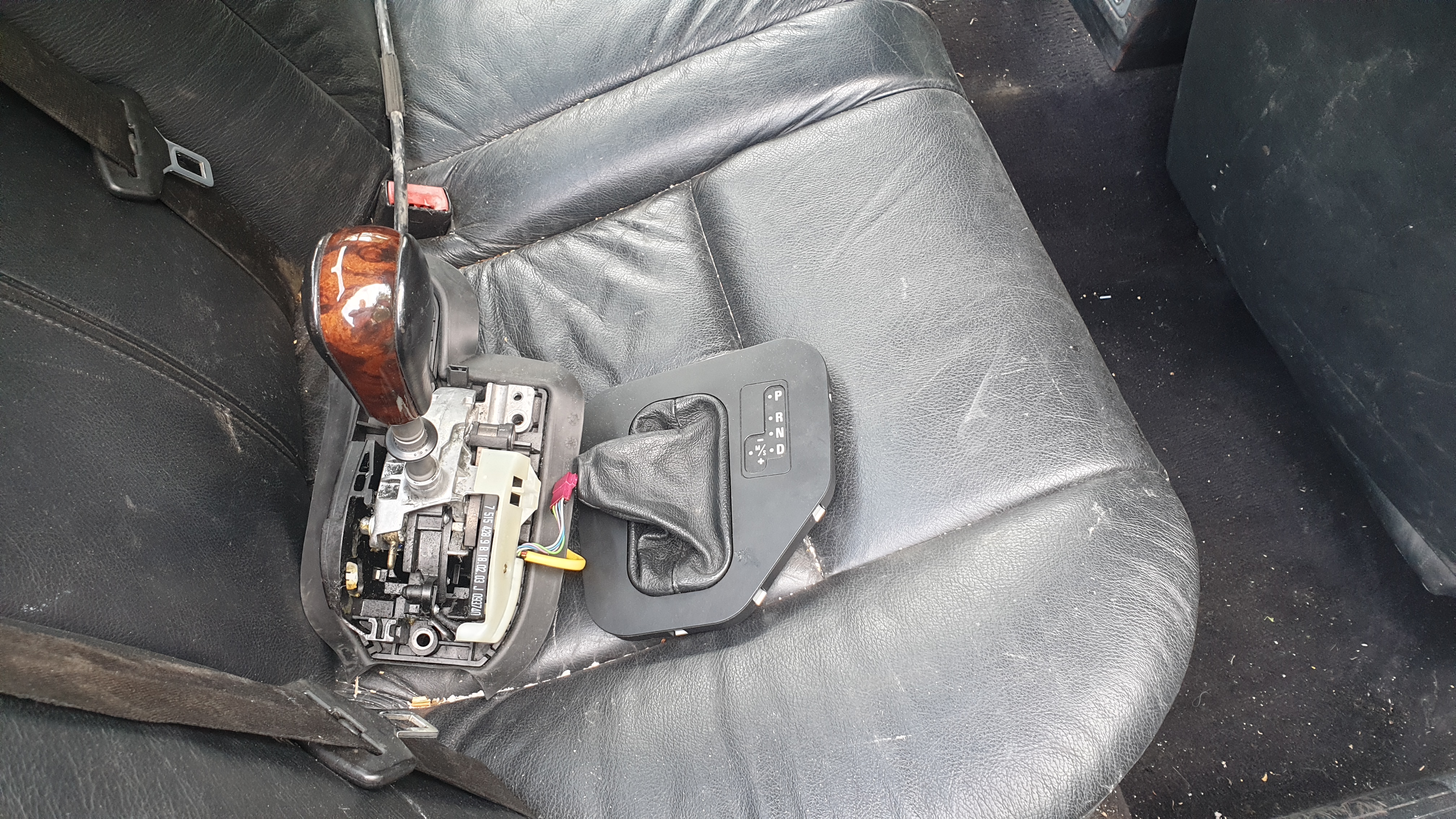

Few more progress pics from yesterday. No work today as spent the night puking into the toilet courtesy of some bad lunch :mrgreen:

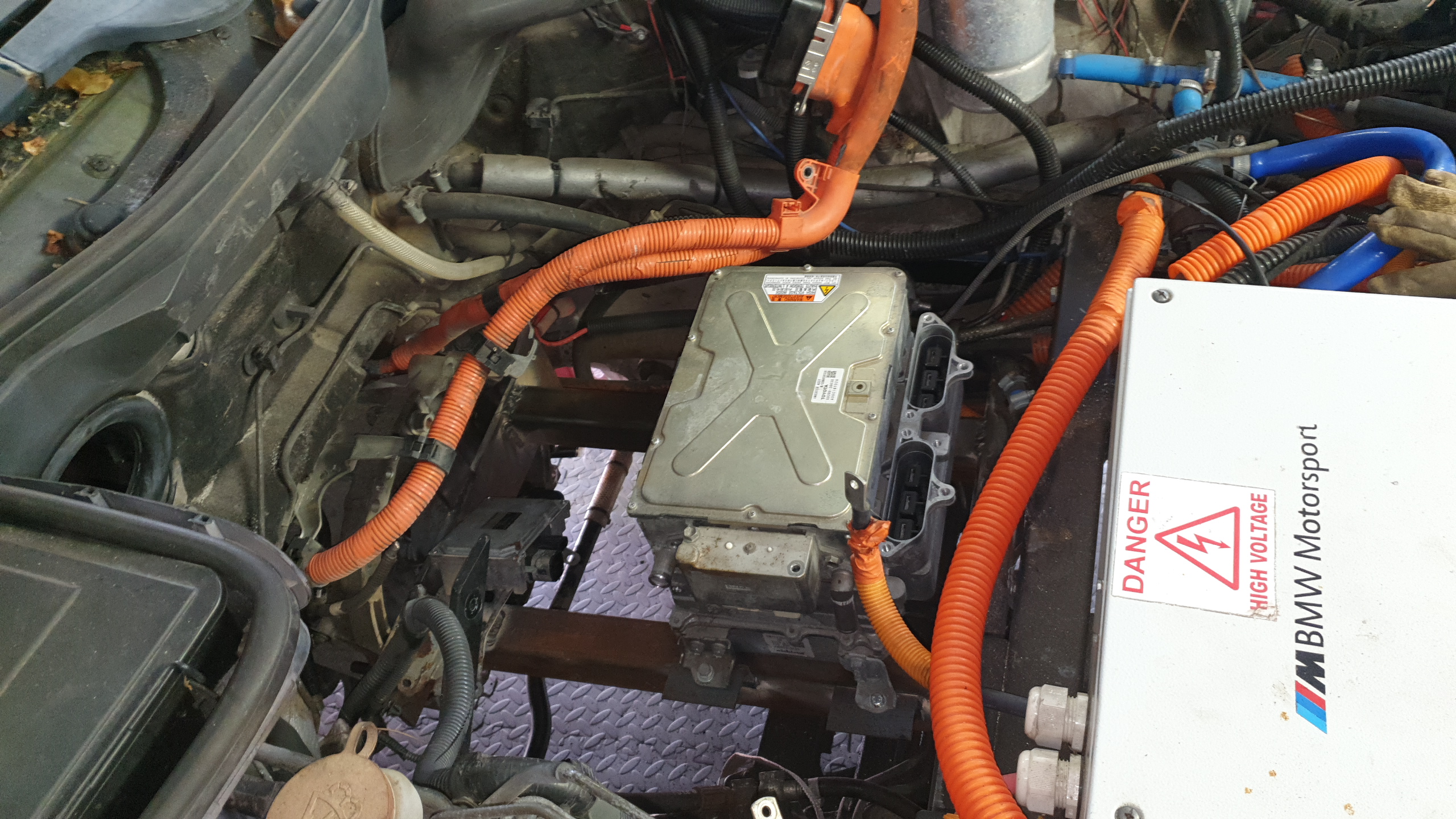

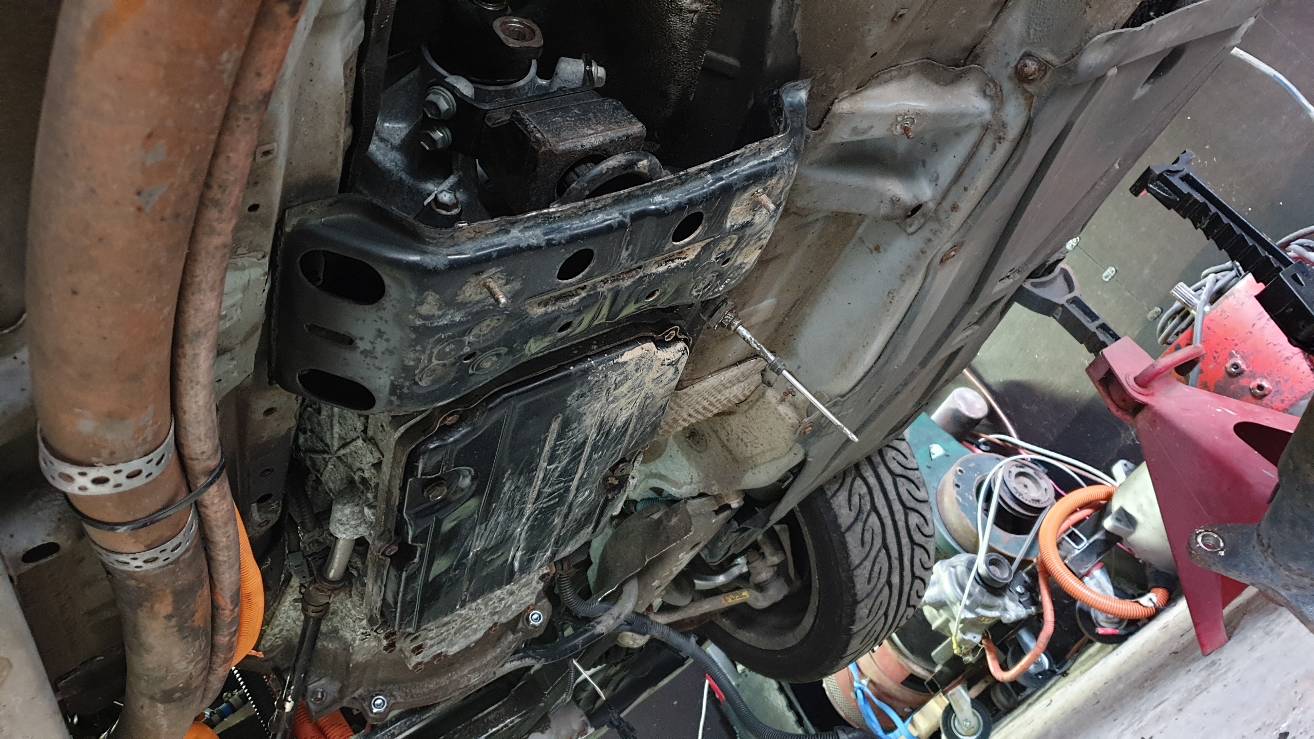

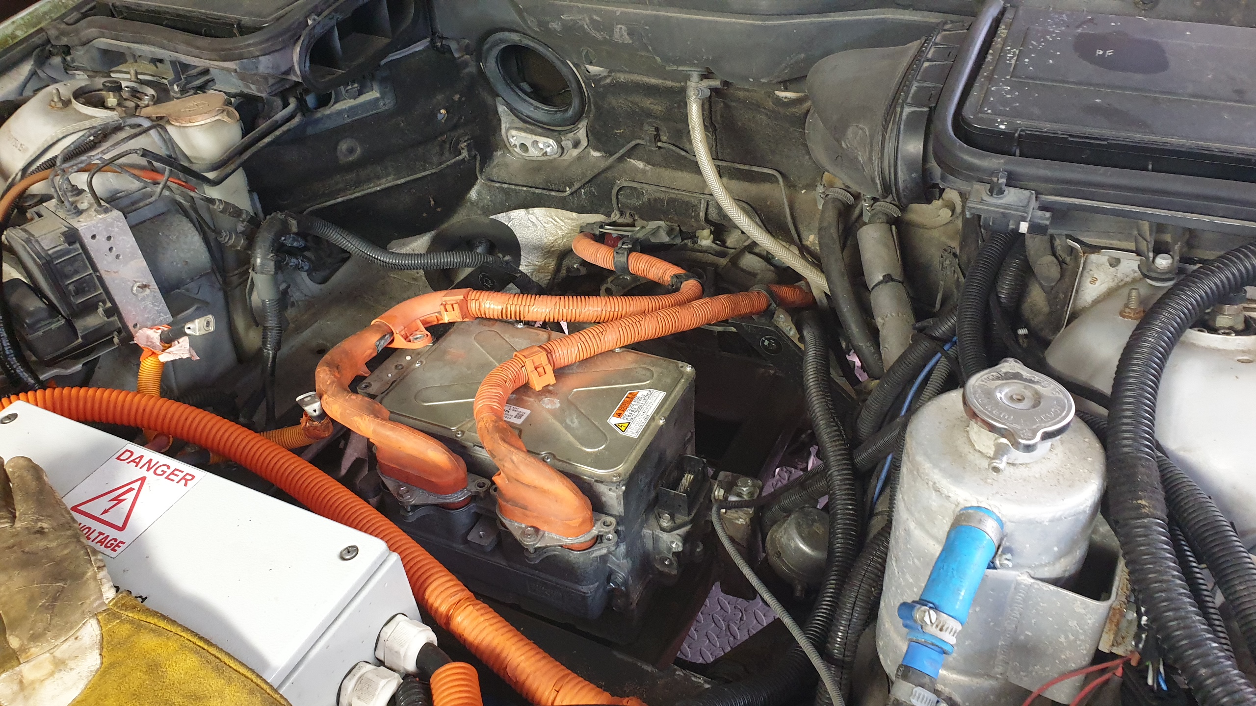

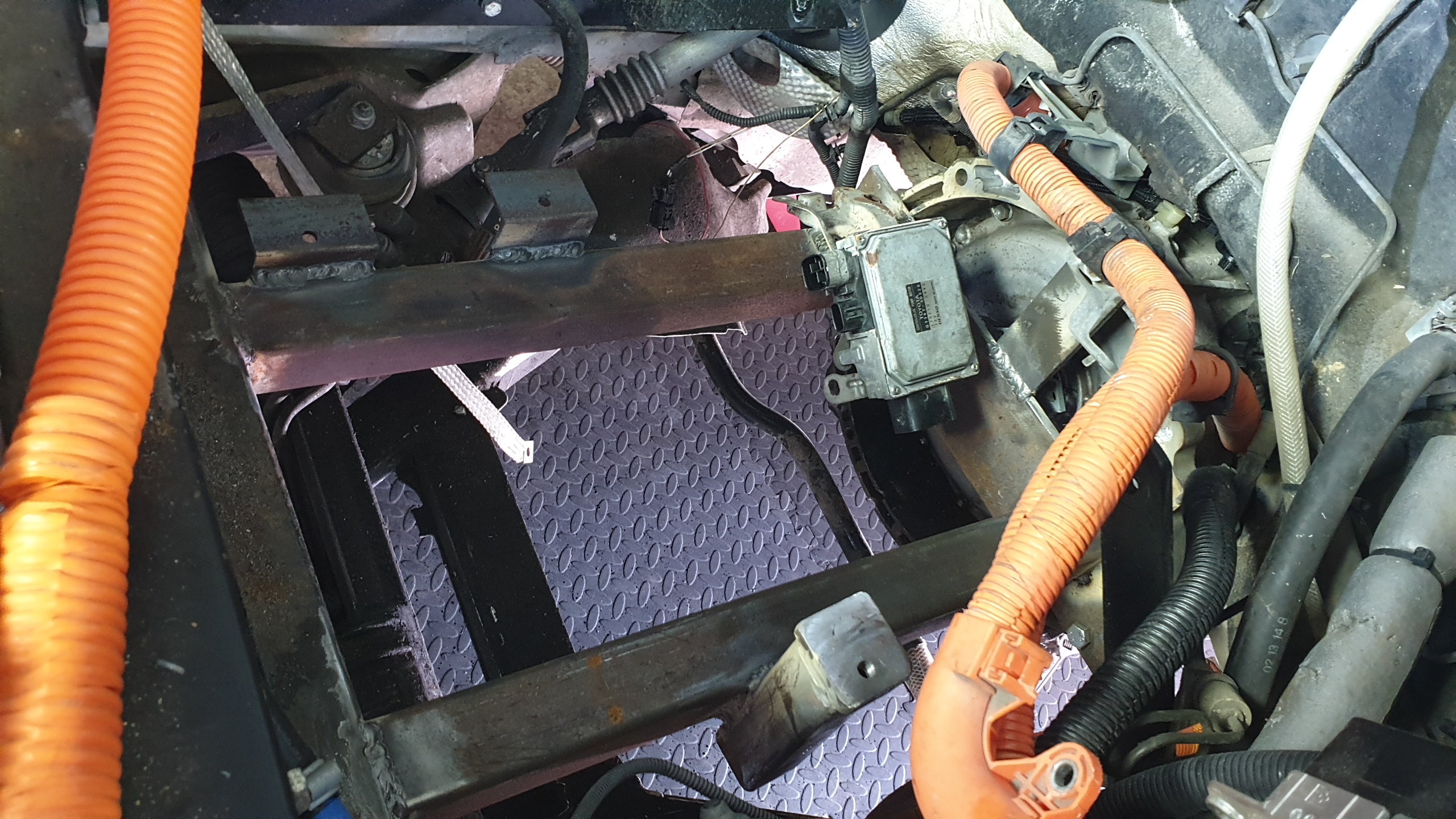

Little more progress.

Looking good. This is the project that makes mine easier :) I can see the gearbox mounts line up well aft of the standard chassis holes. good for weight distribution a hway. If I recall you already had added more, not sure if that was on this car.
I would argue with the 2 tonne thing by the way, my touring is 1850kg. How many leaf cells are in the front, presume you are keeping same battery?
Posts: 4005
It bolts to the same points as the auto crossmember.

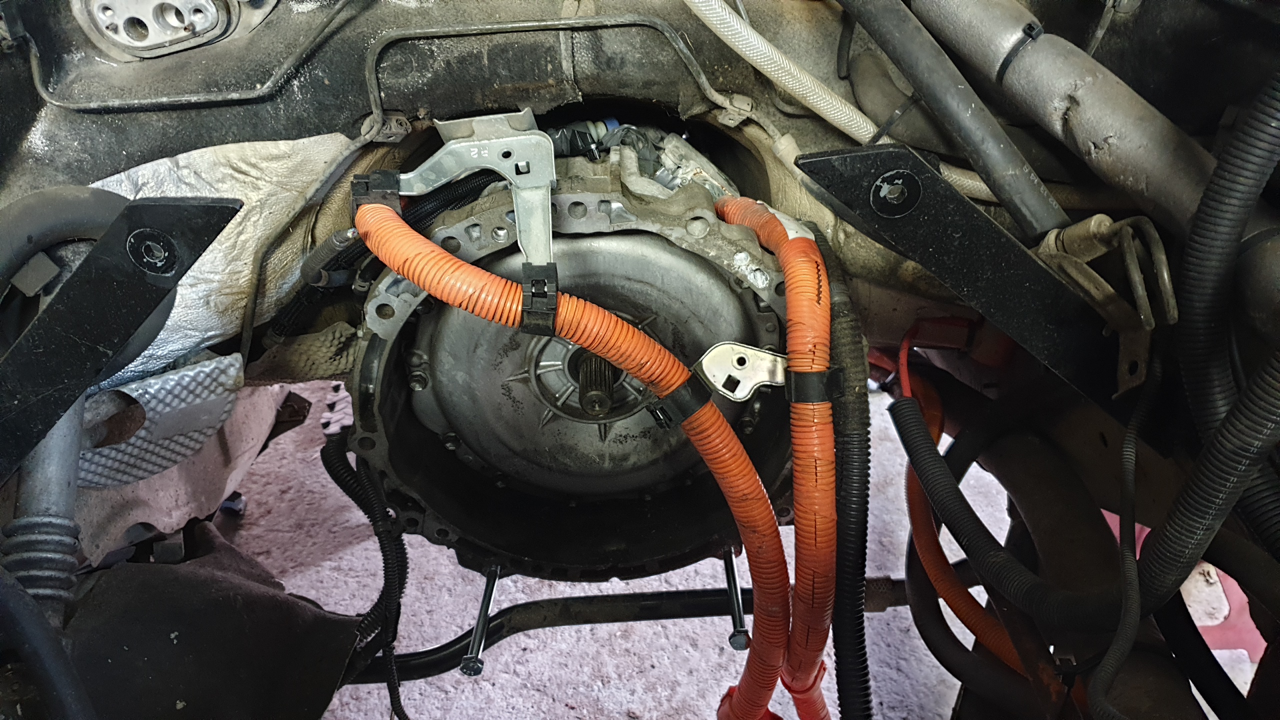

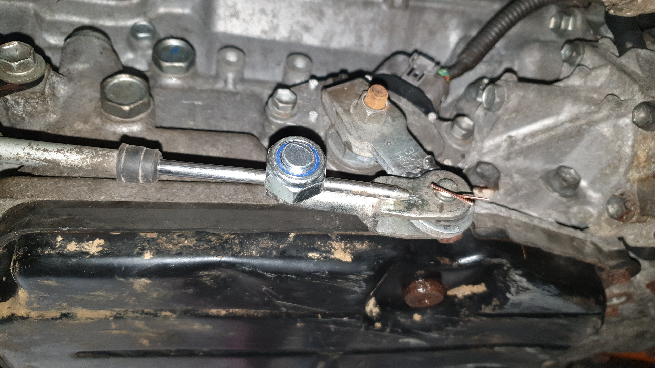

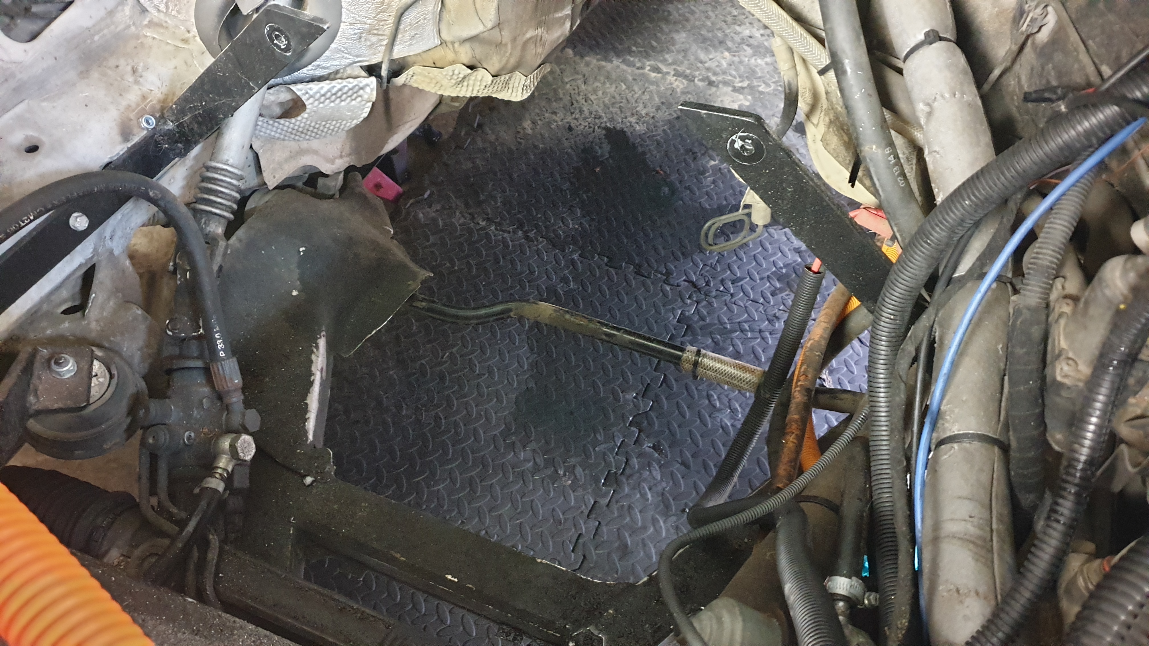

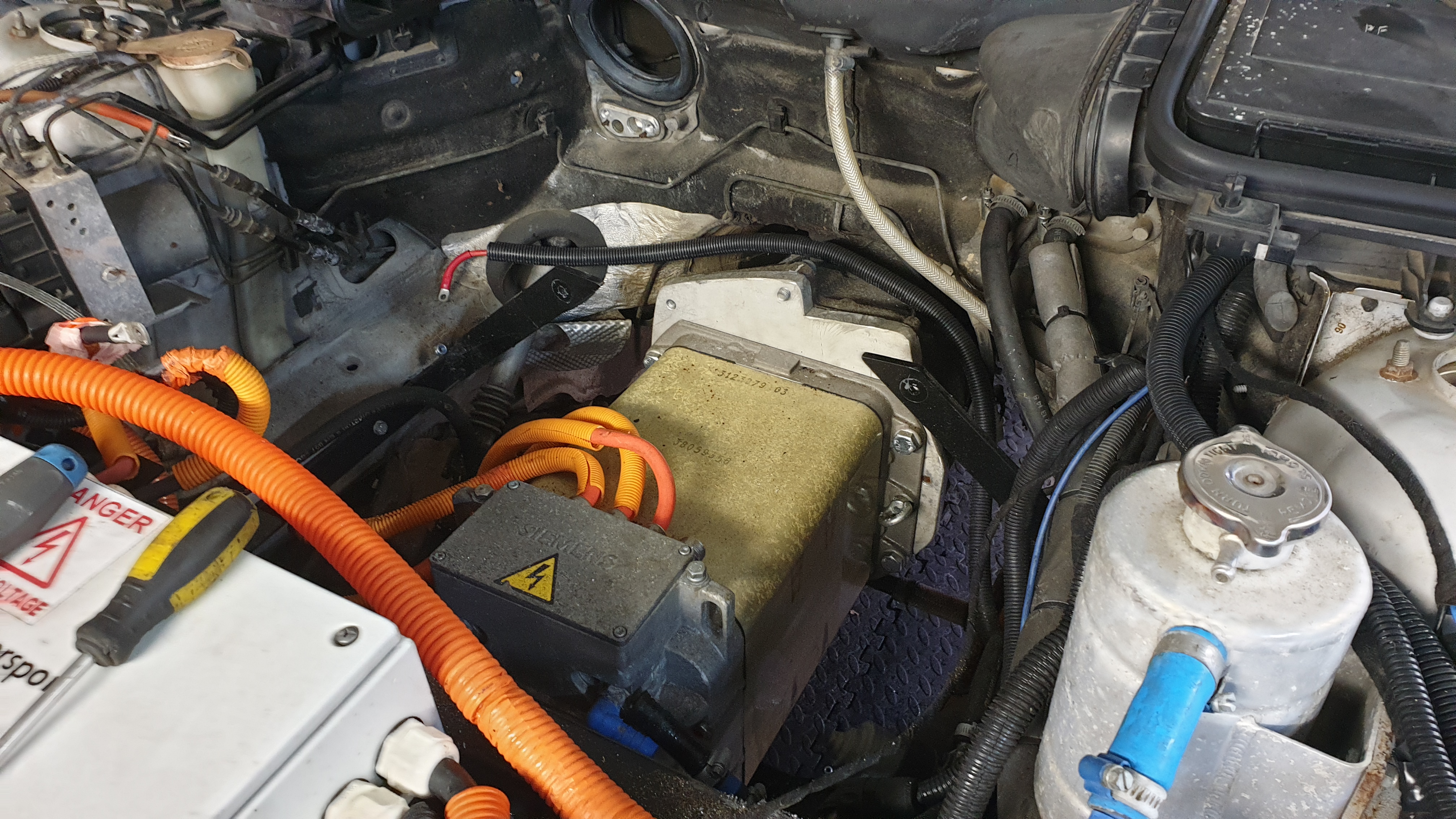

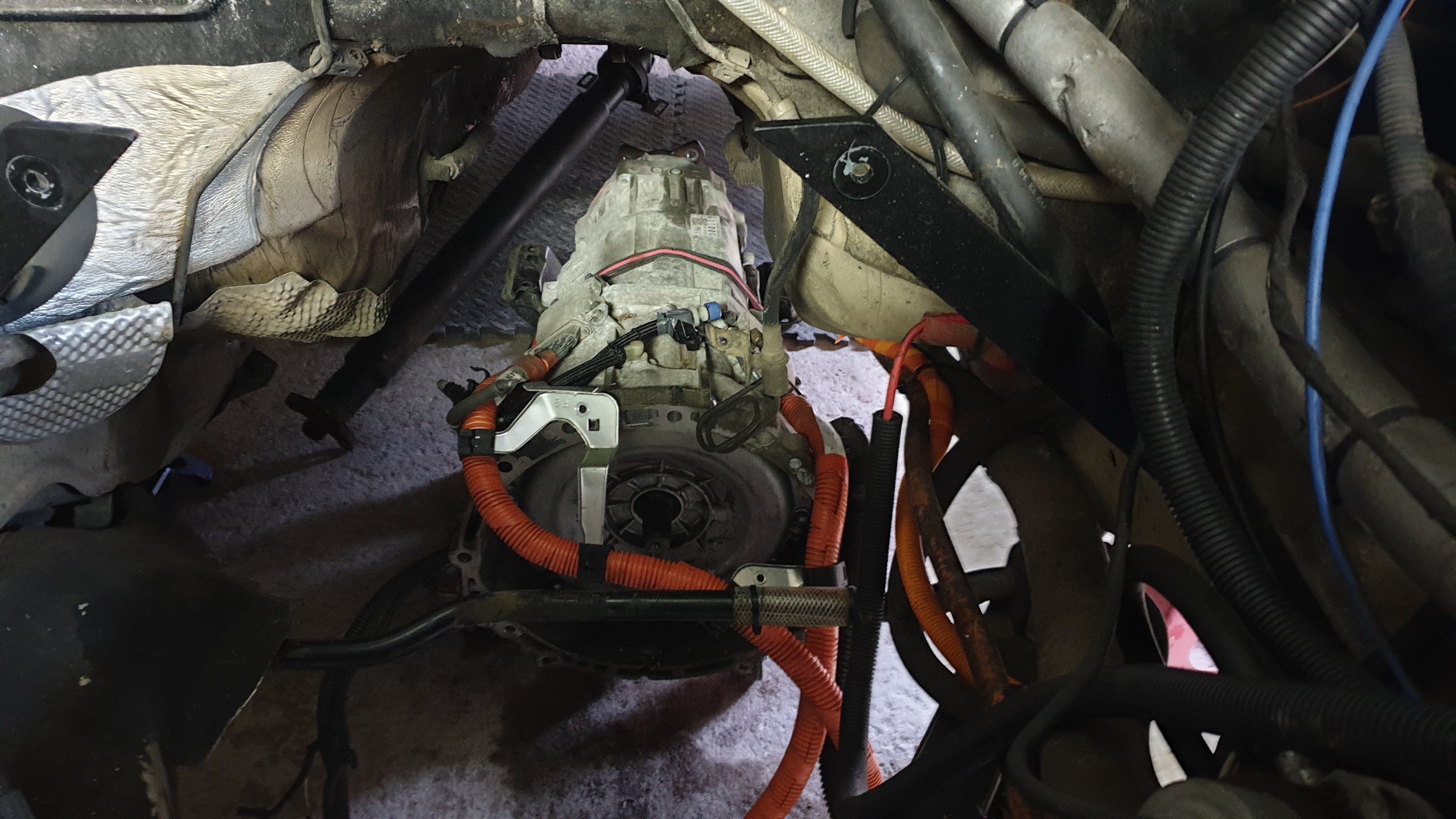

That is great to see :) , are the gear positions on OEM bmw shifter the same as positions on GS450?
How is on IS300 ? (more interesting to me :) )
laverage is ok ?

A point of clarification: are transmission jacks crap in general for getting it in place, or just that particular type? Any recommendations on something that's not crap?
TheSilverBuick
Posts: 187
Post by TheSilverBuick »
mark wrote: Thu Oct 13, 2022 2:14 pm A point of clarification: are transmission jacks crap in general for getting it in place, or just that particular type? Any recommendations on something that's not crap?
It looks like a motorcycle or ATV jack. My guess is the GS450h is about 100lbs/50kgs over what the jack is designed for.
