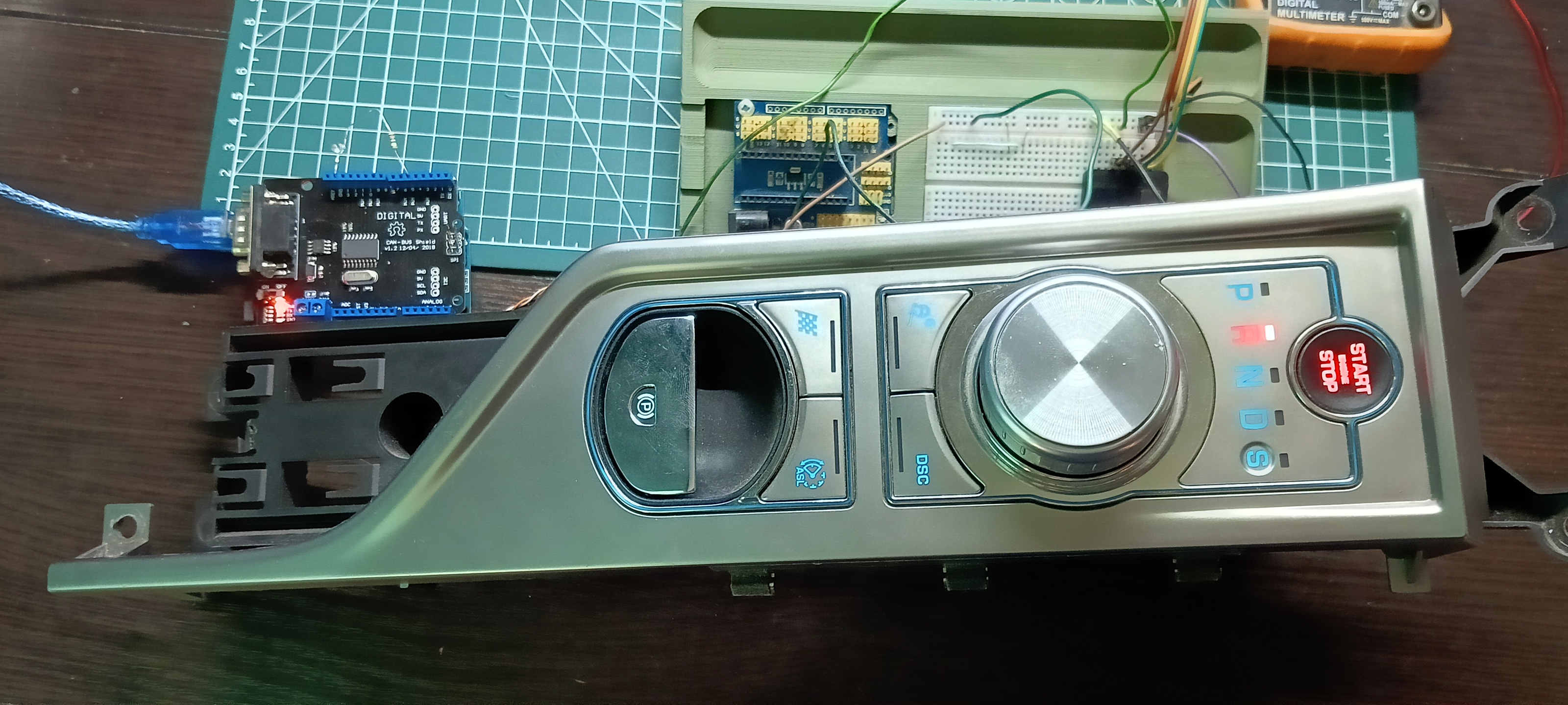

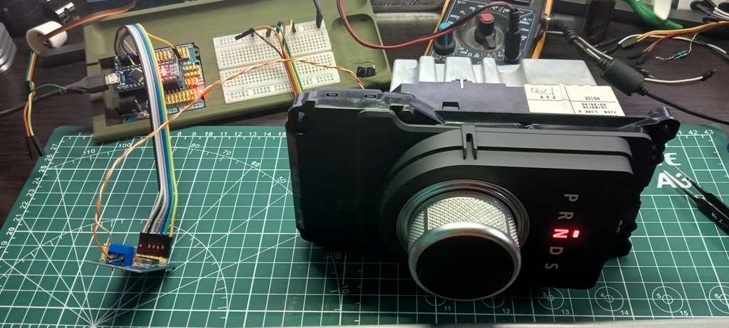

I'm going crazy!!! :x Bought a new GSM JLR EH22-7E453-AB. Uploaded Gen2 sketch to Arduino nano. Knob does not leave when sending 's'.
Connection: PC - USB - Arduino Nano - MCP2515 - CAN GSM.
Connection GSM:
1 - 12V,
2 - 12V (IGN),
5 - CAN H,
6 - CAN L,
10 -12V,
12 -Ground
What's wrong? Please tell me

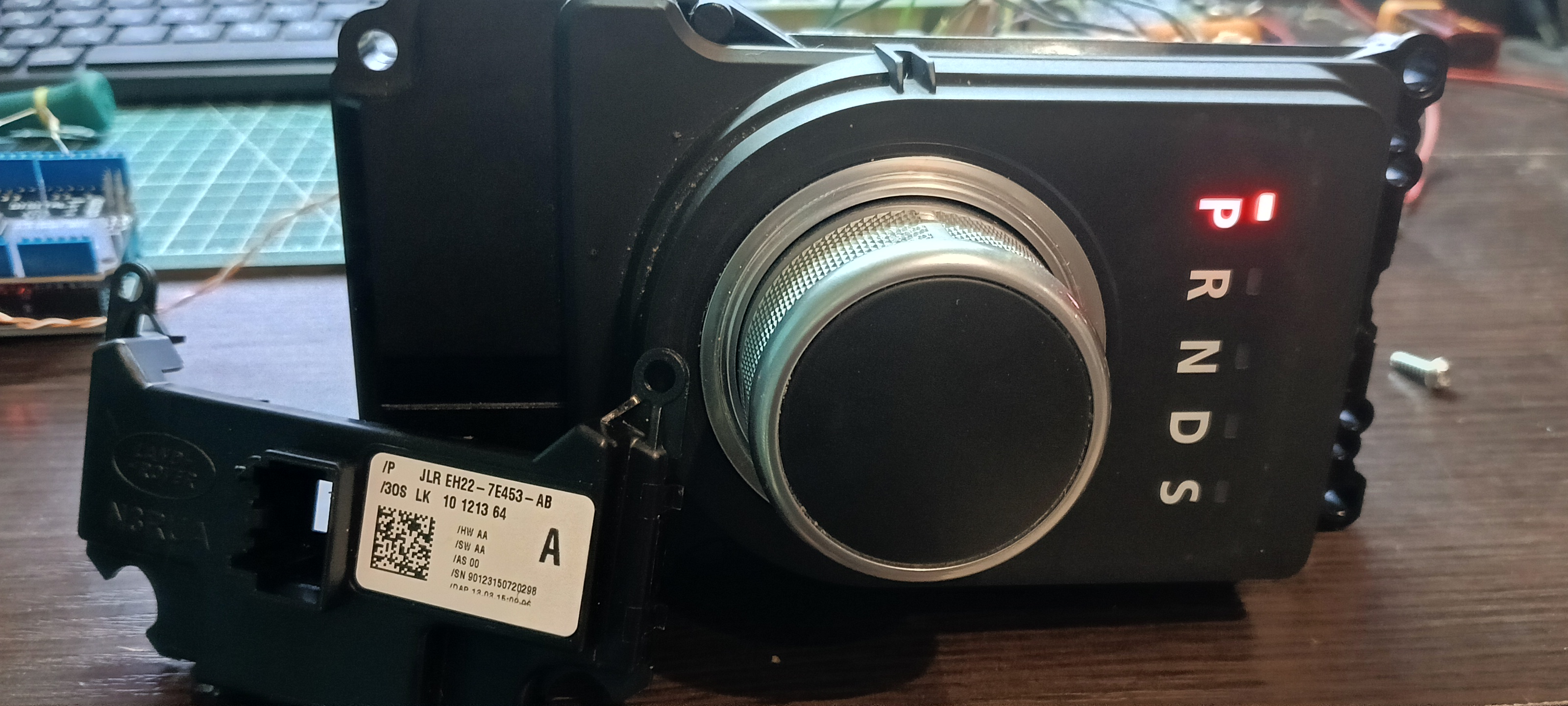

That part number looks like mine which runs on the Gen 1 canbus messages. Try that script.
Unfortunately I don't have a Nano version for my script. But it's fairly basic so you should be able to port it over, or write your own based on that or Tom's code.

VanGogh wrote: Thu Apr 06, 2023 11:14 am I'm going crazy!!! :x Bought a new GSM JLR EH22-7E453-AB.
This is a Gen1 as this is an old knob just like LRBen is using.
If you do not answer our questions and keep doing your own thing we are not going to help you.

I use MCP2515 like this. It has 120 Om builtin resisror and jamper
https://www.ebay.com/itm/404205629787?h ... BMjLPW5uph
If I measure the resistance on a сan bus without mcp 2515 and ignition, then the tester writes 41 kOhm. If you turn on the ignition, then writes 60 MΩ. If I connect to mcp 2515 with a jumper without ignition - 120 Ohm. I turn on the ignition - 0 ohm.

YEHAAAAAAA !!!! The second GSM works with Gen1 :D
Knob rotates and LEDs light up
But the first doesn't work at all (9X23- 7E453-DA)

Tomorrow I will buy another mcp2515 module and read the data between the first installation and the GSM. I'll post the log here.
VanGogh
Posts: 41
Joined: Mon Apr 03, 2023 7:33 pm
Re: can id´s 4 Gear Selector
Post by VanGogh »
Hi.
I connected another NodeMCU with mcp2515 in parallel and read data between Aruino with mcp2515 and the GSM. Attached are 2 logs from different GSM. It seems to me that the Park wire (14 pin for a 22 pin connector or 10 pin for a 12 pin connector) is not working.
Jaguar.txt
(9.55 KiB) Downloaded 968 times
LandRover.txt
(5.64 KiB) Downloaded 817 times

Hi guys. I adapted LRBen's code for Arduino Uno with CAN shield. Now everything works, but there are a few nuances. When I return the knob from the R to P position, the program crashes for a few seconds and then it works again. Sometimes the situation is the same with position S.
Could you look at the code and help me? I also don't know how to add a brake pedal to lock/unlock the knob.
A small video review of the module:
https://drive.google.com/file/d/1IpKJz6 ... sp=sharing
GSM_jaguar.ino
(2.6 KiB) Downloaded 884 times

I have now checked this code with another GSM and the knob goes up and down, but the unlock does not work
VanGogh
Posts: 41
Post by VanGogh »
LRBen wrote: Wed Jul 12, 2023 5:56 pm What do you mean by brake pedal?
Now the knob rotates freely. But in the car, it is locked and only when the brake pedal is pressed does the knob unlock. How to implement it? What data needs to be sent to the CAN bus?
