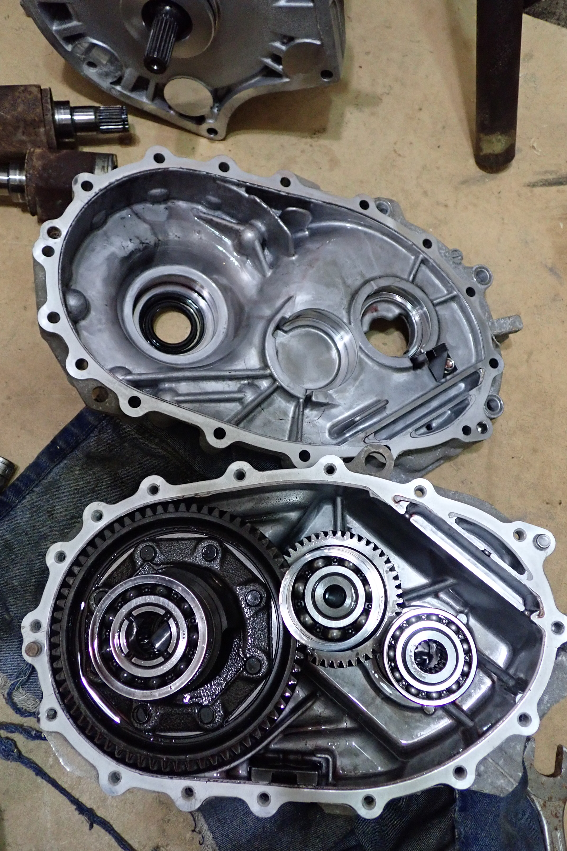

LRBen wrote: Thu Feb 11, 2021 5:56 pm Finally got this motor tuned and running on a Prius gen 2 inverter. My syncofs was 65000.
I have taken the differential apart in order to get the input sleeve the motor shaft would normally connect into. My plan with this is to get it machined and attached to the clutch hub of the gearbox. On first inspection this gear doesn't look as hardened as previous gears I have worked with. So machining should be easier.

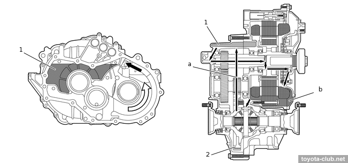

In normaly Outlander MGR orientation is - reductor at front (main gear rotate counterclockwise). If you want to mount motor in front (FWD) yo need to change orientation - reductor at rear, motor at front. If you want to use Lexus MGR you dont need change orientation - reductor is already at rear. And lubrication stay normal.
If there is your topic - Toyota MGR Transaxle - Alternative Orientations?
You will have right orientation - reductor at front

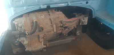

Ctwidle
Posts: 89
Joined: Wed Jan 06, 2021 9:44 pm
Been thanked: 12 times
Re: Mitsubishi Outlander rear axle
Post by Ctwidle »
Sorry about the reflection!
No electrical progress but confirmation that the motor fits neatly in the back of a 72 Super Beetle. Fixed to original VW mounts with no structural changes. Should be plenty of room for an inverter etc.
For anyone else using a Mitsubishi rear motor - make sure you get the drive shafts with it. I only want to use the inner cv joint to graft onto the VW shafts but there seems to be no stock of none oem parts and Mitsubishi quote $960 each for them ex Japan!

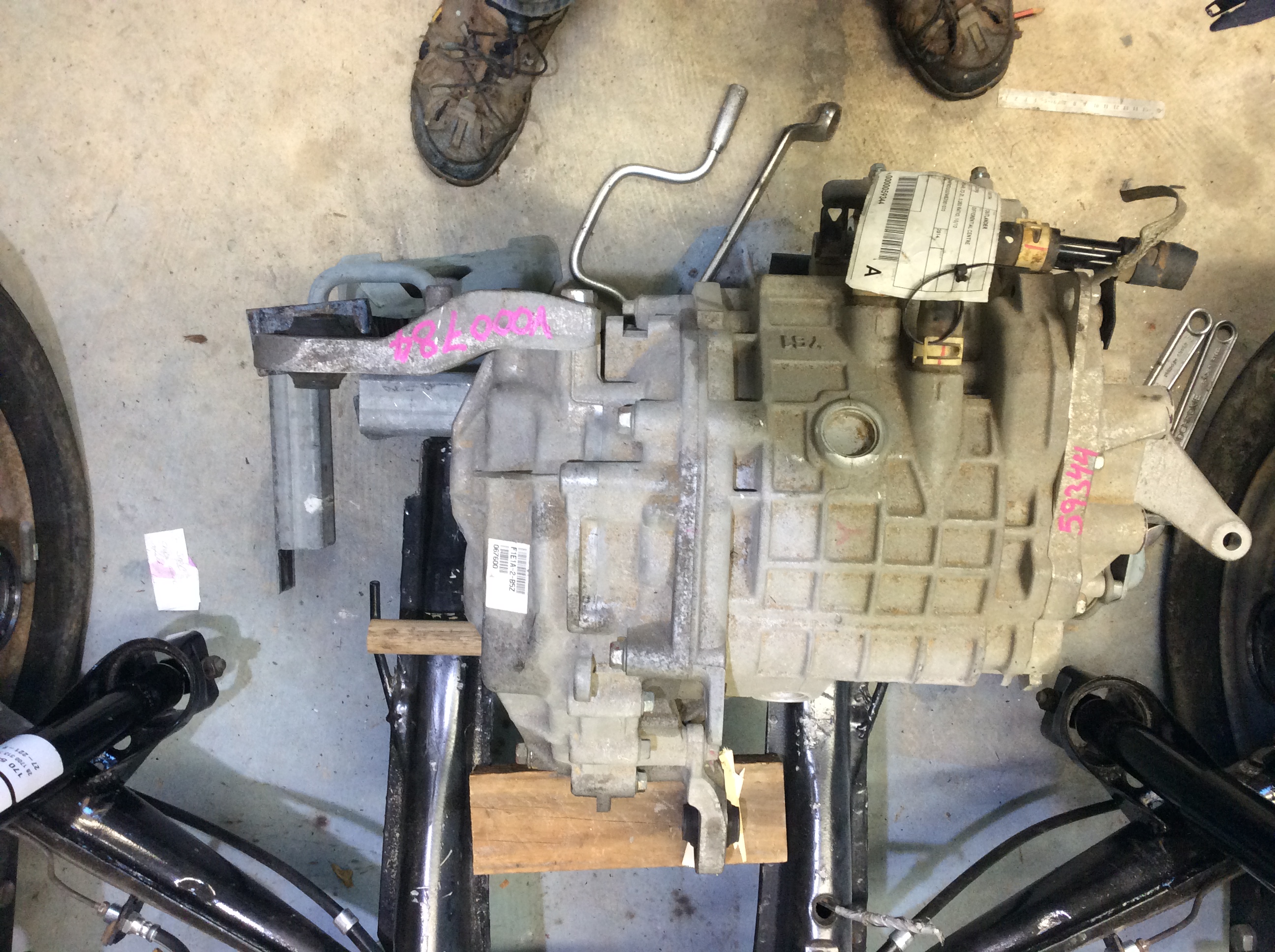

LRBen
Posts: 573
Location: Somerset, UK
Has thanked: 76 times
Been thanked: 220 times
Post by LRBen »
I did look into the inner CV joint for the rear Outlander motor when I was going to go down the same route. From memory the inner CV joints have the same part number going back to previous models of Outlander, including non-hybrid models. So you might be able to pick up a pair of second hand joints for an older model for a bit cheaper, or maybe find some pattern parts.
I'm afraid I never wrote the part number down.

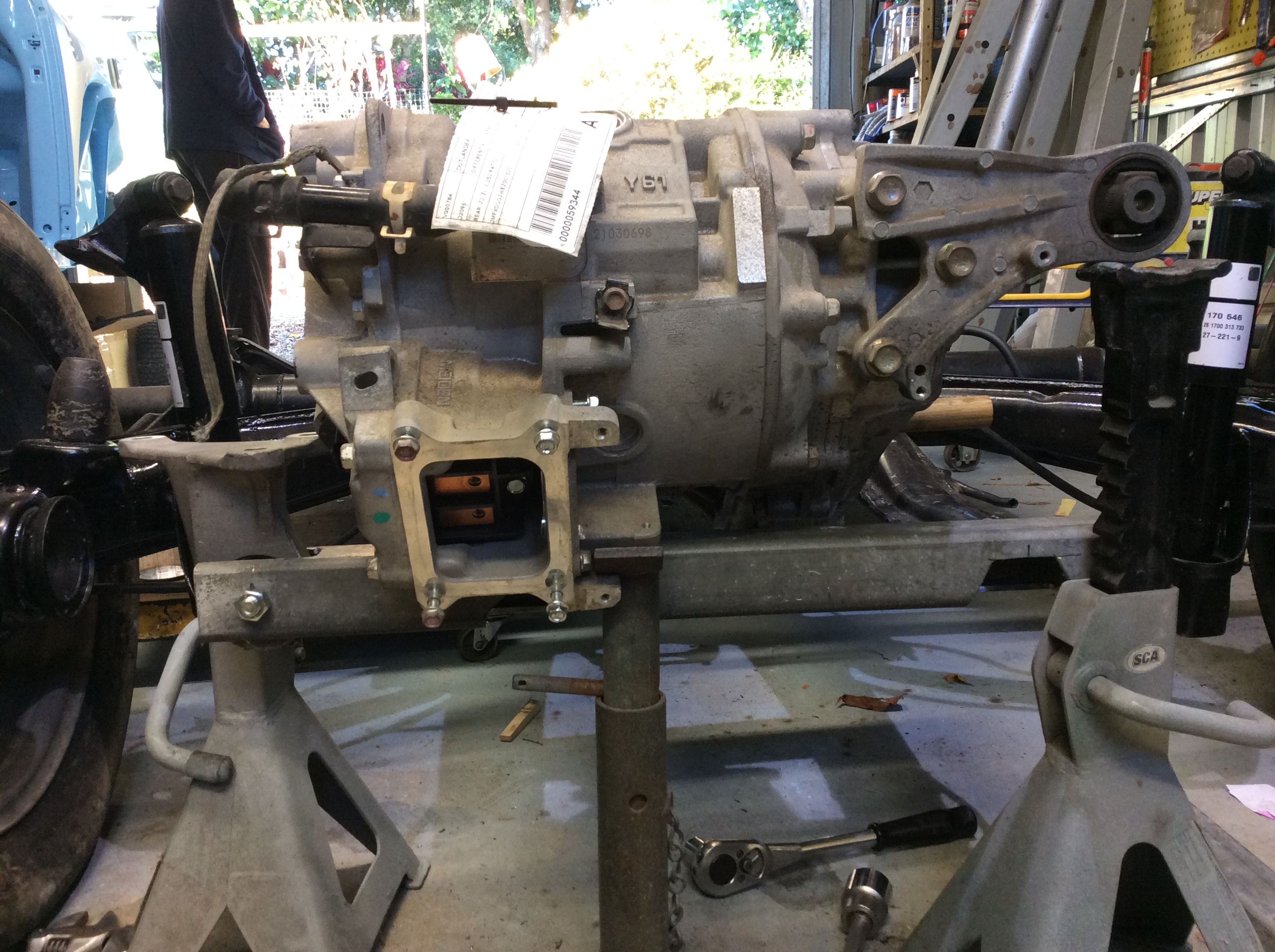

michaelh
Posts: 5
Joined: Tue Jul 14, 2020 2:43 am
Location: Sydney
Post by michaelh »
I'm hoping to be in the same position as you somewhere down the track, but my project is FWD, which will no doubt add complication!
I'd be interested to know where you found the third party axles (I'm in Sydney).
I have a part number for the third party Inner CV joint only, made by GSP: 601548 (I've attached their catalogue), but I've only found them online in the UK. There is lots of spline information in there too, which might be useful.
Michael
