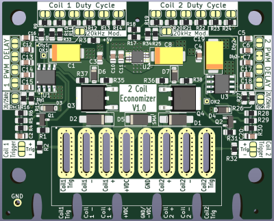

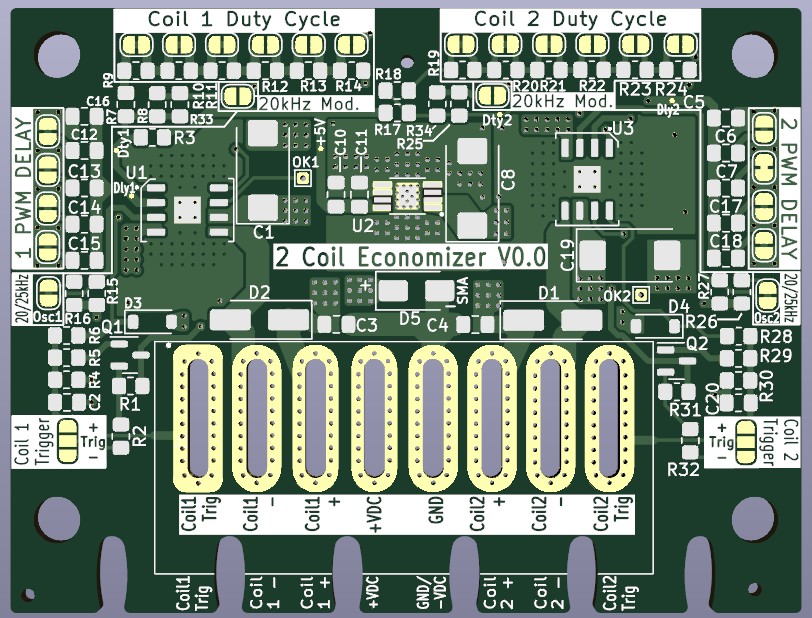

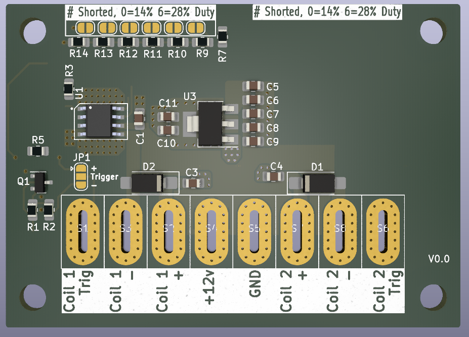

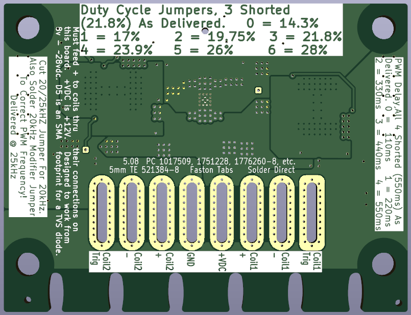

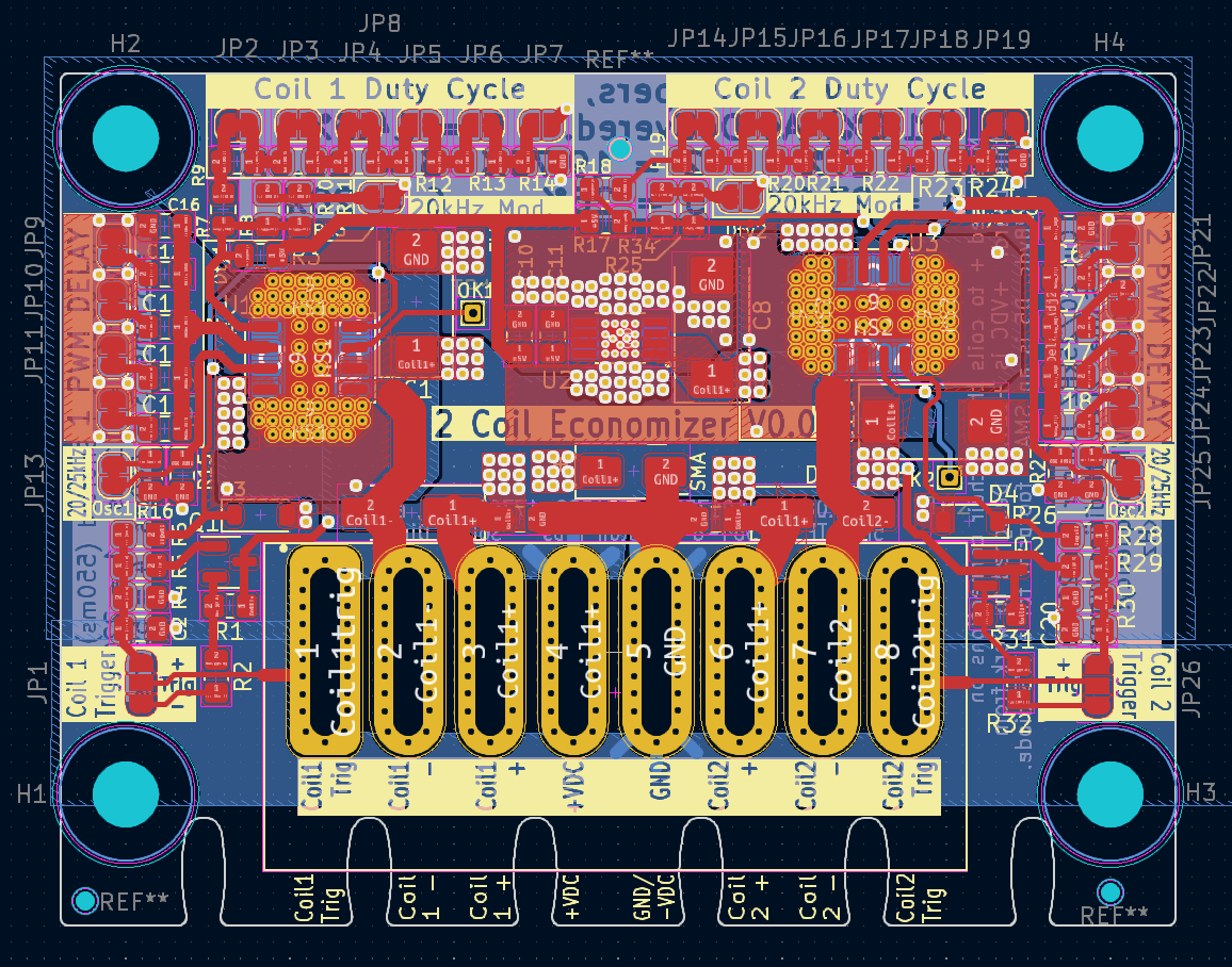

I've been slowly working on this between other things. This s what I have currently.

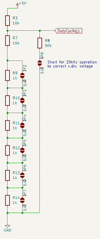

The duty cycle is selectable with solder jumpers.
0 = 14.3%
1 = 17%
2 = 19.75%
3 = 21.8%
4 = 23.9%
5 = 26%
6 = 28%
My thought is to set this up with 3 solder jumpers shorted (that can be cut to open) to default to 21.8% duty cycle. https://everycircuit.com/circuit/4973018295828480 is a simulation of the resistor stack with switches as solder jumpers.
- Anyone need more than 28% duty cycle for their contactor or any that they have seen needing more?
I'm planning to have a solder jumper for 20kHZ / 25kHz with 25kHz as default. Might be a solder jumper to cut for 20kHz as I'd prefer 25kHz as default so us sensitive people don't have to hear it.
I also have a solder jumper to short when using 20kHZ frequency that adds in a resistor across the voltage divider stack. This keep the load the same as 25kHz so the voltage and duty cycle are consistent between frequencies - according to Ti's specs in the DRV103 pdf. The switch on the bottom right switches between 20kHz and 25Khz load in the everycircuit link above.
Full on time I planned for 110ms, up to 550ms with 4 solder jumpers. Thinking to do all 4 solder jumpers as shorted by default. I cant imagine a 550ms on time will heat up / damage a contactor coil. Doing this for low voltage 12v batteries that might end up lower than 12 or 14v as most specs are written to. A car that wont engage contactors because the battery voltage is a bit low isn't ideal.
JP1 is a solder jumper to switch between + and - triggered for contactor #1. #2 will have a jumper as well.

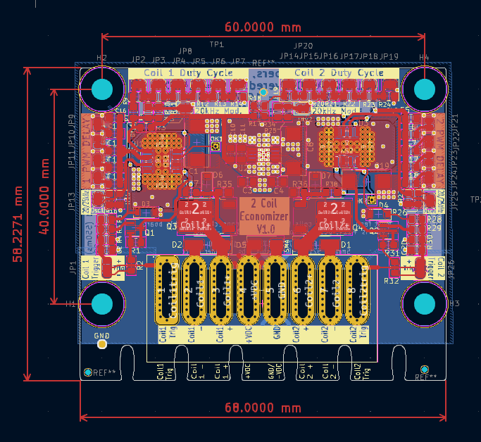

Hole size is 60mm x 40mm currently, board size is 68mmx49.
The slots will work with soldering in wires directly. They are also sized for faston solder tabs like this, Also thinking of adding some slots below the wire area to use shrink wrap over the board and wires as a strain relief.
- Any input, requests, ideas, preferences, critiques, etc?

V0.0 of this is done but not tested yet.
https://github.com/jrbe/2-Coil-Economizer-PCB
Allows different settings with solder jumpers. They are about $15USD each fully populated. You will have to pre order the drv103 chips from JLC though.
More info at github.

They solder it if you pre order it. There's a minimum qty of 5 boards from JLC. It was a bit over $70 for 5 completely populated boards, then add shipping and tax.
You can have them only populate 2 of the 5 boards as an assembly option but the other 3 are component costs only, about $3 each, you don't save much.
Don't forget, not proven out yet, needs testing & maybe troubleshooting.

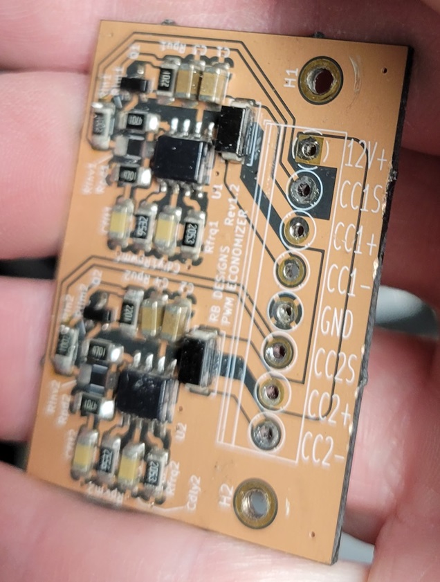

Re: DIY Economiser for OEM Contactors

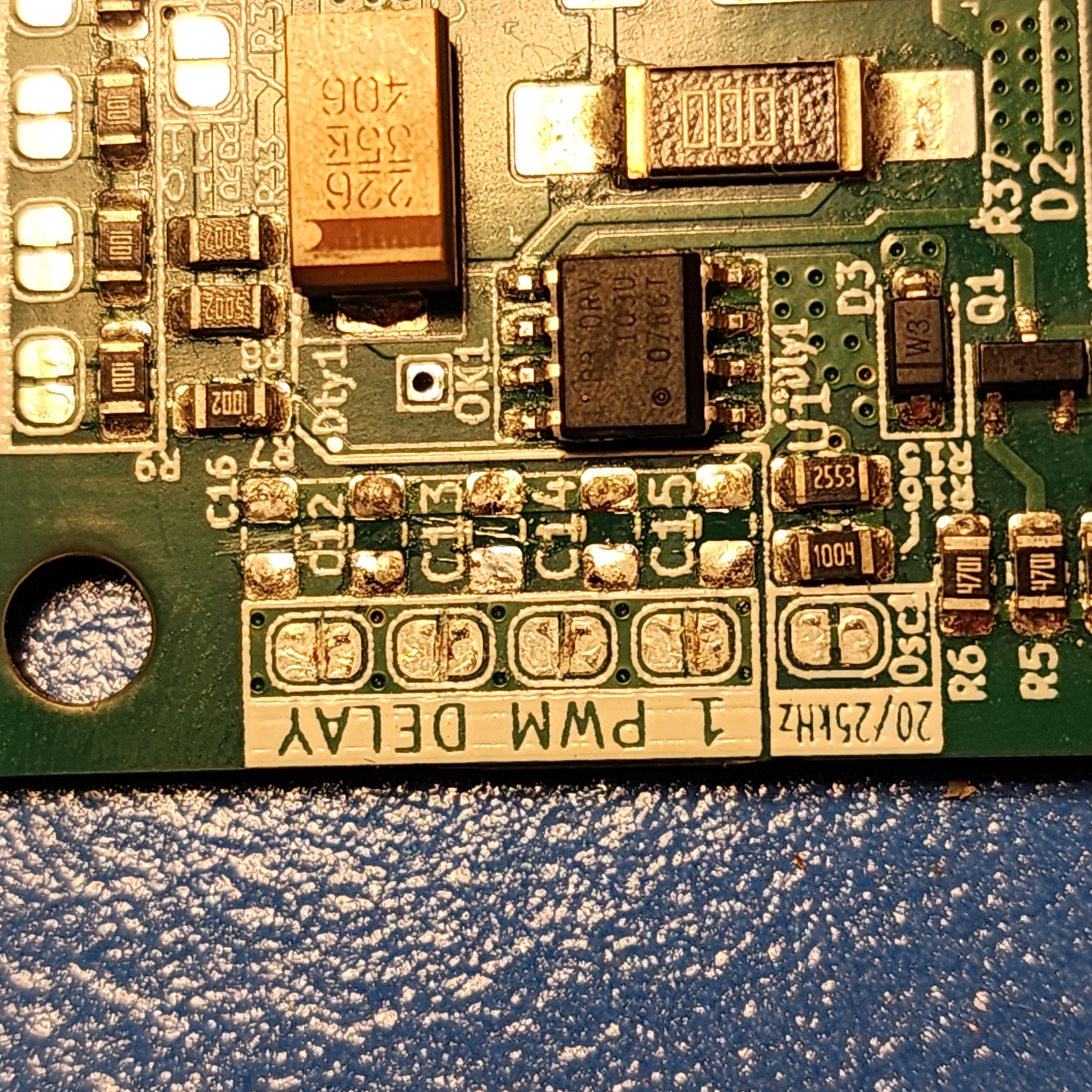

Yeah, I have a copy of the previous design in my car and it's working. I don't have a lot of testing hours on it yet, but so far so good with the 11ohm contactors.
(This was taken when I removed it from the car to replace the screw terminal with a spring terminal)
The DRV103s I have are all non-heatsink version (all that was available at the time I ordered them).
I do have two more unpopulated PCBs and a handful of components sitting around, will see if I can cobble something together. I'd also be happy to mail you one of the contactors if you'd like to try it with your new boards when they come in?

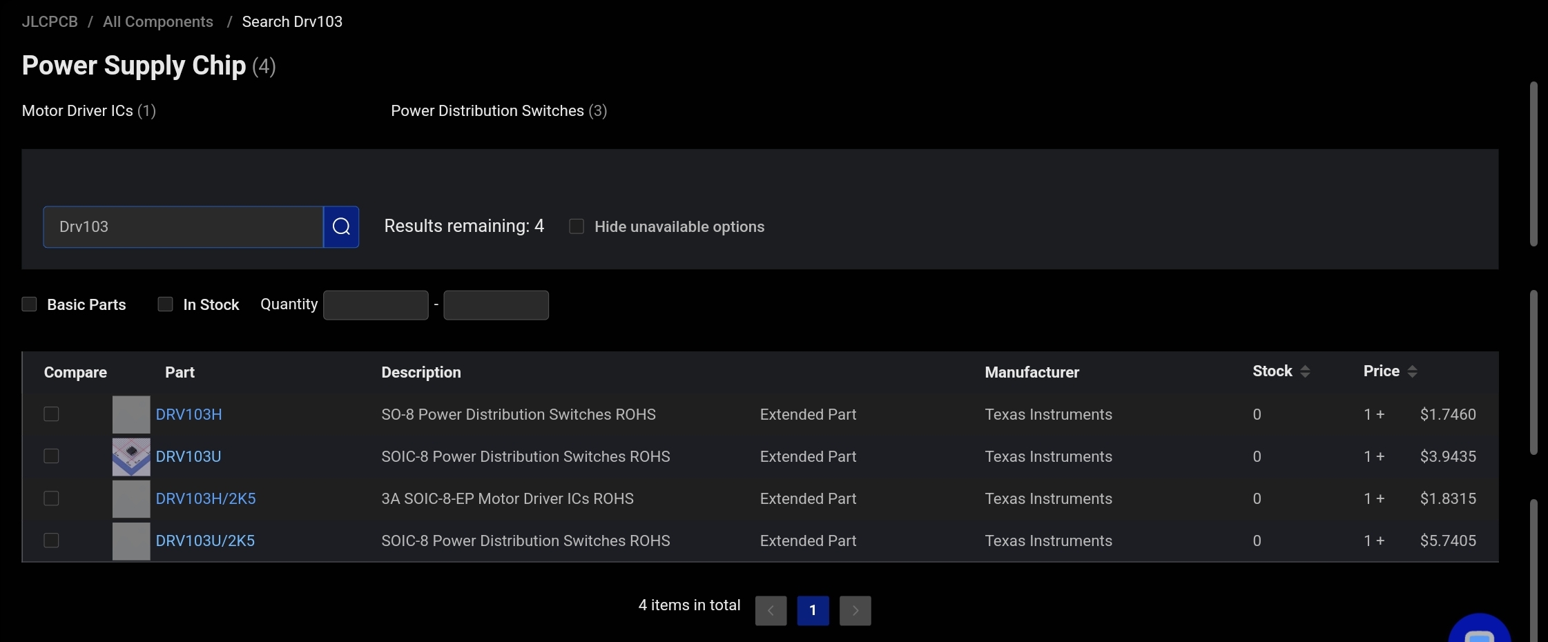

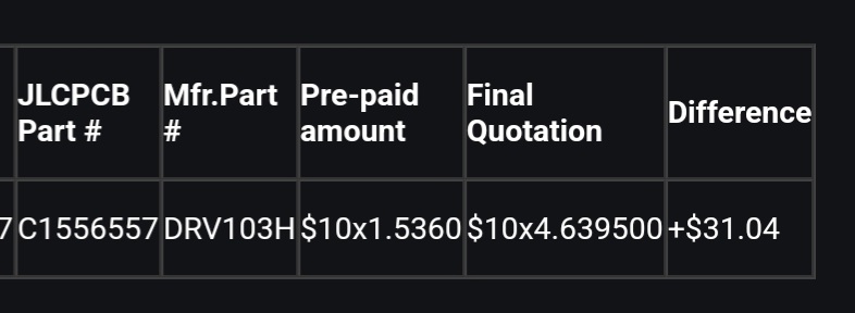

JLC just sent me an updated invoice for the DRV103H ICs I pre-ordered. They are about 3x the cost from what they were supposed to be.
I requested a quote for the 4 variants of this IC to be able to make a better informed decision on which to use in this design. It's not a show stopper but changes things some.
jrbe
- Posts: 766
- Has thanked: 360 times
- Been thanked: 249 times
I'm not sure why they assigned 4 part numbers, it's 2 variants with different assembly feed packaging...and screwed up pricing.
$2.47 for the 1.5 amp version without a heatsink.
$4.64 for the 3 amp heatsink version.
The heatsink on the DRV103 is required to be separate from the ground plane. It looks like the heatsink version could let out a bunch of emi.

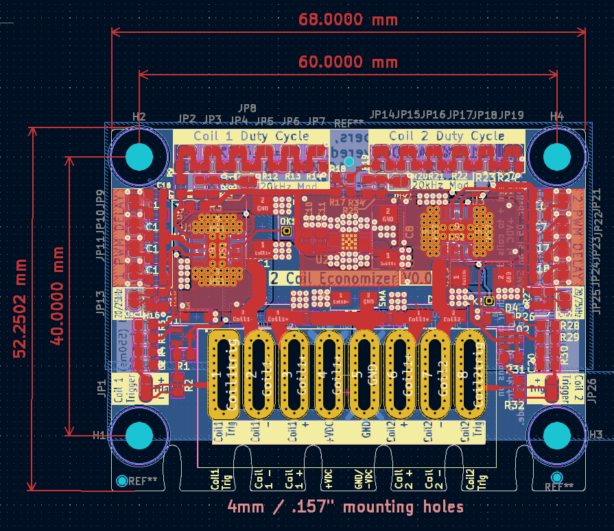

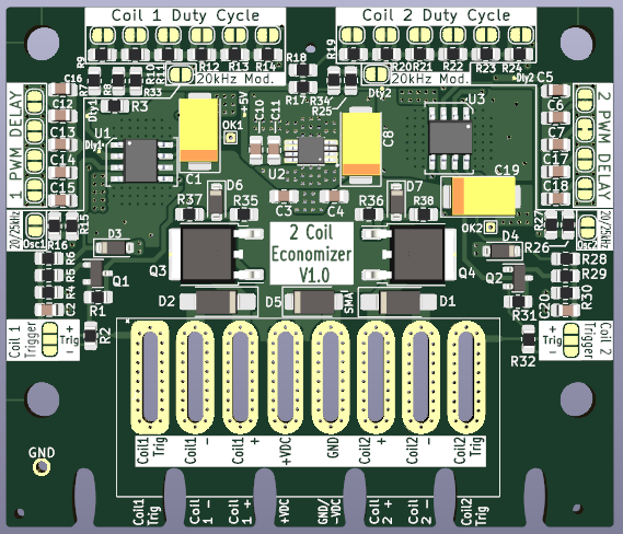

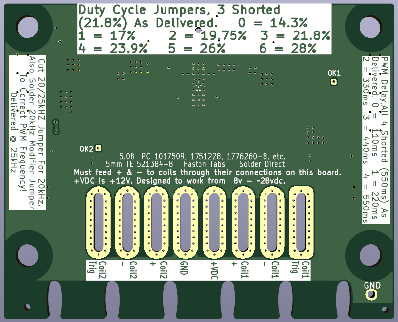

I did the design with P mosfets. I didn't fully work through the gate capacitance / resistor simulation but got it close. I'm planning on adding through hole solder resistor footprints if the resistors need to be adjusted.
I'm planning on using the non heatsink DRV103 as it's only turning on the p mosfet. I think there will be less emi as well going this direction.
jrbe
- Posts: 766
This is the simulation I was doing to find reasonable resistors for the gate as well as for testing the zener to protect the p mosfet.
https://everycircuit.com/circuit/4697508156276736
The green trace there is watching VGS.
There's a switch to swap between 12v & 24v.
This runs at 25kHz. Its looking like a 100ohm resistor to the DRV103 output and a 3k pull up to +VDC, along with the zener to keep VGS in check. Everycircuit has some uncommon settings for mosfets that I'm not familiar with so Its hard to know what specs they are accounting for.
I added a switch with a capacitor to add gate capacitance in to the simulation, but not sure if there is any in the p mosfet already..
I was thinking to leave the zeners out for 12v usage but its cheap protection using this in a noisy / spikey automotive use. It should also allow it to be used in 24v systems without other changes.
The board grew a bit adding the p mosfets. I also need to get rid of the heatsinks and make those back to ground planes. While I do that I'm going to try to shorten up the traces to the jumpers for the different settings. Its still pretty small and should be able to drive 10a coils for pull in. The p mosfet I'm planning is a Vishay SUD50P10-43L-E3 / C913430 / https://jlcpcb.com/partdetail/VishayInt ... E3/C913430
Its a 100v, 20v VGS, .043 ohm RDS on, rated for over 30 amps, & $1.57 ea. They are common and fairly cost effective. So swapping to the p mosfets and the 1.5a DRV103's it should be cheaper and 3x more powerful than the 3a version DRV103's.
Input, feedback, schematic review, etc. are all appreciated.
I was going to only spend 30 min on it but got stuck in it.
Getting rid of the heatsink planes made a big difference. I was able to shift things around and tighten up the traces for frequency and pwm delay a lot. The ground plane is almost completely solid except for 1 duty cycle reference voltage trace that had to hop over another.
Board is back down to 55mm tall x 68mm wide.
I have a bit more time to do the gerbers & fabrication files still.

I just ordered a batch of 5. The DRV103U IC's were pre-ordered already & in. Should arrive in about 2 weeks.
Price went up, they're about $30 each with shipping and the pre-ordered IC costs.
These arrived a couple weeks ago. The strain relief tabs worked out well.
Seems the transistor isn't working as expected, I haven't had time to dig into it though. I'm behind on my work and likely won't get to this for a few weeks.

I'm working on adding this v1.1 to GitHub now and adding where it is / things I found with it. I'll post here once it's up.
I still haven't had the time to go through this and keep getting pulled into different things. I can mail you a v1.1 board if you're willing and able to do the troubleshooting. PM me if you want 1. This goes for anyone else willing and able to help too (for the 4 boards I have.) This was done in KiCad 7.

I finished adding V1.1 to github. https://github.com/jrbe/2-Coil-Economizer-PCB
Please feel free to ask any questions you have.
I spent 5 hours on this today. I think I got counterfeit DRV103's on my boards from JLC.
Or maybe that odd dot is not pin 1?..
I think i also got counterfeit Ti ic's on another board from them too, going to email them about it.
Testing without a load on the DRV103 and its acting odd and just like the other channel that i tested both with and without a load.
Both with and without load on the DRV103 the delay leg never goes above 2.6 v (only gets to 2.2v) so PWM mode never starts. Both ic's act exactly the same. I removed all of the delay capacitors thinking one was bad and pulling the delay pin down. But with them all removed so its just the IC leg and the trace its the same resistance on the delay pin to ground as it was with the caps on the board.
My pnp circuit is also bad. It doesn't work. I'll likely swap to a logic gate instead to allow + or - triggers.
For the cost of a DRV103 and what seems to be a counterfeit issue or at least a quality issue I'm thinking to swap to a 556 timer for each channel. I am very deep into a project currently though and won't be able to do much with this for a while.
