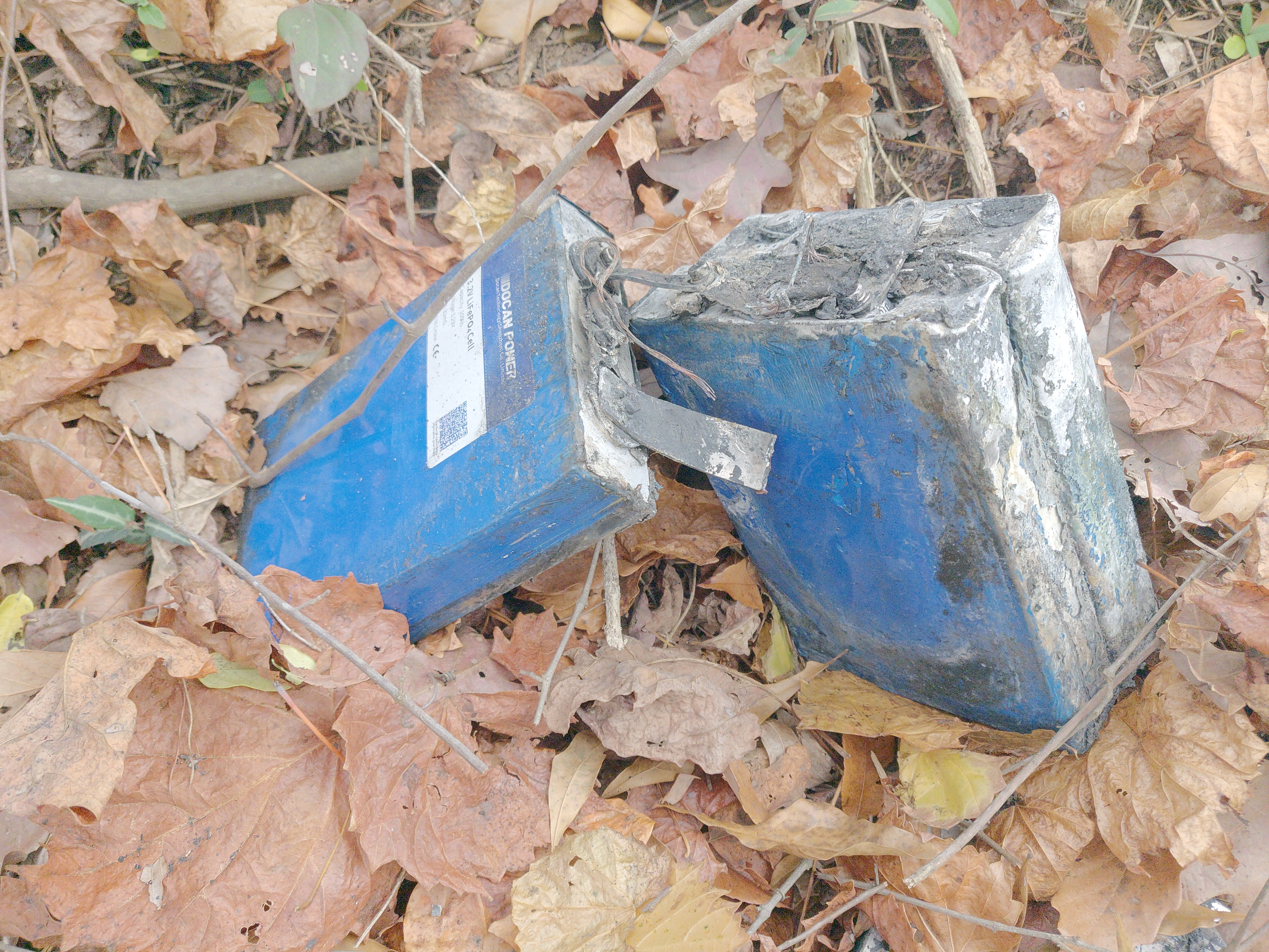

Quick question for people more familiar with the settings on the Openinverter board. I used the default parameters posted here:
https://openinverter.org/parameters/view.html?id=15
Is possible that I drew too much power from my 105Ah batteries? and damaged them. Which parameter I should have changed to limit the amps Draw?
Also where I can find for future the explanation of the parameters.

Parameters are addressed here:Proton wrote: ↑Wed Nov 15, 2023 1:26 am Quick question for people more familiar with the settings on the Openinverter board. I used the default parameters posted here:
Derating
idcmax A 5000.00
idcmin A -5000.00
iacmax A 800.00
https://openinverter.org/wiki/Parameters
It seems you have set DC current to 5000A
And AC motor current at 800A which is more rational since DC current is reflected by the ramp of AC current. Did you drive a long time at high speed?
What was the DC current displayed on your dash?
I dont really think 100Ah cells are harmed by short spurts of less than 3C. However if it would be prolonged 3C drain that can cause cell damage over time. But that would still be overtime. You would see cell swelling and that sweet smell of acetone. However the mechanical swelling by itself wouldnt cause immediate damage. I am still convinced you had a discharge from one cell casing to another. Which would make sense if cells would swell and rub thin plastic off betwenn them...

I had few short accelerations no more that 5 seconds.
More plausible is that the cases touched. I guess the need to be isolated. I have in the house a battery for my solar system and never had issues, so did not think that that could be and issue here. live and learn.

Like marty says it depends also on the arrangement. If you've only got a single row of batteries you may get away with it as 3V are not going to arc anywhere. If you have two rows next to each other maybe you have 100V between neighbouring cells. Plus in the car you have vibration.
After this experience you might want to add isolation between the cells of your house battery as well....

Ufff... you use liion battery in a house assembled without separators? Do you use metal case for that?Proton wrote: ↑Wed Nov 15, 2023 2:56 pm I had few short accelerations no more that 5 seconds.
I would advise you revisit your house battery and put some spacers in between cells that are on different potential. Material like polycarbonat, pv plastic or black rubber is good. But let it come 5mm higher than battery case so you dont get shootrough
Cells in parallel are ok...

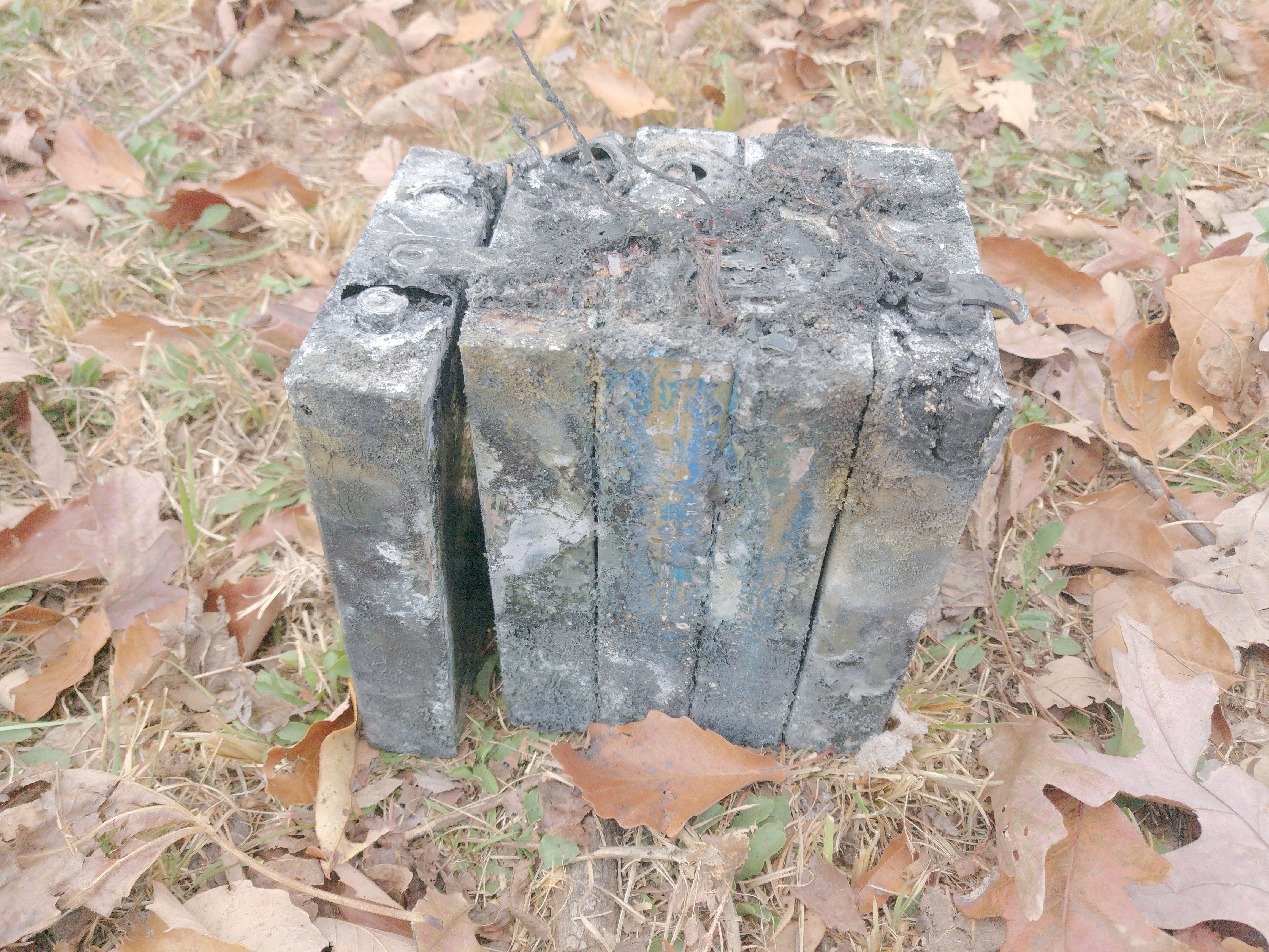

These were LiFePo4. I chose them over LiIon because they do not catch on fire.
- EV_Builder
- Posts: 1205
- Location: The Netherlands
- Been thanked: 37 times
That's what puzzled me the most about this.
You had some short some where, some how... with NMC this would have gone worse for sure...
- Proton
- Posts: 303
- Location: Georgia/US
- Has thanked: 184 times
- Been thanked: 43 times
they had plywood on top and a bunch of balancing cables for BMS. 112 small cables. If they caught on fire they all shorted out setting on fire the wood on top and all plastic around.EV_Builder wrote: ↑Wed Nov 15, 2023 6:50 pm That's what puzzled me the most about this.
lesson learned:
1. no wood box
2. be careful how you route the BMS cables.
3. leave space between batteries and put some separation material between the batteries.
In my case I wanted to make them fit in that space.
***** And I want to mention THE BATTERIES DID NOT BURN. but they got destroyed.

Oh wow. Well that's good in the bad that the LFP claim of "does (hardly ever) not burn" remains.
Maybe lesson 4: have a fire extinguisher. Good enough for a wood & plastic fire

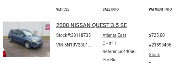

https://www.iaai.com/vehicledetail/PS~3 ... S~12072023
Found another one same year. Learned how to bid online.
on mine the front windshield was cracked and had one headlight broke. if I add all that and few other things I had to fix on mine, this comes almost free.
Now I will take it slower and anyway I do not have batteries. I have to figure out that too.

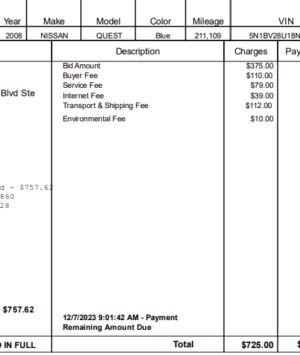

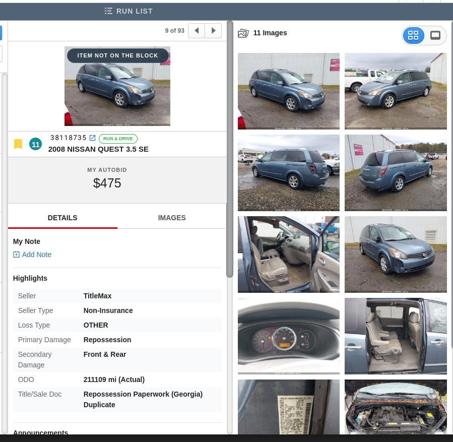

I placed an auto pre-bid of $475. I won the pre-bid and when the bidding started I won the car automatically because the company that was selling the car needed to get out of this car only $375 I think
I did not know this and I paid $100 more. Next time I know and put a lower pre-bid.
the price there is after all taxes and shipping. Shipping to my house is $112.

I guess they only charged me $375. It shows my max Auto-bid there. I think the "reserve" was met at $375 and there it stooped since nobody else outbid me.
They let you get in and see the cars every Wednesday, so I went there 2 weeks ago and saw the car. just to make sure.
