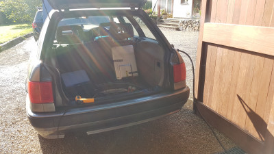

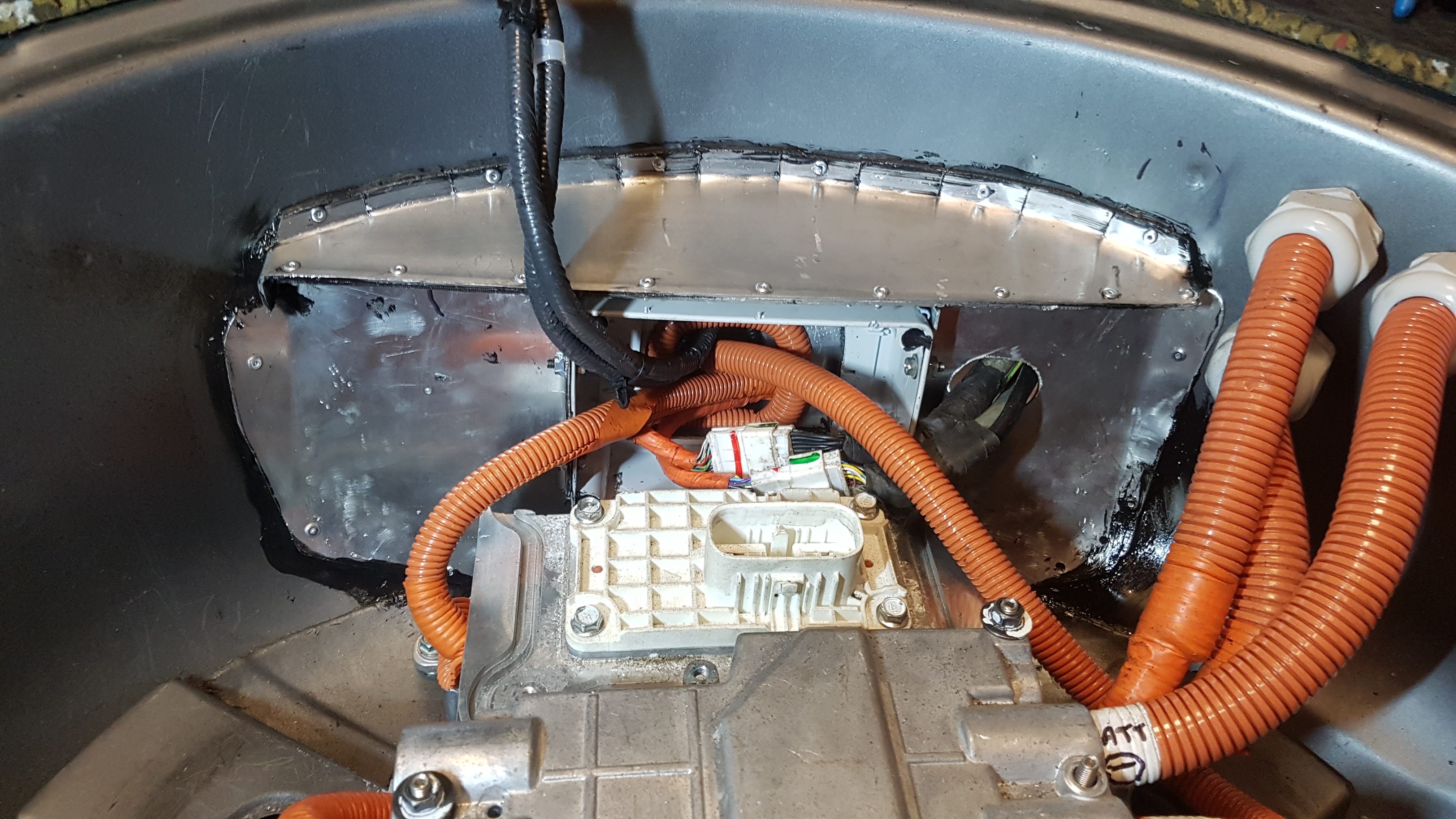

Ok, update time.

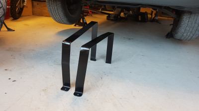

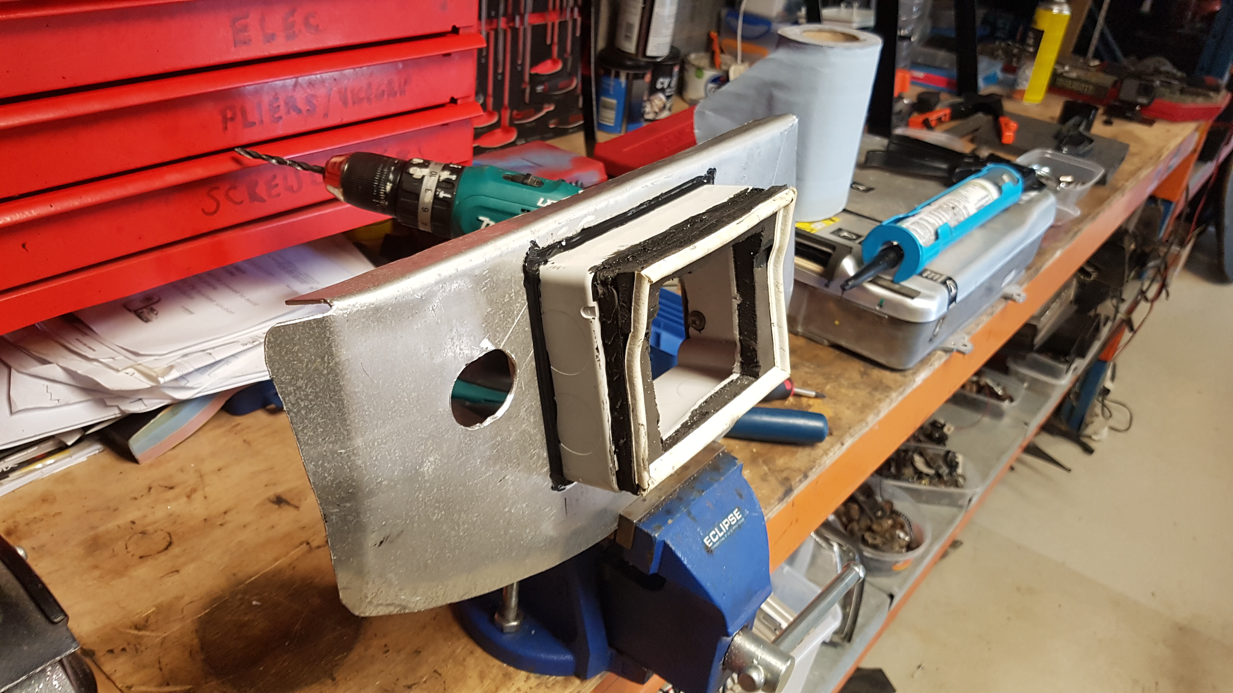

The one job I kept putting off... well two. Drop the rear pack and get it seated with no movement, bond EVA foam to point of contact locations between pack and chassis rails to help, paint the battery straps and seal the interface between pack and spare wheel well. Easy!! Ha! When it was all complete, I was well happy though. The pack now sits snuggly where the petrol tank used to sit. No movement. The boot/pack interface was made from a electrical box and some more aluminium fabrication. Main aim here was to seal the void between the hole in the battery box and the boot space but making it servicable. Now, If I need to drop the pack, I can do just that. I know its a bit of a bodge but, If I had a better budget (reminder... I have none left
) I would have fitted nice and shiny HV plugs and sockets...ooooh.... shiny!
I do still have a bit of a gap where the BMS wires come in but, that's for another day... when I drop the pack and swap the BMS I think (I know) has one or two fried chips. No dip though....
Next up, the decision to run coolant front to rear. Frowned upon, possibly but were not dealing with ICE temperatures. I did ponder having a mini loop for the charger here in the back with associated rad where the rear silencer used to be but, I thought I would try this first. I also added a 2nd aux pump to run while charging separate from the main pump up front. 1st pump (Golf) I fitted rattled... bin. 2nd pump (BMW 3 series) stopped working... bin. 3rd pump 5 series.... annnnnd breath. We are good. The breakers yard were great though. Ended up with a far superior part then I originally I paid for

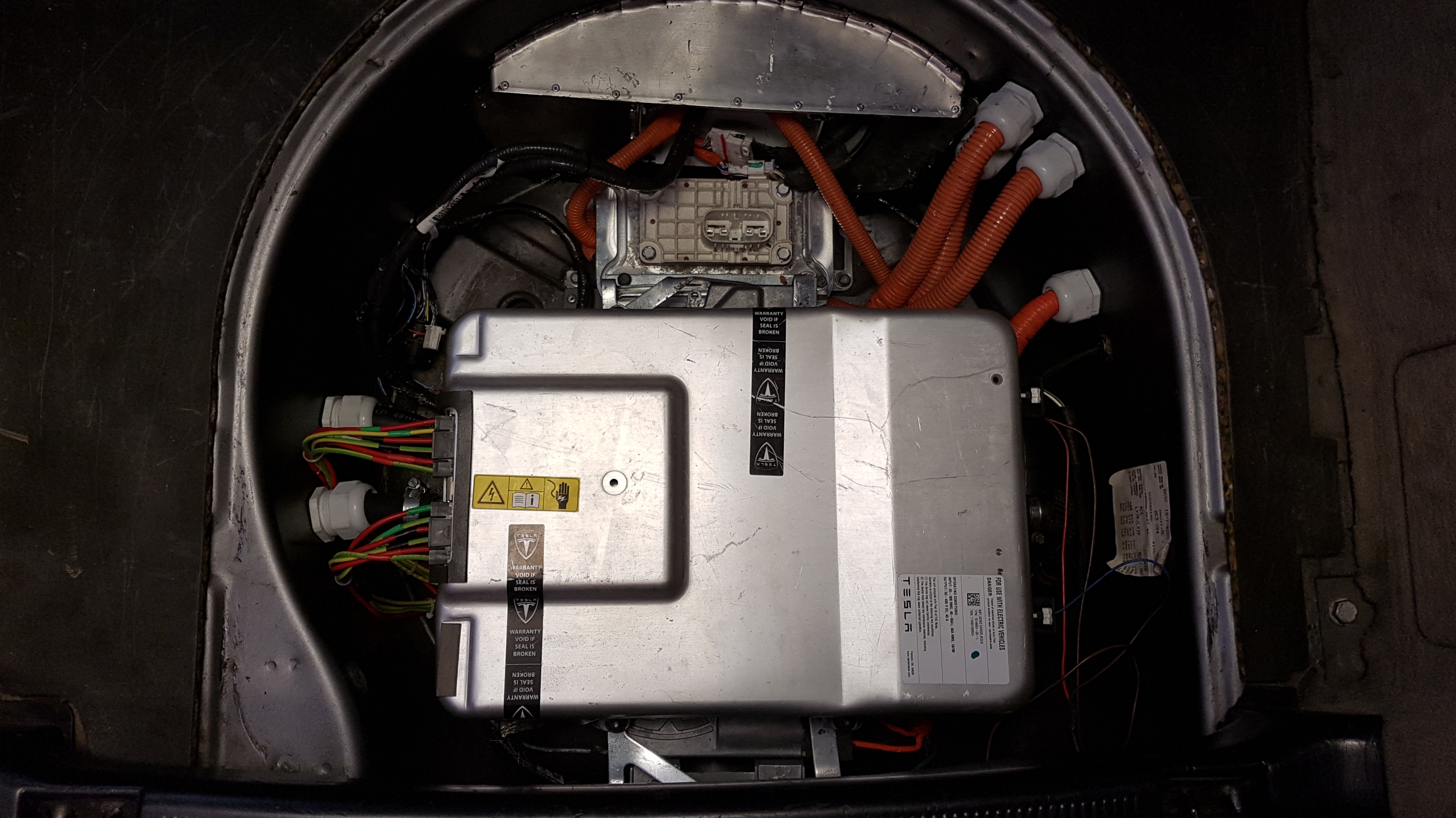

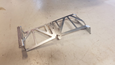

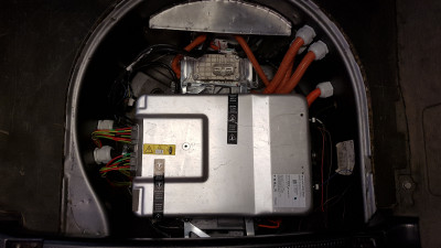

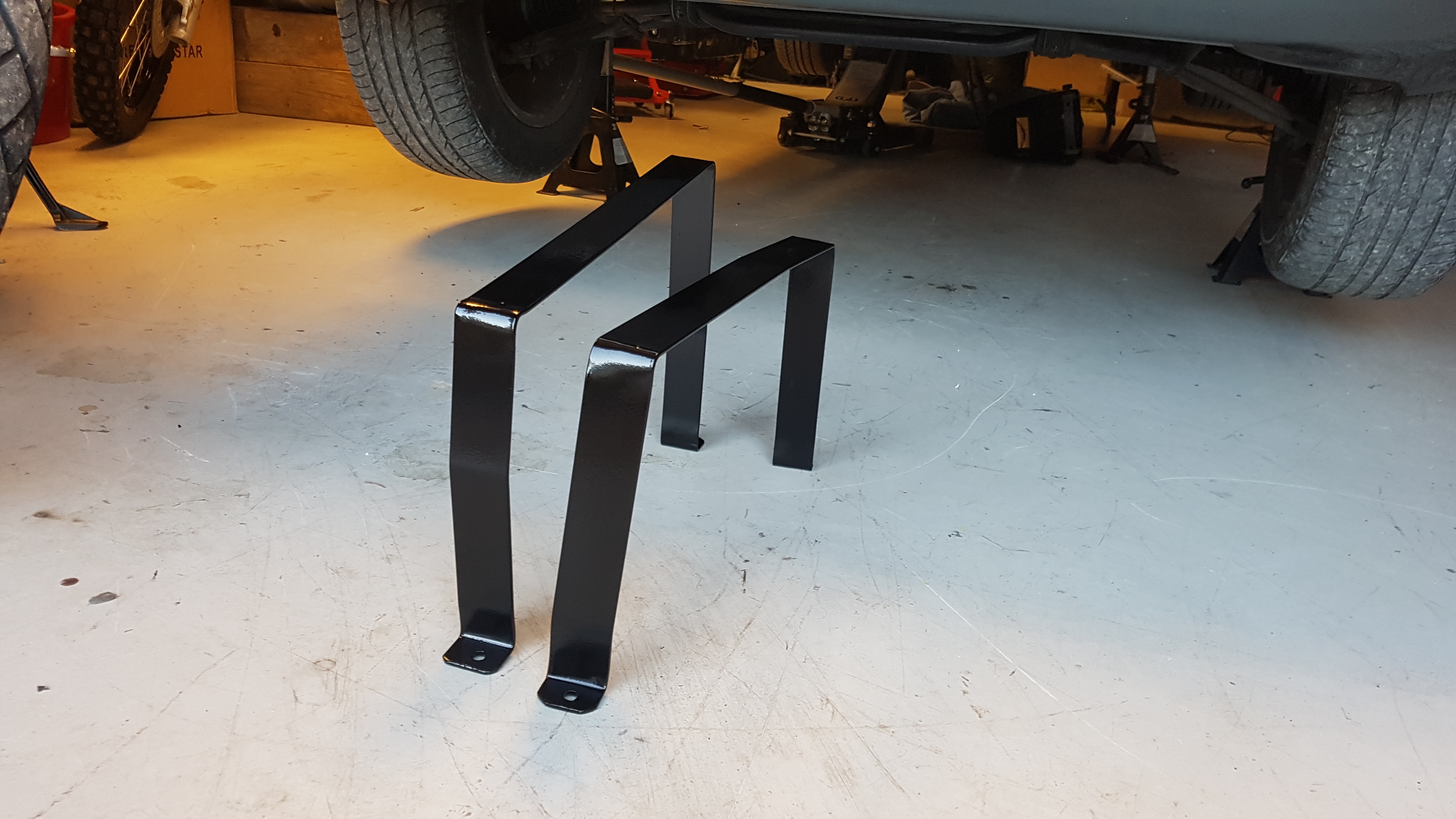

So, Tesla HVJB in. Plumbing in. Batt pack in. Next up, how to fix the charger in place. Ladies and gents, please say hello again to upcyled Leaf battery pack parts! Yes. They are 2 pack module end plates, chopped, bent and welded to form... a Tesla Gen 2 charger chassis and voila! Here it is in all its glory.
Up front, I have tidied up all the loose signalling wiring and with the help of Kevin, worked out my brain block of how to enable the DC/DC after main contactor.

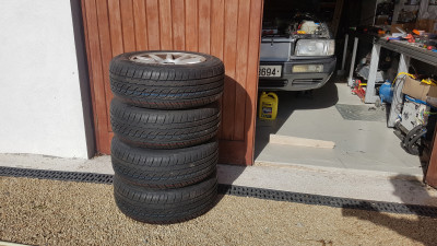

To get ready for the upcoming NCT (MOT) I needed new tyres and my bro stepped up and made a donation. Thanks man!
All wired up, we set up for the first charge. I have put a bit of detail in the Tesla Charger thread but, all went fine. I have it kind of manual at the mo. I flick a switch in the boot which turns on the charger and pump then I plug the J1772 into the port. I kept the charge slow at first, around 1.2kW to monitor the cooling effect of my setup. I bumped it up to 3.4kW for a while and found the temps raised a good bot to ~65 degrees on the 3 x phase modules, 35 deg on the casing and 25 deg on the output flow. I played around with the cooling setup again today, recharged the coolant system with a venturi pressure fill system and today, the flow/return barely went past 15deg after an hour. One thing I did notice and that I will need to amend is the 12v supply. The pump running after 3 hours finally drops below 11v and then the charger starts to flick on/off ending the session. WIll need to look at some others setup to see how to overcome this on long slow charging sessions.
Now back on its wheels and pretty much there, I had the auto engineer call by for the final sign off. After an hour of looking top to bottom, he gave it a thumbs up! Delighted! I swear... it was like a final exam. I was bricking it before he came to look it over. Nothing to worry about in the end. Gave it full marks from a build perspective. Done!
Last thing though to get ready for the NCT is the brakes. If you remember, I had the TRW ps pump feeding the steering and hydraulic brake accumulator (bomb) used in Audi's from about 88' to '95. They went back to regular vac servo boost much like the rest of the world. Well, there has been very little in the way of any brake boost, unless you turn the wheel at the same time... So, as luck would have it a former New Electric course attendee who knows his brake systems came to have a look and after a number of hours, we concluded... swap it out for the 10" vacuum servo from the same era, a vac pump from one of many VW/Audi/BMW's of any time, 3 chamber vacuum reservoir and associated valves, bits and bobs. Ah well... I would like brakes so, I'll haggle with the breakers to see what I can come up with. If anyone though does have a '95 Audi A6 C4 lying about, let me know! PN# 4A0612105P

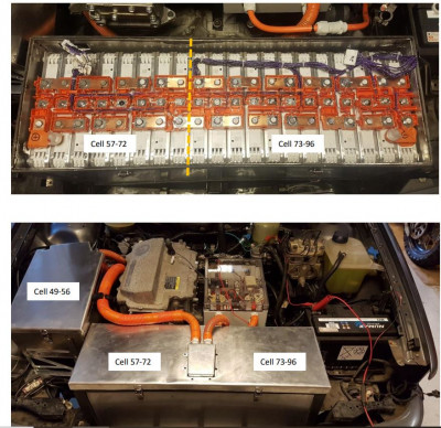

SO, while I wait for the motor tax office to make up their mind about reclassification to an ev (at this point, it is an exercise in me proving in the form of confirmation from Audi main dealers that of course they will not sign off and certify Japanese and Wexford parts in one of their marques... ) and waiting for the new brake boost system to arrive, I have been investigating a little issue surrounding the Leaf BMS.

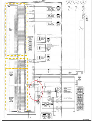

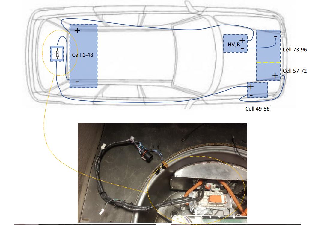

If you will remember, I decided to stick with the Leaf BMS as the layout I was going for would enable me to retain the voltage tap layout with the addition of 2 x BMS adapter cables from the front pack to the rear, linking up to the main unit back there. I painstakingly picked apart the Left and RIght hand 24 modules and associated BMS wiring and rearranged in the 20 modules up front and the 4 in the mini pack where the airbox used to be.
During this process of wiring up the pins in the plugs... well... let's just say there might have been a little short between two pins. A second of a spark and a facepalm. Thought nothing of it until I came to plug it all together and attach the Packsniffer 2 from Wolftronix which had originally given me 93.7% Health and 50% SOC from this 2015 24kWh pack. Well now, it's giving me very different results!

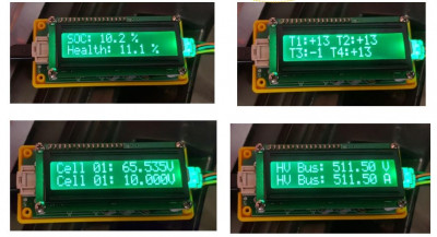

So, here is the layout, Packsniffer 2 results and Pack Schematic with broken orange boxes showing the break up of the modules around the car I packaged all this detail together and contacted Wolf himself. He had been really helpful in the past getting me setup and in turn, me testing some things out for him to create a new version of the firmware.
So here is his bit of insight. He identified that the 511V = 0x1FF in hex... So he reckons my BMS no longer has a working LIN bus, highly likely due to either A: that little issue I had or B: a greater issue in the 'mini pack' which I rearranged a number of times has resulted in a wiring mistake more than likely damaged one (or more) of the balance/monitor chips.
Therefore, I have to embrace the fact, I need drain coolant system, remove charger, disconnect the hv cables to allow me to to drop the rear pack, prise it open and, take the BMS out, investigate and hopefully, using the locations of the parts that died, identify the point where the voltage taps are mixed up
I have already decided to rewire the BMS so it sits in the spare wheel well for easy access next time.
So, the call goes out... does anyone have Leaf BMS they could sell me?? Thanks all!
