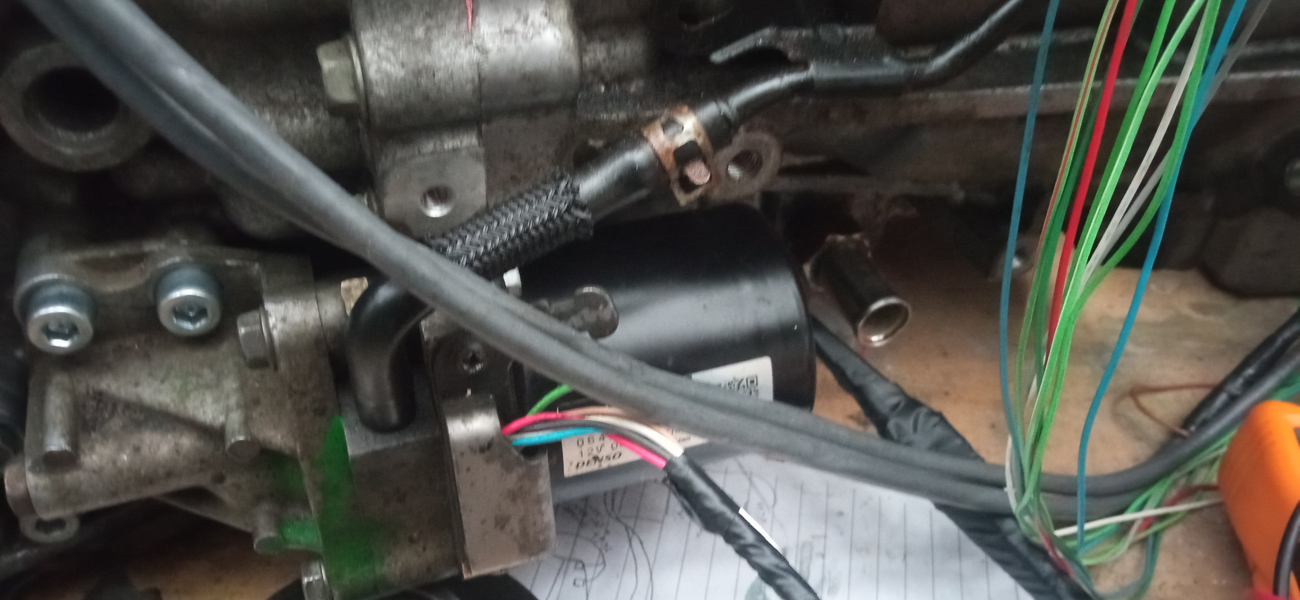

Looking at your oil pump picture, the black hose from the pump, is not on the pump I have, as I recall, when installed last year... perhaps an oil cooler was not used on the original car system that I have used.. I'll check it out.

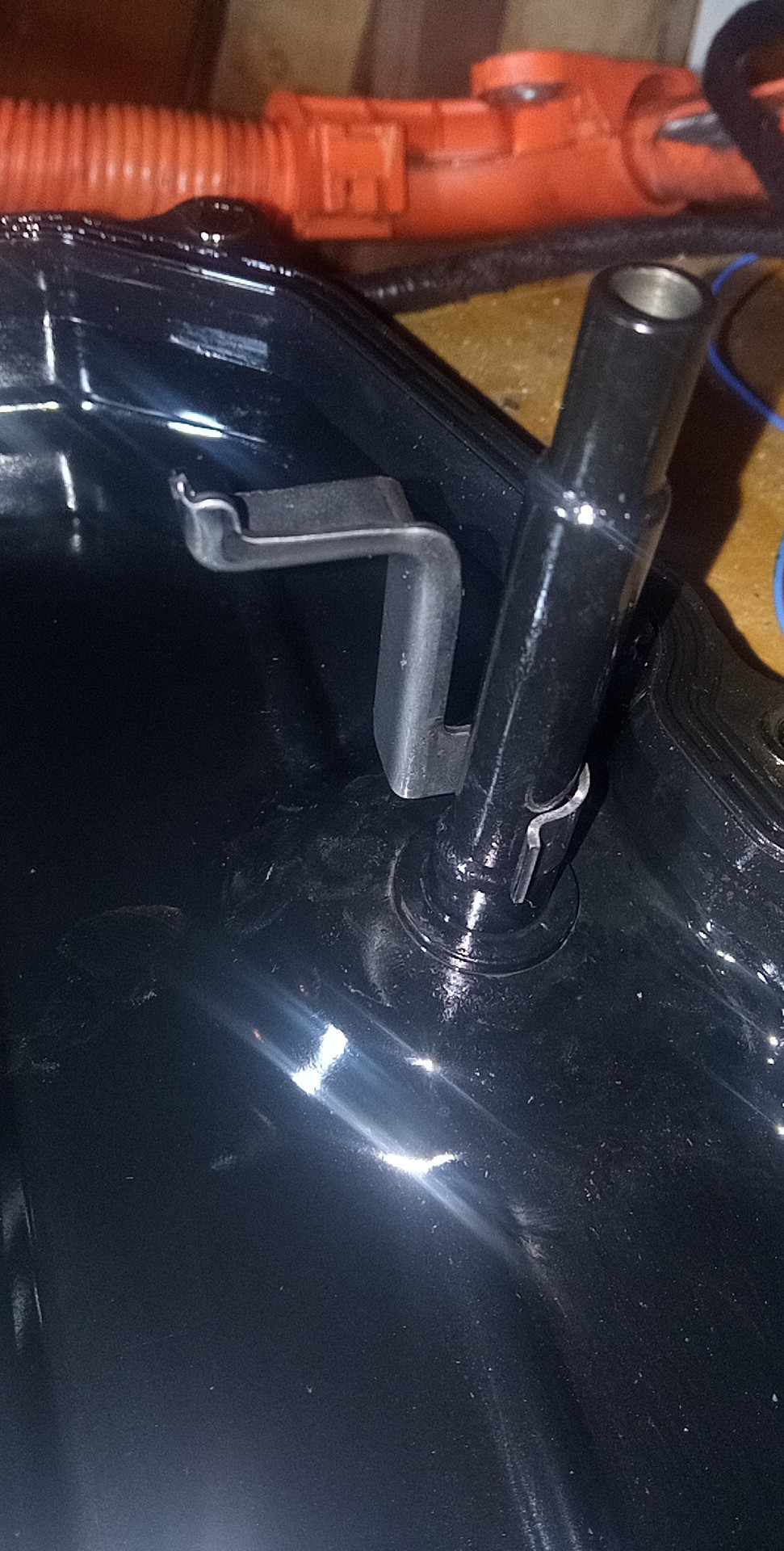

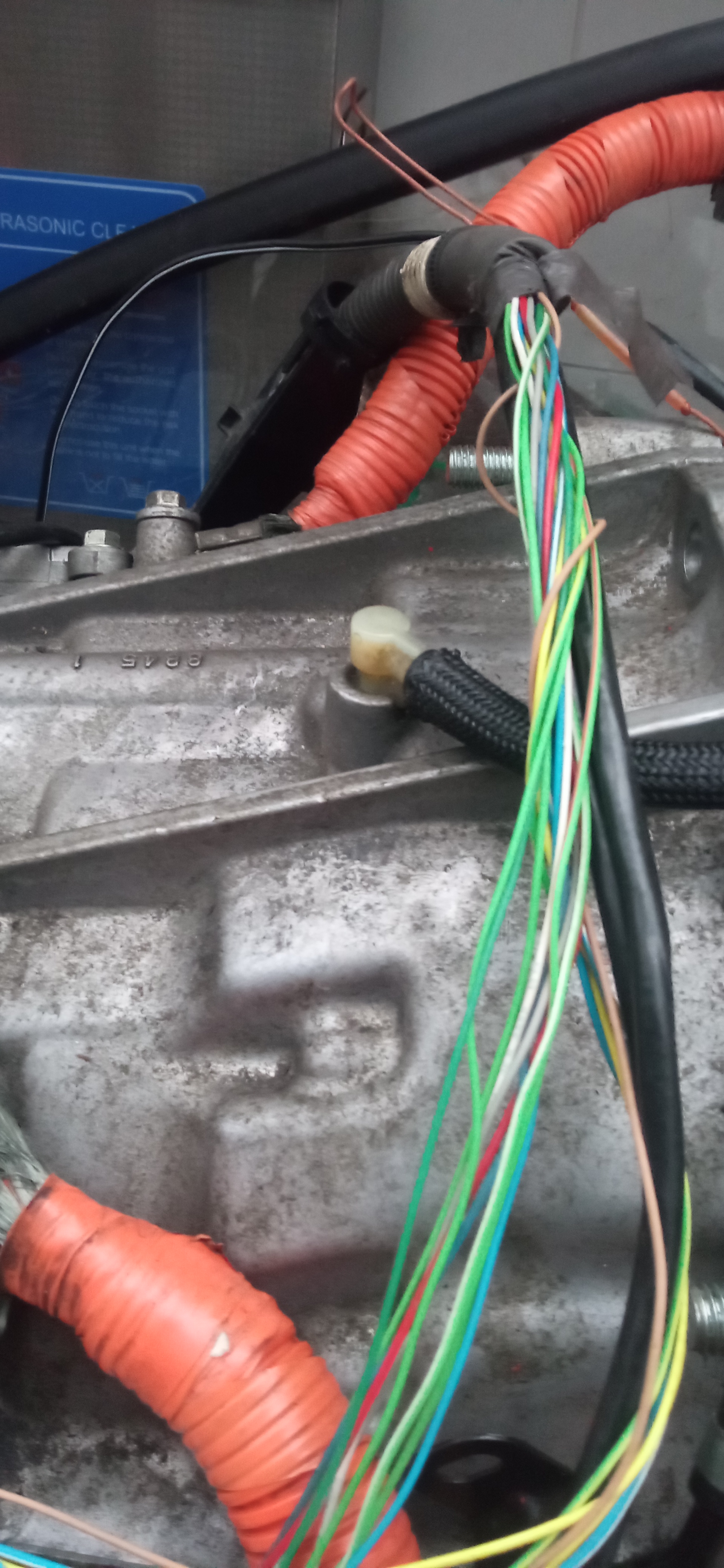

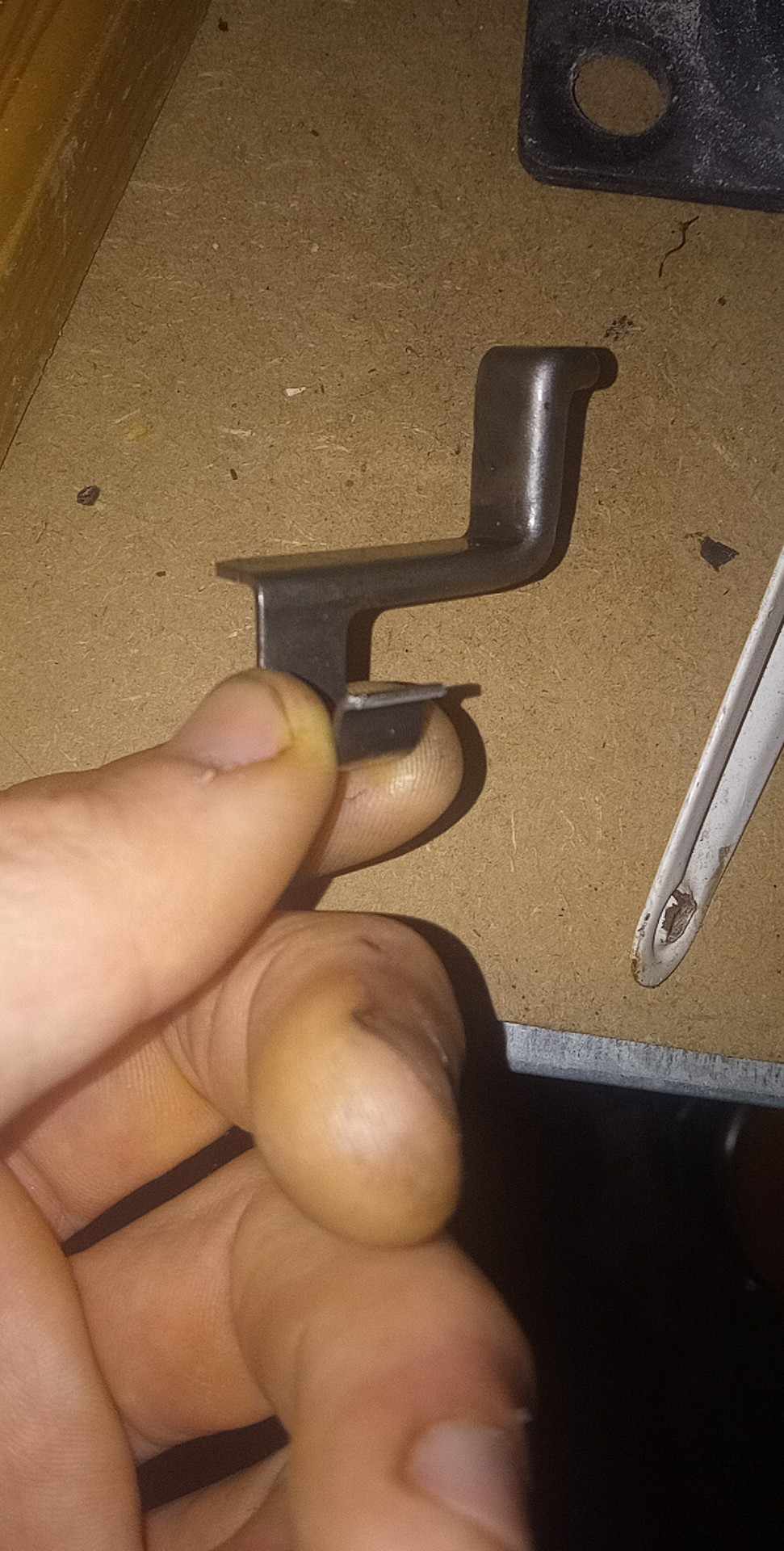

Soooo.... I popped the oil pan off to clean it out before filling it with ATF and unfortunately the pan popped off quite fast. Upon cleaning up the mess I found this part on the floor.. no idea where it's come from, if it's for the transmission or not at all tbh. Any ideas?
It kind of fits around the overfill tube on the pan but only loosely so I'm not sure that's right. It also has a sharp edge suggesting it might have broken off something but I can't find anything so far.

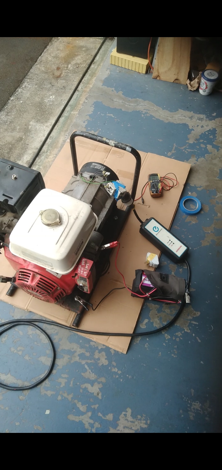

Pre the locating of an I3 REX , which is to be picked up tomorrow, a Honda 5Kw generator is working okay driving 15A into an Evse charging lead..
This allows charging through the charge port, and suitable when not moving.
Previously on another Hv vehicle, had rectified the 240v, and added a number of 24v meanwell supplies on top, and was charging direct to the battery, at around 10A, which could be run whilst on the run.
Am hoping the I3 REX is capable of more, once method to control it is established. If it is resolver indexed, will use a prius gen3 inverter for starting, and request neg torque to enable charging...

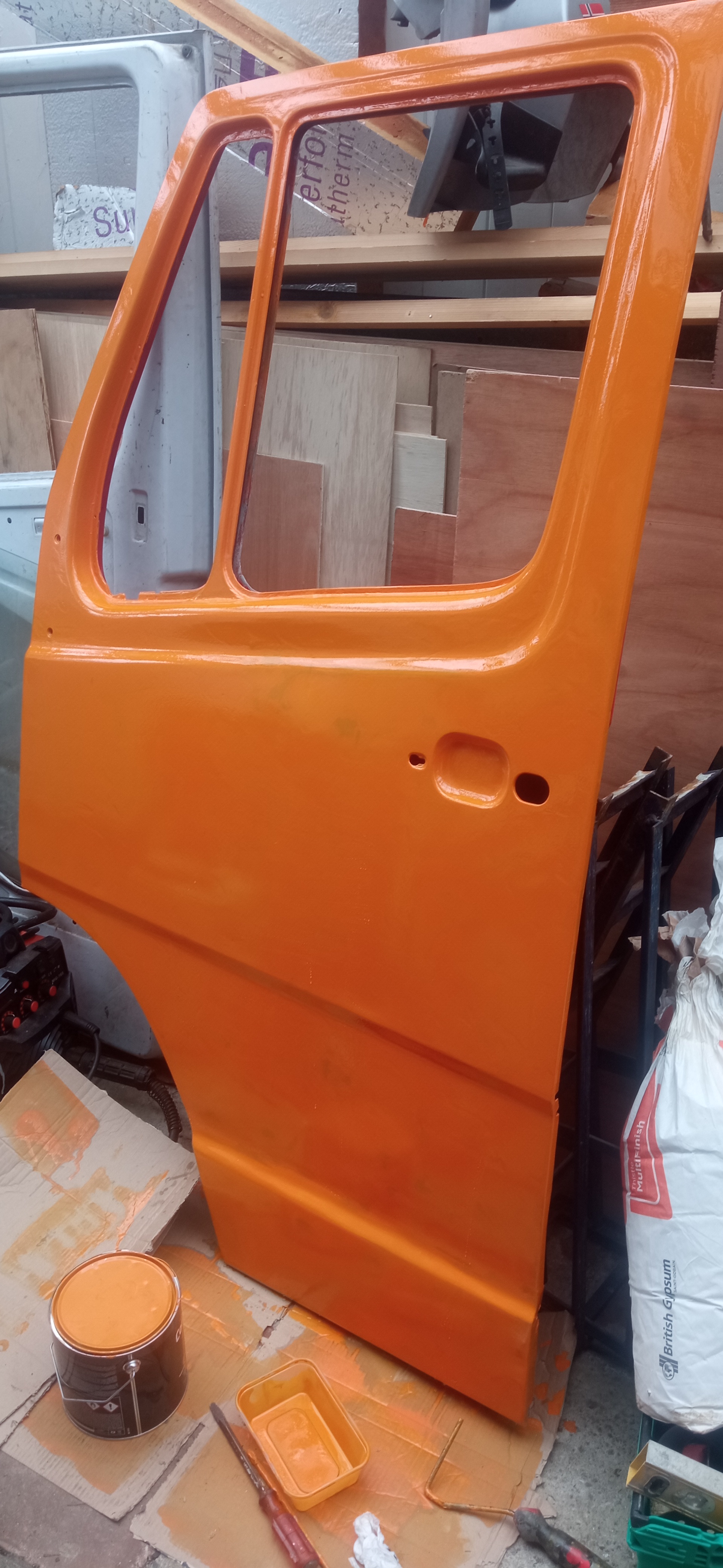

And a little pic of a repaired door almost fully painted...

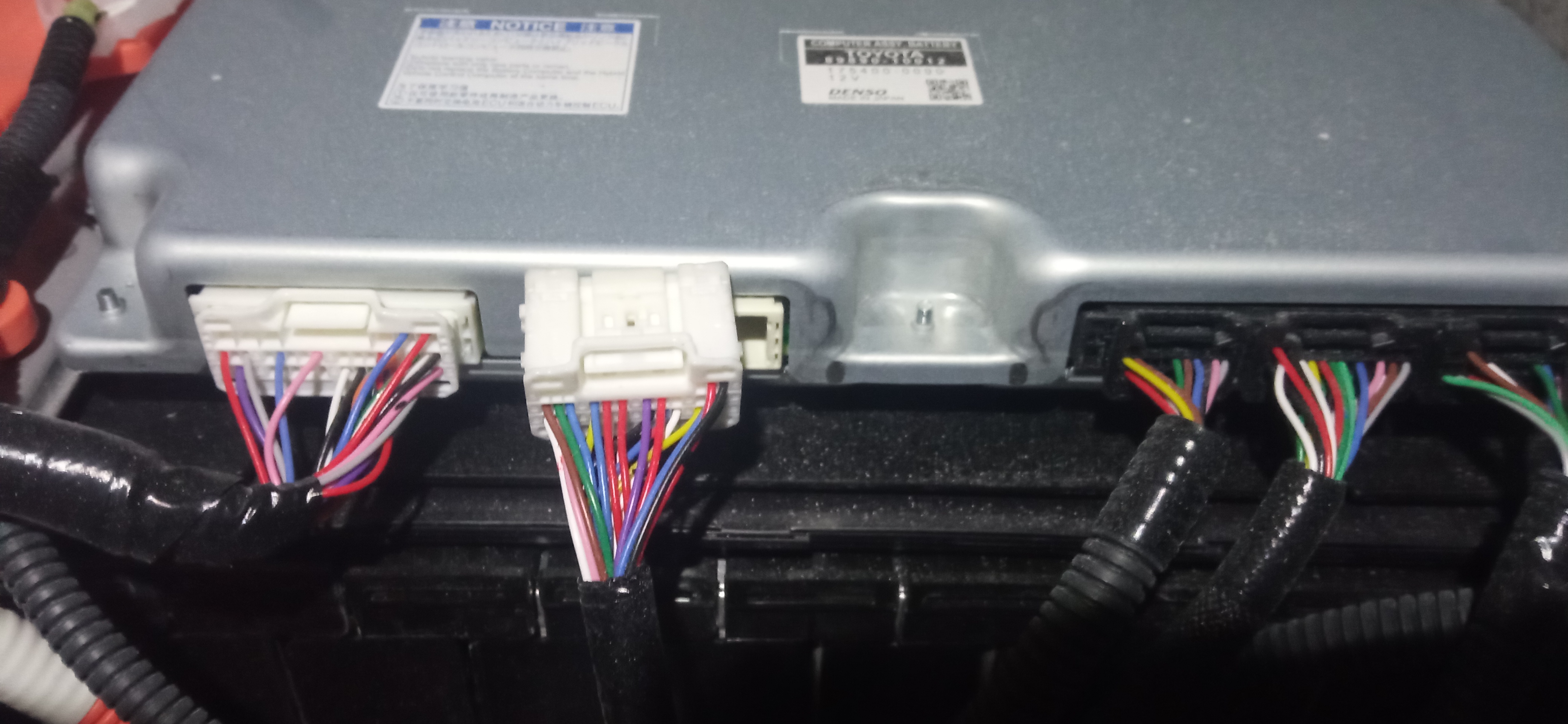

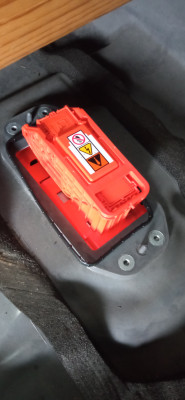

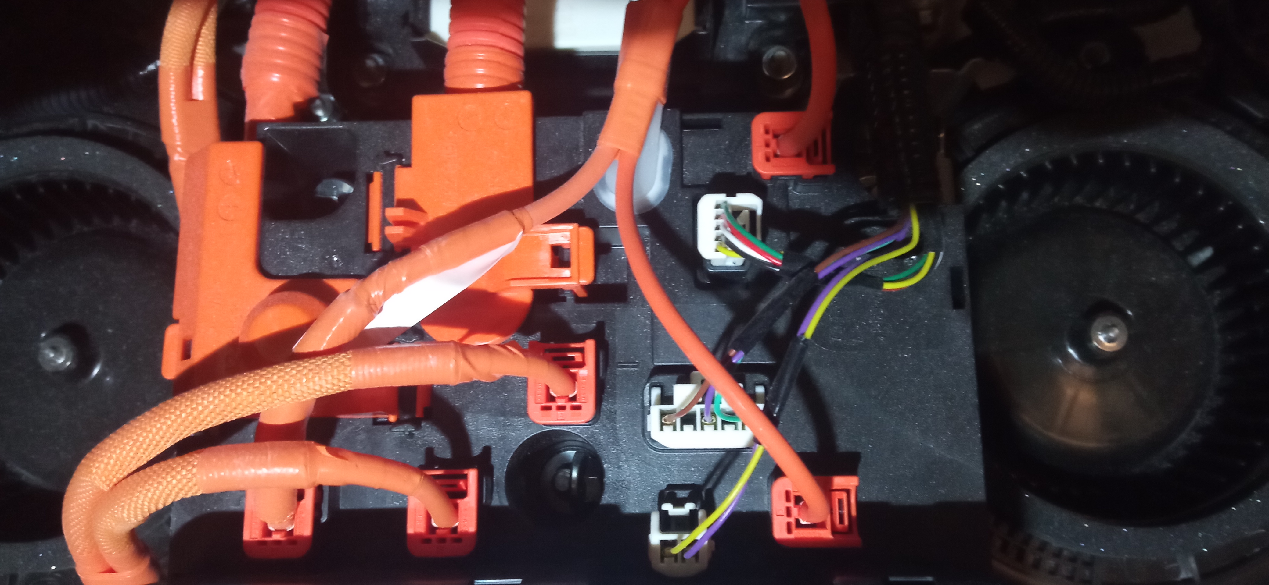

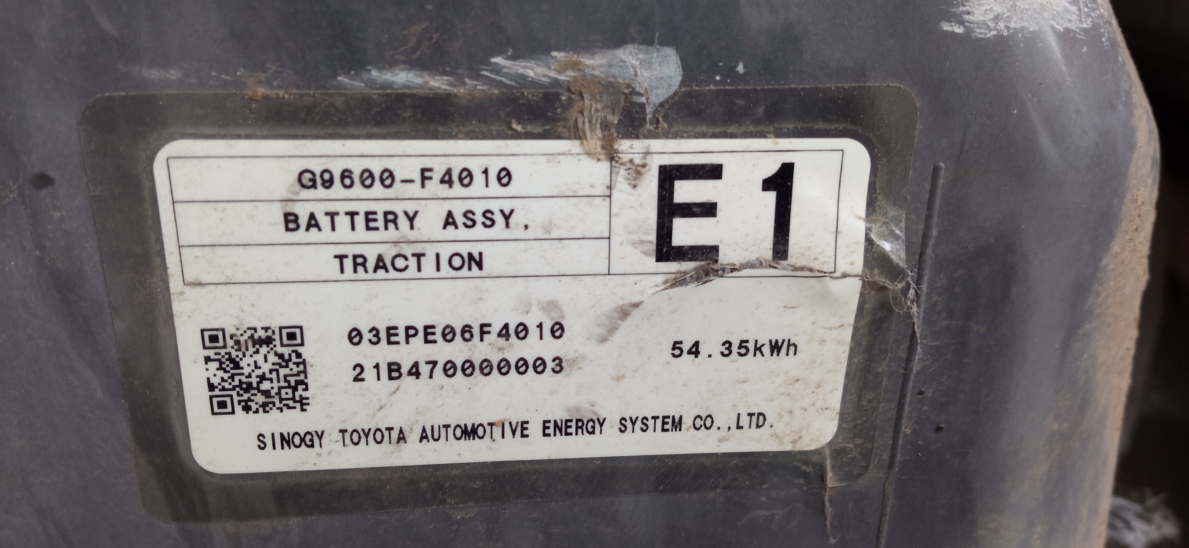

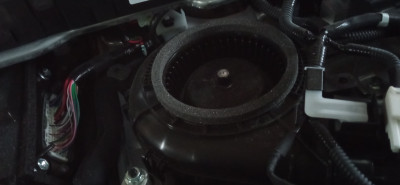

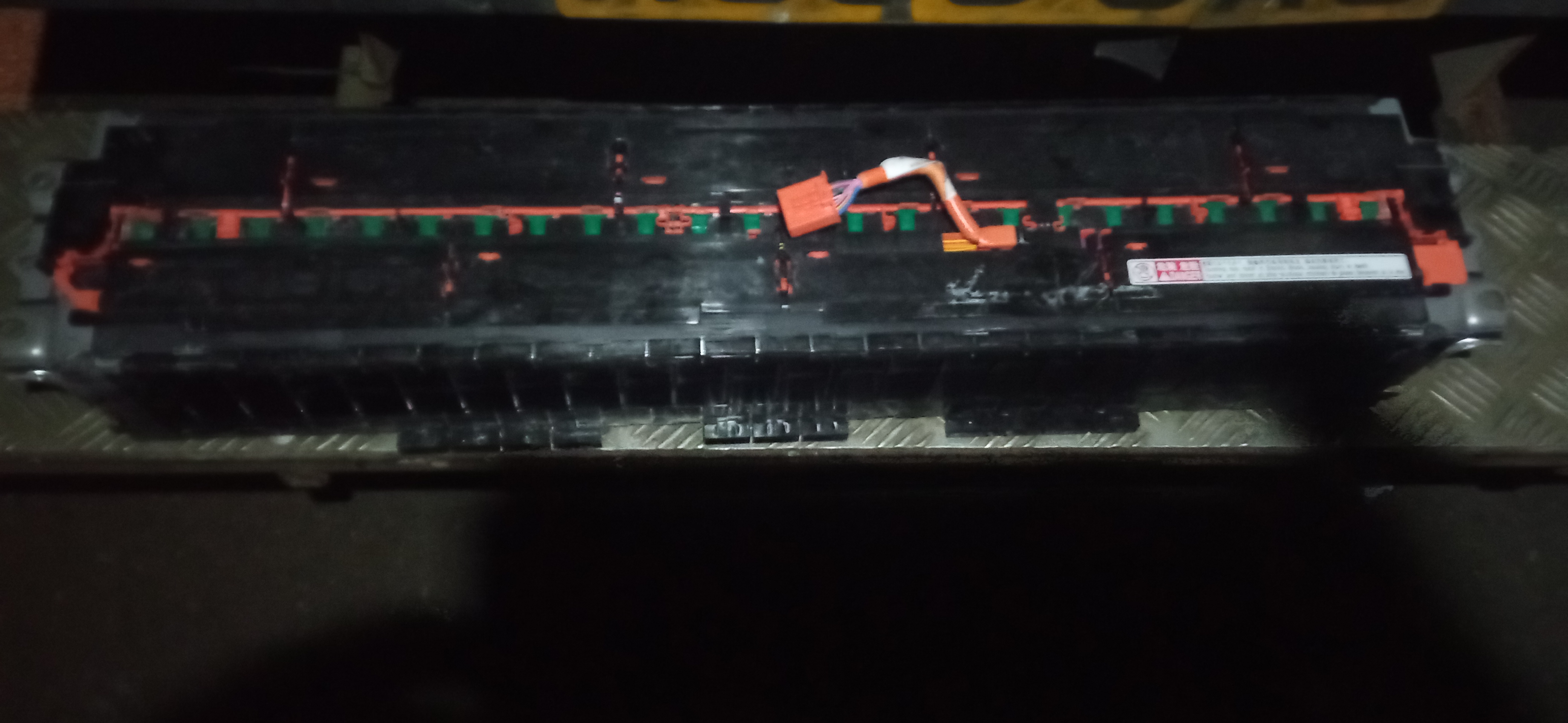

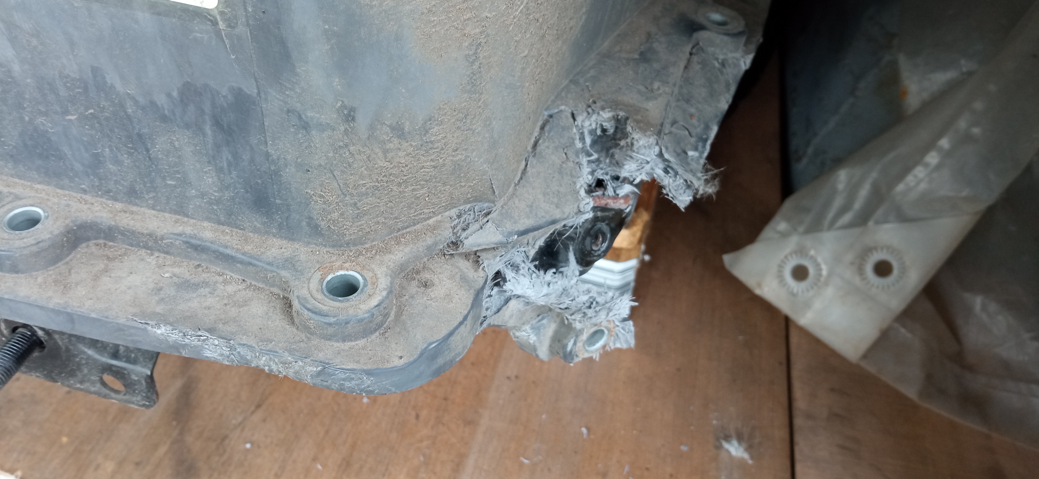

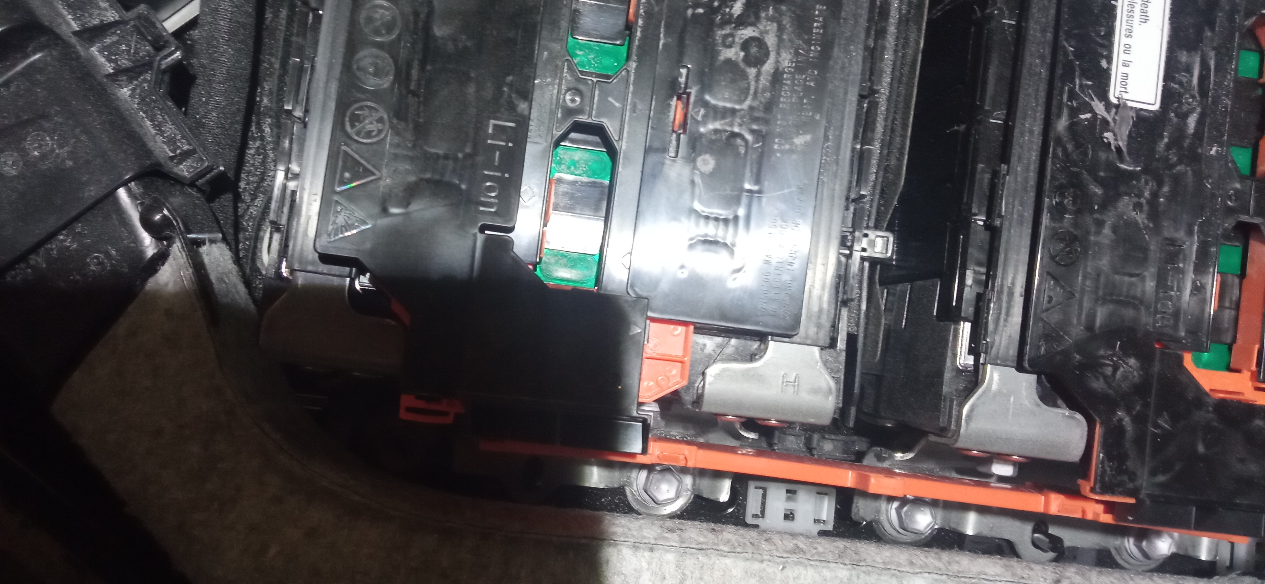

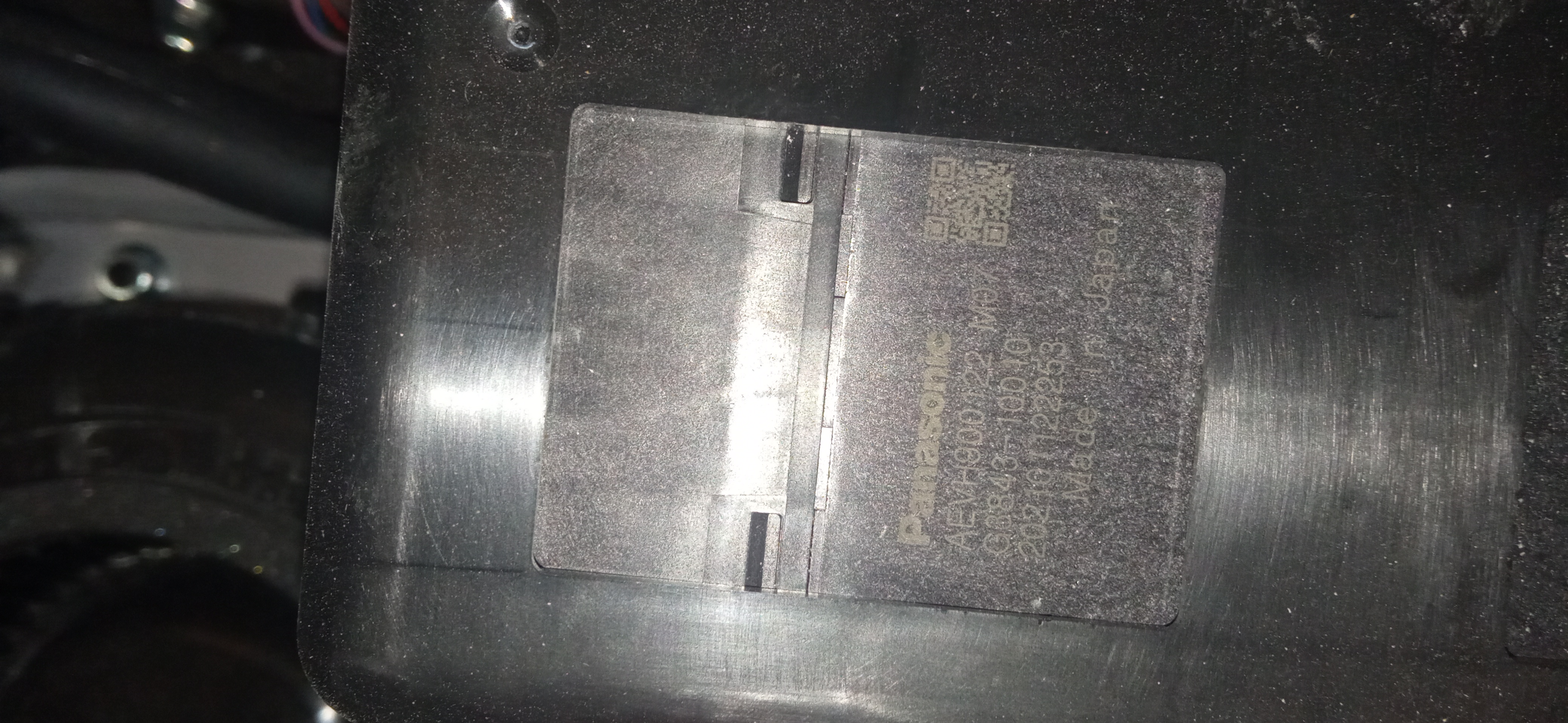

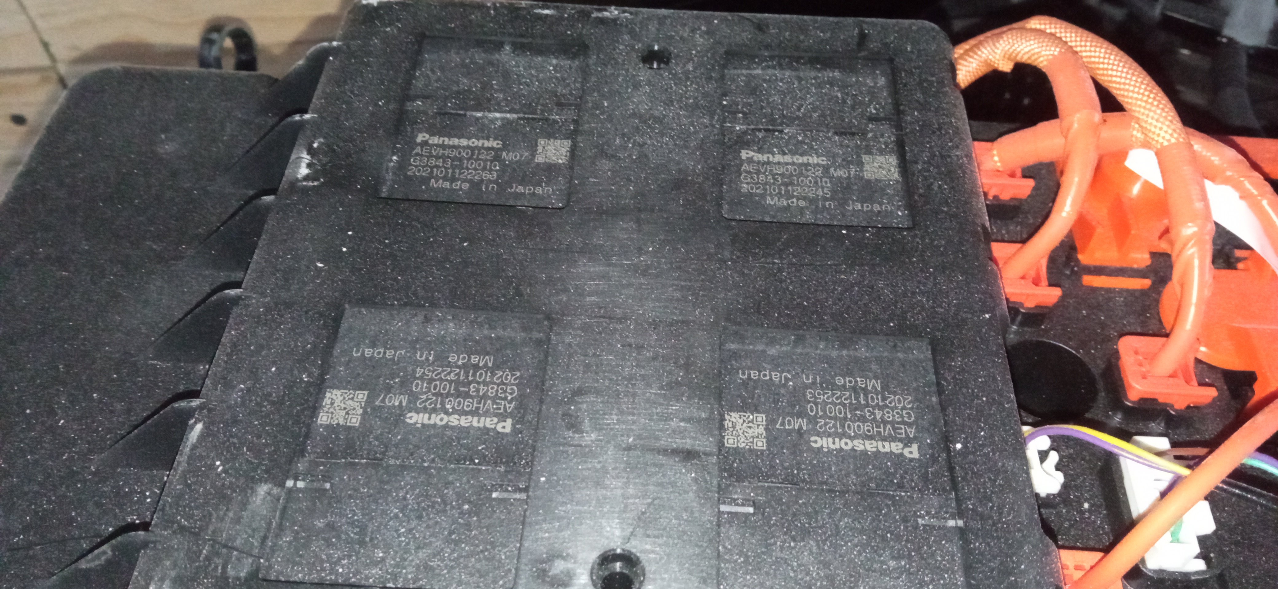

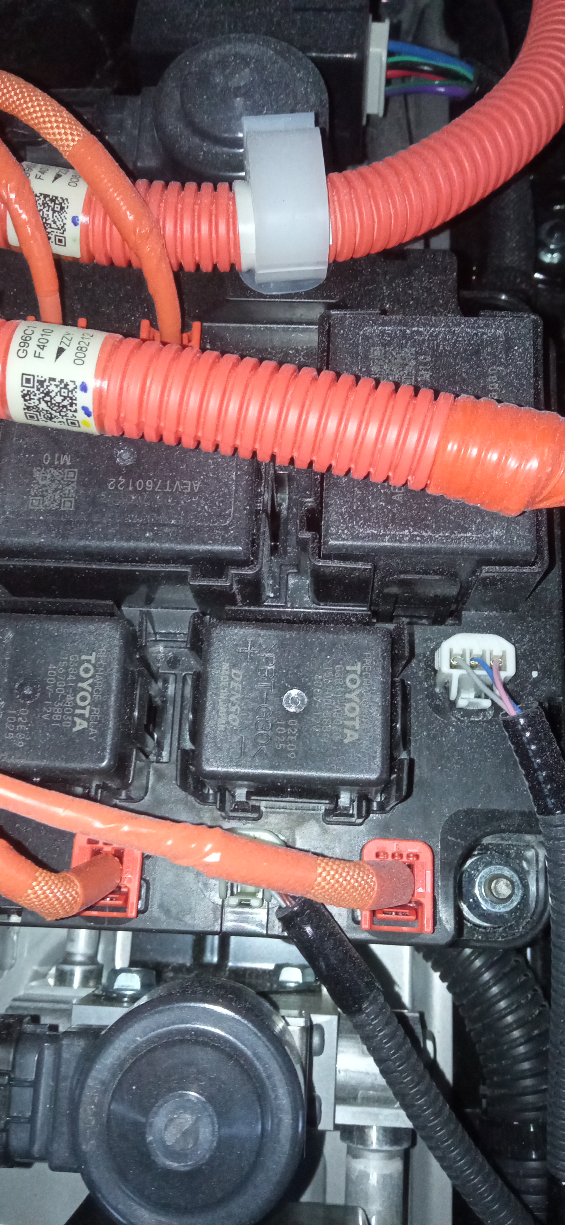

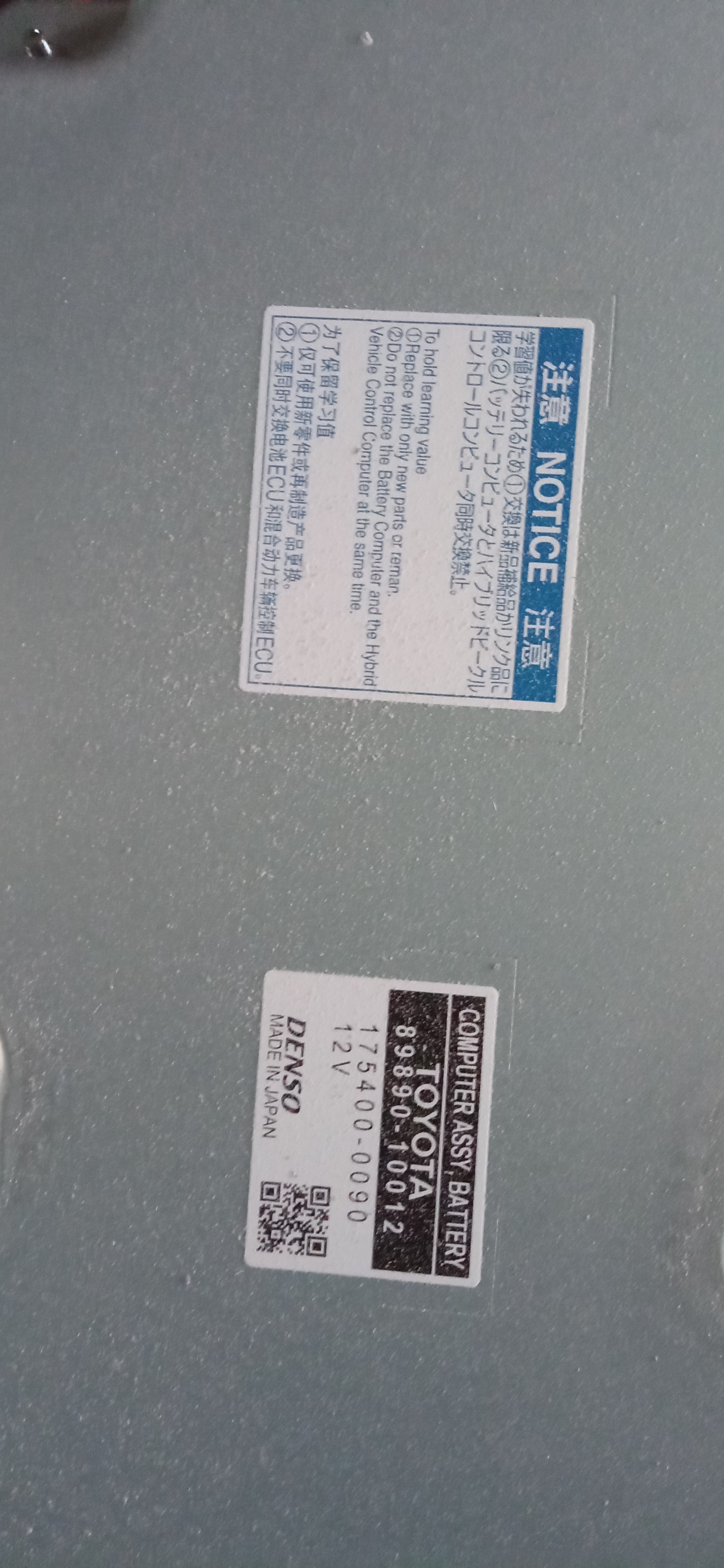

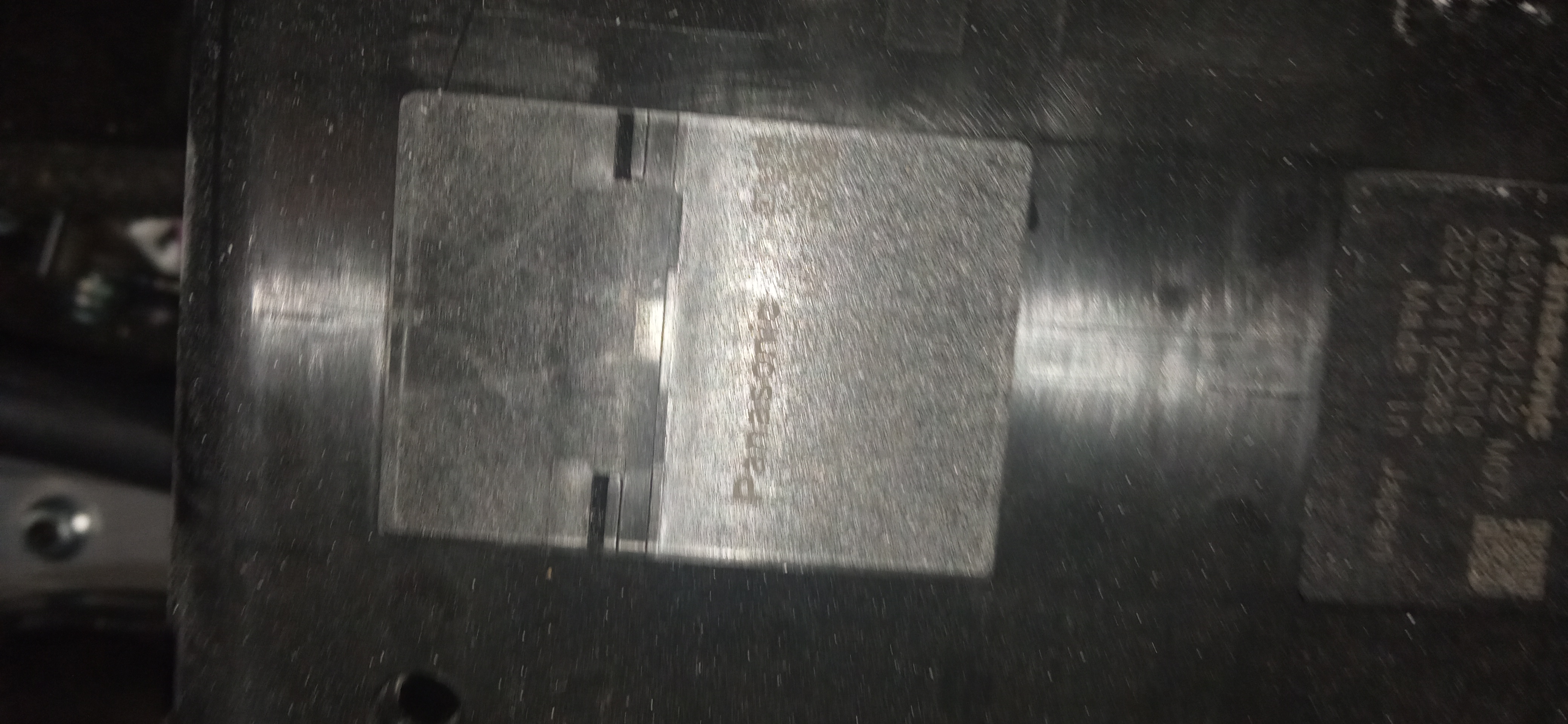

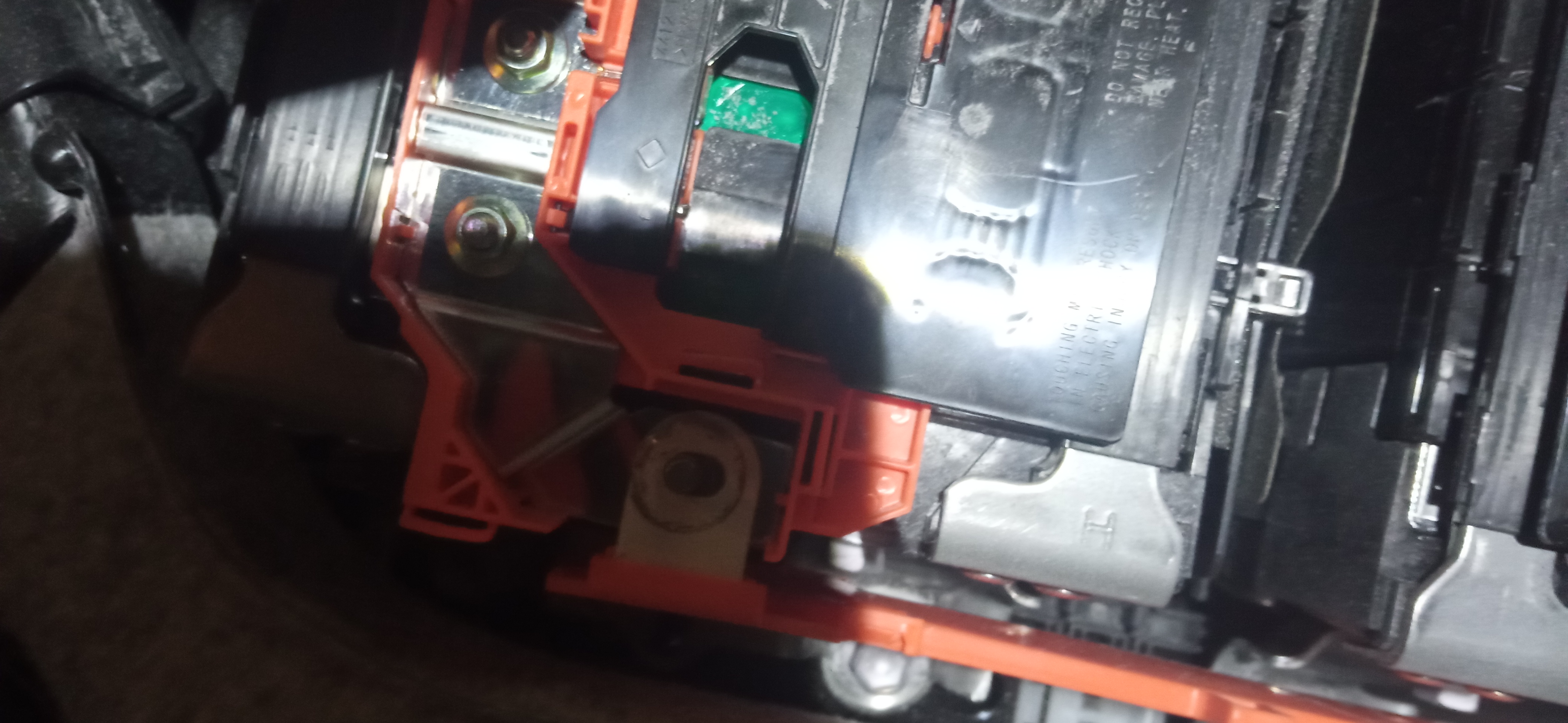

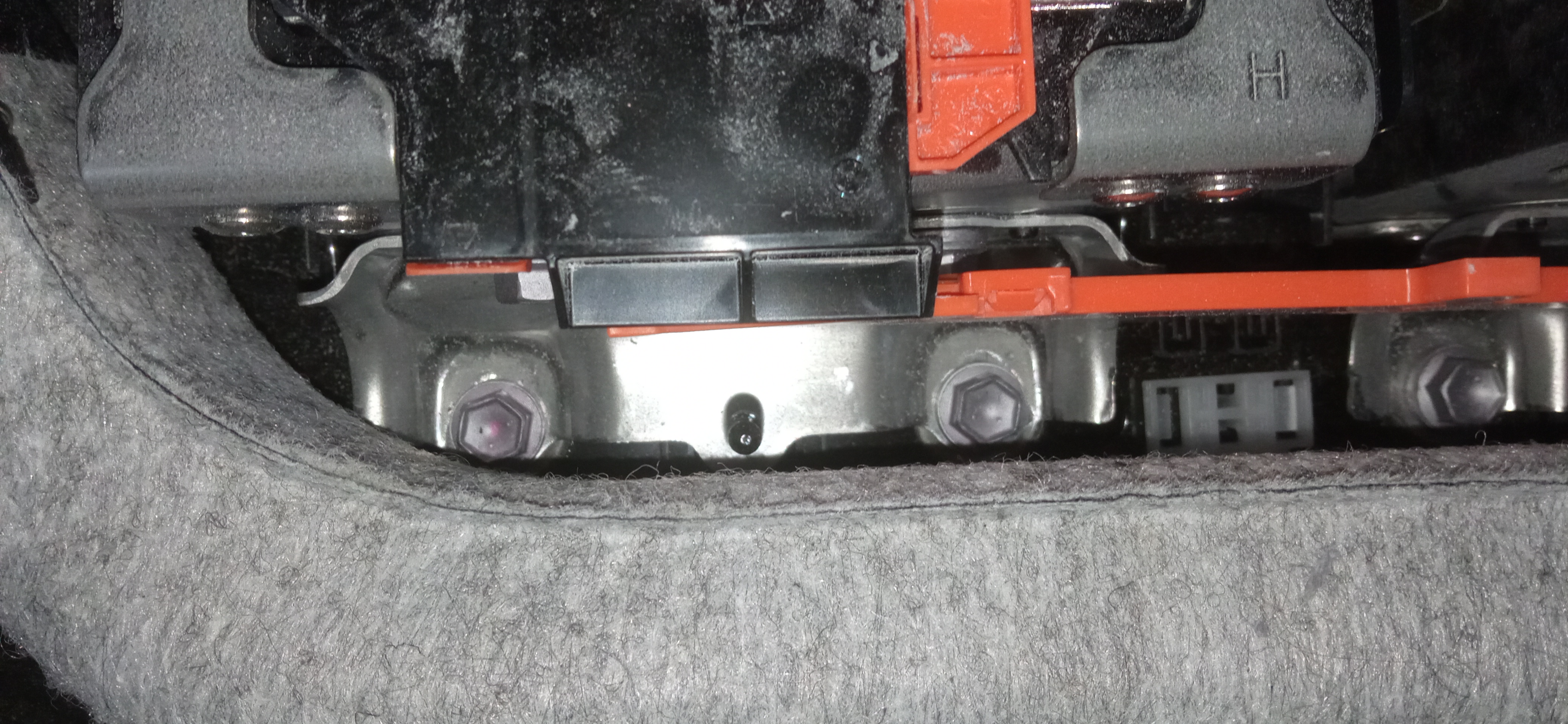

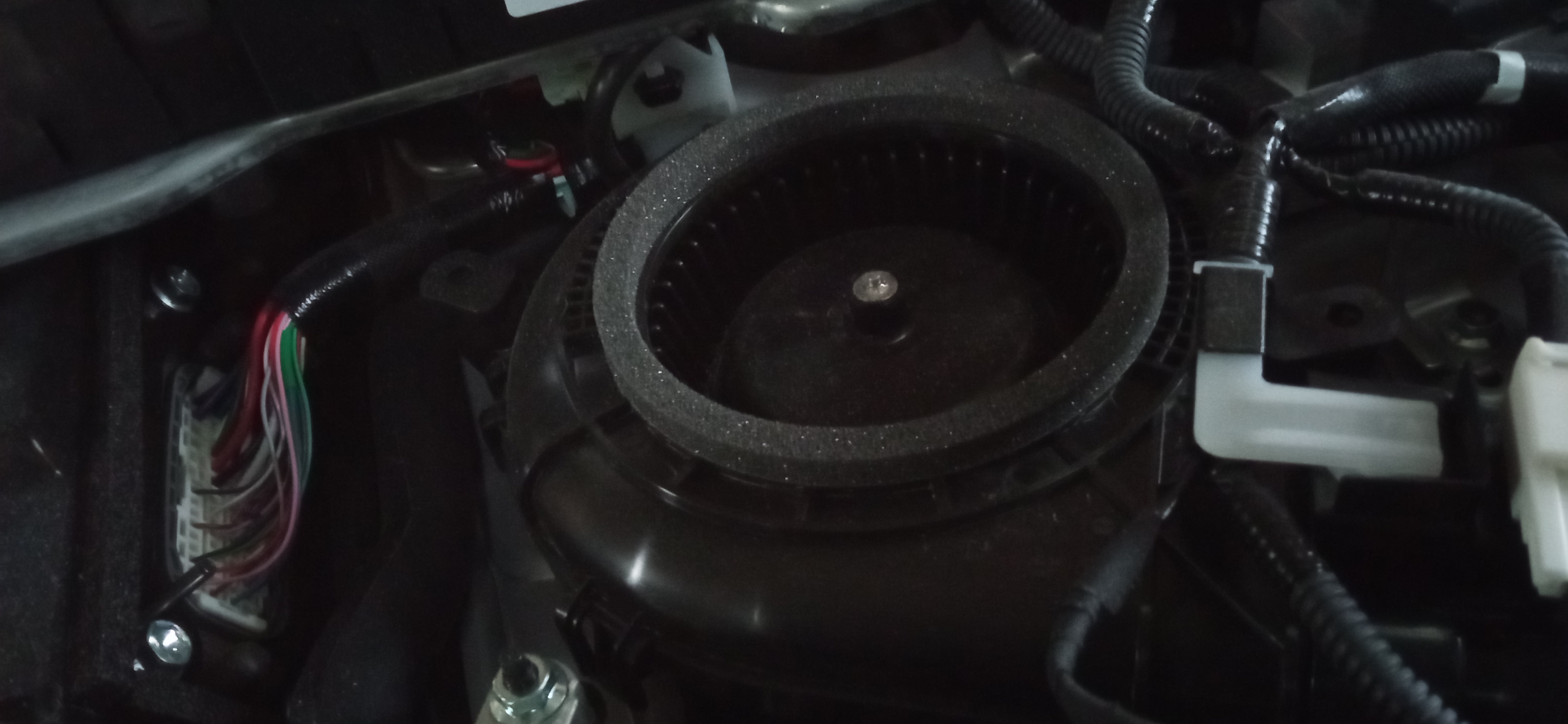

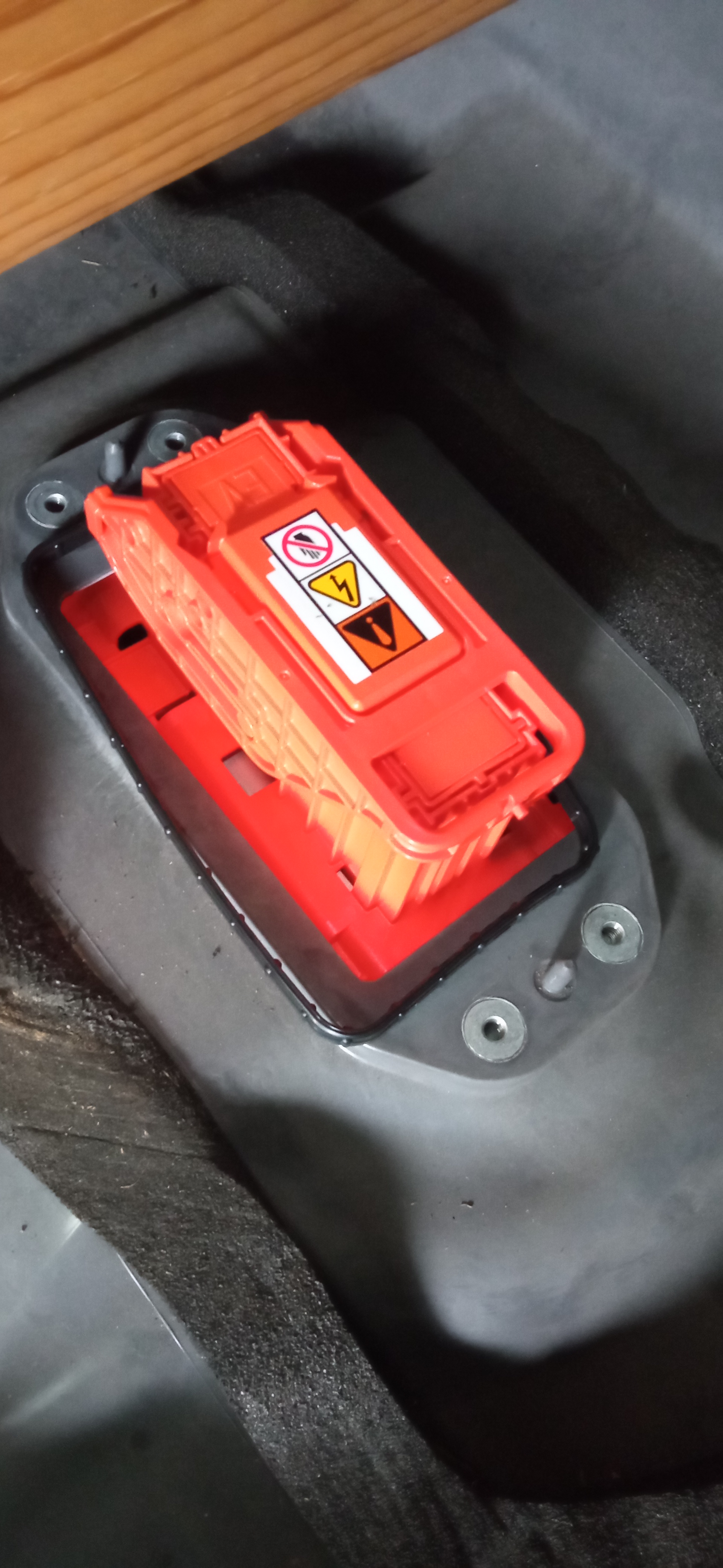

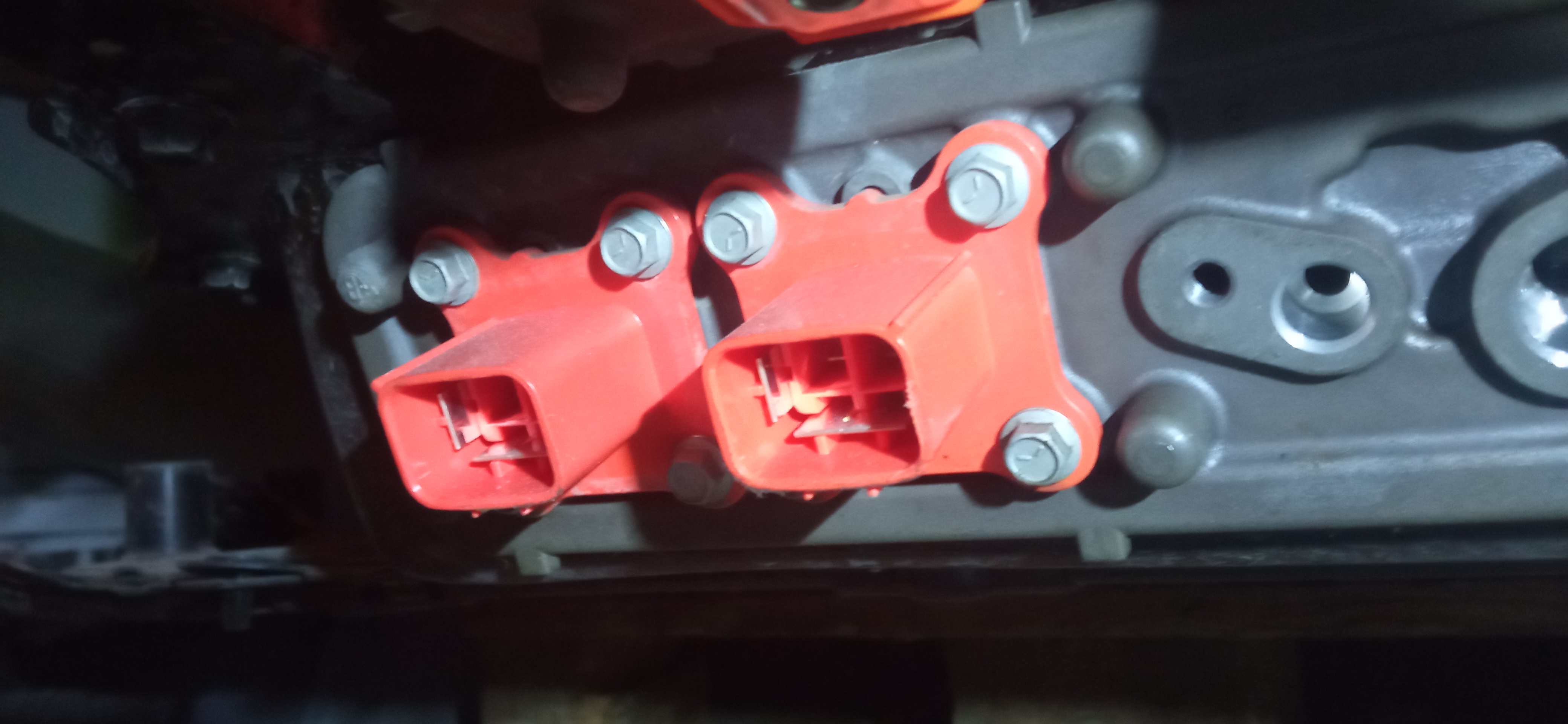

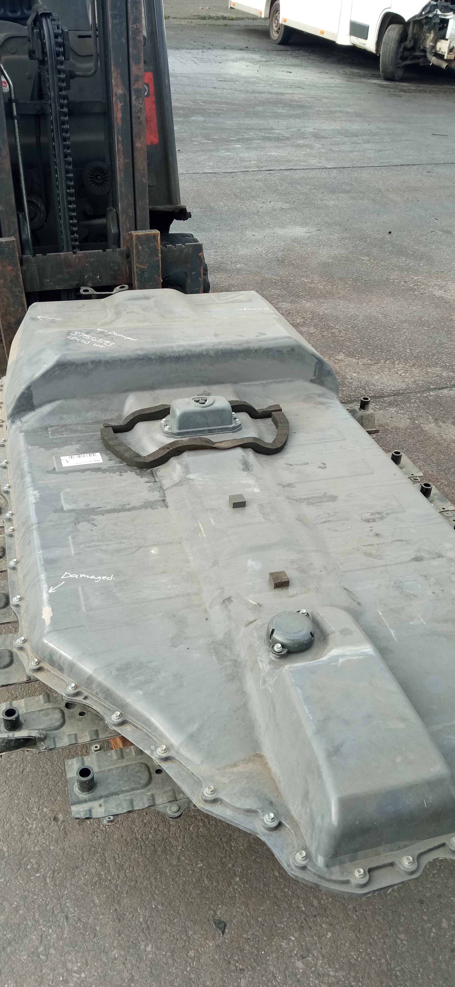

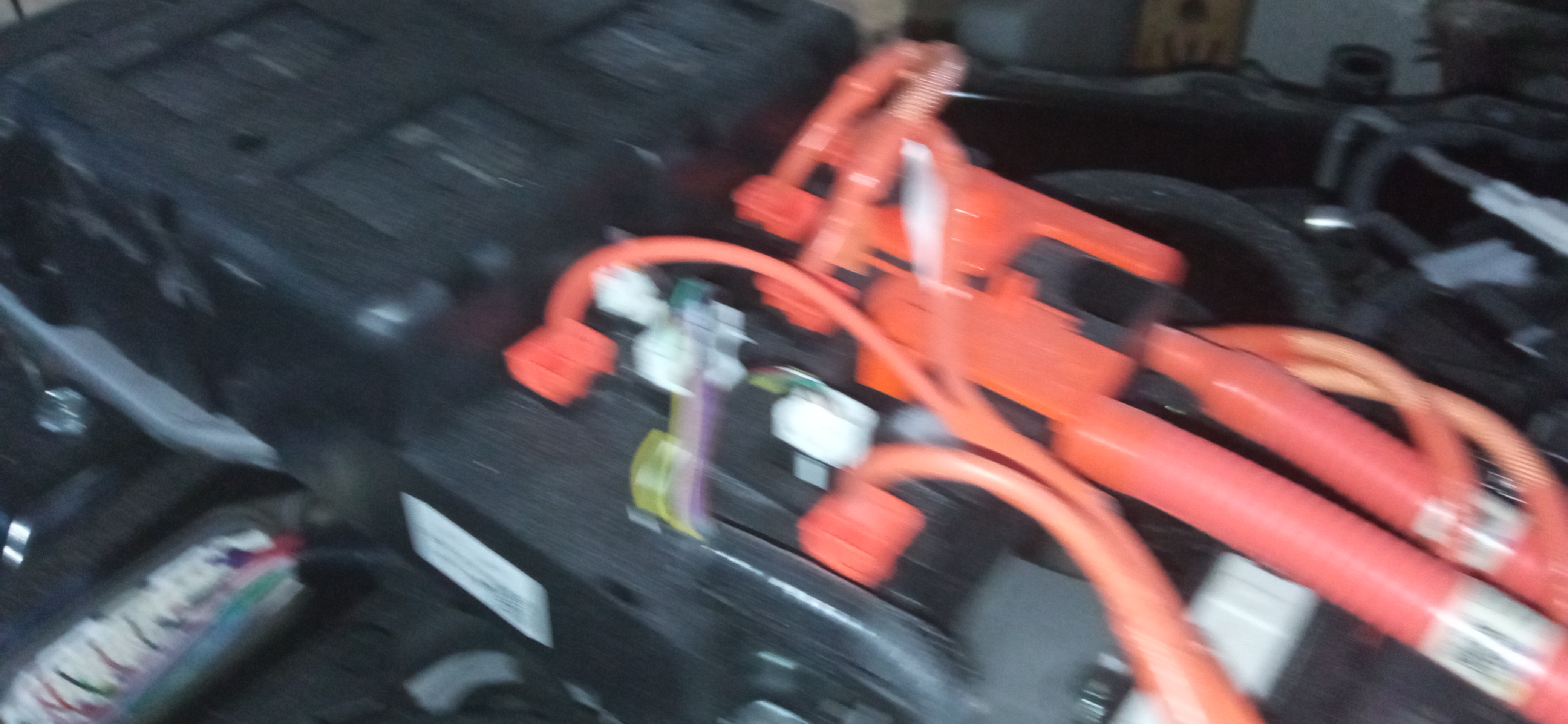

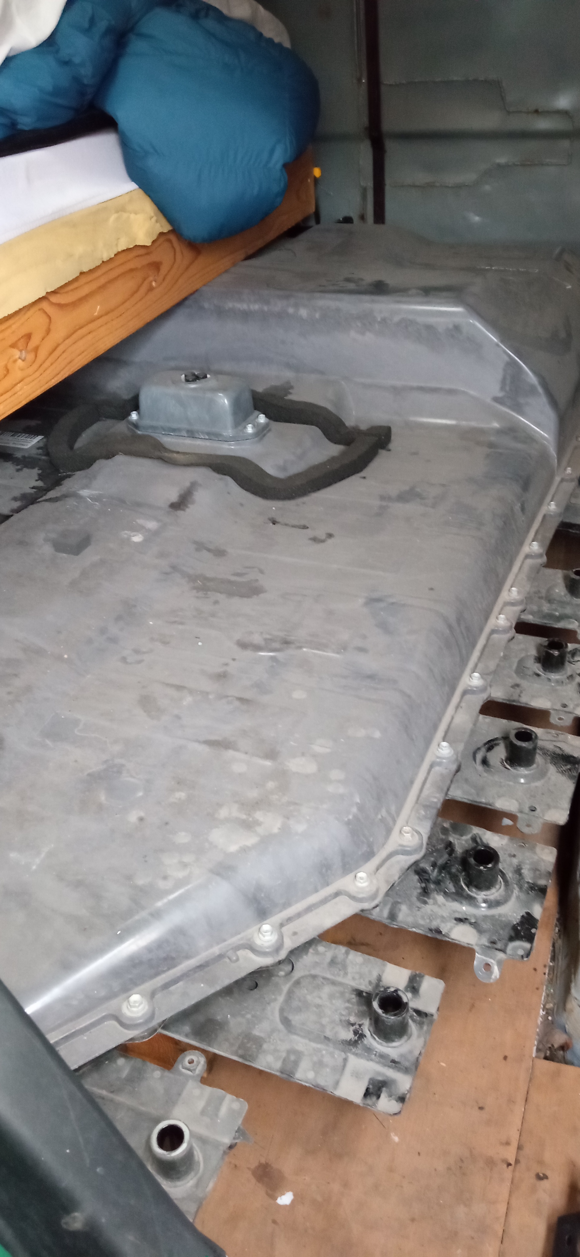

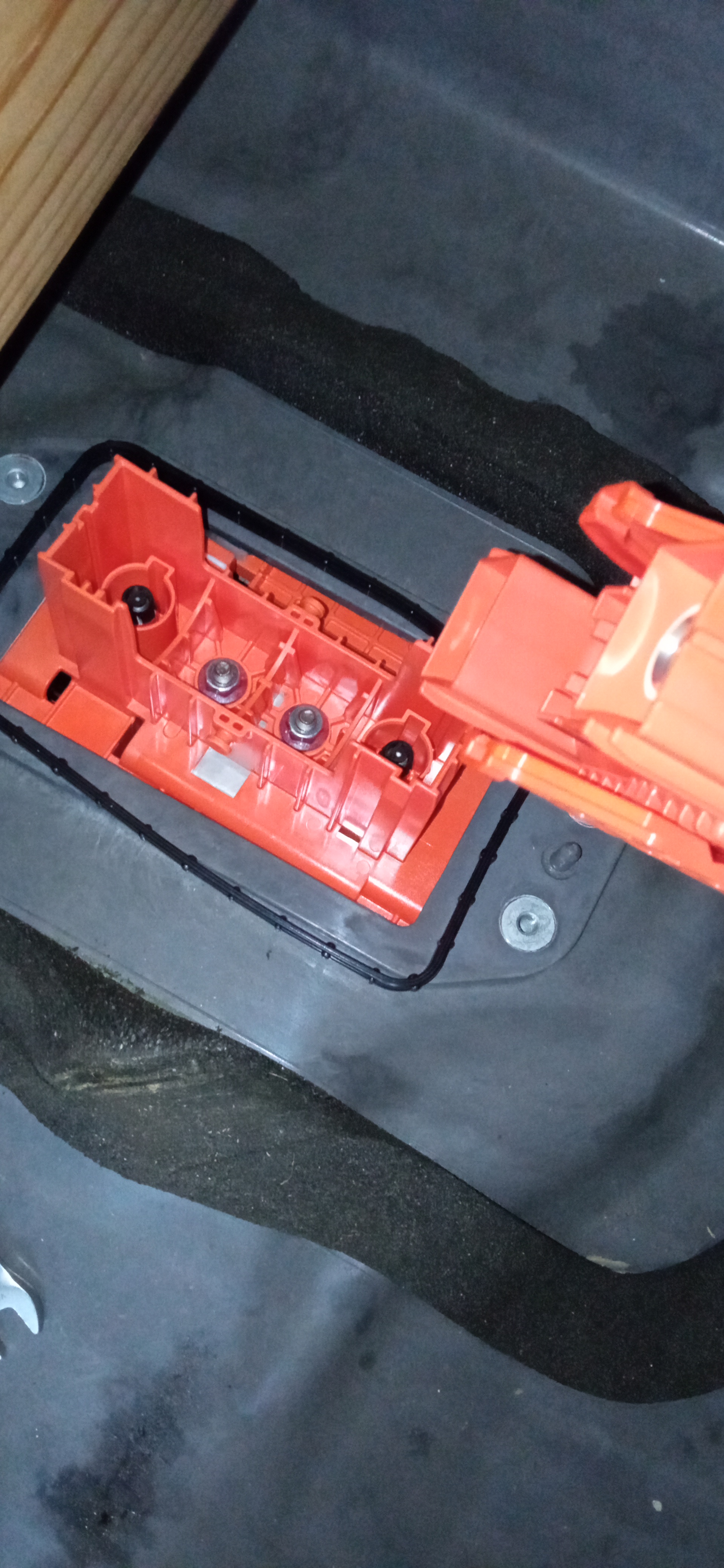

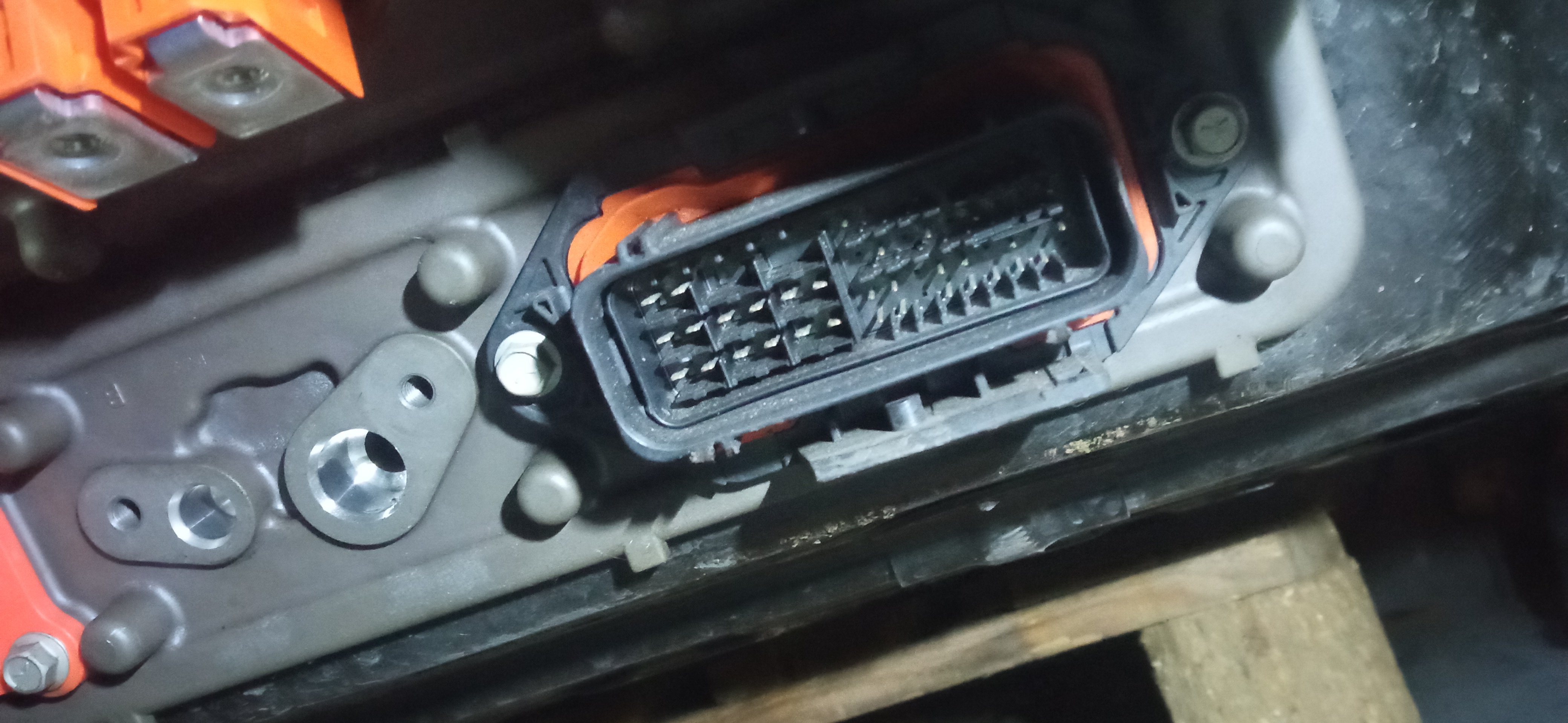

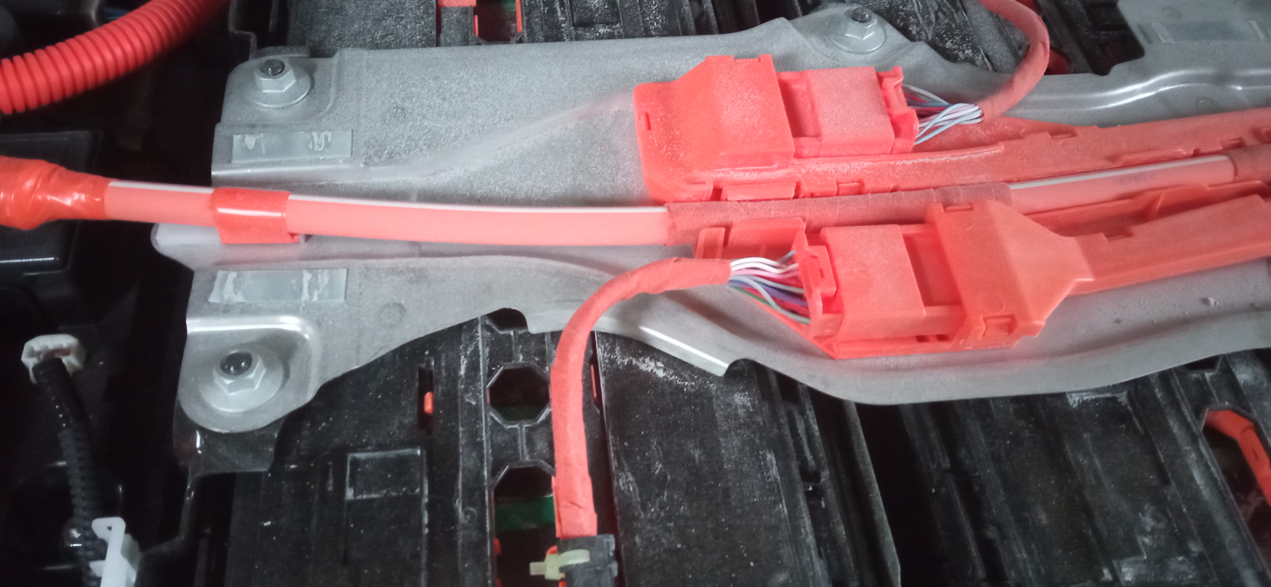

So yesterday I picked up a 54kwh pack from a Lexus UX300E for £900! (thanks BigPie for the heads up!)
It's much mess capacity then I was hoping for but it's a start and I'll add either a similar pack in parallel OR a pack with the same cells in series in the future.
The top was fibreglass and given I can't lift 500kg myself, I had to dismantle it from within my campervan. Once all the bolts around the edge were removed I used and angle grinder to take the top case off as I couldn't manoeuvre the pack to get the lid off in one piece myself.
Here are some pics....
Jacobsmess
Posts: 748
Location: Uk
Has thanked: 404 times
Been thanked: 116 times
Re: [WIP] Mercedes 310E (310D campervan) - GS450H/GS300H
Post by Jacobsmess »
It's got 8 modules of 27 cells (9s3p) and 3 modules of 24 (8s3p)
Its air cooled and has all the cooling infrastructure inside it.
It also has 8 contactors inside, I've not worked out what they all do yet. It's a centralised BMS.
Jacobsmess
Posts: 748
Location: Uk
More pics
Post by marcexec »
Awesome price! Air cooling makes it interesting for DIY. Can you please measure and weigh the individual modules? I'm happy to help you edit the Wiki - just PM.
My Suzuki RF400 build @ES
Honda IMA & Lebowski howto
Jacobsmess
Posts: 748
Location: Uk
marcexec wrote: Fri Feb 02, 2024 12:43 pm Awesome price! Air cooling makes it interesting for DIY. Can you please measure and weigh the individual modules? I'm happy to help you edit the Wiki - just PM.
Yes I will get dimensions shortly, I've only managed to free one small 24 cell one so far as it was late last night. I'm going to get more out today, unless the existing form is maintained I doubt the air cooling could be maintained. It has a liquid to air heat exchanger inside, the pack is sealed and air circulated over AC cooled water I believe and the ducts are formed to match the existing pack shape. Although I may consider it. In this form Toyota guaranteed the pack for 100k miles or 10 years I believe.
