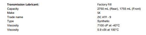

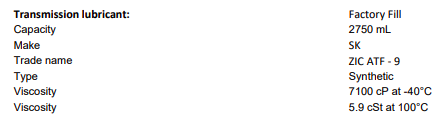

Don't suppose anyone knows what oil the m3 rdu needs? Dexron 6?
Kevin Sharpe
Posts: 1339
Location: Ireland and US
Been thanked: 8 times
Post by Kevin Sharpe »
Jack Bauer wrote: Thu Jun 04, 2020 2:20 pm Don't suppose anyone knows what oil the m3 rdu needs? Dexron 6?
TMC says (here): The model 3 service guide calls the drive unit fluid "ATF-9". This does not appear to be a commercially available product. The exact description of the fluid is "ATF-9. SK Lubricant 422313 (part number 1135241-00-A)"
Edit: "ATF-9" also listed in a Model 3 RDU Service Bulletin (here)
Edit 2: "ZIC ATF - 9" details are on page 6 of the EPA certificate of conformity (here)
Edit 3: SK ZIC Oil don't list the product but some of the DEXRON VI parameters look close (here)
Edit 4: Page 5 of the Model 3 AWD EPA certificate of conformity also lists the front motor (here)

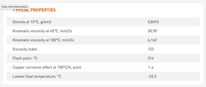

All I can say is that at 100 °C the viscosity is similar if the EPA documents are correct;
"ATF 9" = 5.9 cSt
DEXRON 6 = 6.16 cSt
I've attached the ZIC ATF DEXRON 6 data for reference (source here).
Posts: 3663
Has thanked: 11 times
Been thanked: 346 times
Close enough for me:)

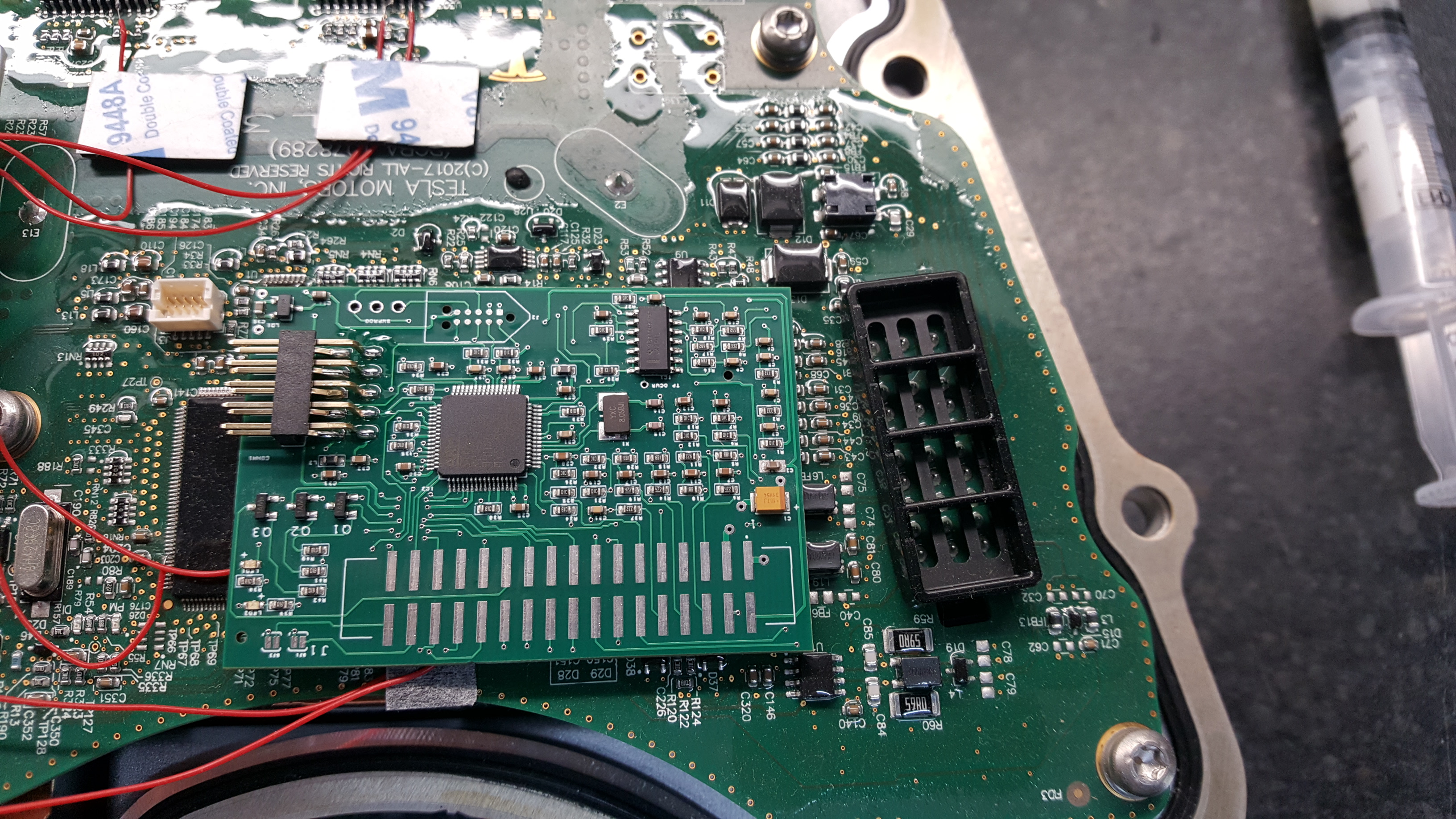

Time for a little update on the Model 3 drive unit.
Modchip board has been tested on the bench and works fine. Next up is wiring it to the inverter, then will need Johannes to do a few firmware mods to trigger the gate drivers at the right time during power up. As we saw from the Prius inverter tests the FOC firmware runs the motor just fine.
We'll do some high speed / high voltage runs to confirm functionality over the next week at which time the boards will go on beta release. A very long and boring video detailing the installation is in progress and will be released at the same time.
PDFs of the schematic and PCB will be available on github at that time however design source files will be available to Patrons only.
