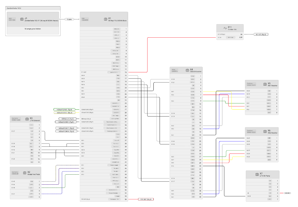

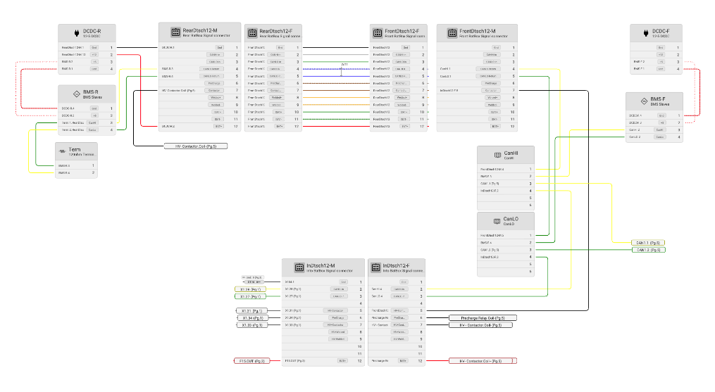

Wireviz was conceptually interesting but I found it to be pretty high friction for getting my wiring harness designed.
Together with @splicecad, I've been working with the Splice-Cad.com tool and I've found it's far more intuitive and easier to visualize what's happening than WireViz. It's constantly being improved and this is my way forward for sure. Splice-Cad exports JSON and even has a way to push revisions directly to my Github repo and kick off a GitHub action to render my schematic/layout.
Example: https://github.com/hpeyerl/evj55/blob/m ... ematic.pdf
Anyone doing an EV conversion, could conceivably download my JSON https://github.com/hpeyerl/evj55/blob/m ... _plan.json and import it to their own Splice-Cad project, or simple copy/paste the portions of it they want.

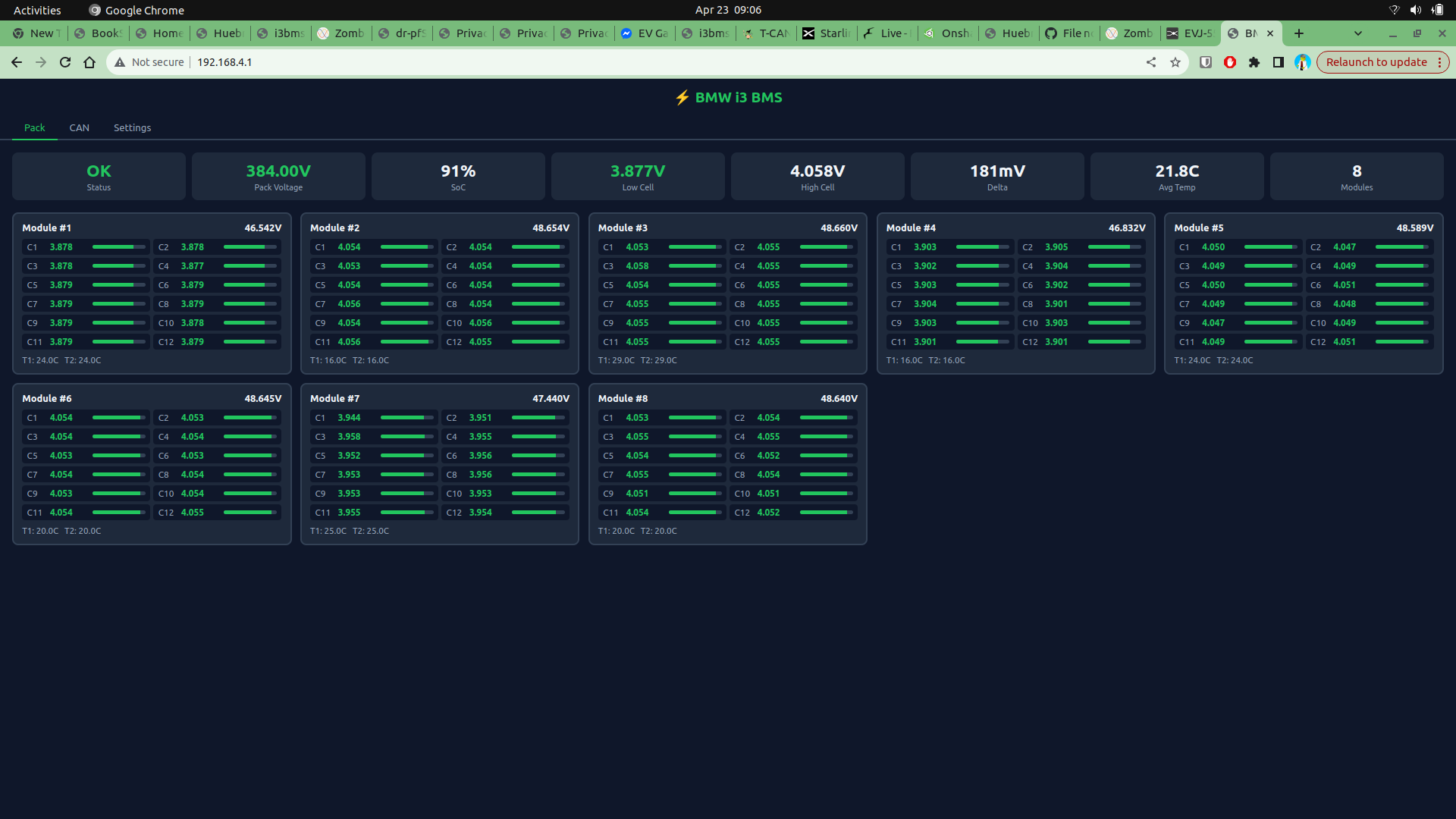

Got 8 batteries across two packs in the truck. The first time I've spoken to the modules and definitely the first time since I manually charged each module.
BMS running on a Lilygo T-CAN485 using the code at https://github.com/hpeyerl/bmw-i3-bms-tcan485
