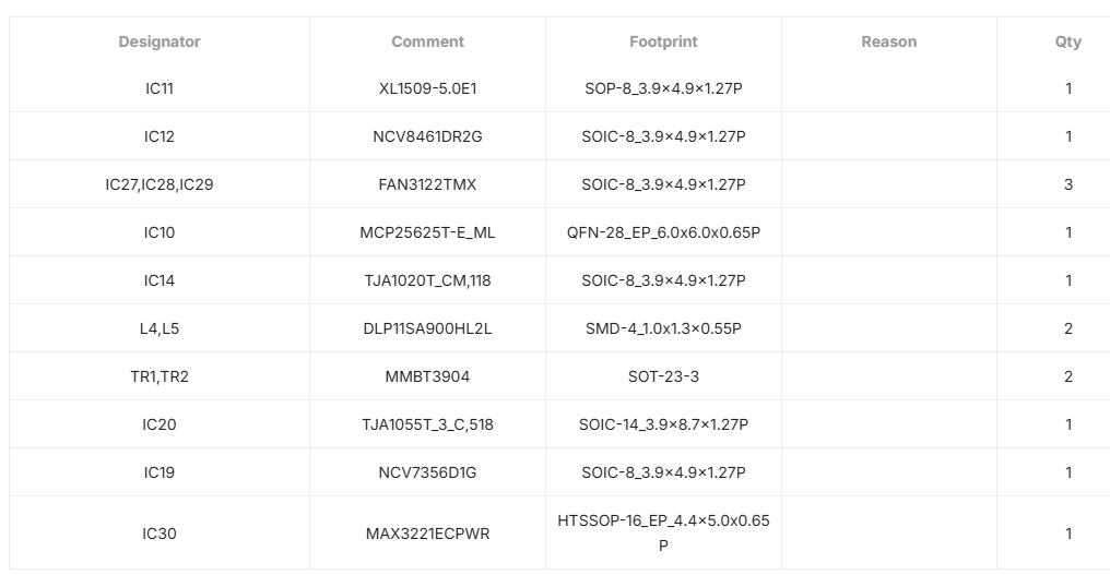

Hi i have a board with this missing components. can someone tell me what component to skip on leaf setup.

Posts: 2962
Has thanked: 328 times
Been thanked: 847 times
Re: Nissan Leaf and Zombieverter minimum components need?
What else are you going to control? what pins will you use?
Just fit all and not restrict yourself.
blasaab
Posts: 14
Joined: Sat Nov 20, 2021 6:17 am
Post by blasaab »
I dont have those component and dont know what they are for. i can order later and fit but now i want to test my leaf motor/inverter without some off this components.
J0hannes
Posts: 158
Has thanked: 21 times
Been thanked: 182 times
Post by J0hannes »
You have on your list parts from modules: power supply, Can3, RS232, LIN bus, Digital outputs and some others.
At least if you don't have any of those power supply related components you listed, you can't use the board at all.
https://github.com/damienmaguire/Stm32- ... ematic.pdf
If it helps, you can look from the scematic yourself, what goes where.
blasaab
Posts: 14
Post by blasaab »
J0hannes wrote: Wed Mar 11, 2026 7:21 am You have on your list parts from modules: power supply, Can3, RS232, LIN bus, Digital outputs and some others.
Thanks Johannes that helped
