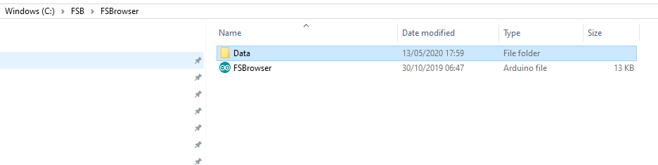

davidwagstaff
Posts: 11
Joined: Sat Sep 28, 2019 8:00 am
Location: Devon, United Kingdom
Re: HOWTO: Flashing ESP8266
Post by davidwagstaff »
Thanks for your reply Matt.
I have a Olimex Mod board and been trying to program with the Arduino IDE . I've got the boards loaded in the IDE. I've connected the board to USP-TTL as per instructions on page 1, moved solder bridge to 0.
Created folders with ino and data. as per arbers instructions on page 3.
If I open the ino file and with the correct board and port selected I can program the Olimex, everything appears ok. It gets to resetting the board and just sits there.
Then I've tried either waiting a while and trying the ESP data upload tool or manually resetting the board by powering it down and then trying. Either way it appears to load the SPIFF and gives completed messages.
I'll try again and take some screen shots.
davidwagstaff
Posts: 11

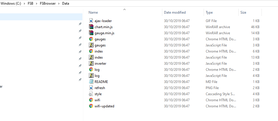

Then on my phone I am changing to the ESP wifi and attempting to go to 192.168.1.4 and get "FileNotFound"

All debug looks good, steps followed correctly. Maybe there is a bug with URL "/"?
Perhaps try full URL? -> http://192.168.4.1/index.html

If I just try going to 192.168.4.1 without changing wifi I get site cannot be reached errors so definitely on the ESP.
Are there any files I've missed in the SPIFFS load?

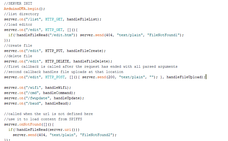

Ok tried it on a Wemos Node Mcu Lolin and it is the same. must be something i'm missing.
Had a play with the ino code to see if I can debug. Changed the 2 "file not found" messages to "filenotfound1" and "filenotfound2"
Now i'm getting a file not found 1 message when I try to access webpage.

Did you set maximum SPIFFS size?
Why not try command line?
Need these tools: Build
mkspiffs.exe -c C:\FSB\FSBrowser\Data\ -b 8192 -p 256 -s 600000 flash-spiffs.bin
Flash
python esptool.py --port COM1 --baud 115200 write_flash 0x100000 flash-spiffs.bin
