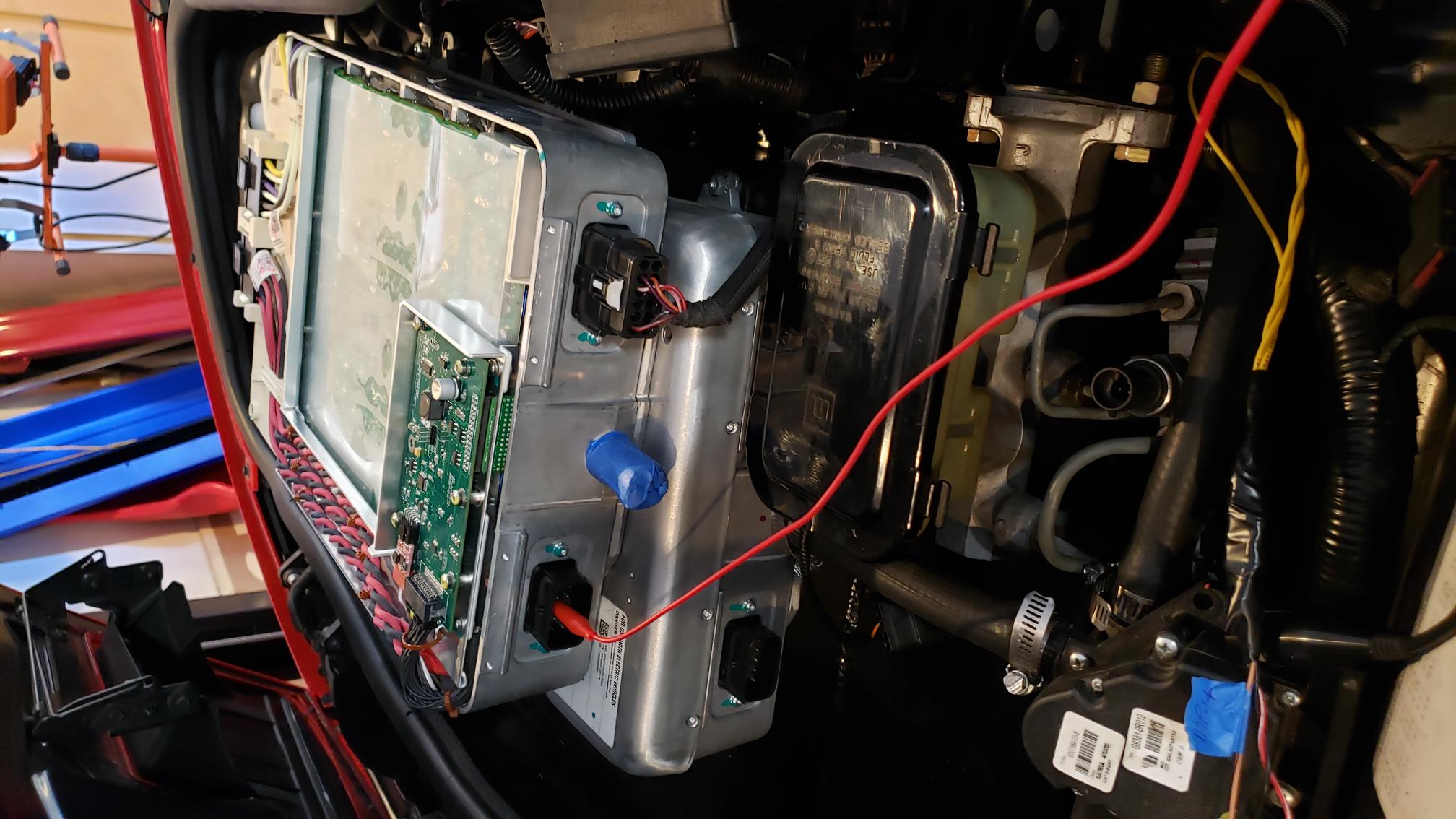

I finally got some time to work on my 944 Tesla project but I can't get more than ~120v coming out of my Gen 2 charger.
Here's my setup:
Gen2 charger with v5aB3 board
EVSE 32A 240v single phase external charger,
P85 Model S pack (all 16 modules) for ~400v.
On-board charger connected to the battery-side of the contactors.
The "Charging" light on the external charger is on when the charge port is connected to the car, and the 3 rails in the gen2 are each lit up with a single red led.
On the low voltage side of the Gen 2, I only have the following wires connected: CP, Proximity, +12v, Gnd, and Charge Enable connected. No CAN, as it seems like *every* component I bought is not compatible with any other component. stupid me.
I'm hoping someone can help me understand what I've screwed up to cause only ~120v to come out of the on-board unit.
EDIT: Running 1.06.R of the commercial firmware.

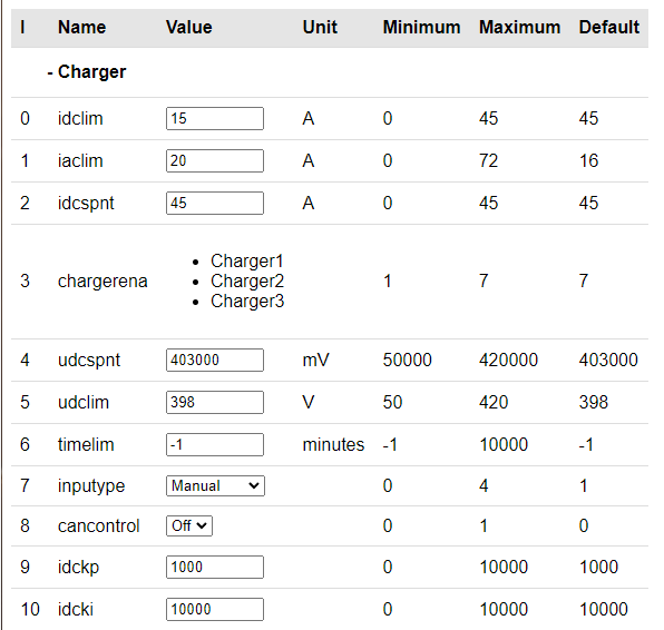

Here's my config:

I noticed your AC current limit is set to 20. I had some strange things happen with similar settingg. Can you correct it to 16?RandallATX wrote: ↑Tue Sep 13, 2022 11:29 pm I finally got some time to work on my 944 Tesla project but I can't get more than ~120v coming out of my Gen 2 charger.
Also you must connect HV battery for charger to work correctly.
- RandallATX
- Posts: 9
- Joined: Wed Aug 25, 2021 1:57 am
I will try that and report back. Thanks for the heads up.
Also, I do have the charger hooked up to the full 16 model S modules
- RandallATX
- Posts: 9
hot damn that did it. it also seems to be talking to the CAN quite well. my SOC shows 124% but there are worse problems. thank you.

"timelim": {"unit":"minutes","value":240.00,"isparam":true,"minimum":-1.00,"maximum":10000.00,"default":-1.00,"category":"Charger","i":6},
"inputype": {"unit":"0=Type2, 1=Type2-3P, 2=Type1, 3=Manual, 4=Manual-3P","value":2.00,"isparam":true,"minimum":0.00,"maximum":4.00,"default":1.00,"category":"Charger","i":7},
"cancontrol": {"unit":"0=Off, 1=On","value":0.00,"isparam":true,"minimum":0.00,"maximum":1.00,"default":0.00,"category":"Charger","i":8},
"enablepol": {"unit":"0=ActiveHigh, 1=ActiveLow","value":0.00,"isparam":true,"minimum":0.00,"maximum":1.00,"default":0.00,"category":"Charger","i":9},
"idckp": {"unit":"","value":1000.00,"isparam":true,"minimum":0.00,"maximum":10000.00,"default":1000.00,"category":"Charger","i":10},
"idcki": {"unit":"","value":10000.00,"isparam":true,"minimum":0.00,"maximum":10000.00,"default":10000.00,"category":"Charger","i":11},
"pin": {"unit":"","value":0.00,"isparam":true,"minimum":0.00,"maximum":67108863.00,"default":0.00,"category":"Charger","i":12},
"opmode": {"unit":"0=Off, 1=Run","value":0.00,"isparam":false},
"state": {"unit":"0=Off, 1=Enable, 2=Activate, 3=EVSEActivate, 4=Stop","value":0.00,"isparam":false},
"uptime": {"unit":"s","value":849.00,"isparam":false},
"version": {"unit":"4=1.07.R","value":4.00,"isparam":false},
"lasterr": {"unit":"0=NONE, 1=CHARGERCAN, 2=CHARGERFAULT, 3=EXTCAN,","value":0.00,"isparam":false},
"uaux": {"unit":"V","value":13.31,"isparam":false},
"aclim": {"unit":"A","value":0.00,"isparam":false},
"hwaclim": {"unit":"A","value":0.00,"isparam":false},
"modaclim": {"unit":"dig","value":0.00,"isparam":false},
"modcmd": {"unit":"dig","value":100.00,"isparam":false},
"cablelim": {"unit":"A","value":40.00,"isparam":false},
"evselim": {"unit":"A","value":15.59,"isparam":false},
"idc": {"unit":"A","value":0.00,"isparam":false},
"udc": {"unit":"V","value":0.00,"isparam":false},
"soc": {"unit":"%","value":0.00,"isparam":false},
"proximity": {"unit":"0=Off, 1=On","value":1.00,"isparam":false},
"enable": {"unit":"0=Off, 1=On","value":0.00,"isparam":false},
"canenable": {"unit":"0=Off, 1=On","value":0.00,"isparam":false},
"cpuload": {"unit":"%","value":0.00,"isparam":false},
"c1stt": {"unit":"","value":0.00,"isparam":false},
"c1flag": {"unit":"0=None, 1=Enabled, 2=Fault, 4=CheckAlive","value":0.00,"isparam":false},
"c1tmp1": {"unit":"°C","value":0.00,"isparam":false},
"c1tmp2": {"unit":"°C","value":0.00,"isparam":false},
"c1tmpin": {"unit":"°C","value":0.00,"isparam":false},
"c1uac": {"unit":"V","value":0.00,"isparam":false},
"c1iac": {"unit":"A","value":0.00,"isparam":false},
"c1udc": {"unit":"V","value":0.00,"isparam":false},
"c1idc": {"unit":"A","value":0.00,"isparam":false},
"c2stt": {"unit":"","value":0.00,"isparam":false},
"c2flag": {"unit":"0=None, 1=Enabled, 2=Fault, 4=CheckAlive","value":0.00,"isparam":false},
"c2tmp1": {"unit":"°C","value":0.00,"isparam":false},
"c2tmp2": {"unit":"°C","value":0.00,"isparam":false},
"c2tmpin": {"unit":"°C","value":0.00,"isparam":false},
"c2uac": {"unit":"V","value":0.00,"isparam":false},
"c2iac": {"unit":"A","value":0.00,"isparam":false},
"c2udc": {"unit":"V","value":0.00,"isparam":false},
"c2idc": {"unit":"A","value":0.00,"isparam":false},
"c3stt": {"unit":"","value":0.00,"isparam":false},
"c3flag": {"unit":"0=None, 1=Enabled, 2=Fault, 4=CheckAlive","value":0.00,"isparam":false},
"c3tmp1": {"unit":"°C","value":0.00,"isparam":false},
"c3tmp2": {"unit":"°C","value":0.00,"isparam":false},
"c3tmpin": {"unit":"°C","value":0.00,"isparam":false},
"c3uac": {"unit":"V","value":0.00,"isparam":false},
"c3iac": {"unit":"A","value":0.00,"isparam":false},
"c3udc": {"unit":"V","value":0.00,"isparam":false},
"c3idc": {"unit":"A","value":0.00,"isparam":false},
"serial": {"unit":"","value":"87184258:49548566:670FF54","isparam":false}

A view of us trying the second charger, feeding 12V to pin three to turn on power modules.

A bit more information.
The board is not outputting any of the required voltages on connector A. No "OUT2 - AC present" on pin A1, in other words. A6 has nothing either.
Thanks, in advance, for any suggestions you can offer.
