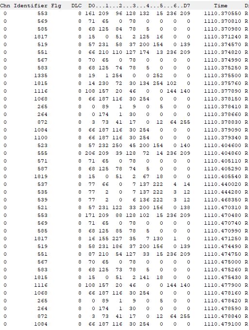

Finally got the CAN messages. Thanks for your patience.
We have the unit charging, however, PIN 1 is not outputting 12V when AC is present, so we are manually jumpering it to complete our BMS requirements.
Any ideas why PIN 1 is not outputting 12V?
Thanks, once again, for any suggestions you can offer.

By "Pin 1" are you referring to the AC Present signal? If so it will not output 12v. It, and all other, outputs on the board are low side switches. If you require a 12v ac present signal then use a relay with its coil switched from the relevant pin.
