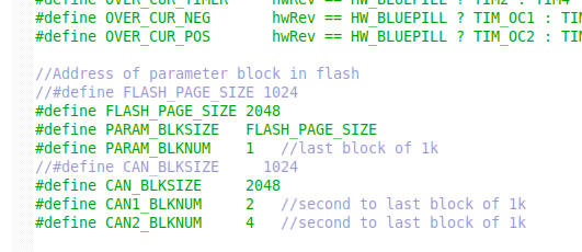

One thing that did seem to help yesterday was changing the page and can block sizes to 2k in hwdefs.h
Although it didnt fix the can mapping it did stop the processor hanging and rebooting. What seemd to take place then was akin to a memory leak where the can map kept growing until it reached the maximum number of allowed messages. All I can assume here is the code is looking for the canmap in the wrong place? Perhaps program space.

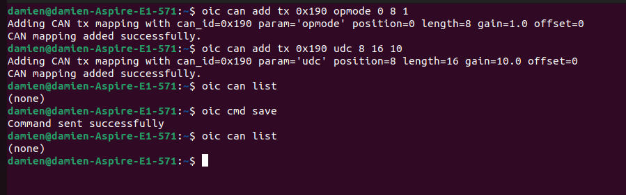

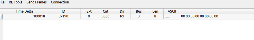

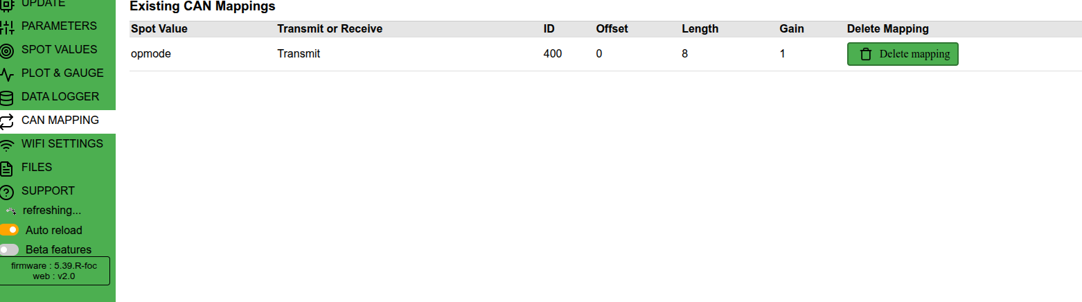

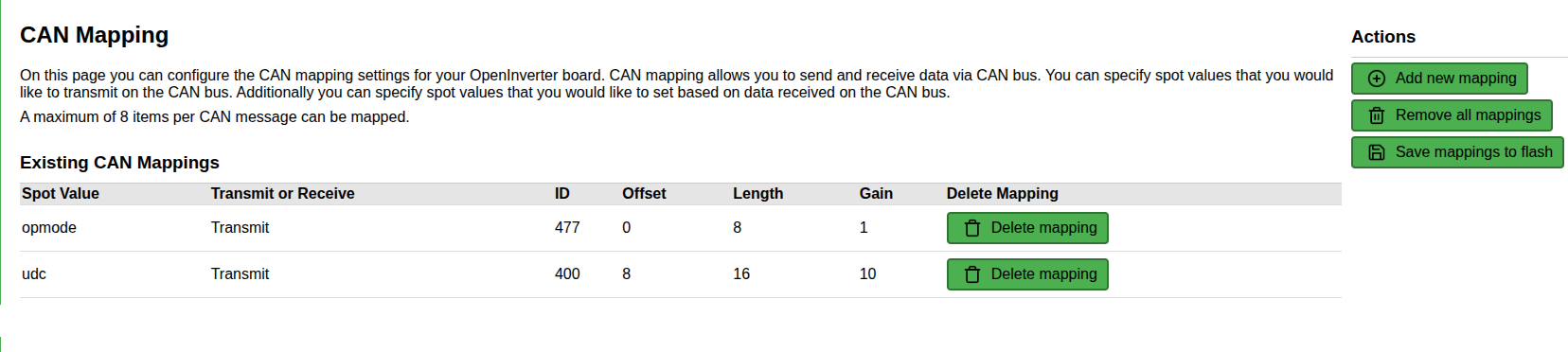

Little bit more diagnostics. Starting from a fresh firmware and no canmap I try adding opmode to be sent on id 400 (0x190). It displays as 477(0x1DD) and indeed sends on 0x1DD. If I now add a second parameter UDC to be sent on 400 (0x190) it displays as id 400 and indeed sends on id 400 (0x190). Now if I ht save canmap all hell breaks loose and the spamming starts. This seems to occur regardless of the version of libopeninv used. Be it the master head , the version Dave fixed or the version used by the ZombieVCU master.

I've checked the code again this morning and I believe it should work as johu described and automatically do the right thing irrespective of whether it is running on 1KB or 2KB flash page hardware.
The corruption of the CAN ID when adding a mapping is odd. Are you able to compare behaviour with the ESP8266/serial interface (assuming you are using the esp32-web-interface for CAN config at the moment)? Also doing the same with OpenInverter CAN Tool might be helpful. Something like:
You need to turn off the esp32 CAN interface when using OIC as you can only have one CANopen controller operating on the same bus at the same time.
Just had a thought: I wonder if it is blowing through its stack. The parm_save() function needs a lot of stack (1KB) for a temporary buffer. You can increase the size of the stack by editing stm32_sine.ld to use all the RAM in your part:
Edit: Wait, that's not going to work. Uhi22 and johu found a bug last year with the stack initialisation that hasn't been picked up by stm32-sine yet. Try:
This will pull in the fix they found for Focci. There's a lot more going on with the Tesla M3 gate drivers and oil pump compared to the regular stm32-sine.
oic can add tx 0x190 opmode 0 8 1
oic can add tx 0x190 udc 8 16 10
oic can list
oic cmd save
oic can list

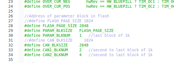

In order the changes I have made over standard STM32-FOC are
1)Change timings to have 8.8KHz pwm and resolver.
2)Activate DMA2 in order to use UART4 for LIN.
3)Change FLASH_PAGE_SIZE to 2048.

So for CAN:
uint32_t flashSize = desig_get_flash_size();
return FLASH_BASE + flashSize * 1024 - FLASH_PAGE_SIZE * CAN1_BLKNUM;
As Dave says neither CAN1_BLKSIZE not CAN2_BLKNUM play any role and if there's any mapping saved for CAN2 it would overwrite CAN1 (but only when saving to flash!).
Parameters:
//Always save parameters to last flash page
return FLASH_BASE + flashSize * 1024 - PARAM_BLKNUM * PARAM_BLKSIZE;
So far so good but now comes PinInit:
#define PINDEF_BLKNUM 3 //3rd to last flash page
#define PINDEF_BLKSIZE 1024
uint32_t pindefAddr = FLASH_BASE + flashSize * 1024 - PINDEF_BLKNUM * PINDEF_BLKSIZE;
And it thereby sits in the same 2nd to last 2k page as CAN1 mappings. So if you insist on using 2k for params and CAN1 then CAN1_BLKNUM would have to be 3. Even if you observe that this "fixes" something. It rather covers something up.
I'd rather suggest to leave FLASH_PAGE_SIZE at 1k because CAN1 mapping and params on the same page is handled in code.
However, none of that would result in the processor faulting out so that must be caused by something else. Currently it would check the CRC of the page invalidated by write_bootloader_pininit() and thus not load anything from flash.

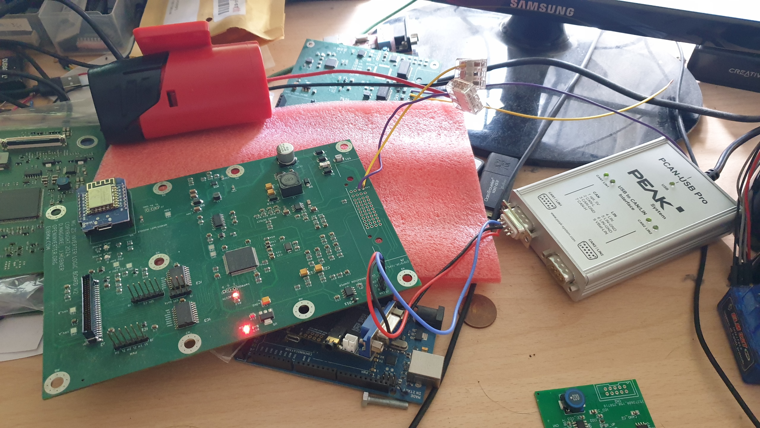

- Posts: 4007
- Been thanked: 1137 times
Starting off with a basic A-B test. Setup is an MG V2 board (same mcu as M3 board) , 12v from a drill battery , CAN and wifi. Loading the unmodified code from the MG-DU branch gives Normal operation of can and can mapping. Next up am going to do a clean build of the M3_DU branch and see what happens.

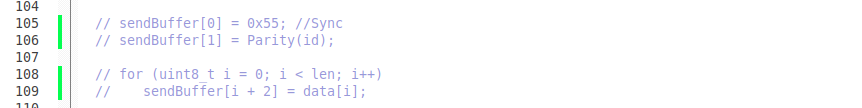

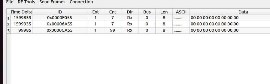

- Posts: 4007
If this line (272) in 10ms task in stm32_sine.cpp is commented out the canmapping behaves as normal.
Now to see why...
Now to see why...
- Screenshot from 2025-08-25 13-47-12.png (8.15 KiB) Viewed 1991 times
- Posts: 4007

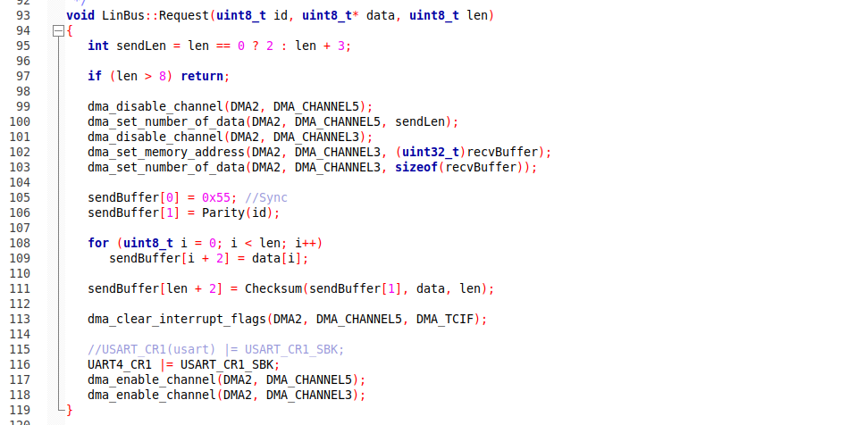

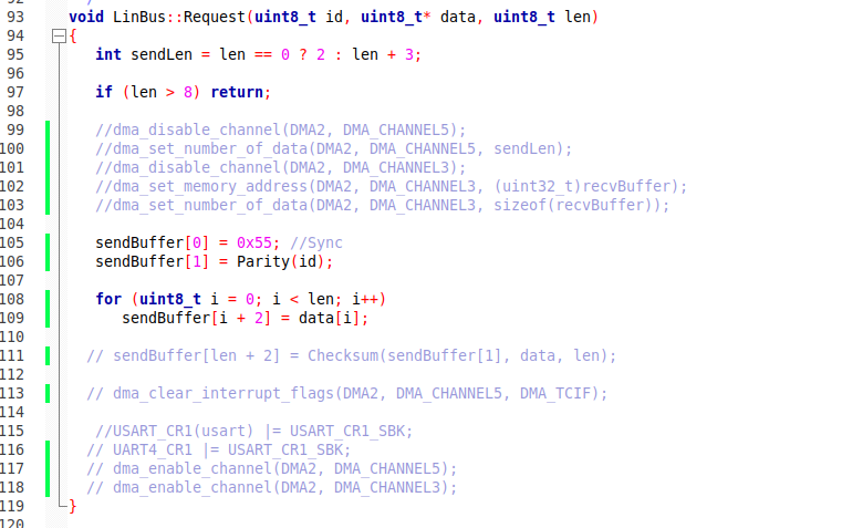

Narrowing further. Any call to LinBus:: Request will mess up the can mapping.
- Posts: 4007

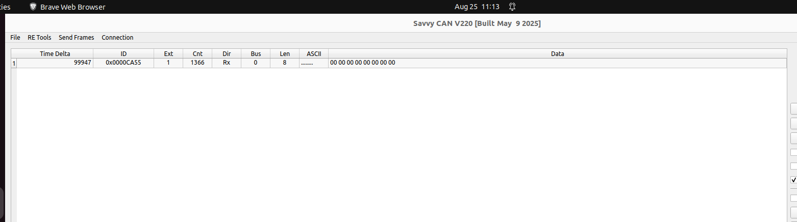

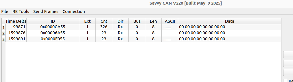

More narrowing. The junk can gets its id from lines 105 and 106 in LinBus::Request. So somehow, data being sent to and from the LIN peripheral is getting to the CAN peripheral via the map and/or DMA....
- Posts: 4007
DMA is innocent. Simply having the following in Lin request causes the problem.
davefiddes
- Posts: 416
- Has thanked: 206 times
- Been thanked: 257 times
First reaction was "Wut!?" but I think I can see what's gone wrong...
There's a use-after-free on your LinBus instance in stm32_sine.cpp:
If you shuffle the code to initialise the LinBus outside of the HW_TESLAM3 block it'll start working. I was going to move it anyway into the TeslaModel3 class (I think, implications need further thought) but no need to do that now.
Edit: The reason you see the data in CAN is because the memory that the LinBus pointer points to ends up being used by the Stm32Scheduler, Stm32Can, CanMap and maybe CanSdo class instances. When the 10ms handler runs is scribbles all over the internals of the CanMap class in an unpleasant way.
if (hwRev == HW_TESLAM3)
DigIo::gate_ps_en.Set();
uDelay(200000);
TeslaModel3::Initialize();
LinBus l(UART4, 19200);
lin=&l;
linM3.SetLinInterface(lin);
} // <------ the instance "l" is freed when this point is reached
Stm32Scheduler s(hwRev == HW_BLUEPILL ? TIM4 : TIM2); //We never exit main so it's ok to put it on stack
