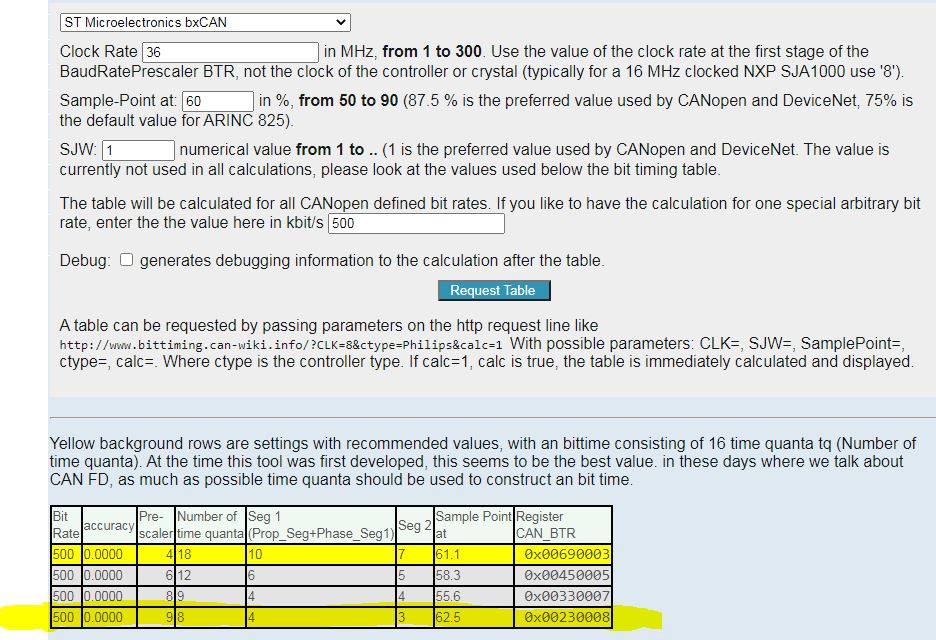

CAN Bus timing.
Since i needed another clock frequency i started the lovely journey of changing the CanBus timing.
What i found was this table:
//CAN TABLE FOR 72MHZ//36MHZ CAN HW BUS  SPEED
// static const CANSPEED canSpeed[Can::BaudLast] =
//    { CAN_BTR_TS1_9TQ, CAN_BTR_TS2_6TQ, 9 }, //250kbps
//    { CAN_BTR_TS1_[b]4[/b]TQ, CAN_BTR_TS2_[b]3[/b]TQ,[b] 9 [/b]}, //500kbps
//    { CAN_BTR_TS1_5TQ, CAN_BTR_TS2_3TQ, 5 }, //800kbps
//    { CAN_BTR_TS1_6TQ, CAN_BTR_TS2_5TQ, 3 }, //1000kbps
Now in order to have the new data in. I needed a tool so i found one at: http://www.bittiming.can-wiki.info/
If i fill in 60% i indeed find this, i focust on 500K for now:
Question: Why are we using 60%? and not a bit higher?
