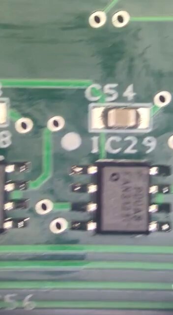

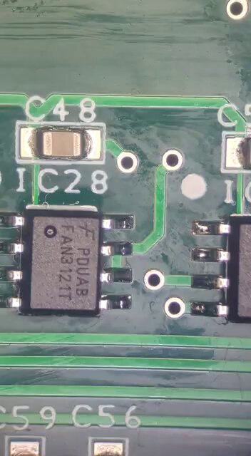

That all looks sensible. Last question. Can you please take a high res photo of the ICs you fitted to the board.

Just need a few pictures of the ics fitted by yourself.

As requested

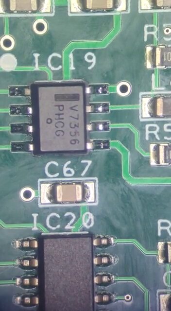

Also IC27,29 and 19 please.

Last attachment should have been a 30 second video.
Beemer
Posts: 26
Joined: Sun Sep 25, 2022 8:22 pm
Re: ZombieVerter VCU Support
Post by Beemer »
As requested

IC19

That all looks perfect thanks. There seems to be no obvious reason other than a wiring error to cause this problem. I think next step is to get the board back to me for a deeper look.

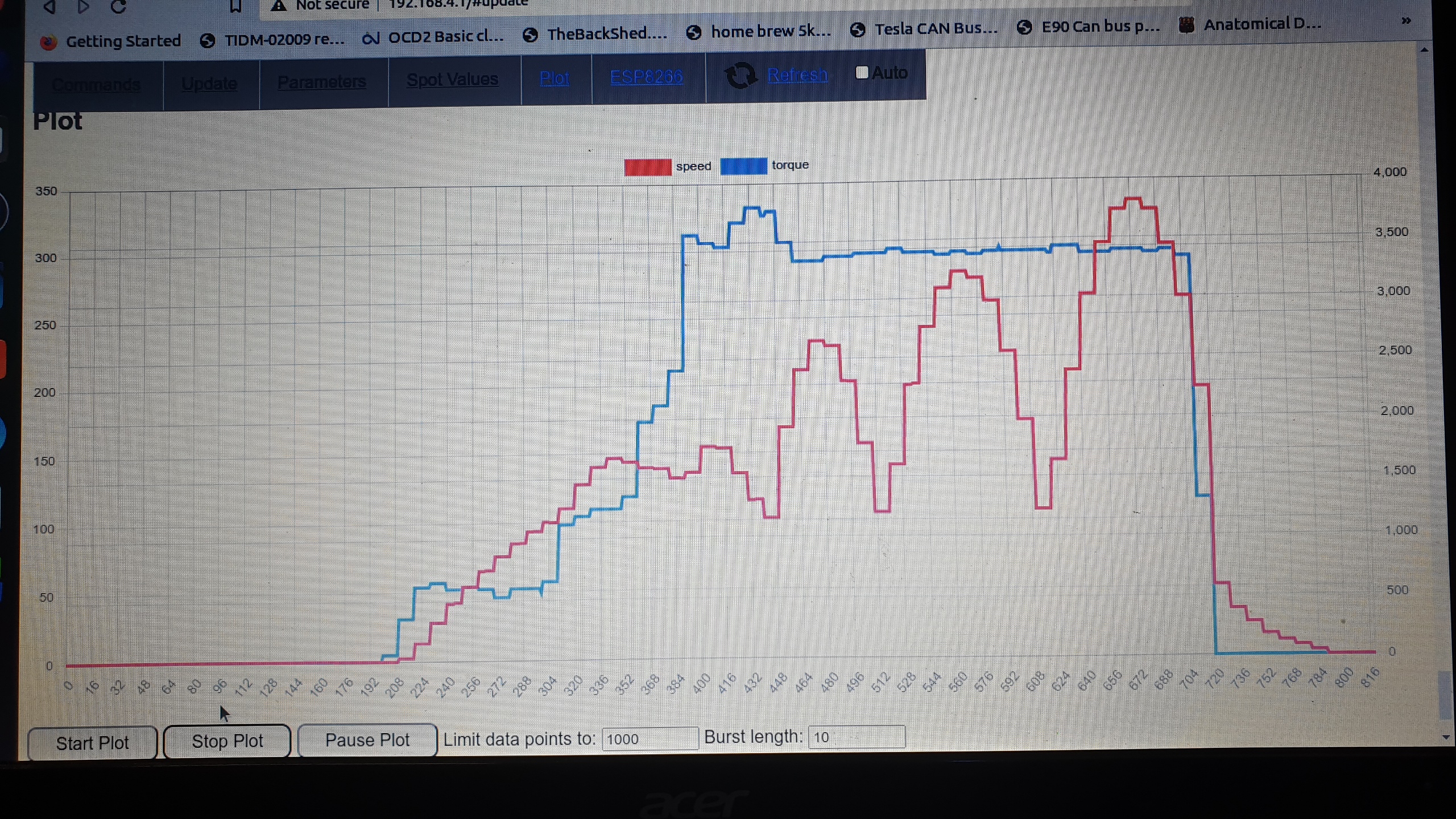

Right, I can confirm that it's not really drivable now! Sort of on/off pulses as you accelerate? I can upload a video if you want.
I'll try to debug this, but can you give me a baseline for what should be working:
Regen: I see the new settings for it, but it still doesn't actually do regen. Should it?
Throttle ramp: Still a pretty aggressive and linear ramp, I've played with throtramp and throtramprpm, they seem to have no effect - should they?
Cheers.
Oops, I hadn't refreshed to see your update - I'll try the new new version!
EDIT: starting again, version 1.01 A now!
Unfortunately I still have the same result - intermittent pulses of power. Not like in your video (It was smooth like that previously though).
What am I doing wrong? I attached the parameters.
Final edit: I get the same behaviour with your .hex from the repo.

I got the VCU board back from Beemer. A Fan3121 has been fitted in position IC12 in place of the NCV8461. This kit would have shipped without the NCV8461 in any event as they were not available until about a week ago. This would have fed 12v into the 3v3 line and destroyed the microcontroller as well as most other devices I would imagine. Whoever fitted the parts failed to verify the positions on the schematic and BOM for IC12.
I just verified the BOM and schematic are correct :

The difficulty I have is I can't replicate that problem. I bench tested this firmware and then built the drivetrain into a car and took it on the road. Not sure what else I can do. This morning I went 40 miles in the E39 with no problems. Car is on charge right now as it happens. I'm in now way saying there is not a problem its simply that I cant see it here and I've exhausted my options for testing. Perhaps someone else could do some diagnostics and help us all out ???

Lets try this : Do a plot of speed and torque. Speed on right and torque on left.

Jack Bauer wrote: Tue Nov 15, 2022 1:42 pm Lets try this : Do a plot of speed and torque. Speed on right and torque on left.
Will do this tomorrow (I actually did it today but didn't capture it - it did show roughly the same as your plot above though).
Assuming the .hex on github is the same one you are using, I guess the only difference should be a setting. I am using "none" as the car type for example. I will try to debug it anyway.
