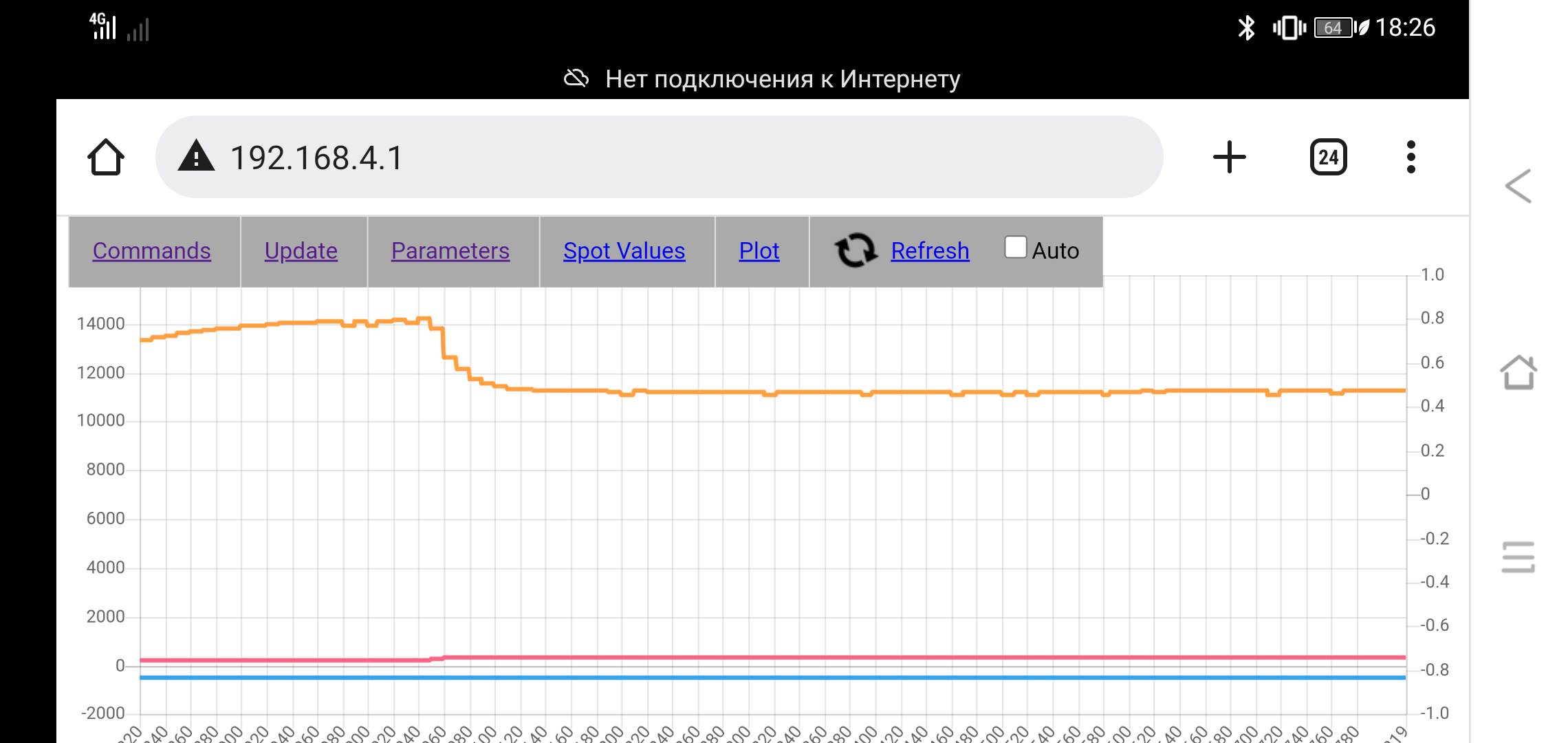

recently, with the wheels removed, I checked the latest firmware from a voltage of 120 volts (motor leaf gen 2) I tried increasing the fw from -100 to -500. at -500, I got a furious acceleration up to 14000 rpm and was not reset by pressing the brake. even when I turned on the neutral, the speed dropped to 12000 rpm and only stopped the power off for the controller.
I don't know if it's important or not, but I decided to let you know.
If this had happened in motion, my car would have raced like a horse at a speed of 200 + km / h.
At the same time, a limit of 400 Hz is set. It seems to me that it is very important to get real speed limits from the controller according to the fmax line in all modes. it is especially scary to set up an syncofs, there is always a motor accelerates to breakneck speeds even from 25 volts
