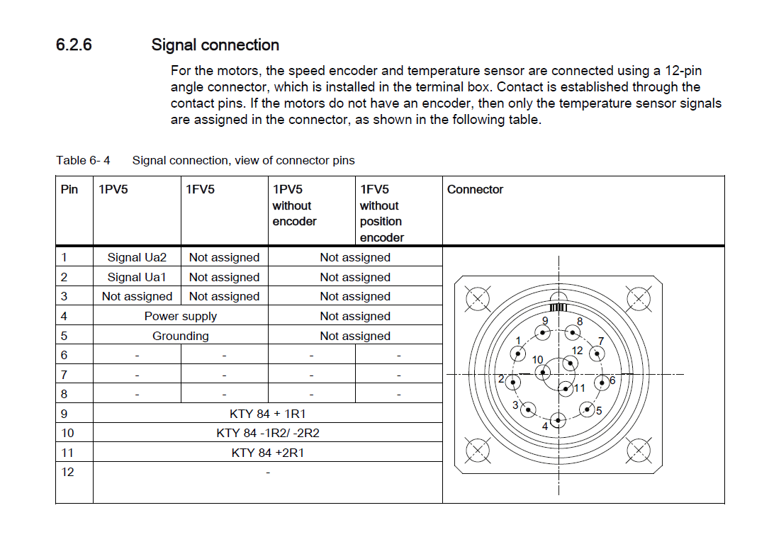

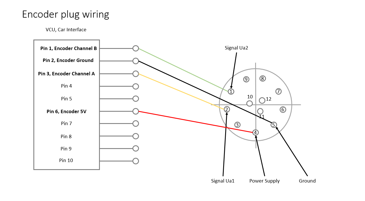

A while back I was able to successfully spin my Siemens ACIM in manual mode with the Prius Gen2 and V1 of the adapter board. I'm now attempting to connect the encoder and throttle. As always I'm having some difficulty, and would greatly appreciate any help!
Here's what I've done:
1. Solder closed the jumpers SJ1 and SJ2 on the back of the board.
2. Selected "AB" in encmode in the vcu interface
3. Wired the encoder as shown in the diagram below
4. Started the motor in manual mode, turned the output shaft by hand, and plotted the angle to see what happens
What I've discovered is that even when the encoder plug is NOT connected, the angle cycles from ~10 degrees to ~350 degrees of its own accord.
No encoder connected, no movement in the output shaft, but the angle shown in the VCU continues to change.
When I do connect the encoder, the behaviour is exactly the same.
Any ideas what might be a miss? I don't know if anybody else is using an ACIM or an encoder motor for their Prius project.
If I can just get the motor spinning under throttle control I can finally justify the most fun part of the project - tearing the ice parts out of the jeep!

no issue so far, you're seeing slip. When in manual mode set fslipspnt=0

Thanks Johu, that makes sense.
I've just gone out and tested in manual mode again.
Setting fslipsnt to 0 fixes that problem.
I'm still doing something wrong though, as now when I connect the plug and turn the output shaft of the motor there is no change in the angle value.
I disassembled the encoder plug to check the connections, looks like they're fine.
Am I missing something obvious?
I don't have HV applied to the inverter or phases connected to the motor.
I'm not using shielded wire and there's no noise at all on the angle reading, it stays fixed at the same value.
Thanks again!

Isaac96
- Posts: 656
Hmm.
You can use a voltmeter to do some testing of an encoder.
With it hooked up and powered on, stick the meter between a channel and ground. Turn the motor a bit and you should see a change (might go high to low and then back, but some change should be visible).
I assume SJ1 and SJ2 are for pullups?

Thanks for this Isaac. I was away for 10 days so just got the chance to test that this evening.Isaac96 wrote: ↑Sat Feb 19, 2022 1:59 am Hmm.
I wasn't getting any change in voltage between GND and either channel.
The voltage was just 3.57v across 5V and GND, so I reckoned that was a bit low.
The motor's manual says the encoder needs between 5v and 20v, so I connected a second 12v battery directly to the encoder using a 12v bulb as a current limiter.
This worked better, and the voltage values between GND and the channels changed as I turned the motor shaft doing test you suggested.
From my understanding, I need to use the 5v and GND on the board to get encoder readings on the VCU interface.
I can't do that yet though, as the voltage supply from the board is too low for the encoder to function.
Is there any reason for the low voltage from the VCU output? Something to do with the jumpers? It's a first edition board, and I know a resistor needs to be added to these ones for the temp sensor. Is something else needed for encoder pull up too?
