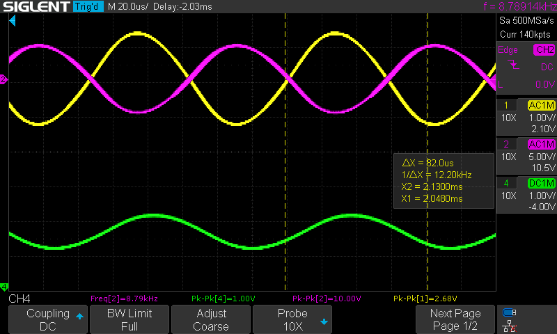

Thanks. Looks like you're pretty close.

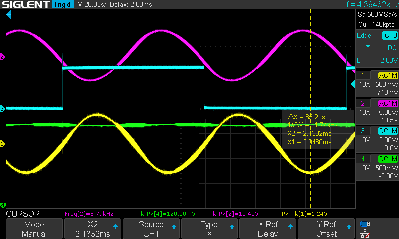

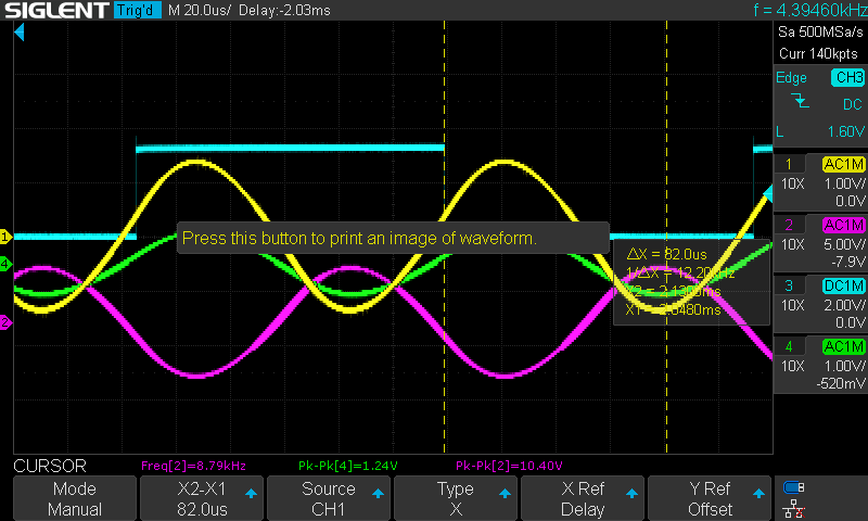

The sample is actually scheduled from the trailing edge of the cyan trace. This measures as 82 uSec. Which is a shift from the 40 uSec used at 4.4kHz. I hope there is enough time for the injected conversion to complete before the resolver code reads the value on the rising edge of the cyan trace.
Fixing up the filter has improved the output from the resolver markedly though.
I've mounted the resolver in my motor but it just produces garbage data until I fix the timing. The ADC is very noisy on the V1 board too (as previously noted). I measured 250mV ripple on the VDDA pin without a functioning gate driver PSU. :-|

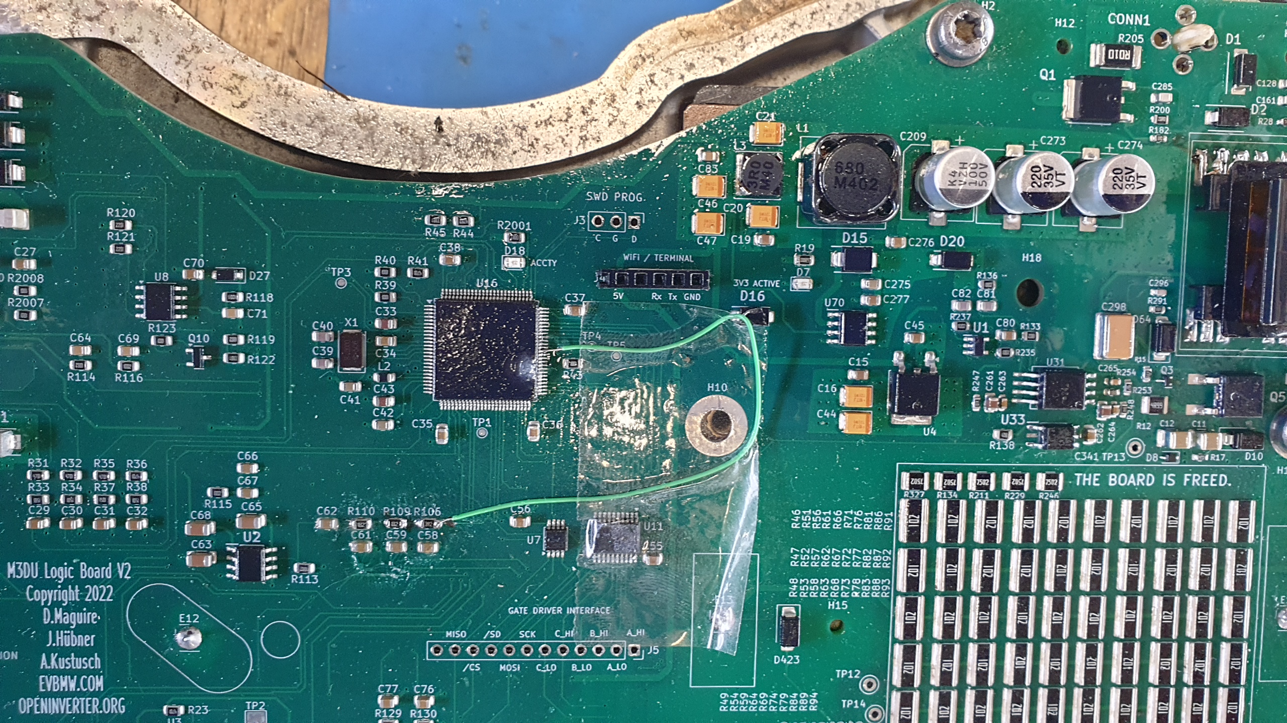

I'm planning on removing the 3.3V regulator and bodging in a linear regulator. Hopefully that'll clean things up.

davefiddes wrote: Tue Sep 09, 2025 6:33 pm The ADC is very noisy on the V1 board too (as previously noted). I measured 250mV ripple on the VDDA pin without a functioning gate driver PSU.
You can try to add copper straps from ground pads to the mounting holes, for example with solder wick. The more the better.
Important areas are the ground connection(s) on the 30 pin connector (or whereever you have your power supply connected) and around the gate driver supply.

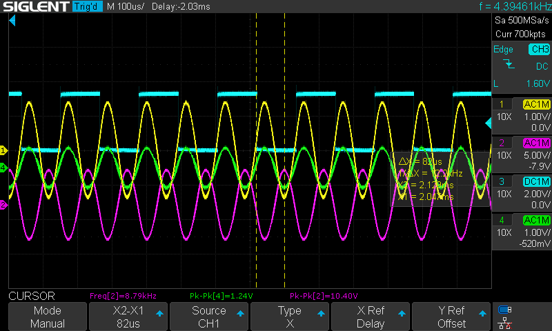

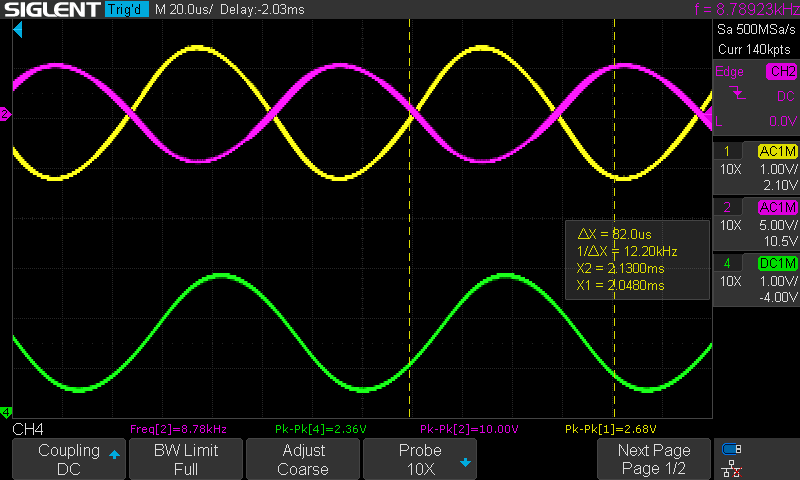

Not very fruitful day. Hey ho. Some combination of removing U22 and replacing with an LD1117 and U6 (for good luck) and joining up the unconnected holes with 2.5^2 copper has quietened things up nicely.

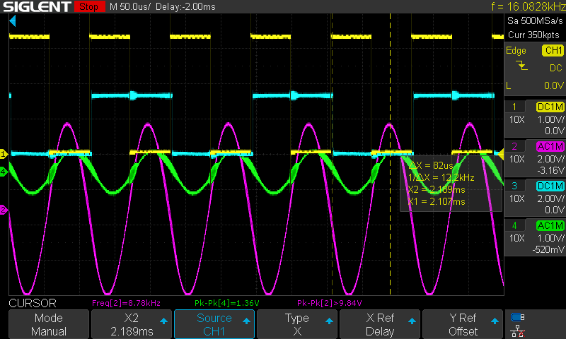

Some very clean signals going to/coming from the resolver:
Cyan is main control loop with the dotted line being the sample delay. Yellow is the sine and green the cosine signals with purple being the exciter.
Zooming out a bit things still look good:
Every cycle is identical and the hit-one-miss-one sampling looks like it should deliver a stable answer for a static motor.
The signals heading into the ADC look good to me. Biasing is correct and the amplitude is fine (e.g. sine 2.40V pk-pk and cosine 1.04V pk-pk):
Obviously a software problem right!? Apart from fixing the exact timing the sample is taken I've not changed any of the non-initialisation resolver code at all. Need to sleep on it and go again tomorrow.

Post by davefiddes »

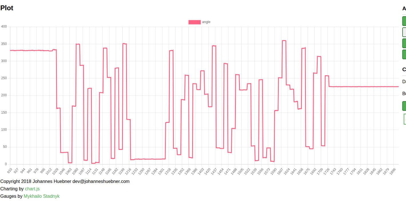

Face palm. Assumptions will make an ass of you and me...

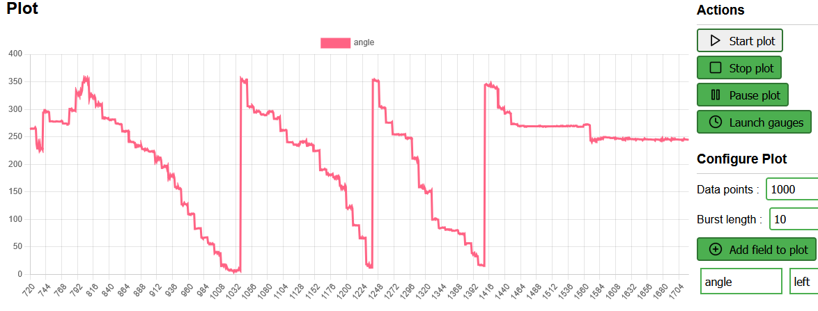

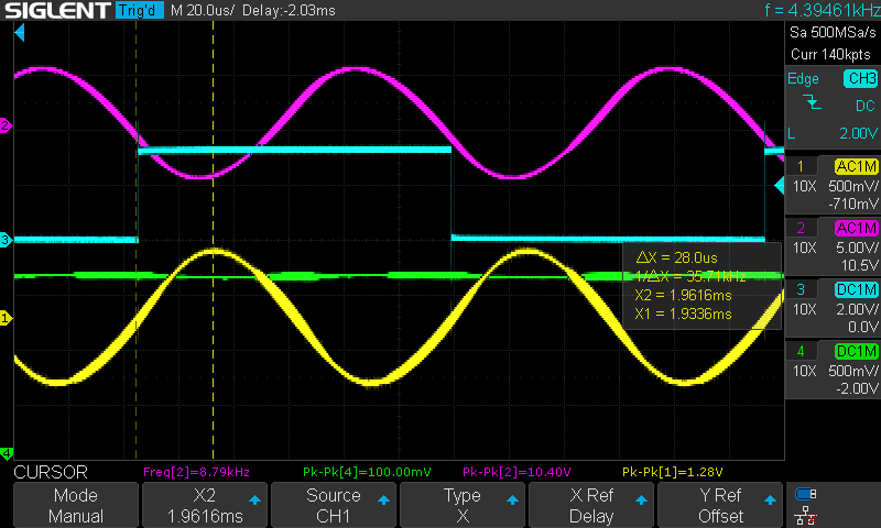

When operating at a fixed 4.4kHz control loop and exciter loop the time between the falling edge of the exciter and the peak of the exciter sine wave is 40 uSec. On the rising edge it is assumed to be symetrical at 40 uSec. This falls apart when the exciter is running at 8.8kHz and the control loop at 4.4kHz. The falling edge needs to wait 85 uSec before sampling but the rising edge only 28 uSec. In other words 1/2 a wavelength less.
Fix that and I stop getting garbage data. Here's a plot of the angle as I walk an uncalibrated nut round the resolver ring then hold it steady:
Just need to clean up the code and add a new resolver type.

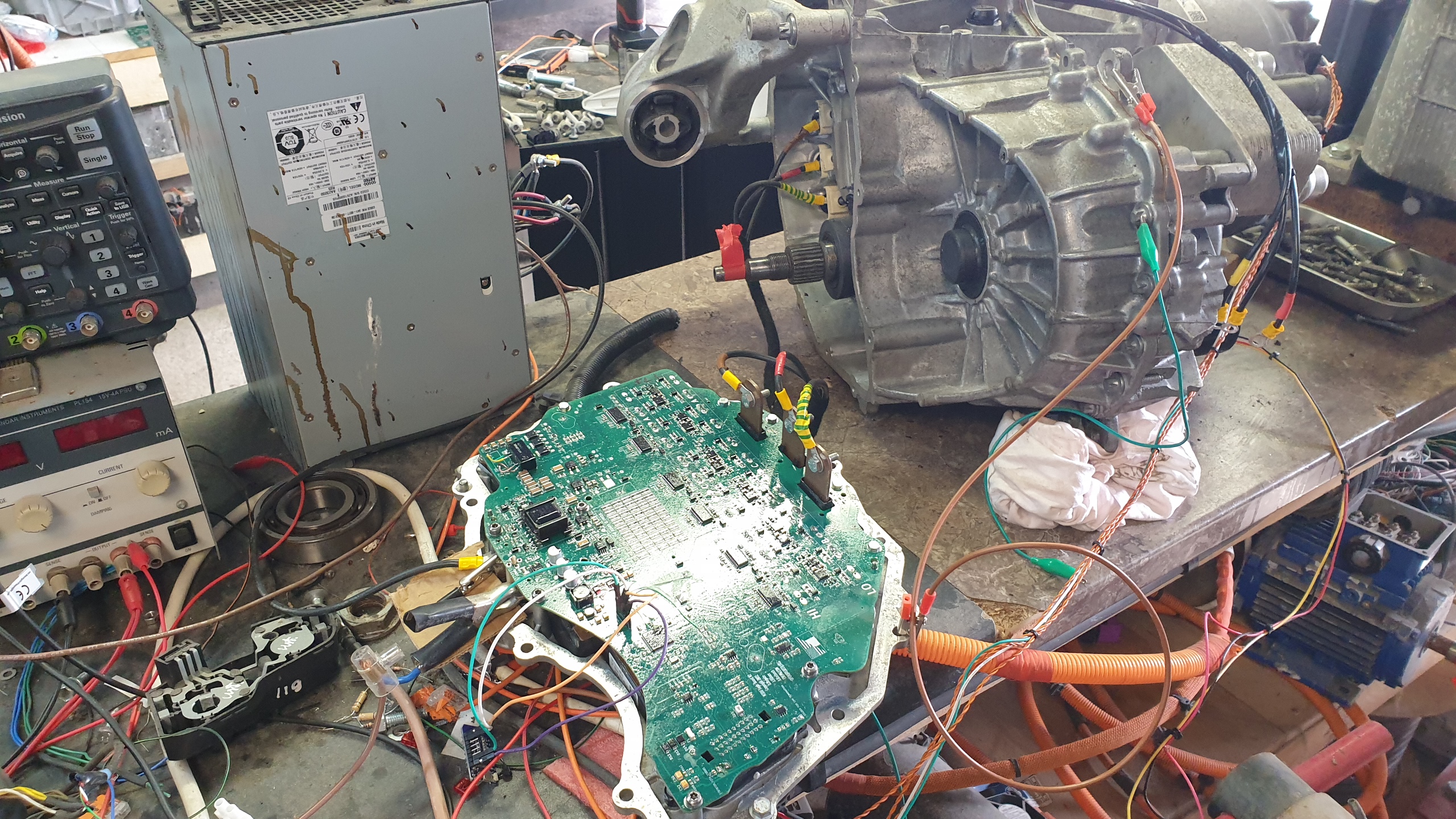

Posts: 4007
Been thanked: 1137 times
Ok so I pulled the inverter from the car , loaded in Dave's firmware. Only problem was it detected the hardware as a minimainboard so I just added a bodge line to
static HWREV ReadVariantResistor()
return HW_TESLAM3;
After that all was well, I cut the track from PD2 to R106 and added the wire from PC6 to R106. All those years spent chipping game consoles came in handy. Connected up to my bench motor , hit the throttle and away it goes.

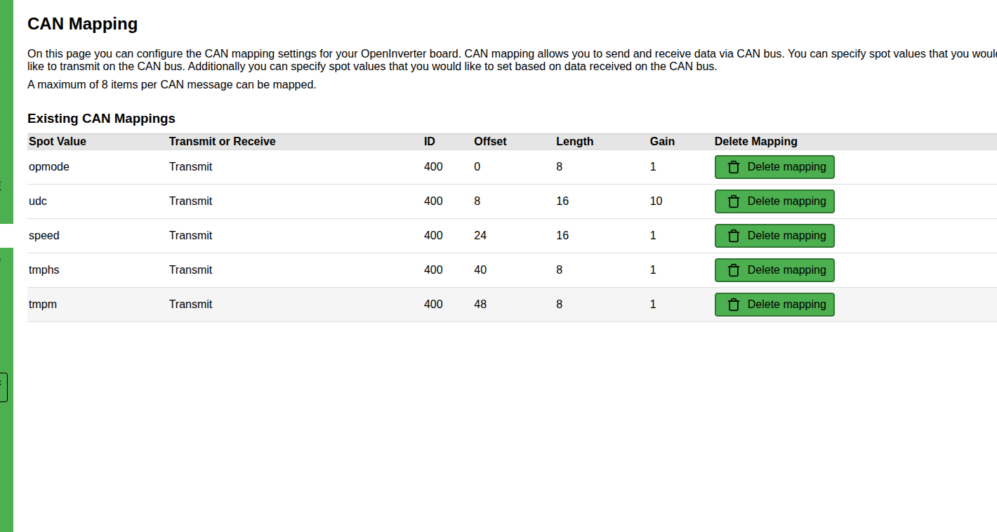

One observation is the web interface is a LOT more stable now. I'm going to hookup to CAN next and see if the mapping works etc.
Thank you Dave.

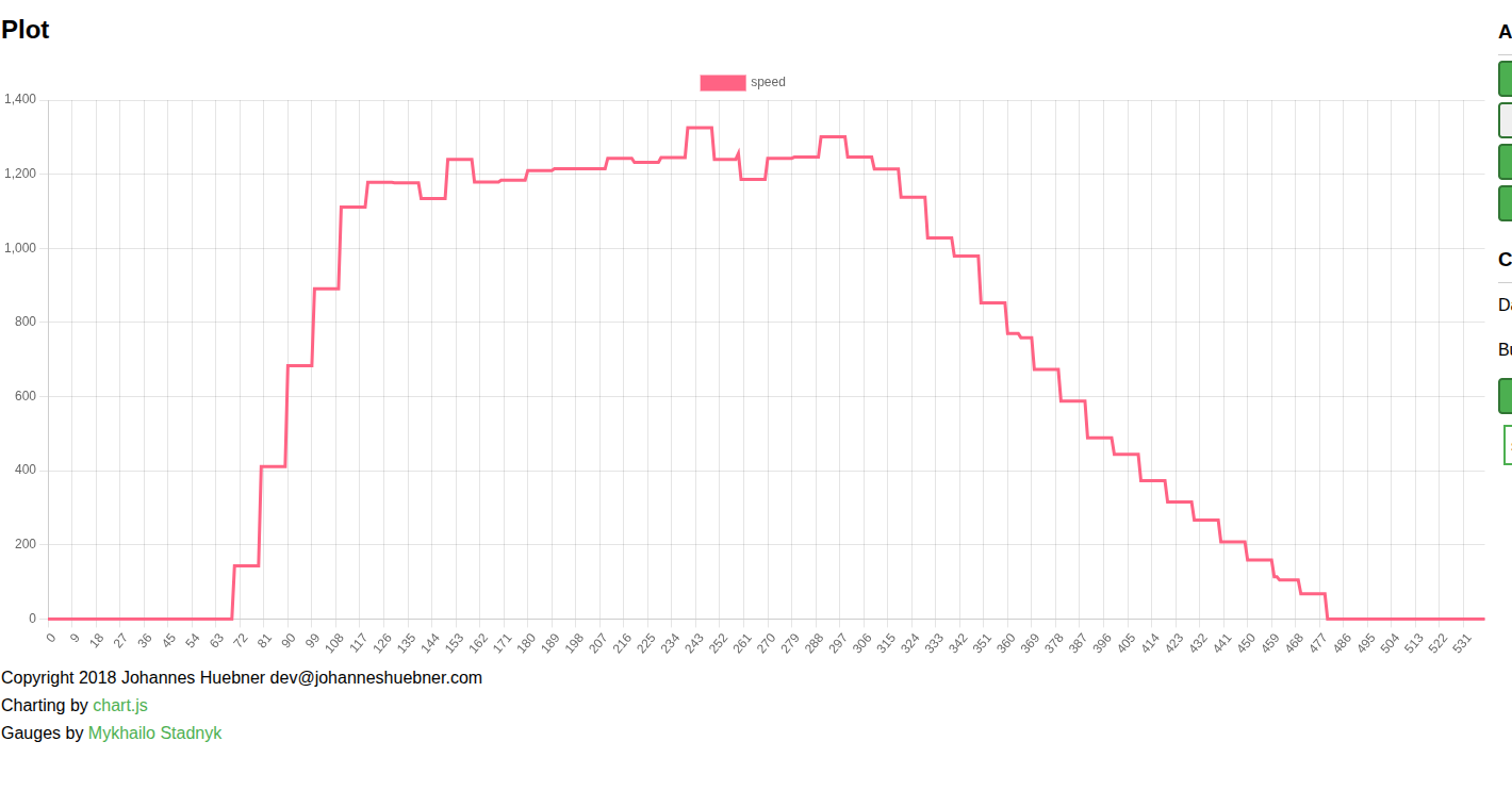

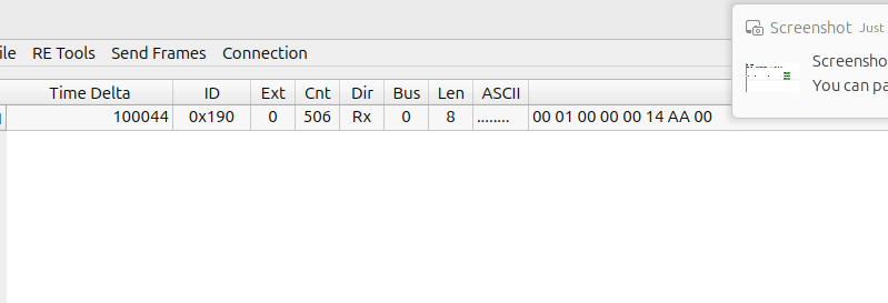

I don't have debug setup on the stlink and codeblocks yet. Will try to get it sorted. Meanwhile can mapping and OIC working perfectly.

Excellent news on the CAN mapping front.

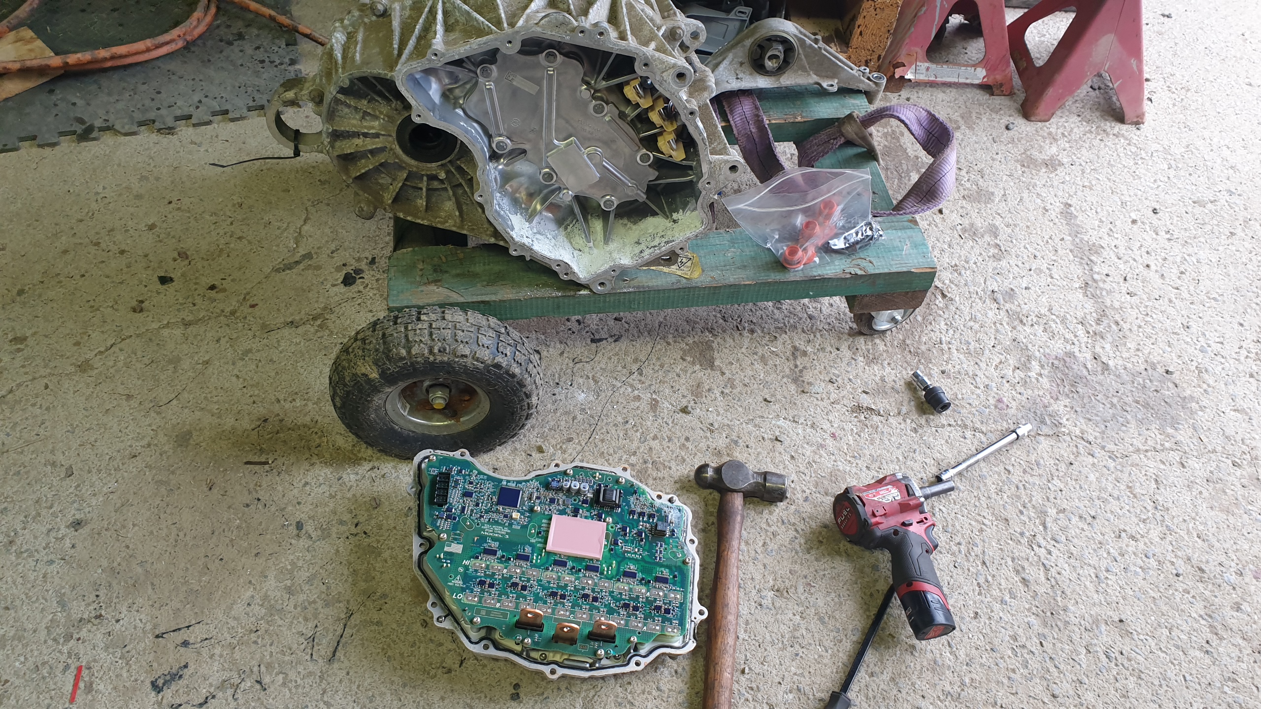

Posts: 4007

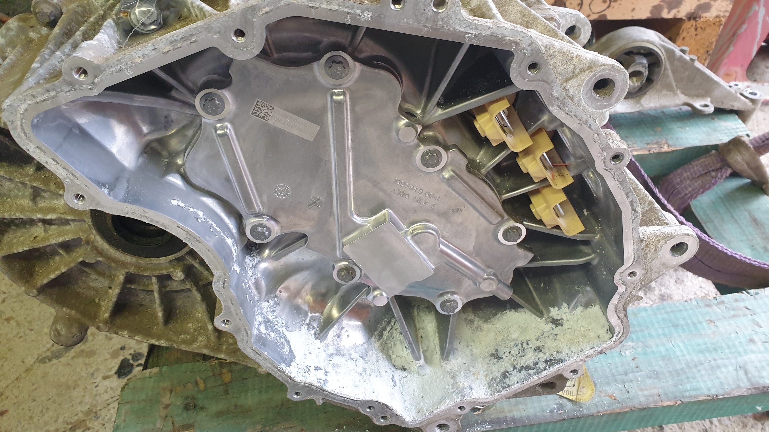

Got the front drive unit inverter off. Will grab a gate spi log tomorrow. Tempted to see if I can spin it with the rear inverter while I have it off the car. Not sure how the sine firmware deals with resolver though...
davefiddes
Posts: 416
Has thanked: 206 times
Been thanked: 257 times

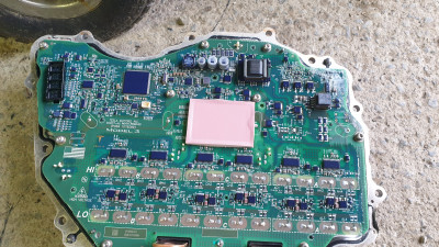

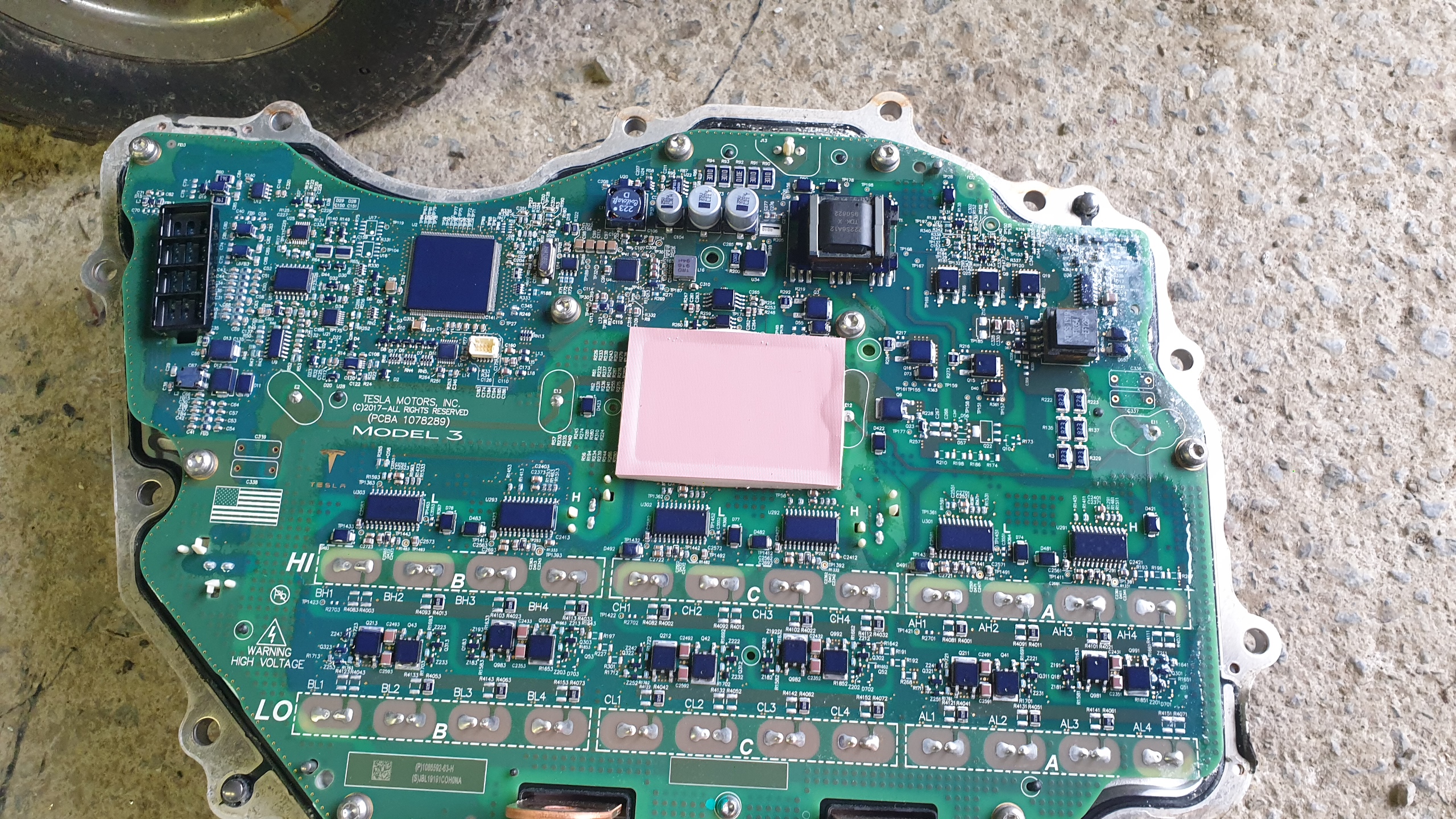

That's properly crusty in places. I may be going senile but the inverter board looks like a spitting image of my RDU board. It's the same PCBA at least. IIRC the first FDU board you had was missing all sorts of components around the "viper" HV gate driver supply. They clearly thought they were necessary at this point. Curious.

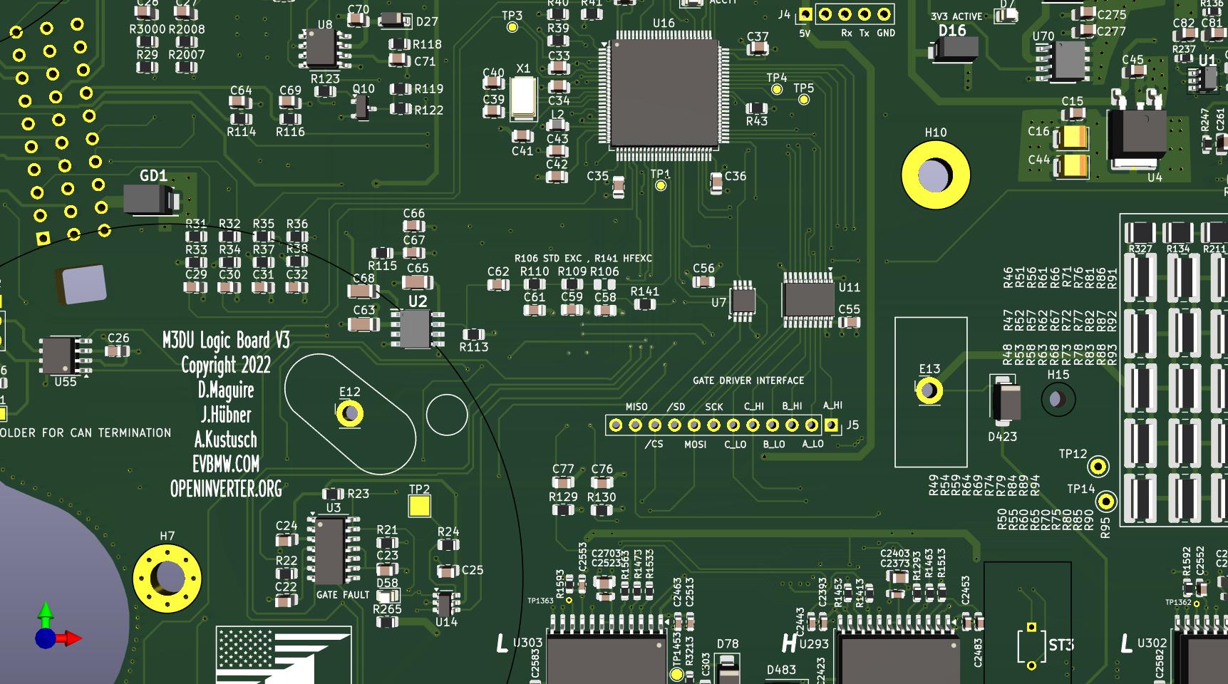

Posts: 4007
V3 board layout with option for HF or standard exciter. Will test board detection tomorrow. Sorry Dave got sidetracked today.

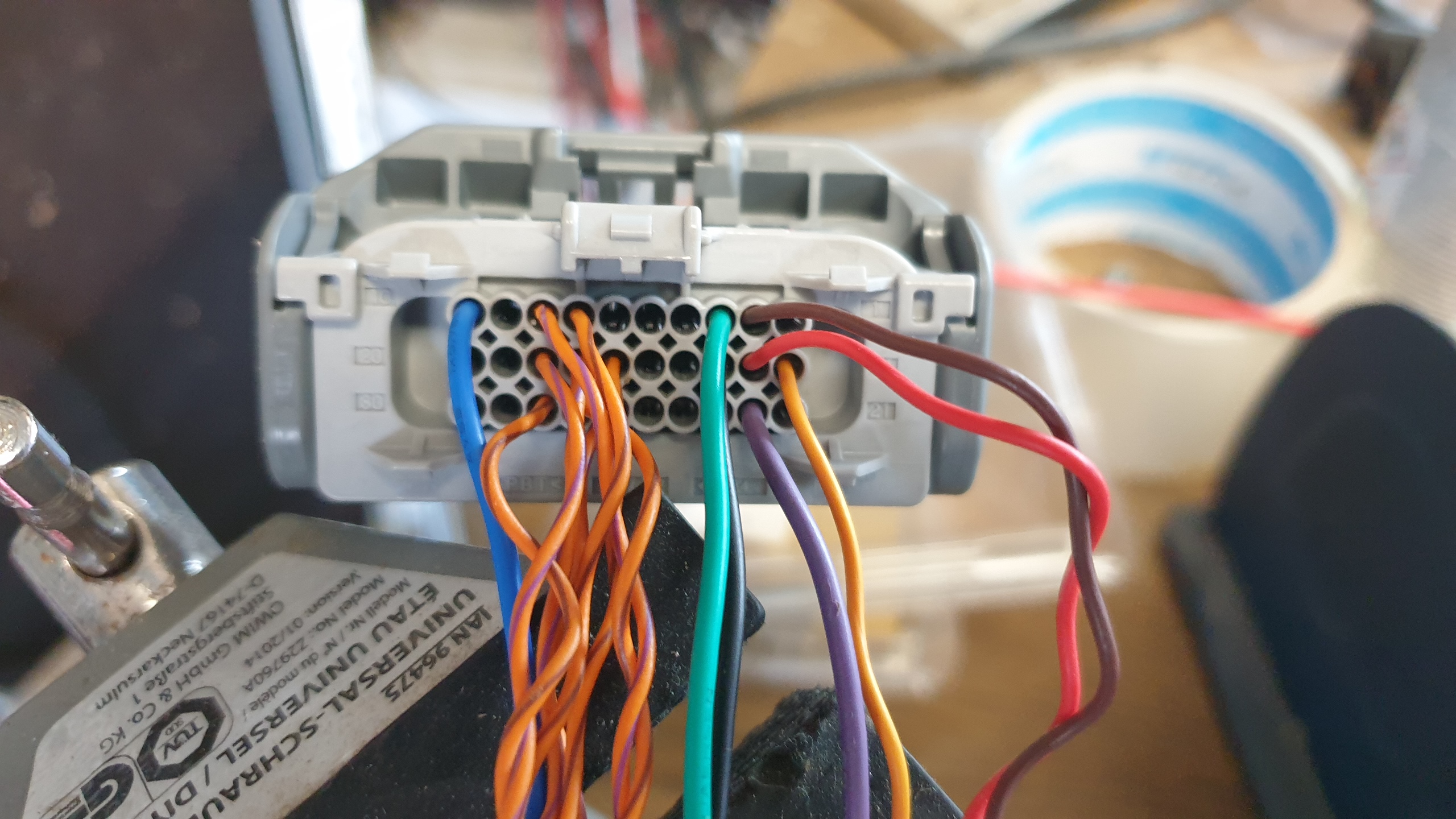

Posts: 4007
Got the inverter back in the car today. Tomorrow will be HV wiring day hopefully. Also made up a drive unit loom. Not super exciting but is exact same pin usage as OEM so an OEM harness can be used if wanted. In the picture the bundle of orange twisted pairs in the middle are the 6 resolver and 2 motor temp wires , Blue in the top left is oil pump LIN , Green is T15 , Brown and red , CANL and CANH, orange brake pedal , Purple 12v permanent and black is ground.
