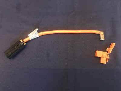

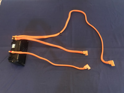

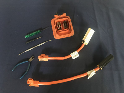

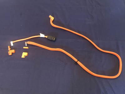

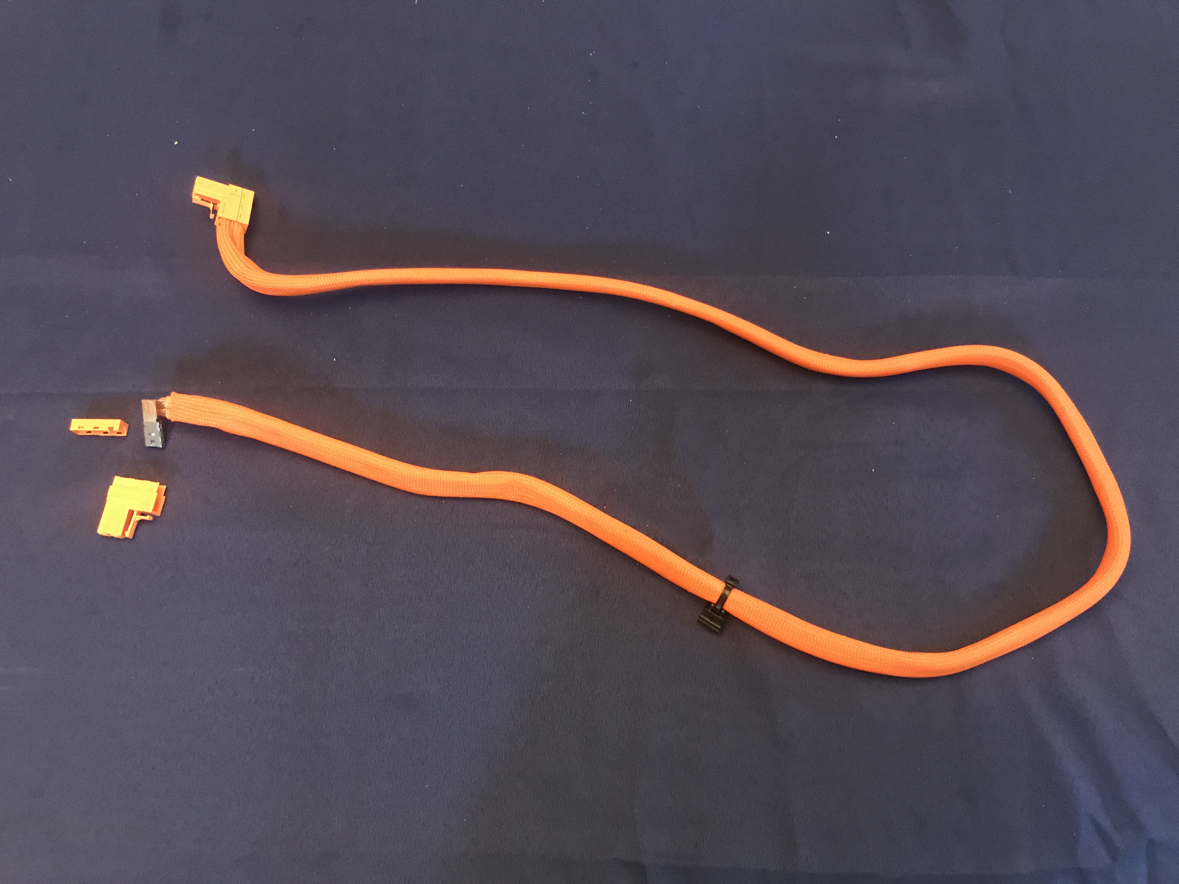

I also did a write up on BMW Hybrid Battery Cable Connectors Reconfigured Rekeyed
in order to eliminate the OEM output plug (one less connection to worry about)
so I'll just post some highlight pics here

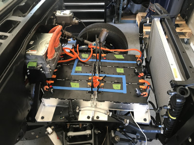

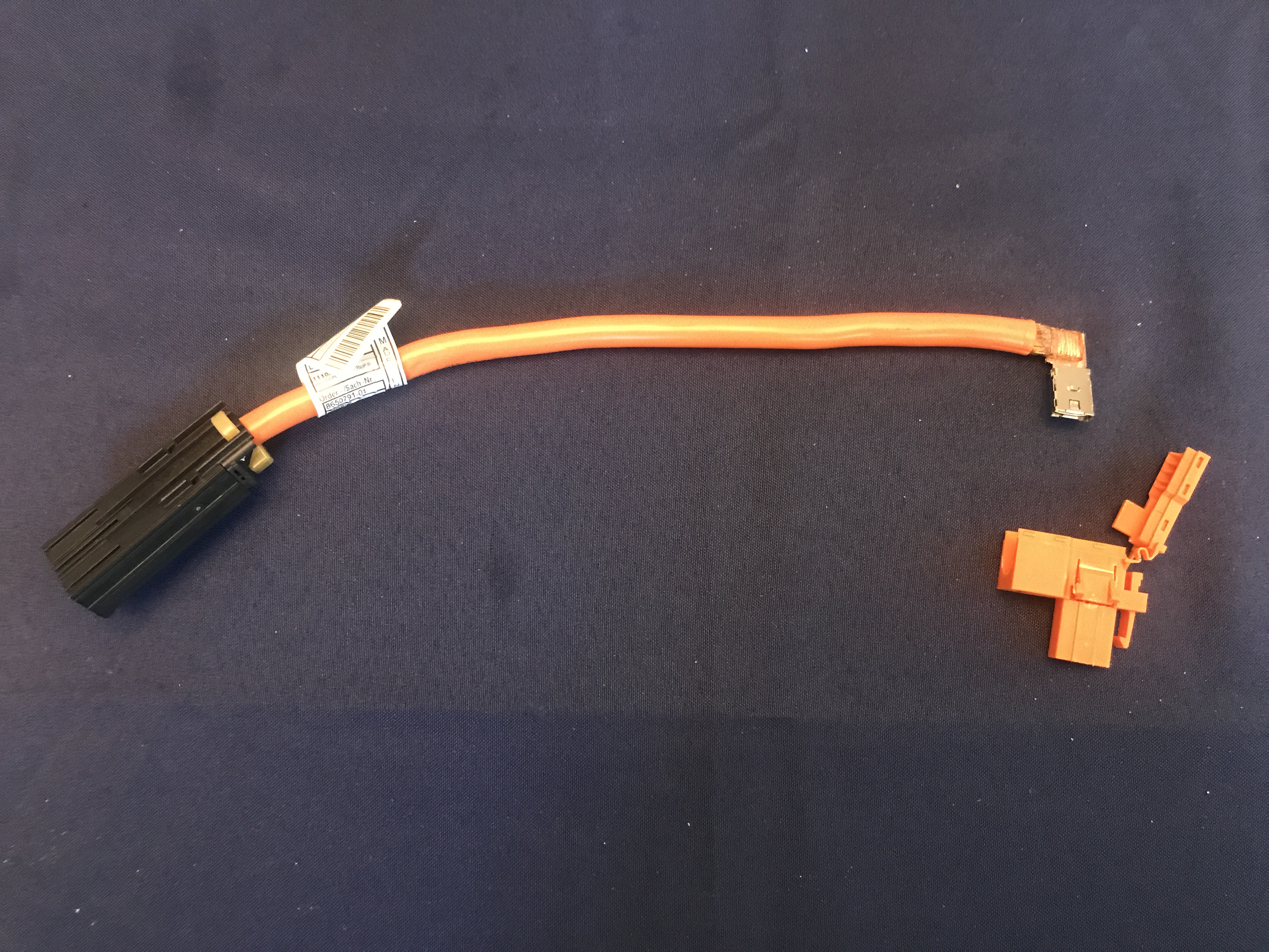

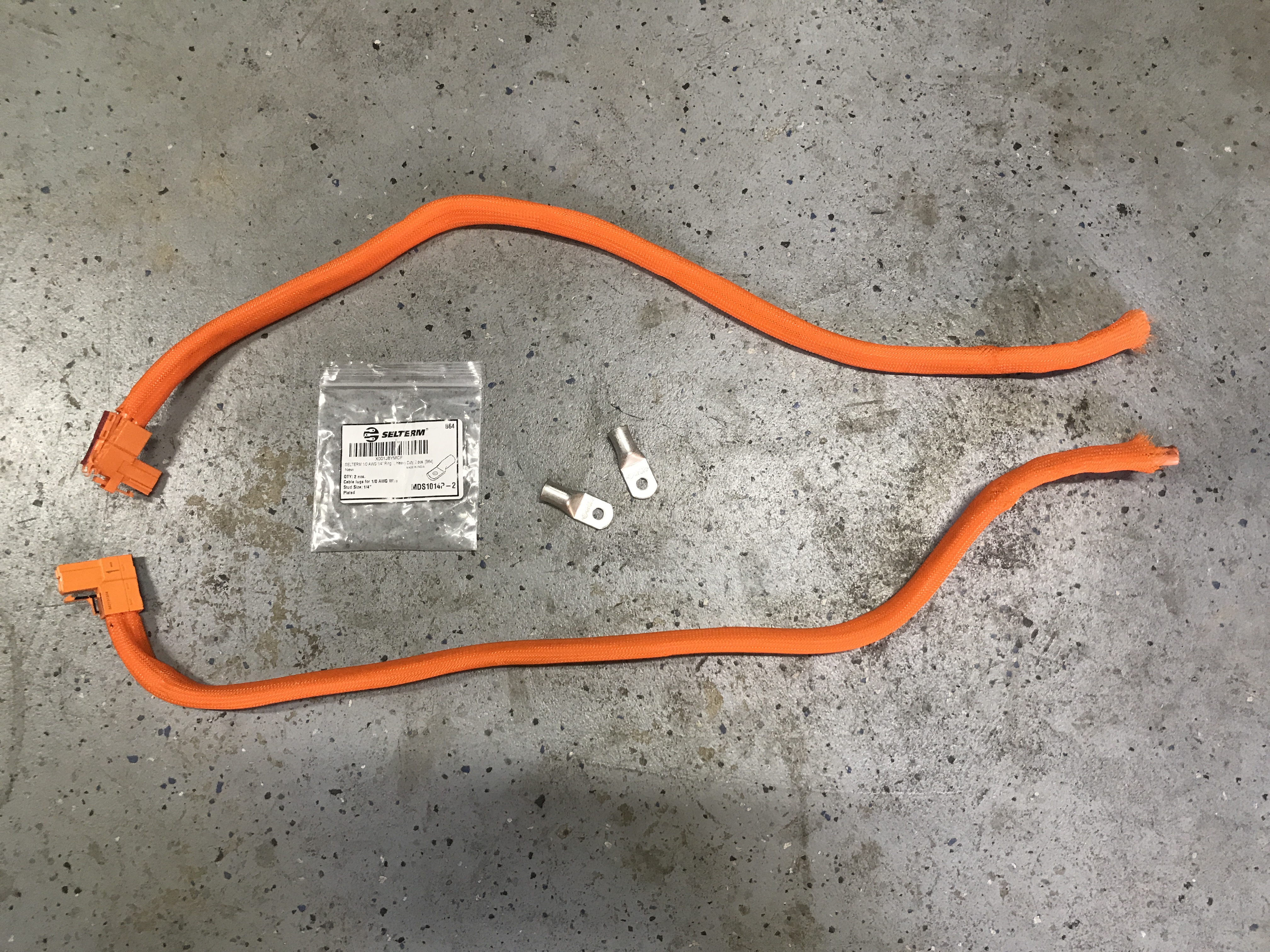

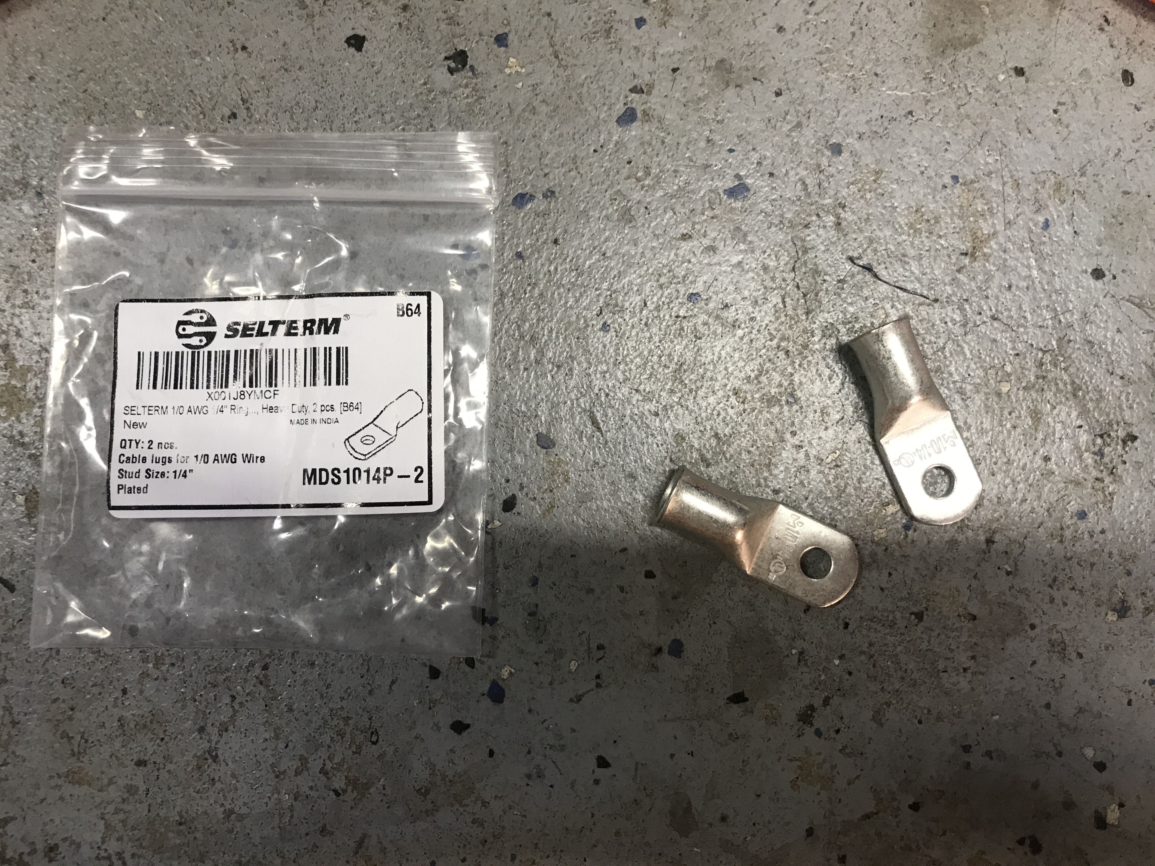

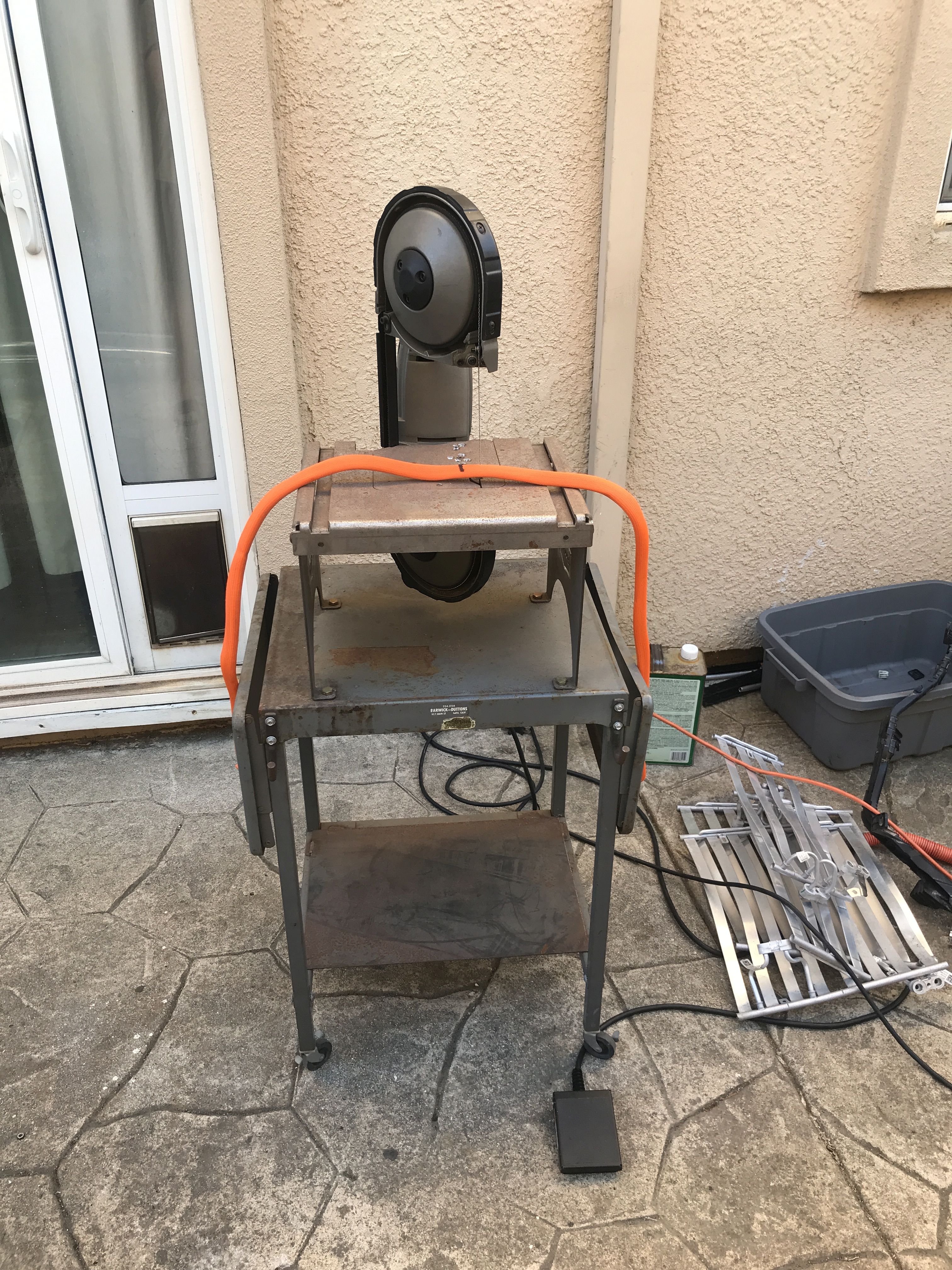

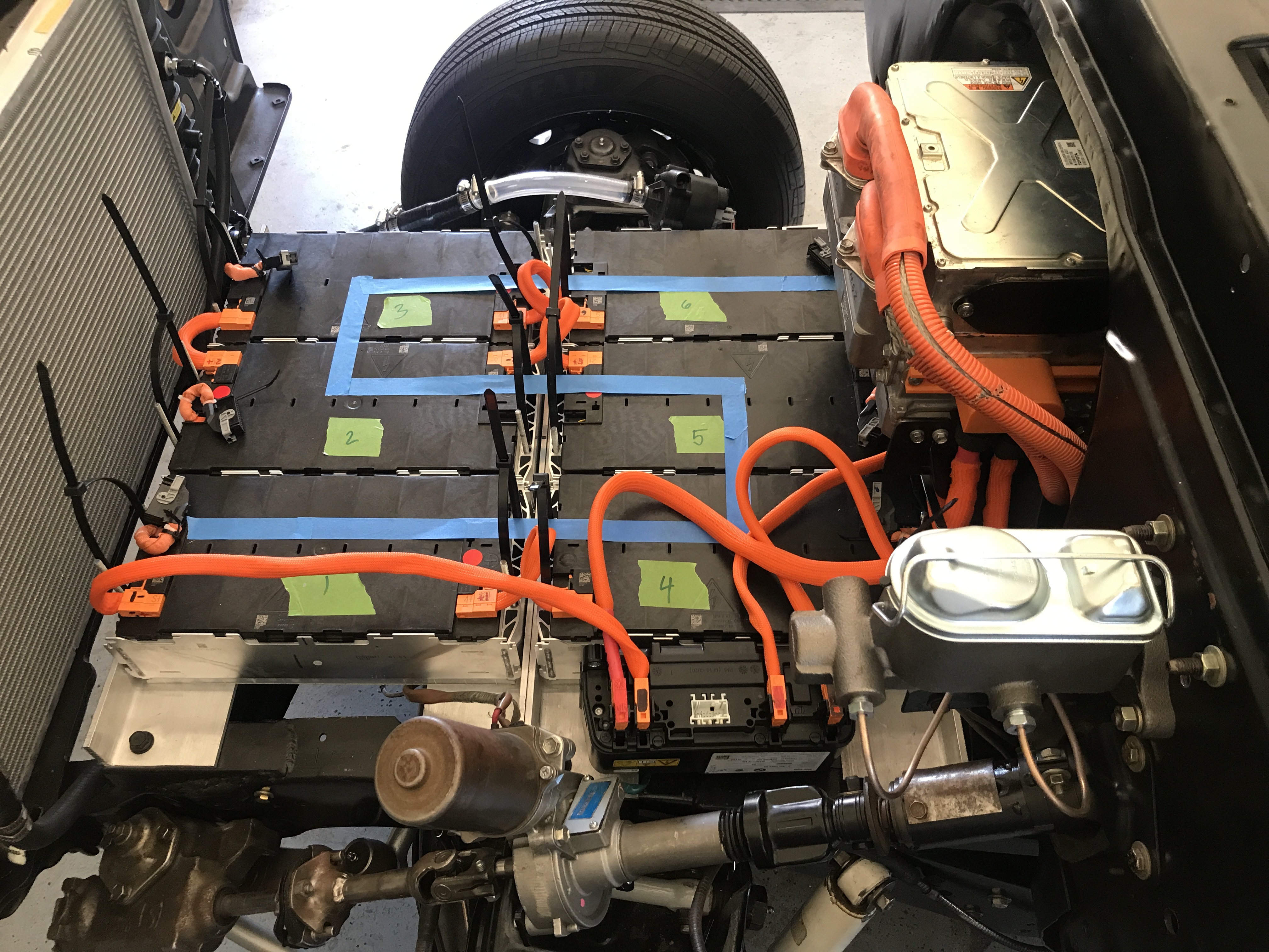

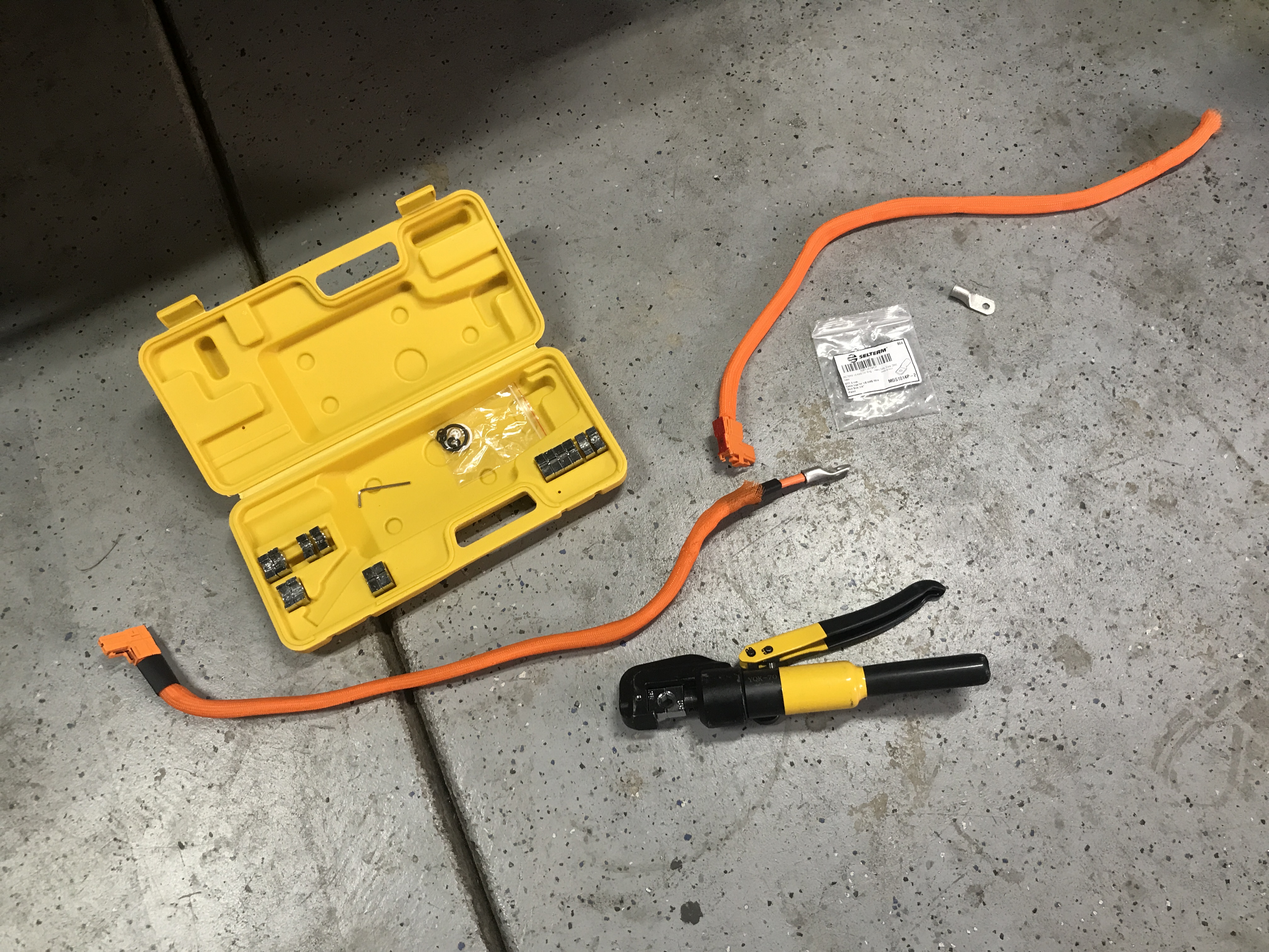

then I cut that longest OEM 5' lead in half to make two leads to the Inverted out of it
- Gregski
- Posts: 3161
- Has thanked: 631 times
- Been thanked: 1608 times

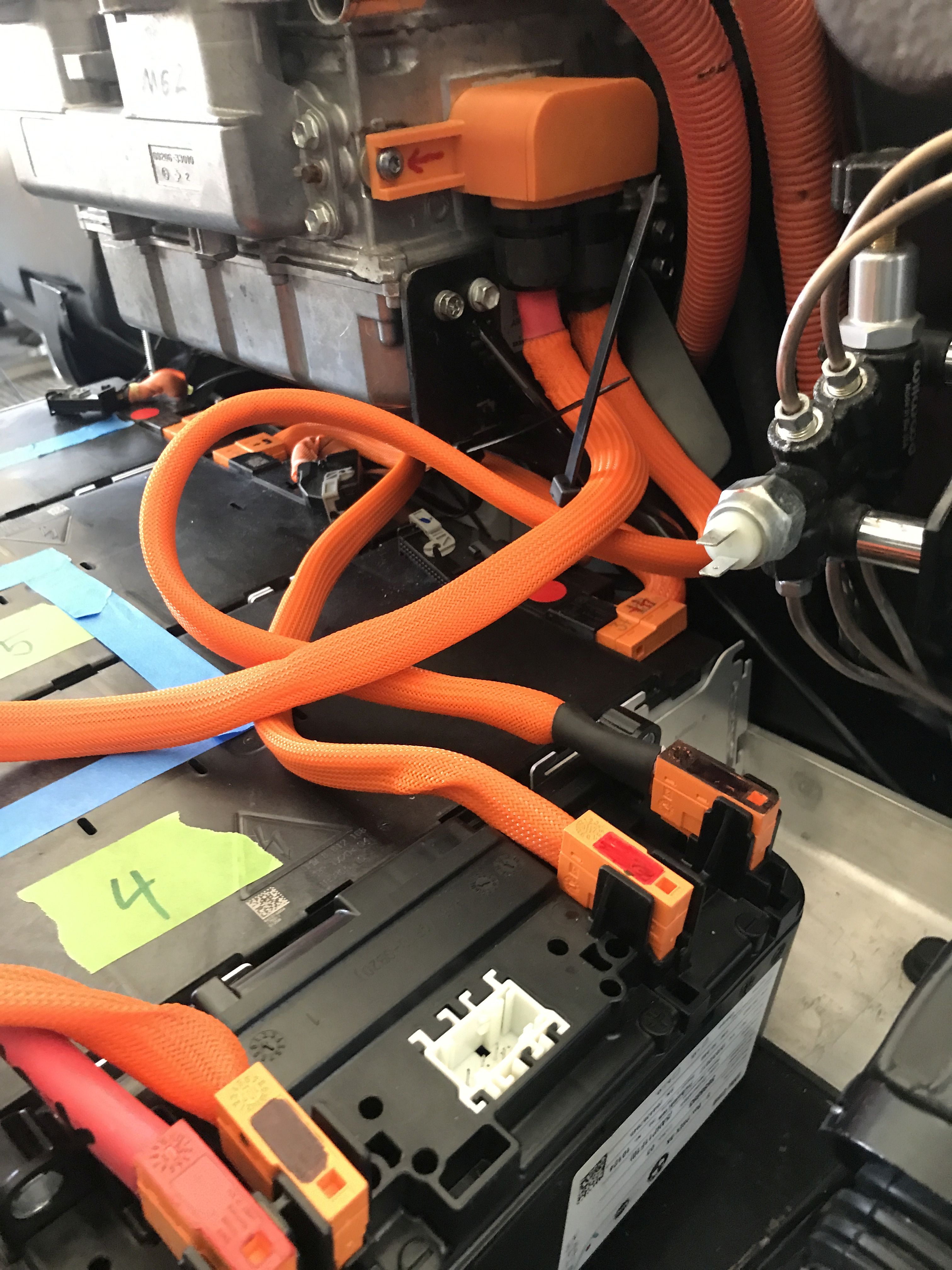

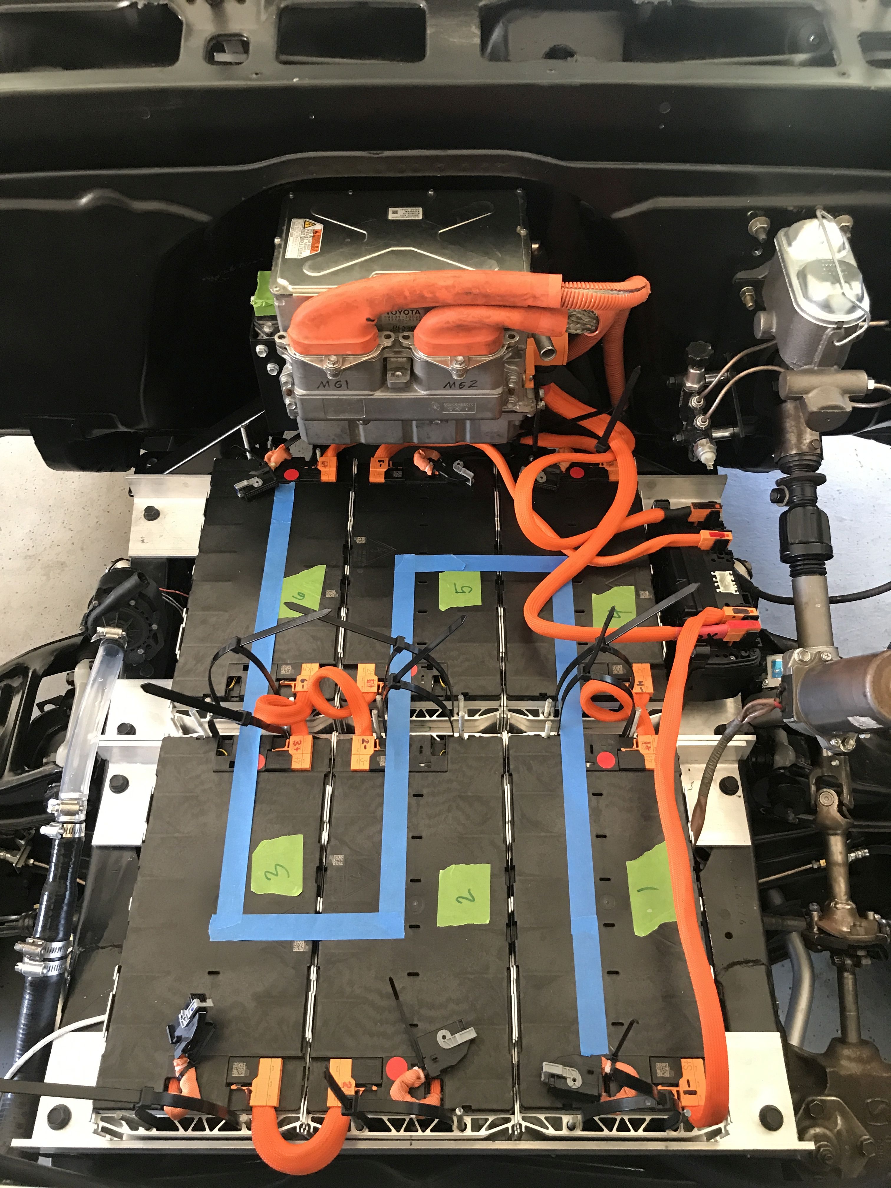

then I assembled it all for what I hope is the final time, the S shows how they are connected in series
- Gregski
- Posts: 3161

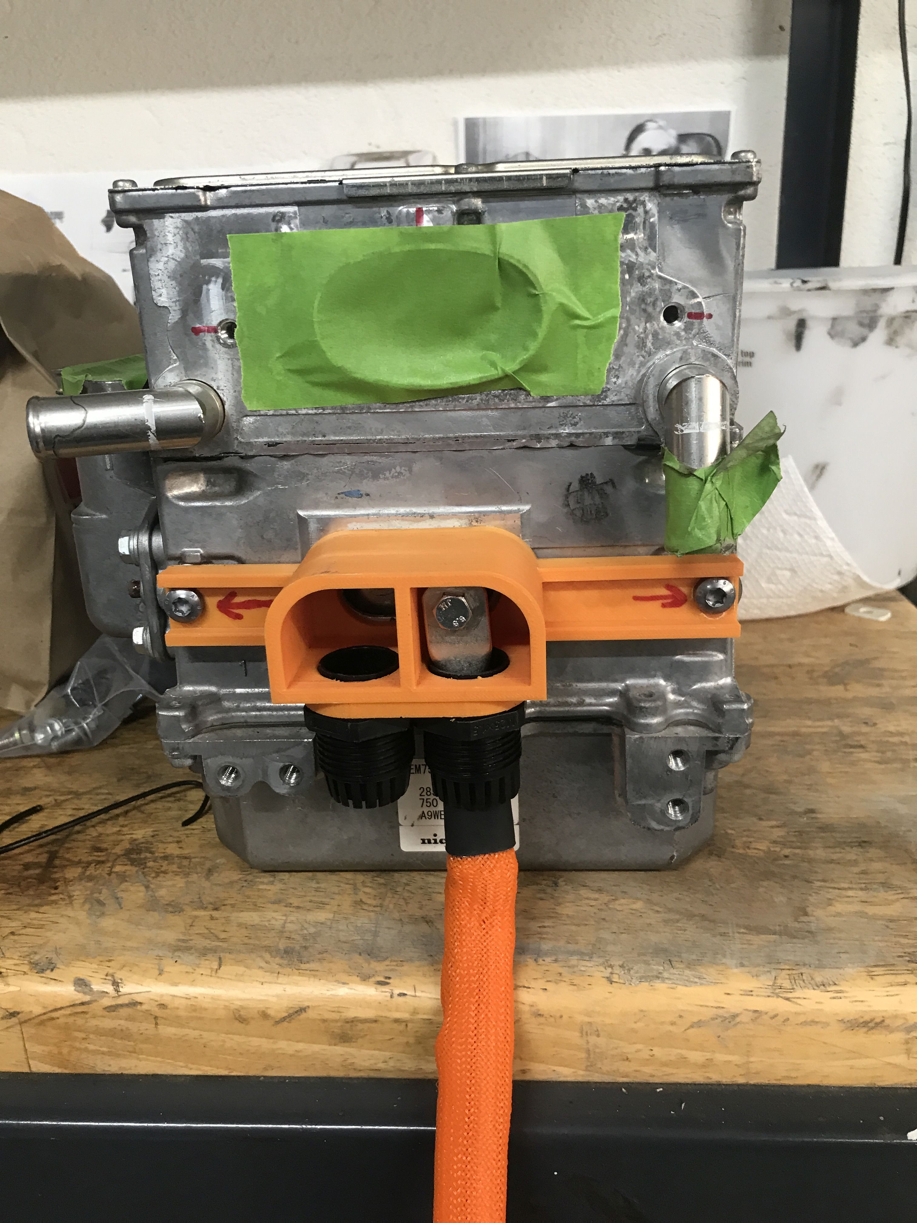

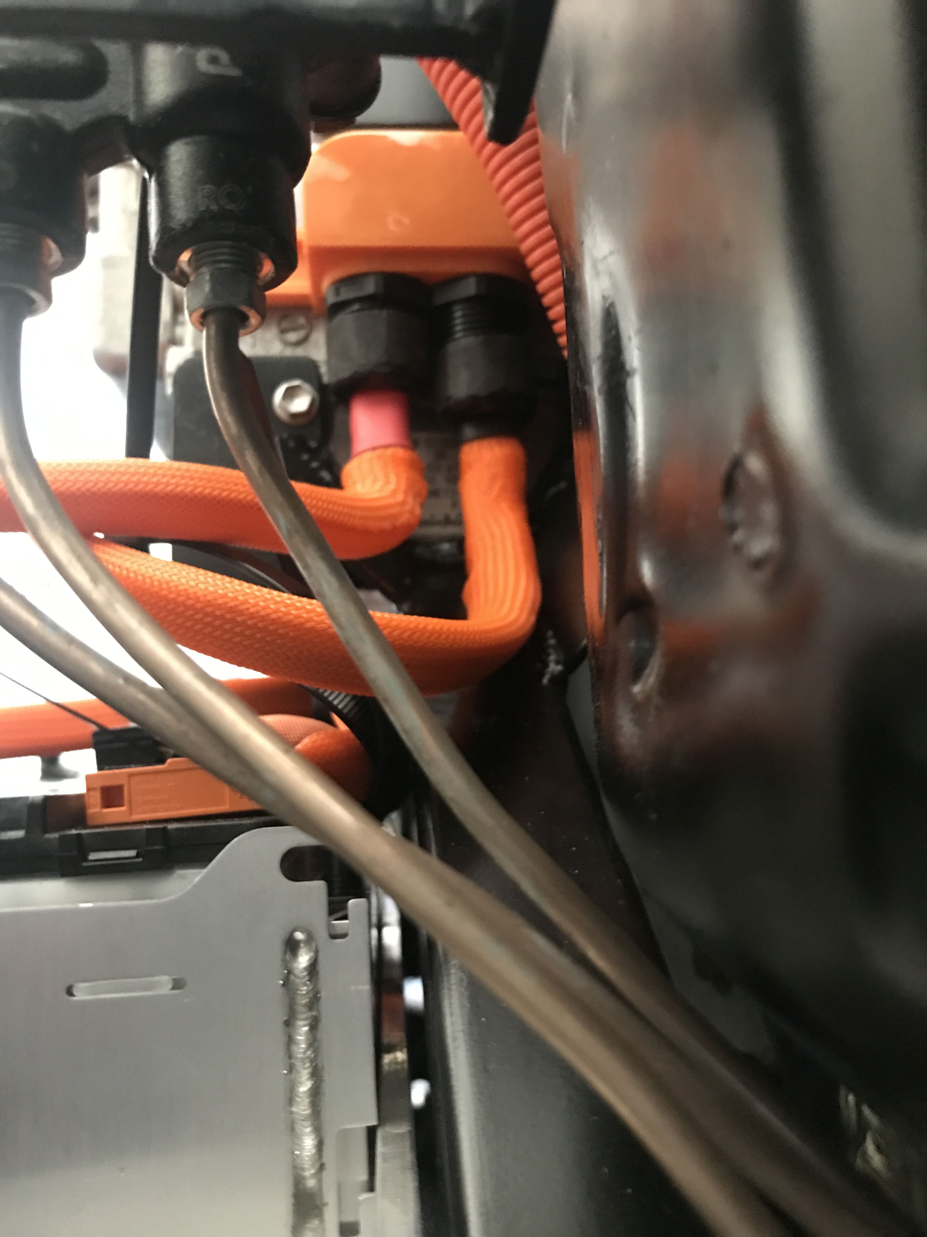

a little close up of the leads going into the inverter, 90% of all that orange will be out of sight out of mind

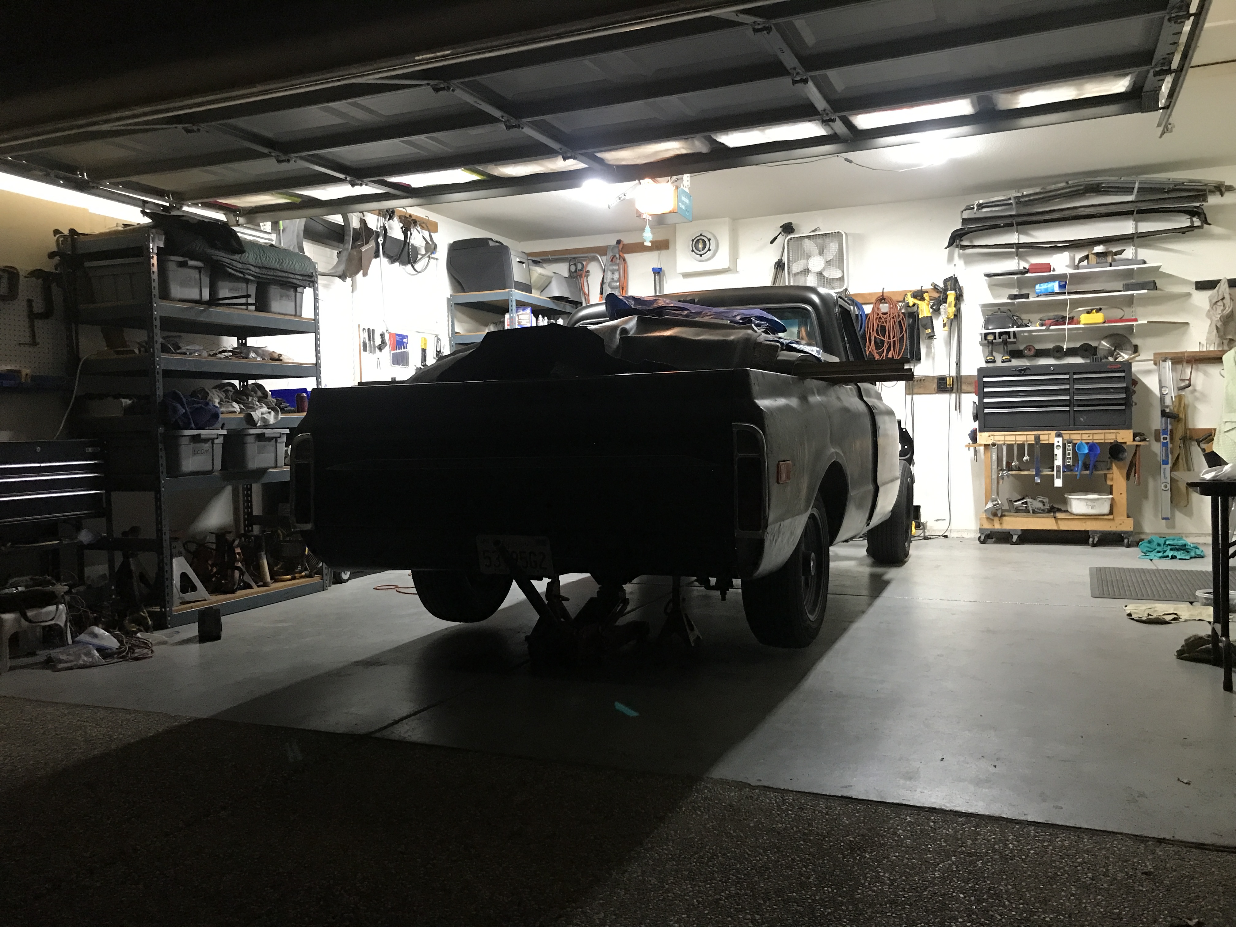

just another day at the office
... so close tonight ...

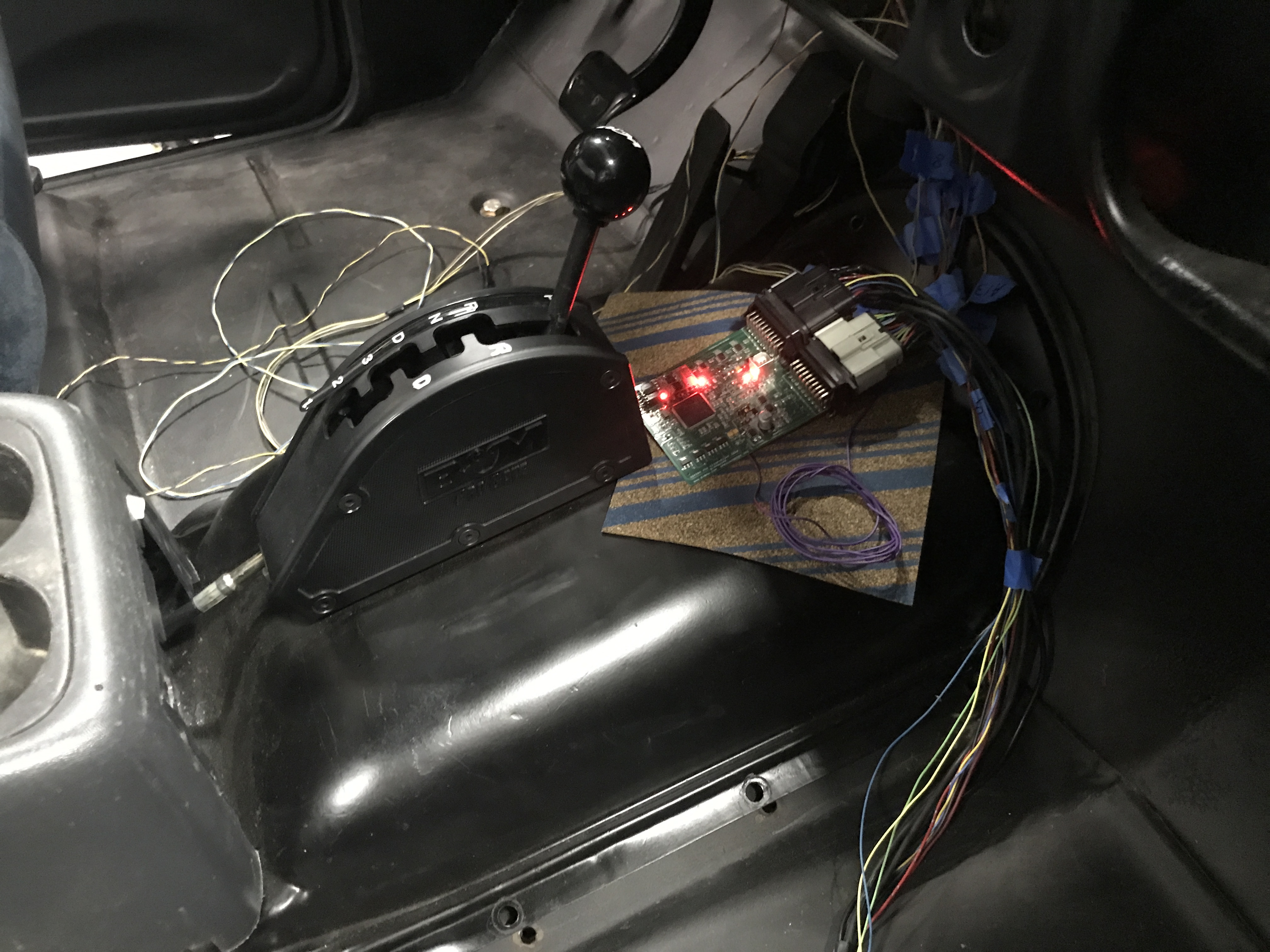

so here's where we be at, I am using the OG VCU ver 2 (the pre ZombieVerter hardware)
your help and advice is greatly appreciated
- battery, safety box, inverter, trans, vcu, and throttle all hooked up (no DC-DC converter, no charger, no BMS, yet)
- throttle calibrated
- torque set to 500
- the S box sees: 347 volts
- the inverter also sees: 347 volts - but they drop quickly 310, 260, 180, 80, 60, down to zero type of thing without me doing anything

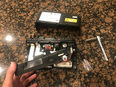

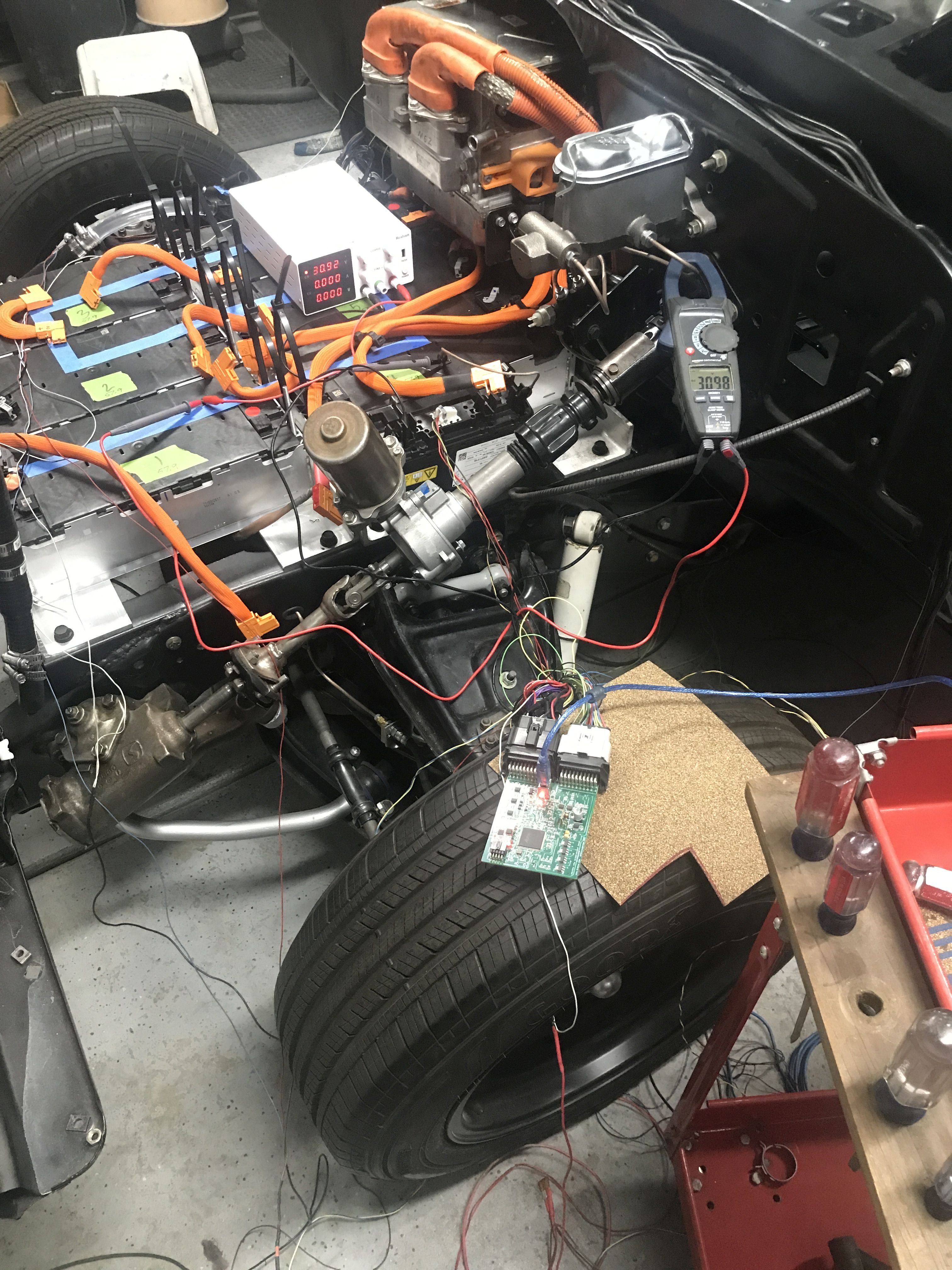

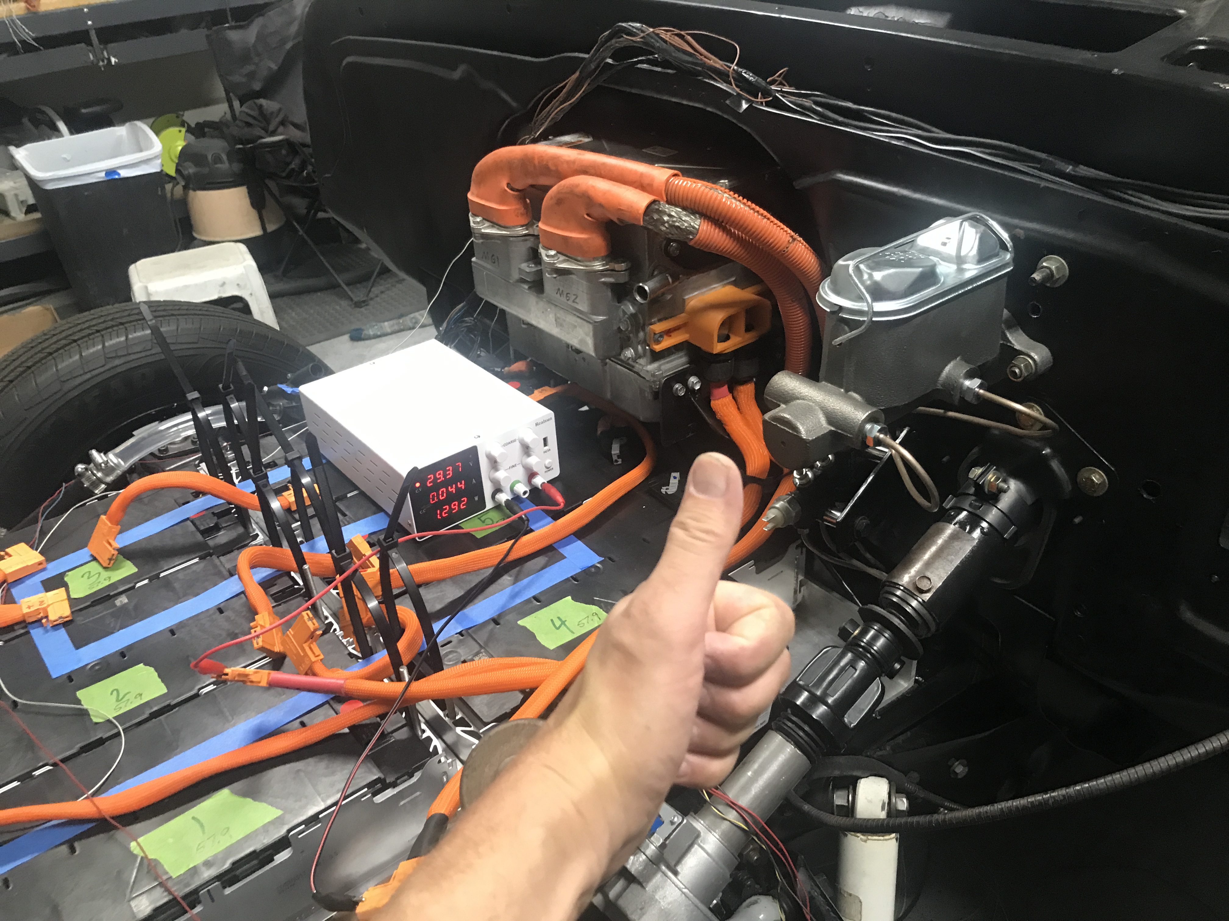

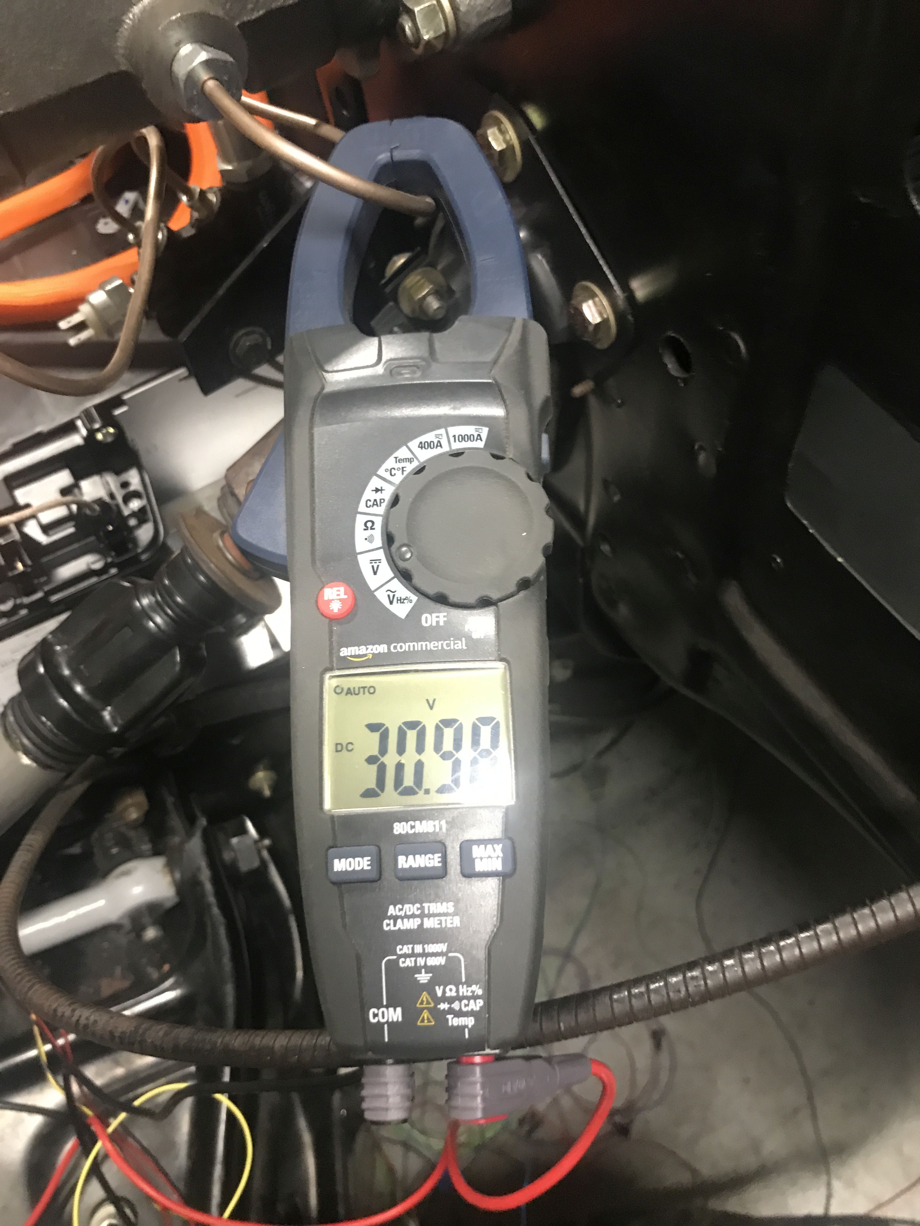

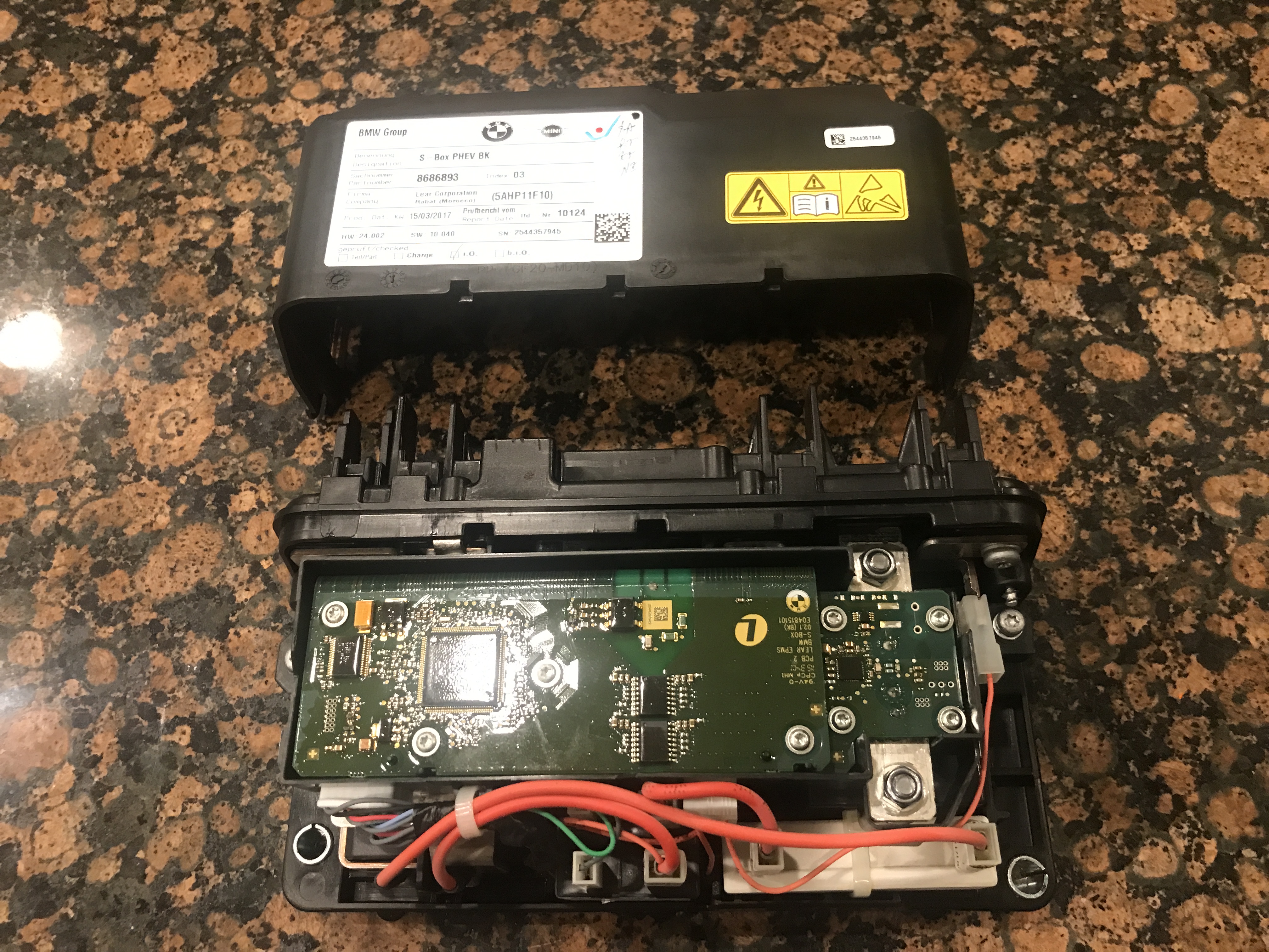

so I did a test where I connected a 300 watt (30 volt 10 amp) bench power supply directly to the inverter and the wheels spin just fine
- Gregski
- Posts: 3161
more trouble shootin'
here I am bypassing the Positive Contactor in that black Safety Box and only closing the Negative one, and we see full voltage from the 30v bench power supply, so something is up with the Positive Contactor closing then opening, or maybe some circus board logic in that box, donno

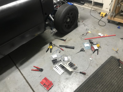

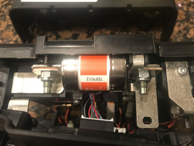

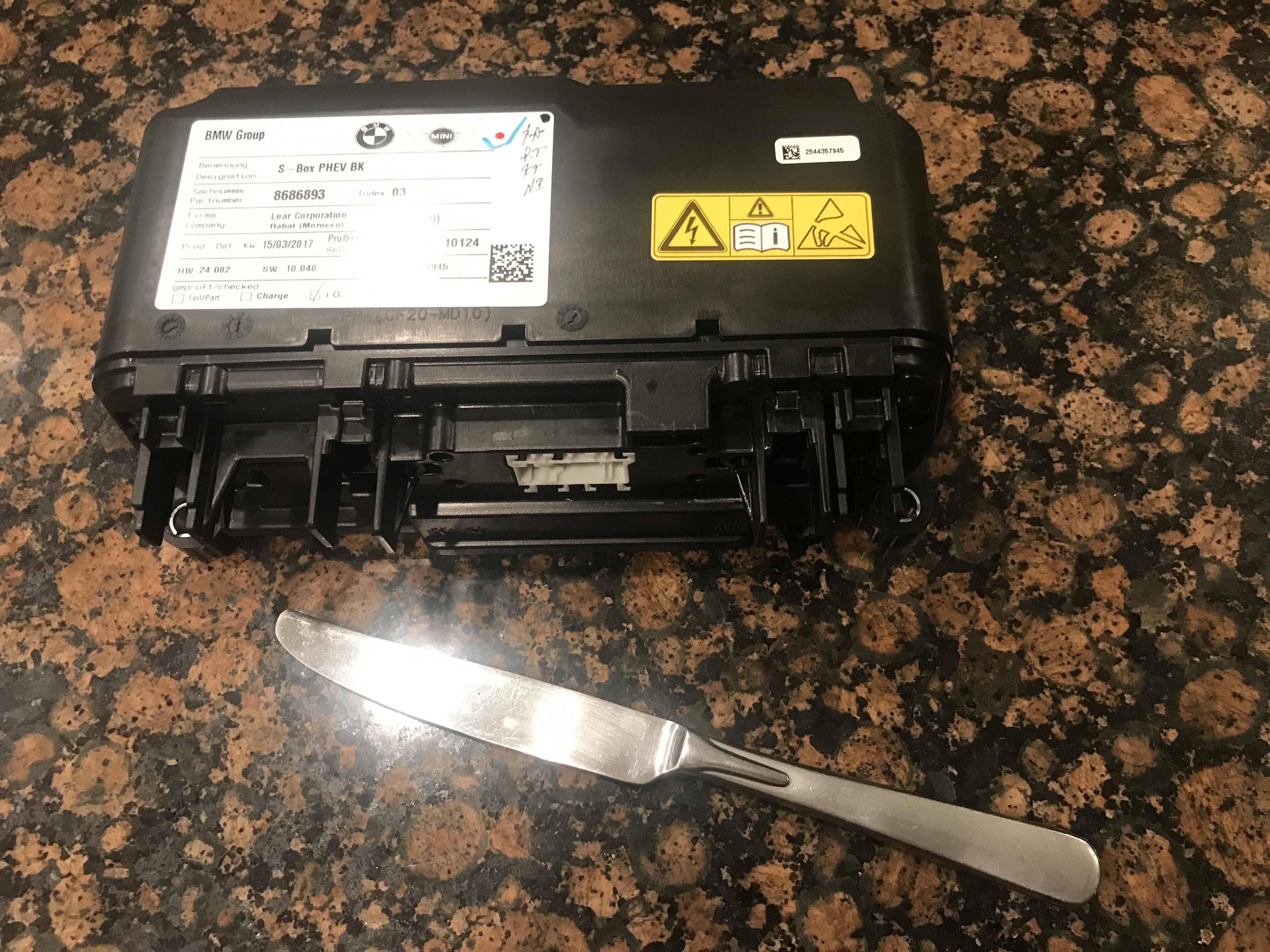

I usually like to keep to myself (I'm a very private person... I'll wait till you stop laffin') and work in the privacy and comfort of my garage, but the wife insisted I do this next part on our granite kitchen counter tops
the butter knife is there for scale purposes I so did not use it to pry that plastic lid off that it would fit perfectly under the tabs if I or any other person decided to use it in that matter, but I didn't, I swear
time to check the B.A.F. Big @ss Fuse
it beeps so I recon it's good, plus I would expect it to make a mess if it had a bad hair day

so great news I got it working, it turned out to be operator error, I did not understand/know how the logic of the S-Box code works, now I do, so here is how it works
anytime you execute a menu option (like close Negative contactor) first it opens all the contactors
So when I thought I was executing these commands stacked on top of each other, I wasn't

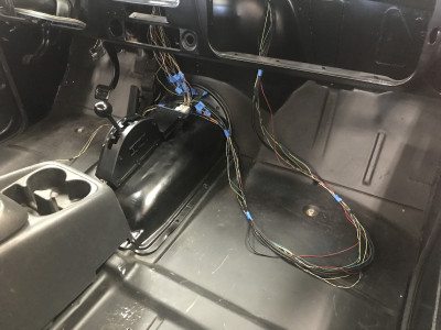

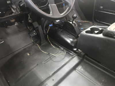

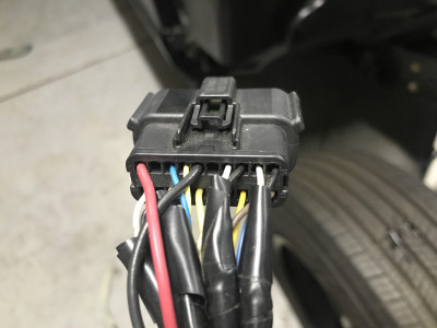

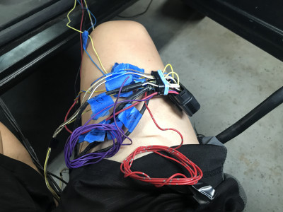

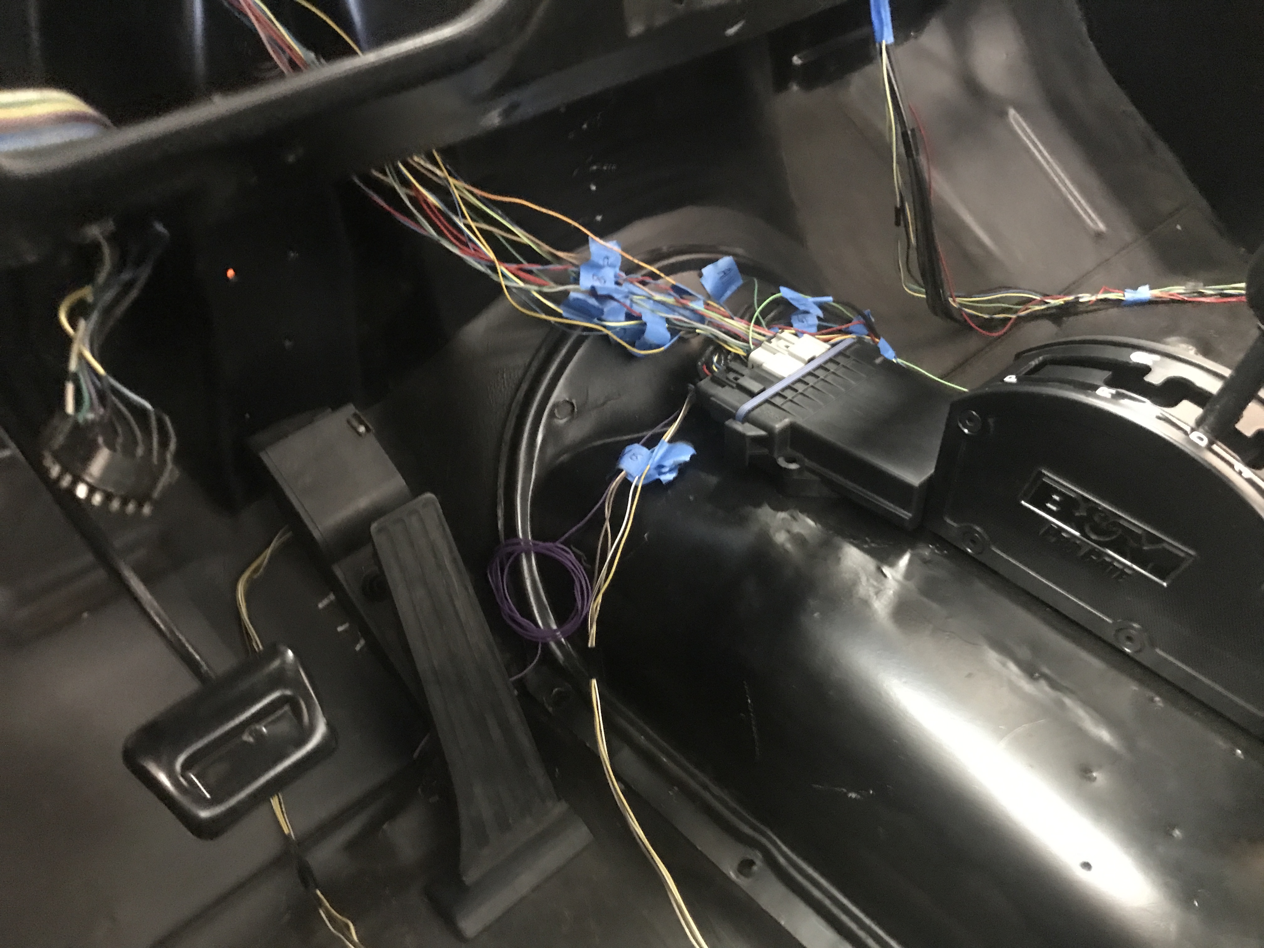

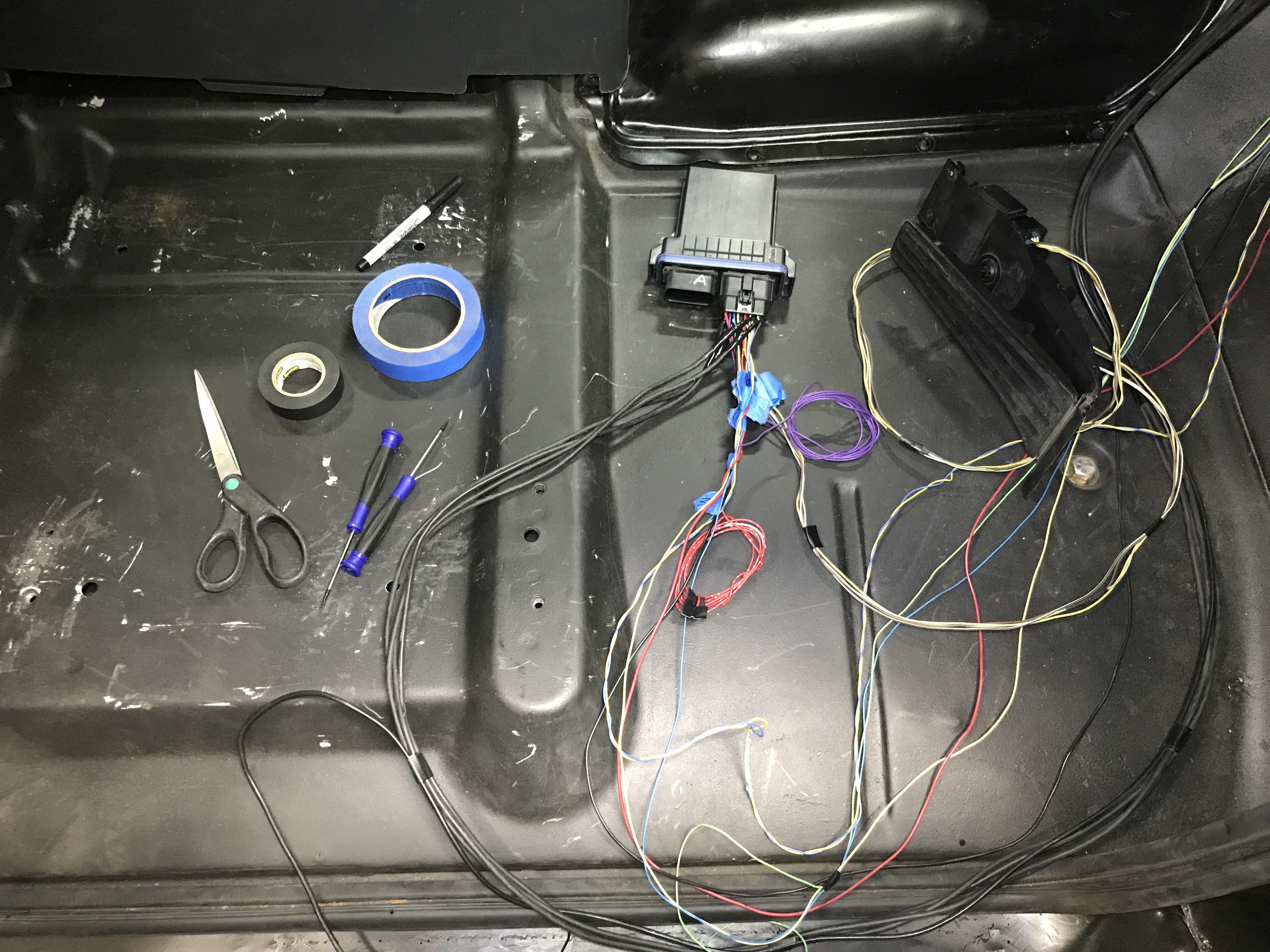

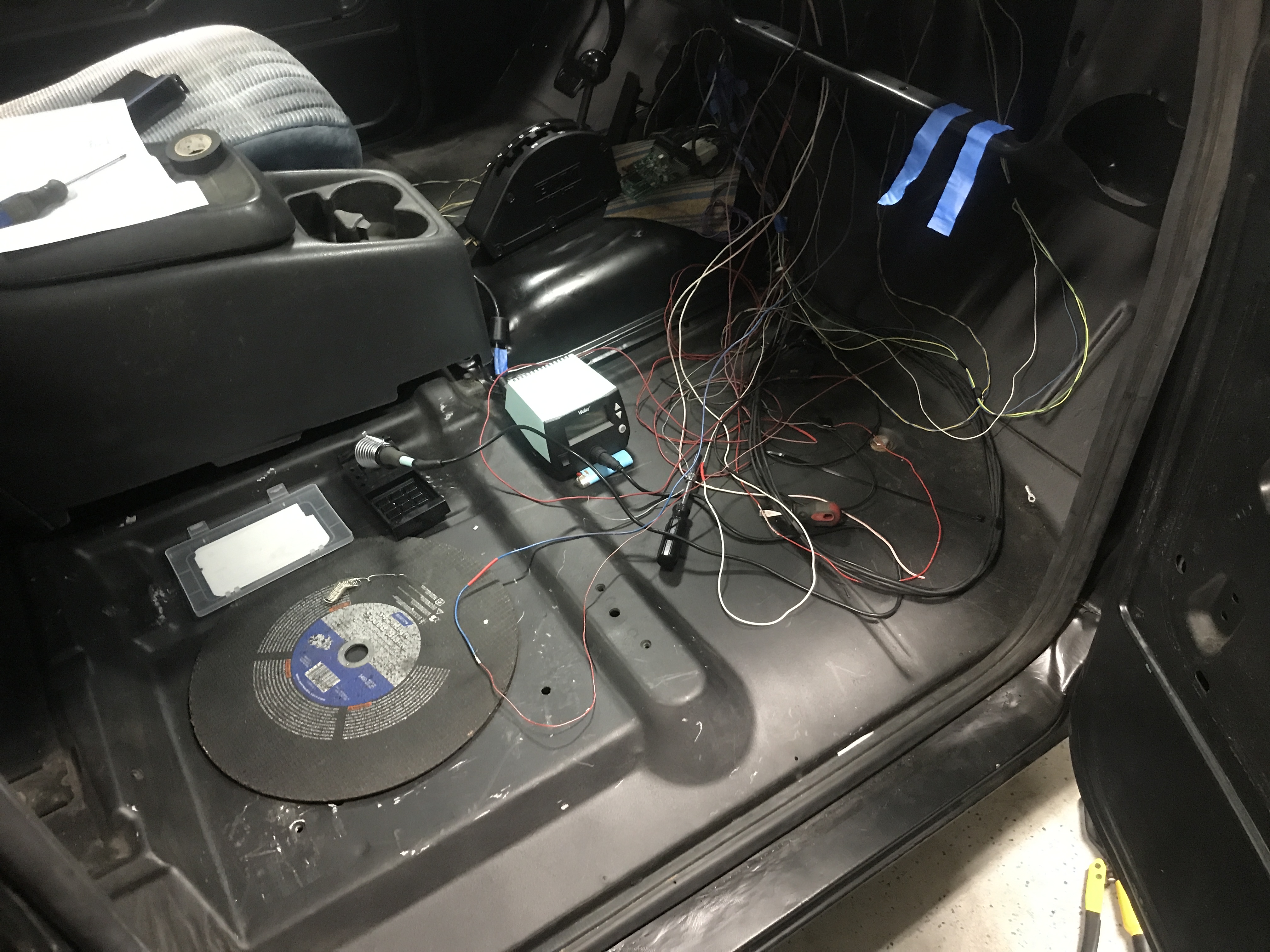

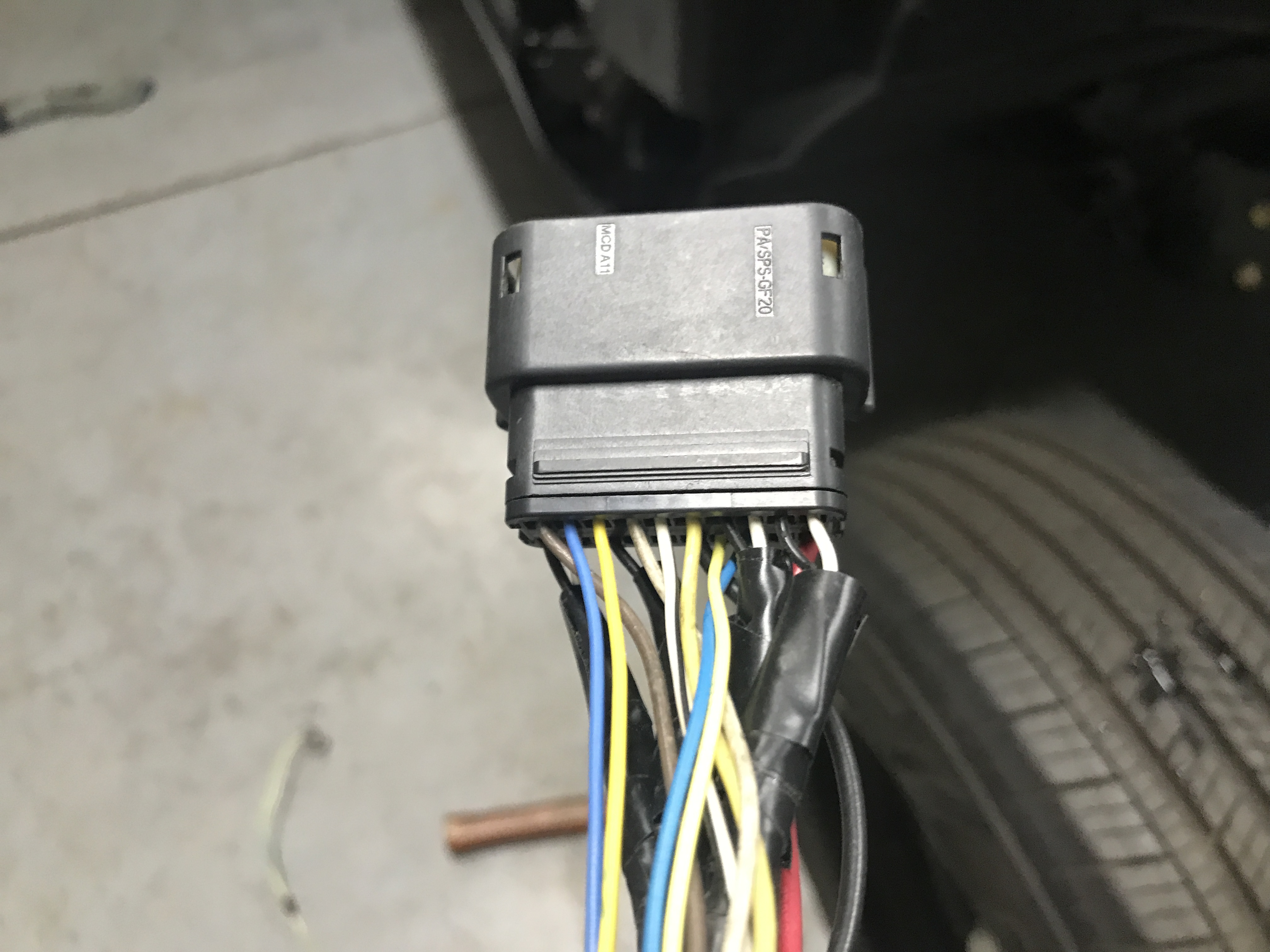

4 hours of unpinning and repining and all I got to show for it is the VCU and throttle pedal are now on the other side of the firewall

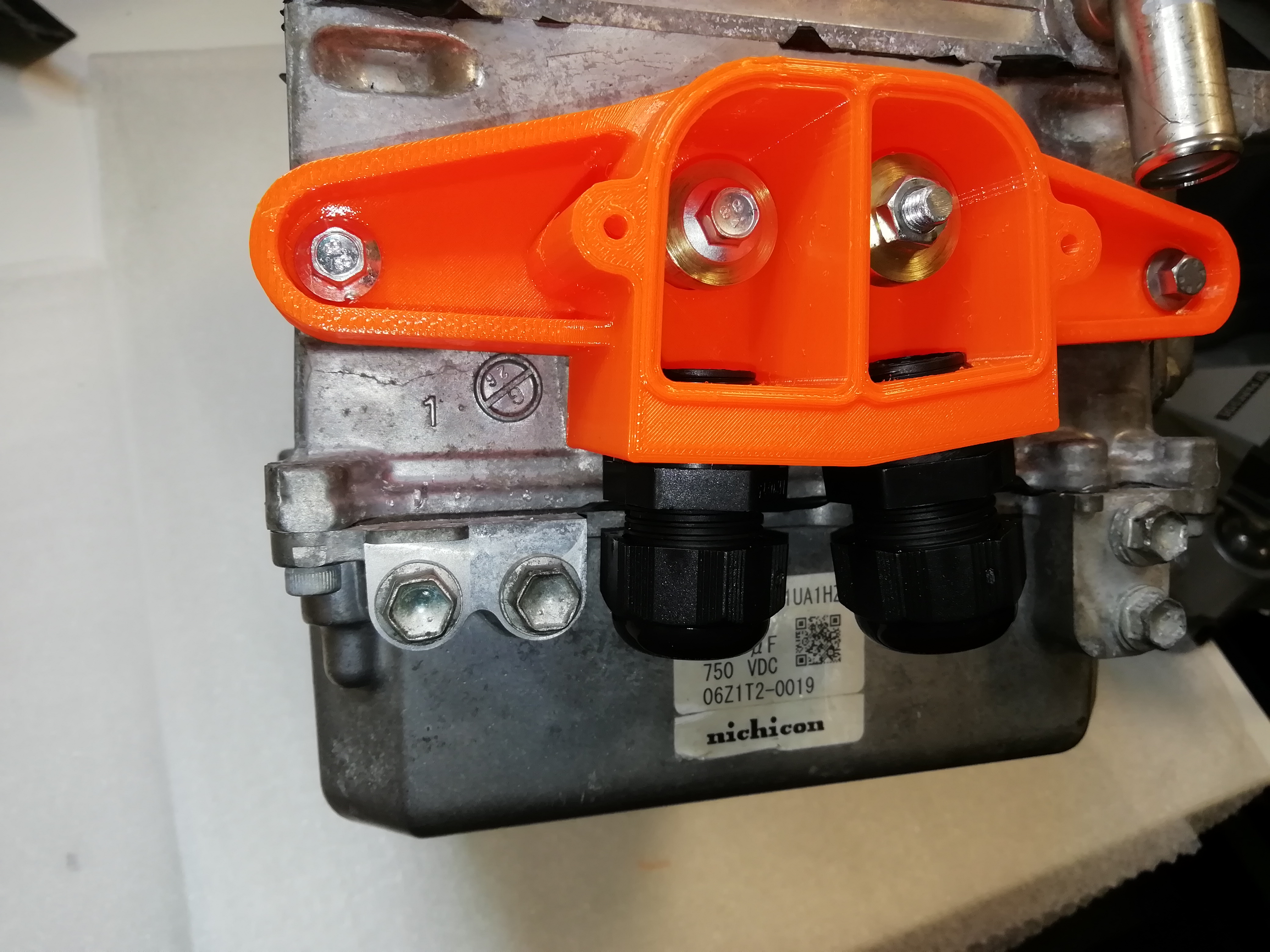

Updated side input port is now on Grabcad, the M20x1.5 thread prints a little lose on one of my slicers and a little tight on the other (Flashforge and Cura) . The small overhangs and threaded holes all print OK without support for me but YMMV. Let me know how you get on.

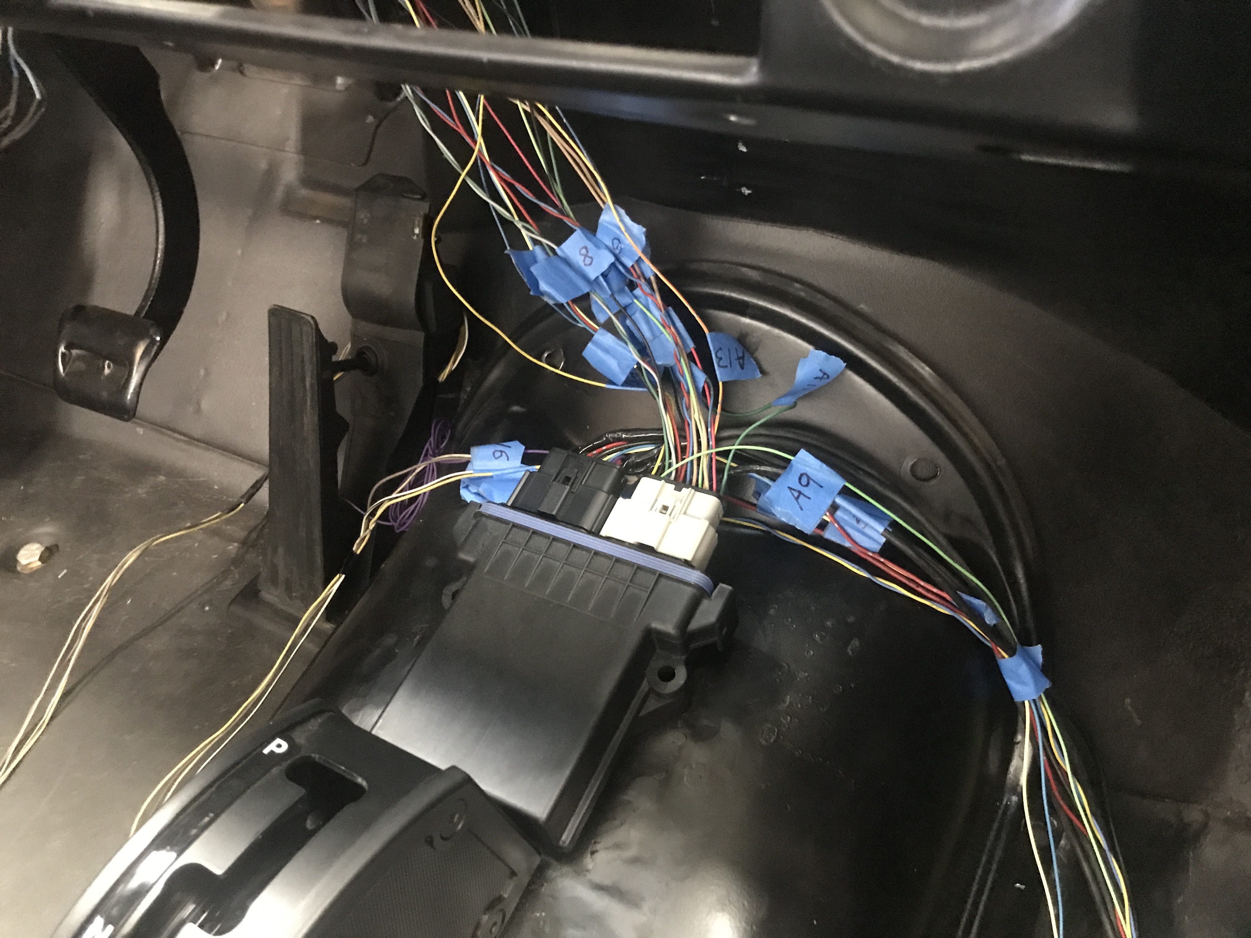

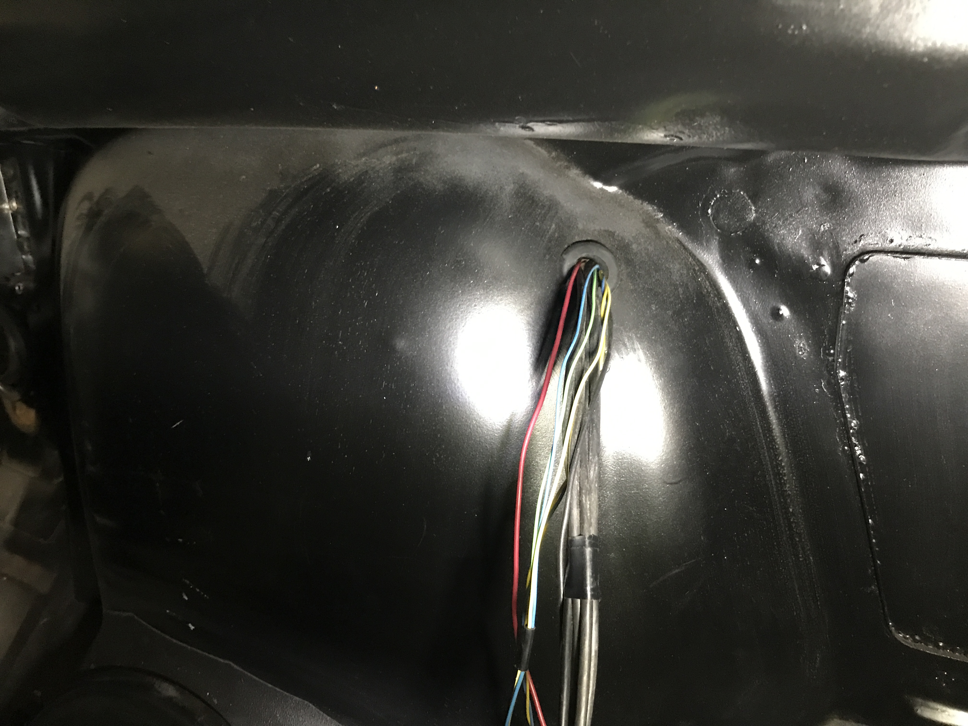

got the second connector harness through the firewall and now the EV Vehicle Control Unit (aka VCU) as well as the skinny pedal live in the cab, getting ready for the next test from within the cockpit, the goal still being running and driving truck by the end of this month

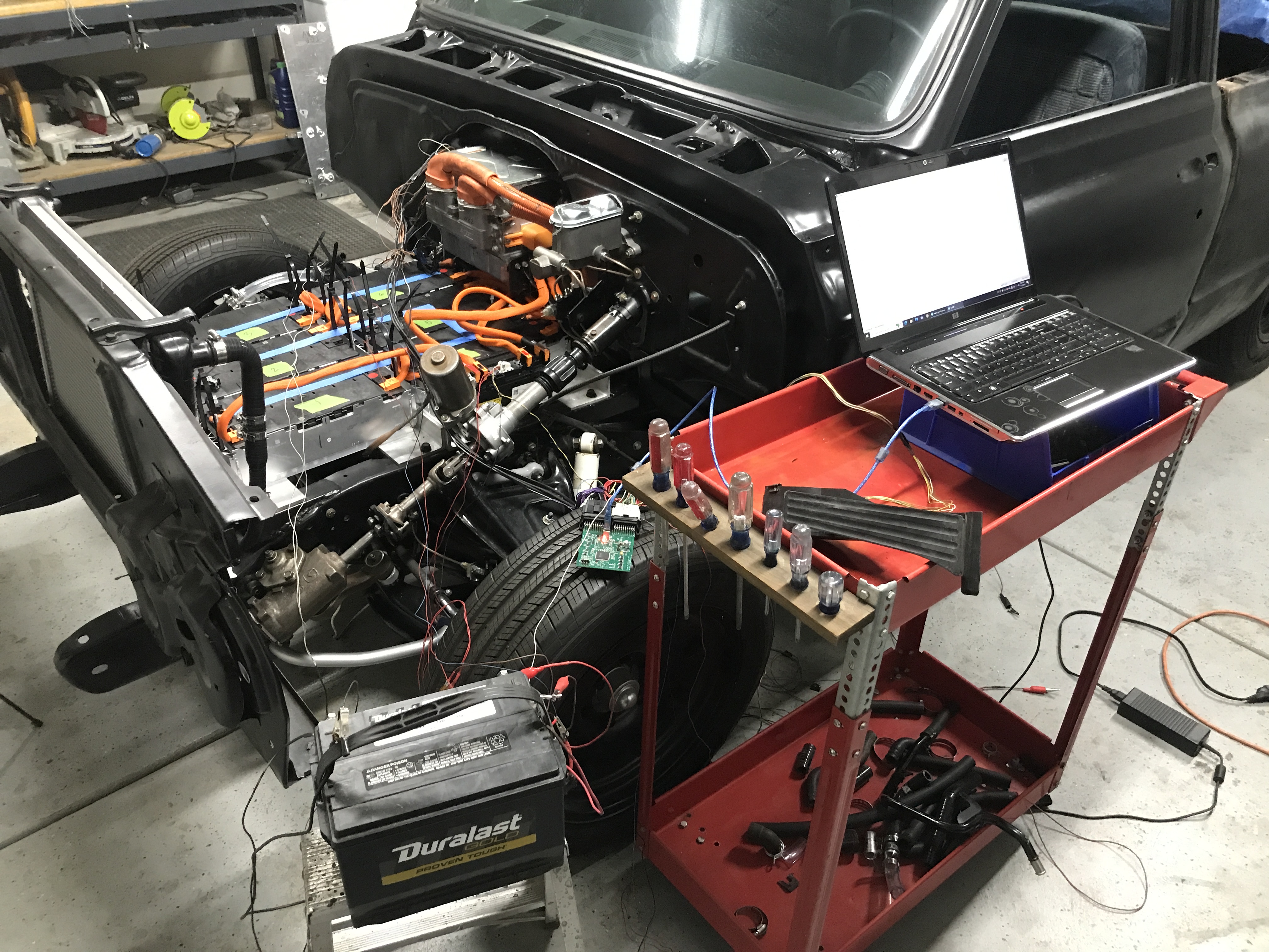

So the goal is still to have a running driving truck by the end of this month. So what do we have left to do to meet this specific goal?
1. Wire an Inverter relay to turn it on from the VCU
2. Add CAN Bus code to control the Chevy Volt DC-DC Converter
3. Wire a relay for the Toyota Prius EPAS (Electronic Power Assist Steering)
4. Wire a relay for the Tesla water pump
5. Add PWM code to control the Tesla water pump
This will be a crude drive test, most likely with a laptop sitting shot gun for S-box control as I am still in the process of finding suitable ChatGPT code in order to automate that.

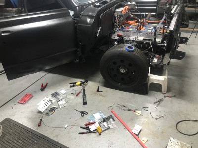

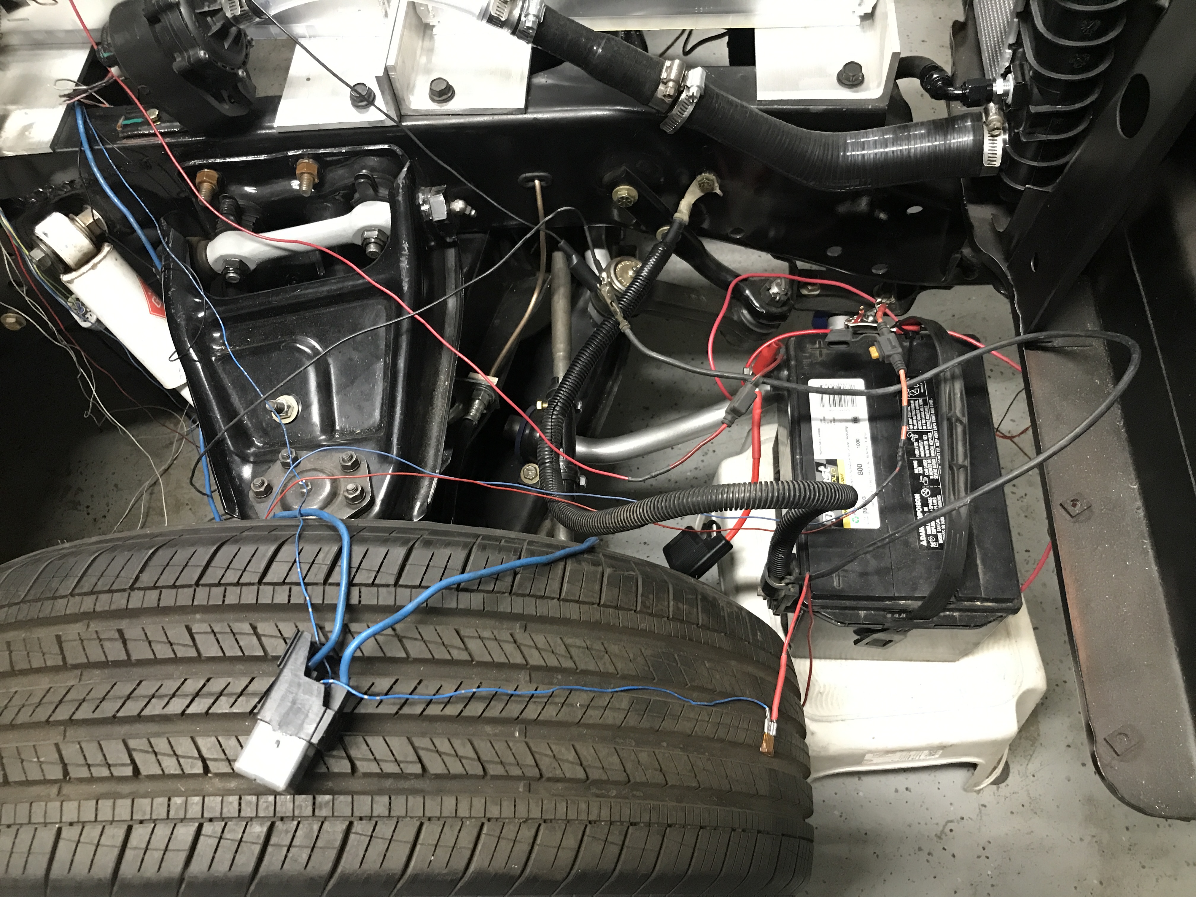

well that escalated quickly, as I spun my wheels all evening chasing over a dozen grounds, I think I'm gonna list them all for prosperity if you see one I missed please let me know (also I think I will brand the apparatus cause details are good) may take me numerous updates to this post plus it's midnight
