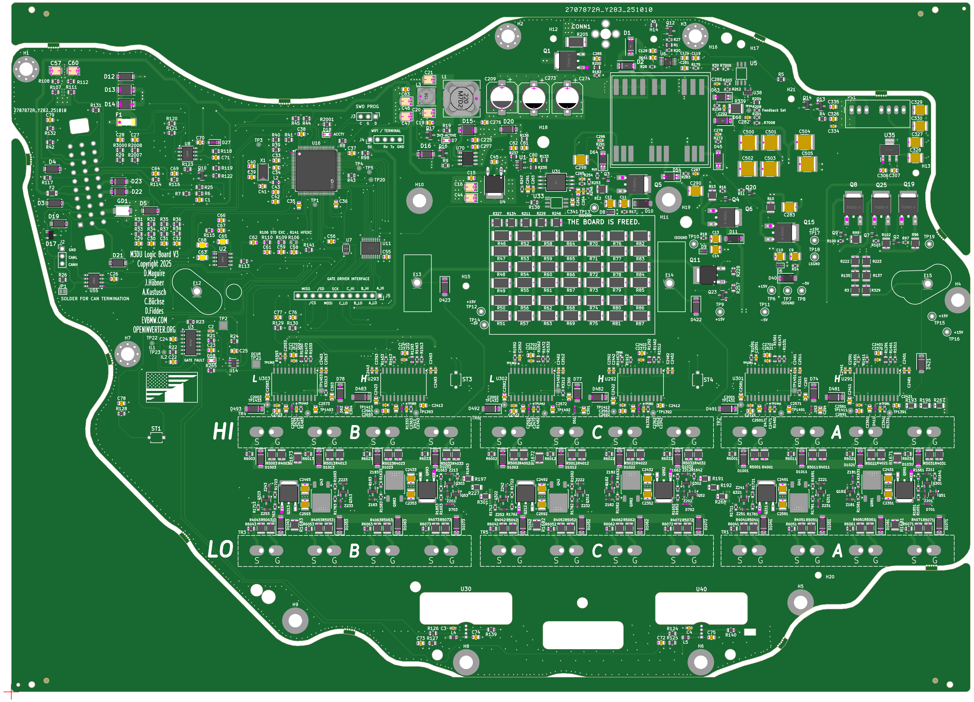

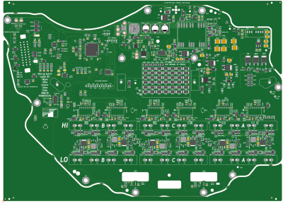

Sorry I'm late with the review of the schematics.
Regarding the throttle inputs: I'd propose to re-arrange TVS and the serial resistor, to make these inputs 12V tolerant. It is a good rule, to avoid circuits which are killed by just putting 12V on them. In best case, even +12V and -12V should not lead to smoke. So I propose to put the TVS behind the serial resistor, and not directly to the pin.

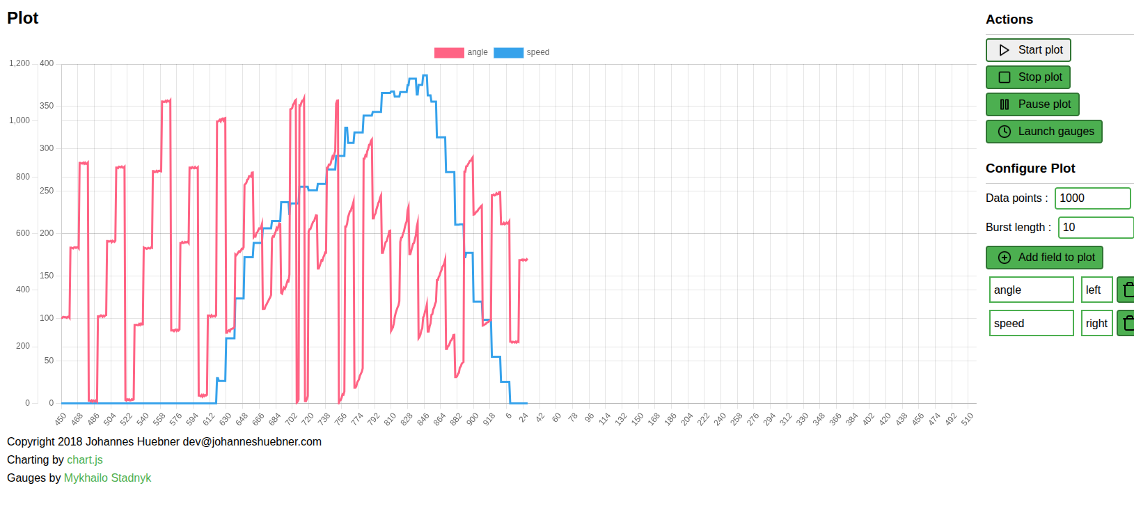

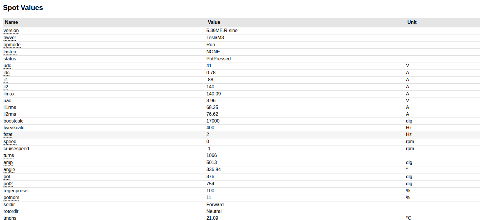

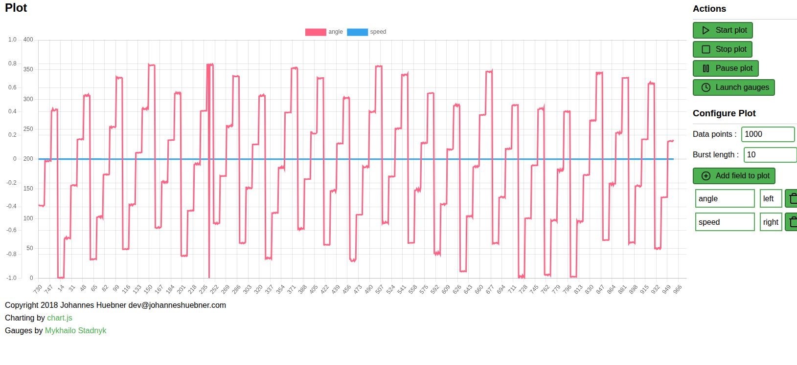

Yes but the front M3 drive unit is an induction motor not PM so am trying to run with sine firmware not FOC. Sine needs to know only rotor direction and rpm. In both screenshots above , the rotor is stationary. Sorry if am missing something obvious.manny wrote: ↑Wed Oct 01, 2025 5:45 pm This is how it's supposed to work

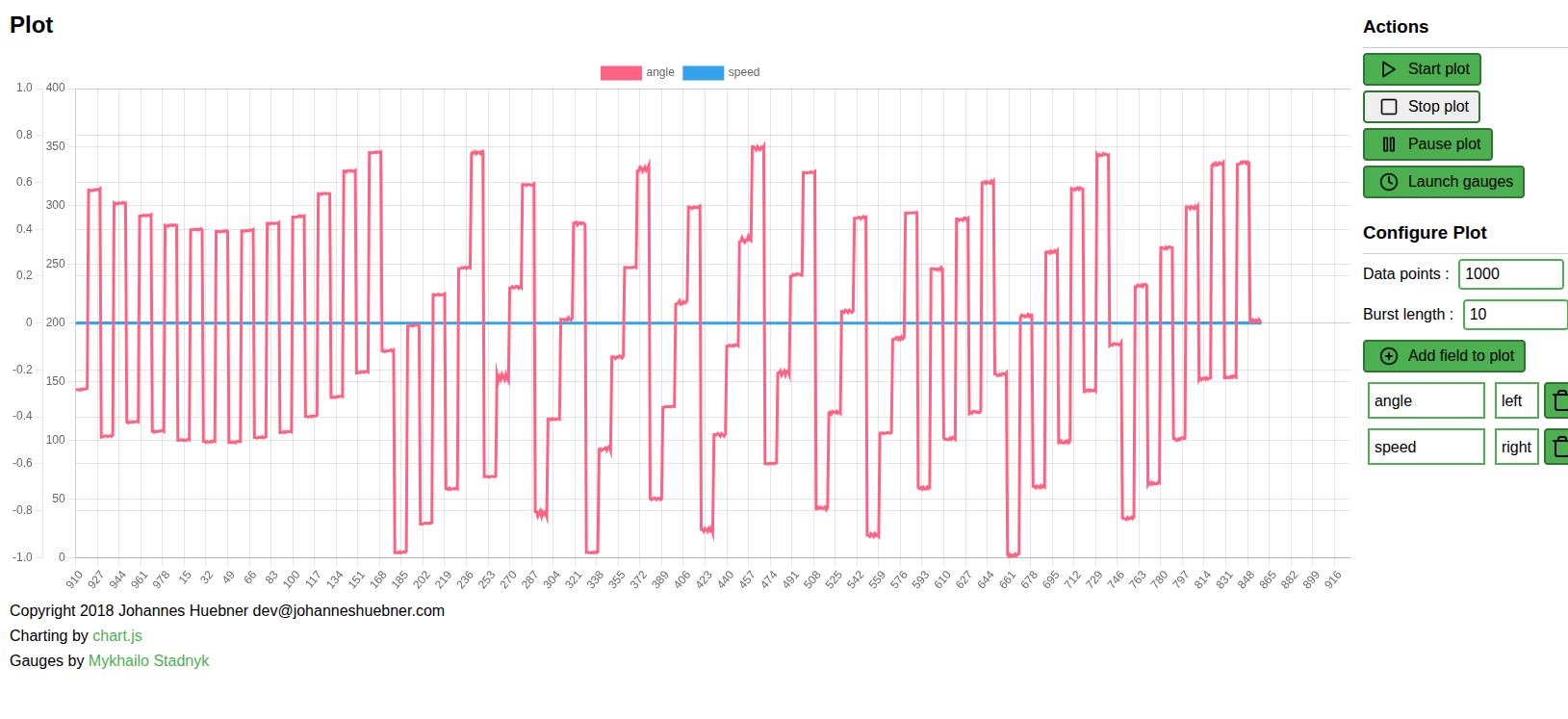

So ran some more tests. Set fslipmin to 2Hz. In manual mode I can set a freq and ampnom and the rotor will turn as expected. In this case angle behaves as expected but speed(rpm) is always 0. In run mode upon starting the inverter injects current and 2Hz into the motor. Pressing the throttle increases current as expected but as the sw does not see motor rpm it just sits at 2Hz and keeps increasing current.
Edit : in fact rotordir remains at neutral so the control loop is not seeing direction or rpm.
- Posts: 4006
- Been thanked: 1136 times
Annnnnd.....forget all that its working perfectly

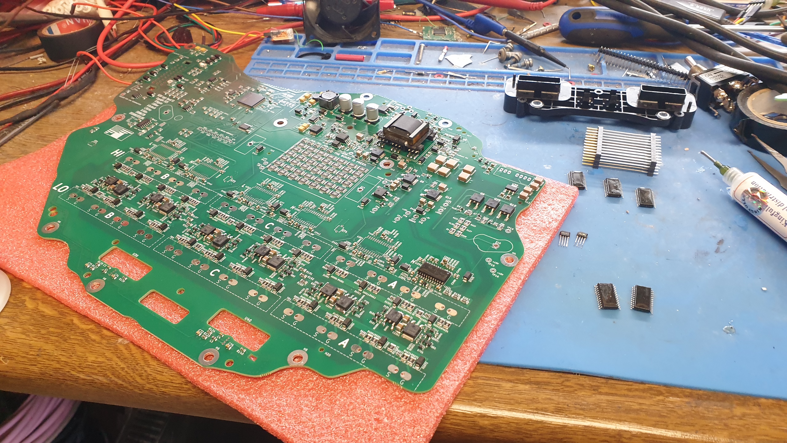

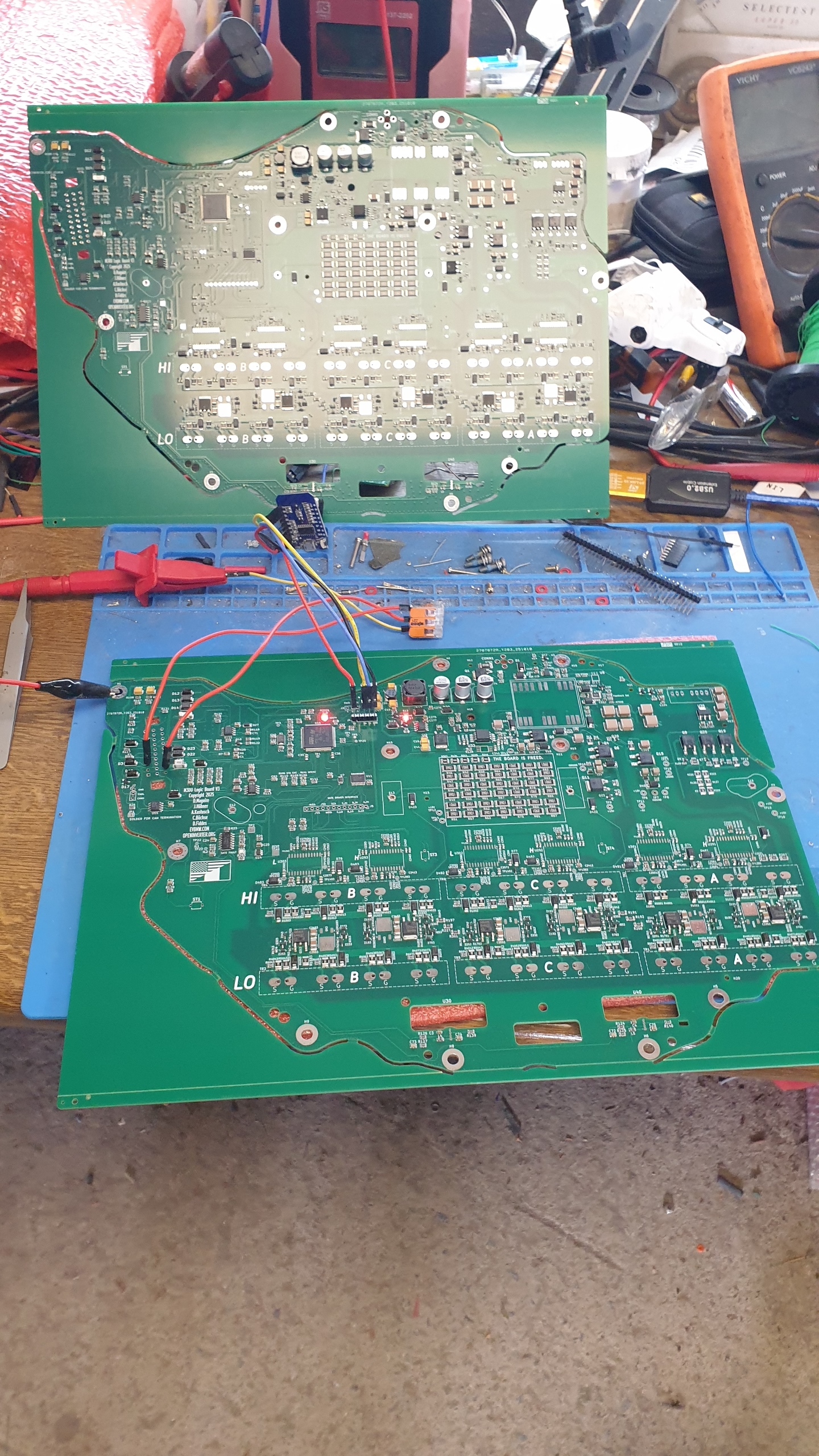

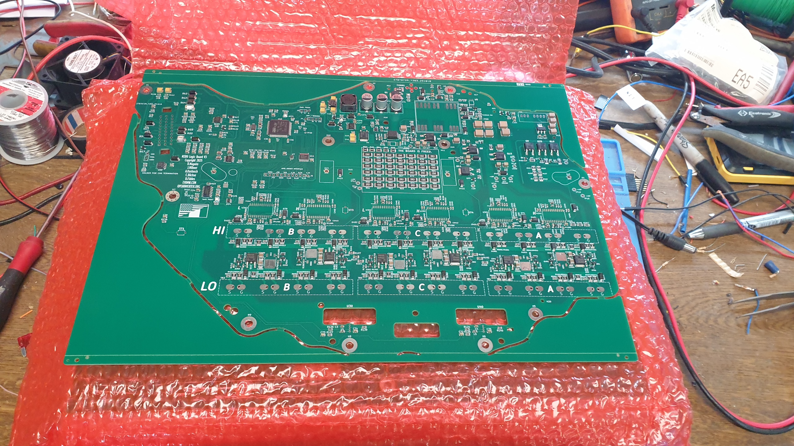

Getting boards ready for beta testers.
- Posts: 4006
Well, here it is folks. The beta release : https://www.evbmw.com/index.php/evbmw-w ... -3-du-beta
Now five of you unlucky persons can own a piece of history and fund my early retirement to Lanzarote......uhhh...cough...I mean fund further development and opensource releases. Video will be up soon showing the fitting procedure etc. Do note this is a beta board, not a finished product and DO NOT buy this if you do not understand the risks and are willing to provide feedback and work through problems here on the forum.

Thanks Dave. Could you add a line to turn off pin PE12 at startup? This will disable the big active discharge resistor bank in the middle of the board. Gets a bit toasty at 400v
