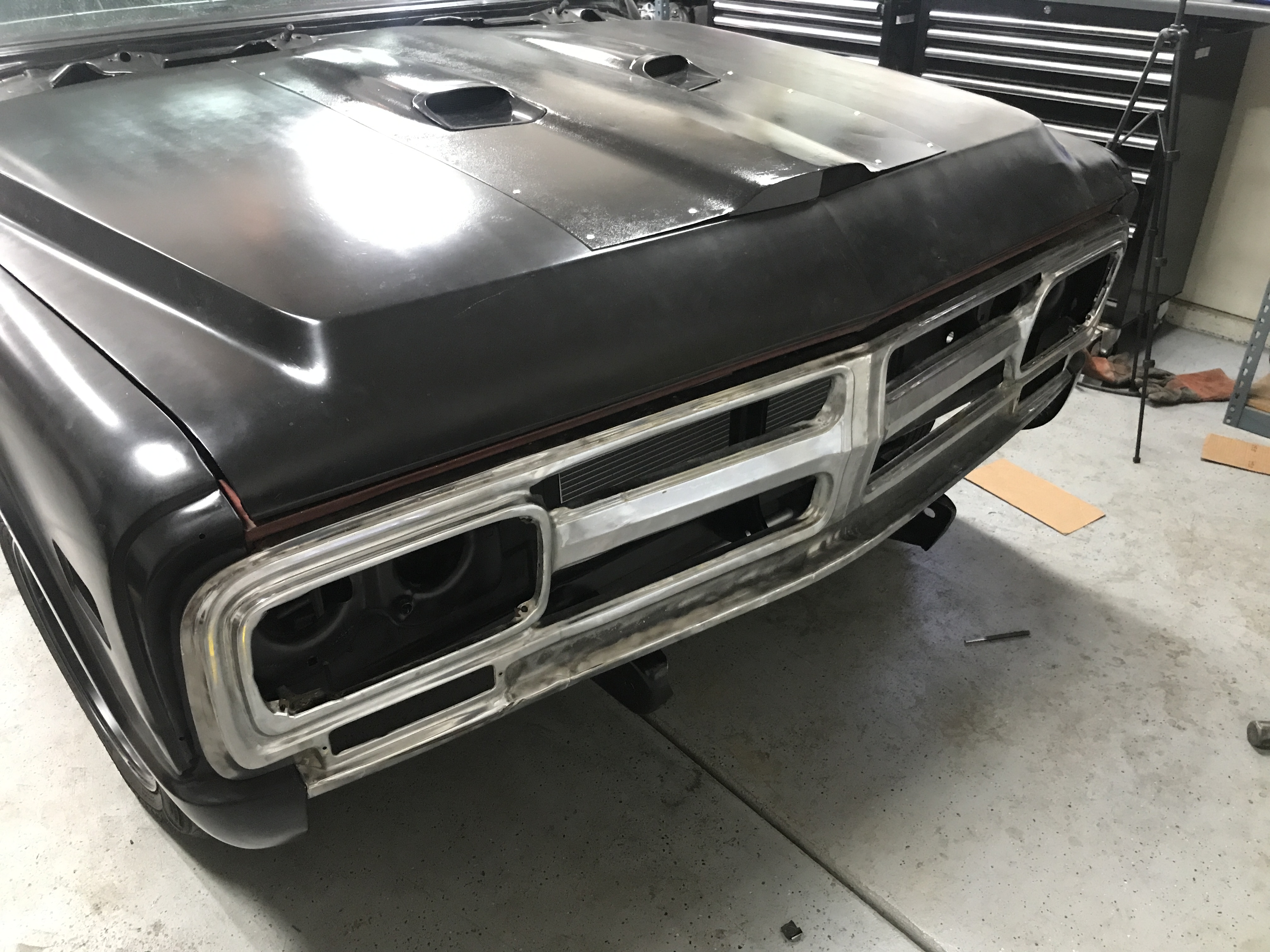

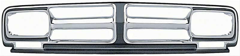

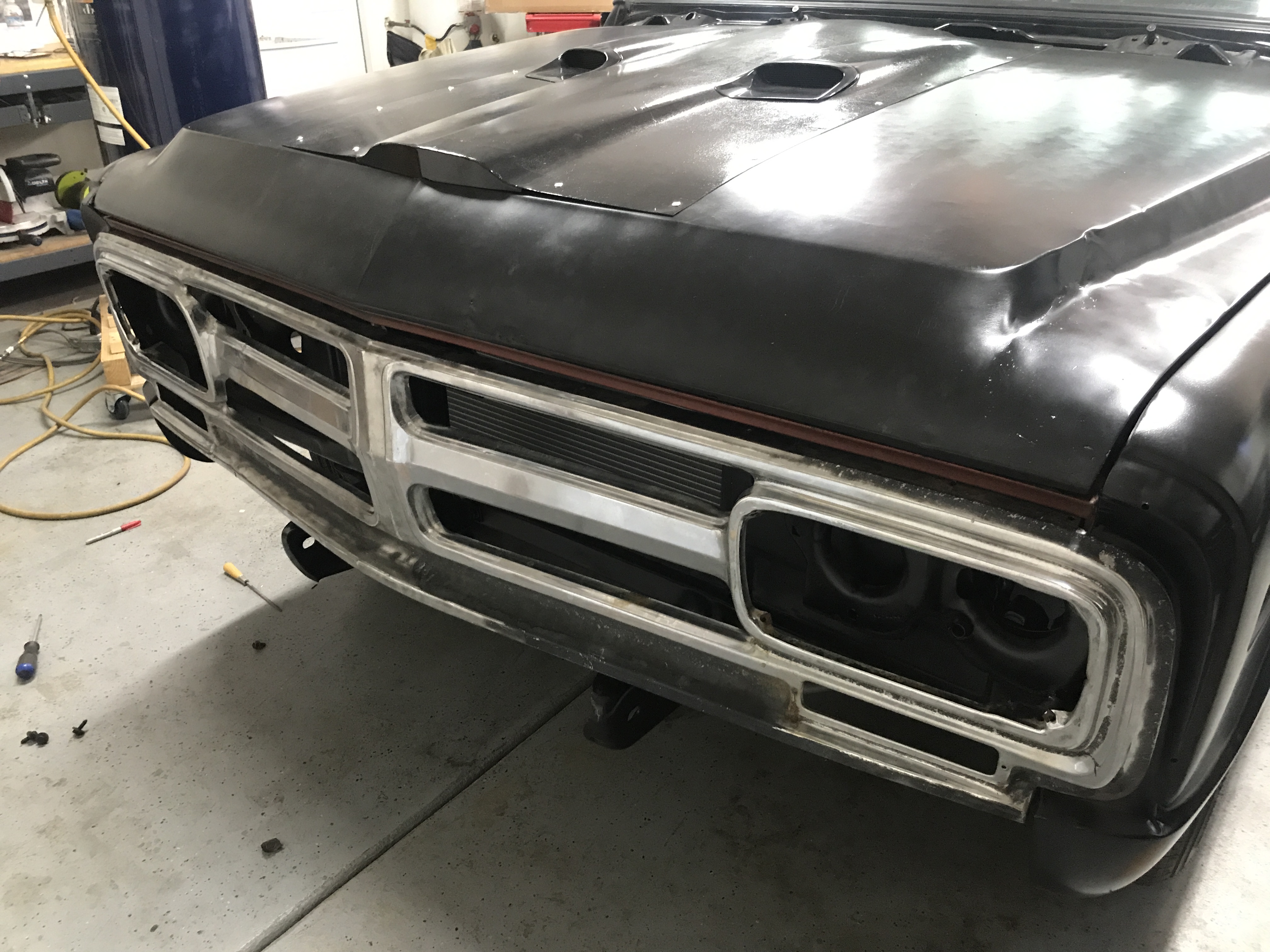

mounted the grill, are there any four eye car fans out there?
so need your advice, this is one of them faded '71-72 grills that had the innards painted black, should I paint that black again, or steel wheel the rest of the faded black off of it and just run it chrome?

Gregski wrote: Fri Jul 28, 2023 1:38 pm mounted the grill, are there any four eye car fans out there?
Not an EV, but I like the look of my '86 Mustang before they adopted the aero nose.
My 64 has a similar anodized aluminum grille and I decided to repaint the black. Still need someone with a steady hand to paint the letters, but since so much of the stuff I've added has been painted a satin black, I think it adds consistency to the design.

PatrcioEV-ATX wrote: Fri Jul 28, 2023 2:31 pm My 64 has a similar anodized aluminum grille and I decided to repaint the black. Still need someone with a steady hand to paint the letters, but since so much of the stuff I've added has been painted a satin black, I think it adds consistency to the design.
is that pic PhotoShopped, what did you do with all the junk in your garage? LOL

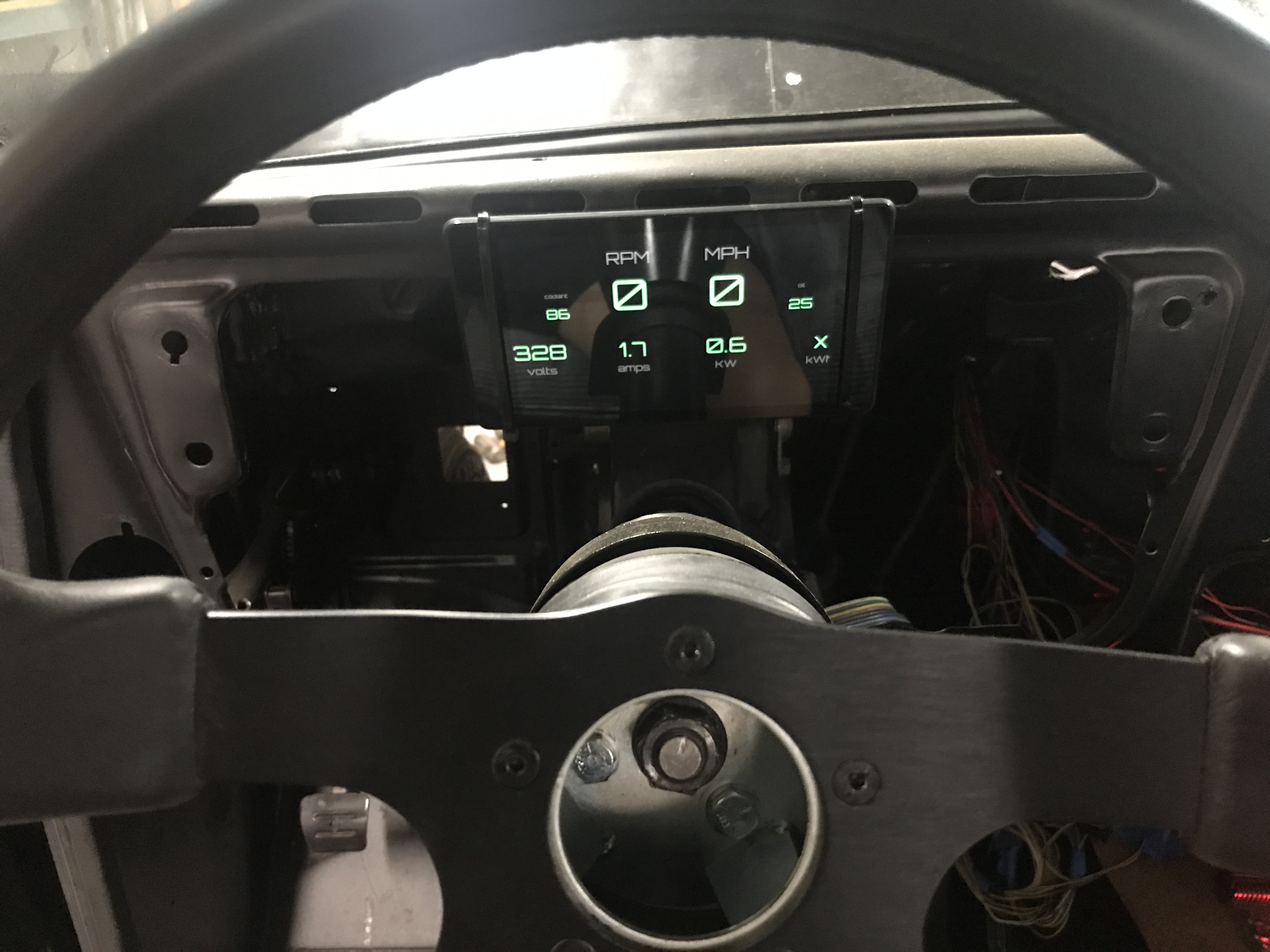

Post by Gregski »

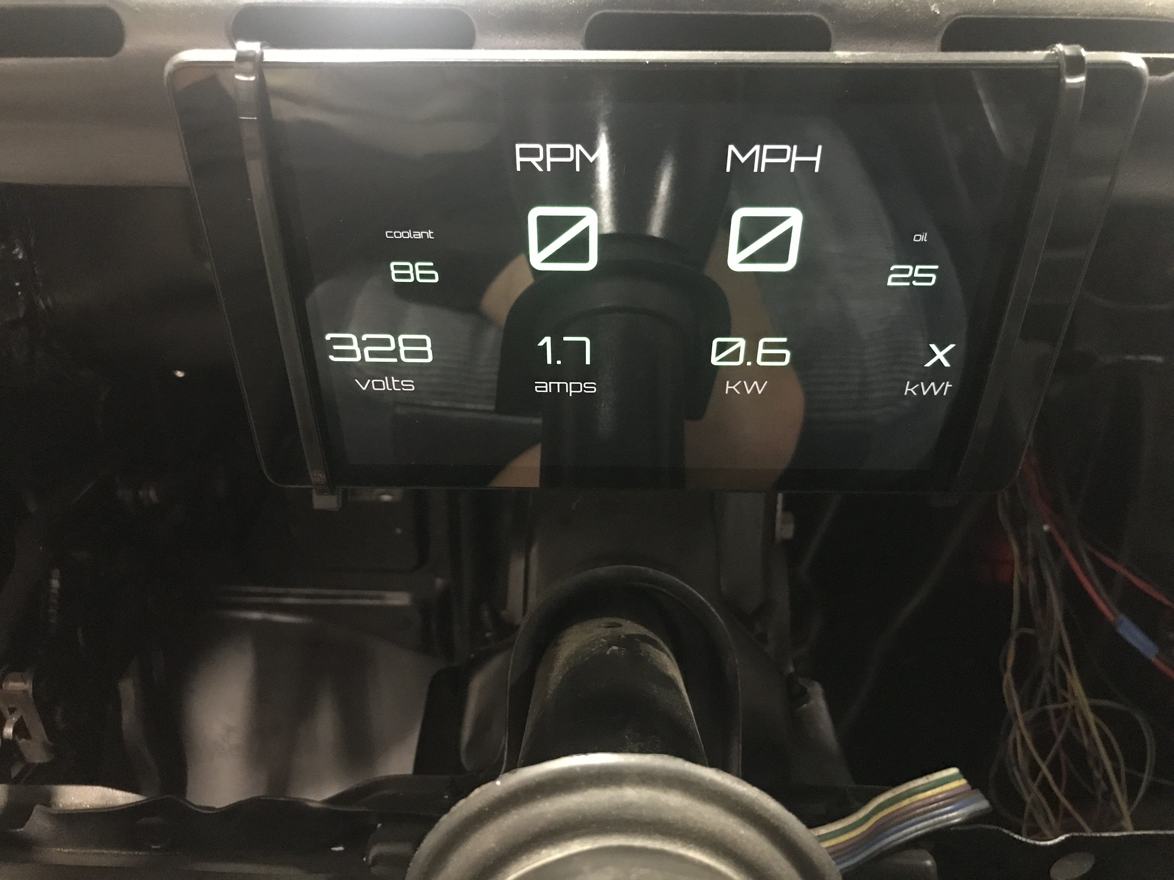

so now that I'm injured, I got a pro off of Craigslist to install my gauges for me, she did it cheap, and it only took her a couple hours

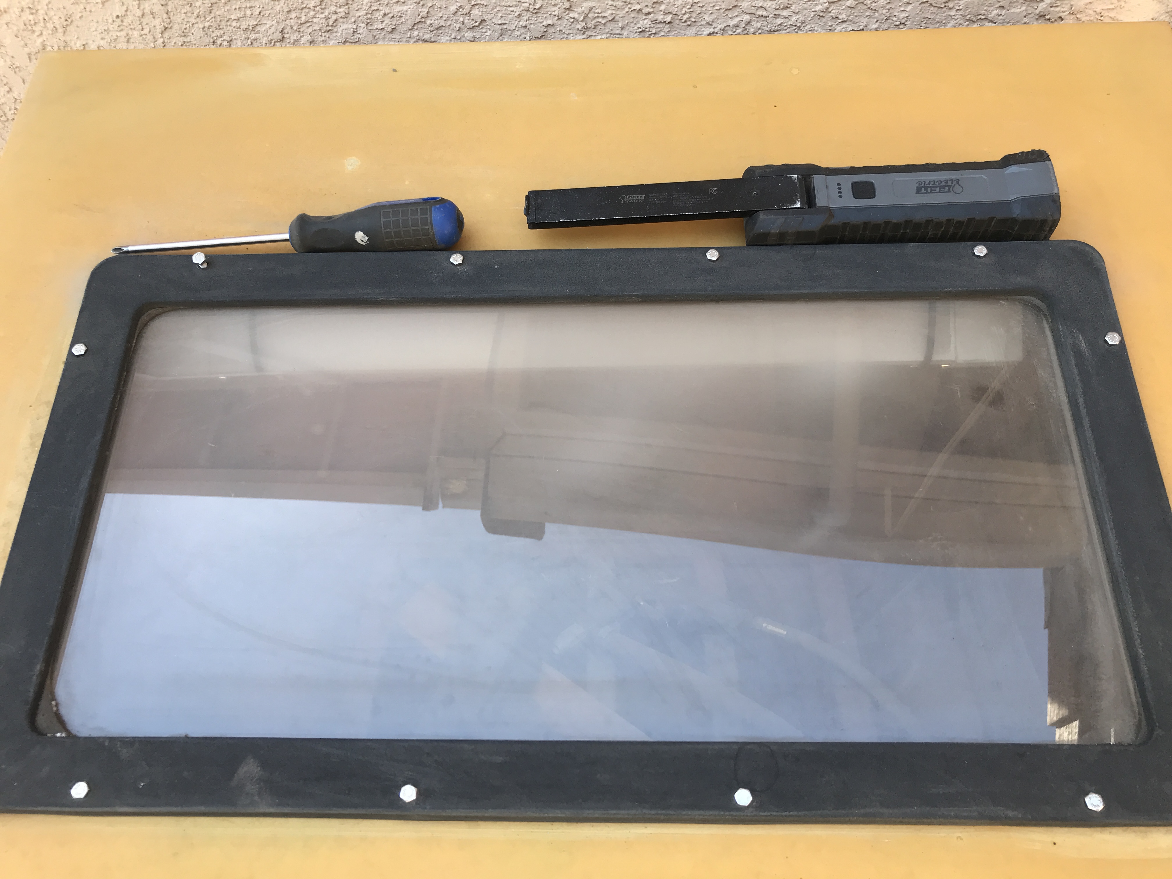

2. thought I be smart and stay off of it by doing some Arduino coding, upgraded to the latest IDE version 2.x and noticed it ran super slow, VCU updates took 15 minutes instead of 20 seconds, and then it crapped out my laptop, Arduino crashed and took down some DLLs with it, I literally uninstalled everything off of it except for Windows and it still is dog slow

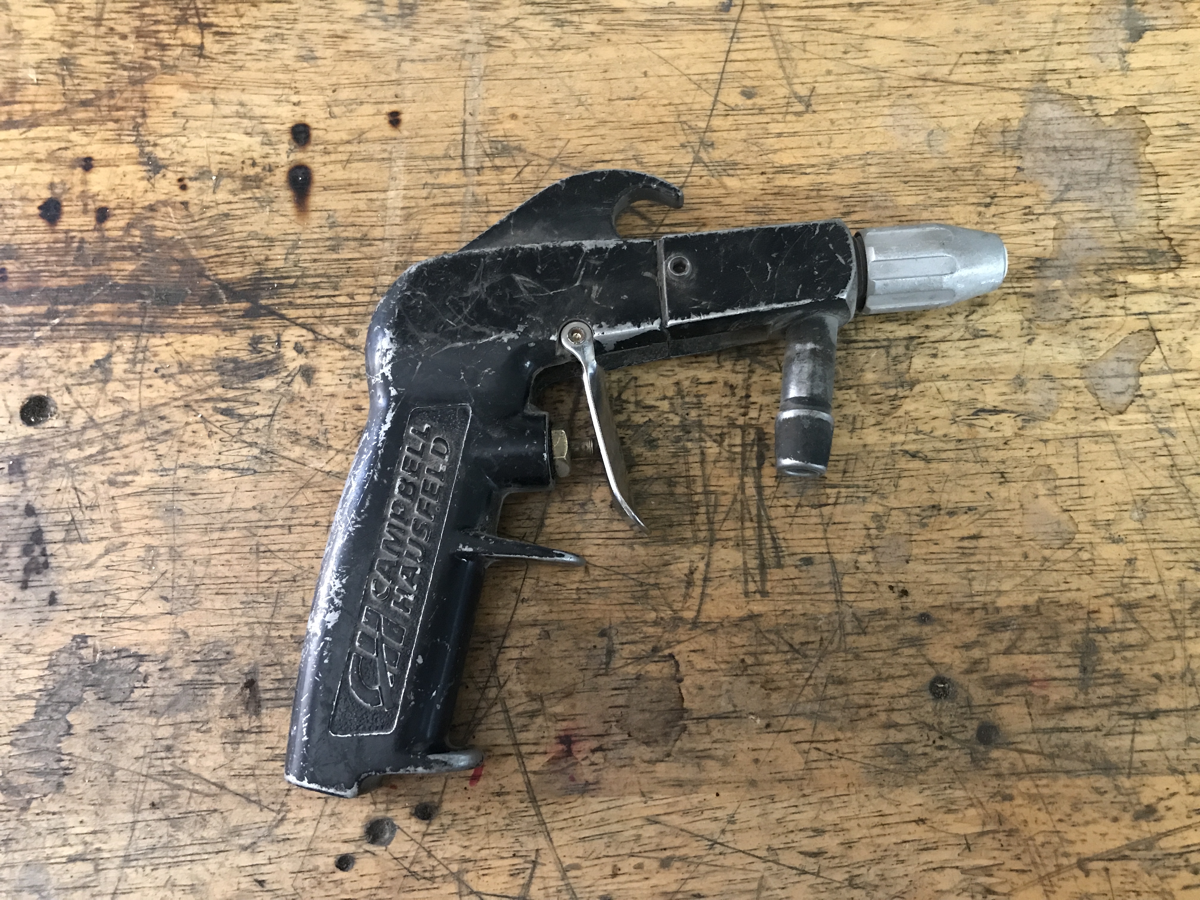

3. then I thought lets take out some frustration on the media blasting cabinet, well first all my media was all lumped up like concrete from sitting there over winter, funny this did not happen last winter, anyway sent that through a strainer, fired the shop vac up and noticed a gaping hole in the vacuum hose (the media blasting hose kit is brand new less than 1 years old) so duct taped that, fired up the compressor, remembered my gloves were torn, so mounted brand new gloves I had on the shelf, then noticed my gun keeps getting stuck in the on position, so took it apart, brake cleaner sprayed it, lubed up the o-rings, put it back together, and 2 minutes later it jammed again, replaced that gun with a spare gun, 3 minutes later that gun jammed in the open position, all this time I can't see shiet through the viewing glass, and its brand new too but I leave my media blasting cabinet outside, so the sun must have had it's way with it, look up Grainger my part supplier, yup CLOSED TILL MONDAY...

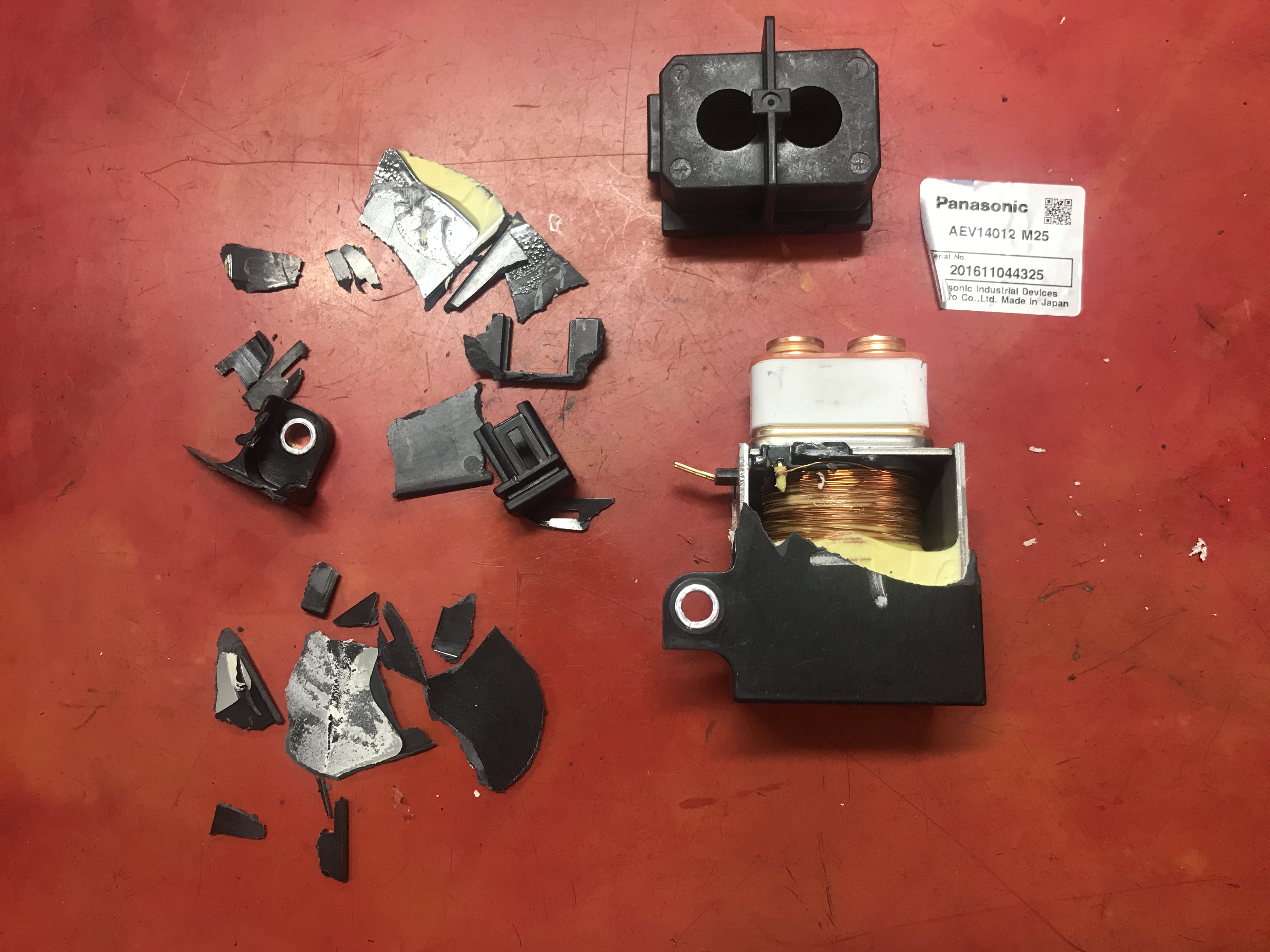

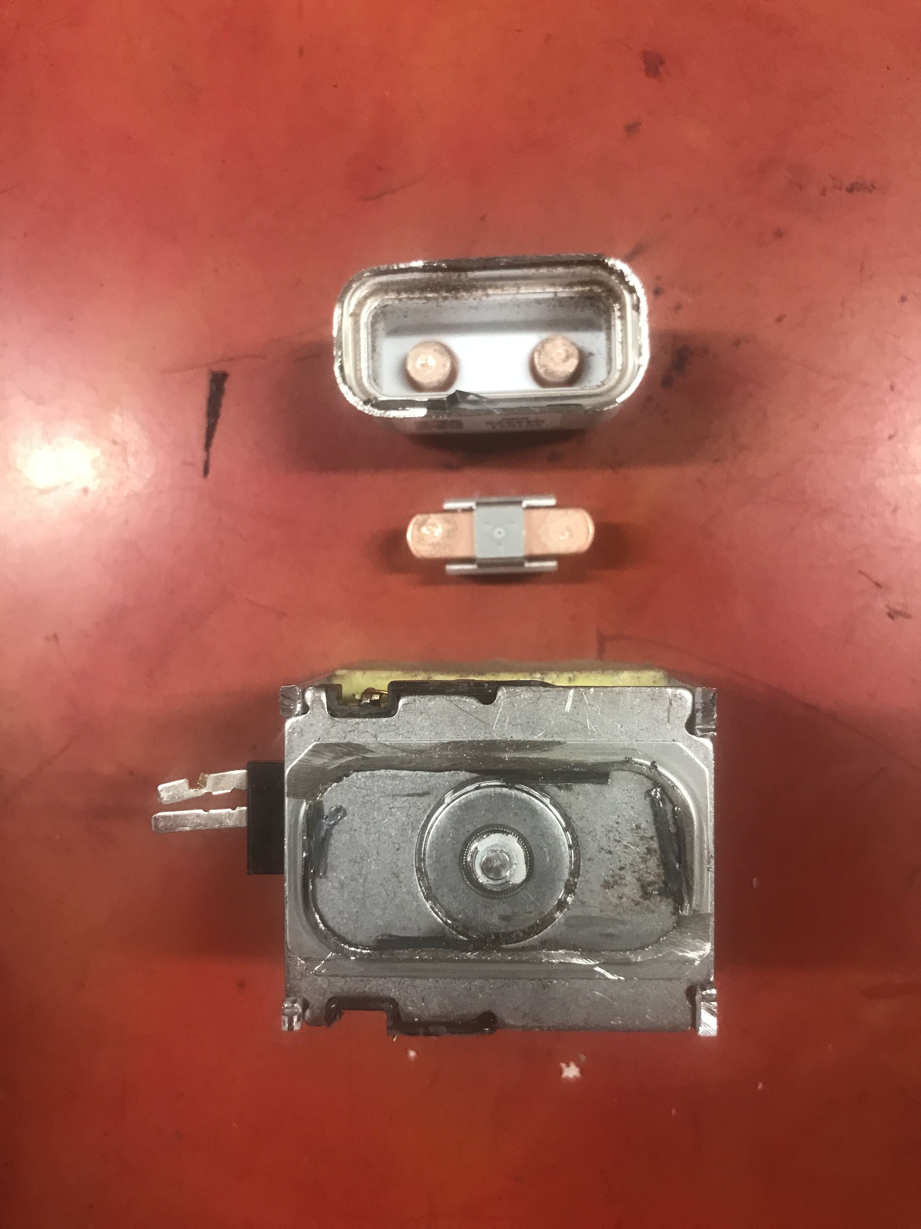

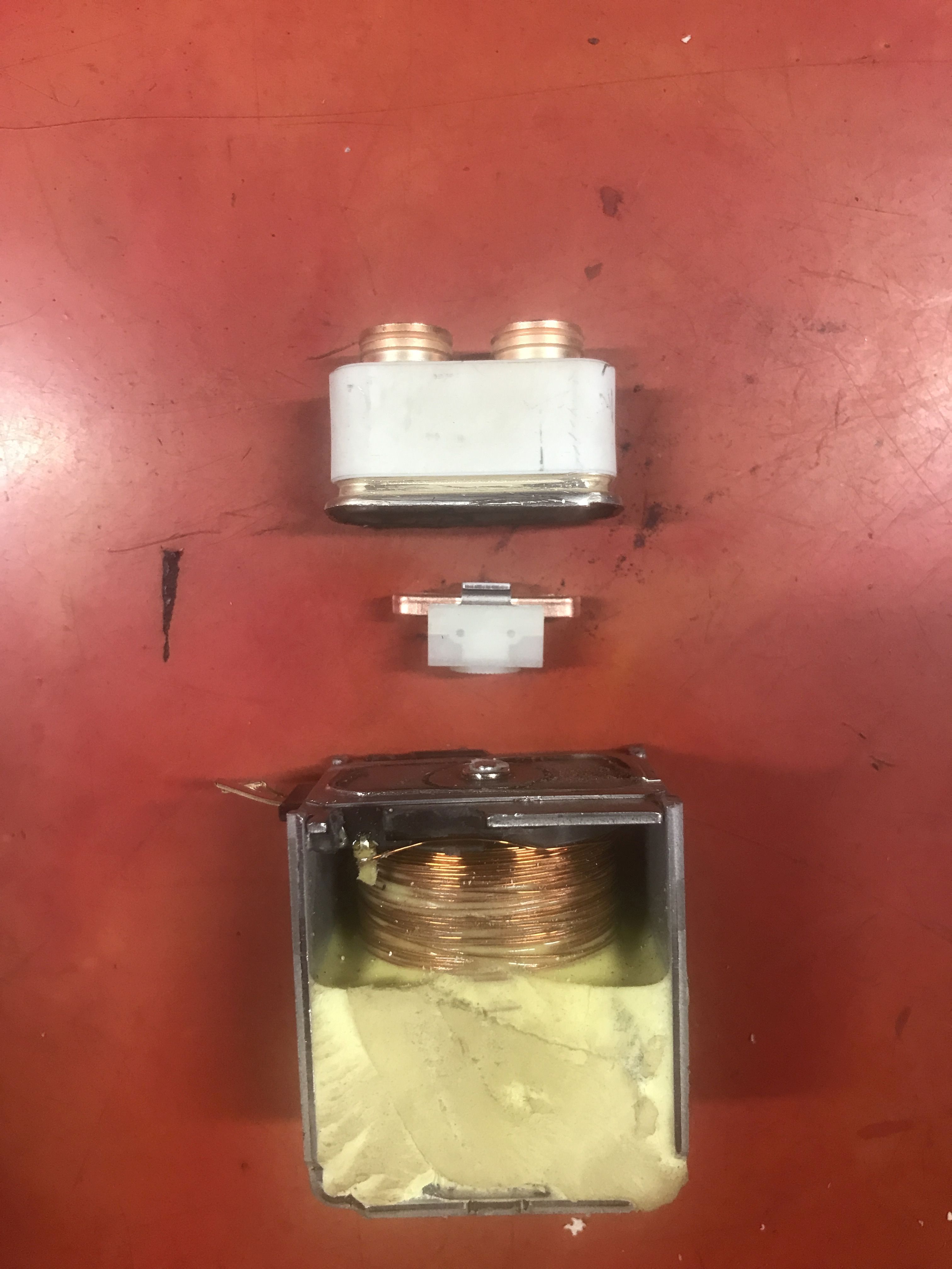

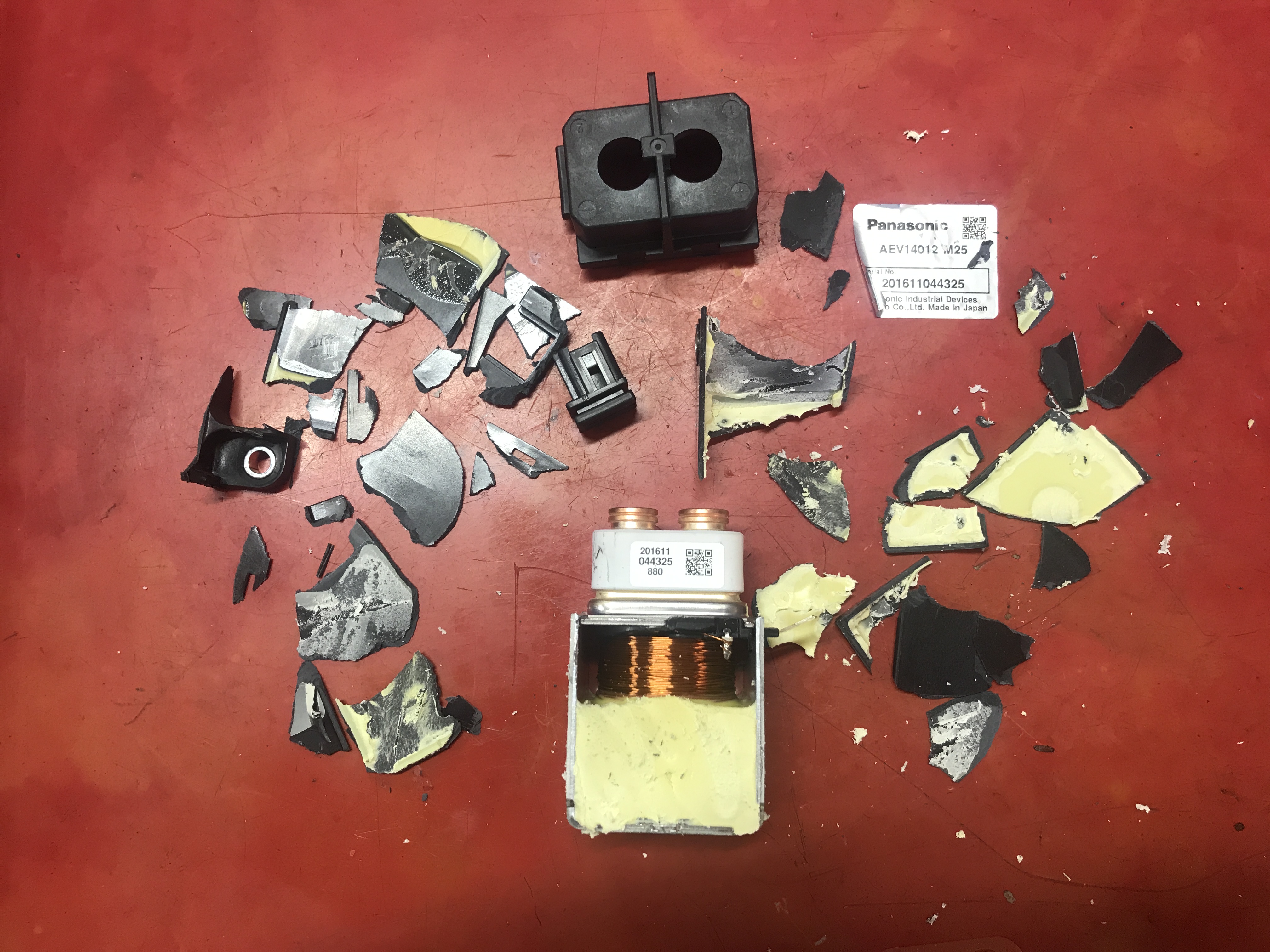

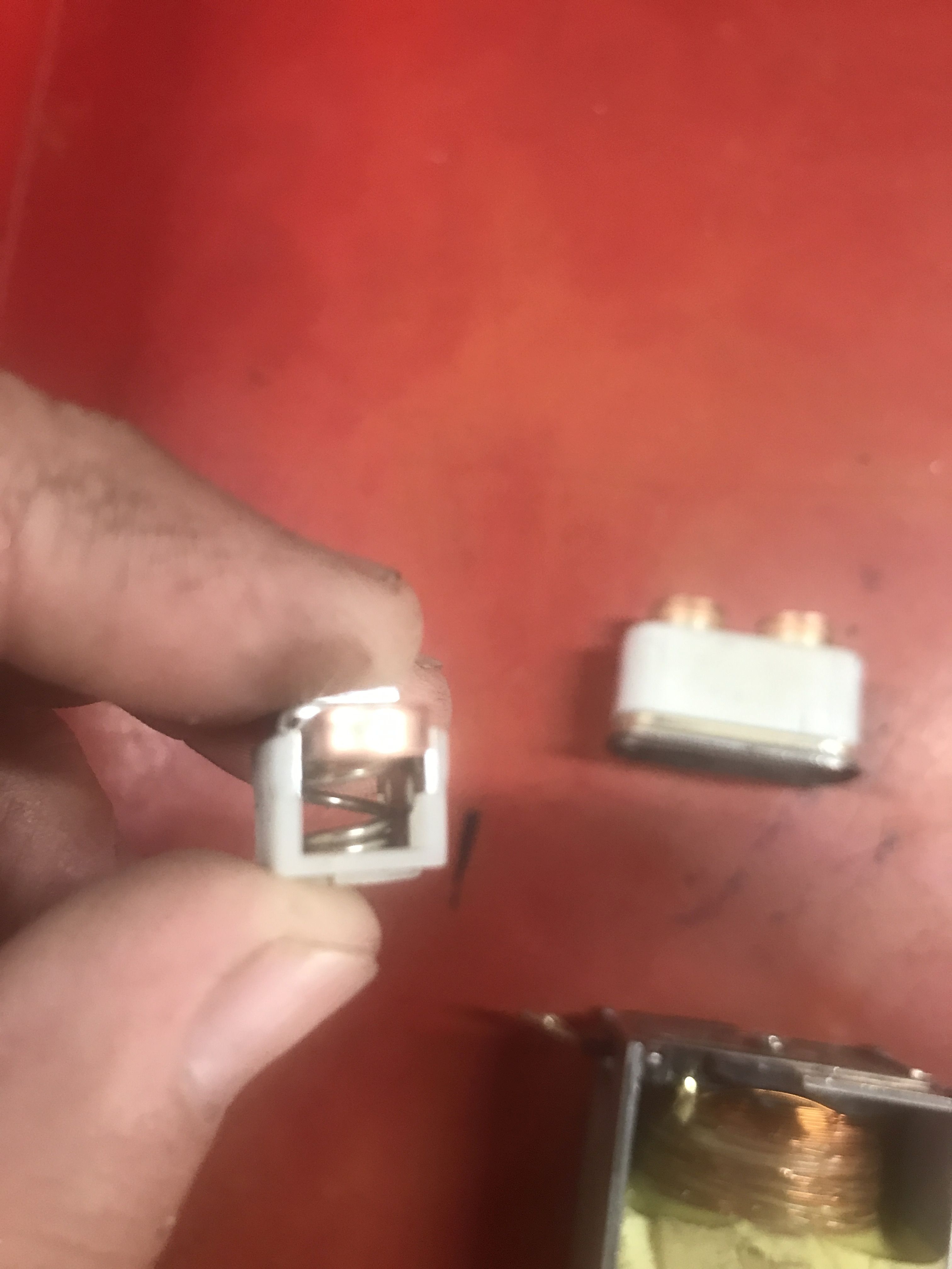

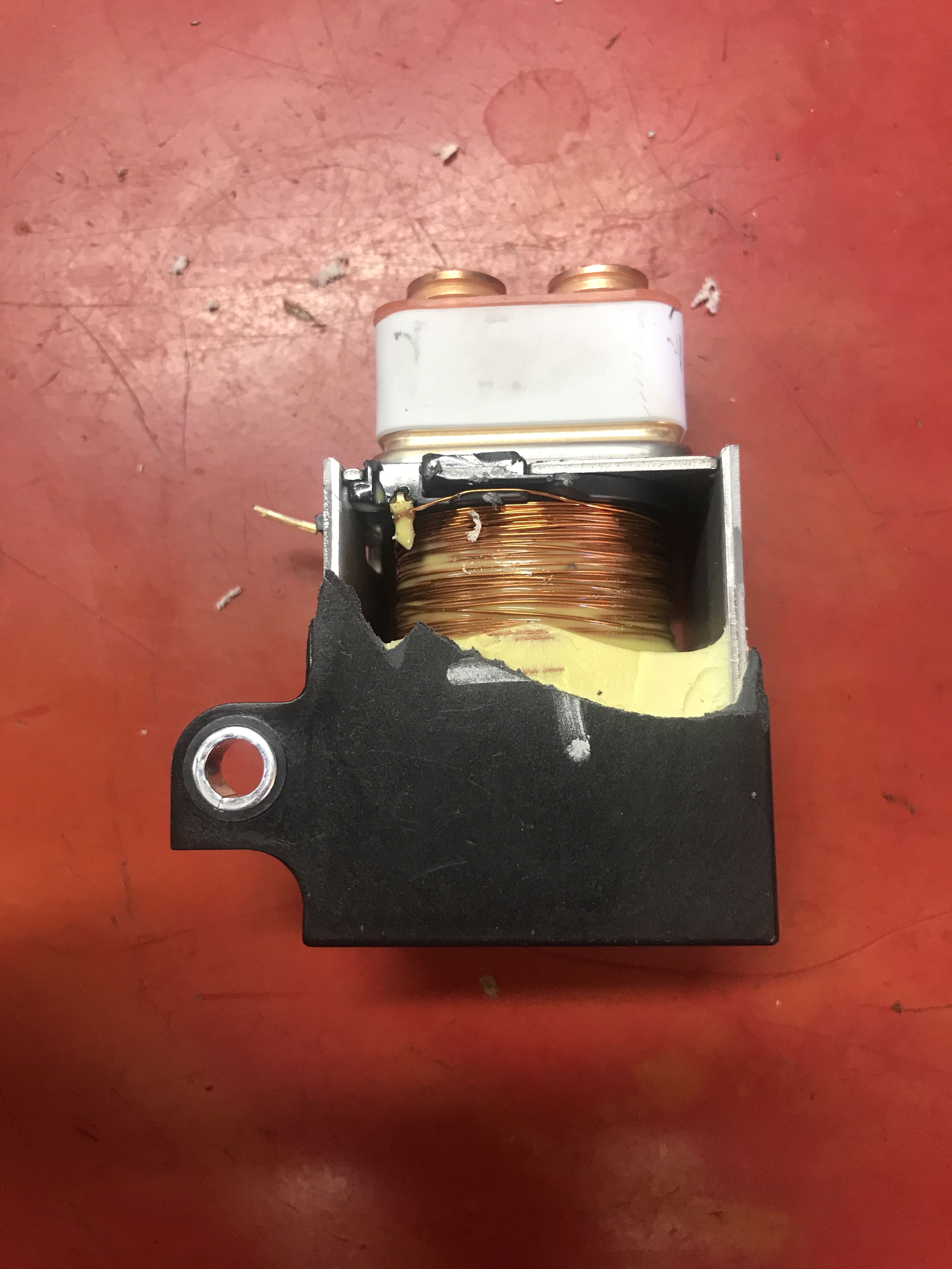

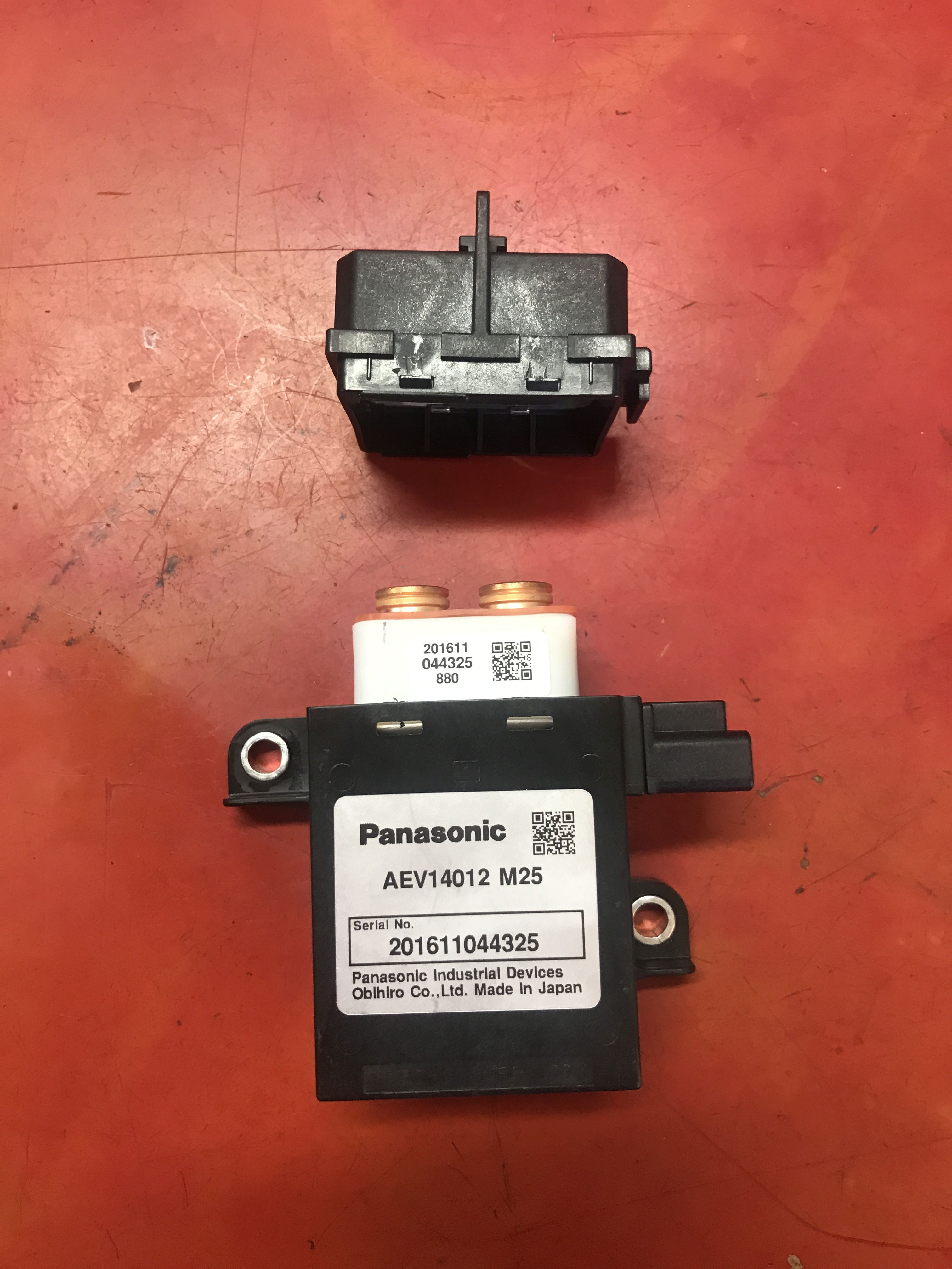

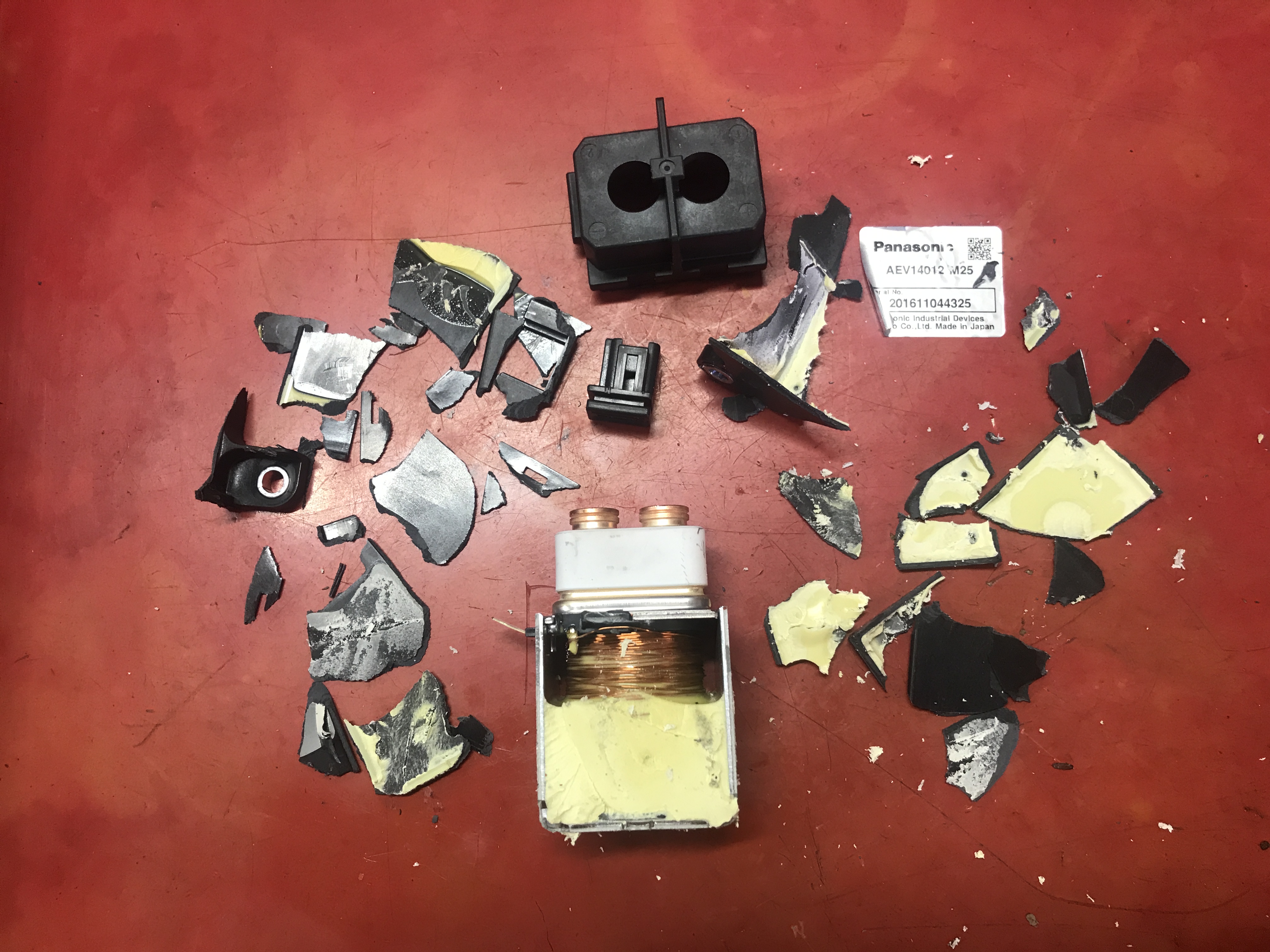

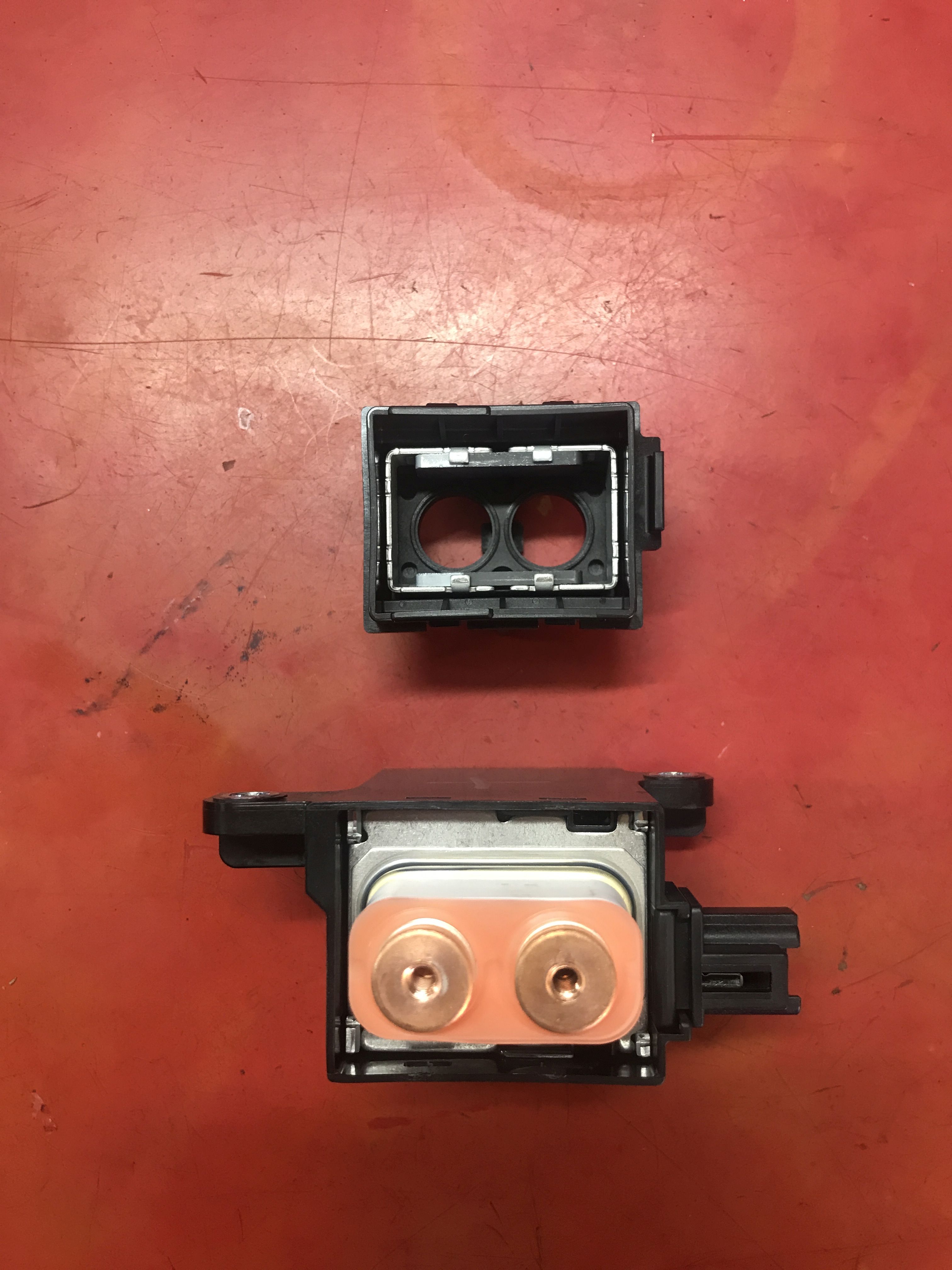

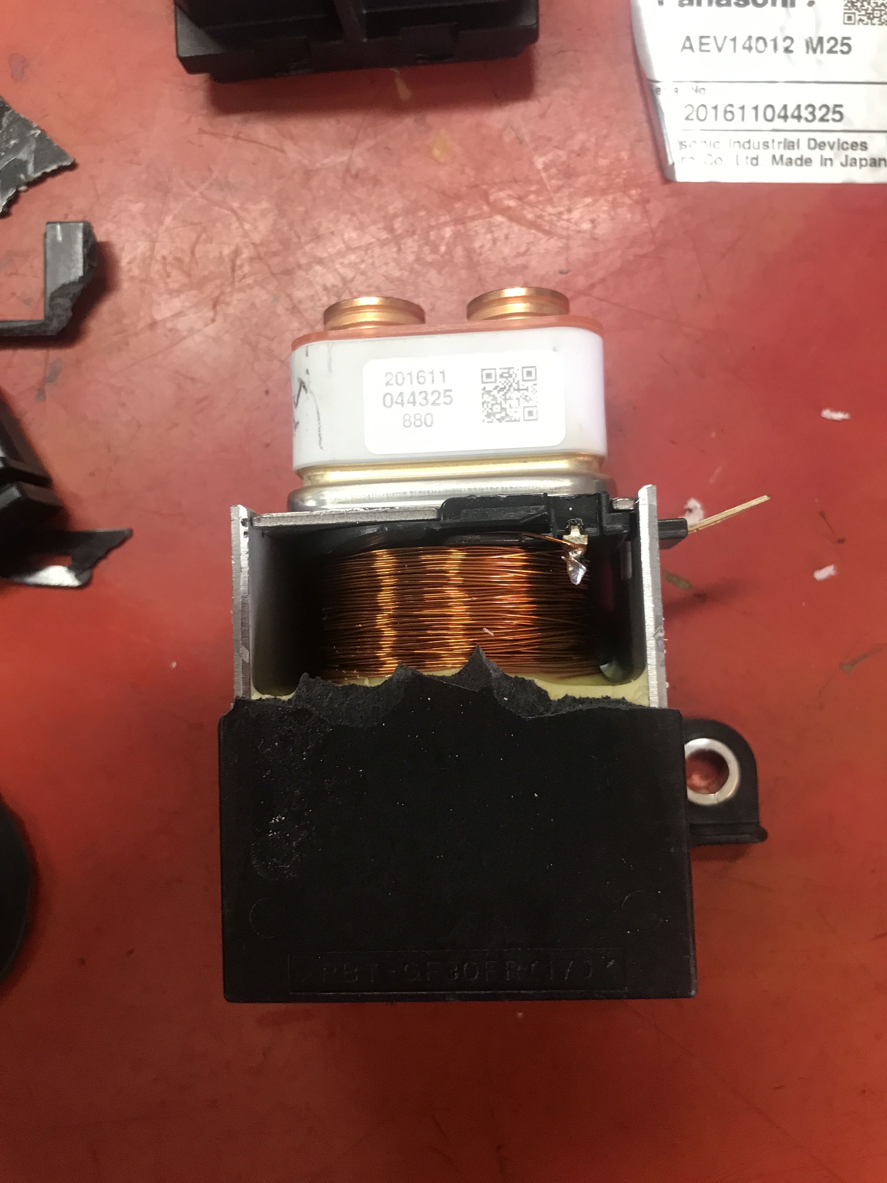

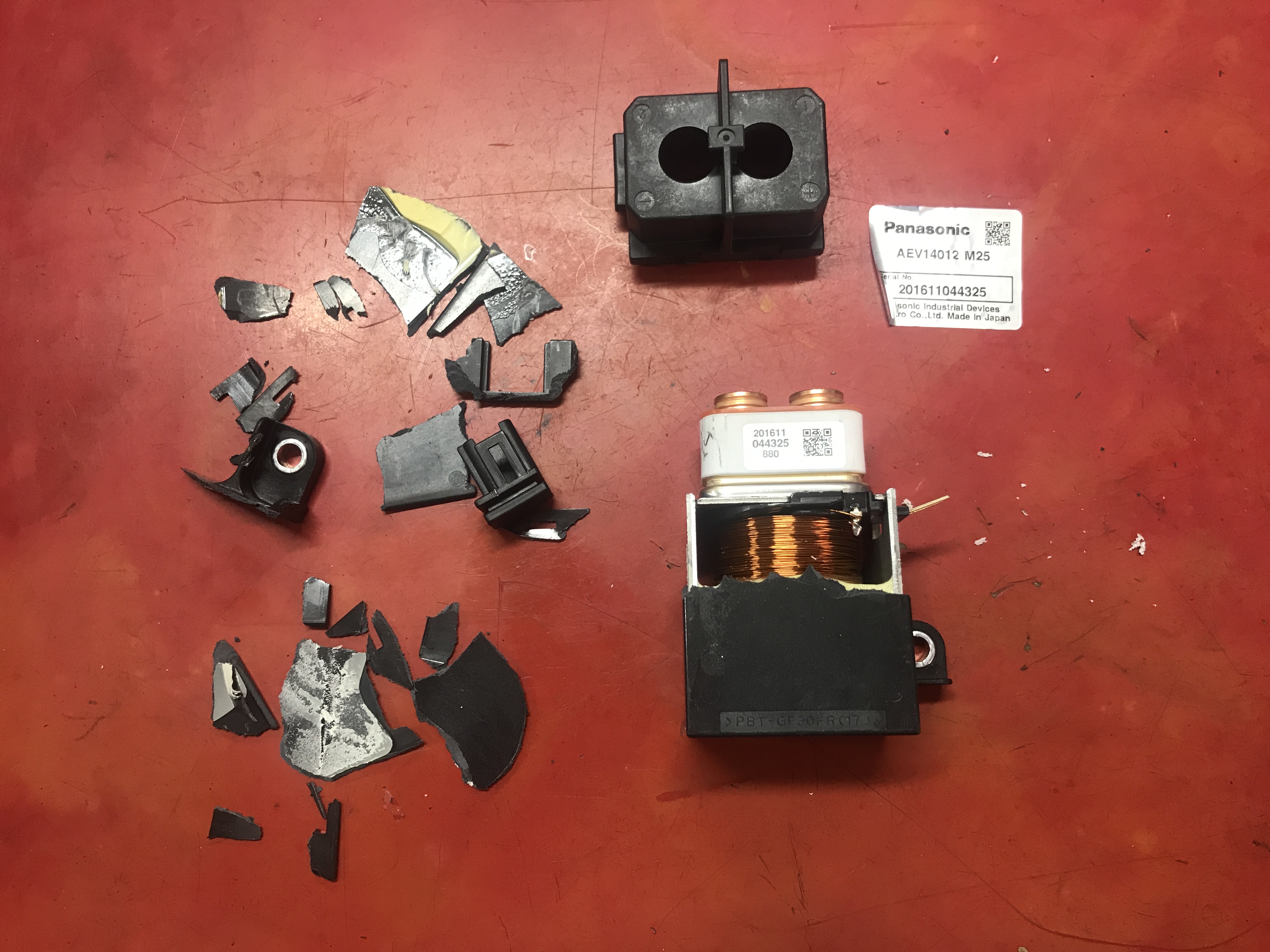

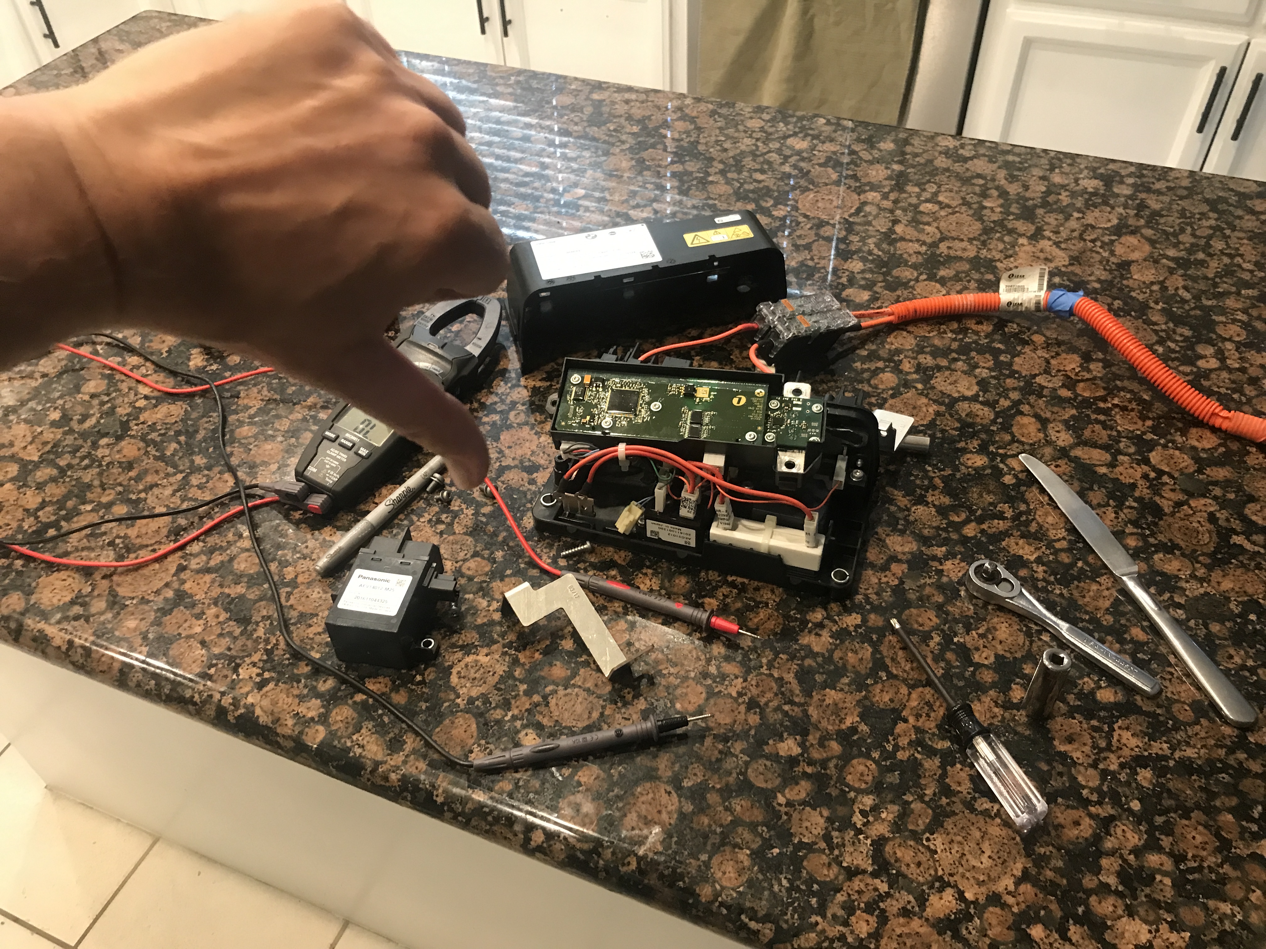

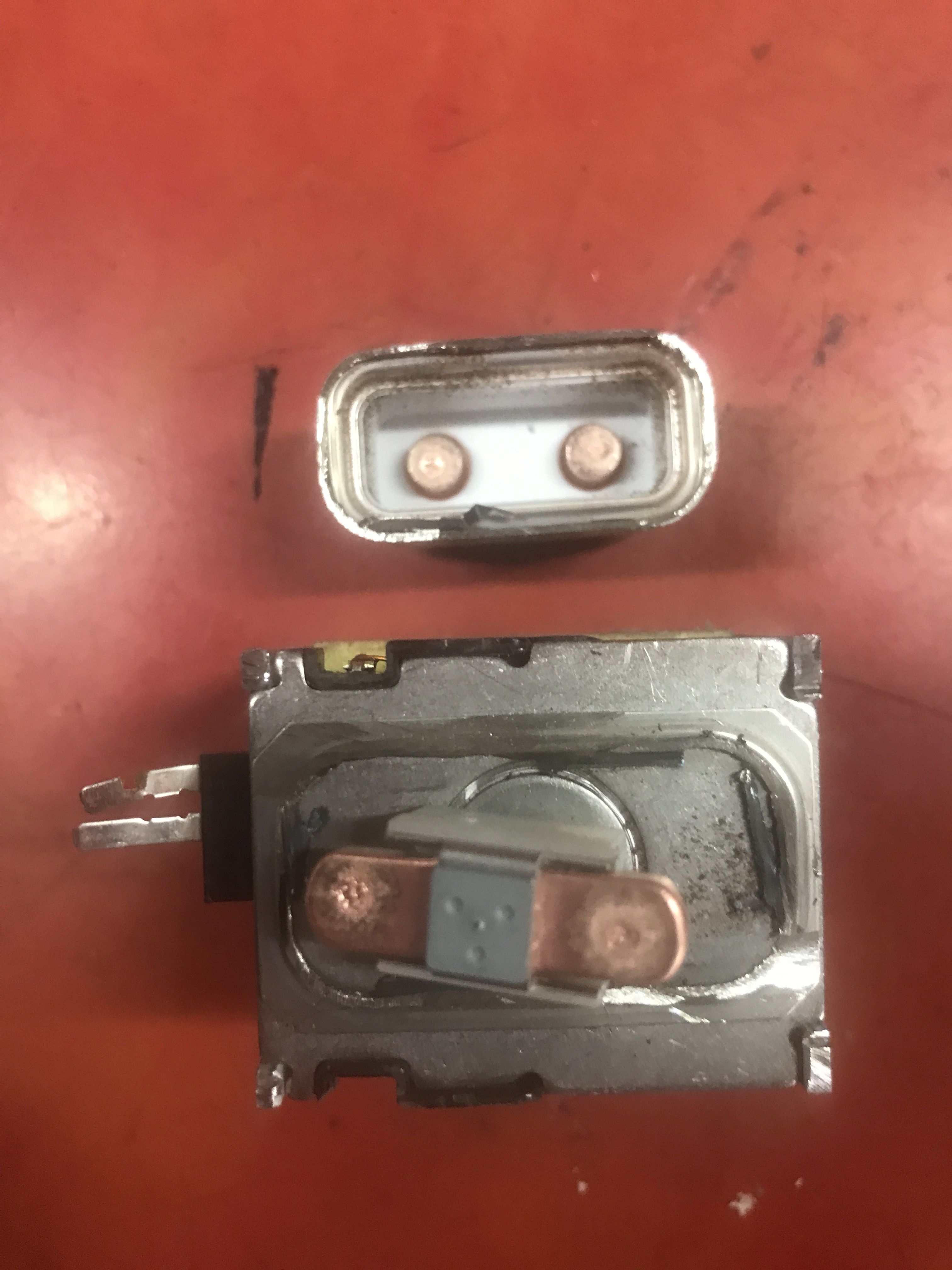

HOUSTON WE HAVE A PROBLEM
so I go to make a high voltage connection from my Chevy Volt charger to my fuse box which is already connected to the Safety Box and serving the DC DC converter, but something tells me to check the voltage first with a multimeter, so I do that and I got 200 volts DC live on that fuse block, that shouldn't happen the S-box is OFF ?!?!
um, no, no it is not, I can NOT turn off my BMW Safety Box, oh it clicks like it is turning off but the voltage remains
a quick audible continuity test and ...
ah yup, both contactors welded shut !!!
it must be a logic flaw in the automated BMW Safety Box code that is supposed to pre charge the inverter and then close both contactors
delgadb2
Posts: 8
Joined: Fri Jul 02, 2021 9:54 pm
Post by delgadb2 »
You can give the contactors a couple whacks with a hammer or screwdriver handle and they should pop free... should.

Post by Gregski »
delgadb2 wrote: Mon Jul 31, 2023 4:21 pm You can give the contactors a couple whacks with a hammer or screwdriver handle and they should pop free... should.
RetroZero
Posts: 947
Location: France
Has thanked: 645 times
Been thanked: 64 times
Post by RetroZero »
I see you started off by playing nice..... started off I said. Sorry to see you have work cut out again.... I know that feeling. I suppose it's running pwm once closed.

Post by crasbe »
I don't think a sledge hammer was the recommended hammer, but oh well 😅

crasbe wrote: Mon Jul 31, 2023 7:04 pm I don't think a sledge hammer was the recommended hammer, but oh well 😅
this was the positive contactor, I also removed the negative contactor and tried tapping it with a proper hammer to no avail
crasbe
Posts: 330
Location: Germany
Has thanked: 58 times
Been thanked: 180 times
Post by crasbe »
To be fair though: A once welded contactor usually has a pretty severed degradation of the contact surfaces, leading to either a unreliable connector or repeated welding in the future. It might be fine, it might not be.
Either way, a contactor that loses contact mid-drive or a contactor with high resistance, leading to higher power dissipation is pretty undesireable.
