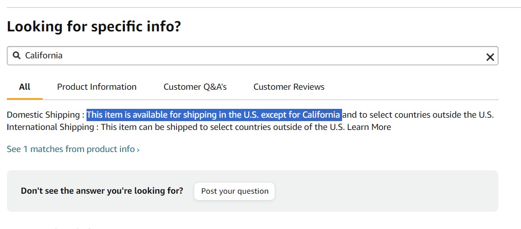

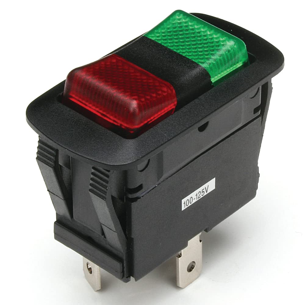

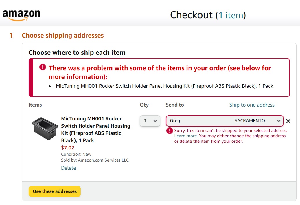

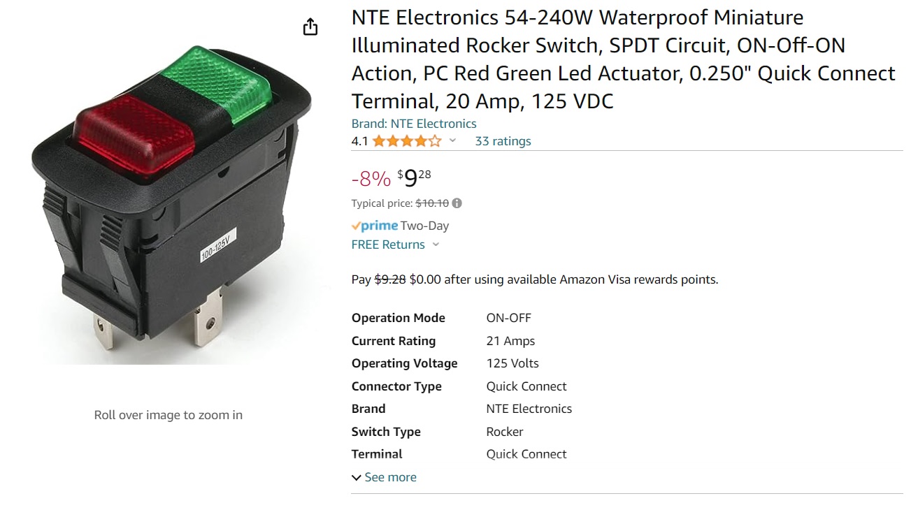

Nobody: hey what's it like trying to do an EV Conversion in California?
Me: it sucks
so I ordered this three way rocker switch, up (green) will be for Drive and down (red) will be for charge, yes this will be done manually during the first phase of the project, well, AMAZON shipped the switch but refuses to ship its housing as it may cause California in the state of Cancer!
the struggle is real
Me: it sucks

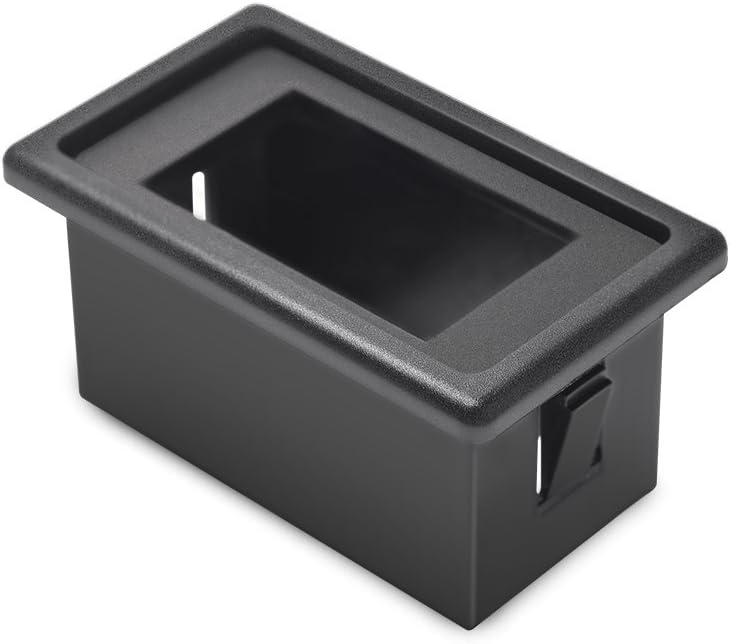

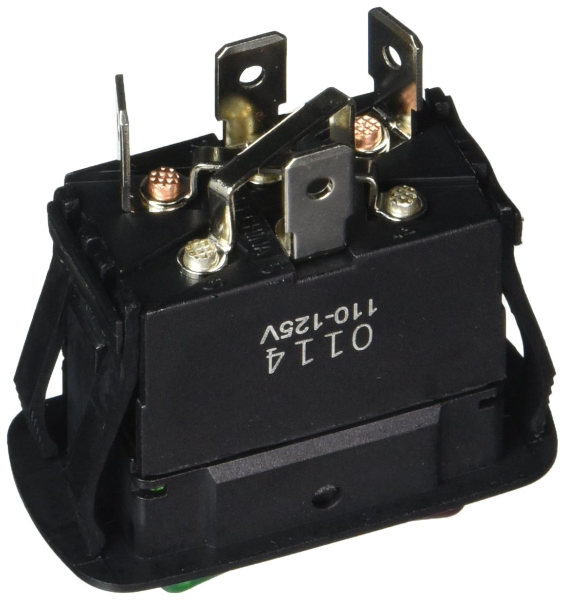

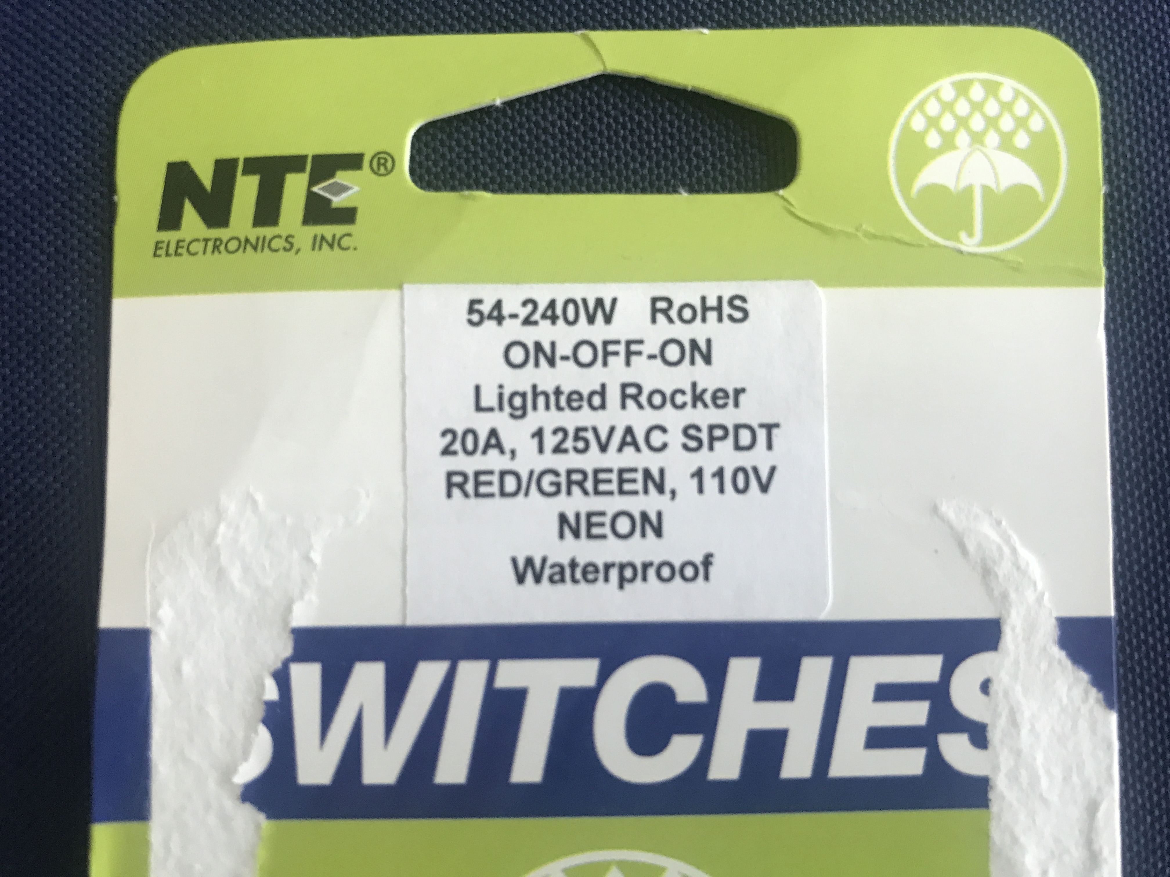

oh this toggle switch, the gift that keeps on giving, so it was advertised on AMAZON as a DC switch but then they shipped me an AC switch

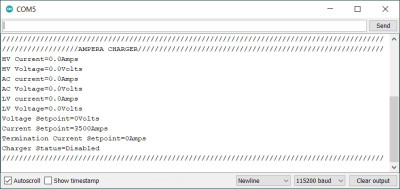

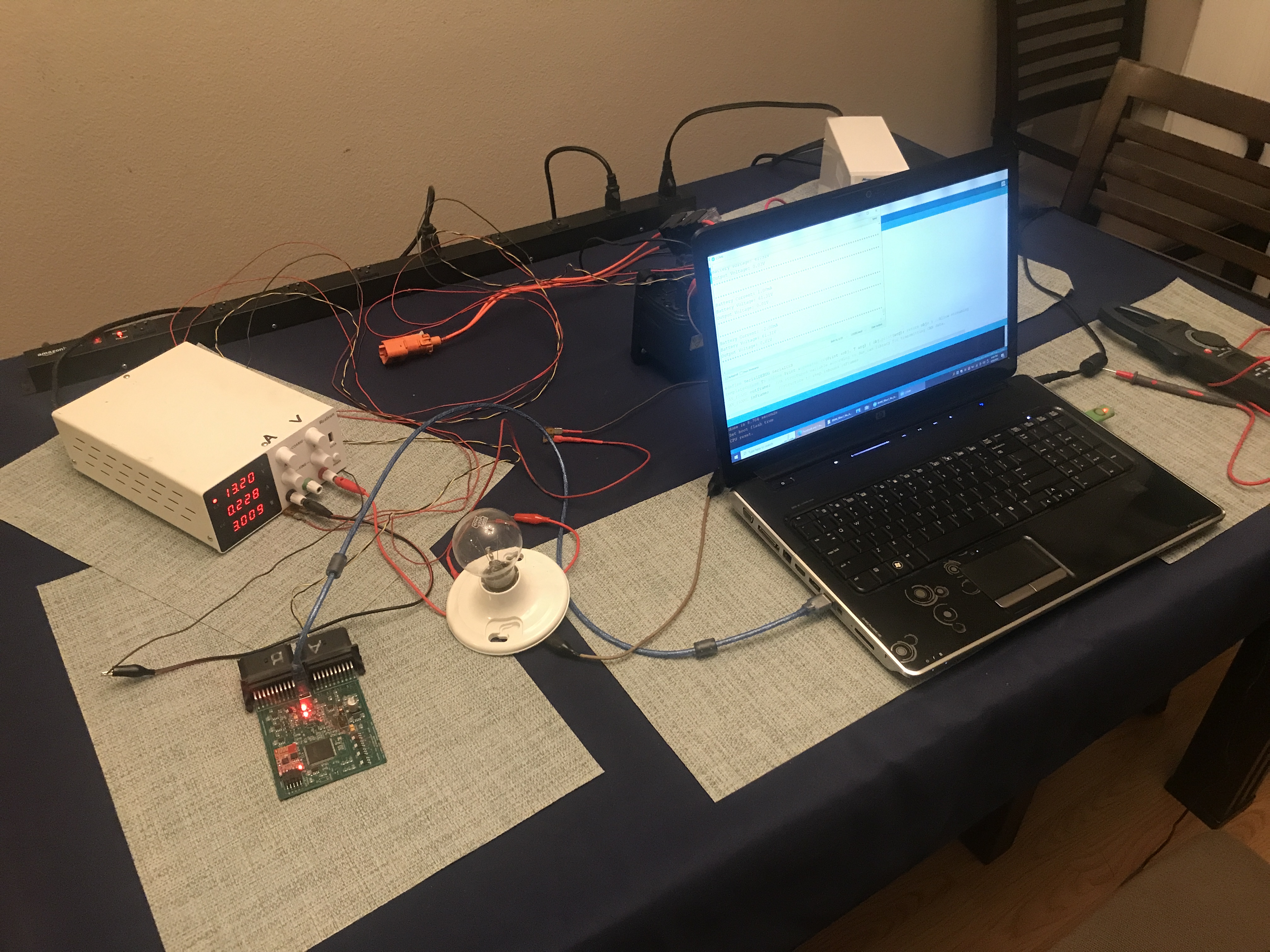

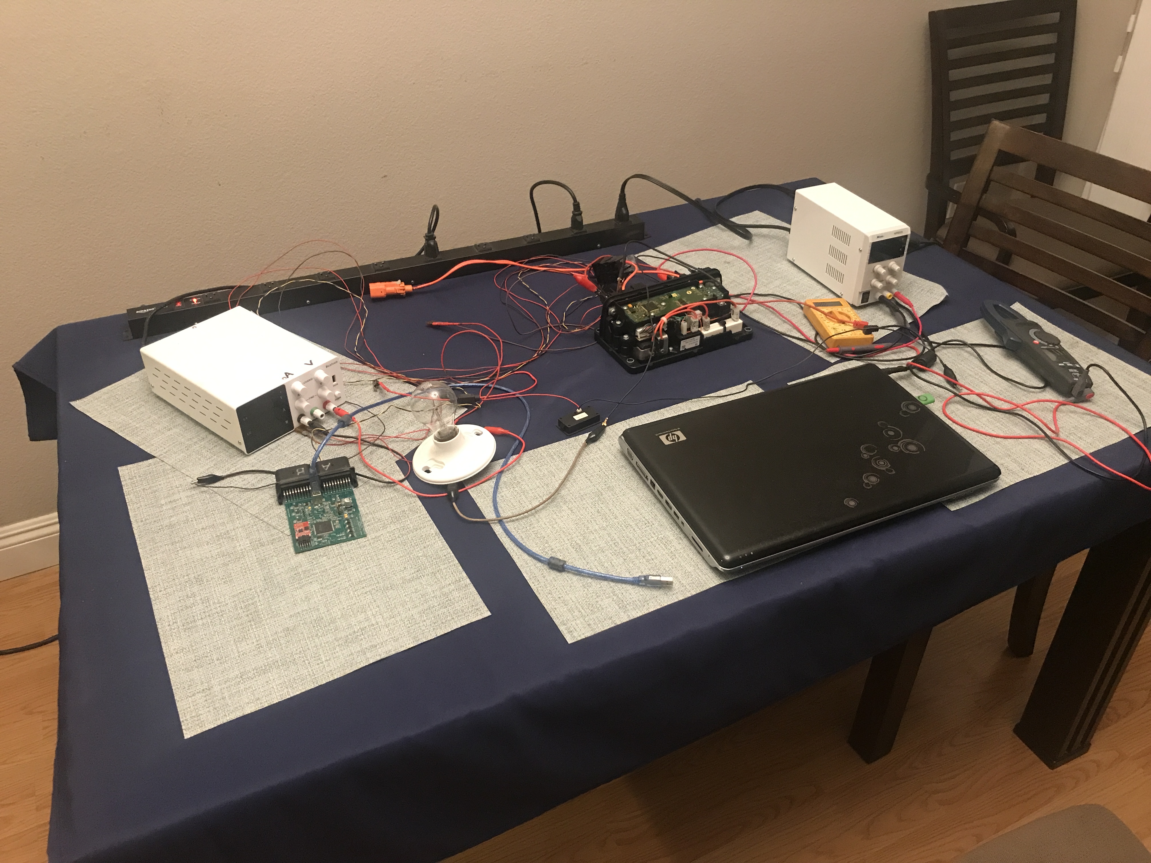

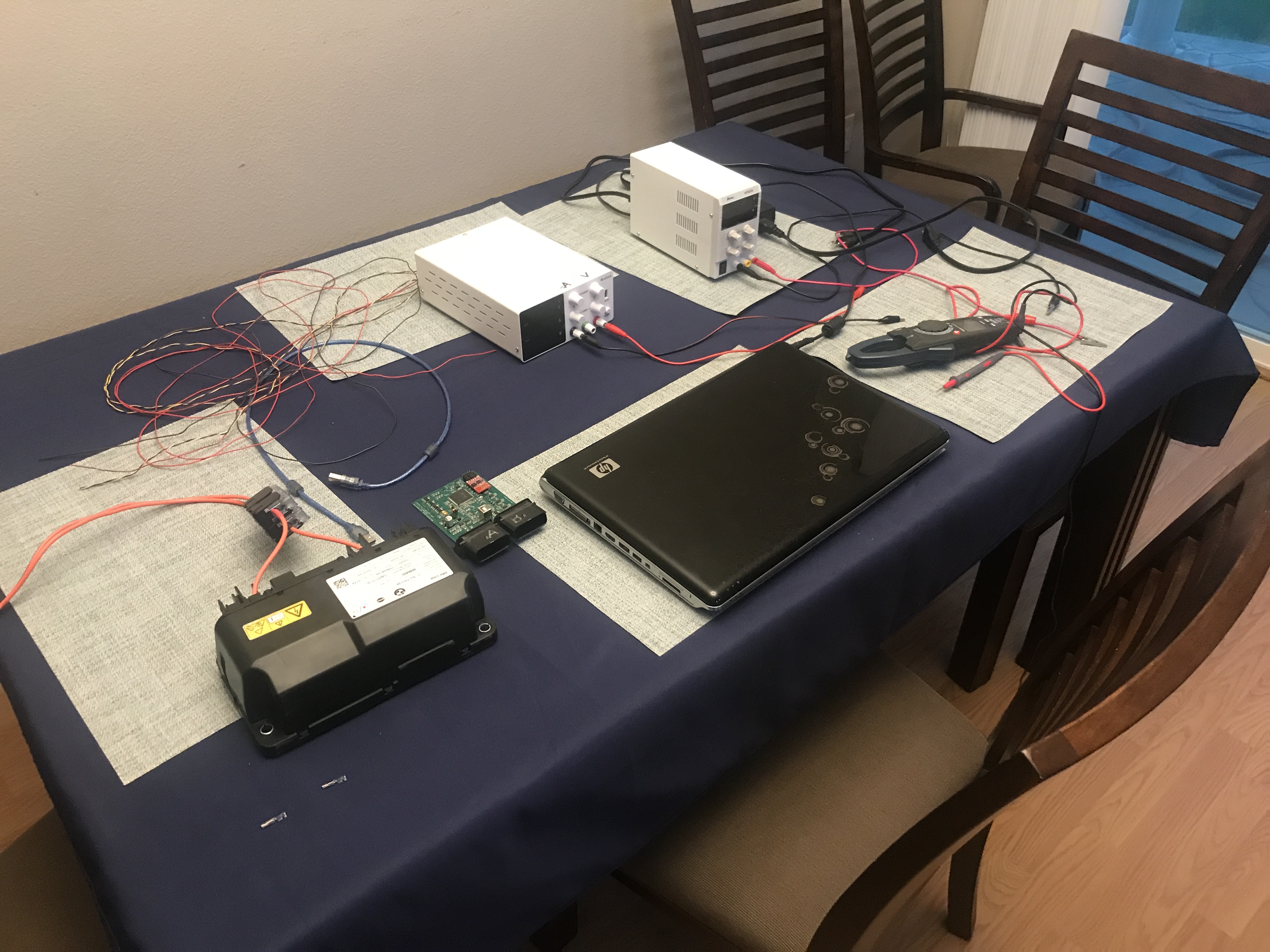

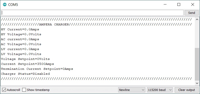

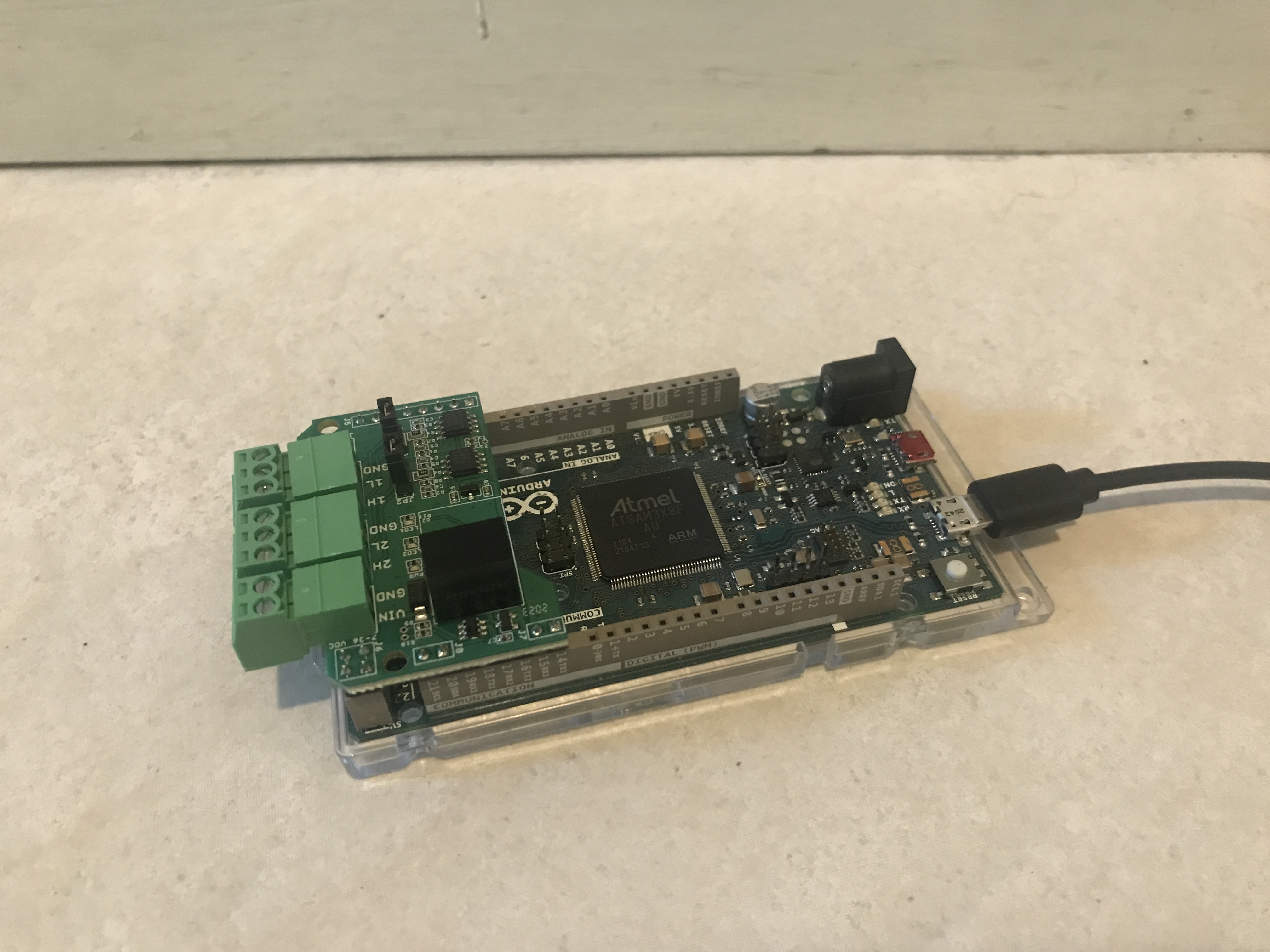

Charging for the first time using a first gen Chevy Volt onboard charger, Arduino Due (with a COPPERHILL TECHNOLOGIES Dual CAN Bus Interface For Arduino Due With Extended Power Range CAN bus shield), and Damien Maguire's free code off of GitHub, thank you sir

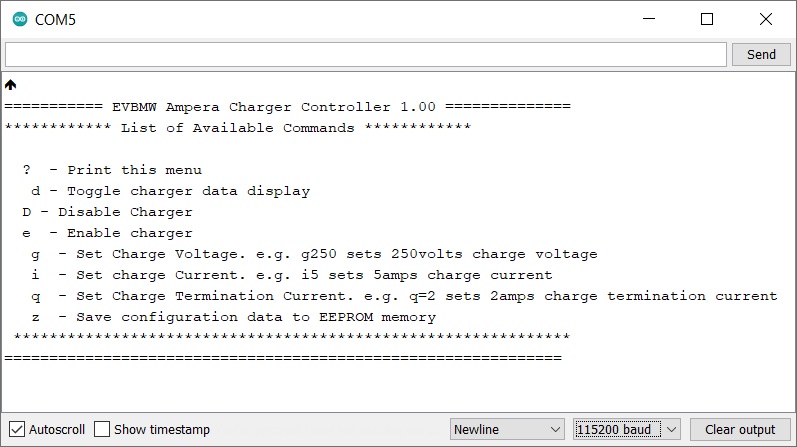

so this is what the simple Charger Menu looks like, I just wanted to show it to you guys, it is so easy to use:
[me commenting from the future on the apparatus below, though it will work, you will not be able to save your configuration settings such as Volts, and Amps setpoints to the EEPROM, since the Due does NOT have an EEPROM]

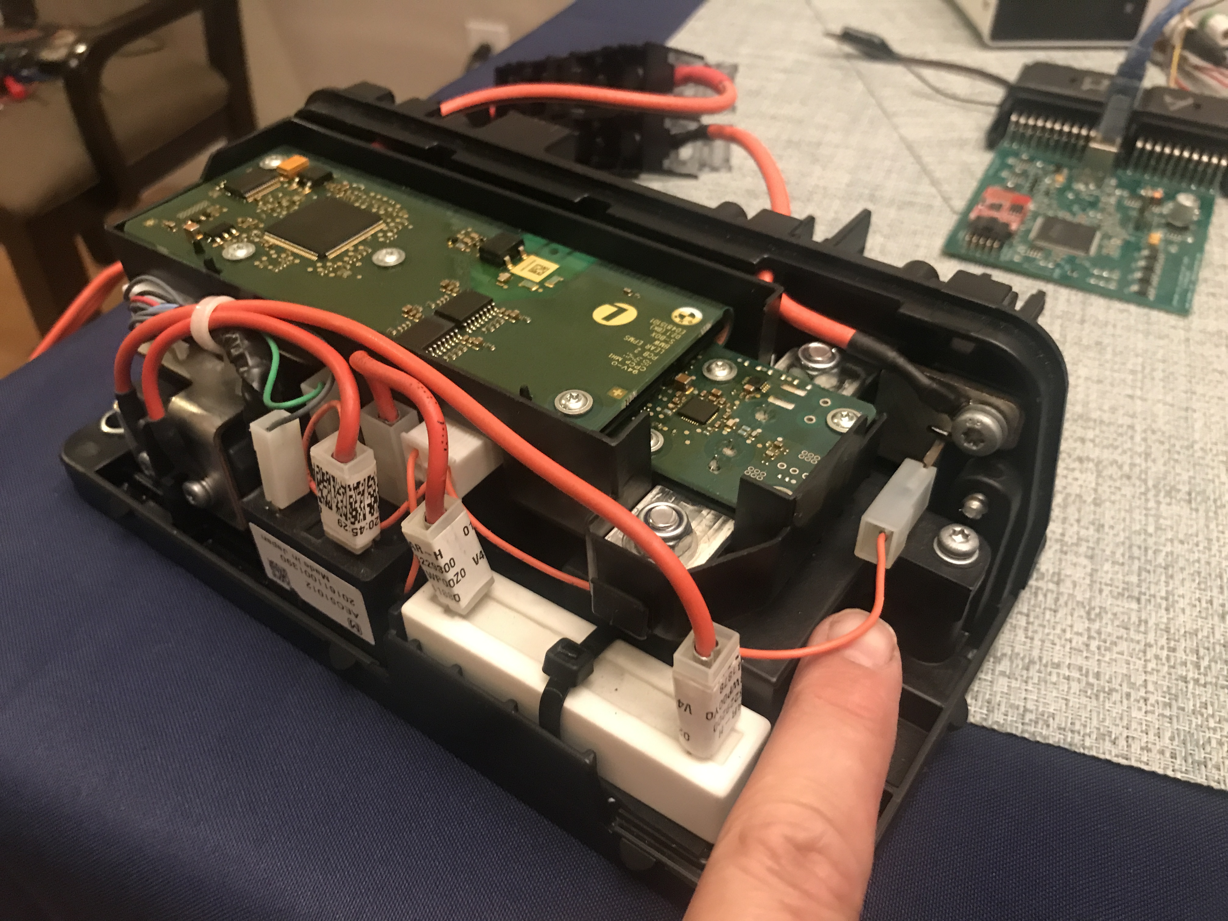

a bunch of Science went down tonight
pointing to a thin orange wire to make myself look smart

I don't know for sure but I think this will fill in some missing pieces. Damien's Arduino Due CAN and eeprom shield, https://github.com/damienmaguire/EVShield

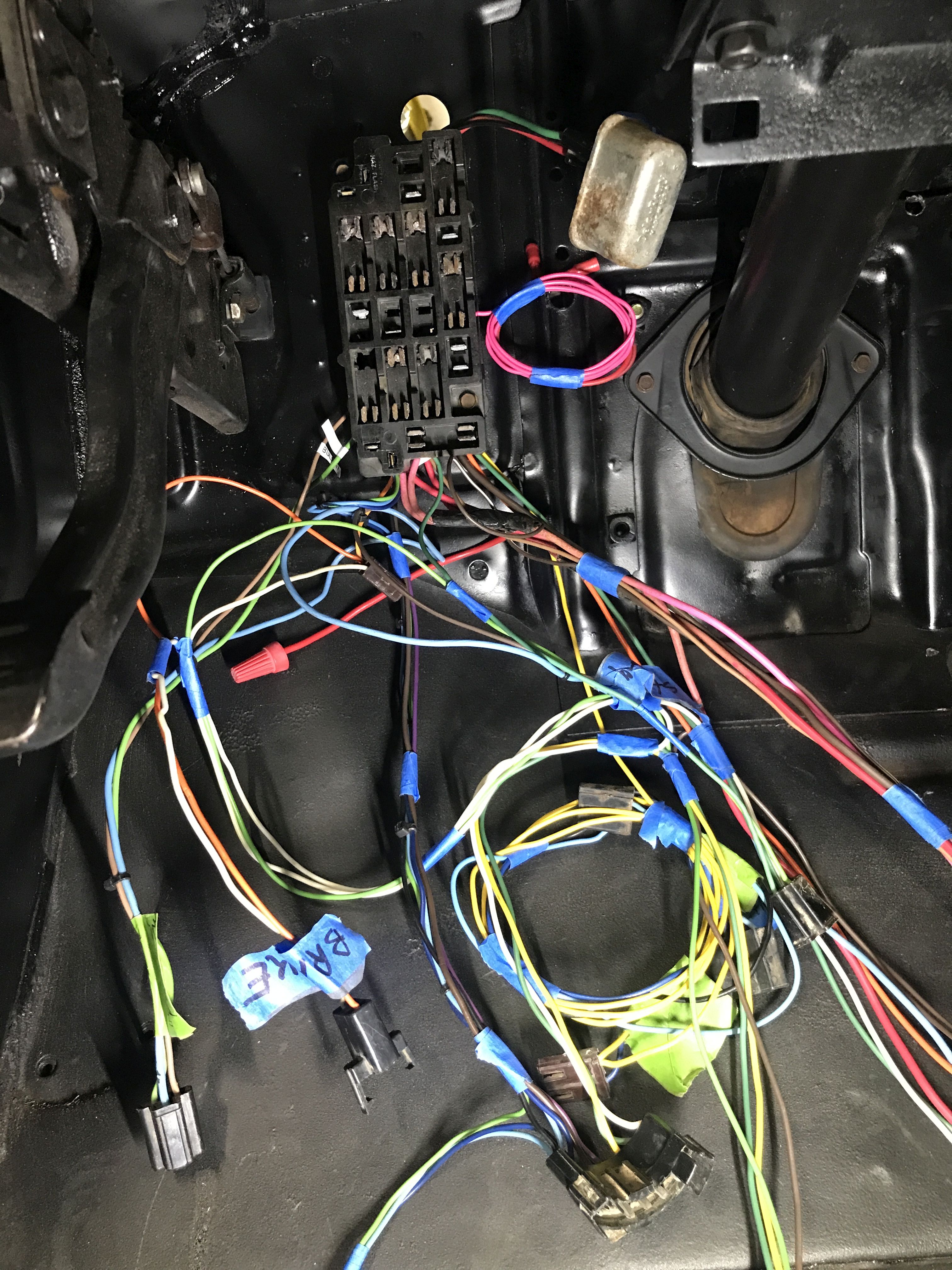

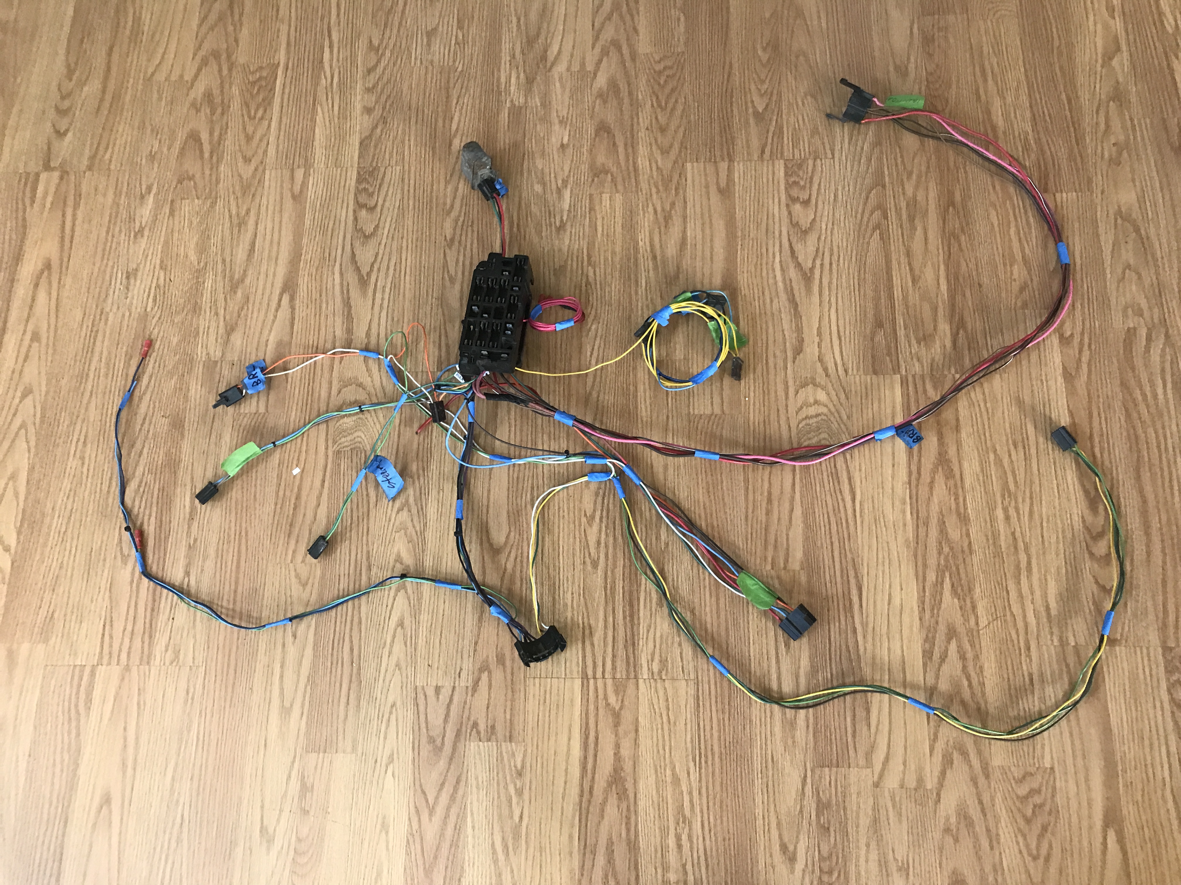

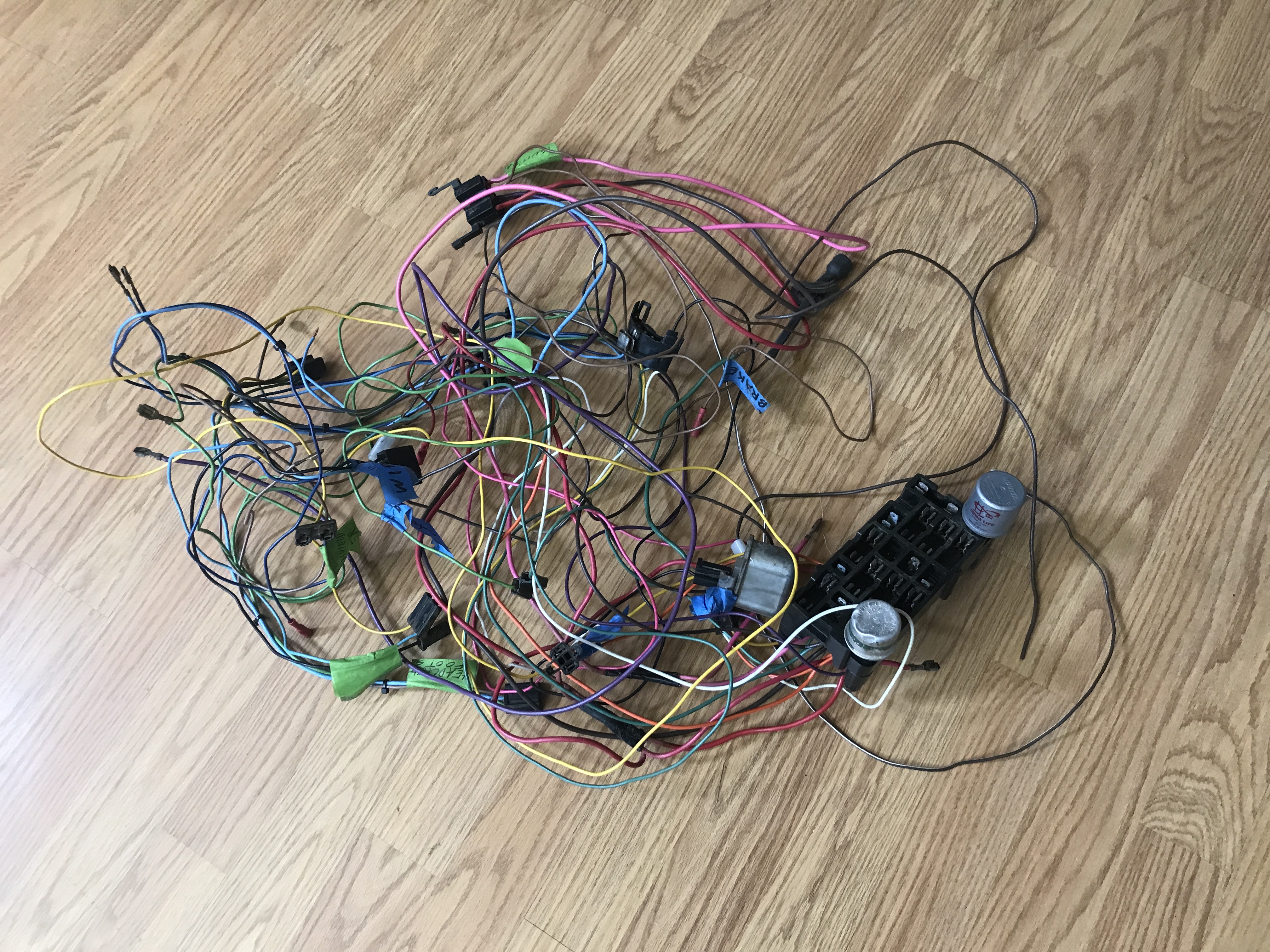

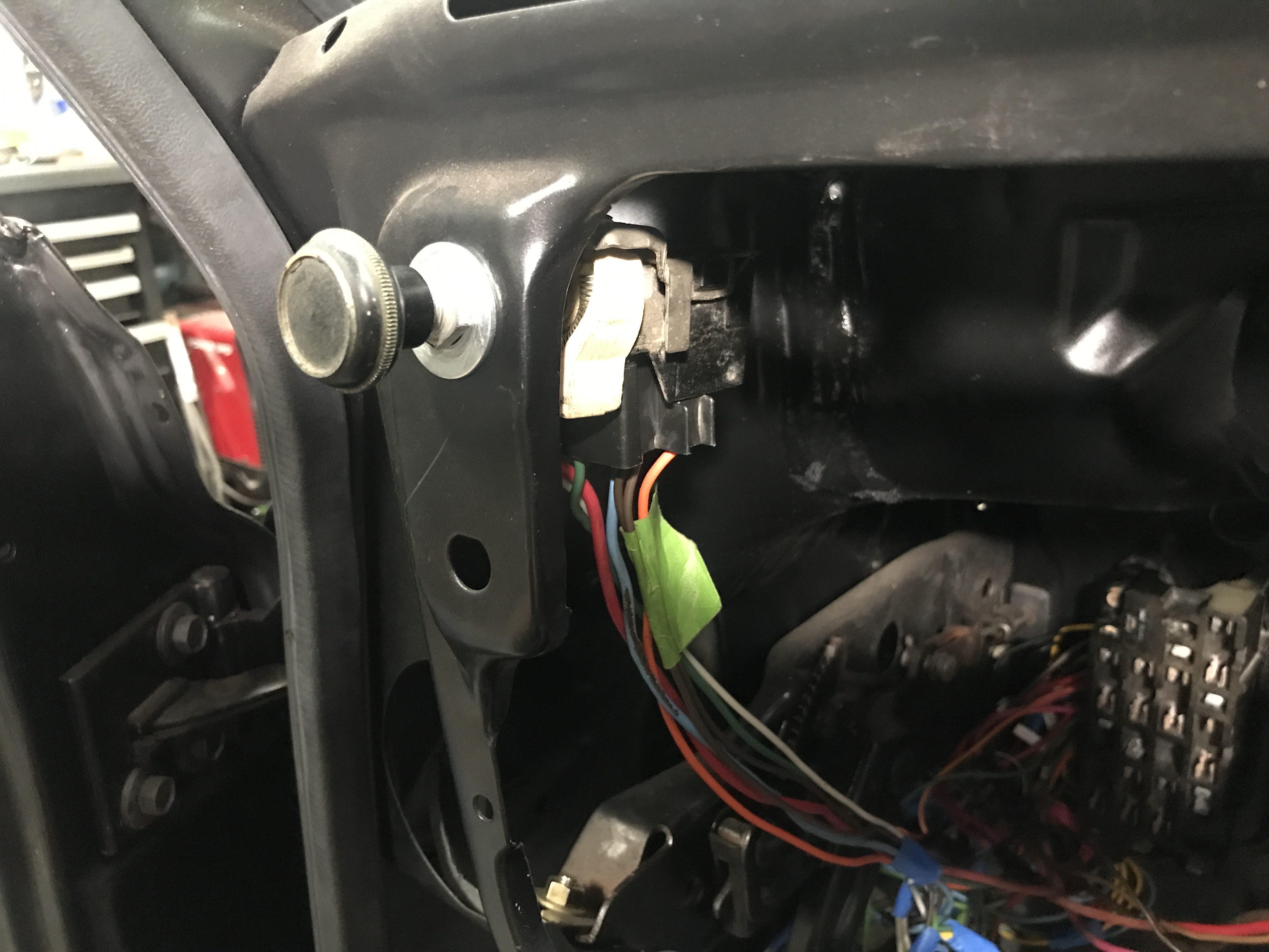

1971 stock Chevy C10 wire harness going back in, slightly thinned out mind you, I ditched the starter wire, the alternator wire, this was a factory AC truck so I deleted the AC (won't put an electric back in cause this is a Hot Rod and I'm dumb) also deleted the heater, I may put an electric one in possibly out of a Volt some day
the goal was simply to have brake lights, but for that these trucks need the headlight switch, and that needed the fuse block, and of course the brake pedal sensor switch, so the dominos started falling

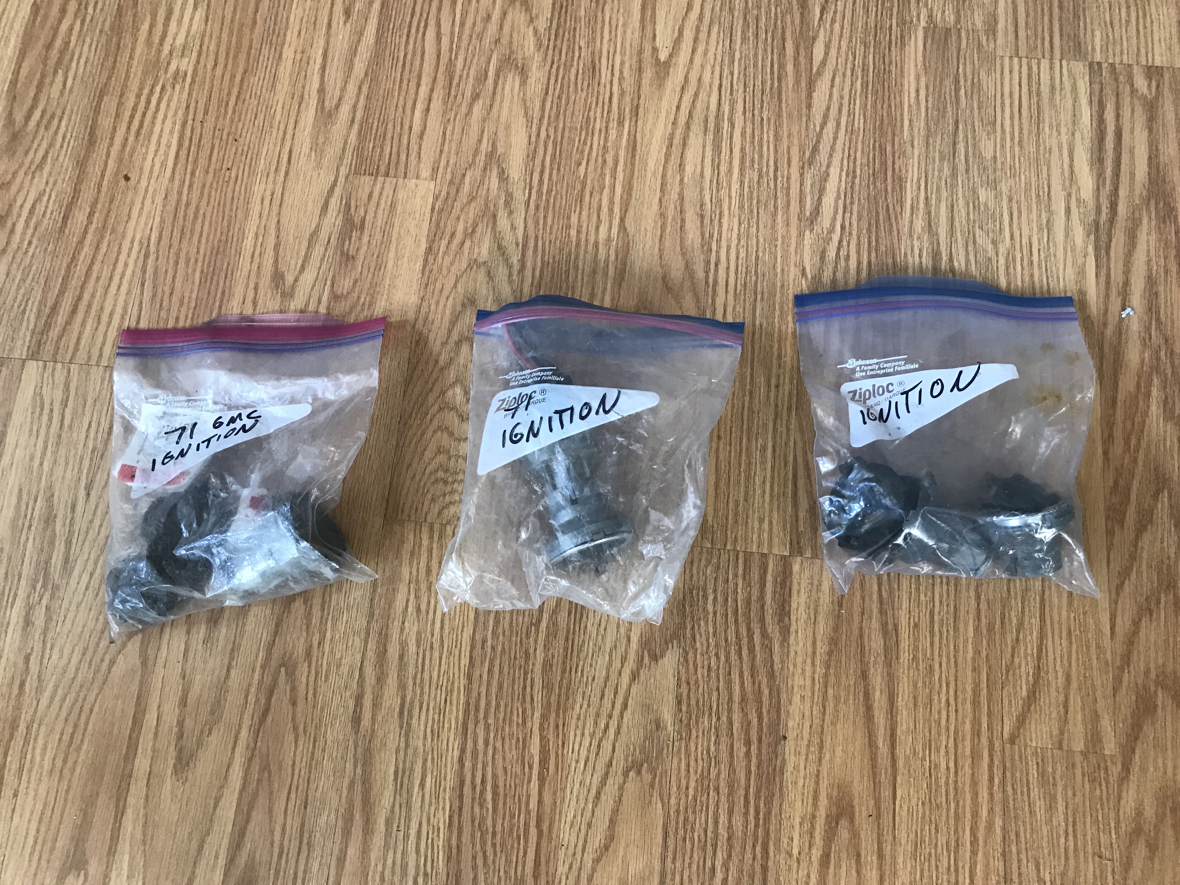

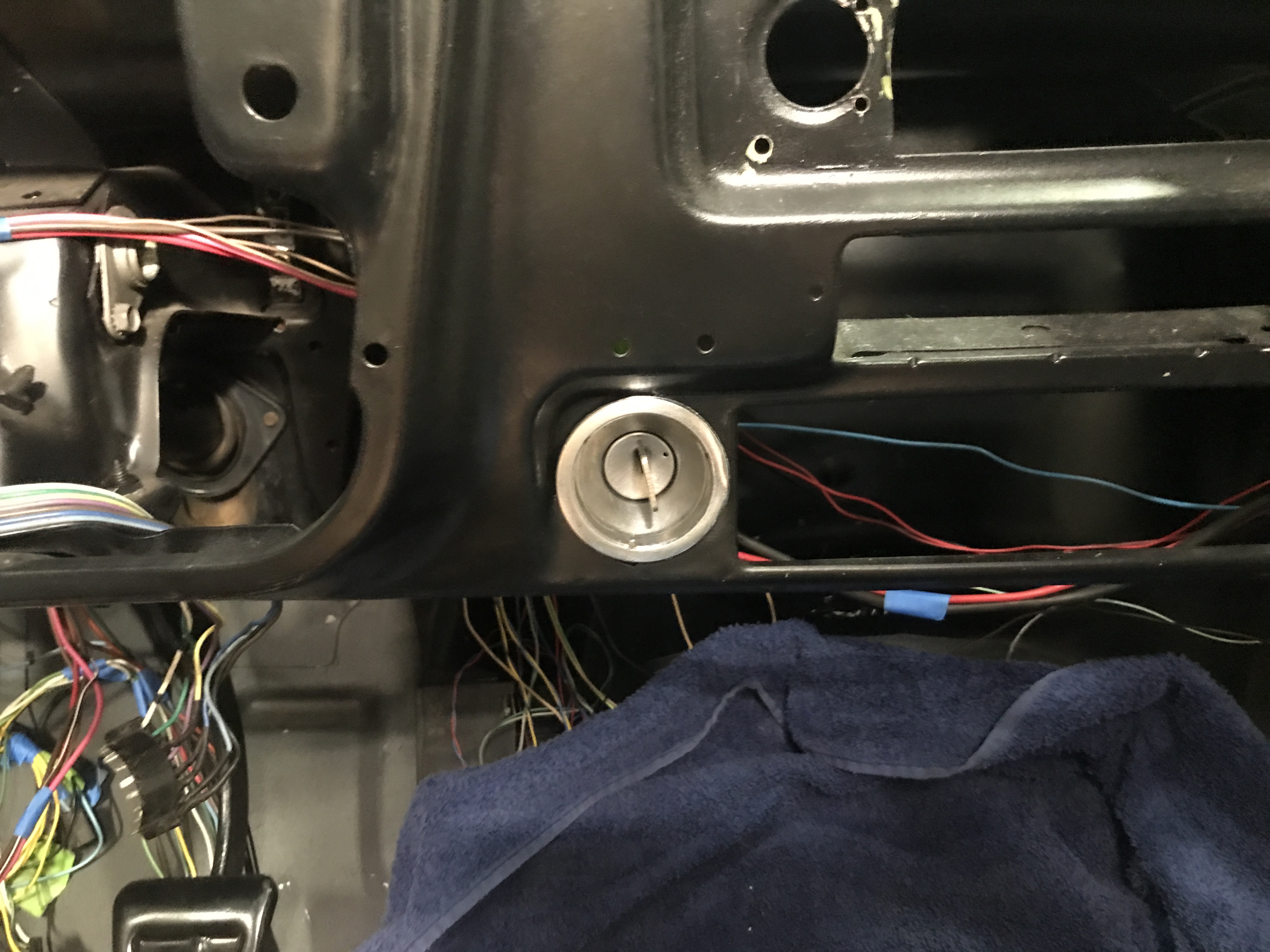

I somehow went from not being able to find one ignition switch to tripping over three !!!
no more manual toggle switch, now we have an ignition switch (think key starts will really take off some day)
and that headlight switch, yes for tail lights and brakes, I don't make this stuff up

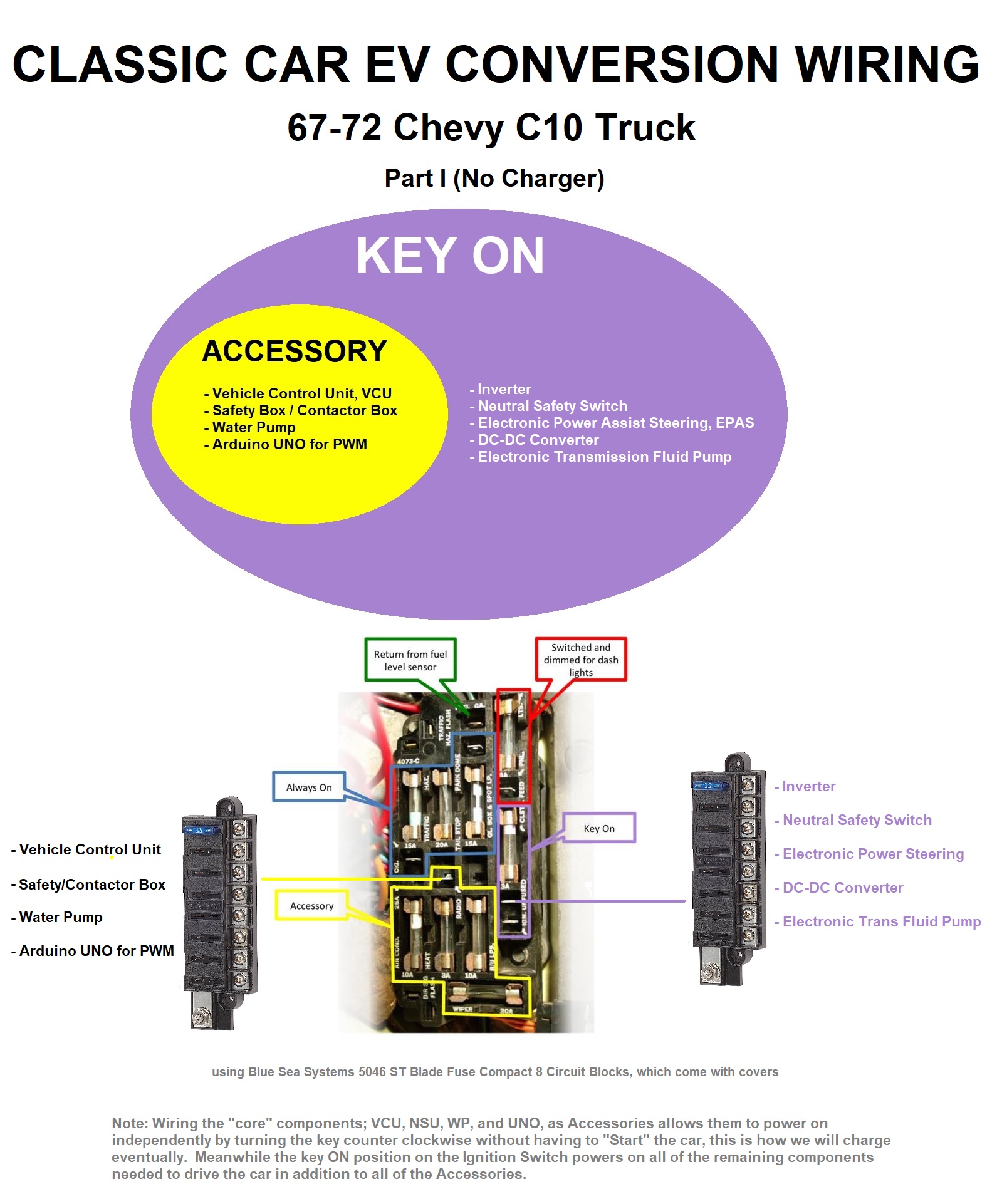

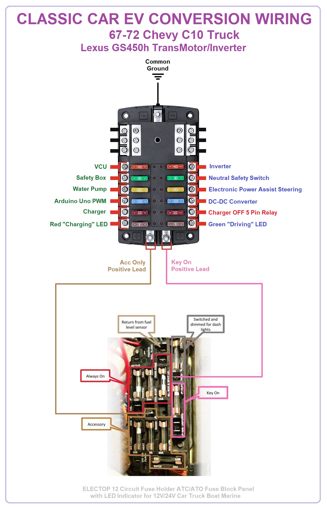

maybe some of you will find this wiring visual helpful when considering wiring up a "classic" car EV conversion
the nice thing about this design is that it does not bastardize the OEM fuse block in any way, it simply uses it's expansion slots as intended
I plan on revising this when I add the water cooled Charger, it adds a tad of complexity and clutter so I intentionally omitted it in Part I
You may well want the DC-DC on the "accessory" side, especially if thats used for charging.

I am sorry i missed that post. I would suggest to use the "french" point switch with your fuel cover flap and some spring element.Gregski wrote: ↑Wed Aug 02, 2023 1:24 am Nobody: hey what's it like trying to do an EV Conversion in California?
Me: it sucks
Once the flap is opened your truck would be unable to drive and when you are done you can simply close it up and drive away. Sort of semiautomatic way of charging. I mean you surely must plug your AC cable some way
