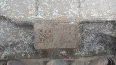

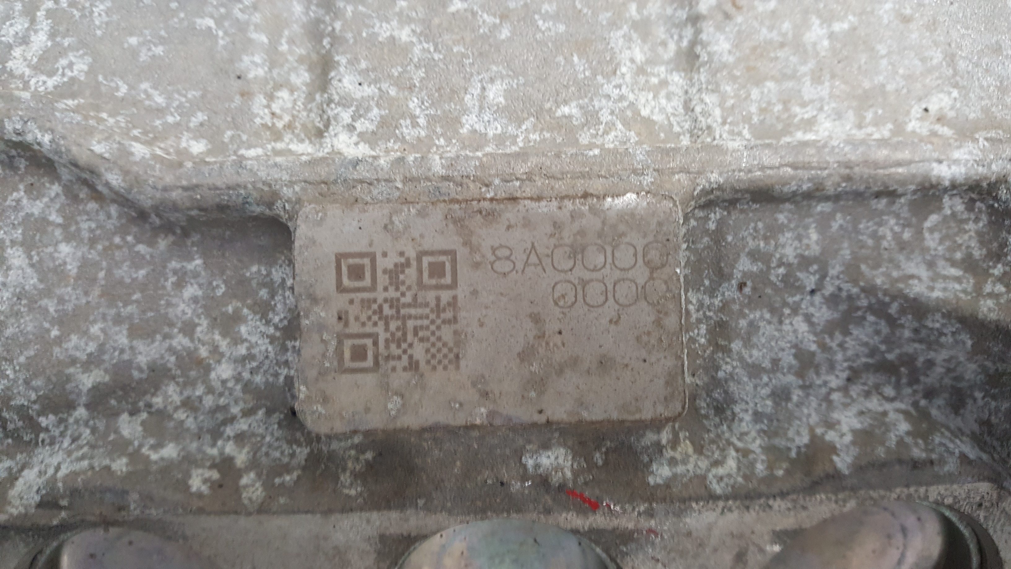

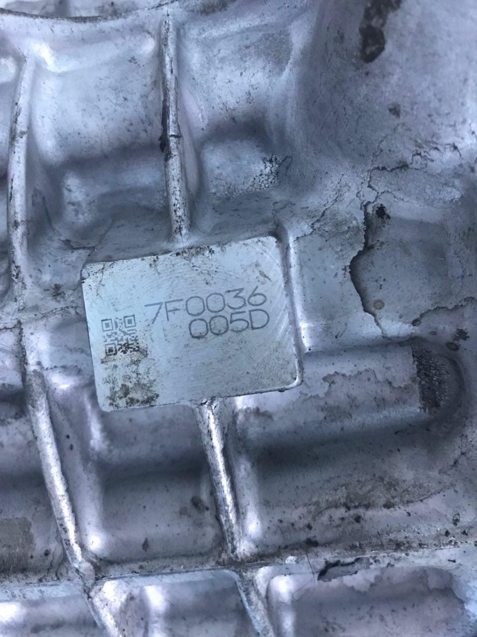

So it turns out the Leaf motors are marked with a resolver calibration value that needed to be entered into the inverter whenever a mechanic swapped either motor or inverter. So on this thread I wanted to collect some of these numbers to find the system. They can be found on the bottom of the motor. Here are some:
Somehow I think it's a group of 3 2 digit hex numbers and 1 digit on Gen 1 motors?:
  • 8A00000000 (Gen 1)
  • 8E00000000 (Gen 1)
  • 9400000000 (Gen 1)
  • 8600490054
  • 8500070057
  • 8400650056
  • 84007D005F
  • 8200DF005D - syncofs = 1000 (where 360°=65536). So 0x4 if 360°= 256
  • 800044004A
  • 7F0036005D
  • 7F0055005D
  • 7500C1004E
  • 7E001B005A
So all the first and the last number are sort of close together. The middle one doesn't follow that scheme. The Gen 1 motor seems to have only the first number set.
If it is really 3 and why, I don't know. Maybe for forward and reverse but what is the 3rd?
EDIT: many numbers now. Since I've pretty much tuned syncofs for my motor others can start doing so. Maybe add the numbers to their original post in bold so I can see it. Or we might just transfer it to a wiki page.
I can say for sure that syncofs 1000 +- 500 seemed the point for my motor were it would not spin on ID current. 1000 means 1000*360/65536=5.5°. If we assume 360° is 256 in Nissans world then syncofs_256=1000*256/65536 = 0x4. If we further assume that they phase shift their calibration by 180° for some reason then 0x2 would be perfect for my motor since 0x2 + 0x80 = 0x82.
In this case to convert the first digit to an openinverter-syncofs you would calculate syncofs = ((digit + 0x80) mod 256)*256
Lets get this confirmed.
Maybe I should add this here: To find syncofs you set throtid=1, throtiq=0.05. Now find a syncofs where the motor won't move at all, even at full throttle. Careful, the motor can spin up uncontrolled! I think disabling regen actually helps. Jacking up the wheels instead of neutral gear to be able to use the cars brake certainly helps.

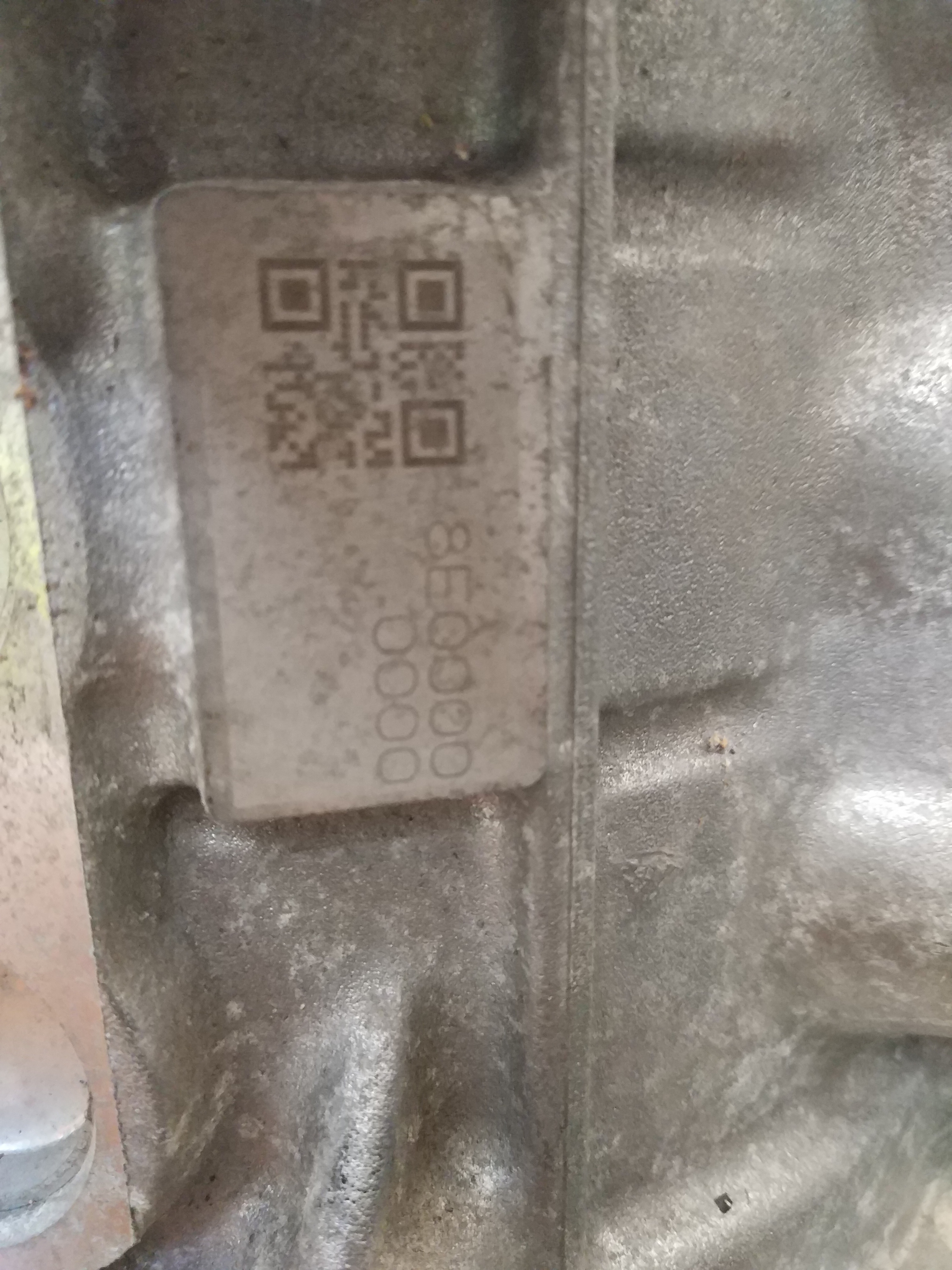

do you have a photo of them, i will check mine this evening.

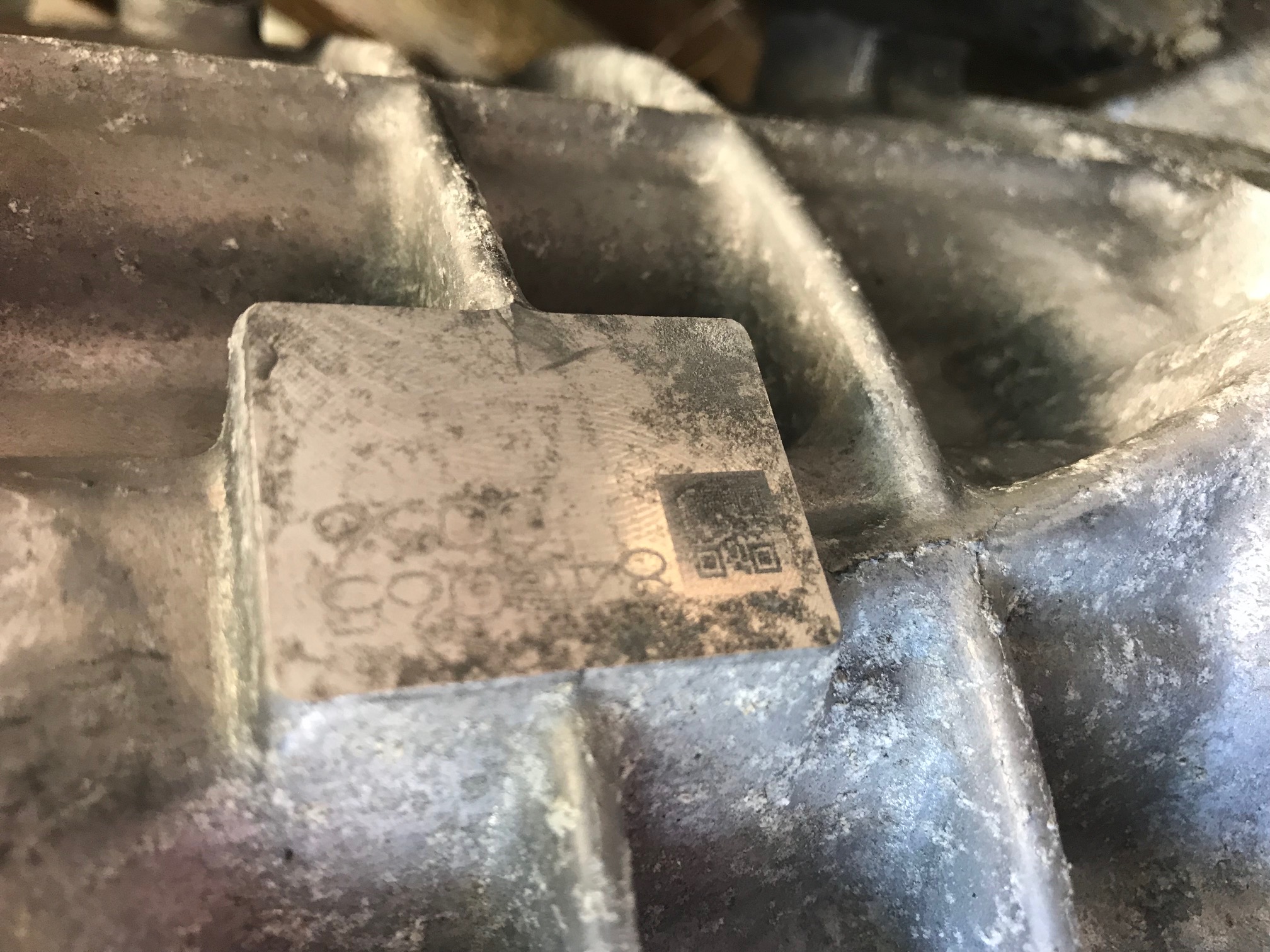

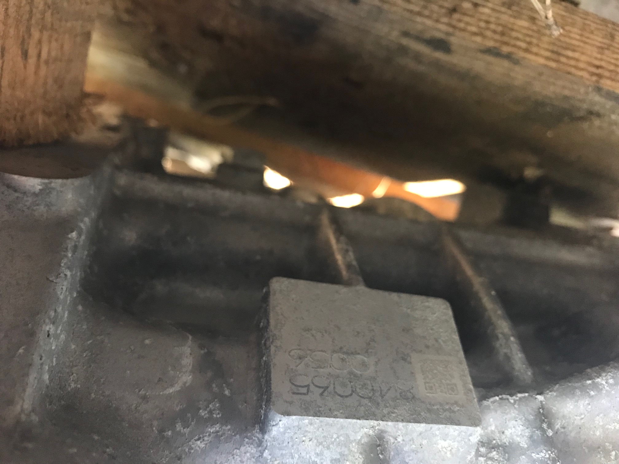

Is it that?
Been thanked: 1918 times
Re: Nissan Leaf Resolver offsets
Yes, so 8100650056 it seems?
Post by D@F »
81 or 84 i have to confirm tomorow morning

Post by D@F »
I Check it and is 84.

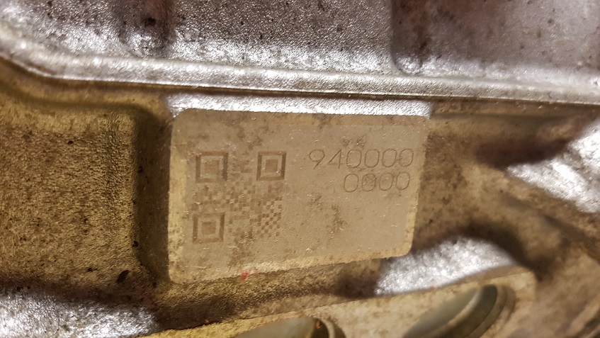

Here is mine. Gen 1 leaf.

Mine: 7F 00 36 00 5D

So once I have the FOC software done you could find the syncofs value and we can match it against what is printed on the motor. I basically set iq=0 and looked for the offset where the motor wouldn't move

My recent purchase is from a Gen1 EM61 - offset code
9400000000

My gen2 leaf motor says 86000D 0057
I don't really understand the formula to calculate the offset.
To do the experimental method, how do you set throtid=1, throtiq=0.05 from the web interface ?
Paul
Hm maybe the formula can be simplified. If v is the first value, so v=0x86 in your case
then syncofs = (v - 0x80) * 256
So (0x86 - 0x80) = 6
syncofs = 6 * 256 = 1536
But as this is speculative, experimental is better. With the new software its also easier.
Find the parameter throdiq in web interface and type 0. Find throtid and set to -1 . Put car in first gear and change syncofs until you feel no more force.
PoloLbricolo
Posts: 106
Joined: Wed Apr 10, 2019 2:32 pm
Location: France
Been thanked: 12 times
Post by PoloLbricolo »
Thanks a lot !
I've done the experiment and between 600 and 1000 same behaviour, the car didn't move at all. i've put 768 (1536/2) and it works well.
