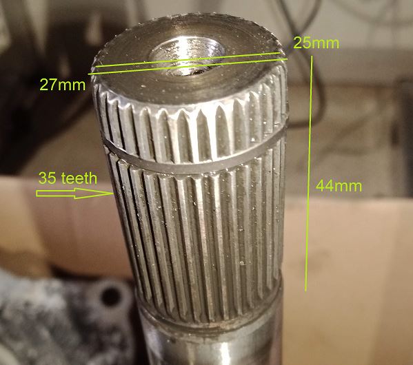

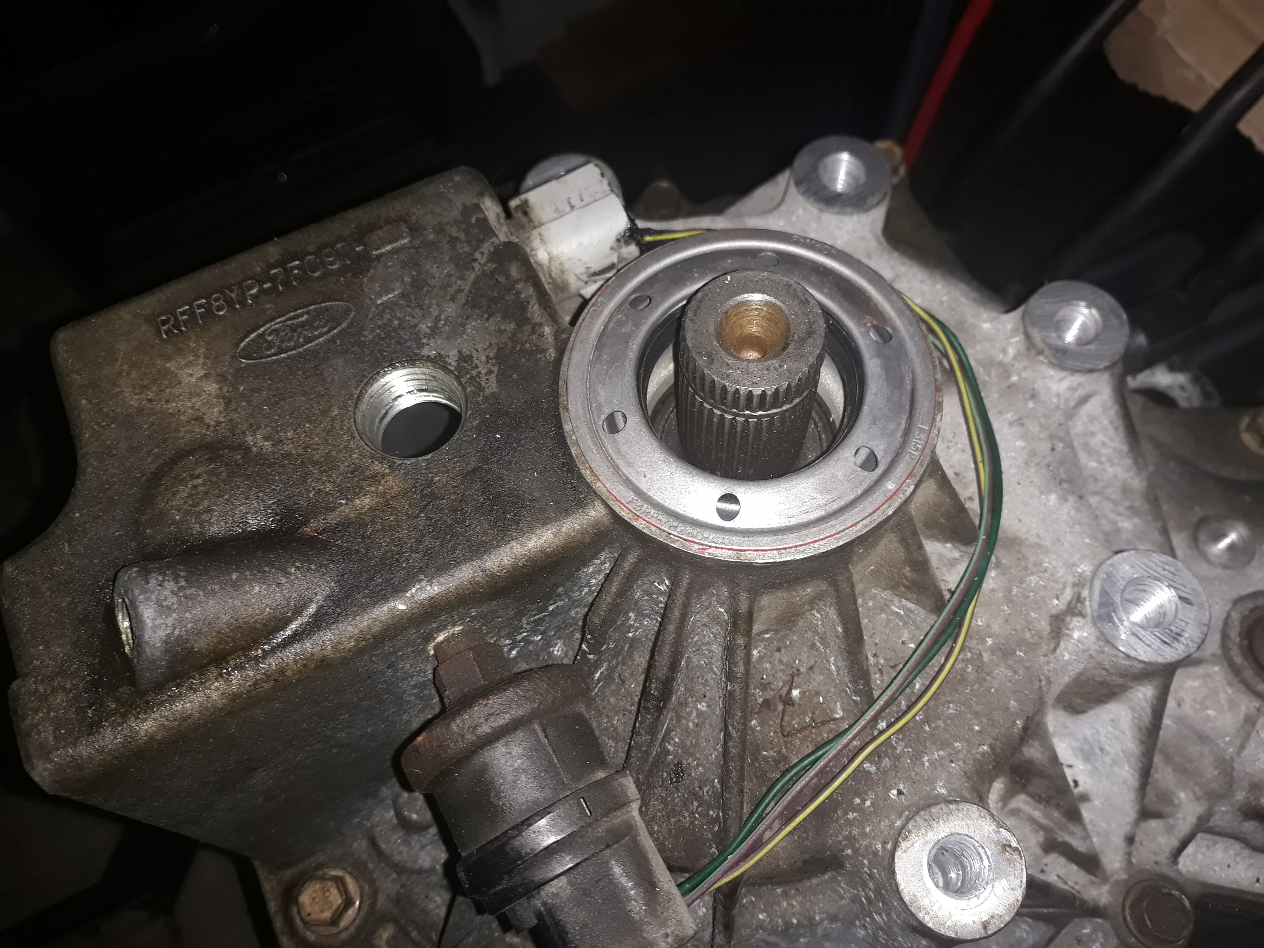

there’s a guy locally selling 4 Siemens motors, transmissions and inverters.
Any one have any info on the axle shafts that mate to this transmission? is it a stock ranger cv axle?

Sorry missed this one, I have a picture from when I changed the shaft seal.
Will try to find the measurement, and come back to you.

Hey, cheers thanks! So they are male splines off the gearbox, not female. Or is one side male, the other female?
haven’t yet, but looks like I got a deal for 2 motors for 1200$ cad.
if I can figure out which cv axels work will make things quite easy

Both output shafts on the gear/motor is male.

talked with a bunch of ranger ev folks, and found some repair manuals, the ranger ev in fact dose use stock ranger front cv axles.
