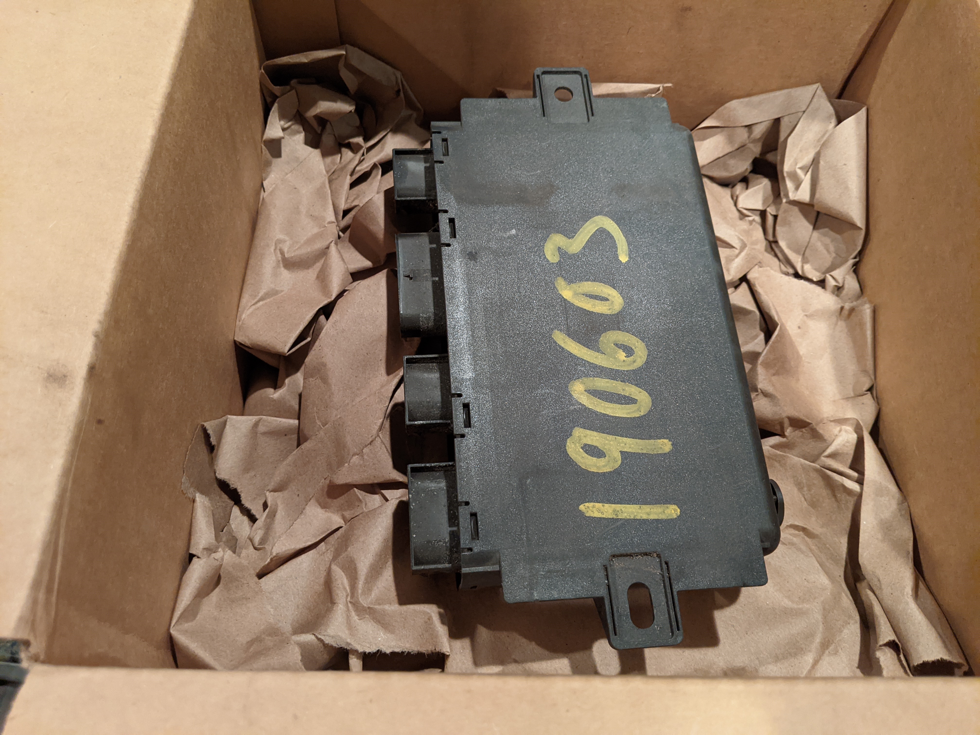

Posted: Tue Nov 24, 2020 1:51 am
by mdrobnak
I got a package!
Ooh a 'chassis brain box' :D
To me it seems held together by those small tabs on the base. Haven't tried to open it yet. Will come back to this later.
-Matt

Posted: Tue Nov 24, 2020 7:05 pm
by mdrobnak
Some shots:
A search for the CPU part number yields "NEC uPD70F3550 GCA V850E2/FG4 V850 Microcontroller"
https://en.wikipedia.org/wiki/V850
S/W float.
Dual instruction executing.
7-stage pipeline.
2.56 Dhrystone MIPS/MHz
1.5 mW/MIPS
Multi CPU core support.
Memory Protection.
https://www.renesas.com/sg/en/doc/Docum ... 00_FG4.pdf
Rear door actuator driver is the L9951XP chip.
Edit: Duh, this is all in the block diagram on the top. :: headdesk ::
And that's all I wrote for the moment. :D
-Matt
