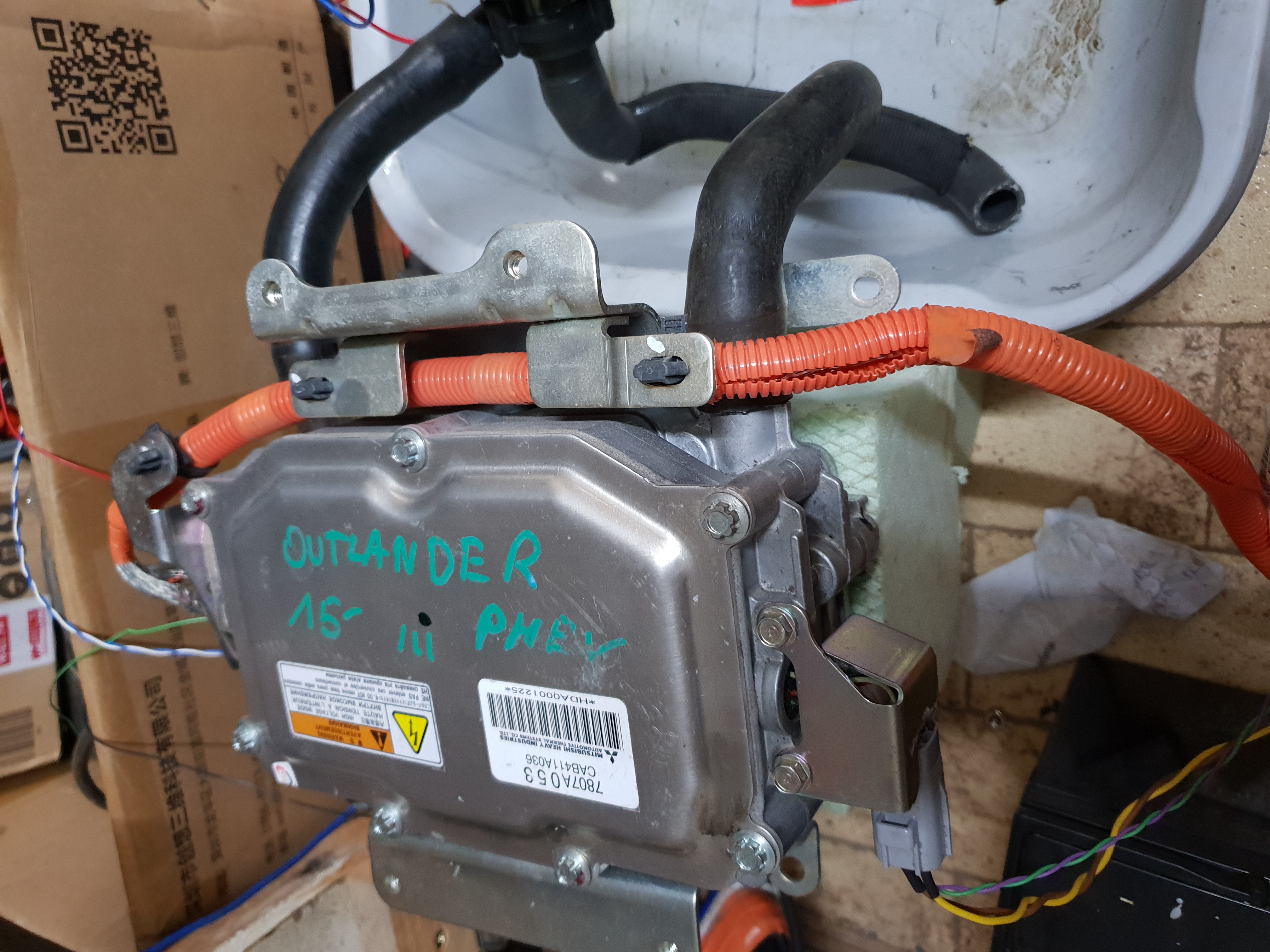

It seems heater P/N 7807A053 is CANbus controlled unit and it is connected directly to rear inverter via 20A fuse.
I am waiting for one heater to arrive. So i will first listen to its message.
I got some wiring from Outlander PHEV.
Anyone has Outlander PHEV available? Is possible to spy on CANBUS and turn on heater to see which msg it requires to start?

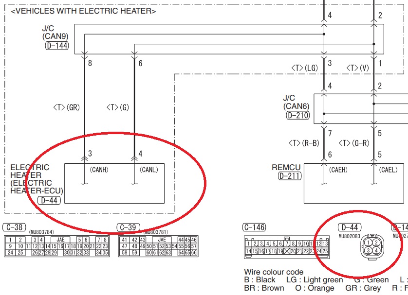

Re: Mitsubishi Outlander PHEV heater

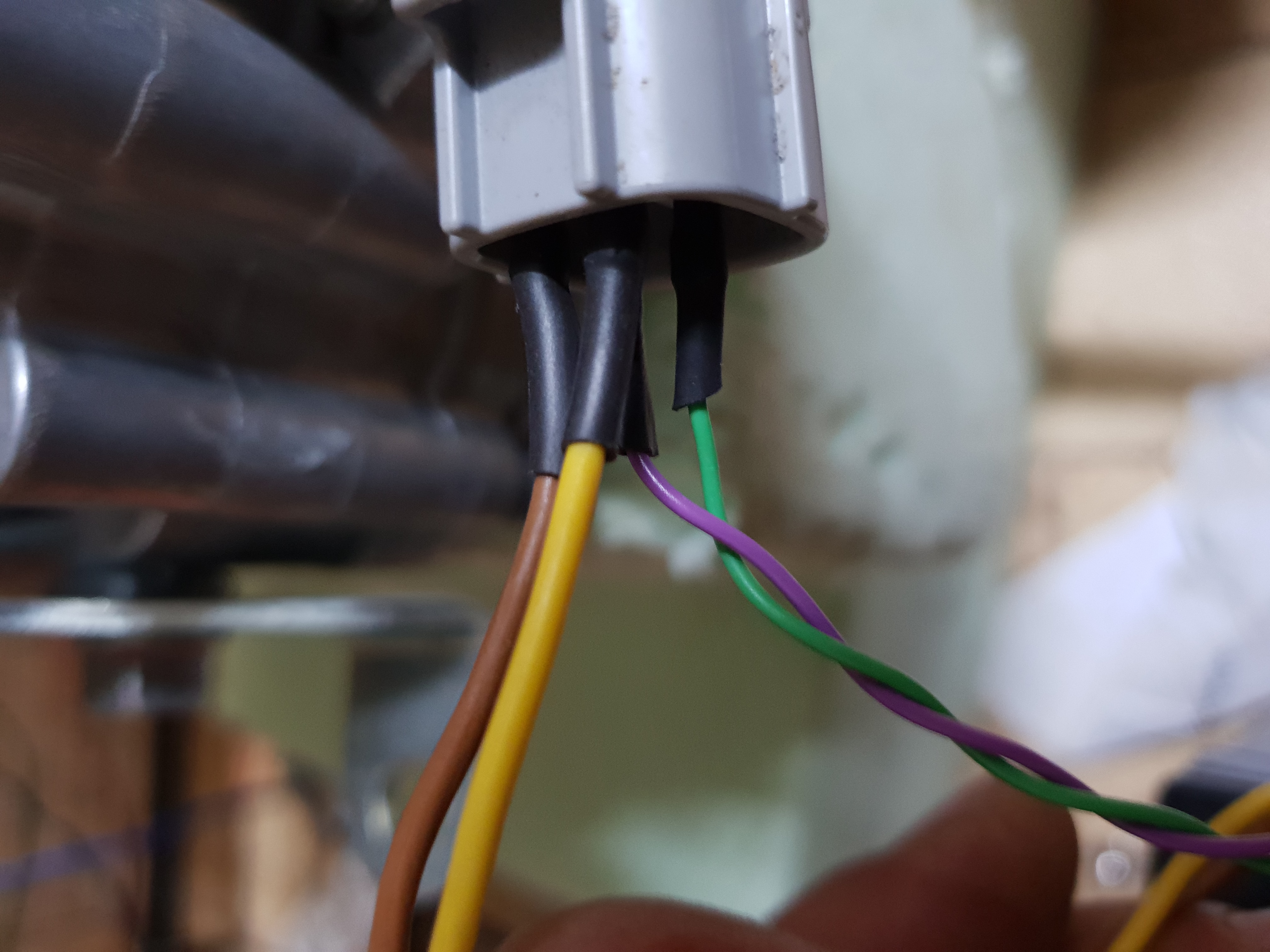

No! The one i got is CAN bus controlled with 4 pin connector. Top two pins are 12V(1) and GND(2) and other two CANh(3) and CANl(4).johu wrote: ↑Mon Aug 30, 2021 12:43 pm I think the heater is sorted: https://openinverter.org/wiki/Webasto_HVH50
I provided schematic pic with connector marked in red.
When 12V is connected i got 4 CAN telegram reports on 500kbaud.
0x398 ID 00 09 00 3B 3B 00 00 00 at 100ms
0x630 ID 00 00 00 00 00 00 00 00 at 500ms
0x062D ID 00 00 00 00 00 00 00 00 at 500ms
0x06BD ID 00 00 00 00 00 00 00 00 at 500ms
This is without HV connected!
I haven't seen pictures above becouse of connection restrictions at work. Now i know my pinout was wrong.
Sorry for mistake.

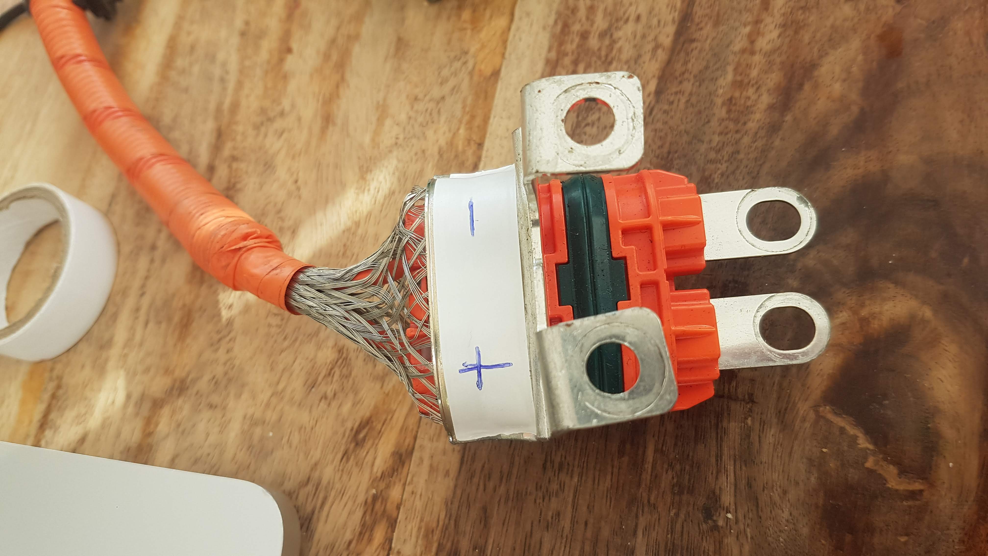

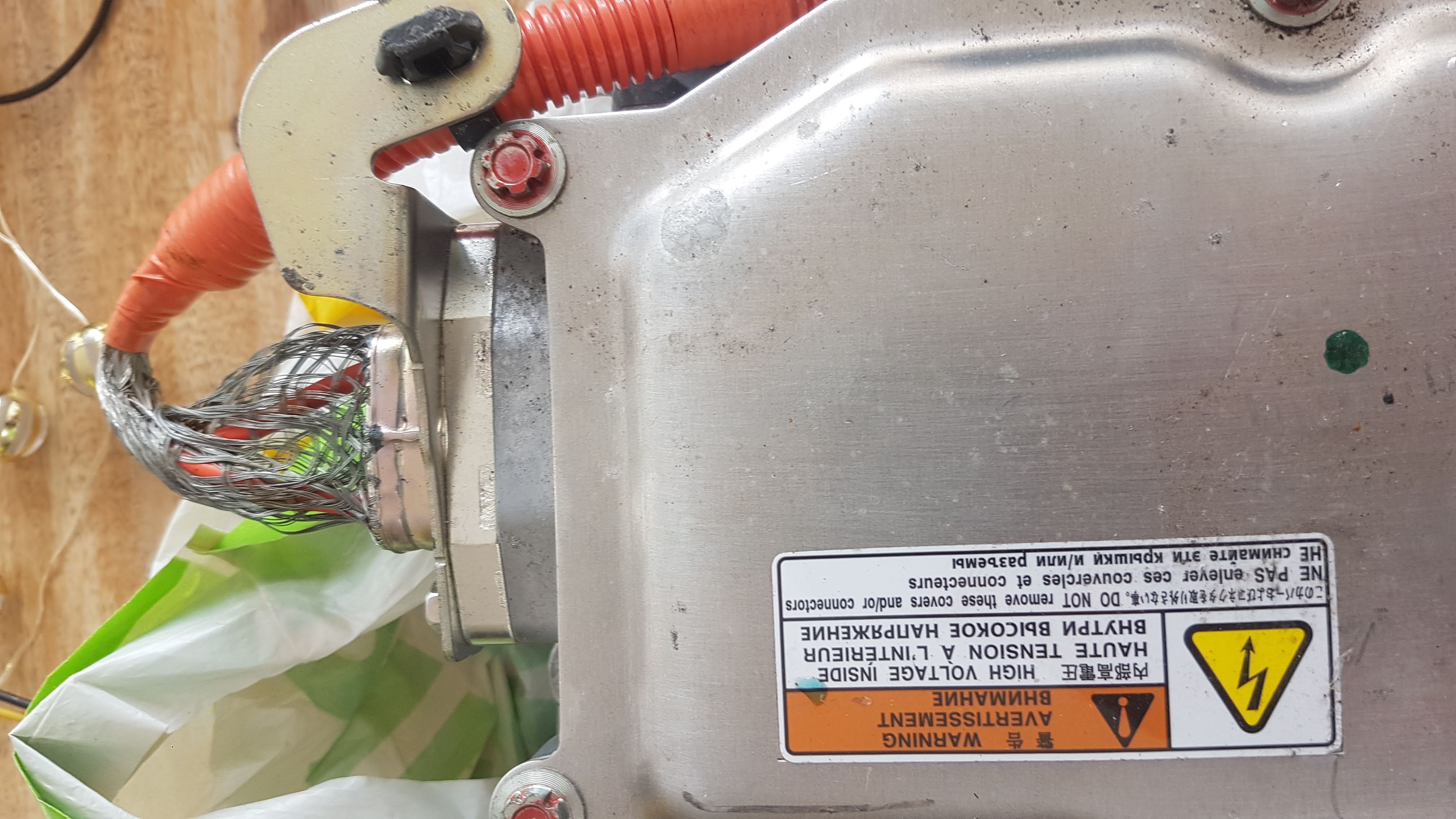

I have connected HV to the heater. I did not yet fill it with coolant.
HV cable orientation is Positive contact inside inverter on the side of 30A fuse.
When i connected HV sole change was in the 0x398 telegram. Now i got:
0x398 ID 00 00 00 3B 3B 00 00 00 at 100ms
I need to provide coolant and pump!

Did you get anywhere with this @arber? I now have an Outlander heater and now that the car is road legal, making it warm has become a priority!arber333 wrote: ↑Tue Aug 31, 2021 6:50 amGot the files now thanks. I am seeing a possible 1st byte in 0x185 gets set from 00 to 08.projectgus wrote: ↑Mon Aug 30, 2021 10:39 am Weird, that's annoying. I guess LFS isn't the simple solution that I thought it was. I've recreated without LFS enabled and split the large log, unfortunately you'll have to clone it again but it should definitely work now.

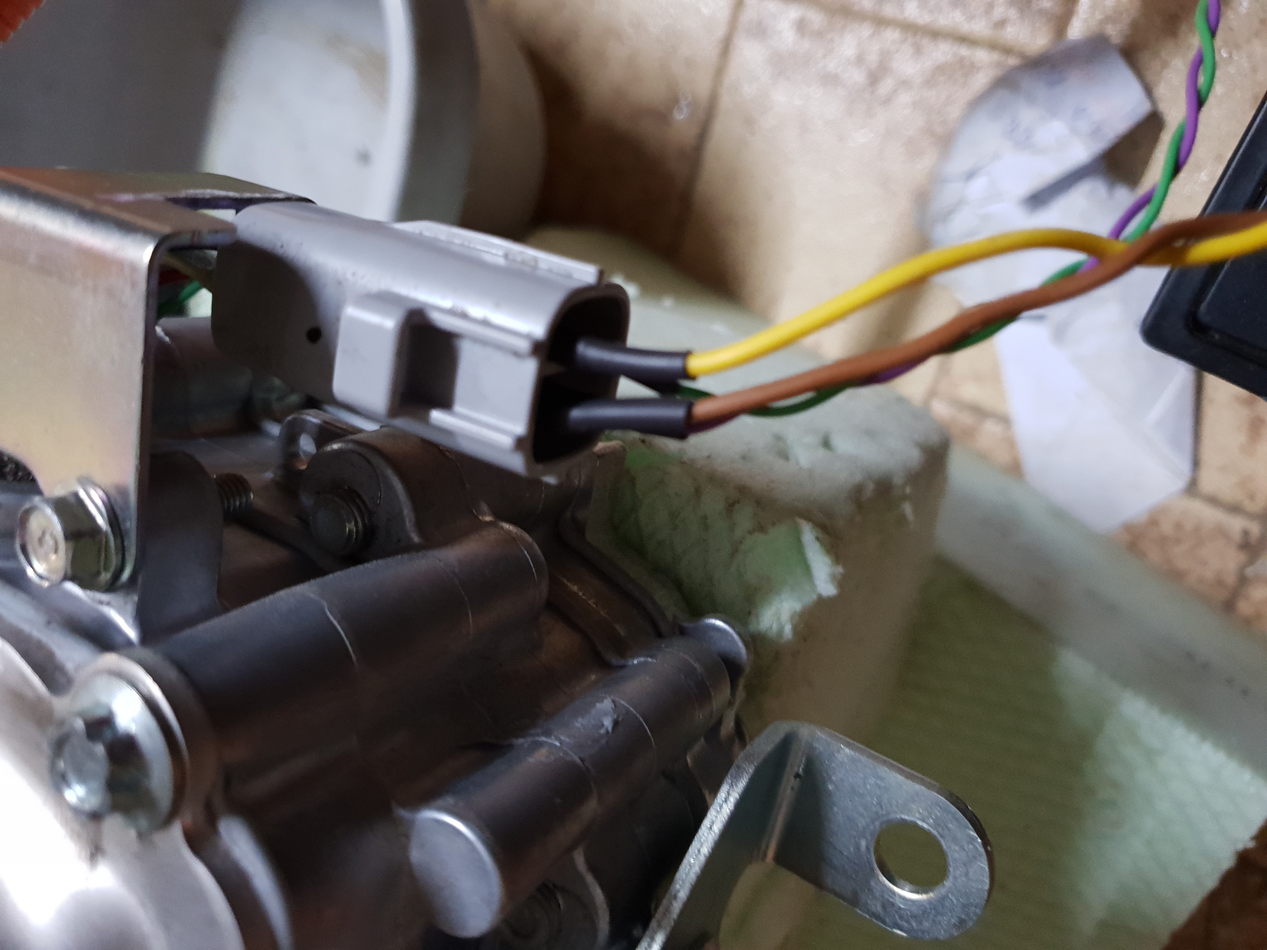

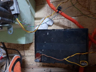

@arber, do I have the polarity right? Based on the photo here https://www.myoutlanderphev.com/forum/v ... hp?p=33926
My 0x398 differs from yours, but I have no water in there, it's completely dry.
https://openinverter.org/wiki/Mitsubish ... ter_Heater I've started a wiki page for confirmed information.
02 00 00 3E 3E 00 09 00

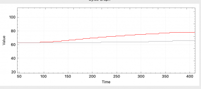

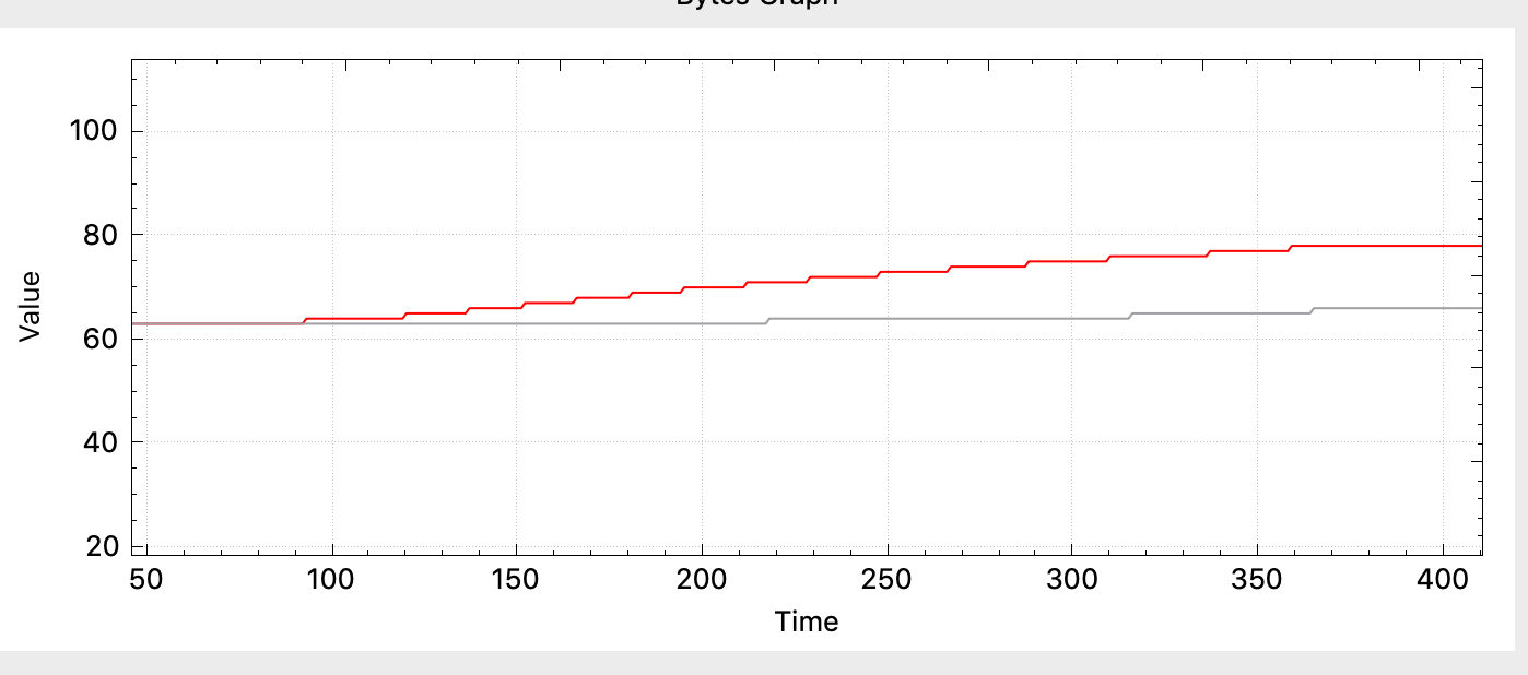

0x398 has the water temperature in byte 3. I filled mine with water from the kettle. Byte 4 also seems to be a temperature, might be device temp?

Sorry didnt catch that msg.Bigpie wrote: ↑Mon Oct 11, 2021 9:54 am @arber, do I have the polarity right? Based on the photo here https://www.myoutlanderphev.com/forum/v ... hp?p=33926
Yes the + marked connector is the positive and if you observe how it connects you will notice it is connected through the fuse. On the original schematic you should see fuses are on the + side.

I think you are right about 0x285 being a general status message, at a glance, it looks like byte 5 is HV voltage.RAS_666 wrote: ↑Sat Oct 16, 2021 12:48 pm i managed to get my ac pump running from this though the 285 message is needed for the aircon pump it changes the last bit of message 0x388 from the pump. I think 285 is like a master control message maybe signalling that the drive battery is connected. it is needed to use the charger units, the inverters and the ac pump i have.
