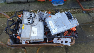

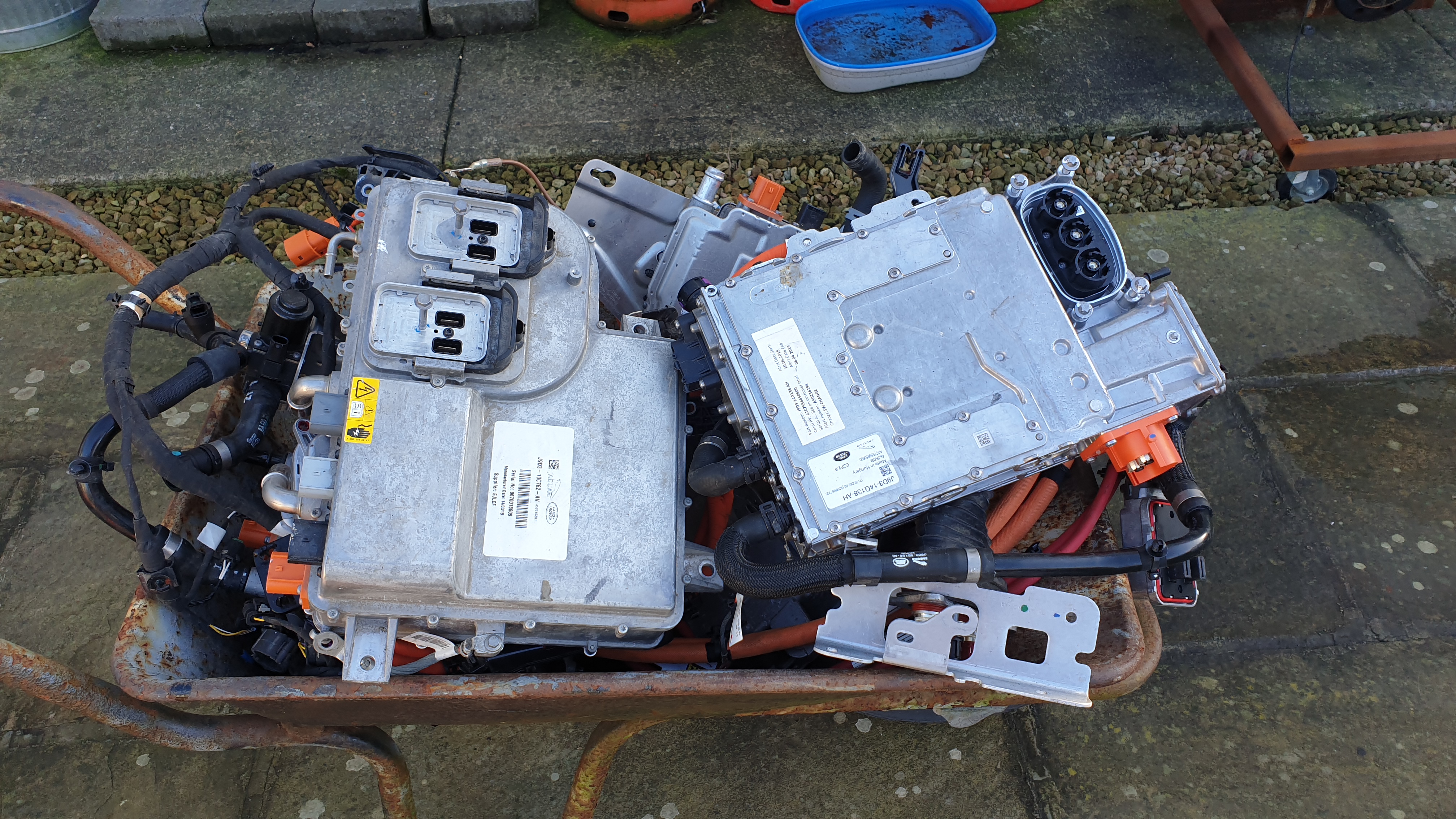

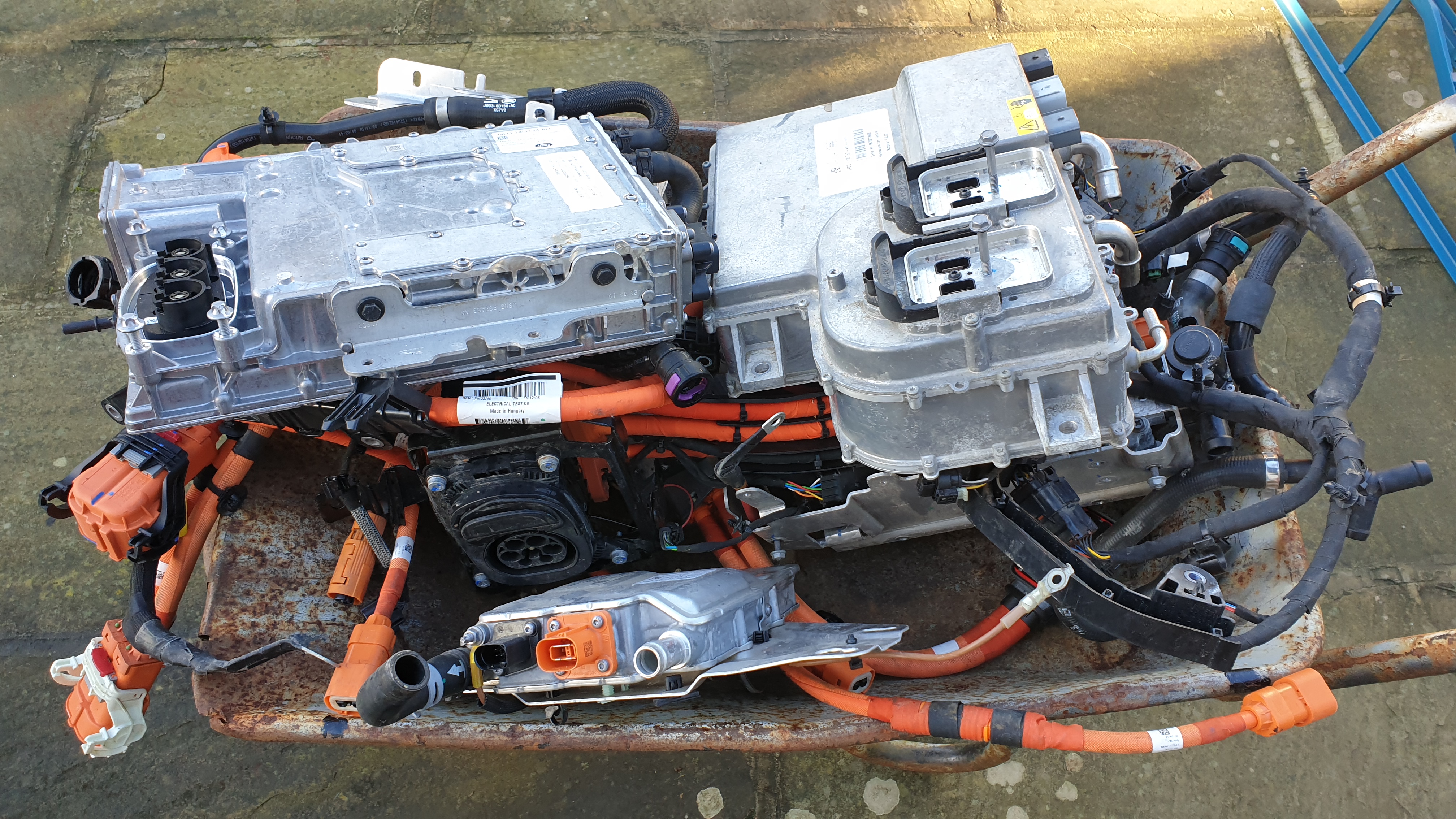

So I figured I'd better start a subforum and put in a placeholder for Ipace parts hacking. From a 2020 vehicle. Have a front motor and inverter and quite a bit more that I don't know:)

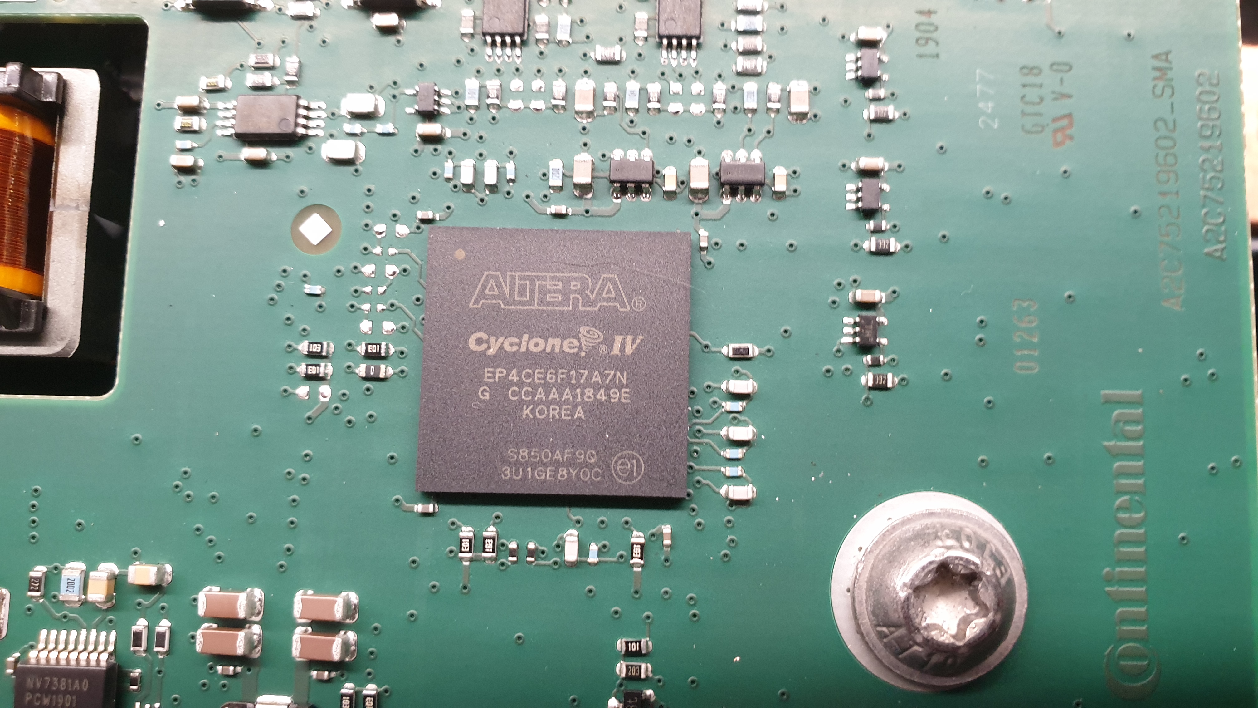

Interesting article on comma.ai. Most useful is they opensourced a flexray decode for the Saleae and published the fpga design. That said, I feel a replacement logic board coming on. This automotive stuff is funny. Nothing in a car that can't be handled by CAN or even good old RS485 and yet we see crap like this....

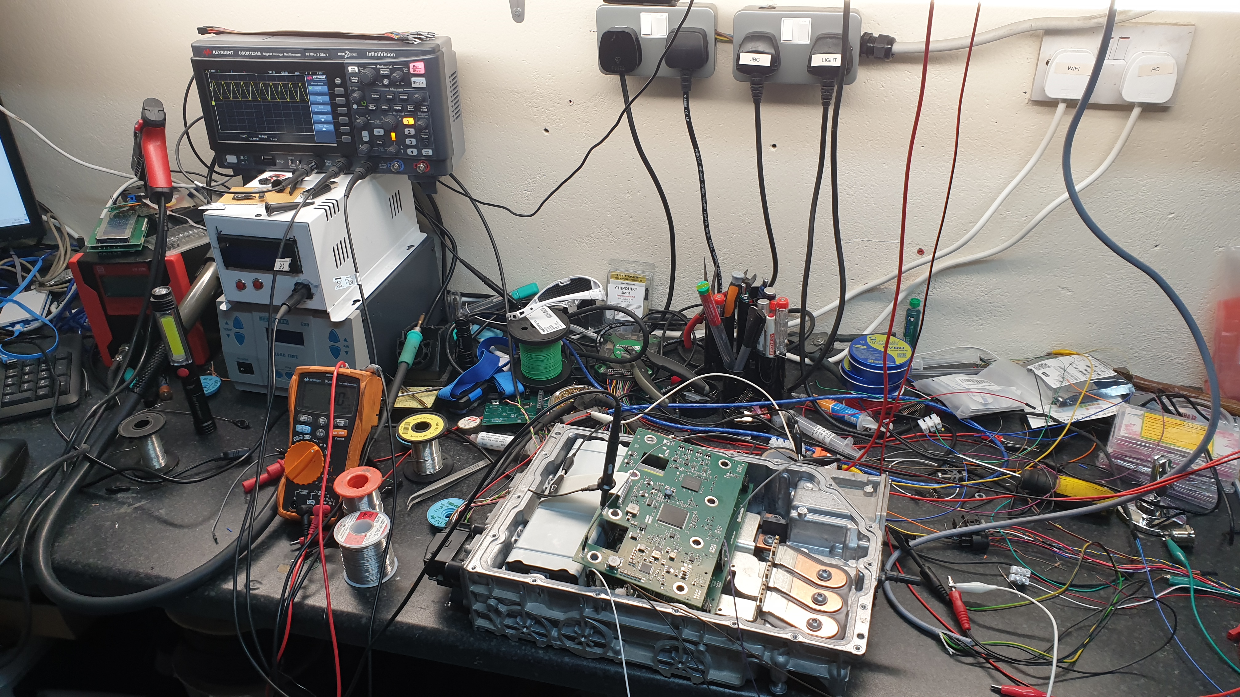

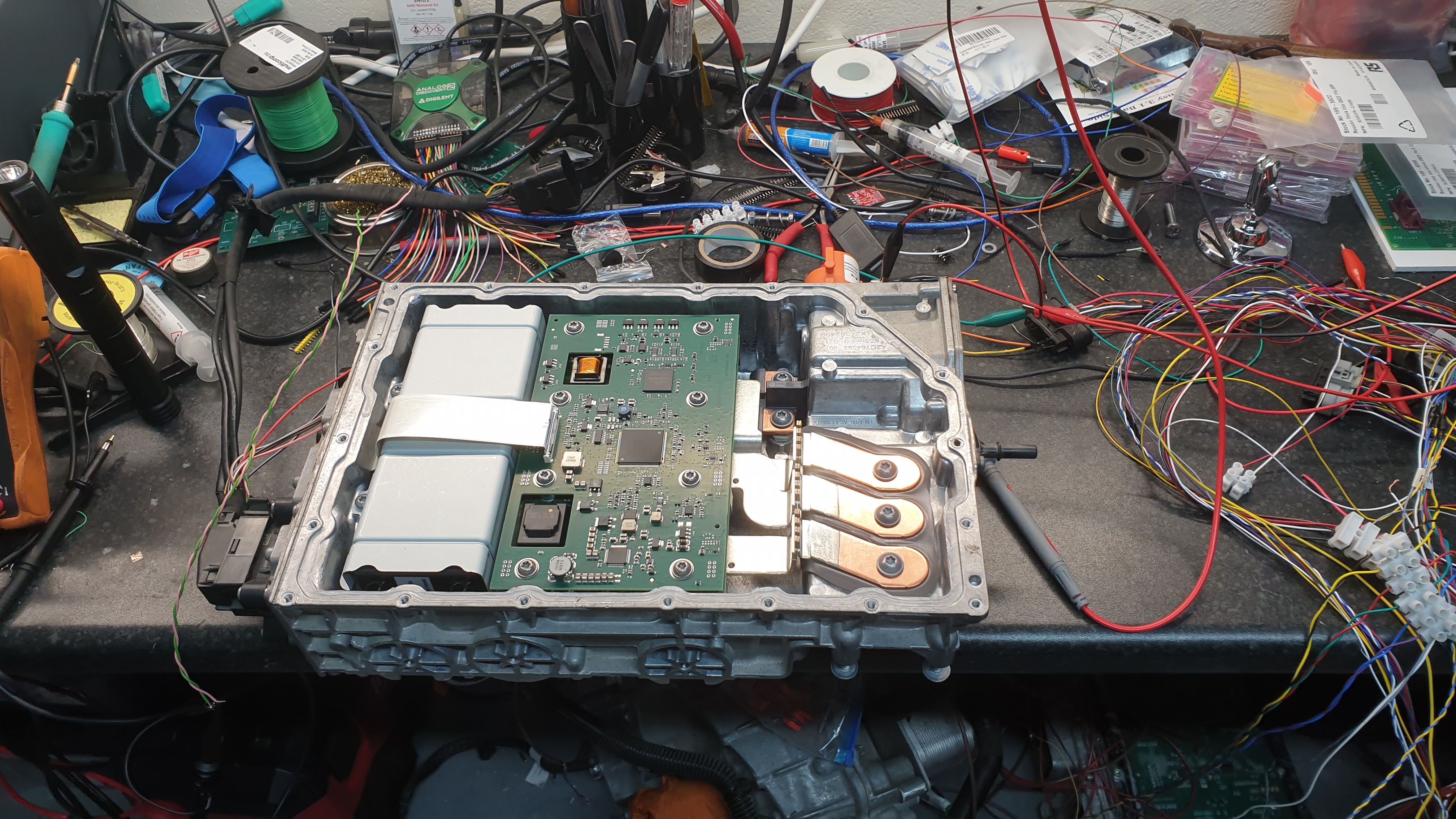

We're in....
anyone want to help find that mystery psu control ic .... ?

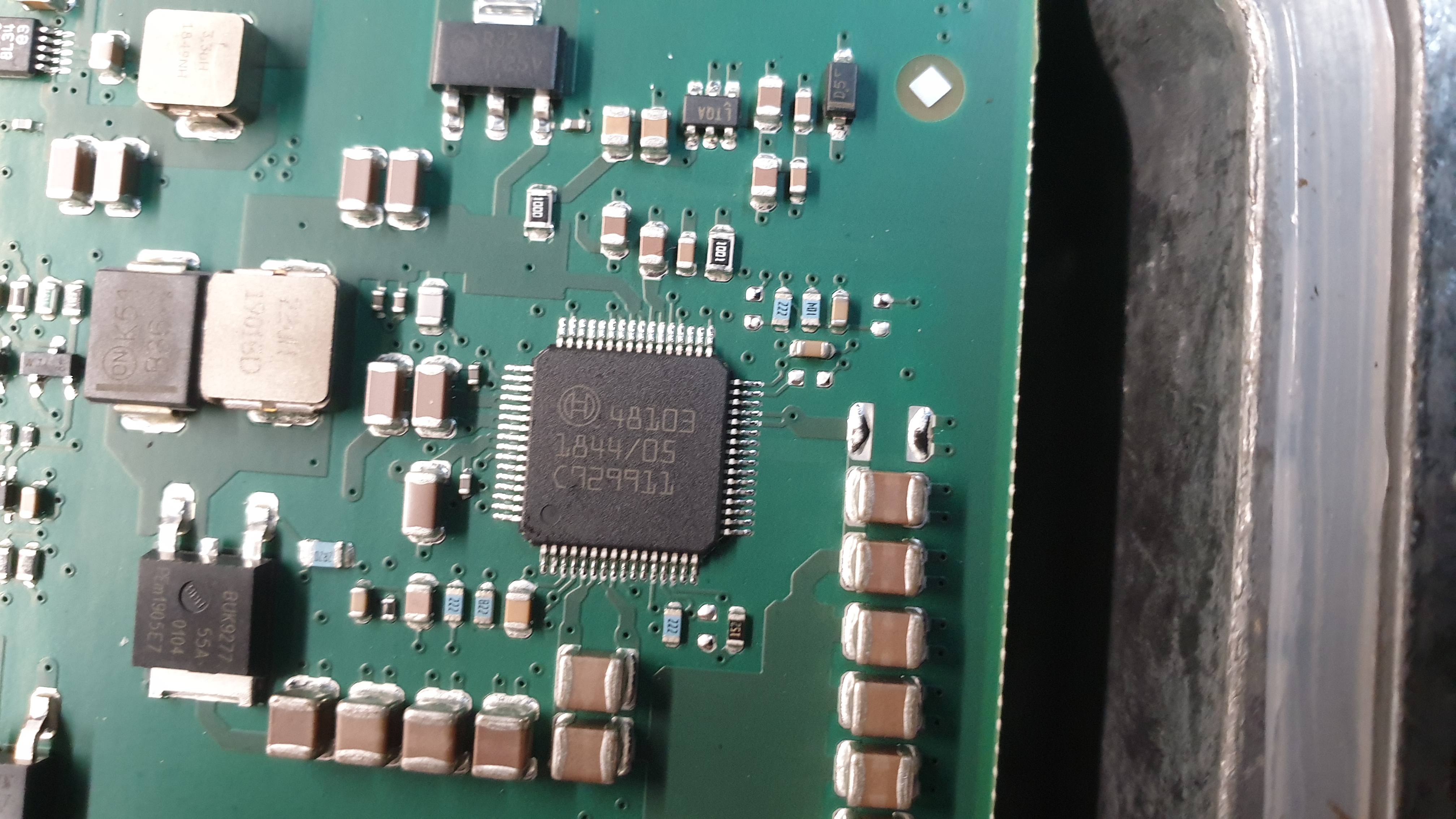

FlexRay Transciever : NCV7381
https://www.onsemi.com/pub/Collateral/NCV7381-D.PDF
BUT...We also have a CAN transciever : TJA1043
https://www.nxp.com/docs/en/data-sheet/TJA1043.pdf

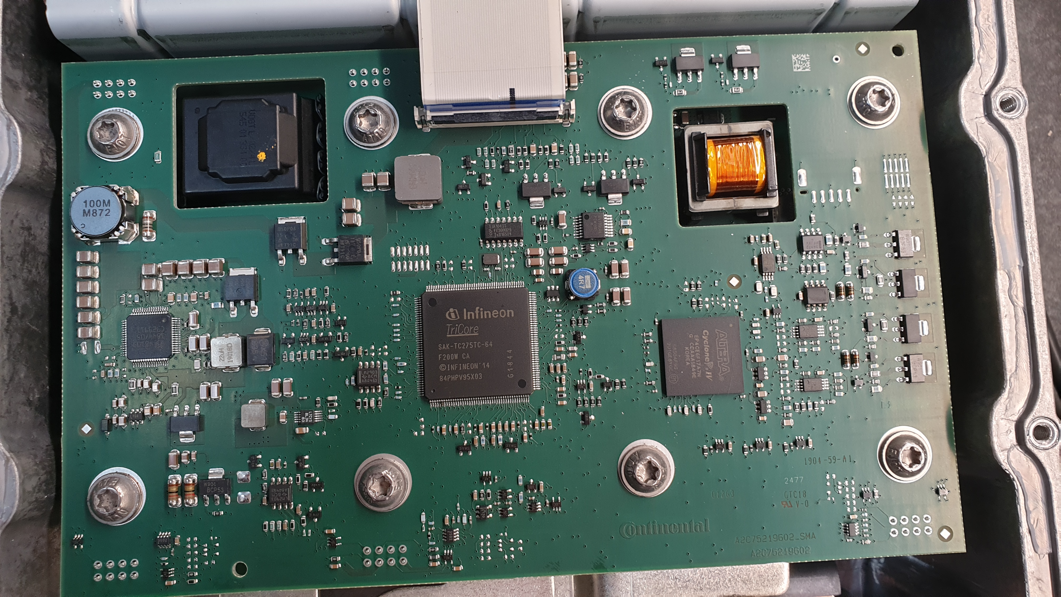

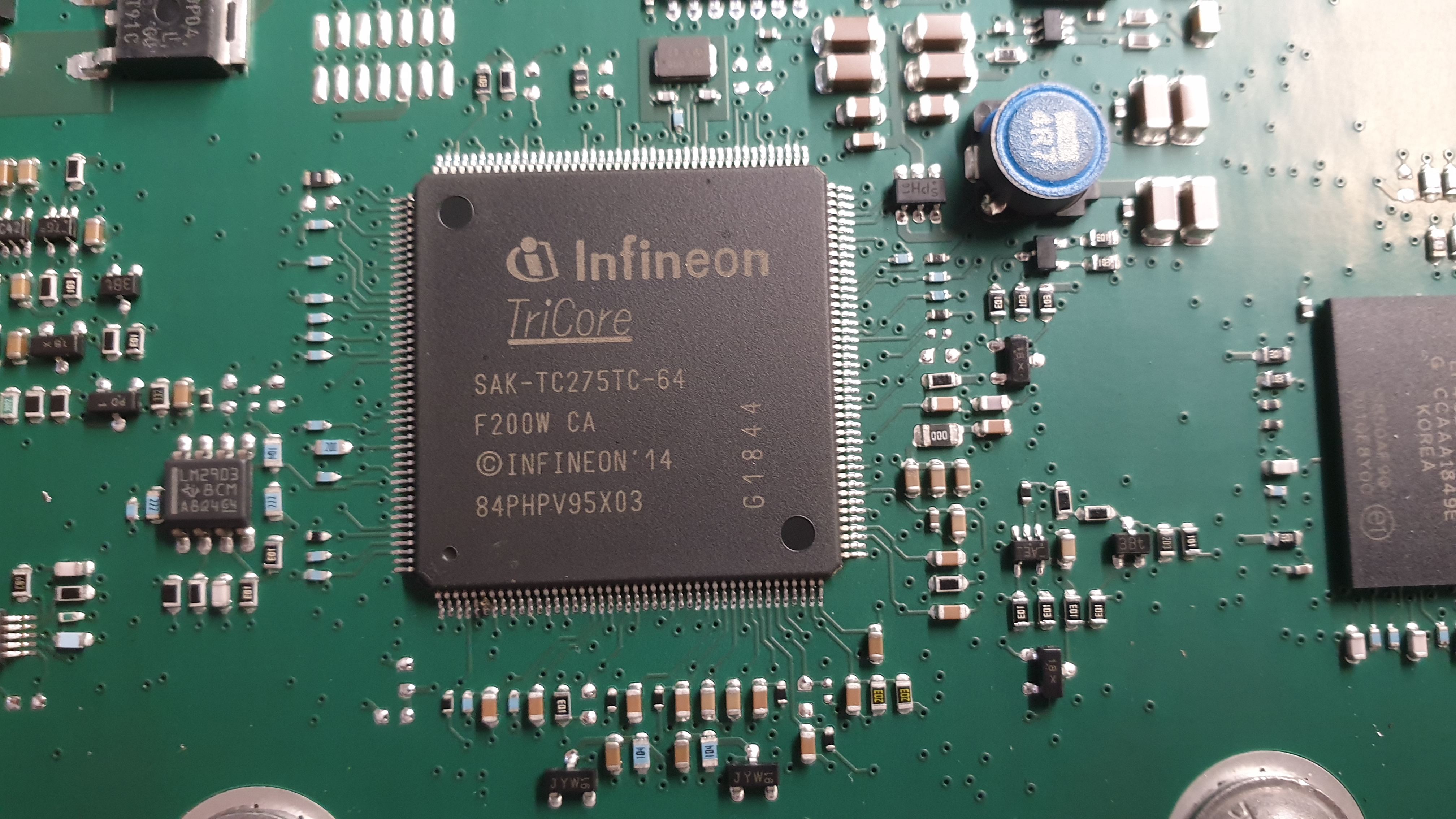

Re: IPace Front Motor Hacking
LOL are they doing angular processing in the FPGA? (MoTeC does this for engines)
The TriCore can do quite a bit too.
Wow, so, yeah that's...really, really overkill.
-Matt
-Matt

_OH_
Continental. That makes so much sense now. They love their TriCore. Probably same engineers as the Engine Control.
The hardware does look good, and pretty compact.

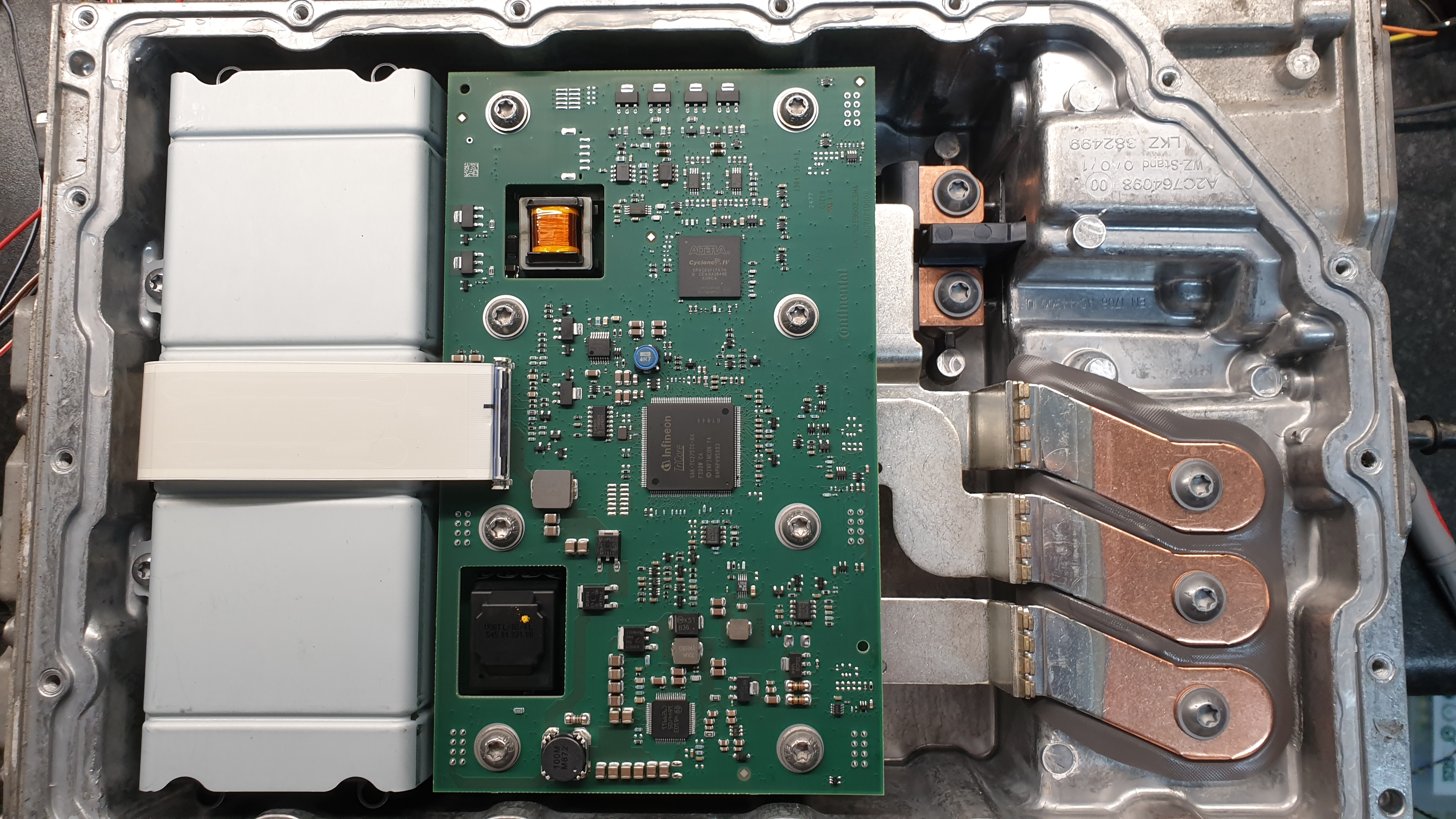

It might be worth measuring up the flexi ribbon cable to see if it's simply a standard FFC, Flat Flex Cable format.
These cable ends come in standard sizes with different types of zero insertion force connector available and each with different orientations that will all fit the same cable ends.

Thanks to a youtube comment we now know the inverter is made by a German company called Vitesco for several different oems.
https://vitesco-technologies.com/en/Hom ... PF2-8-)-en
They even call this version the open inverter
https://vitesco-technologies.com/en/Hom ... nverter-en

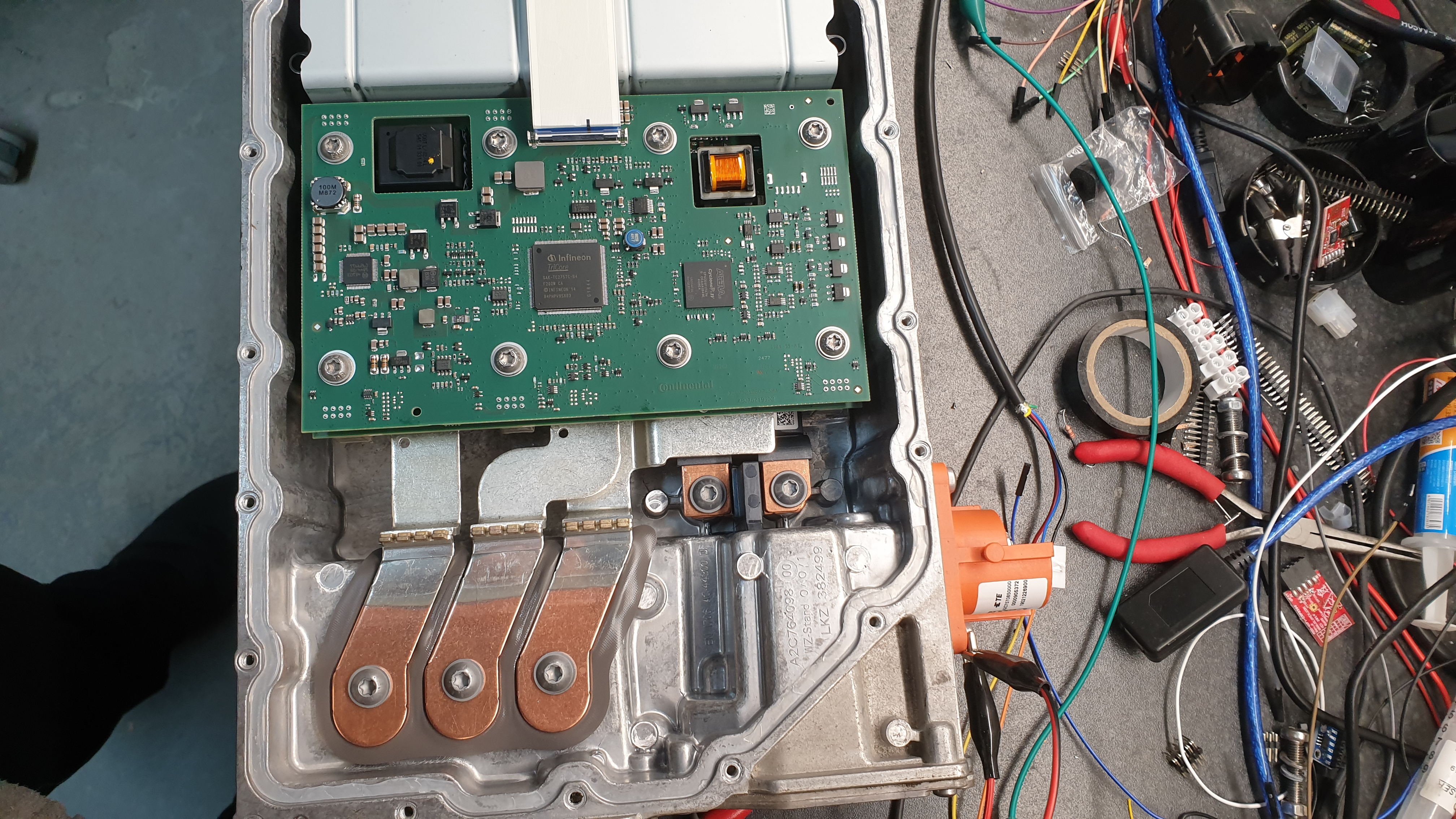

From memory them pins are called compliant pins, claim to be better than soldering as the allow for expansion etc...
Have seen them fain on Bmw air bag satellite sensors, where the housing / connector had 3 compliant pins for the connections and the pcb was a push fit.
I'm not sure the pitch of your connector but if the are at 0.1 inch pitch you should be able to put a samtech connector on the new top board and solder long pins into the bottom board.
