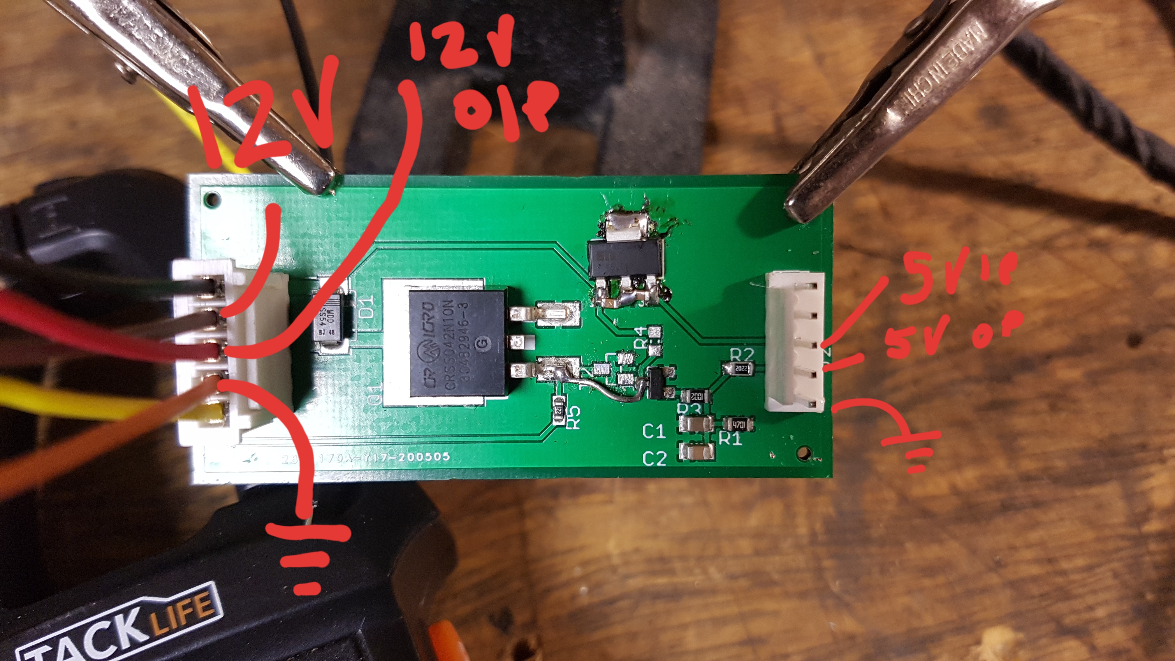

I could use one of these too. Just bench tested the Bosch 0265 005 321 Vacuum Brake Servo Sensor from the Zafira C. It works off 5v. At no vac pressure, it sites at 0.7v and when you get to max vac, it hits just over 4v. Reckon the populated PCB could handle this Johannes?
Posted: Sun Nov 22, 2020 9:58 pm
by johu
I think with the inversion stage skipped it should do. Gotta ltspice that.
Basically T2 and R4 removed and collector of T1 bridged over to R5. And voltage divider R1/R2 adjusted so T1 activates at 4V or 3V, whichever is appropriate.

Posted: Sat Dec 05, 2020 5:17 pm
by Cookie6000
johu wrote: ↑Sun Nov 22, 2020 9:58 pm
Thanks again Johannes for sending the unit on. So, as outlined, remove T2 and R4 and bridge the T1 collector over to R5. Do both R1 and R2 need to be swapped to achieve the trigger points? Any pointers for someone who is rusty on his electronics? I would have it activating when it drops below 3V.

Yes, like drawn
You could replace R2 with 15k or R1 with 3k3

Posted: Thu Dec 17, 2020 10:42 pm
by Cookie6000
So, all components removed and tracks jumpered up. Swapped R2 out for a 22k for now as it's all i had lying about.
Am I right with the wiring here on each of the connectors?
Re: Hardware threshold switch for brake vacuum pump
Posted: Fri Dec 18, 2020 7:08 am
by johu
Yes looks correct, except input GND is on yellow, not orange.
For startup testing, I'd expect the pump to be ON as long as no sensor is connected. Then as "5V op" approaches 3V the pump should turn off. Also check "5V ip" for correct value before connecting the sensor.

Posted: Sat Dec 19, 2020 2:02 pm
by Cookie6000
Cool
OK, i'm on the right track. I rigged it all up as you described, changing the ground, stepped through the test before I connected up the sensor and after and here's how I got on. No activity from the pump at all. Powered pump itself outside the circuit, all good. Wired up, no go. We do however have our 5v out the other side for the sensor and a 0.4v ref voltage fed back with no vacuum. Here are a few test measurements I made WITH the sensor connected. Anything obvious? I do have the 12v ip/op connected the right way, yes?
Posted: Sat Dec 19, 2020 3:04 pm
by johu
Ah, the pump output (red) is switched GND
Posted: Sat Dec 19, 2020 3:54 pm
by Cookie6000
Excellent
Thanks for clarifying that. Think I'm almost there.
Switched ground Red to ground of pump. Brown to 12v+ on battery. Yellow to 12v- of battery.
Sensor voltage now 0.9v after vacuum purge.
Connect 12v+ to the battery, away she goes. Ref voltage climbs, gets to 4.3v and no further, motor keep running. I am guessing I am at the point now I need to change either R1 (currently 4k7) or R2 (currently 22k) to get the trigger point to about 3v, no?
