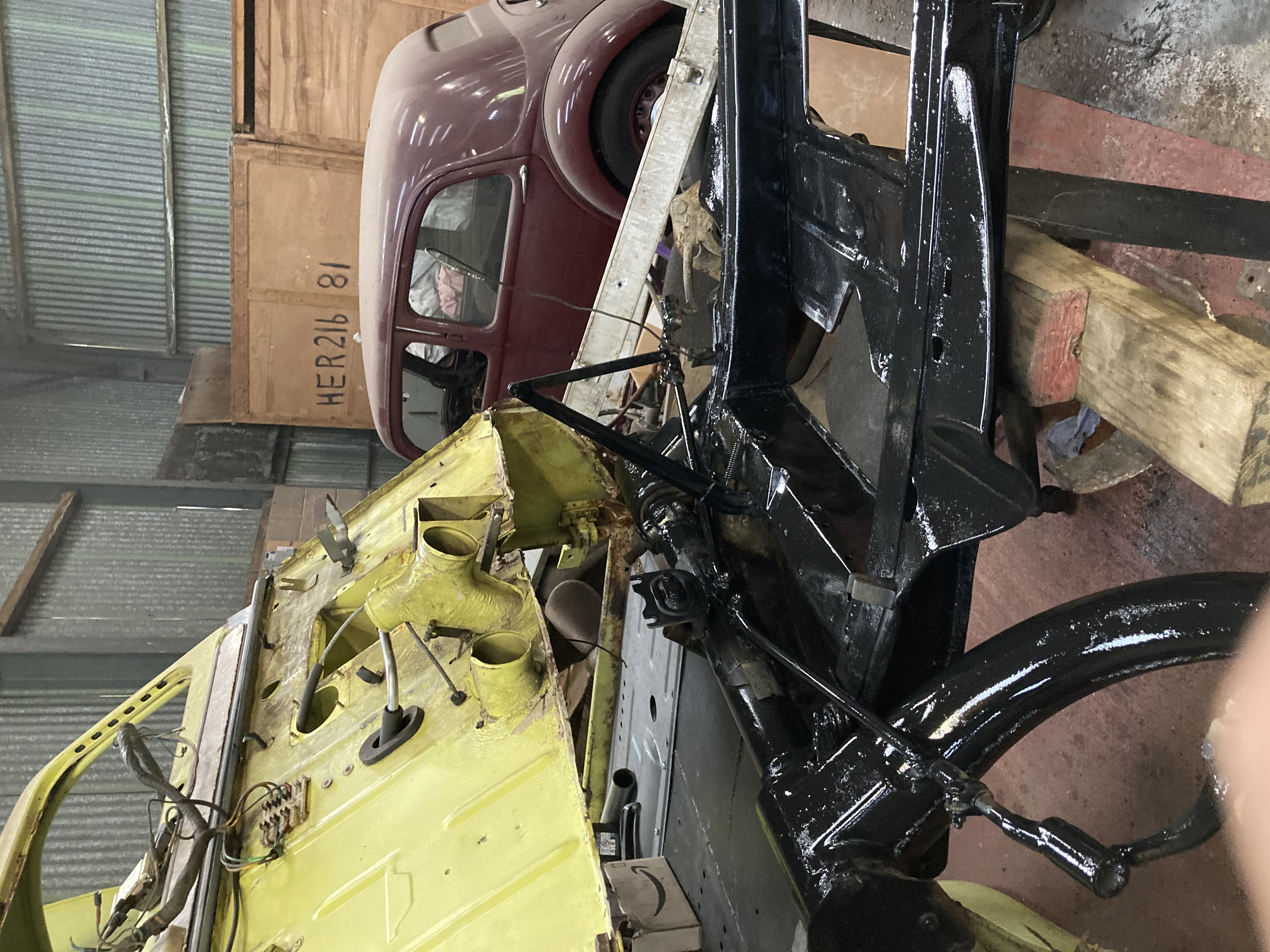

Finally got some time on the 2cv , having realised the motor was fitted to a GS disc gearbox that wouldn't fit the 2cv easily,I remade a splined adapter from a 2cv clutch , put in all new floors, and bought and fitted a disc brake gearbox . Still working on the OI brain in a yaris inverter
engine bay and front suspension all cleaned up ready for the new motor/gearbox
Made up a mandrel (left) to keep the imiev (big) splines and 2cv clutch centre (Smaller) dead straight whilst welding
2cv gearbox fits straight on to GS drilled plate on the Meiden motor
New floors / bulkhead progress .....
