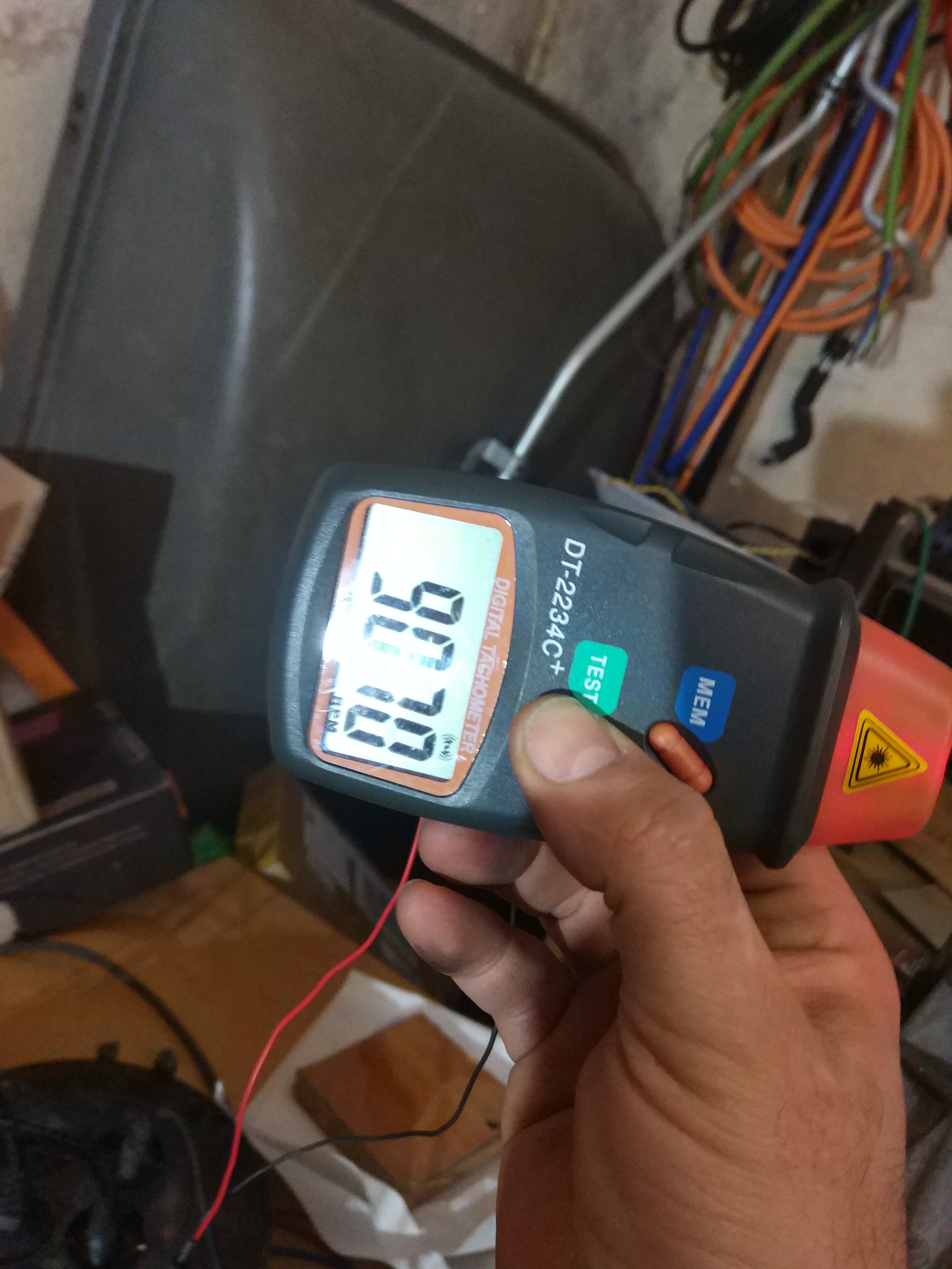

I will hijack this thread since everything about HSG is already here.
I got one HSG motor and i prepared my Volt test inverter to drive it with 360Vdc. That is correct! I applied full pack voltage to motor that in OEM uses
120Vdc 240Vdc or so. I made cables from 6mm2 wire and i added large fastons on the ends. That makes for super easy connection.
My inverter of choice for first run is Lebowski since i already have the board made. The board is Volt Lebowski ver3 with sensorless interface.
However there is a twist
. Since i will also be trying to run Outlander motor via BOTH power sections i decided to connect my HSG motor via the small power section meant to drive the Volt transmission Aux oil pump.
Lebowski makes this almost too easy and i was spinning the motor via settings for regular Prius AC compressor in no time.
9000rpm at 35000erpm, go figure... This means motor is 4 pole pairs! I measured phase resistance and got 460mohm so i divide this between phases and i get 230mohm for a single phase.
I tried FOC calibration and got some more results.
HSG settings
Current settings
Sensor transimpedance 40 mV/A current sensors
Max motor currents 20A Set 20A for start
Max batt currents 10A Set 10A for start
FOC impedance measurement
- Inductance 1500uH
- resistance 230mOhm
Next i will need to setup Openinverter with full resolver interface.

Re: HSG - Hyundai/Kia
Posted: Mon Apr 19, 2021 5:16 am
by arber333
Maybe 6mm2? That would mean some 60A to 100A current limit.
It will not be force fed. It just wont accept more amps once stator is saturated.
On start from 360v i see 8A that falls to 1A with steady acceleration about 5000erpm/s. I may try for main power connections since small power section is limited to about 25A max.

EDIT: strange, i see from ORNL report motor is 6pole. But speed achieved with Lebowski RPM limiter led me to believe motor has 8poles. I will have to confirm that with Openinverter.
Posted: Mon Apr 19, 2021 6:58 pm
by kiwifiat
arber333 wrote: ↑Mon Apr 19, 2021 9:03 am
The resolver gives it away, three lobes for a 3 pole pair motor. Each lobe represents 360 electrical degrees and in the ORNL report you can clearly see the six magnets in the rotor.
