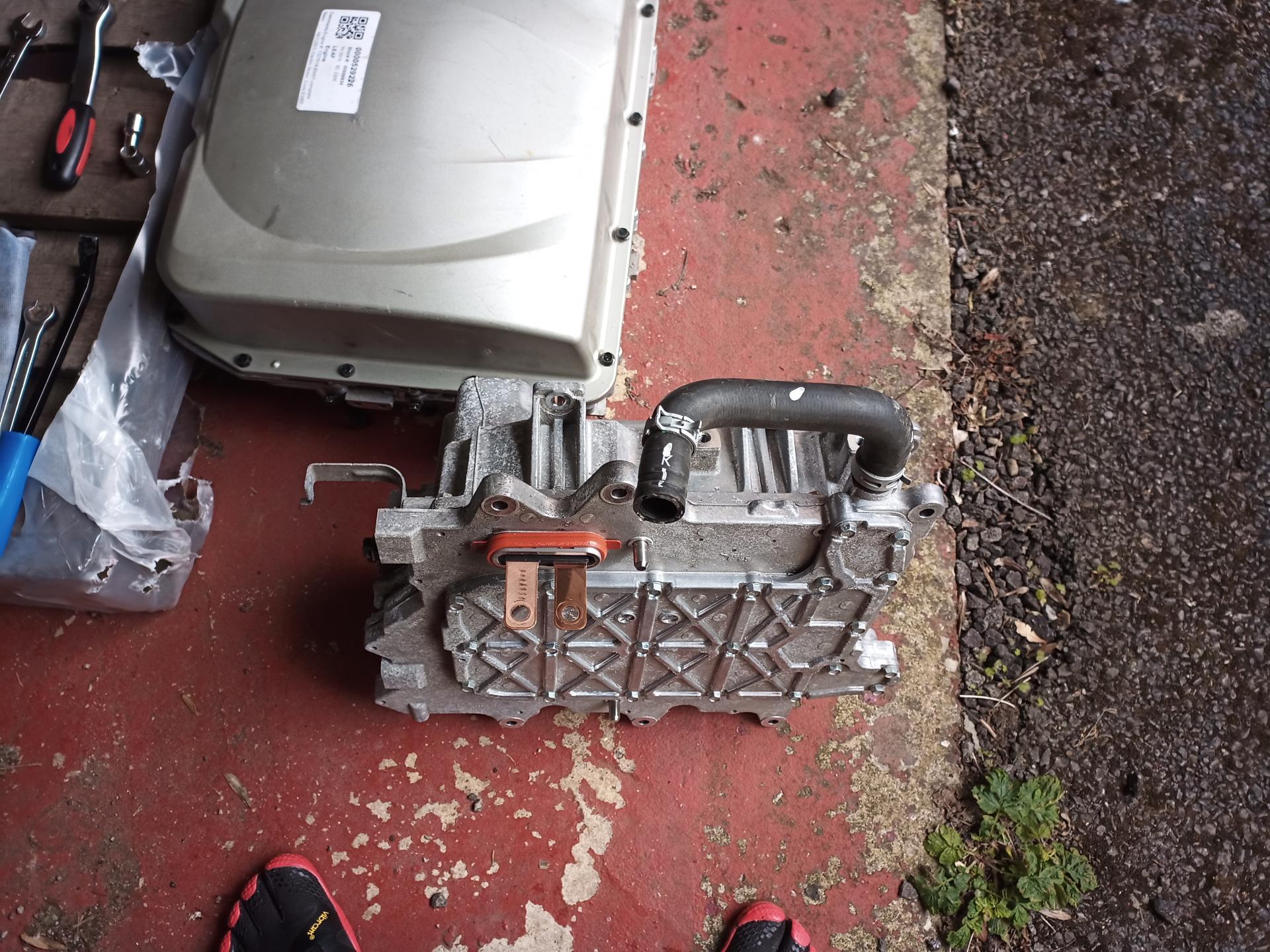

Well my leaf motor finally turned up today :), I think it still has the AC compressor attached too, lots of loom including the charge socket.
Intention is to get it working then pick up the best cheap RX8 I can find.

Well it all comes apart!
Has anyone tried using the 12V DC/DC converter standalone?

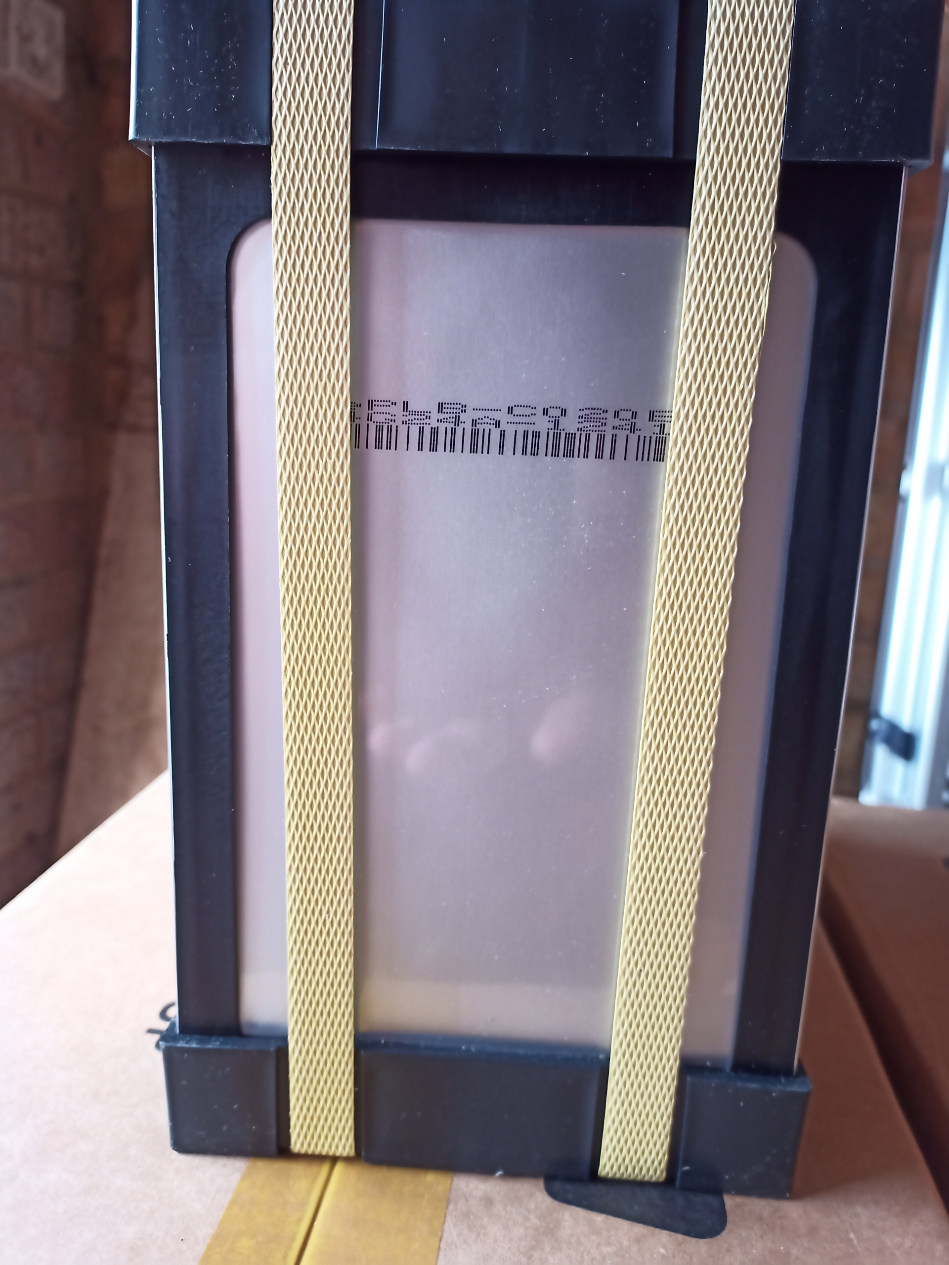

I'm now the proud owner of 500 EIG C20s, they threw in everything I need to make up 10 10S5P packs from them, and a BMS from MG Electronics (and a bunch of other stuff).

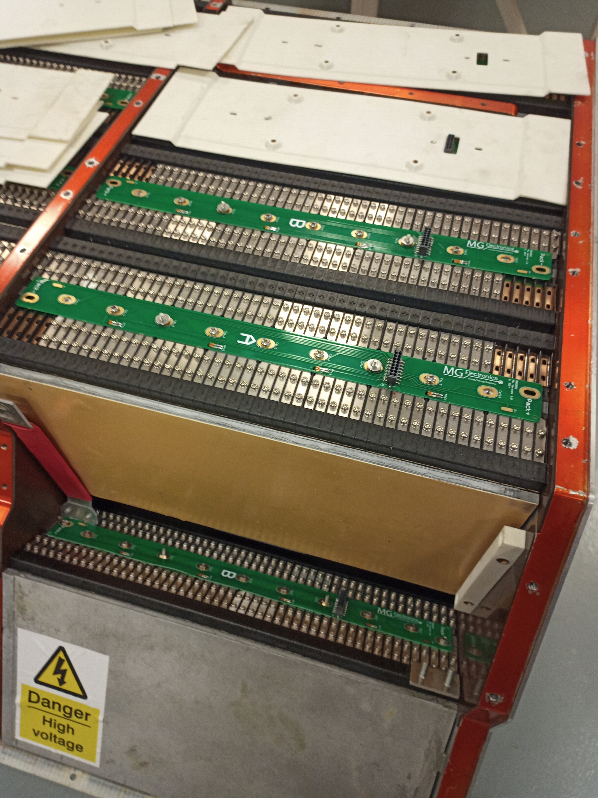

This one of their own packs, in the raw
and ready to go in a car

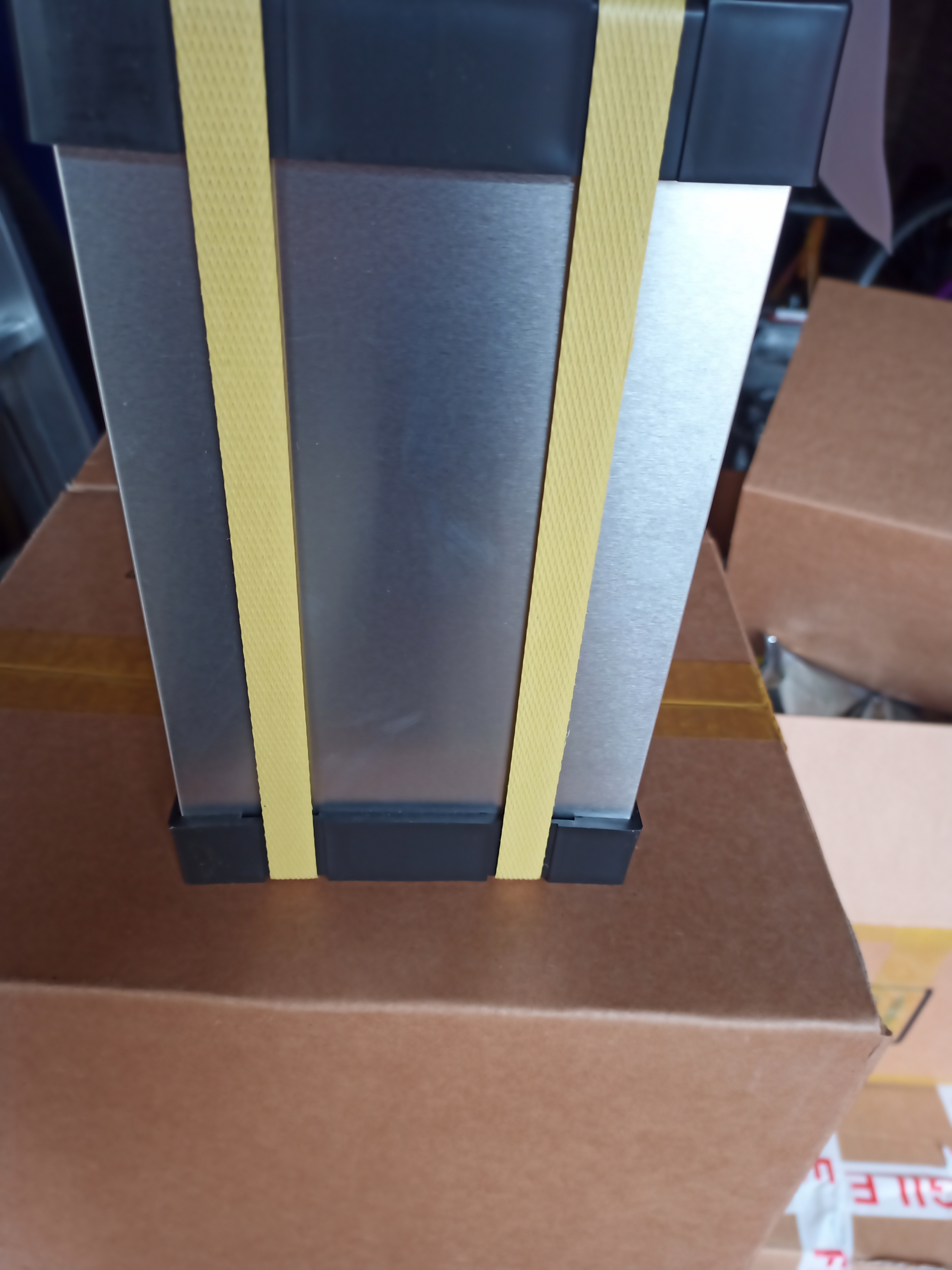

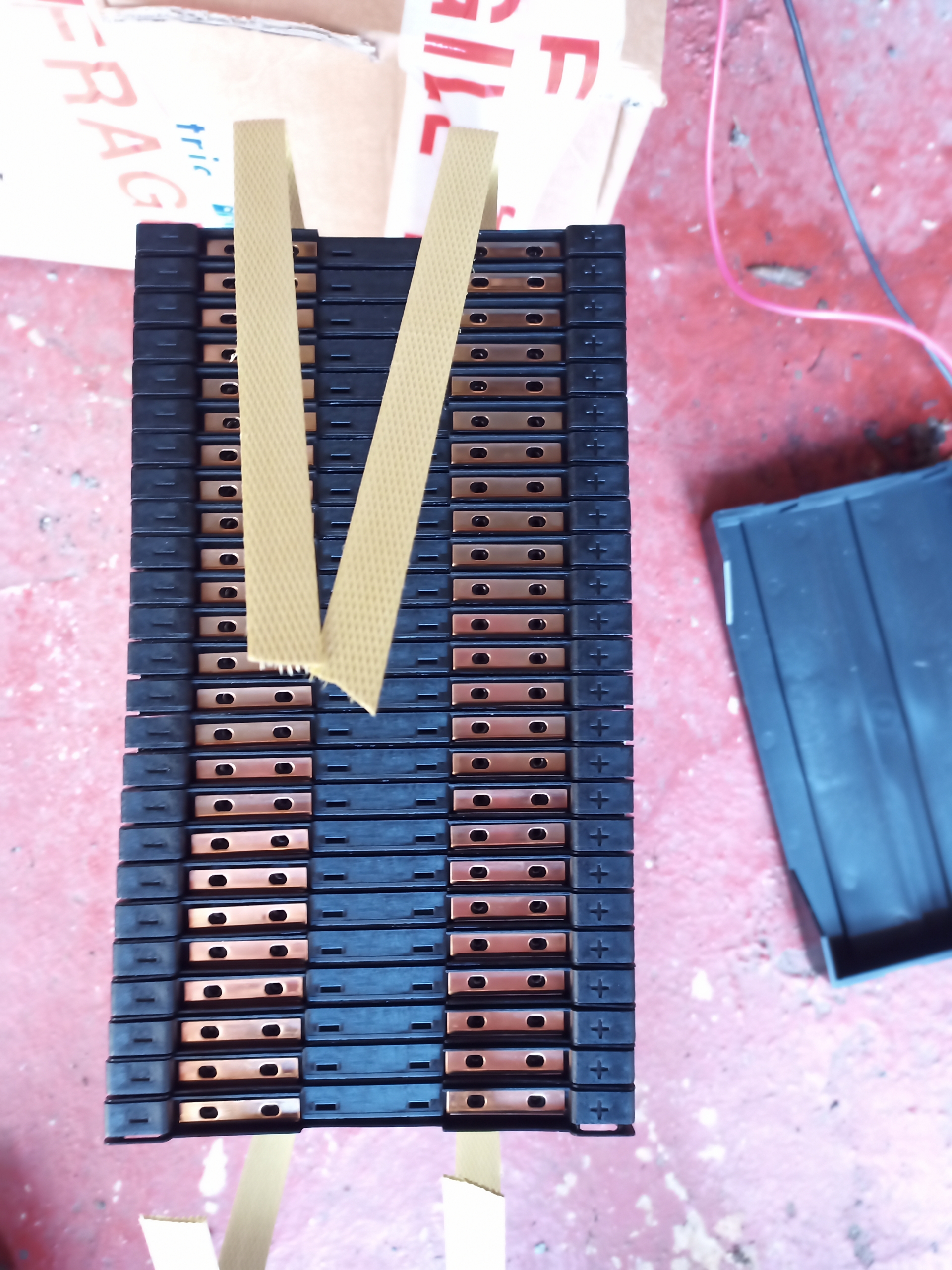

And how I received the cells
