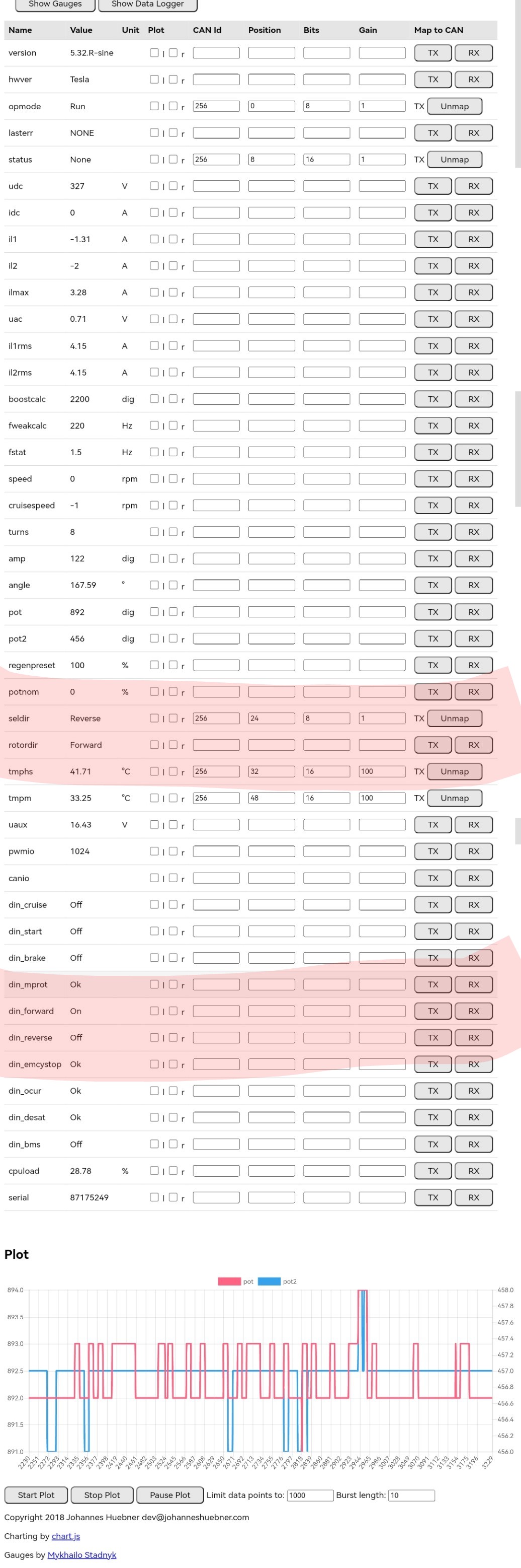

Today I received the second report that the SDU spins in reverse when forward direction is selected. One user might have even damaged the gearbox because he spun up too fast in reverse.
Due to due a lack of an SDU I can't test this myself, but I'm assuming this will be the same for all SDUs and people are just used to make do. So be careful when spinning up.

Just tested my SRDU, can confirm it's backwards. Wonder how that came about...
I presume I can just switch my F/R wires and nothing will behave differently?
Posts: 6735
Has thanked: 378 times
Been thanked: 1559 times
Re: Tesla SDU forward direction
Yes, no different logic in reverse. You can also set dirmode to "SwitchReversed" if you don't want to pull wires.

johu wrote: Mon Mar 29, 2021 8:11 am Yes, no different logic in reverse. You can also set dirmode to "SwitchReversed" if you don't want to pull wires.
I advice people to switch internally the motor phases (in the software configuration), not the wiring of the inputs or the software logic etc.
Forward needs to be forward en reverse needs tobe reverse...
If you swap stuff there might be a risk in the future with updates which are made to work in forward mode etc. etc..
For example a reverse throttle tuning with speed limiter for more feeling during parking etc.
Or a ramp/hold mode which activates in forward gear only...

I just testspinned my SDU this weekend and I have two questions. Exactly how should I apply the command switchReversed in the user interface?

ViktorT wrote: Fri Sep 02, 2022 8:38 am I just testspinned my SDU this weekend and I have two questions. Exactly how should I apply the command switchReversed in the user interface?
switchReversed should be an option under the "dirmode" setting dropdown.

Next question: How to "switch internally the motor phases (in the software configuration)" the right way?

I didn't see any option in web interface where to switch motor phases.
Only parameter related to phases is
syncofs	dig	0	65535	0	Phase shift of sine wave after receiving index pulse
Has anyone done this actually? Maybe it was just wishful thinking? :)

There is no option to swap phases in sine firmware. Only option to swap forward/reverse pins
