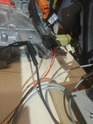

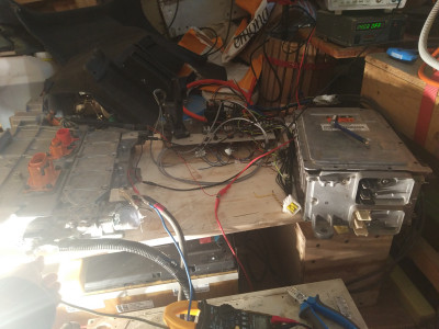

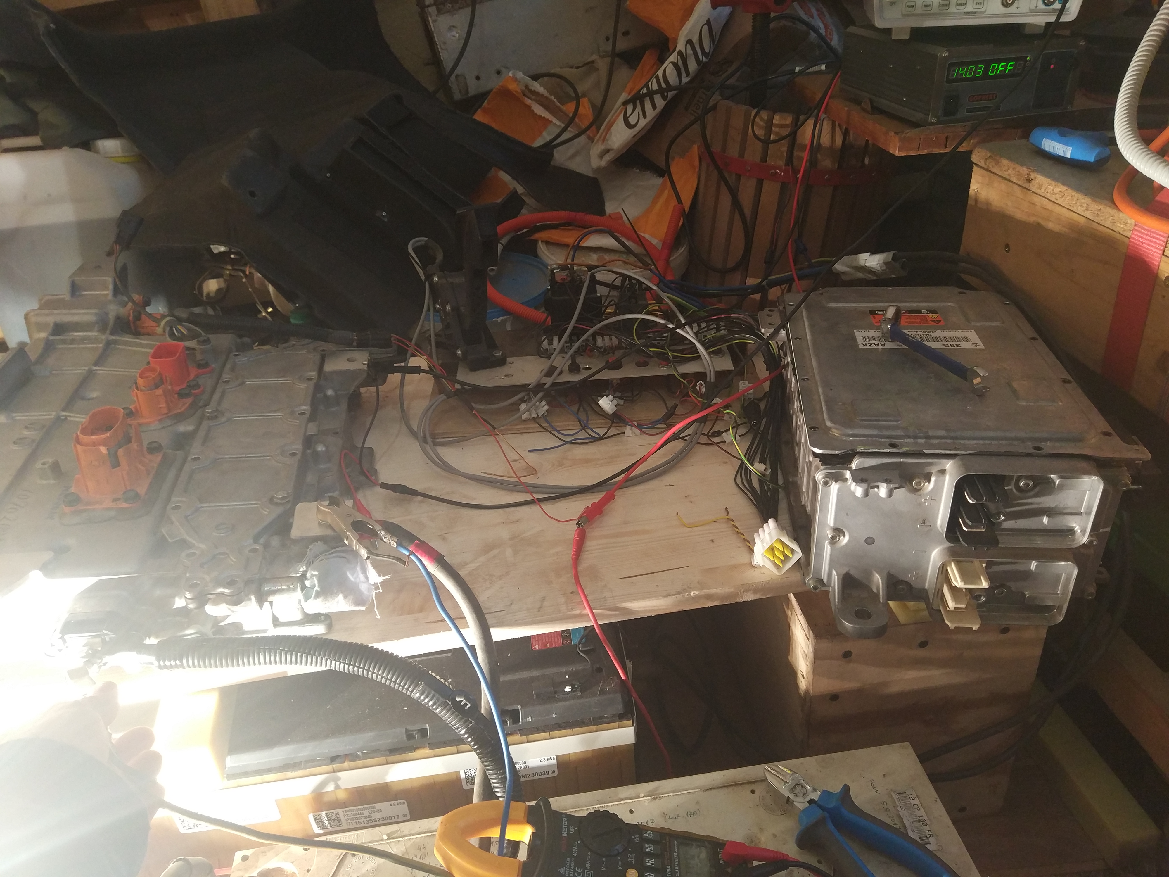

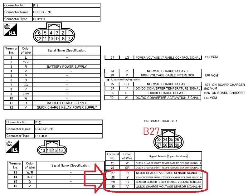

I am not sure if this was already documented here somewhere. If so please consider this only a documented "how to" from me...
A friend lent me a HV contact box out of Nissan Leaf Gen1. He said i should try confirming if it works by simple DIY means. When i googled around in true engineering spirit i noticed this particular DCDC is documented on various sites and videos, however not with schematics or wiring diagrams...
I used some photos and wiring from here: http://myimiev.com/forum/viewtopic.php?t=4533
Starting with connection of the 12v positive terminal to battery
And then GND the case back to battery negative terminal
I connected HV directly to DCDC input wires. Then referring to plugs F11 & F12
Terminal 3 and 11 would need +12v for Battery power supply

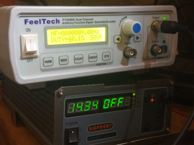

Pin 1 needs a PWM signal 9Hz 50% duty to it Well it was all good and well with the wiring obtained online, however i noticed that DCDC starts as soon as i provide 12V to pins 3 and 11 of connector and provides 14V power to charge 12V battery.
When i added 9Hz PWM to pin 1 of connector F11 i got following result:
PWM voltage
80% 13,10V
70% 13,40V
60% 13,70V
50% 14,00V
40% 14,30V
30% 14,70V
20% 15,00V
If i remove PWM from pin 1 i again get 14V on DCDC output. Also i tested the output with 14V 85A load (9x H4 light bulbs and 60Ah Pb battery) and DCDC provided true and steady 14V power.

The Nissan manual also indicates the PWM signal is 5v.
I have checked that PWM signal straight from a UNO pin does control the DCDC voltage.

Yes. I used both direct 5V PWM and MOSFET amplified to 12V.mackoffgrid wrote: ↑Fri Apr 09, 2021 12:15 am The Nissan manual also indicates the PWM signal is 5v.
I did not play with precharge startup however. I just connected 360Vdc directly on to the DCDC input and it worked immediately with only 12V on pin s 3 and 11. I did not need to use PWM to get 14V. I expect you would need to use PWM also to start precharge relays in a proper way?
Would someone confirm that?

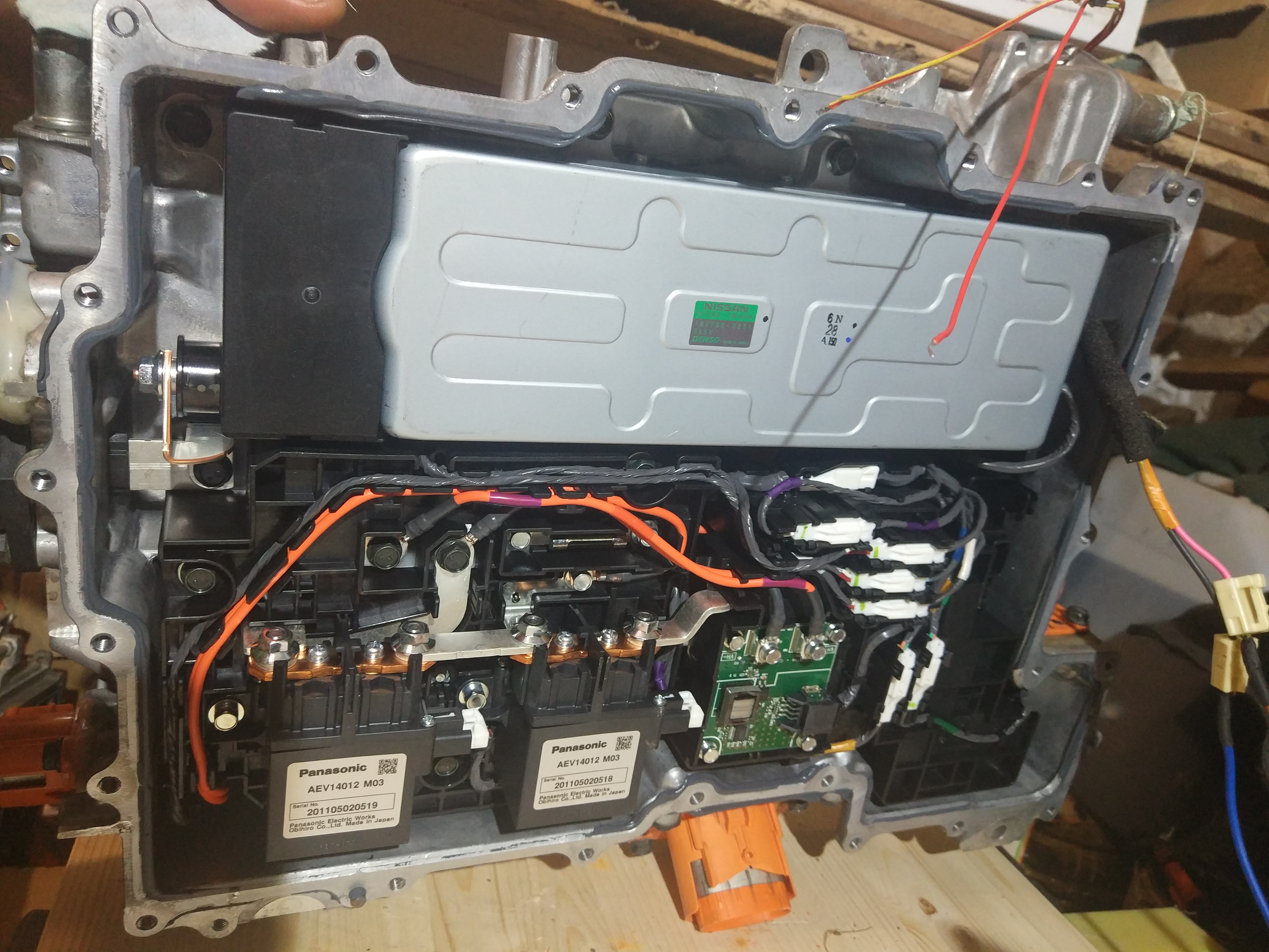

After disassembling the block, it seems to me that the use of pin 11 is not necessary. only pin 3 (+12v) and pin 1 (pwm) can be used. Pin 11 connects to the high voltage relay, not to the dc/dc box

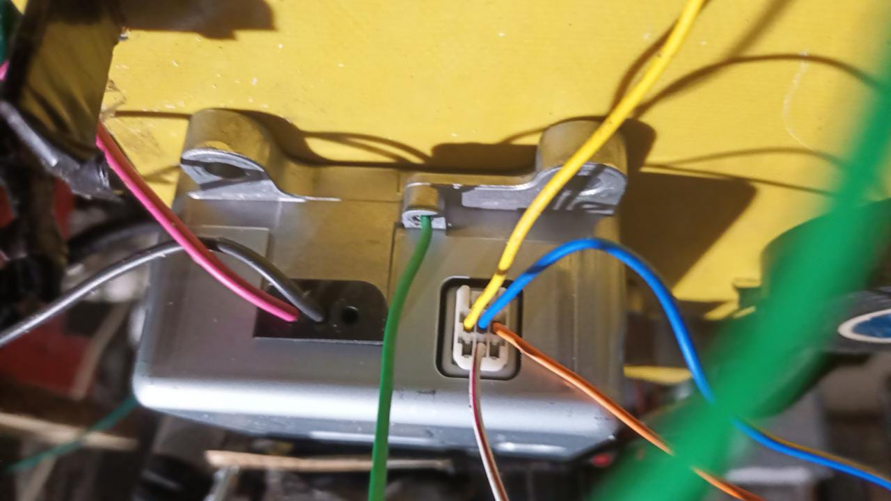

Re: Nissan Leaf Gen1 DCDC control
Hi guys
I've been working on this too for a little while and just today got the dc-dc 12V charger working by applying only 12V to pin 3.
As mentioned it gives 14.15V to the battery with no other input.
While this is another step forward for me I have a couple of questions.
First, I noticed the DC-DC converter was making a noticeable squealing noise. Not loud but it had me concerned so I turned it off again and thought I should ask here.
Has anyone else noticed the same?
Is it normal?
Is it because I'm not controlling the voltage with a PWM on pin 1?
At first I was taking the 12V for pin 3 from the battery being charged via a 12V bulb (in case I'd cocked up the wiring) so it was more like 14V going to pin 3.
To check if this was causing the issue I tried again using a 2nd 12V battery with the neg going to the dc-dc frame and the pos going direct to pin 3 but the result was the same.
Second, 14V is around normal for the output of an ICE alternator so provided the dc-dc converter is happy with no input on pin 1 is there any reason to change it?
Thanks guys.

So I put a smallish load on the 12V battery and tried again and after a few minutes the squealing sound quietened a lot. The dc-dc converter was sending approx 5A at 14.05V (under load) and seemed happy. I'm happy this is OK so unless someone says otherwise I'm going to go with only supplying 12V to Pin 3. I might put a resistor in line to reduce the voltage from 14V to 12V but I suspect it won't matter.
- Posts: 3566
- Has thanked: 134 times
- Been thanked: 335 times
Yes, all DCDCs i know of hate to work unloaded. You need to at least provide a small load like a light bulb. Otherwise they release angry sounds...Alibro wrote: ↑Thu Mar 17, 2022 8:30 pm So I put a smallish load on the 12V battery and tried again and after a few minutes the squealing sound quietened a lot. The dc-dc converter was sending approx 5A at 14.05V (under load) and seemed happy. I'm happy this is OK so unless someone says otherwise I'm going to go with only supplying 12V to Pin 3. I might put a resistor in line to reduce the voltage from 14V to 12V but I suspect it won't matter.

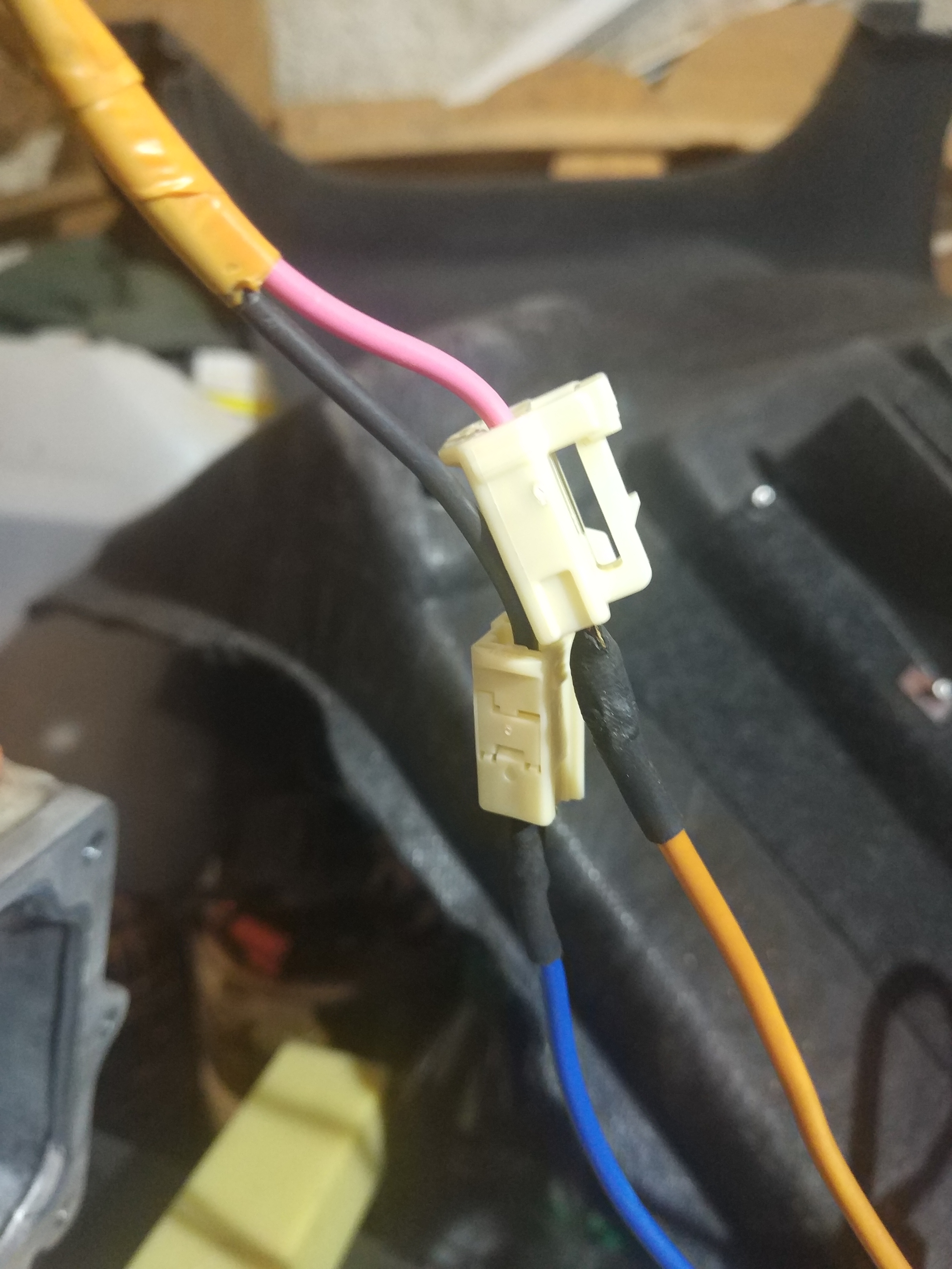

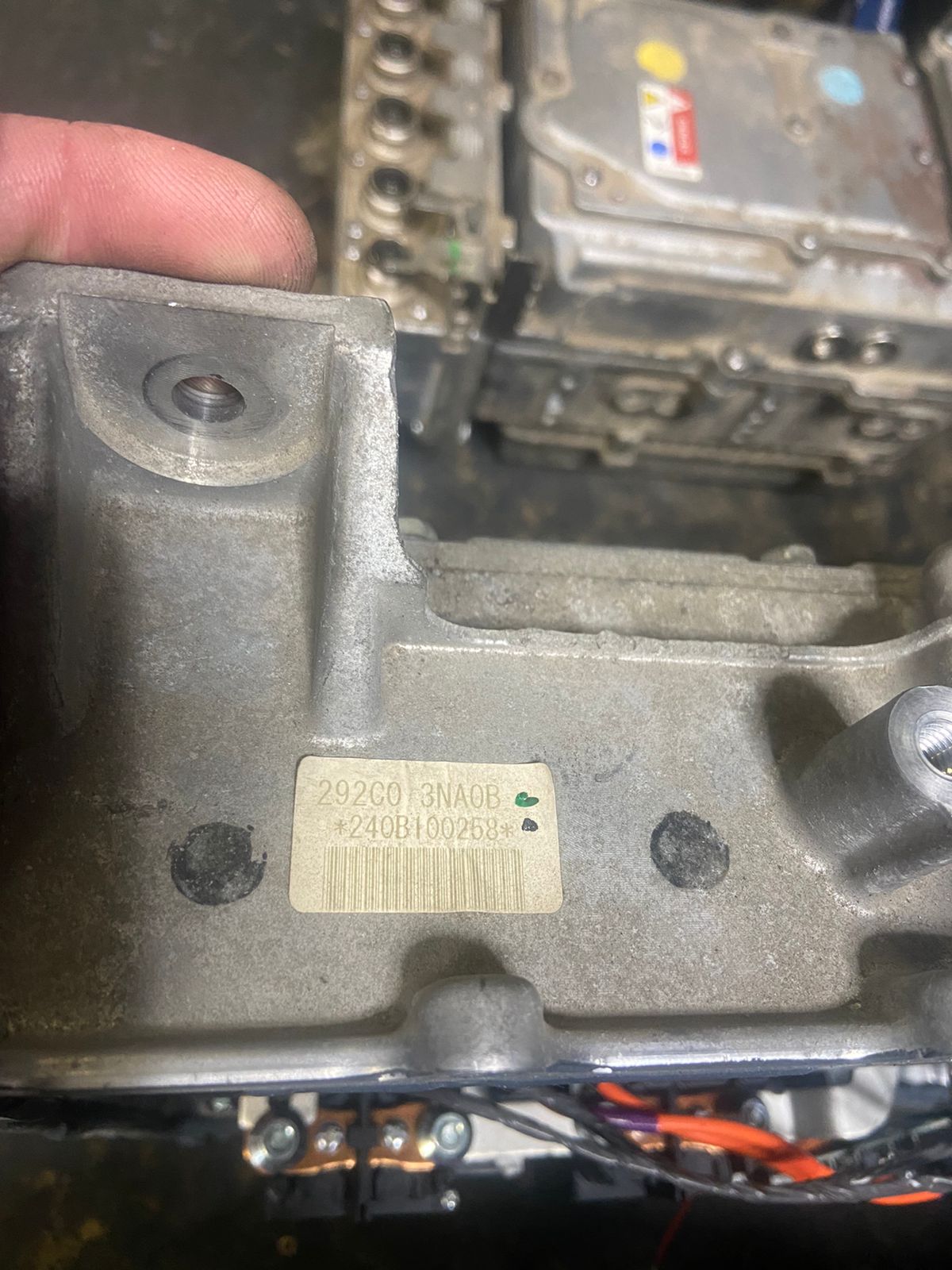

All instructions indicate the pin numbers at the entrance to the main large box, but what if only the dc/dc itself is in the hands?
on which of the four wires to apply + 12, and on which pwm?
I can answer everyone for the future myself. Connect a 12 volt battery to the output, supply a high voltage to the input, supply +12 volts to the blue wire. That's it, the output will be 14 volts.

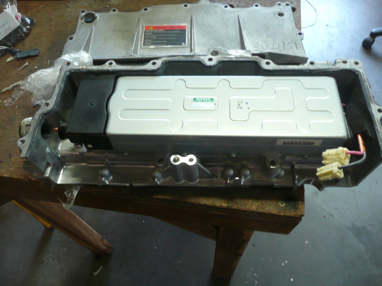

Is that module in the photo the dc-dc converter from inside the PDM?
- Romale
- Posts: 526
- Location: Romania
- Has thanked: 308 times
- Been thanked: 81 times
yes. today I checked by applying only 240 volts to the high voltage input and it started perfectly, 14.03 volts are produced at the output.
evil neodymium
- Posts: 982
- Location: Northern Ireland
- Has thanked: 369 times
- Been thanked: 221 times
Yes I was able to get mine working but it's still inside the PDM
