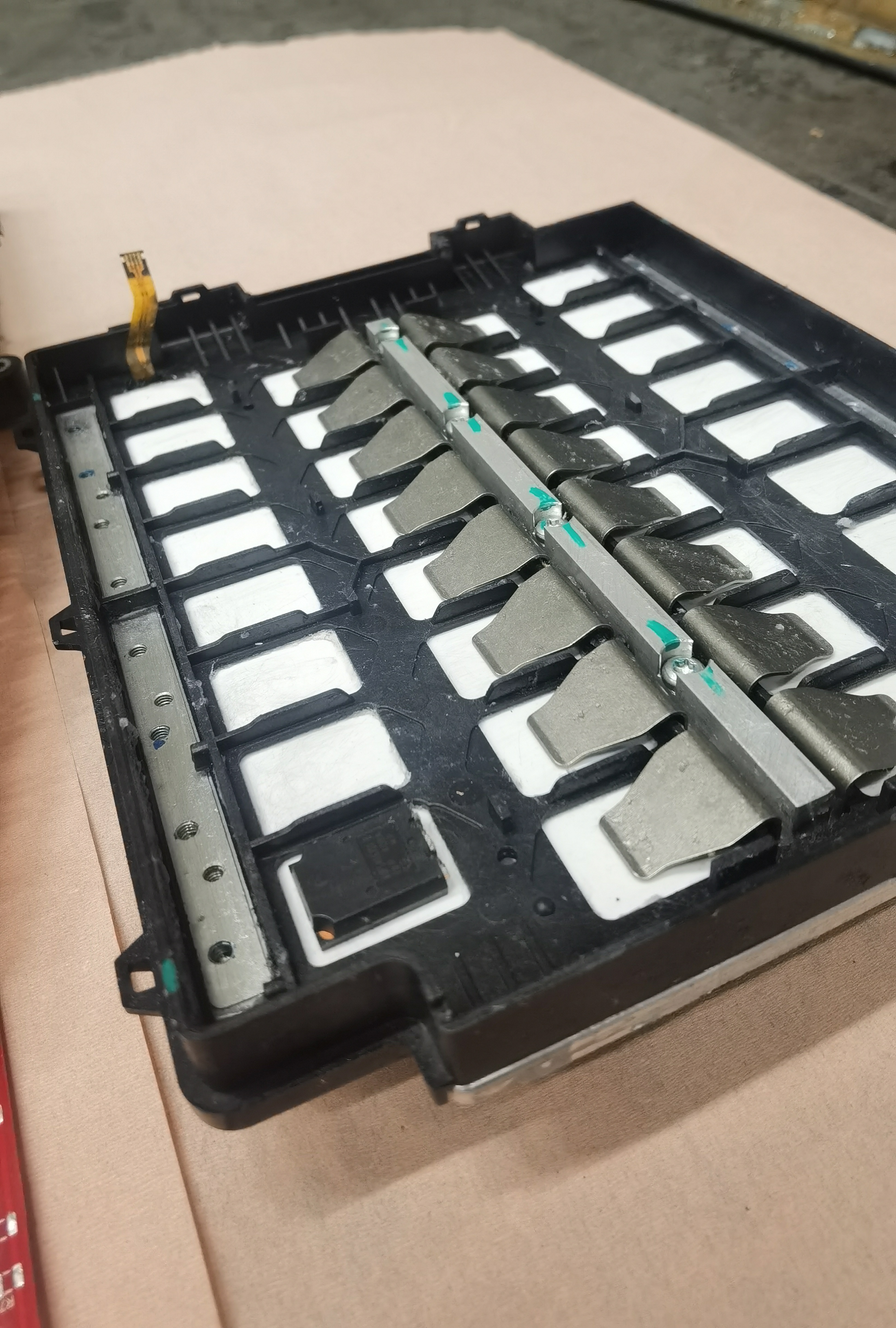

Hello
Time to reveal Tesla LDU Inner secrets
Unfortunally ive got an IGBT Blowout, New inverter piece is incoming thanx to the kind user "Boxter EV"
As return favor to the forum i decided to teardown my broken inverter piece
The solution i found to deal with the "Elon goo" was Metal cleaner:
https://veidec.com/gb/metal-clean
It did not eliminate the goo entirely but its stickyness disapered and behave like gelatine the just blew it away with compressed air.
First preheat to 150-200 degree, then the desolderring begin, ecuipped with 150w soldergun in combination with Vaccum solder station.
Total time from blown inverter piece to this, aprox 4 hours. In this condition it is quite possible to restore with new igbt.
By the way, not the same Igbt as the base unit,
AUPS4067D1-B
https://www.amazon.com/10PCS-AUPS4067D1 ... 08KTDJ9HR
And it can not be repeated enough, this is an example of fantastic engineering and problem solving

Then it was time to spread some light over all the broken Large drive units, i have against all odds managed to bring life to my P85 drive unit.
After replacing all the igbt in one of the bridges.
As well as all semiconductors in all three drive cards, everything had a short circuit. Not unexpectedly i constantly had overcurrent alarms.
Everything solder together, just the cap left.
All semiconductor on the "isolated" side replaced.
Everything from igbt driver to diodes and n/p transtors.
After final test i decided to add some re-entering silicone.
Couldn't find any transparent unfortunately.
Not a project for everyone but it has been quite educational, spare parts have cost about 4-500eur. Also had to buy a new soldering iron of 200w to cope with the thick laminated copper. The worst part was all the lacquered circuit boards in combination with the extreme lack of semiconductors...

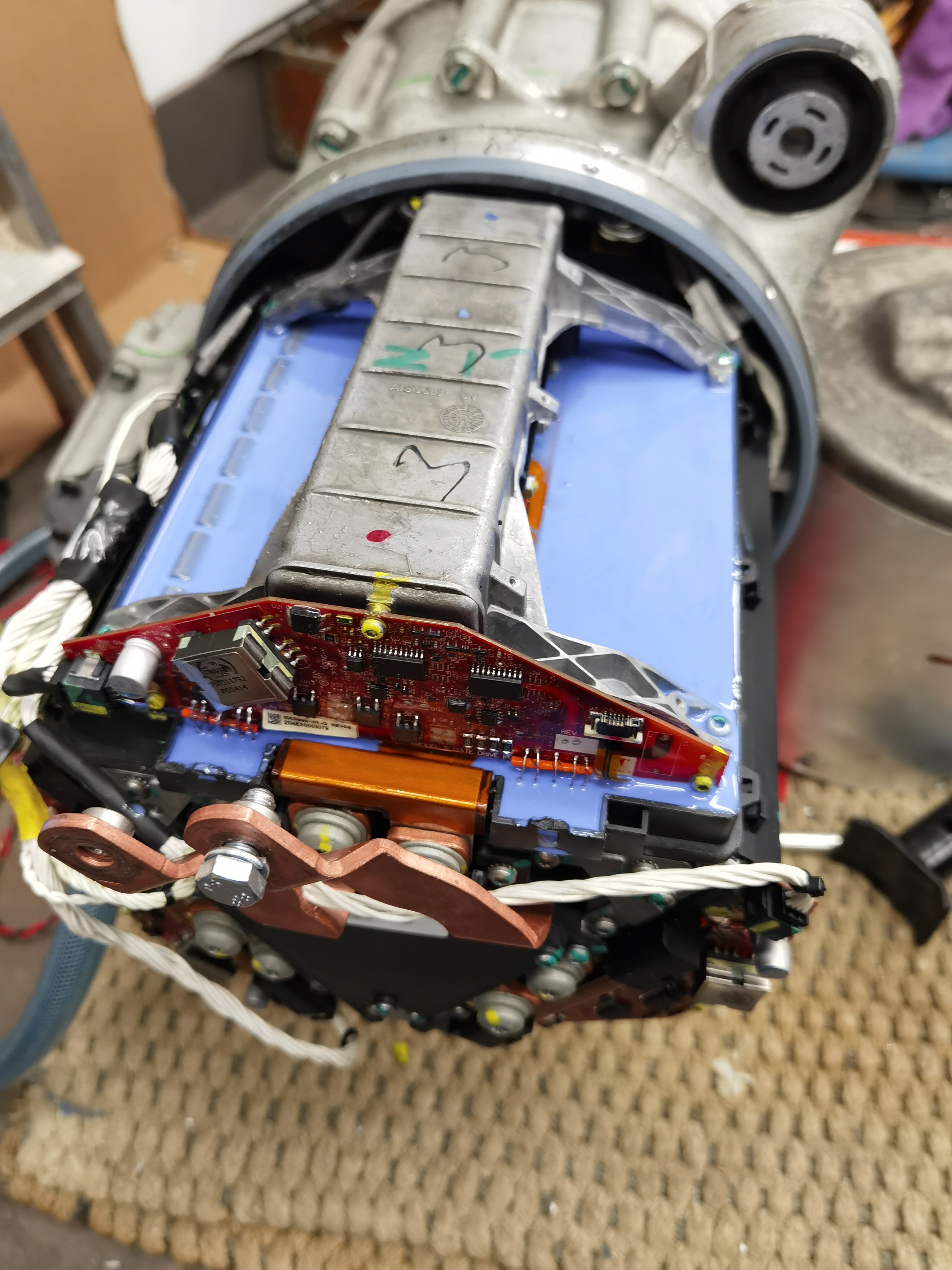

I just picked up another LDU, which I knew had a mechanical failure. Upon opening it up, I can see some signs of IGBT failure. Where/what do I need to measure to confirm a blown power stage? I know it's been discussed before but I could not find it.
Re: Teardown - Tesla LDU - Inverter
Posted: Sat Jul 08, 2023 9:53 am
by fredd90
P.S.Mangelsdorf wrote: ↑Sun Jun 18, 2023 5:31 pm
Did answer you on PM also, put this is answer here to help other people,
I did measure in diode mode, the data sheet say that forward bias should be around 0,5v the ones that was in worst condition was totally shorted, the other around 0,1-0,2v.
Then the low ohm(1ohm) power resistors for "gate" control was in Mohm range. probably therefor the igbts blown, not had the possibility to open/close correctly...
Both +/- side engaged at the same time... My final verdict is that the problem started with bad resistors...
