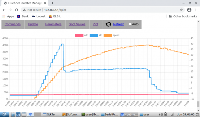

Adjusted "throtcur" to 1 (2) to get a smoother result when flooring the accelerator pedal as using 2 seem to give me slight wheelspin...
udc, speed on left and idc on right

This picture show what I expect in terms of motor power when entering FW, slowly decaying power as speed increases.
To my understanding, the above result can not be explained by motor behavior but rather the inverter limiting the current to about half when entering FW.

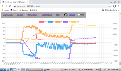

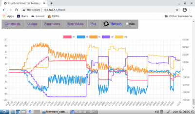

Now tow plots with added Ud and Uq.
id, iq, idc on left axis, ud, uq on right, fwkp -300
On the last plot there is a strong unwanted regen period at time stamp 1780-1820.
Back to the main issue and there are definitely some unexpected behavior regarding Id and Ud.
I expect Id to keep going more negative when entering FW but instead it makes a step closer to zero and as a result, to weak FW and hence reduced torque. Iq seem to do what I expect.
Ud seem to somehow max out. Are there a limit to Ud and Uq? I guess, I need to further look into the FOC SW. I'm thinking, Ud and Uq are calculated values.
There are also noticable more noise on Id when in FW as compared to before FW.
Also strange with the odd behavior of Id when in regen, time stamp 1780-1820 in last plot. Unwanated regen might have the same cause as with the reduced current/power when in FW, or not?
At this moment I have raised more questions then I have answered, but will keep looking into this.
EDIT: Added conclusions, or more questions if you will...

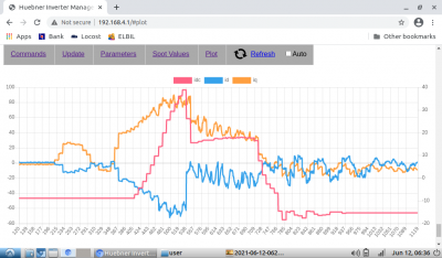

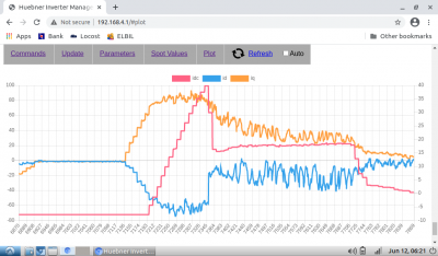

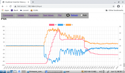

Managed to test with "syncadv" chaged to 20.
id, iq, idc on left axis ud, uq on right axis, fwkp -100
id, iq, idc on left axis ud, uq on right axis, fwkp -300
id, iq, idc on left axis ud, uq on right axis, fwkp -500
id, iq on left axis idc on right axis, fwkp -500
Changing fwkp seem to have no effect but increasing the syncadv definitely gave an increase of current during acceleration. Did also seem to increase low speed stuttering and unwanted regen, but still positive effect on acceleration...
Idc peak goes to 45A (40A before) and during FW to 30A (20A before).
Was going to test "syncadv" set to 5 as well but managed to not copy that build over to the laptop and now there are to much traffic. I think 20 seem to give some good result. I can test with 5 tomorrow if still useful?

When looking at the code below from the pwmgeneration-foc.cpp I relized that the low speed stuttering (more info here: viewtopic.php?f=7&t=1546) I'm experiencing at 2-3km/h is probably also created by this.
When increasing syncadv I got more low speed stuttering and when doing the math I get the following:
syncadv can't be negative so for a frq from 0-20, syncadv is 0.
With a polePairRatio of 2 the rotorFrequency of 10Hz results in frq=20 and hence start of syncadv.
10Hz rotorFrequency equals 10*60/4 = 150rpm and in my car that is equal two 150/65,8 = 2,3km/h.
10Hz rotorFrequency equals 10*60/2 = 300 and in my car that is equal two 300/65,8 = 4,6km/h.
rotorFrequency is not actual rotor frequency but rather resolver frequency, so may not be related but I got an increase in this stuttering with increased syncadv.
So my theory at the moment is that these two faults may have the same cause.
Might be a good idea to perhaps measure this or do something to get a better picture of what is going on.
I think less syncadv at low speed and more at high speed would be beneficial but maybe not only speed driving this but also torque demand as it also seem to effect regen or unwanted negative torque in FW.

EDIT: my math is incorrect
Re: Halved current during field weakening
Posted: Sat Jun 12, 2021 5:51 pm
by johu
Yes your code change was correct. And yes syncadv will introduce some speed dependent variation of id/iq distribution. It might well be that syncadv is correct (it is NOT motor dependent but depends on the time between sampling angle and actually calculating the next dutycycles). So then the id/iq distribution created by MTPA could not be appropriate for the motor.
I'm currently not sure what to vary. The relevant constant in foc.cpp are fluxLinkage and lqminusld. Also the dependent constants lqminusldSquaredBs10 and fluxLinkage2 (squared) must be recalculated accordingly.
lqminusldSquaredBs10 = lqminusld² * 1024
EDIT: thinking about it again, the pole pair ratio could matter to syncadv. Twists my brain a bit ;)
