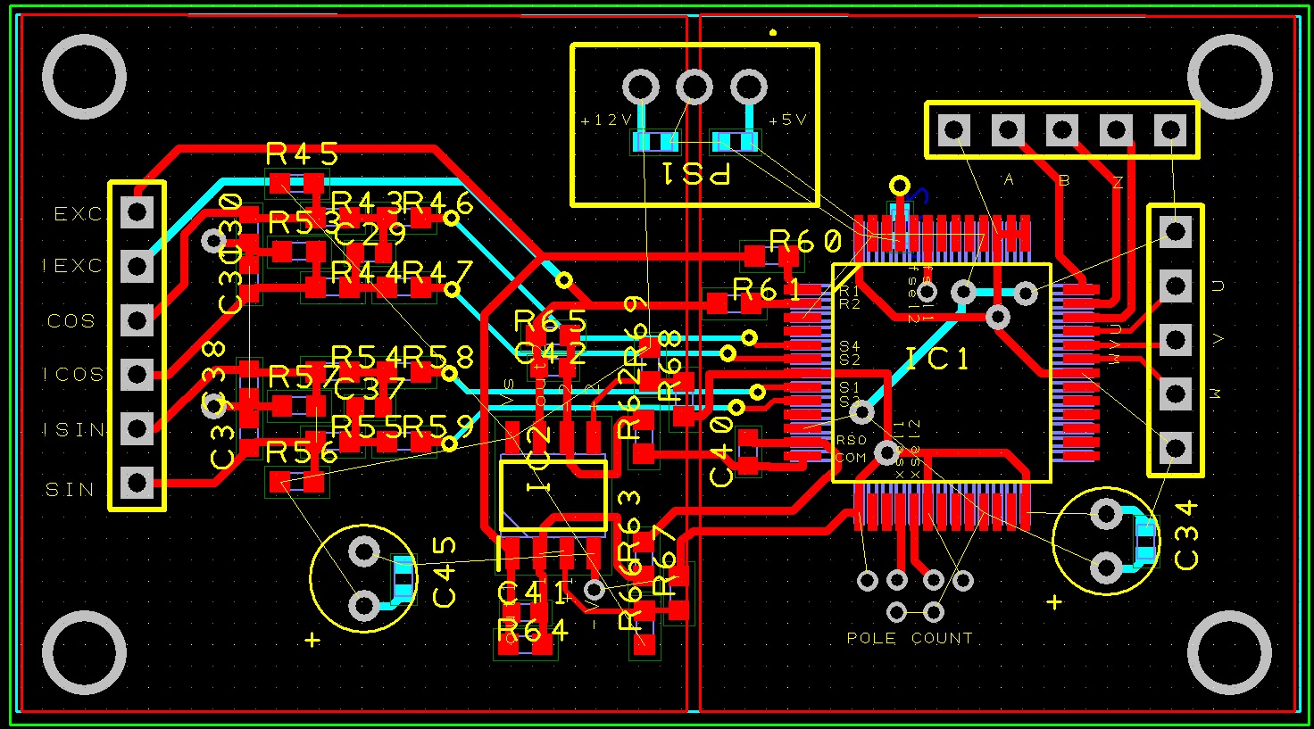

Ok i quickly made a circuit that i could use to drive my Lebowski inverter. I will try first and then publish my design.
There are 5V plane and 12V plane. I intend to use one nonisolated 5V to 12V boost converter. I think 500mA should be enough?
Or i can use this one, but i have to correct pinout. https://www.ebay.co.uk/itm/DC-Converter ... YUtlQsjBaQ
I prepared I/Os to get either UVW or ABZ outputs. That should work even for Pauls controler.
Also i will order like 5 Boards of which i will take one for myself. If you are interested i can then send one of those to someone interested.

I am sure 500mA will be fine. Do you realise that if you are going to use the three highest bits of the parallel output as UVW signals you also have to clock the resolver chip to get it to do the sample and then place it on the parallel data bus? To do that you need another micro to generate the required clock sequence for the resolver chip. Have you thought about switching to KiCad for your designs? It is opensource.arber333 wrote: ↑Wed Jun 19, 2019 10:19 am Ok i quickly made a circuit that i could use to drive my Lebowski inverter. I will try first and then publish my design.
I am disinclined to use anything sourced from china in an inverter for a car. Too many low quality knockoff chips that I just don't trust, better to design a boost converter using an IC from a major company and sourced from a reputable supply in my opinion.

Hm... i will not be using the bus. Only UVW or ABZ digital outputs in pulse mode. I will go back and draw an external clock. I totaly forgot about the recommended crystal oscilator.kiwifiat wrote: ↑Thu Jun 20, 2019 4:56 am I am sure 500mA will be fine. Do you realise that if you are going to use the three highest bits of the parallel output as UVW signals you also have to clock the resolver chip to get it to do the sample and then place it on the parallel data bus? To do that you need another micro to generate the required clock sequence for the resolver chip. Have you thought about switching to KiCad for your designs? It is opensource.
I got used to designspark and dont really have the time to learn new design interface. Maybe i will try to learn on vacation

I can't tell from your PCB if you are using an AD chip or the Tamagawa chip? The Analog Devices chip requires not only an oscillator but clocking of the CS and Sample pins.arber333 wrote: ↑Thu Jun 20, 2019 5:22 am
I got used to designspark and dont really have the time to learn new design interface. Maybe i will try to learn on vacation.
A
Johannes is there any chance you could port your current resolver code down to a lower spec ARM chip and output UVW based on pole pairs and number of lobes on the resolver?

I use Tamagawa resolver chips AU6802N1 with proposed datasheet circuit. I didnt change a thing. I will post design when i try it here.
This should have UVW as well as ABZ pulse signal.
