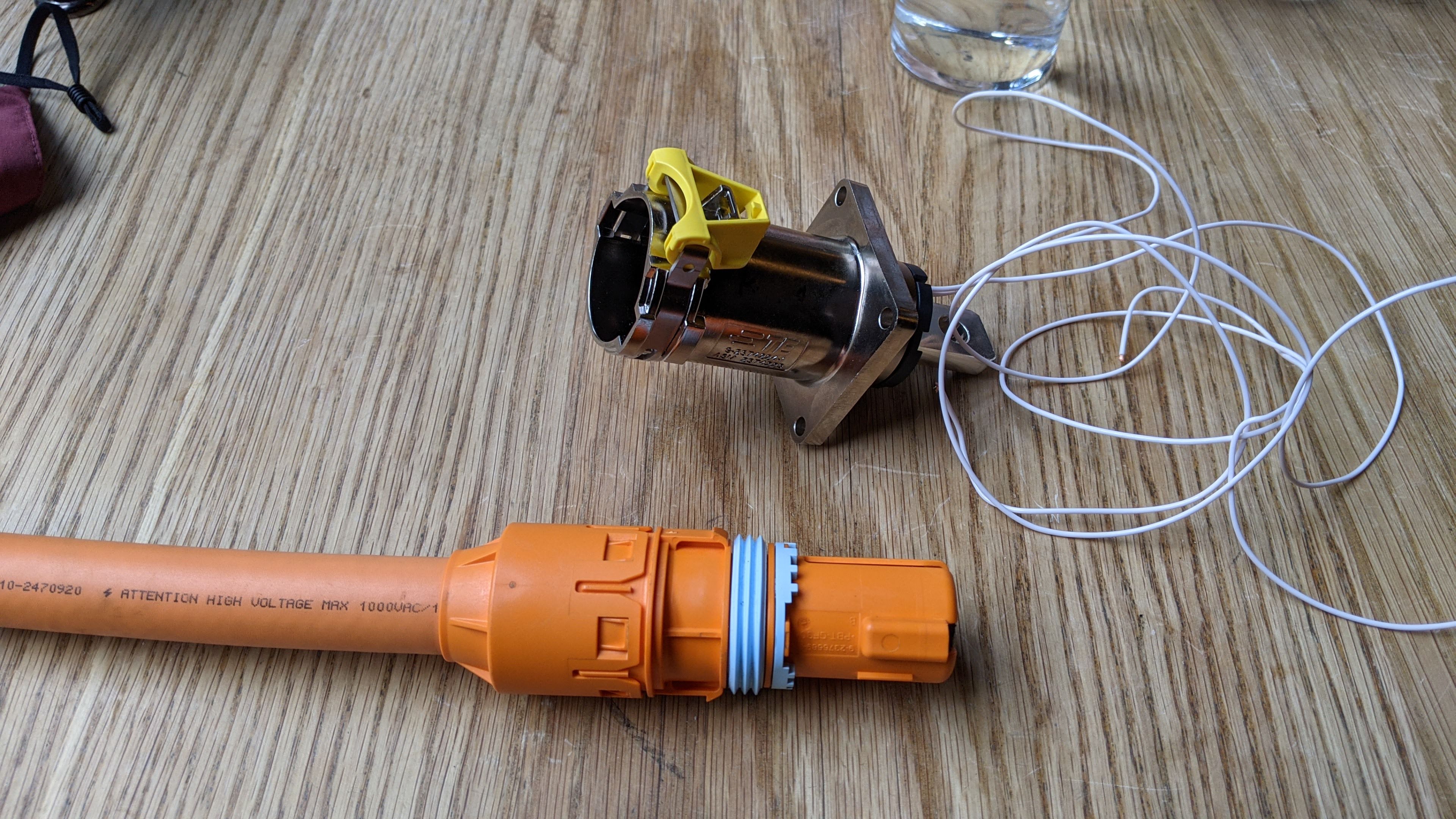

the difference in safety measures between our conversions and the systems I design for public use is ridiculous - HVIL and Iso Detection being the main pieces.
as an example we are using 120mm² single pole cables x3 (pos & neg) in parallel to carry the current we need.
