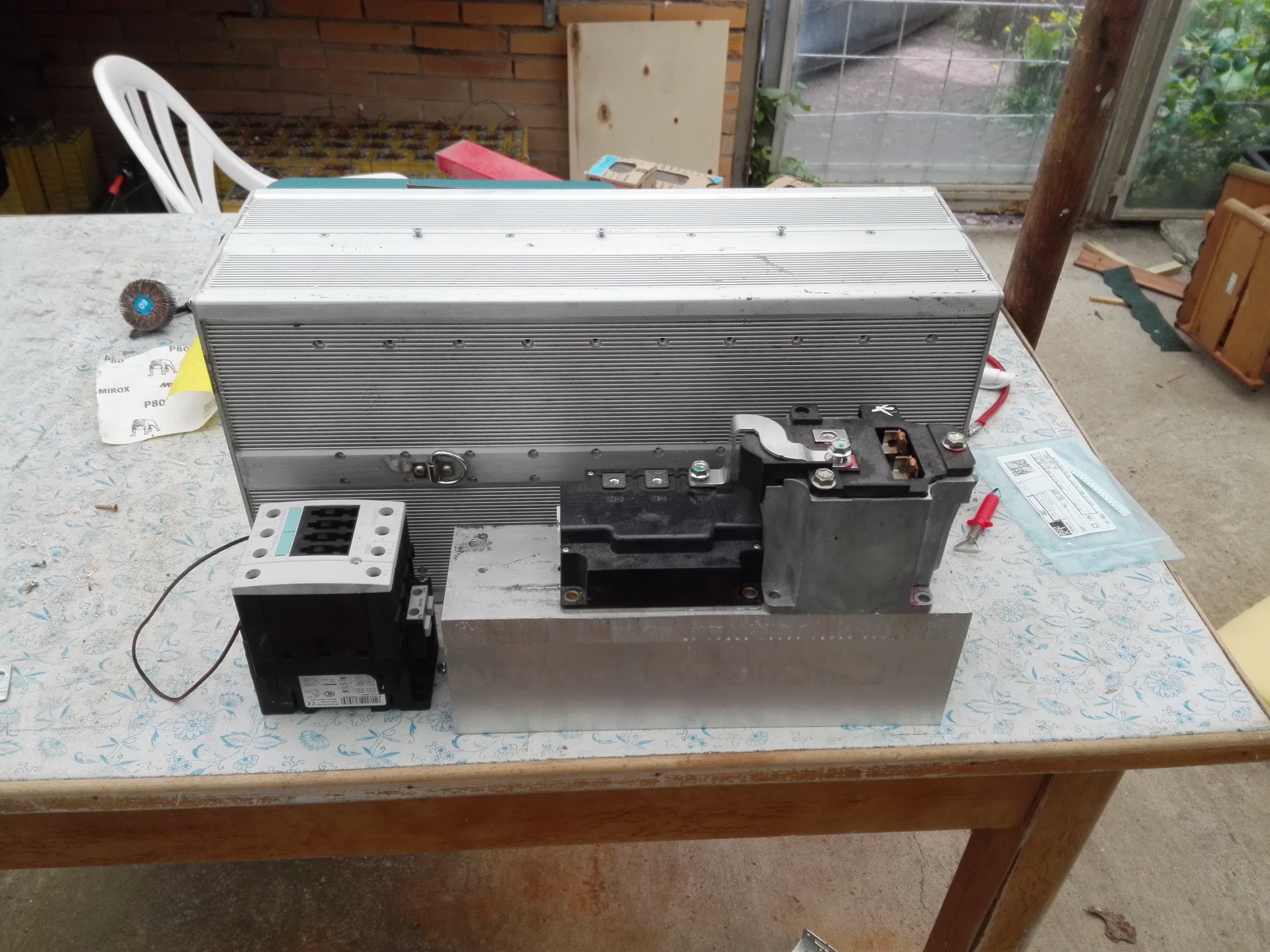

If you can't get the Tesla chargers, you could build a 43kW 3 phase charger out of two prius gen3 inverters. The budget is completely dependent on how cheap you can find the non-Yaris/Auris/C ones that have 400V dcbus1 capacitors.
Been thanked: 1914 times
Re: e-cannonball 2021
I have a Gen2 inverter handy plus the inductor and IPM from another Gen2 inverter. And I have a Gen3 Prius inverter. So the last one alone should get me how many amps? I guess we have a current limit for the inductor, not a power limit. So if it's 20 kW@200V it would be close to 40 kW @ 400V, right?

The Prius fast charger sounds like a good idea. I still have a large heat sink and a nice enclosure left over. It will be an air cooled design because it weighs less. Of course I can't fit any (decent) input filtering...
Pictures later.
EDIT: the idea is merely to be charging at all if all DC chargers are occupied instead of not charging.
So like this...

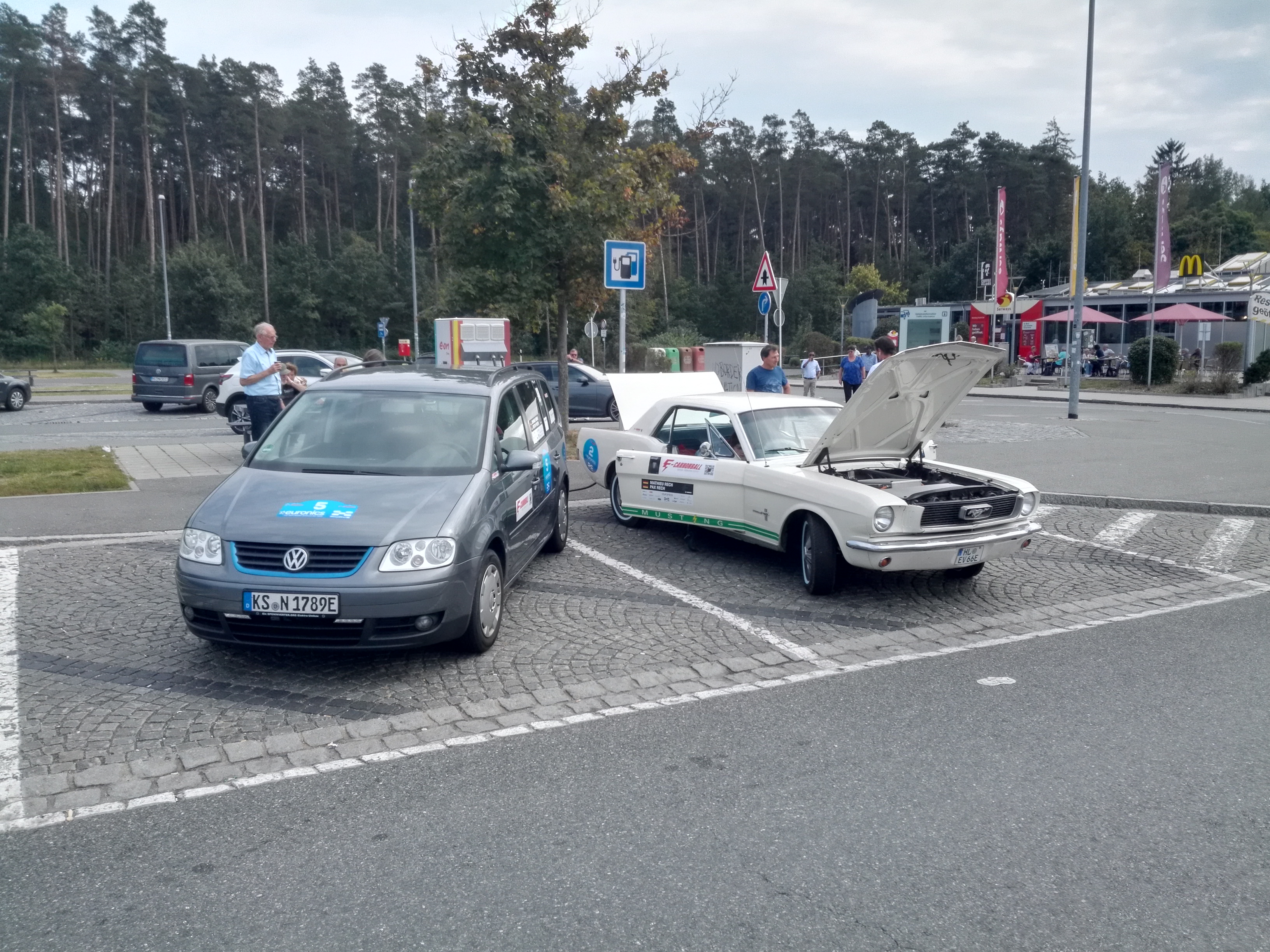

Finally yesterday we drove back home to Kassel which was another 500 km. That time it went semi-good. We actually met Mathieu with his Mustang at the first charge stop. He was using the full 43 kW AC power of a triple charger and the charger didn't allow us to start a CHAdeMO session in parallel.
So we tried to continue to the next one but the road was closed to reach it. So we continued to another one which stopped charging at 60% and didn't want to restart. The CHAdeMO inlet was quite warm so I suspect some chargers don't like that. From then on everything went smooth, except Kerstin forgetting her phone at the last charge stop, adding another 20 km to the trip ;).

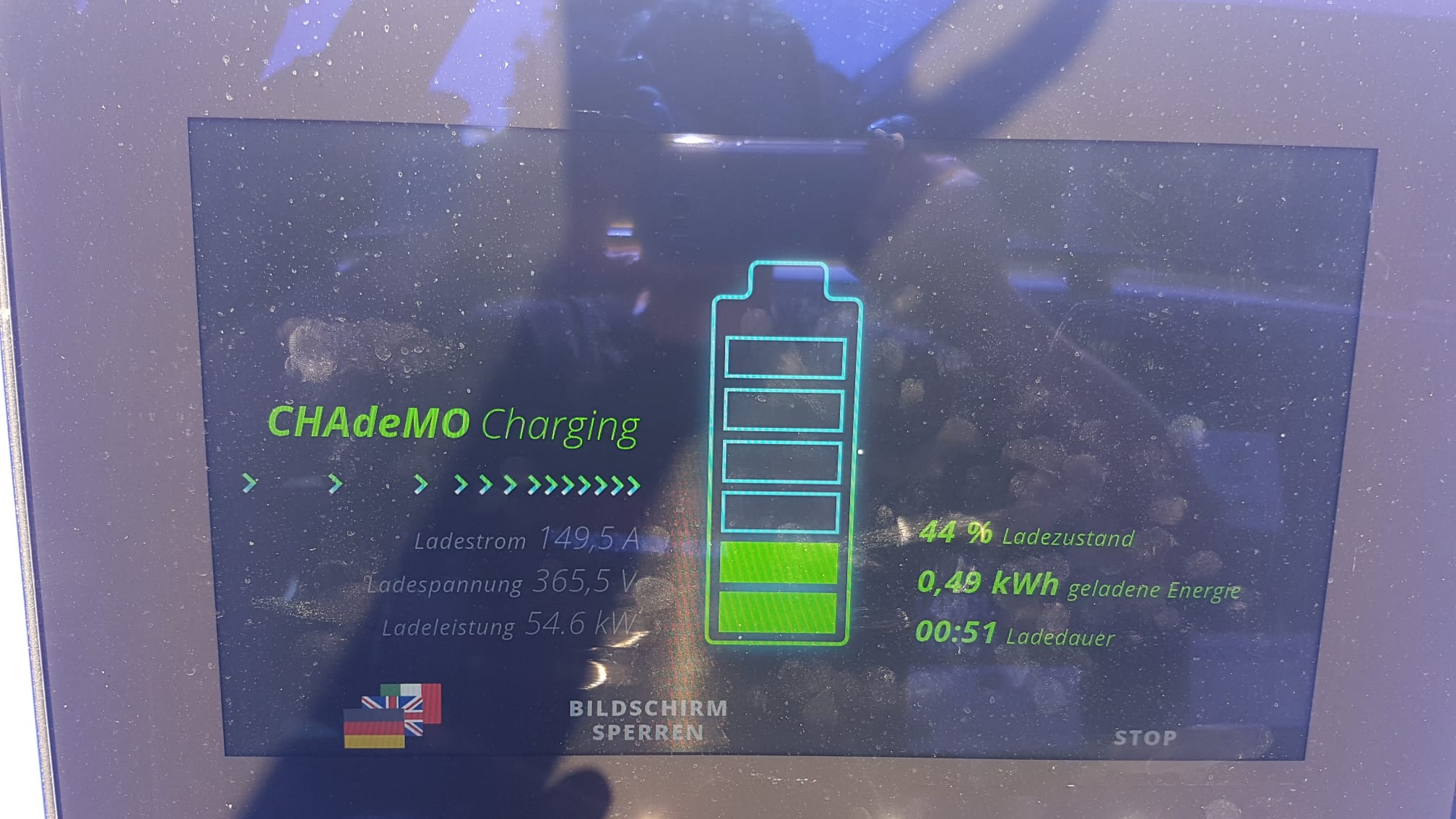

EDIT: we encountered another 100 kW CHAdeMO charger. I could have let it charge at 70 kW but since Nissans relays are rated 150A for 2 minutes I limited to 150A and later to 130A. Still we saw a 56 kW peak :)
