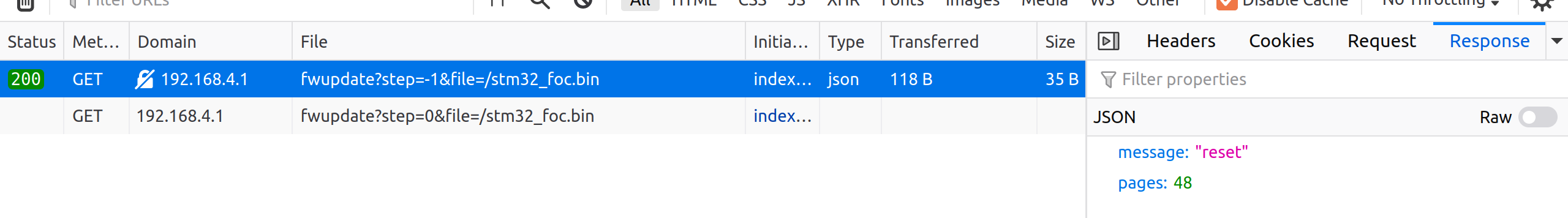

Ok, I am struggling with this again today and bricked an inverter for the moment.
I can download http://192.168.4.1/stm32_foc.bin from the ESP and it has the same SHA256 checksum as the file I uploaded.
runUpdate gets to -1 for reset, returns { "message": "reset", "pages": 48 } , then 0 hangs forever.
I tried manually triggering var file="/stm32_foc.bin";runUpdate(-1,file); but get the same behaviour.
A quick look into FSBrowser.ino reveals that -1 is the reset command, and 0 - 48 copy the file (makes sense). I wonder what goes wrong in the copy process that halts the ESP altogether despite the file being fine?
I am now browsing handleUpdate and am wondering what fails. Serial.write can be assumed to work in principle because it is used in the reset path for -1 already: https://github.com/jsphuebner/esp8266-w ... r.ino#L313
Corresponding line in bootloader sending the 'P' that Arduino Serial.read is waiting for: https://github.com/jsphuebner/tumanako- ... der.c#L199
It looks like the desired response sequence from STM32 is '2' -> 'S' -> 'P' -> 'C' -> 'D' during the upload process, with ( 'P' -> 'T' and 'C' -> 'E' indicating timeout and errors). Now unfortunately I can't see the UART communication.
I think it waits for the 'C' but never receives it?
Edit: Tried flashing stm32_loader.bin and now it times out at step -1.
Edit Edit: Tried flashing another inverter on the bench with a spare ESP, and got to the same place, noteworthy: That one only wanted 28 pages, both now timeout at step -1 already for both

Now the only question remains: Why does the ESP fail to update it? I have an open inverter (ha ha) on the bench now where the ESP web upload does not work in the same way it failed yesterday in the car.
Edit: Ok, I will hook up a USART to USB adapter to listen in and print on the terminal what ESP & STM say to each other, hopefully that will help figuring out where it gets stuck and doesn't allow updates when it has half a firmware on it.
Edit Edit:
Ok, there are human readable debug messages between the inverter commands! Surely that is not desired behaviour?
I can see "2SPCPCPCPC..." when it is updating, but at the same time I get output like this:
handleFileRead: /style.cssUnknown command sequence
handleFileRead: /chart.min.jsUnknown command sequence
So me loading assets from the webinterface sends commands to the inverter. But I sketched the arduino with DebugLevel: None; DebugPort: None and still get handleFileRead: output.

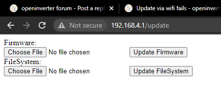

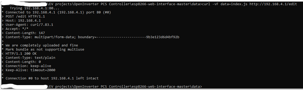

I believe I have had this issue appear recently as I finally got around to implementing the Tesla PCS controller board that has been sitting on my shelf since mid 2021. It was working well until I tried to update the board firmware using the web interface, after which the board completely stopped responding. I am almost certain that my issue is the same reported here because 1)My ESP8266 firmware was an older version that I hadn't updated, and 2) the controller micro bootloader seems to be intact (sending "2D2D2D" when i connect directly to the serial lines), but 3) any attempt to upload new firmware to the microcontroller via the web interface appeared to succeed but had no effect on restoring normal behavior.
I am in the process of updating the ESP8266 from its originally shipped firmware to the latest version (e87dc18..). I believe I have updated it correctly, but it looks like I deleted the filesystem in the process... I get filenotfound at 192.168.4.1 and [] at 192.168.4.1, however I do get redirected to a very simple update page after a delay.
esp8266 update page.png (8.75 KiB) Viewed 19663 times
I am now struggling to with how to reload the files required for the web interface. It feels like it should be straightforward (use the update filesystem button on 192.168.4.1/update) but i can't figure out where to find the appropriate .bin file, or how to create it. I am not a software developer, this endeavor to re-flash my esp8266 was my first experience with the Arduino IDE, Github, or TTL serial... what am I doing wrong?
janosch
Posts: 329
Location: London, UK
Has thanked: 98 times
Been thanked: 106 times
Re: Update via wifi fails
Post by janosch »
Ken_S wrote: Sat Sep 24, 2022 10:07 pm filesystem update
You are nearly there! There is no bin file for assets, you just upload the html/css/js/png assets directly.
The *.bin file is updated via the button once you have index.html & index.js in place.

I am stuck at this step... I am not sure if it is something I am doing wrong?
This is the verbose output of curl when I try to upload index.js.
I am not an expert, but it appears like it worked correctly? However, when I then go to 192.168.4.1/list, I still see an apparently empty filesystem [].
I was using curl to delete extra files from the filesystem at the beginning of this saga, when I thought the problem was too many attempted uploads, and I was able to see files in the list at 192.168.4.1/list, delete them with a curl command, and then refresh 192.168.4.1/list to see that they were gone. What am I doing wrong now?
one note: I wasn't able to get the commands listed in the wiki to work exactly as written, if I left the single apostrophes and the @ symbol I got the following return:
>curl -F 'data=@index.js' http://192.168.4.1/edit
curl: (26) Failed to open/read local data from file/application
but as shown in the screenshot, it works if i delete the @ and ' ' from the statement... could this be related? I am using a windows 10 laptop if it matters.
[EDIT!] I got it to work... I don't understand what the @ symbol does in curl, but adding it back in and forgoing the ' ' apparently caused the files to be uploaded correctly!
curl 192.168.4.1/list
[{"type":"file","name":"index.js"},{"type":"file","name":"log.js"},{"type":"file","name":"inverter.js"},{"type":"file","name":"index.html"},{"type":"file","name":"log.html"},{"type":"file","name":"wifi.html"},{"type":"file","name":"wifi-updated.html"},{"type":"file","name":"ajax-loader.gif"},{"type":"file","name":"refresh.png"},{"type":"file","name":"style.css"},{"type":"file","name":"gauges.html"},{"type":"file","name":"gauges.js"},{"type":"file","name":"gauge.min.js.gz"},{"type":"file","name":"chart.min.js.gz"}]

Ken_S wrote: Wed Sep 28, 2022 7:06 pm ...
Neat.
Whats the output from these two commands:
curl --version
echo "$BASH_VERSION"
I am using curl 7.68.0 (x86_64-pc-linux-gnu) and bash 5.0.17(1)-release.
Why don't you modify the wiki to leave a hint or try to change the script so that it works on both versions? Might help the next person.
