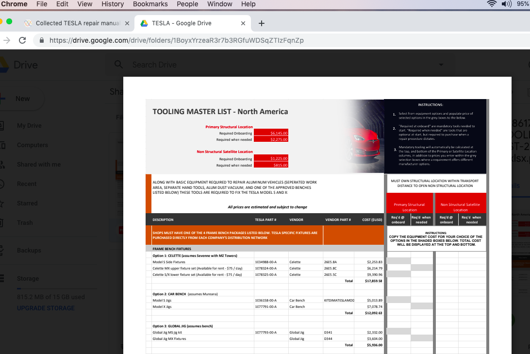

Kevin Sharpe
Posts: 1339
Location: Ireland and US
Been thanked: 8 times
Re: Tesla main juction box model S
Post by Kevin Sharpe »
Johaljaswant wrote: Wed Jul 03, 2019 4:57 pm Could not down load any thing my Drive said no recoded activity.
Link works fine for me and I can access documents (see screenshot)... maybe it's an issue with your browser (I'm using Chrome)... why not try looking up that error message?
