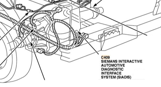

I guess you are testing it on the bench, or have you mounted it inside the TIM?
When mounted in the truck, the wifi is plugged into the "SIADIS" connector (was used for diagnostic/programming on the original TIM)
Will take a picture of the "SIADIS" plug

Connecting the olimex wifi module.
Connector C409 has a dummy plug, use a plug salvaged from the battery box, and connect like this:
Save the dummy plug, for water protection.
Connector C409 is placed on cable coming from the TIM connector C4998
